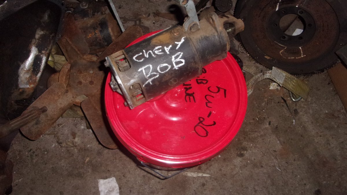

    If you shoot me a photo of the 29 starter, I might have a spare off of my 31 that I can send you.
    The car is packed up in a storage shed. Since 29 and 31 had identical 6 engines, starters should be the same.

    Geez, starters, starters and more starters: Bob Jr was chatting with Jim last time, when Bobs 51 Chevy truck was driven over for a visit. I never knew, but Bob told Jim that he had overheated his 51 starter years ago as it was a barn find start up, and it kinda acts up when very hot driving temps... Well, Jim brought one over for him yesterday, pest that he is... :) He put it just inside my front shop door...geez, add another freaking starter in that area! So I said I'd better mark it and he said he was going to suggest that (but why didn't he?) Like I am a mind reader, or what?

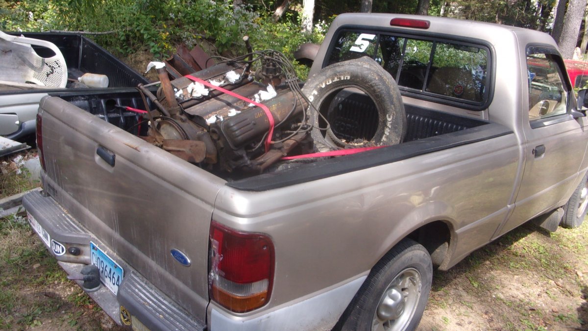

    That Olds Rocket is being picked up by Kyle in a day or so, for his 30 Chevy rod! Hope it don't rain! It has a 40 Ford trans on it now, but that won't hold up to HIS abuse! Maybe go with a 37 Buick Roadmaster with Olds V8 gears like the 32 has??? he wants a stick, not the hydro..

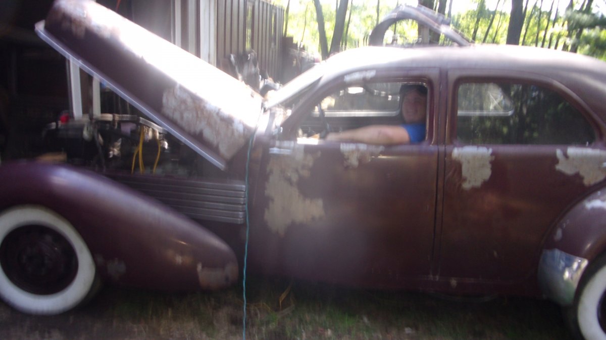

    Today, the Cord gets what should be, I hope, the final engine diagnosis.

    Lots of stuff going on lately, but Kyle was here to pick up the 303 Olds Rocket for the 30 hotrod that is still here. I had taken the 303 out of the LaSalle room a few days ago, while there was a clear shot when the 35 went out, and before the 34 went into the rear bay.
    Then he helped with the Cord which was already outside when he got here. Man, this car is SO hammered...I have NEVER had a barn find that was so abused as this poor Cord! We messed with the engine RPMs, both of us trying to zone in on what the heck noises are going on... The pan is coming off soon! But, when they backed into something to mash in the Left side tailpipe, it caused a Z shape bend in the left exhaust pipe, which is now blocking the oil pan from dropping down. Here he is striking a pose that I asked for, for my FB peeps.

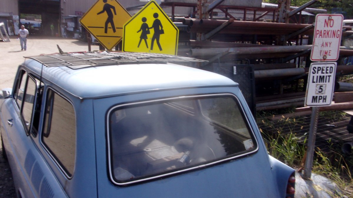

    geez...it's not easy doing two sites.. I will be on the Cord tomorrow if all goes Ok. My jackstands were tied up till today, and that Cord needs those to get it high enough to drop the pan. Oh, I did get my "Cutie fix" at the scrapyard Saturday...first of 4 of them was a freakin goddess I tell you whut... Long sandy blonde hair tied back out of the way, so she could find good stuff... she was buying a sweet 30 foot tow chain,, I said "nice hooks" LOL. I was serious though. She must have been checkin me out earlier as she knew I bought to 4x4 foot square sheet of rack stuff made from 1/4" rod...she said she bought one here before and used her roof rack.
    ^^(as I said on the other site; I always park at the "no parking" spot, I never have to look for a spot that way)..I then tied mine to my roof with a one dollar ratchet strap I found there, and two rubber bungees and a floor mat from Bob P, whom I saw there, he's an old friend that was in the aircraft salvage & scrap business. I asked him about the US Army UH-1 Hueys he had sold, when I did not know they were to be sold. :( I wanted one for yard art! He said the last two also were also put back to airworthy, the last one is in South America doing remote logging. All 4 were ex-Viet Nam combat units, two were "slicks" and two were short fuselage gunships.. I don't go for war glorification stuff, but those choppers sound so nice at low level flight. Hey, he just sold his big farm for downsizing issues, but did have a Harrier Jump jet (VTOL) as his yard art! I will get back to the scrap place on Saturdays to keep tabs on that princess :) Hey I almost forgot...my kid and his 32 got in a local calendar! pics below. Check out his look...he is a total badass in the pic ;)

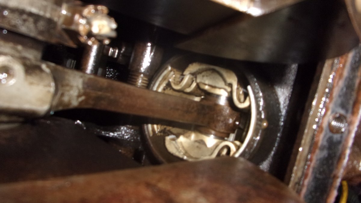

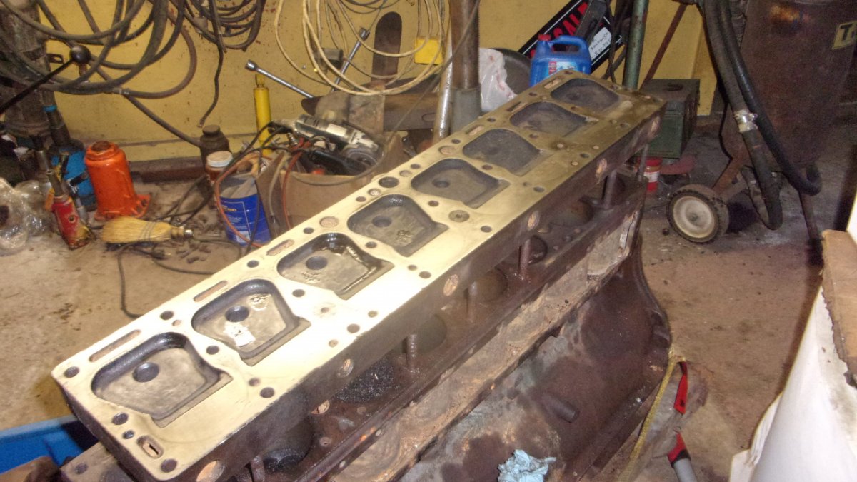

    Things are looking bleak....a LOT of water in the oil. I always let just a bit of oil come out of the drainplug threads to see if there are any water drops, and if so, is it pure clean water or antifreeze. This was pure clean water at the first half ounce, but then it was all light gray "soup", not black oil! I am letting the crank & whatnot, finish dripping before I pull the pan tomorrow. I have not condemned it yet, but I have no idea how this will turn out.

    Maybe rig up a pressure tester with an old radiator cap, the cheap HF leakdown gauge set comes to mind as a good unit for this.

  24. fordrodsteven
    Joined: Apr 1, 2017
    Posts: 98
    fordrodsteven
    I see the crack at 12 o'clock in the picture and a missing piece at 8 o'clock on that piston. Did you find any pieces in the pan? Can you get a replacement piston or a substitute set of pistons?

    Yes, I did see one small piece of piston way up front in the pan. Has sludge in pan bottom which seems odd, because the motor looks like it is too clean if you know what I mean...like the engine was out, not too many miles before parked 31 years ago. Now, was the piston broken then? or did it break here? I need to go deeper at some point. The break looks very clean! At this point, I do know the piston is broken into "two pieces", I just don't know where the break runs to... but I walked away rather that do something dumb like pull the head to remove that piston. It cannot come out the bottom, as most of us suspected. I need, and must, find out about the water first. I cannot just assume the block is cracked or whatever.
    I need to isolate that badly leaking water pump, then find a way to keep the block and heads full of water, then keep watching from the insides of the engine. We never ran the engine with the radiator cap on, it was always open, not under pressure. In hindsight, I wish I had drained the oil before I first tried to start it, or at least checked the drain plug "water test" like I said above. I will measure how much is in the drain pan, then I will know that if it is like 2.5 gallons, then yes, water did get in after or during the many test runs.
    Ron said one head was rotted with a hole showing, so as the intake is also aluminum, I suppose it too could be rotted where I can't see? No sense rushing into a tear down just yet. Kenny did say right from day one that Lycoming straight 6's had problems with cracked pistons(I think he said skirts), but I will ask if those 6's had water/oil issues later this week.
    This shit don't scare me... beats doing rot repair on a daily driver...LMAO

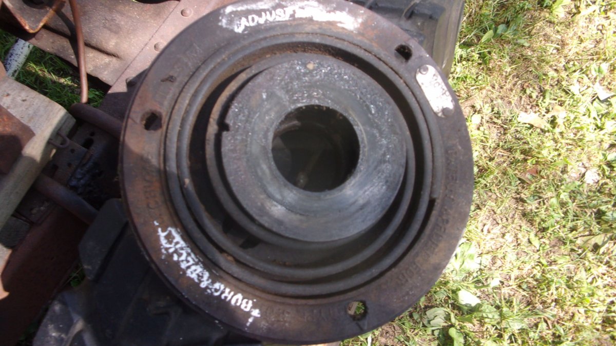

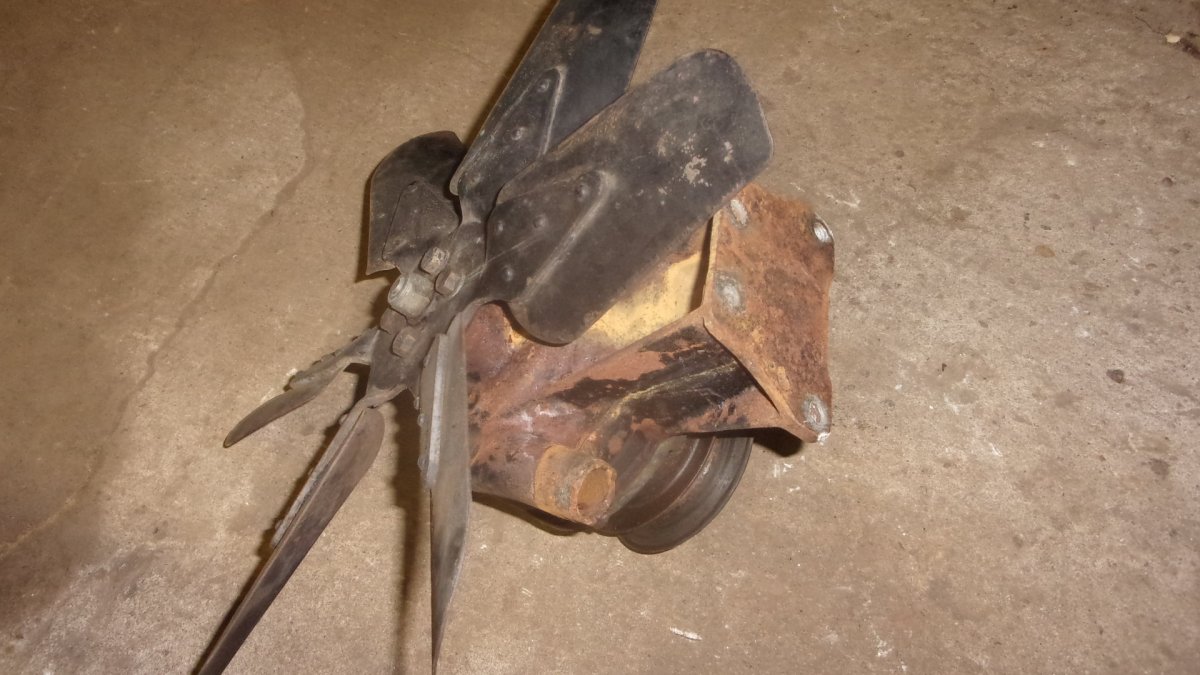

    Today I struggled to get the Cord water pump out, it barely had room, and the fan cannot be removed first, as there is zero room to do that. 100_1341.JPG 100_1342.JPG
    ^^the two hubs are loose on the shafts, may need a lot of machining to repair, the seals are leaking badly, and the shaft bushings are loose, as well as the fan belt adjustable pulley needs repairs!
    The yellow X is where the pump sits. The circle shows the once white towel which filtered the radiator lower hose is full of rust.
    ^^^ that large drive pulley is NOT on the crankshaft, it is the camshaft snout. That is facing forward, but it is the true backside of the engine.

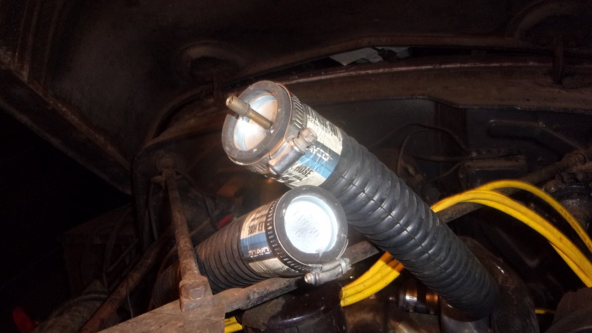

    Then I had to block off all the water hoses for a pressure test. I used freeze/core plugs and one has the inner part of a tire valve stem to add air.
    It FAILED the pressure test. I just went back to the shop at 11PM, and the pressure had dropped, I went under with a light, and water is dripping from the rear left piston, way up at the ring lands! So, it is water on top of that piston, maybe be gasket leak, or crack in the side of bore? Both heads need to come back off, which sucks. Then I can also pull out the right rear piston to see where it is broken in 2 pieces.

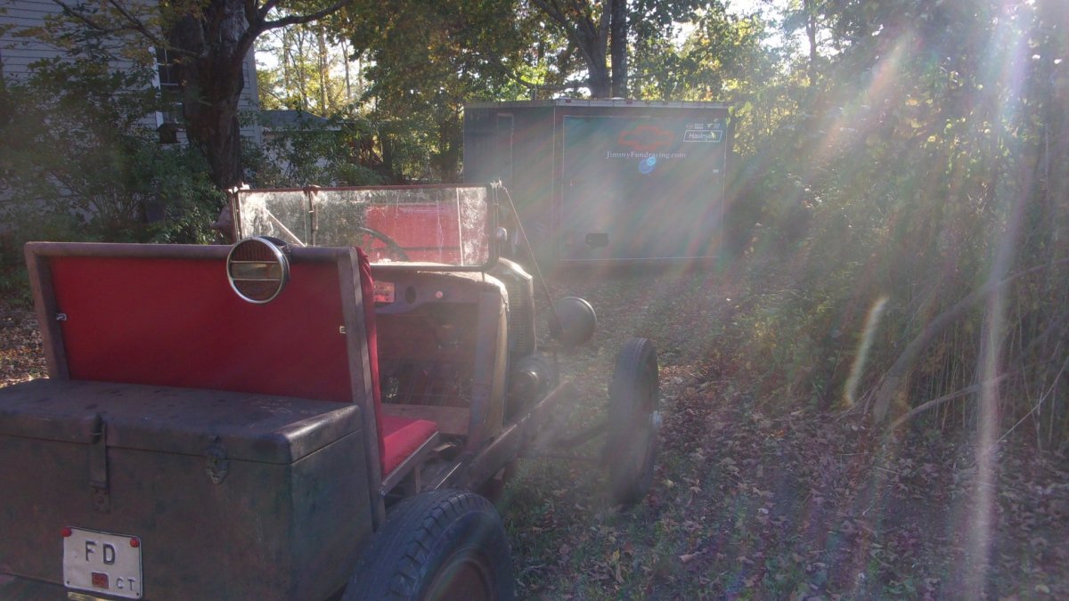

    my quickie hotrod,
    ^^as found^^^

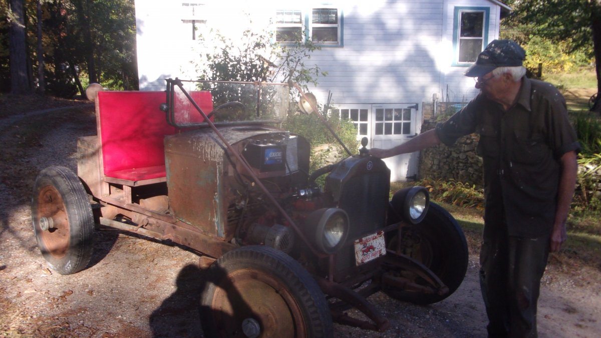

    ^^^at one neighbors home..a couple of weeks later..NOW with a 1920's Star motor, with 20s Moon front axle, 20s Packard rear end. It has 2 transmissions, one is stock star, other is 37 willys. I run it with the 2nd one in second gear.
    ^^^at Chelsea's home, she owns a Model T open cab truck...with stock motor
    my two bugs below, other is a 1930 Whippet w/International 2 speed rear
    I also drove the Model A to the neighbors, and out on the road. LOL

  30. Hi Frank
    Is that a 30 Buick tail light on the Star ?
    George
    F&J likes this.
