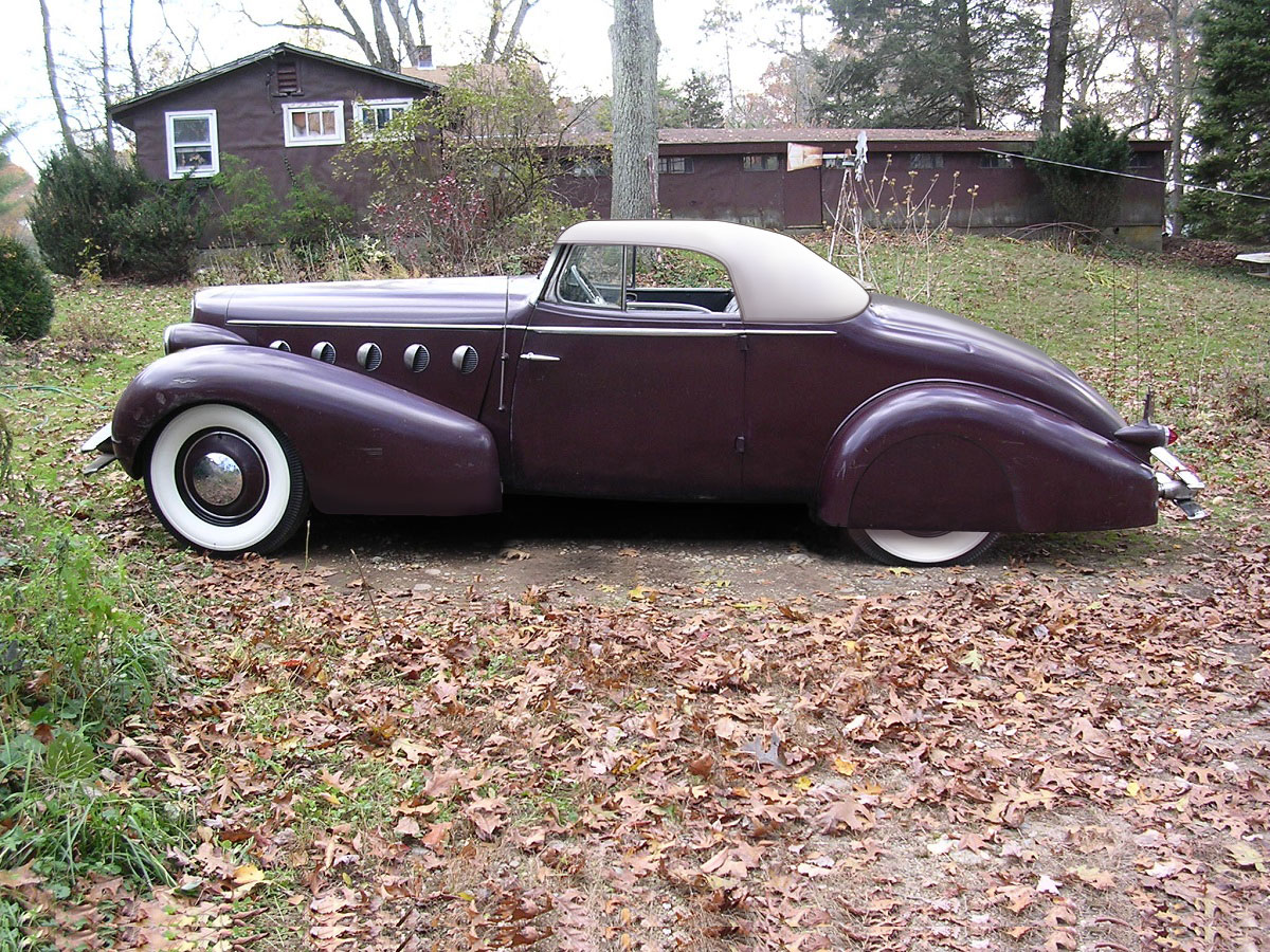

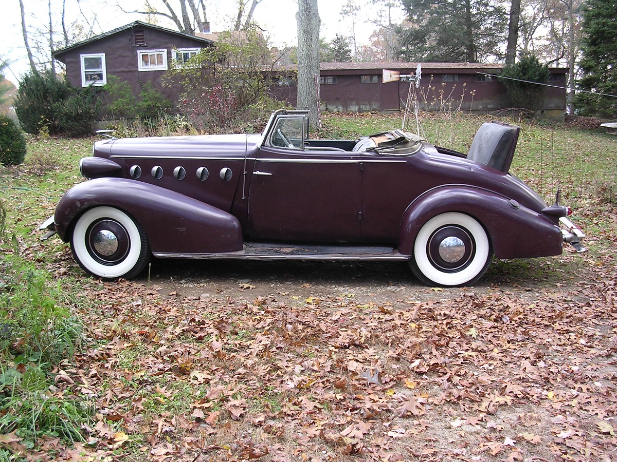

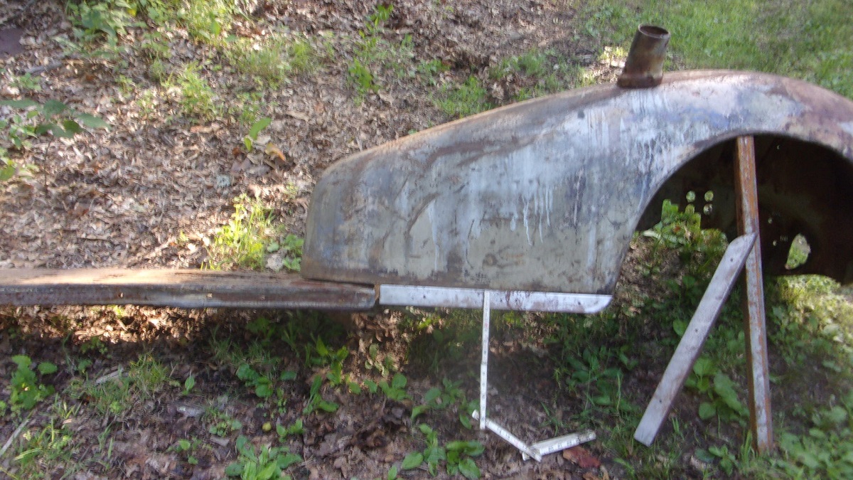

    Ok, here is broken 34/35 grille pieces to show that the bars do come off, but they cannot be put into a different pattern as there are eyelets on the one-piece outer grille surround. Also, the fine thin steel ertical fins or whatever, are held in place by the crossbars. THE 36 is all one casting! Nothing is separate...except emblems.
    Here is a fender mock up with running board and running board extension that bolts to front fender rear half.
    All these pieces will be eliminated on the channeled 35 Conv. It is 1-3/4" tall, for the board thickness and extension.
    here is/are the pics I would think is OK for a Photoshop? I'd like to eliminate the running board and extension, then "move up" the front fender alone, by 3" approx.? Also a skirt installed on rear?
    Then we should see that the top of front fender is now closer to the long body side moulding strip, and that the top of rear fender with be lower from that strip. I am hoping the effect with skirts on, that it may make the car seem raked? I don't know the words to describe the "fooling of the eye", but I hope that strip and fender tops do something to the eye...but in a good way not an ugly way.

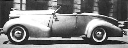

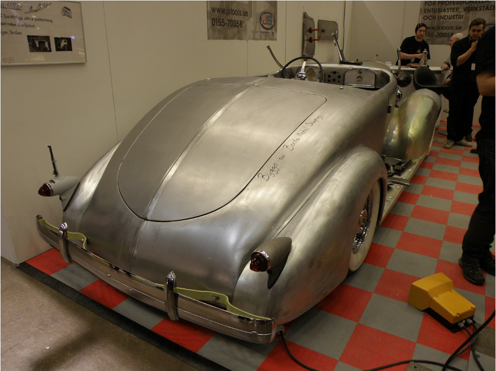

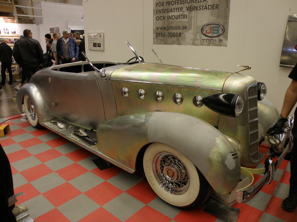

    Time for som inspiration , here is a car made from a -35 LaSalle 2door sedan , rear end is scratchbuilt . I saw this in Sweden in 2013 at a carshow after hearing about the build for years :
    https://public.fotki.com/TinWolf/custom-cars-clubs/elmia-2013/p4010089.html#media
    These guys are not aiming for traditional custom but coachbuilt style , still very impressive to see the craft
    https://public.fotki.com/TinWolf/custom-cars-clubs/elmia-2013/p4010087.html
    2.PNG https://public.fotki.com/TinWolf/custom-cars-clubs/elmia-2013/p4010111.html
    https://public.fotki.com/TinWolf/custom-cars-clubs/elmia-2013/p4010112.html#media

    Okay, i think i got this right....raised the front fenders around 3" (and added the filler panels back at the base, as it looked a bit "chopped off" without them and made them look raised in comparison to the rears). Yanked the running boards and lowered the back of the car so it matches the front (the front wheels were raised with the fenders, so i had to do the back to match). Added skirts and a top.
  10. F&J
    Joined: Apr 5, 2007
    Posts: 13,291
    F&J
    Awsome description that even I can follow after a grueling hot/humid day of work! I see the front fender fillers you added...and the very rear underside part is hidden a bit in the shadows under the car....but I can almost "see" that the tail end lowest rear tip "bottom"should end up being rounded a bit, not a sharp bottom "point"?? I will mock up both a sharp pointed bottom, as well as my idea of a rounded under part... SUPER!
    Again, I do get your description perfectly! One very important tidbit I forgot to say>>> The new 1935 LaSalle ch***is was said to be one inch LOWER ride height as compared to a 1934 LaSalle like the maroon car shown in this post! So, I bet I can get the same front end lowering you ended up with. The rear with leafs will be simple with just blocks!
    The skirt type is EXACTLY what I wanted!...however, the Carson type cut of the roofline is not what was in my head. The 34 conv has a very "ugly" look to the stock top and framework. However, the 35 convertible has a VERY nice looking top shape that I do hope to be able to execute ..
    Understatement beyond my words! It is STUNNING! I love it. Now I have the git-up-and-go, to try to do your plans some justice. I will keep trying till I get it right! I simply cannot believe that the "raised fender" flows so nice without ever needing to section the back body, or raise the rear fenderwells. This alone makes for such a simple easy build that will look so perfect! Thank you so much, James! Now I sit here waiting for my son to show up so he can see this :) He was giving me some pointers himself a few days ago, and it sure seems he has crossed over the line to knowing what the word "traditional custom" implies. he, he
    Thanks again, Frank

    P/S I really love the 3" lowered hoodline! Shezam!
    Runnin shine likes this.
  12. James, this first pic is absolutely fantastic!!!
    Hnstray and F&J like this.
  13. tb33anda3rd
    Joined: Oct 8, 2010
    Posts: 17,588
    tb33anda3rd
    34-LaSalle1.jpg this is awesome! i would love to see it with the luggage rack on the back.
    Runnin shine, kidcampbell71 and F&J like this.

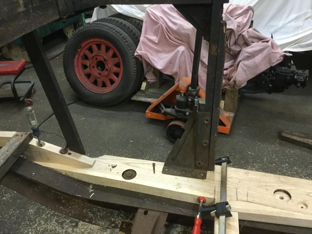

    Ok, the body framing: I just grabbed some pics from a resto thread on AACA website. It is a 32 Olds 6 convertible coupe being rewooded by a talented guy over there. I will use these pics to try to tell what my 35 will have for steel framework instead of the original "bulky wood".
    ^^^ see the flat wood sills that run from firewall back to the start of the rear axle kick up? My car will have a have a heavy gauge steel angle iron piece instead, The longest tail of the angle iron hangs down from the top of framerail.
    Then in that pic you can see what that builder calls the rear "kick ups". The kick up bolts right down through those flat wood sills, then the kick up beam goes up over the rear axle and back to the tail end of body.
    My 35 will have kick ups made from thick wall square tubing rather than wood.
    ^^^ these last two pics show the B pillar attached to the sills. There is that steel brace, as well as the pillar is screwed into the outside of the sill. On my suicide door LaSalle body, the door hinges are hung on the B pillar, so it needs to be very strong and solid. I will use some type of steel tubing, modified, to make these B pillars.
    I will end up rebuilding/reframing the body without any need of temporary bracing at all! I do that ALL the time on every steel replacement I have ever done, going back to the late 1970s. I simply cannot get inside the damn car to fit and weld anything if the temporary bracing is a tangled spiderweb in both door ways! Watch how it goes once I finally can get started :)

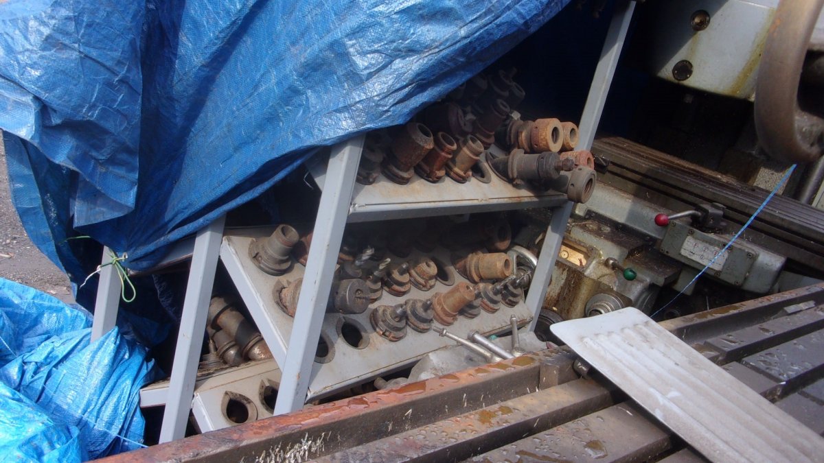

    Alrighty, I busted tail on the smacked Mercedes today and maybe have one hour more workbay weld/task left in the morning...then drive that dang thing out.... so I can finally put the 35 Ch***is in there for a FULL month,( before the 37 Cord arrives in mid August.)
    I did get to the s**** place by 8:30 this morning as the C50 owner said "some machine shop machines" came in,,, he first said CNC, then changed it to Bridgeport, then changed to Cincinnati ???
    There are TWO of these, and one huge box shaped CNC station that ran both. This thing is unbelievably HUGE,,, 8-1/2 feet tall at minimum. Weight looks like "insane". So big and so heavy, the two partners said "we are NOT moving it to another town for a buyer!" ...and one partner said: "We are going to break them up for s****...maybe today, as I want my money back out of them"
    Table is SIX feet wide!! and the table can be moved extremely far away from the unit base.
    Racks of special Collet chucks to fit the machines...sold by the pound he said. Also a small special grinder that an AACA machinist thinks is a machine that dresses the collet cutting bits! That one is by the pound also and they ***ume $500 for that grinder machine. 100_0251.JPG

    great build, really well considered tweaks to the lines to get a beautiful car.
    Makes me week to see quality machine tooling get weighed in for s**** but what can you do, they are m***ive!

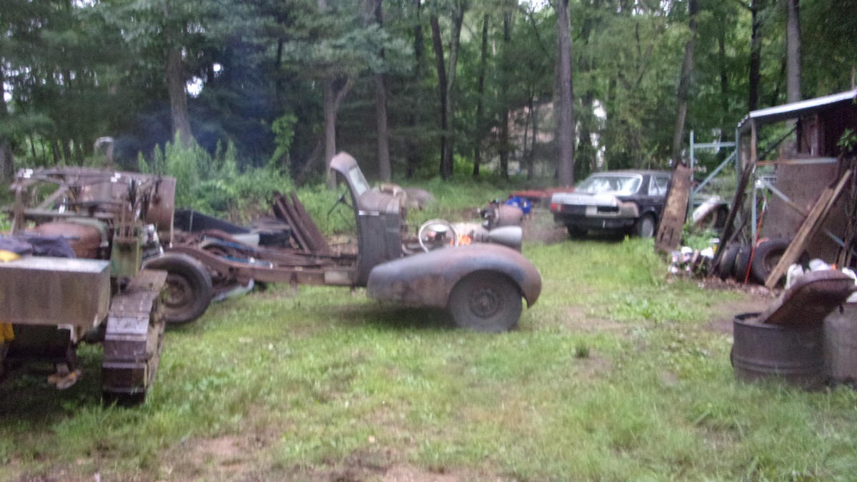

    First thing early this morn, was go grab the LF tire/wheel off my 34 Conv, to replace this one below, on the RF of the 35. I need two tires that hold air for this slam bang move!
    Joe G tried to put air in this one at the barn find day. I heard it blow, yelled "you OK?" he said "no problem" :) He was working in the barn darkness and never saw where it blew, and still does not know, as we never looked at this tire later or since that day.

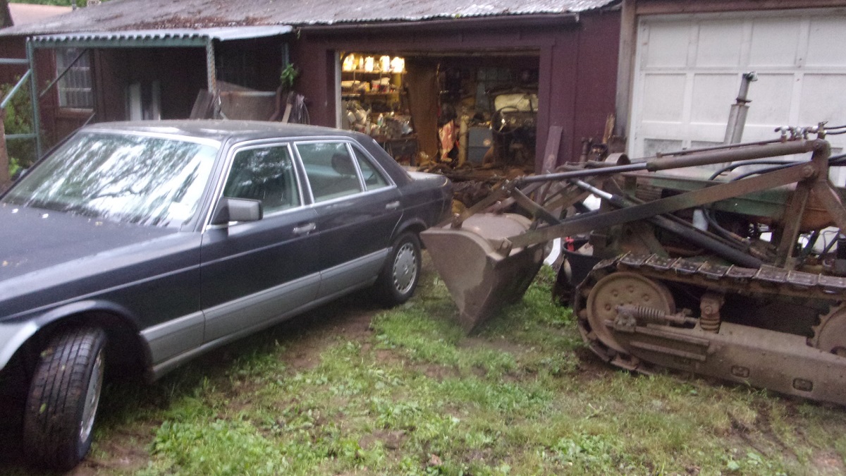

    Then the next thing was to move the Mercedes outside, and out of the way, but first I needed to back up the 72 C50 that my friend parked there in the way two days ago. The Chevy started right up and ran sweet....but the jack*** Mercedes was stone dead! Where the 'ell is the stupid hood realease?? I knew there is a safety latch thingy that pops out of the grille later, but I cannot find the friggin handle....up the dam house to look on the net! Yep, other people can't find theirs either.. Good goin you A-hole designers. LOL
    Get the hood open, charging the battery at 50 amps while getting the crawler going, dragging the '35 away from building to swap that tire... got that done, and now the battery charger is wicked hot...but the Big Pig actually started up finally.
    Now I actually remembered to leave that POS MB running when I moved it away far enough,,,,but now the heavy damp air is filled with the stink of catalytic converter... wow, such a nice car, ..
    Now, hook a chain inside the bucket where I put a center hook a few months ago, That hook lets you pull up equally on both ends of a car frame, then lift the *** way up, and you can get incredible dexterity to move a car in such tight quarters..
    I did this move by myself and it went SO fast... and just by tickling each track brake, you can guide the front end precisely where it needs to be, with zero damage to anything.
    .Move Miss Piggy back close to the workbay for welding when I dam well feel like doing it... :) ...then go make a freaking COFFE... Rock On!.
    "Old Age"...no such thing around here with Joe G and I. "we have no age...we are just here".. Once you think of your age as just a record of how many years of life's experience you have, and not get brainwashed into thinking a certain "number" means something....then **** gets fun, and gets better each and every day. Not kidding at ALL on that statement. Live for the day, each and every day, and not wasting brain cells planning for your death. Rock On!!.. (oh, but AFTER my coffee break) LMFAO

    Now Ted my friend, you are starting to push my ****ons with that MB nonsence. I AM DONE with later models for good. I already made that announcement before this MB was accepted by me as the last one. The only reason I took this job is because of one precise thing: This car was totaled. It was hit shaply slightly off to one side by a tree or light pole. The car rolled out of the owners steep driveway for some reason, and that is how it was hit.
    MB is full of "crumple zones" designed to crush in a series to slow the inertia, which saves lives or injuries. I simply did not have the equipment to stretch the "corrugation'' ripples in FRONT of the lay down spare tire well. I told him I cannot fix it unless he gets it pulled. He tried, but only one shop near Hartford, would touch it, but they wanted the 'whole job' and priced it at "4500, but could go 6K". He then found a friend who is in his late 50s with "big ones". The friend asked "how many used rear bumpers and brackets do you have?" LOL...this guy ran a chain to one side at a time, chained to a BIG tree, and had the owner floor it (F-n nuts!...I am shocked the big V8 did not eject out the front)
    They broke two sets of spare bumper stuff but did one heck of a perfect pull, and those corrugated lines were freakin GONE! So, to reward their efforts of trying to fix stuff for themselves in the future (because I won't do late models anymore) I said I would do the clipping. Heck I even clipped the FRONT of this MB 8 years ago! Cut the uniframe rails right at the front of engine. What a s---job, but I got it right.
    Now, the real reason I am pissy about the MB, is actually something the owner said to me just a few days after finally getting my dream car home, still sitting in my lot. He asked what it was, then said "You could fix that up and sell it, then buy a nice new car". I was f'ng stunned, kicked in the stones...here I was so happy to finally rescue that 34, and actually get it home, and he lays the whole asinine brainwashed thoughts of the USA consumer, that a NEW car is somehow better than this??? WTF. I dam well told him point blank quite sternly: "Those three words (nice new car) simply does not exist in MY vocabulary!!" He GOT the point real quick!
    anyways, If Pete would have shown up, maybe I'd get something done today ...
    The motor might be out by supper if the trans spline is not frozen..
    I did do some chalk marks prior, to see what will hit the firewall after the 3" channel. Not much really, just near the manifold.
    I decided the motor needs to come out so I can channel the cowl without removing the cowl. Why? because I want to keep the original wiring at this point, so I can keep the ch***is yard drivable, as well as keeping the wires intact so I can copy/remake new ones later.
    I will head back to shop now, need to unhook clutch cross bar, and kinda hope I can leave one mount brace in place. If not that will only add 15 minutes to remove.
