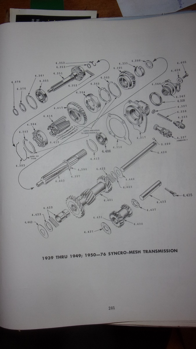

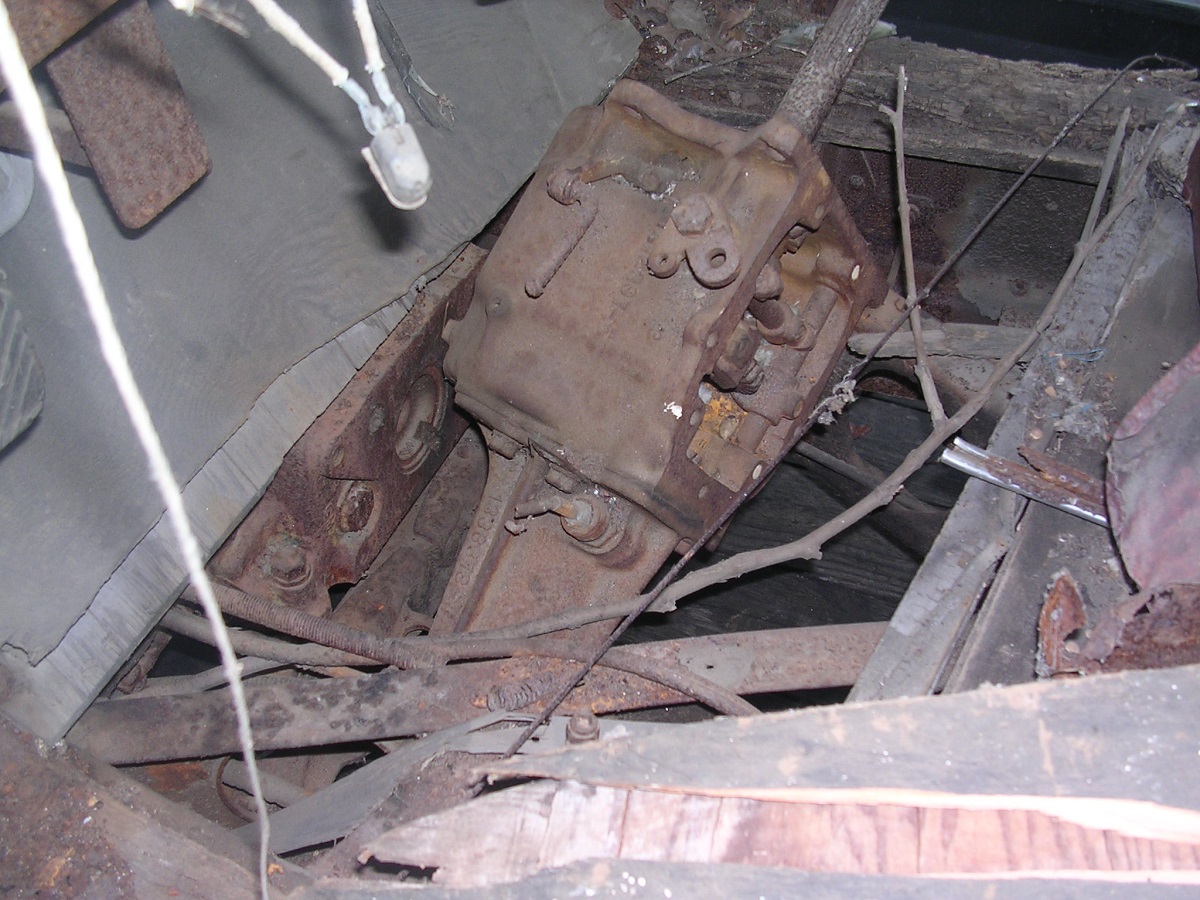

    I checked into possible transmission interchange a week ago, I was trying to find out that if the "new" donor later Olds engine with an attached column shifted transmission, could I get around not wanting a column shifted type trans..
    I must have measured wrong. I was certain that the 334-36 trans face bolt pattern was not the same as the later Olds trans that is coming here at some point. But we found out late today, that it will bolt up as far as pattern.
    That trans can only be one type; a 5 bolt Selector type, and those cannot be modified to use a center located "top shifter".
    here is from a later OLDS parts book I have:
    Well, my son hated the idea of this car NOT having the same floor shift as his 32 Ford with the modded 37 Buick Roadmaster 6 bolt...so I had him carry inside, the rusty Olds Selector that I found just tossed into the tunnel area of the rotted black 4 door.
    Here is how it was found:
    ^^ I ***ume some past owner tried to find a replacement trans for this car, and did not realize that the 34-36 trans has a one inch longer input shaft length. Then they just gave up and let that car rust away.
    Well, now with a clearer head, I wonder if the bell was made deeper, for some reason. I am thinking that my 34-36 bell will bolt right up to the newer Olds straight eight that Kenny will hook me up with. Now I only can just wait until I finally own that motor/transmission, to see if it can all work.

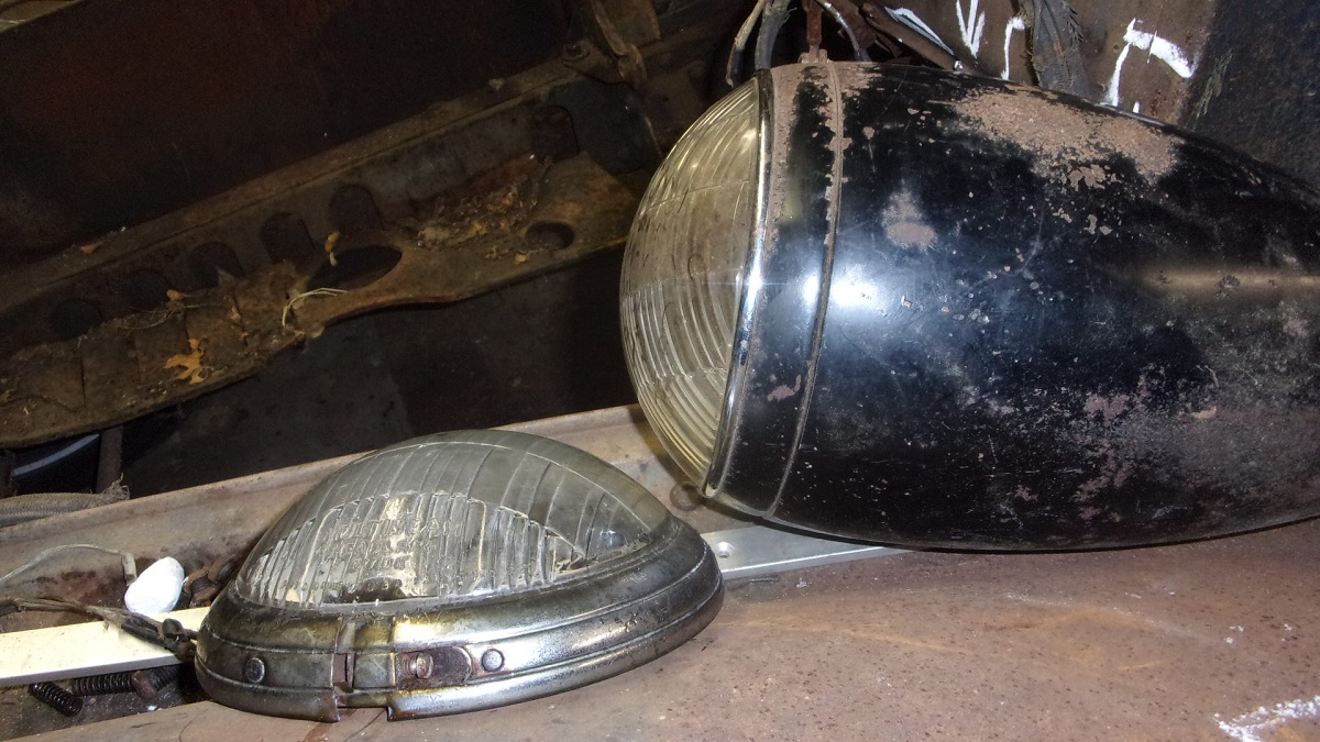

    I did go to that farm/tractor/pop engine, misc show with a decent sized swap area today with that young fellow and his 47 Dodge pickup. Lucky that it stayed cloudy as it is so humid. I did buy 3 of those long C-clamp type vise grips for clamping deep reach body panels.... as well as 3 ratchets, a replacement 11/32 SK Wayne deep socket that got lost. We did talk with Kenny to make plans to go get that later Olds inline engine from M***achusetts, if his wife is OK on her own, for our daytrip.
    Also, I brought a pic on my camera of a missing headlight ring for the 35. He sent me across from his space to see a guy named Roger who has sold parts in Hemmings and Hershey for 45 years. Roger says that mystery rim is "37-38 LaSalle", and it will take a couple weeks to get to his warehouse to locate one. One less thing I need to look for now, if he does have one. It is the loose one in this pic, and it has decorative rings on the rim:

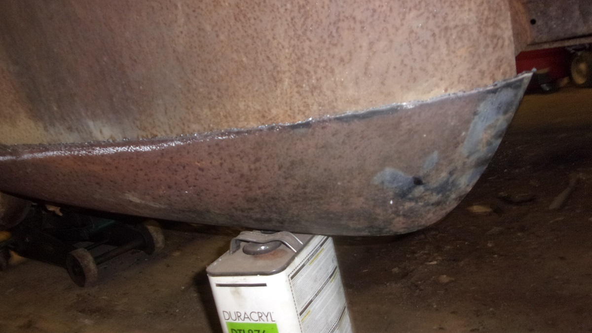

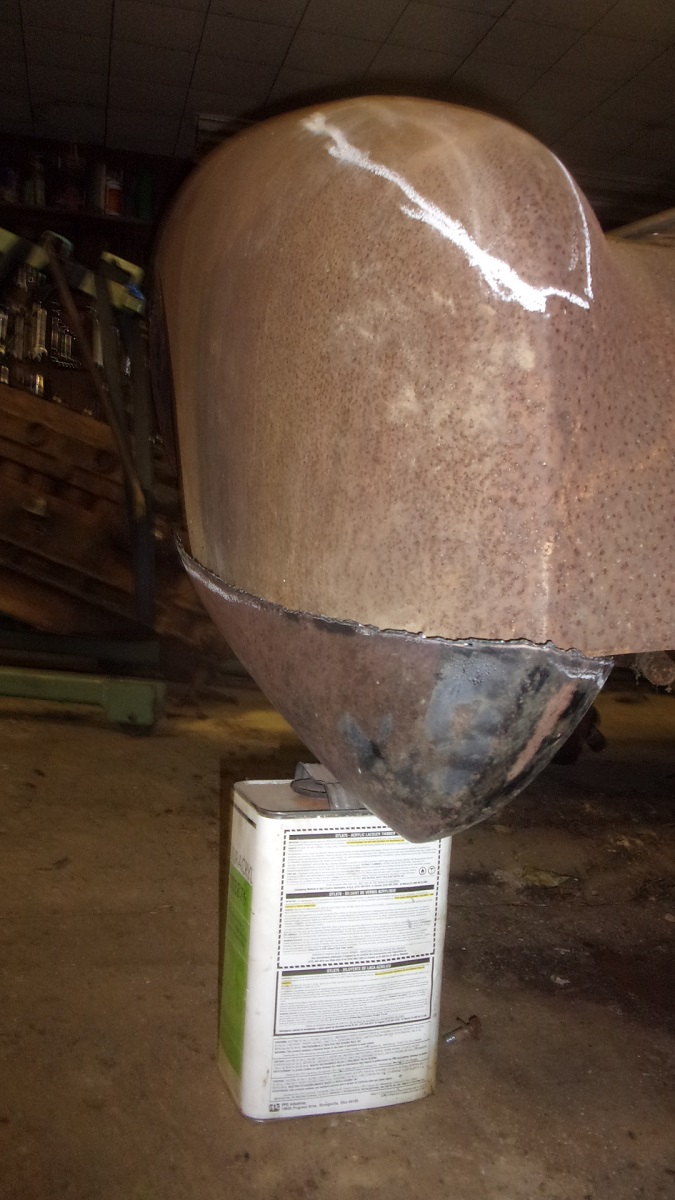

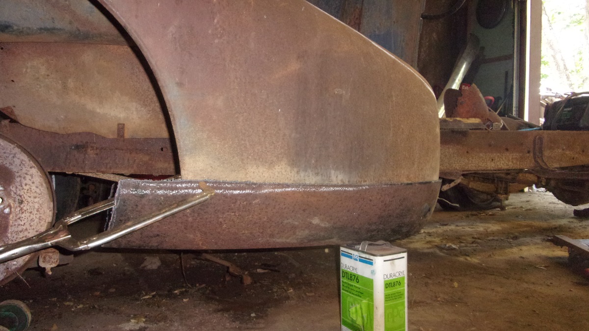

    Ok, I cut up one junk front fender to mock up the lower curved filler panels that James D talked about:
    Ok, to make the transition from the flatness/flat sided area of the stock lower fender edge,....so I will need to cut a lot higher on the good 35 fender.
    The sketch, I hope you can follow it....there will always be a "point" at the back end of fender where the new piece fits. That is due to the patch coming from a "slanted top section" of the donor fender....so the angle at back edge is slightly wrong, but it should still look OK I think because my sketch shows the point more exaggerated than reality.
    Now there is also a problem when looking rearward into the fender lip where the new piece fits. It just rolls under the fender a lot, and the tire treads will throw sand specks at that curled under piece, which will cause road-rash.
    just a mock up for now, as I am a bit too tired to do any real t******* to get it to fit better. I just don't have any extra fenders, good or junk, in case I ruin something by rushing.

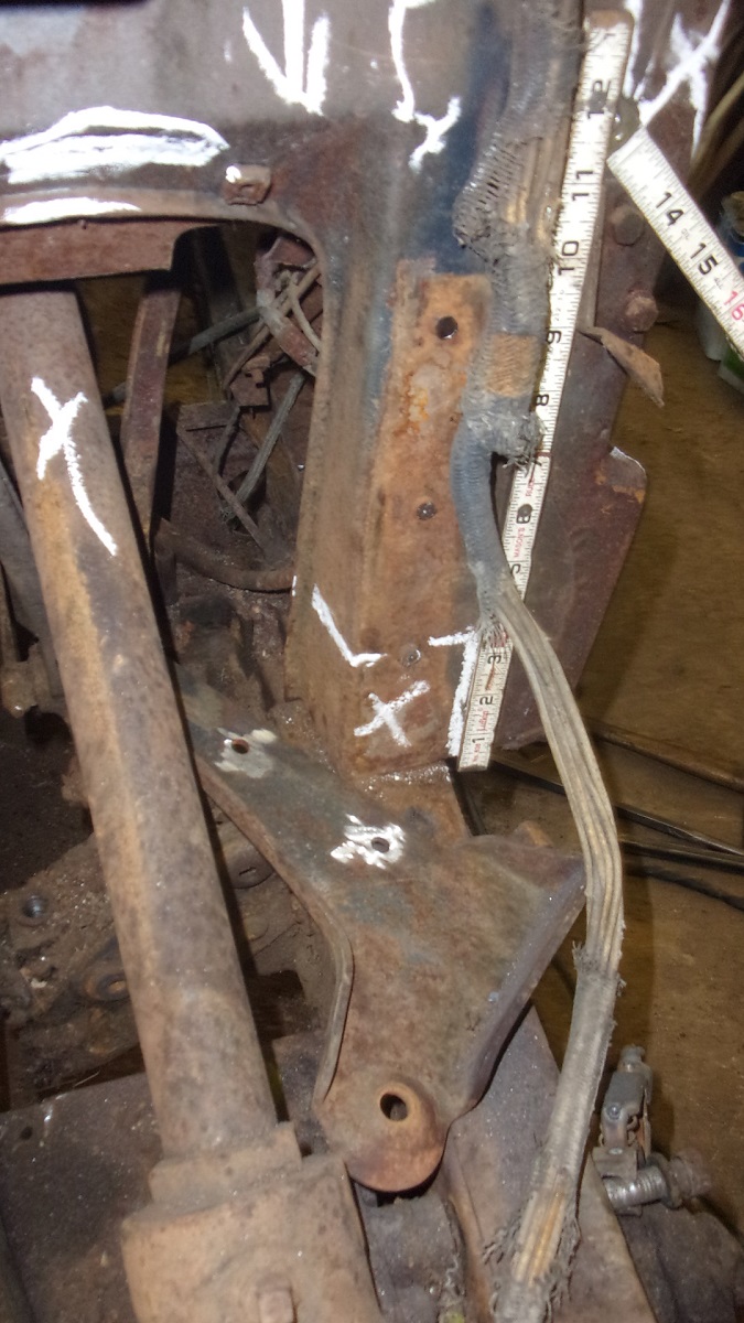

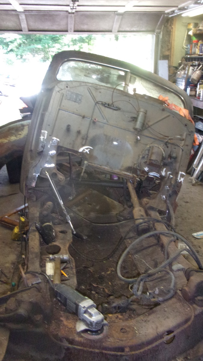

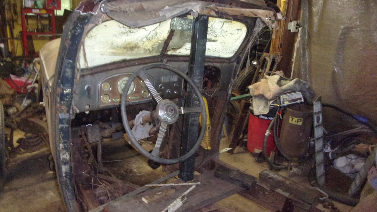

    I got a very early start today.. I am working on channeling the cowl. First thing to do is get rid of the front fenders, then get a true, accurate measurement of where the B-pillar area is, above the ch***is front legs of the center X.
    Pretty cool/convenient in that where I measured down from (the lower edge of dovetail plate) worked out to 12-1/8". My channel needs to be exactly 3-1/8" due to where the 36 grille will need sectioning later, so that means my final measurement there will be 9" exactly after the channel. I need to get the cowl dead nuts, right from the start, so the project can advance at a decent rate.
    The front of cowl at firewall is easy to establish, as there are heavy brackets that are held on with rivets. I just need to move those rivet holes upwards exactly 3-1/8" and then, theoretically, the cowl will end up exactly level again after the channel. Here is a pic of the 34 Convertible when I first brought it here. You can see those two lower firewall brackets right above the frame rails. On the Fleetwood Bodied 34, those brackets are bolted to the firewall, but the 35 Fisher is rivets instead. No big deal, replace with bolts after moving them up.
    ^^^ ok, check out the "new for 1934" IFS with coils and knee action SHOCKS, not knee action front end like the Chevy had. When I took the fenders off this morning, I took a quick look to see how *****y it might be to lower the uprights by sectioning them or whatever...
    I was pleasantly surprised that the forged lower A arms curl around the coil spring bottom. So, no need to mess with lowering/cutting the uprights, all I need to do is lower the spring seating lower plate by cutting off 4 HUGE rivets and replace with long grade 8 fine thread bolts with 4 spacers to lower that plate. It looks like it will work out fine, and not cutting coils like some customs had, the ride will still be so silky smooth like a stock 34-36 LaSalle! I only need to figure out (later), exactly how much that plate needs to be lowered to get the rake I want.
    There seems to be plenty of camber adjustability, so I am not too concerned about lowering the front end and not being able to get the final alignment correct!
  15. F&J
    Joined: Apr 5, 2007
    Posts: 13,291
    F&J
    Geebus, another coffee break??? Well, I also had to dump some camera memory at the laptop. I am going balls out today!
    more pics:

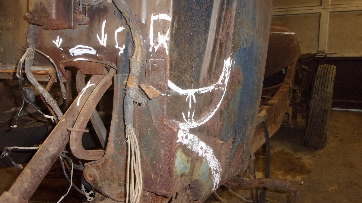

    ^^^^ all those chalk marks are to remind me where stuff needs doing at some point. There is so much going on at once that this is the only way I stay focused on each step.

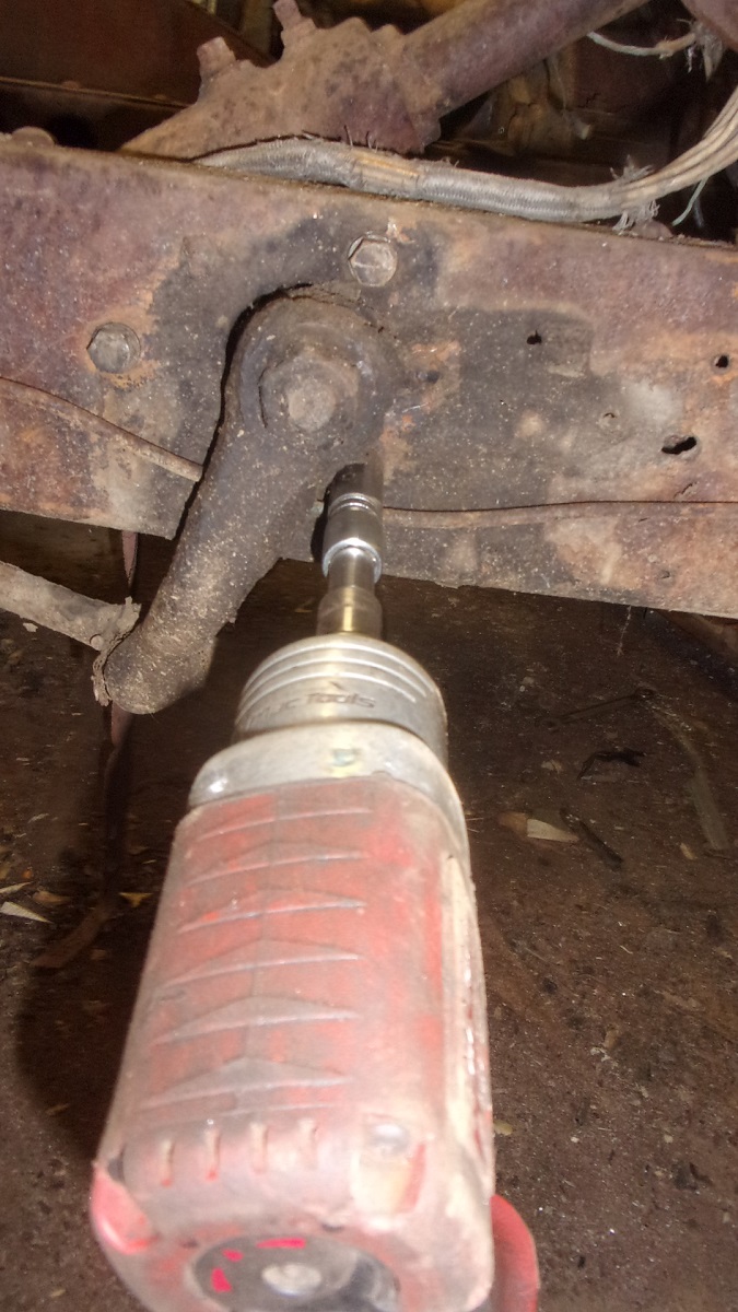

    ^^^ not enough room there for the 3.125" channel, but if I loosen the steering box, I will be able to keep on going:
    ^^ well I see yet another difference compared to the 34. This Saginaw box is a 3 bolt, compred to the 34 four bolt. All of the antique car reference books I have here all say "the 35 LaSalle is essentially the same as 1934" ********. It would be far easier/quicker if I listed the few parts that are actually the SAME!

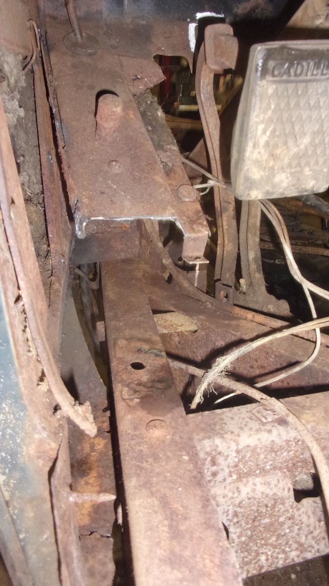

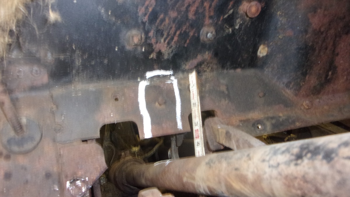

    100_0278.JPG ^^^ inside the car; I need to notch for the column as well as pedals. I won't need to do the pedals right now, as I can swing both inside, then when the channel is done, swing them forward to know how little of a notch they need.
    ^^^ there is the driver side firewall bracket removed, and the white X shows where the channel is going to be, and that area needs cutting out.
    ^^ then it was time to cut along the top of wood sill, out near the kick panel. Here is the still smoking wood sill. The Mercedes came in handy at least for doing this pic LOL. It does not need to be finished till next Saturday, the only day he can come pick up a car. So, it now waits for the last few hours of work it needs.... :)
    ^^^ this is in the area looking forward on driver side, where that wood sill was.
    ^^^ last pic showing where I stopped. The firewall bracket is moved up 3.125". The notch was cut in the bottom face of firewall first. That old hydraulic bumper jack is hooked to the rear hoodside latch thingy. I have 3 of these jacks and they are so freaking handy for this type of stuff. One is a tick longer or shorter, I forget. That jack is the only thing holding this entire side of the cowl up now. The cowl is still up at stock height here. I will need to stabilize the entire cowl before I get too far into it, for safety sake.
    I need to repeat all the above tasks on the "p***enger side" when I get back on it....but another coffee sounds pretty good right now.. he,he

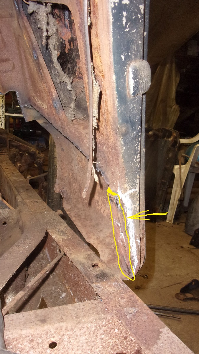

    Well, I never did brace up the cowl before starting the p***enger side, and this is the 2nd time it nearly got away from me. I actually thought it was going to roll right off the left side, onto the floor.
    ^^ but, heck, it was easier to cut out the p***eneger sill this way :)
    Here is the first time it went:

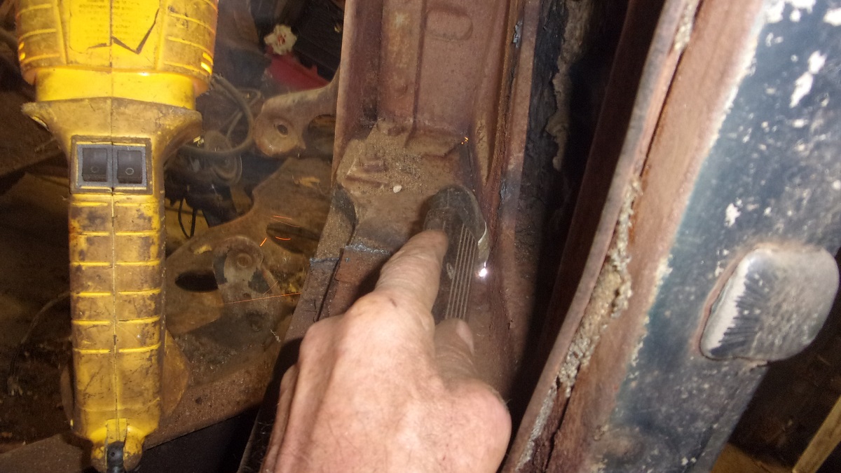

    t******* along the kick panel with plasma cutter, from front of firewall, back to b-pillar.
    there is a flat spot shown in outline here. That flat spot is where the "Pete Plate" will be welded to at the B-pillar bottom support. Pete used 1/8" plate because he had a full sheet leftover, so he just went strong iin the channeled doorway of his 32 5w. I will copy him there, except my plate will run from firewall back to the very start of the rear frame kick-up area.
    Got the cowl pretty close to that predetermined 9" guide line:
    Ok, this is now the channeled cowl at 3.125". There is still plenty small things to do:
    -move up the curved pattern of rear fender bolt holes at cowl sides, then also section the hoodsides which means I will have to move up that recessed area on cowl side, where the stock hood corner fits into a low area:
    ^^^ Sectioning the radiator shell is next...maybe later today, maybe not. I thought of an easy way to make up that offset when you section an angled/tapered panel. I will just slice the top across from left to right, then add a filler piece...all done after the section takes place.
    As far as makes any sense, the hood sides must be sectioned "above" the hood center handle? I think so.

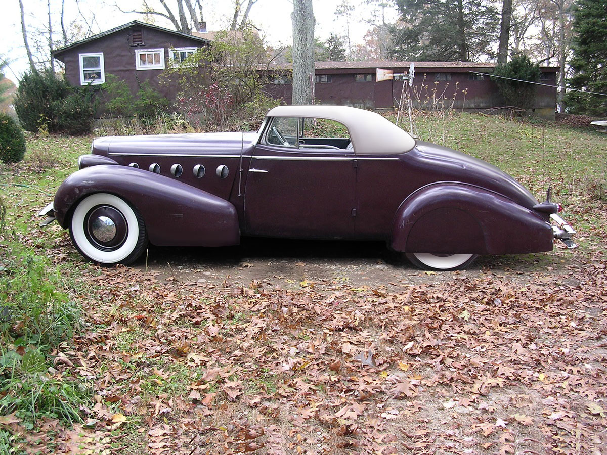

    DSCF9476.JPG Ok, Speaking about Caddys, what is this one, and what has been done to it? Sorryto take Franks thread sideways. Bob
    F&J likes this.
  26. CadMad
    Joined: Oct 20, 2012
    Posts: 886
    CadMad
    1941 Cadillac series 61 sedanette. Has had a heavy midway section. Front fenders appear to be 39 series 62.
    F&J and The37Kid like this.

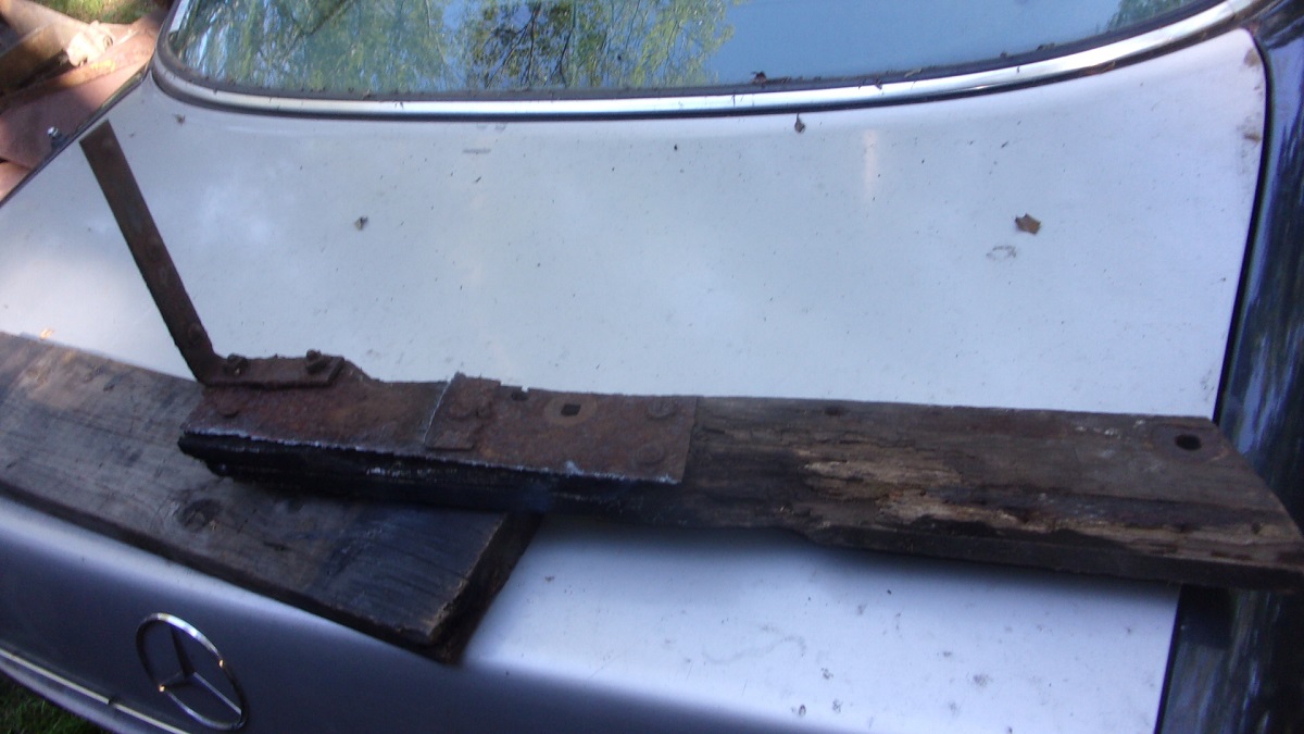

    Take a look:
    ^^ I would need to drill out dozens of spotwelds to remove that bracing. Then even more work to form special edge details.
    Plasma lit.....and Like Vanna said after each show.... "buh-Bye"
    I think I can get by with just slicing this off for now. It is less that 3" removed, but I think it will clear the fender top. I am just trying to get the left side of car back together to see how the channel looks> :) everyone else probably wants a look, too. I won't be able to pull down the front suspension, it is just too much work right now, so it will be way up there without the motor installed.

    Nothing is really adjusted right, or bolted solid. The tail end of this fender has a bumped out detail that used to go under the bottom of the cowl, but now needs to be trimmed flat to fit against the cowl.
    here is the best I can do right now. I will stop until Kenny gets a chance to go on the engine trip. Putting the engine in, is what I want to do next.

    put a headlight rim and lens in. I hope to find one more to match it, they are not easy to find for any year LaSalle, like this 37-38 one.
    There is one of the rough 34 convertible doors, and hiding behind it is the 35 front sedan door. I need to graft them together :)
