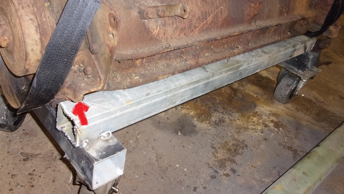

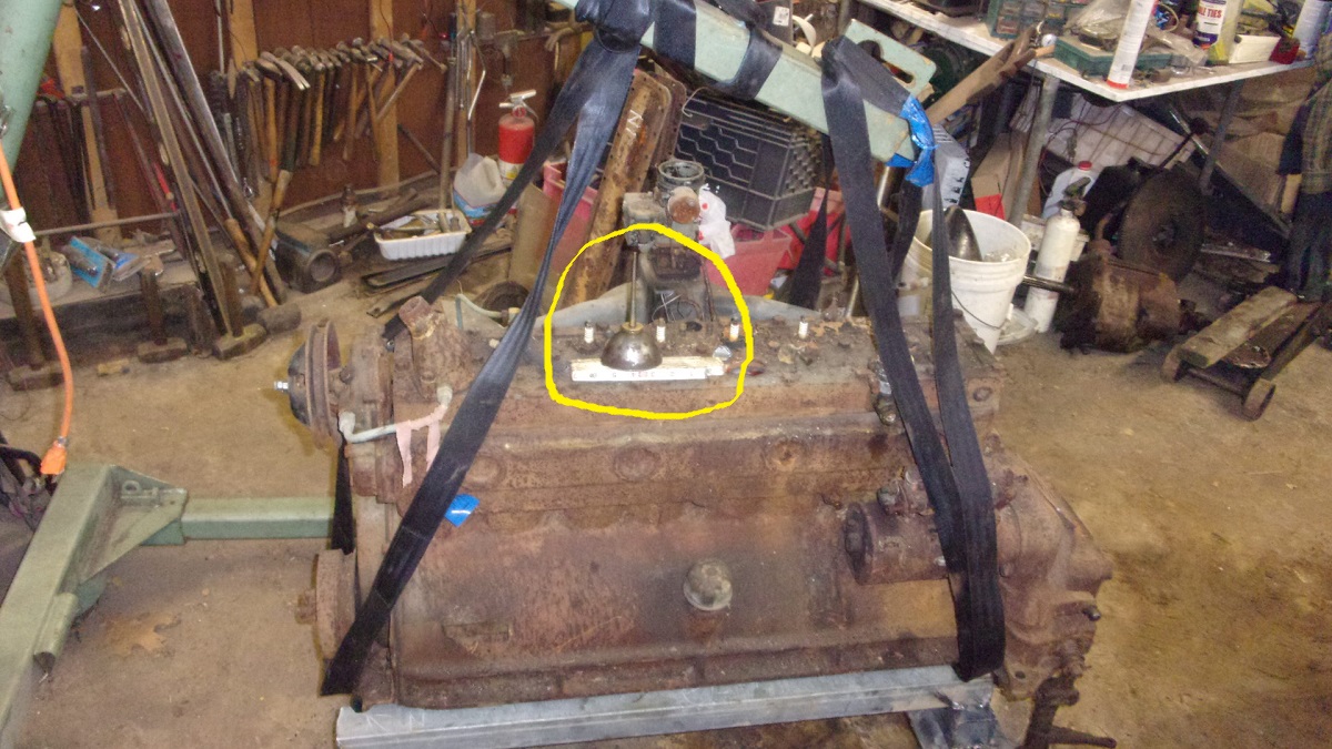

    I built this engine dolly today. I had enough stuff from the recycle place to build two, but this motor is a 35 and I know there is at least a few differences compared to the two more 34 engines that are still outdoors. I must wait to build another, and will be fitted to a 34, not this 35.

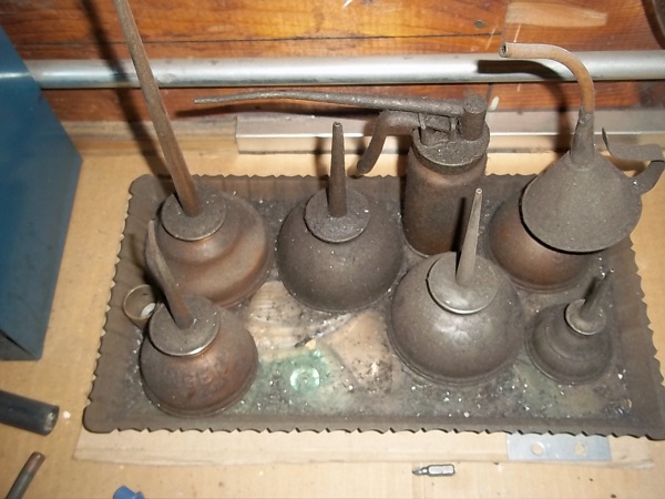

    ^^ there is the wooden ruler....and an oil can. I oiled the casters after I built this. Those oil cans work great, but nobody uses them anymore...well, "normal" people don't. lol
    ^^^ I notched the front so the engine stays locked in place. That motor plate is different on a 34, so that is why I could not copy this dolly, for use with a 34
    I was easily able to push that motor two bays away where the 32 is, backed it outside, then added this motor to the good one already there.

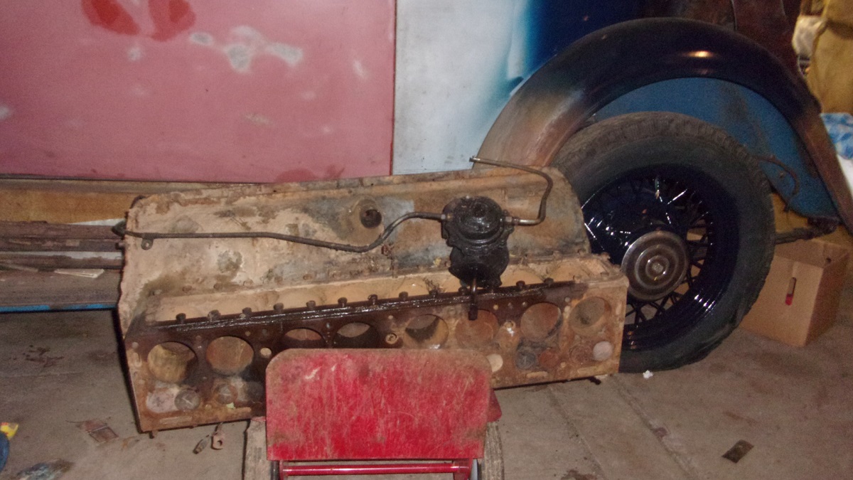

    Hi Walt, here are two short tail 51-53 housings that were subject to "core shift" which leaves some weak areas/broken casted lips at the rear bearing seat. This is NOT a problem at all, as there is a thick, heavy main boss that cannot ever break away, and will always keep the bearing seated in the main case. Those strong areas I marked as "A". The arrows show where the web is either cracked and must be removed fully with a die grinder, and the other shows major areas of that thin web is gone. You are welcome to either of these if you need one, just PM your US Mail address, as they will shipo "US Mail Flat Rate carton, not UPS/Fedex

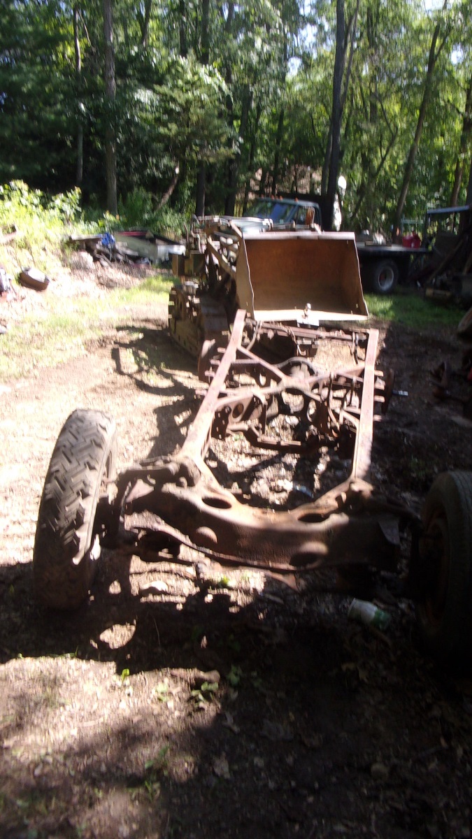

    It is an early 1950's Oliver OC3 with what is called a "ware" loader, made in Ware, Massachusetts. It sure is a very strong and very handy machine. We just used it this morning when Joe G. stopped by early, to install the 16" Jeep wheels on the front, then lift the back up away from the building, set the blocks under the springs to wait for the last two Jeep wheels he is going to look at today...Then scrape off heavy grease and crud, then send it out for blasting! Getting closer it seems, and surely beating winter we hope.

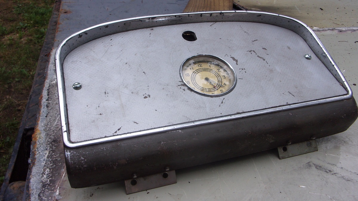

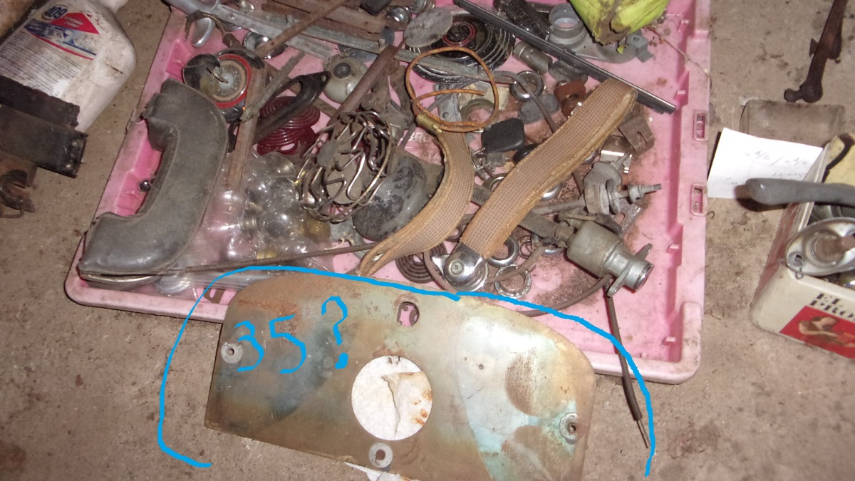

    This box of 35 dash stuff I had been sorting 34 gauges a few weeks ago, and started a "35 box" then. The glove box door looked so wrong to me, but it did fit??
    Well, that just looks crappy, but I must not give up just yet! Now go back to that pic of the 35 box; there was a clock??? what? where does it go...it must go in a glove box door but I don't have one!
    So, being that this is a LOW, low budget build, maybe I can use the spare chromed gauge housing in place of a door??? Wow Frank, that sure is a mickey mouse idea!. ...or was it... LOL
    I cannot freaking believe what I finally figured out! The 35 LaSalle was a COMPLETE and Major cost cutting redesign of the "super $$ excessiveness" of the 34 LaSalle. They simply must have lost crazy money on that new for 34 "downsized Cadillac" (34 LaSalle), and were then forced to pinch pennies everywhere on the 35 rehash. Look at this!
    ^^^ Holy crap, I just cannot get over this! They used another dash chromed bezel, added two hinges to the bottom, added two spare screw holes to hold the clock, then made a new tin back panel to hide it all, then made a new tin face that has a basket weave pressed in pattern on the steel, that matches the same basket weave details around the speedo and gauges!!! That lid is naturally SO VERY heavy, as it is such a heavy & complicated dash gauge bezel! I cannot imagine feeling the weight of it with the clock installed, when you go to slam the lid closed! That is the most bizarre "re-use" of an existing factory designed part, that I have ever seen in my entire life around cars!

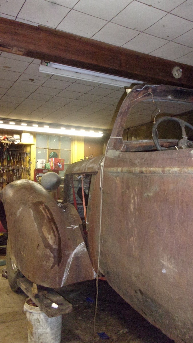

    I quit at 4:15 because "I think I got it".... lol...the mockup I mean. It was a royal PITA as nothing was really bolted down or tweaked into shape, causing an incorrect view of what the car nose will look like later. So, I struggled on, finding out what was causing issues, and fixing them.
    I did say at Noon break, that there was a surprise that showed up on the new ideas of using all 34 nose parts. Well, I totally missed the fact that if I use a 34 grille shell, then I MUST use a 34 radiator support! I simply do not have one more 34 support to spare...I'd be taking the second one of only two 34s that we have!...and Joe's car would be missing another major piece, one that is a one-year only part, and likely near impossible to find. Well, it then hit me just at the same time; why can't I use the 35 grille shell and it's 35 radiator support??? I knew I measured the possible difference in how a 34 hood top might end up being wrong length, but I sure thought I figured out then, that it would fit the 34 hood top! So, I started the mockup that way.
    Sure enough, the 35 stuff works super, and now Joe can have the spare 34 grille support. But there is now the issue that we simply do not have much left for good/repairable 34 hood sides for Joe, or for this one. So, being that the LaSalle sheetmetal is so thick, I decided that I must use the 35 sides, and it should be very easy to lengthen either the front or back end of each 35 side. The 34 sides would be even MUCH shorter that these 35s!! I've done this hood side stretch stuff before, and on even thinner hood sides, so I know it will be super easy and we can now use the best spare 34 sides on Joe's 34.
    But, although I did finnaly free up the totally frozen side hinges a few days ago, I simply cannot get the long hinge pins to even budge a tiny bit. They may have a spot weld hiding, a weld that was done to keep the pin from working out? But I thought most cars are not ever done like that, so more inspecting is needed.
    Here are a run of pics as taken, with zero text. you can see the progression as I went along, even getting sidetracked to show the very fancy script lettering on the very later years of LaSalle hub caps that I have several of. I dig them, so they will be used for sure.
    Check out the last pic closely! I finally fixed something that always bugged me to no end! And, I am digging the mockup so much, as it won't be chopped, does not need a chop, and most importantly, I love the sneaky look of the 3" channel that most people who see the car when done, at a show or on the road, won't know it was channeled. It will just be low and very slinky! I love the thought of that.
    100_0415.JPG 100_0416.JPG 100_0419.JPG 100_0420.JPG 100_0421.JPG 100_0422.JPG 100_0423.JPG 100_0425.JPG 100_0426.JPG 100_0427.JPG 100_0428.JPG 100_0429.JPG
    I am sinking the grille! It looks way too much like a 36 Buick with the grille sitting outside of the shell. I cannot stand that look at all! So, "sunk" it will be, but in this pic, the grille bracket tabs are keeping it set back too much. I will soon have the grille to be less "sunken" than shown here. It still will have that very noticeable red colored round "LaS" emblem mounted on upper right side of that grille, to let people know it IS a LaSalle!
    I sure can't wait to get the heavy straight eight installed to bring that nose down, and I already posted how simple it will be, to lower the front spring pockets to really "get it lower"! I am pretty stoked at this point today.

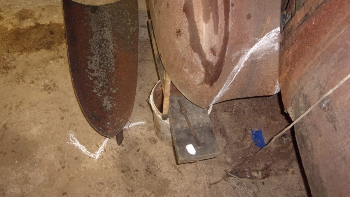

    Anyways, I grabbed a chair to ponder the view...WTH...the front wheel opening NOT lined up with front tire??? I get up to scout why that is....geeez, I missed the rear fender "hook" thing that holds the rear tail of the front fender up to proper alignment, with a wide flat steel J hook, that is on the framerail side. There are three per side, and I forgot to line those up when I struggled that massive, heavy fender on days ago..
    So, all that typing to say that the rear of fender was WAY down, which throws the entire side view of the channeling off! I then tried to tie up the driver door skin, after I got the fender tail up. It needs more fussing to get the door fit correctly for the best view, but I can already see how super long...and super low the car will look. It will belie that 120" Wheelbase I would think, like making the car look even longer WB. It sure shows that any more that 3" channel would have ruined the car! Not kidding on that observation!
    I think I'll have time to get the A pillar trimmed right at the door top, so then the door gap will fit right into the A pillar, then I will find a way to brace up the rear edge of door, too. Then I will take more pics.
    I cannot see how I can later hang the rear quarter panel up by myself tomorrow :( but I suppose I will try anyways! LOL

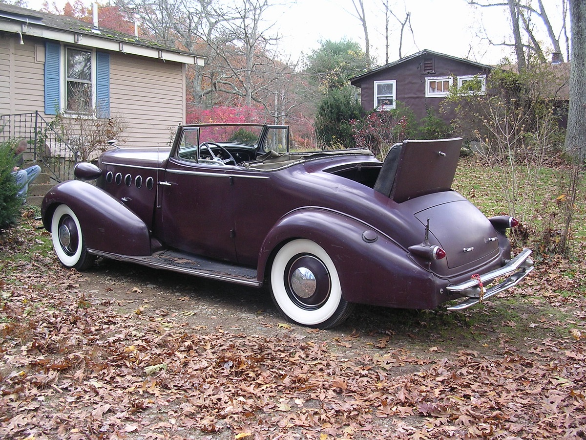

    Guys, I am not sure if I mentioned here on hamb like I did on the AACA.... The NY guy who hauled all the 34 collection in from Wisconsin 10 or so years back...he was also a very long time good friend of the owner of the estate long before he passed away.
    On our 1/2 + hour recent phone talk, one question I had of many, was where did the maroon 34 come from and could it be the car that one handyman at the Estate told me "one car in there, is one that he saw as a young guy, driven local by an older guy who refused to sell it or talk about it"...but then "He did end up with the car decades later". I simply "knew/felt" that the"car" had to be the Maroon 34! The NY guy said the maroon car was used during WW2 by the Civil Air Patrol, and was used exclusively to patrol the Connecticut River for enemy activity. which that river is right nearby the Estate!...almost in it's back yard! That must be why it has twin heaters up front?? during those cold winter nights on patrol? and a very odd large "antenna ?" hole drilled right through the inside mirror bracket and top windshield frame? It had to be some sort of Civil Defense radio? IDK, but the hole was very odd for sure. The NY guy said his friend, the estate owner, had that car for at least 30 years!

    But I did do some fitting of the door gap on the 35, and other mockup stuff. I do now know that I will again, lower the headlights about 1-3/4" like I had done before I did the channeling. I want the centerline of the headlight buckrts to be in the same line as the hood vent portholes. I know it will look great.
    more random pics, some show a disappointing difference on the rear "boattail" of the front fender. I like the 34 so much better, but we do not have any spare 34 front fenders!...so I need to try to make the 35s look more like the 34 "boat"tails.
    100_0436.JPG 100_0437.JPG 100_0438.JPG 100_0442.JPG 100_0443.JPG 100_0444.JPG
    ^^^ there is some serious metal missing on the lower edge of the door skin. The skin is supposed to curl under on a radius, like you might see on the maroon car. There is/was a solid wood beam there when new, and it always stayed wet, causing rot on all these 80+ year old LaSalles.
