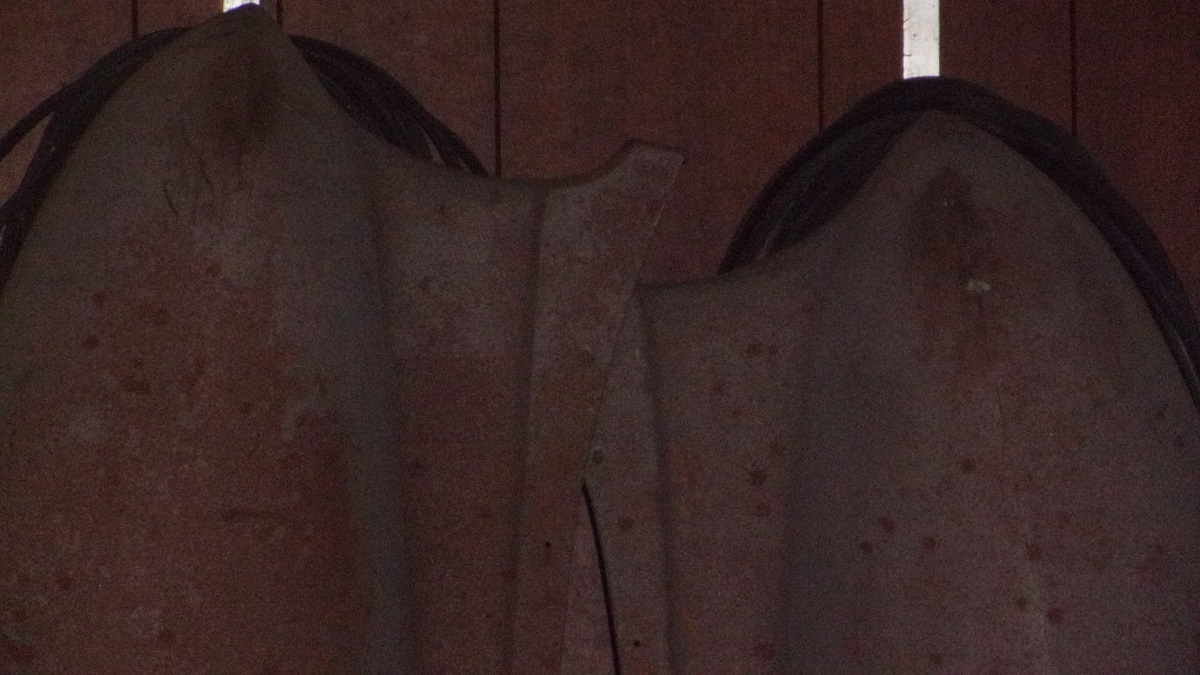

    Ok, Here is a huge possible problem in trying to figure out where the 34 Fleetwood rear body lower edge belongs, compred to a 35 Fisher rear body lower edge.
    The two bodies are different in one noticeable area; the 34 has a lower trunk lid for the spare tire, 35 does not. But that lower edge is way different heights on both cars pictured below. The only way I can attempt to guess the inches difference, is perhaps studying both rear views, and looking at their taillight mounts? What I mean is try to run that lower edge line mentally, to see where it lines up near the taillight areas, on both years?? I am not sure if that will help. Bear in mind that I still need to lower the 34 body line on my ch***is by 3.125"...so that makes it all even more difficult for me to get a start. The bright red show-car is a 35 below, then the maroon one is a 34:

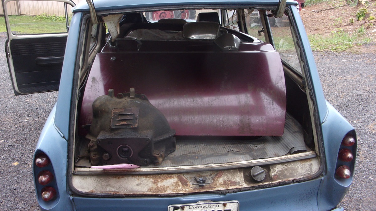

    ^^^ I took a 34-36 LaSalle bellhousing to Charlies, just in case. So here is it loaded back in my car. Yea, I have the wrong drivers seat cover, but it was free and it kinda works.. :)

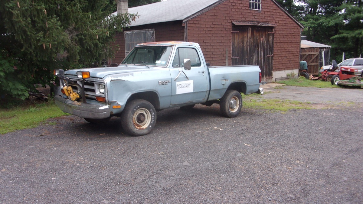

    Oh, I took this Dodge pic at Kennys before we went North. How the heck does a seacoast NY squarebody Dodge NOT get rusted out beyond belief??? IDK...and it just came in from central NY? far far away from Long Island??? Kenny says he needs it for holding stove wood and will keep it backed up to his house door, then refill as needed. ********! I WANT it for a plow truck for MY lot! I will find a way to swindle him out of it LOL. I sure will try, dammit.

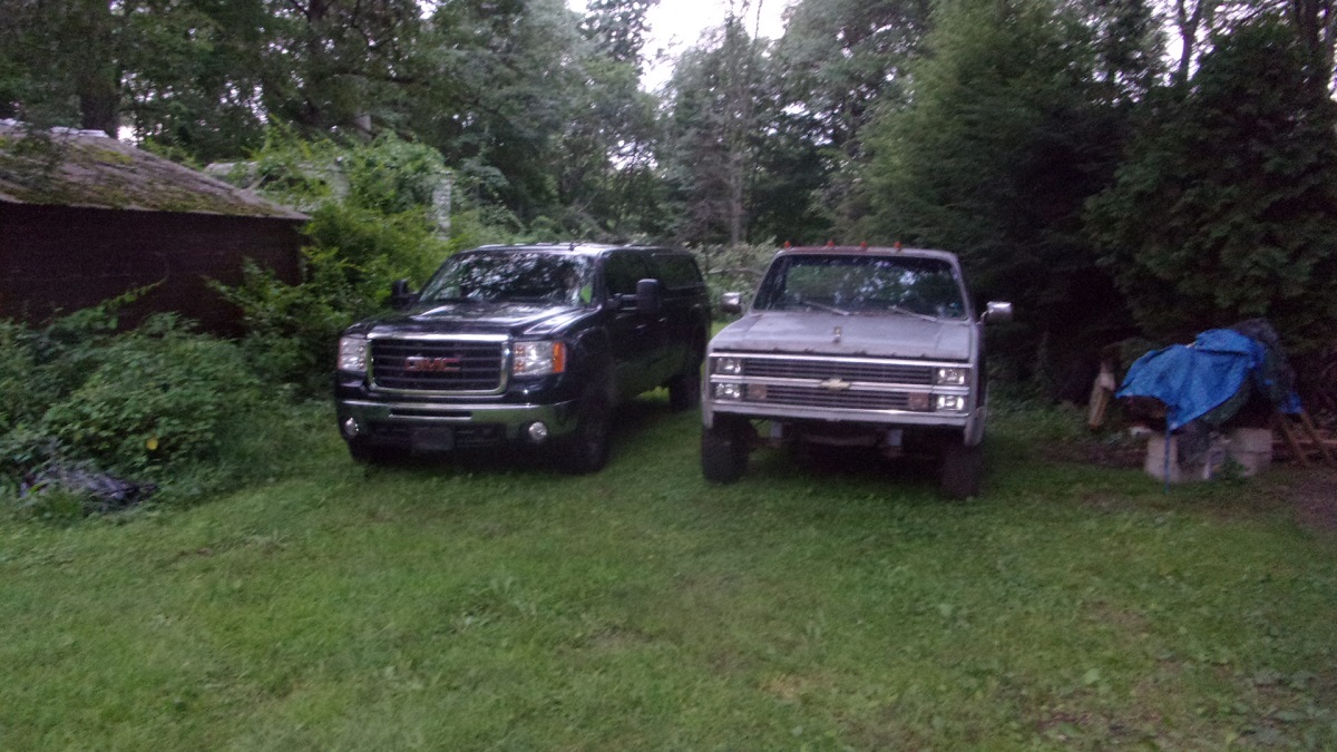

    After things calmed down, my son parked the GMC to learn some of the features, TV, remote everything, even the pedals adjust up/down. GPS, on board screen...wtf is all this chit :)
    Talked a long time with the owner, He paid 75k new! just bought a brand new, exact truck, and gave my son a sweet price (10k) as he knows my son will be hauling all his friends on dive and fishing trips! This guy is an ex-cop, retired, but does Big$ in syrup, K9 dog training, even commercial fishing, etc. He WAS the mentor to get his son and my son into diving/spearfishing some years back! He is going diving with his "also now a cop" son in the morning on Dads boat, as sons new boat has a DOA motor that needs warrantee work but is being stalled until October!! WTH, the season is over then!

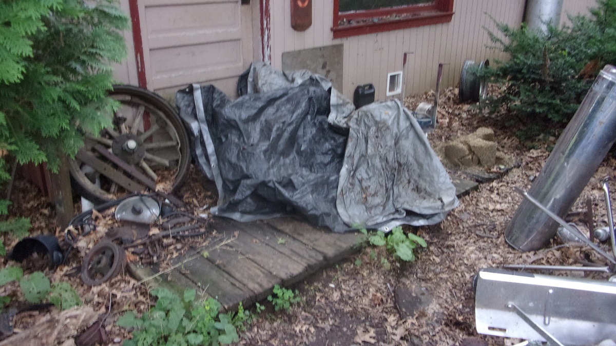

    Someone dragged an old discarded tarp to cover something at the doorway?
    ^^^ many friends drop off things, but I sure had NO clue who left this very random box of unrelated stuff?

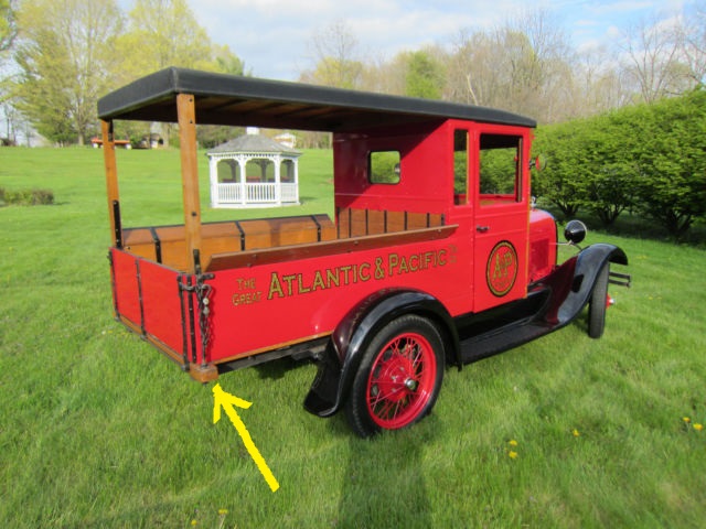

    Ok, I could use some help with ID'ing that 1931 Model A huckster body manufacturer. It may also be called a fruit peddlers wagon, or something along that line. I tried looking up two names that Kenny called me with when we were putting those doors on! He gets all excited like a little kid when another oldie is coming in!
    He said Martin-Parry or ...dammit, I just zoned out on the other single named builder. Anyways, I looked in my truck books earlier, and did web searches and cannot find that exact one. Mainly, this is a super unusual, high quality body with pressed design, steel skinned front doors, over heavy wood door framing. I cannot ever recall a huckster that did not have totally wooden doors.
    I kept telling Charlie and Kenny, that this is a super rare one, but they kept sidestepping that for some reason. So, if anybody can come up with other truck body builders names or any clues, that would be of great help. Another thing that seems odd, at least to me, is that the sidemounted spare tire is on the driver side. That seems opposite of what would be more sensible? Tim's 34 Ford 1.5 ton I had here, has a p***enger side mount, and then it is out of the drivers way?
    anyways, all I "must" do before 3PM tomorrow, is fix that tiny solder leak spot on the 32, then put the radiator shell back on, and hook back up the H/L wires. We are going to the Ashford cruise at 4:00-4:30Pm that day. Other than that, I simply don't give a toot about doing anything at all. :) ... just like "life" should be able afford; "that occasional event"!
    EDIT; Cantrell was the name I forgot, but I think those are more like woodie wagons? Not sure. More ID info: this cab side view, even though it is a 31, not a 28-29 truck, there is that same decorative panel behind the door like this yellow outline.
    That panel is also sheetmetal like the door skin it has. The cab is also like this picture, with it having a back wall behind the driver seat. Many hucksters were open back. This 31 huckster truck also has a manifold heater coming through the firewall, so it verifies that this truck was used in very cold climate. It must be local when it was new. IMO

    Thanks, Frank.....that is really closer than anything I saw so far. Then I went down that list of hucksters until I spotted another 28-29 that has one feature that is more like what the mystery 31 has:
    ^^^ see the wooden cross beam under the tail end? That is like the mystery 31, except the 31 has a diagonal strap metal brace up to the sideboard, instead of what looks like a vertical rod in the pic above? But, it might be the same company and maybe made a change or two by 1931? Thanks, we have something to show Kenny now. He does not have internet but I can show him on my laptop.

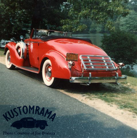

    came back in for a coffee :) so here is a link I'd like you all to read. This IS the original builder of my old hot rod! Talk about one heck of a life....and a quick search this morning seems like he is still with us at age 74! I will fill you in on more cool stuff about this guy, told to me by phone from his youngest son Karl from New Hampshire...including a fabulous cool story about his Dad, Mom, and their "first newborn"s vacation trip up north in the hotrod, so very long ago.... you all will love it
    http://archive.boston.com/yourtown/news/east_boston/2011/11/east_boston_man_once_had_white.html
    kidcampbell71 and Hnstray like this.

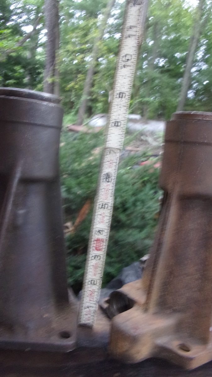

    noon break, dumping some camera memory, etc. First I need to post some info for walt in Vermont on the Olds tail housing he needs measurements of: Fuzzy pic though..

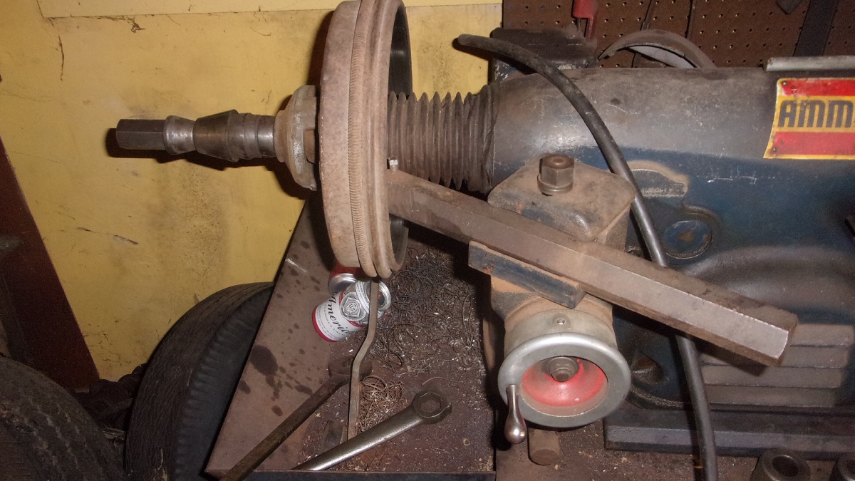

    Ok, 8-1/4" to end of cast iron, and asbout 8-1/2" to end of seal. This housing is for all short tailshaft (aka Mainshaft) used on 51-up Olds Selector transmissions. It is also same length as 57-up BUT you cannot use these with those as they had a fatter shaft! So, use these tails on 51-56 short, NOT the Olds 98 which has a super long shaft!
    Next up, those three young men know their stuff! I ran the left rear drum on the Aamco first...wow...bent!

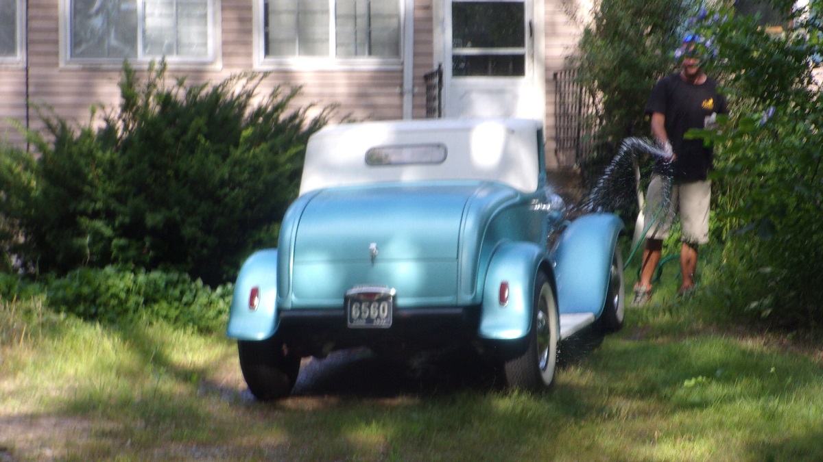

    He, he...My Son and I mixed that color in a new clean 5 gallon bucket. We were given the entire contents from an Auto Parts Store PPG mixing system... All the toners, many different types of the metallic additives called "poly", clears, you name it, and we had SS Urethane, base coat clear coat, acrylic enamel as well as our choice of Acrylic Lacquer!
    I asked on hamb back then as to how much of the poly we could mix in, as I had full gallons of the stuff! I think it was said that some silver car colors from factory, were mostly made of poly, so we ended up adding a lot. That is what makes it glow on a dreary day! it gets a lot of looks and comments just by the color and the use of white things, like roof, boards interior and tires.
    The m***ive amount of poly made it too difficult to spray though. The lacquer dries so fast, even with new and expensive PPG thinner,(which is NOT the same as the stuff from the 70s or earlier) that the flakes to tend to lump up or get blown random in the overspray, so it left bumps at these drifting flakes. I redid it twice. It is very smooth but not shiny, and it looks like an old paint job. We like it the way it is :)

    You should be able to see the center hole in these pics....(I sure do like seeing/preserving personal history on vehicles):
