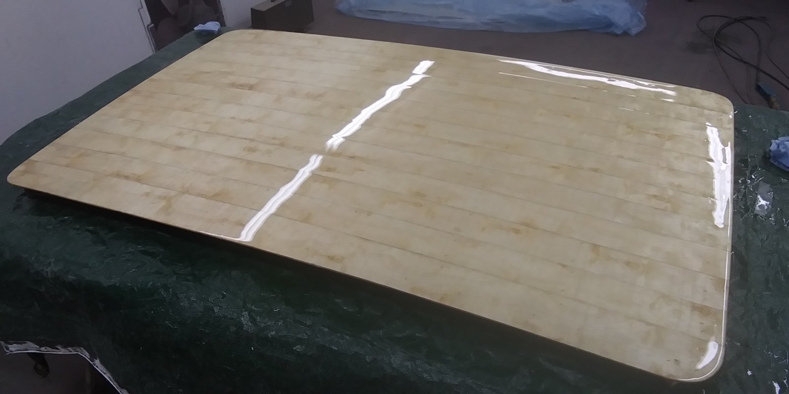

  5. Top insert glued up and sanded. Gonna have to wait a few days for some warmer weather to do the epoxy coating. I don't think it hit 20 degrees here today.

  7. This clear epoxy is wild stuff. Pour it on, spread it out and let it self level. Kind of a shame to cover it up.

  10. The epoxy is all on and sanded smooth. Before I put the vinyl on I wanted to finish the under side. I plan on leaving this exposed, so I put a nice finish on it. Should contrast nicely with the white interior.

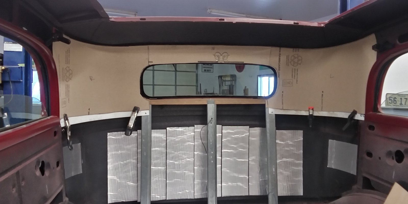

  30. My plan for the interior is "no sew" using rigid panels covered with vinyl. I used this method on my f-1 pu and it worked out pretty good.
    First step is making patterns. The curved pieces will be made from aluminum. This is the tedious part...... Once I have the patterns done it goes pretty quickly.
