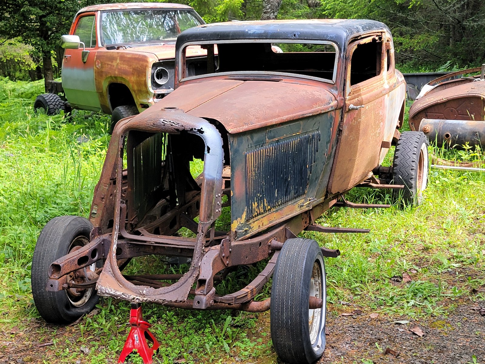

    Thanks guys. Currently there is a Chevy front end of some type bolted on. This weekend I'm removing it. It has dual leaf right now. That is also going since I'm going fenderless
    My plan was to measure frame distance and current axle. At my local hot rod shop, they have a drop axle setup there on a frame. I planned to measure all that and compare to ensure all the dimensions are right for what I plan
    For the wavy, I read Dave's thread on here where that was converted that to single leaf. That would be my goal.
    Also, the previous owner mentioned the current frame wasn't the original frame. He wasn't the original original owner either. There's a chance my hood and body are not the same car as well....but hey, it's only metal...it can be modified. I planned to start mocking things up as well.
    Yes, there's a lot of body work to do. Scares me, but also looking forward to it

    I can say, most of mine is in better shape than that! I got that going for me. I ran out to the storage area for mine and took some pictures and measurements. Looks like my current wheel base is 104in The outer distance of the frame rails at the middle of the cross member is 28in and the inner (to edge for frame rail, as if I boxed it) was 23.
    Looks like I'm missing some door striker plates as well.

    Frame and axle appear to be early Chevy. Not a bad choice, my avatar '31 Plymouth coupe is on a '33 Chevy frame. Fits really well...

    Hadn't thought the frame to be Chevy. Guess it could be, but the fr rr axles are Chevy for sure

    You can tell by the frame horns if you look at mine. Yes, mine needs quite a bit of metal work! It was only 900 bucks though and I am up for it!

    That front crossmember is not a Plymouth. BTW, the bodies are all the same. The difference in the wheelbases is all in the hood length and frame. When you are searching for parts, don't rule out the Dodges - they are the same except for the fender style, which won't make any difference if you are running a highboy. The 104 inch wheelbase sounds too short. I think mine (a short wheelbase car) is 112, but I will have to measure it tomorrow to confirm. Do you have any other measurements you would like me to check?

    Looking online looks like Chevy was 107in wheelbase in 33-34. So that makes sense as my measurements may have been off a touch. In my defense, I was wearing a white pullover I didn't want to get dirty. I just did some quick pics and measurements
    Guess I need to throw the hood on to see where to put the front axle if I keep this frame. Looks like it'll move forward 5-10 inches as the Plymouth was 114.

    Got the front end off. Was trying to mock up up the radiator and hood but a tree fell and I had to chainsaw that up and stuff.
    You can see the temp brace in front of original. That gives me enough for the hood length and 114in WB. So that's all closer to a Plymouth
    Oh....and FREE. Come pick up this Chevy front end!
