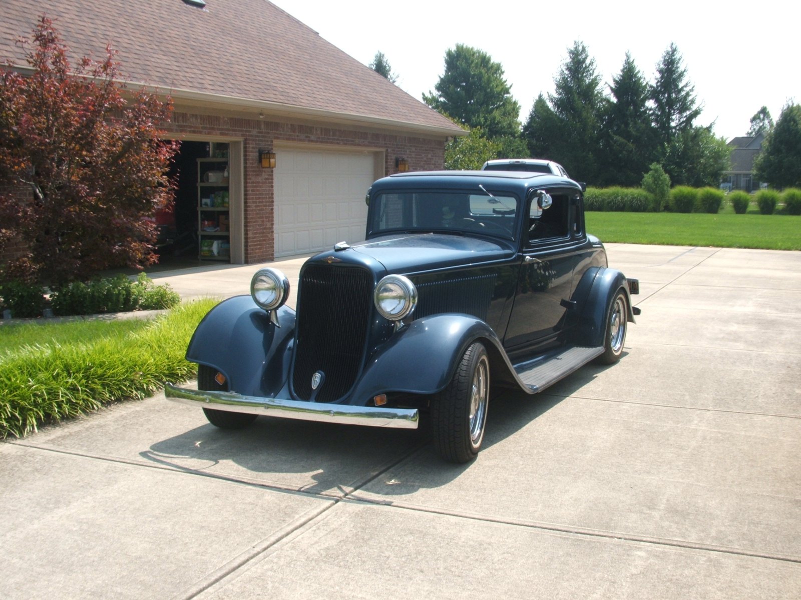

    I mate of mine is into 33/34 Mopar stuff - he has had a few coupes, a roadster and a couple of pickups.
    There is lots of differences between all of the models that isn't obvious at first glance i.e. wheel base, cowls, body pressings, suspensions etc. That being said, they are a really well built vehicles with lots to like about them. Certainly in Australia there isn't as much available 'off the shelf' as a Ford.
    Here are some pics of his Coupe that is my favorite - inspiration perhaps
    Thank for posting your build
    Cheers Turns

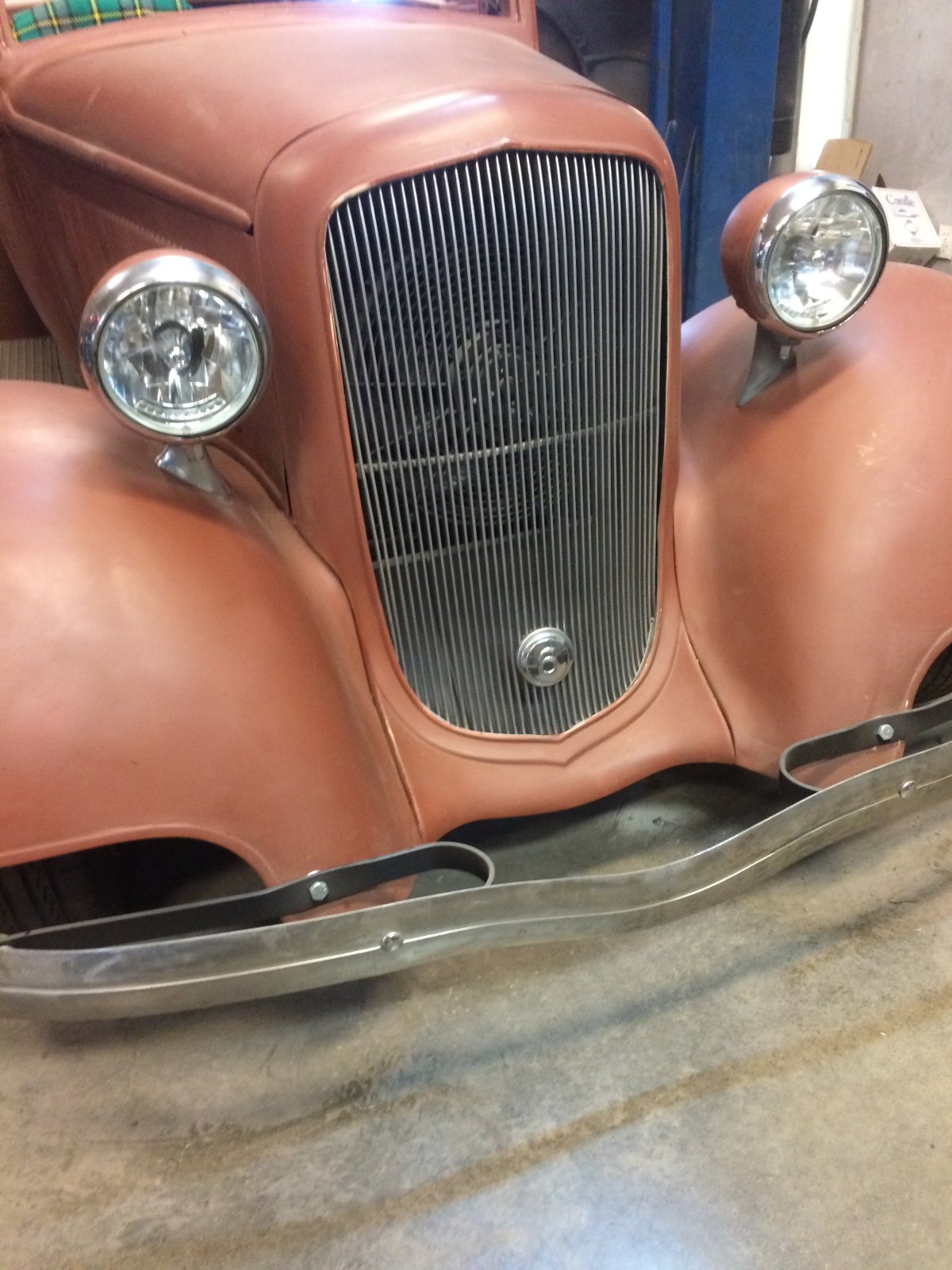

    I got my 34 Plymouth headlights yesterday, but I have a couple questions.
    1. One headlight with the horn, there was an outer chrome bezel and in internal bezel that connected to the inner ring with springs that held the headlight. This internal bezel is toast. Rusted out and weak.
    2. The second headlight didn't have the outer or inner bezels. It has the turn signal in the reflector and that attached to the inner ring with springs. (Gl*** is long gone on that one)
    My questions
    Am I missing an outer bezel on the light with turn signal?
    If I get halogen or led headlights with modern wiring, can I just use 7inch new mounting hardware (like from a Harley, it looked the same as my internal bezel).?
    ***uming yes, I can use a aftermarket inner bezel, and the 2nd light doesn't require the outer bezel ....do I need bezels at all if I do the same mounting system in both lights?
    I feel like I'm missing a bezel and that may be hard to acquire

    They didn't have turn signals. That would be a park light.
    That rusted out piece is an aftermarket adapter for a sealed beam bulb.
    They didn't use a headlight ring. The gl*** lens kinda twists in and is spring loaded.
    I would switch to hot rod headlights like BLC or Guide.
    Dave

    Thanks guys. I now understand how the original worked(one left in pic) and how an aftermarket change was done (one on right).
    I have some lights and parts from my 50 Chrysler I can use to hopefully test fit how I want it. Not switching buckets if I don't have to.

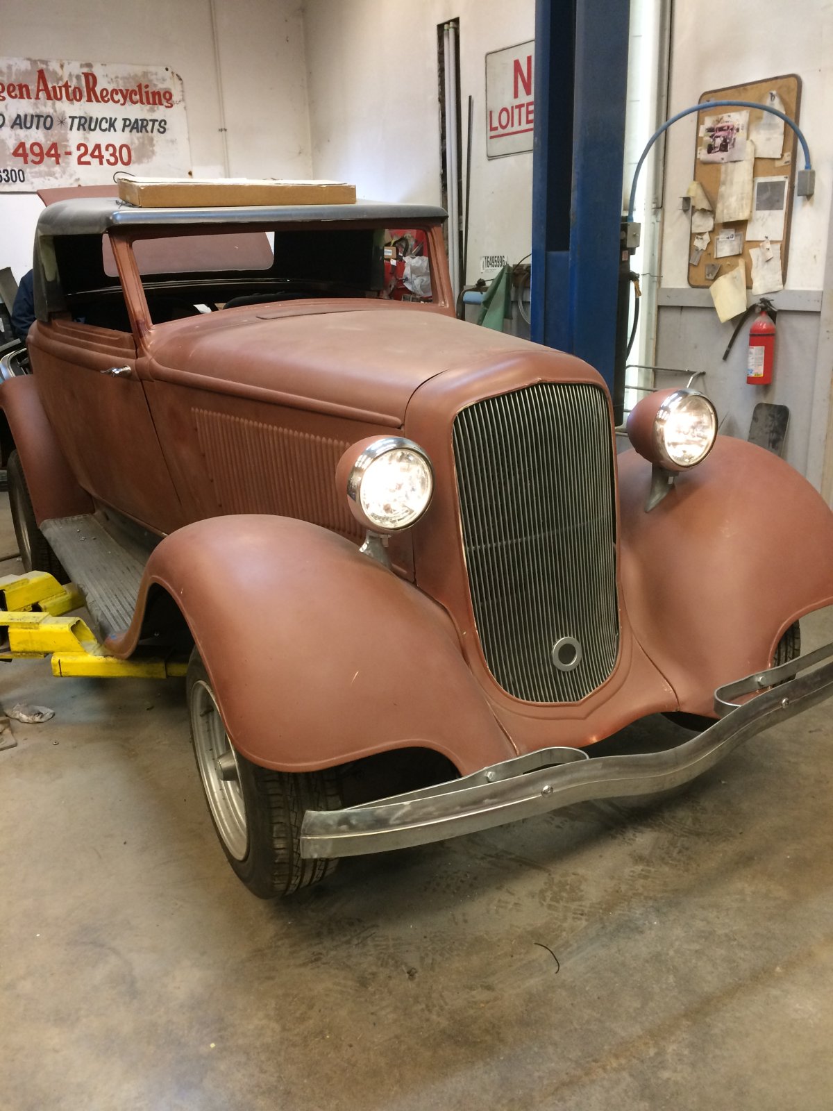

    Lights from 50 won't work without mods, but I think I have everything now....if lenses I ordered are right.
    I moved the body forward to get the rear tires centered.
    Didn't get to do this last week, but I needed inspiration!
    Based on mock up....my radiator is 28in high. Max mounting it on the 32 Ford cross member makes make height of 21.5in. the rods for the hood will be 35 as other states, so my previous attempt for mock up was the issue

    The body really has great proportions stock. Lowered a few inches from where it sits now would give a better idea of potential ride height, I suspect. Those rear leaf springs appear to have quite a bit of arch, but you have to work with what you have at this point.

    Front end is on jack stands with no suspension/axle. Rear is leaf springs and YES, it sits toooo high for me. I did this mainly to position the body and the Hood/Sides so I would know where to put my crossmember....in doing so, I noticed the angles of the sides on the hood force the current radiator to sit low. That won't work with the 32 crossmember. This boy will be low when done with a slight rake.

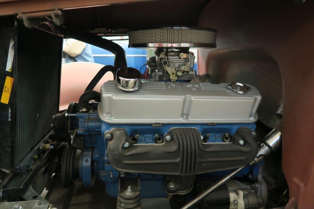

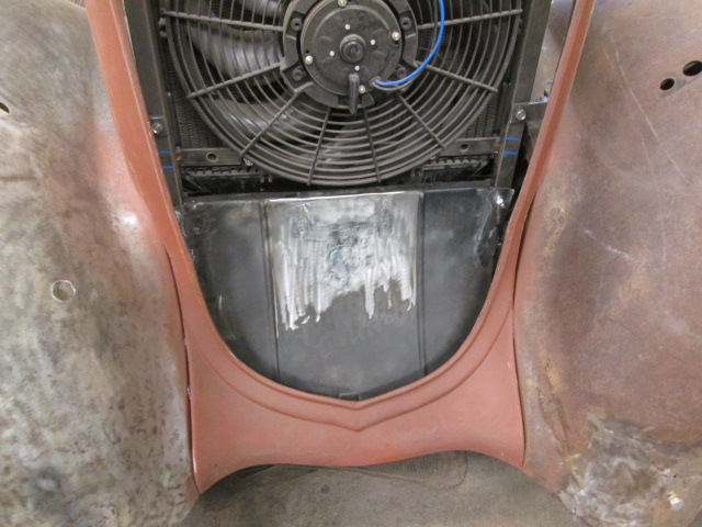

    I’ve found that a 65/66 Mustang radiator fits most of the grill shells. Fits right up to factory air dam IMG_2527.jpeg sorry about bad pic. Only one I have
