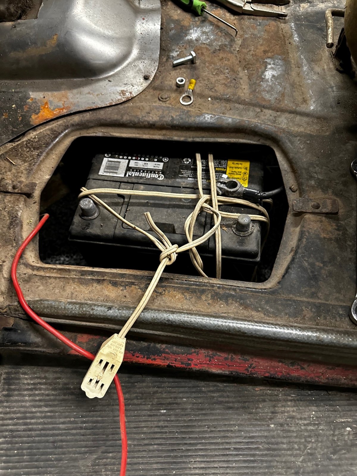

    So here we are 1 week in... Alot of rewiring, and lowering the battery box to fit the taller battery and have a floor filler installed over it.
    If you don't know what success feels like, its pulling 8 screws out of vintage tin with an easy out successfully.
    Spent 1 day of working on ebrake and service brake pedals to get them to jive correctly.
    Then I wanted to seal the floor under the mat that will be installed or carpet to make sure it lasts. So I did a good ole Por15 topcoat on there.
    I had to re adjust the hinges on the drivers door, it was making contact with the inner striker plate only and the gaps were stupid tight at the rear, so bent the hinge and got it aligned where its hitting the stock wear points on the striker 100% so Id say its as good as henry did it.
    Few update photos... Wiring in progress, will have more on this as I am adding a 4 circuit fuse panel that fits the era under the dash.
    Here is the battery hold down I had to remove and rebuild the battery box structure to fit and hold down the battery in the correct location. Figured everyone needs a just for laughs but it worked.... The terminals were sticking above the floor and this box needed to be corrected asap.
    Floor before and after... It was 100 % scrubbed out and rust was killed before sealing as a precaution also. I had to easy out all of the trans cover bolts. You can see the new battery terminal and hold down is hanging in there now like a champ. Movement controlled in all 4 axis. Hold down good and tight.

    110 vac converter?
    nice
    3blapcam, swade41, catdad49 and 10 others like this.
