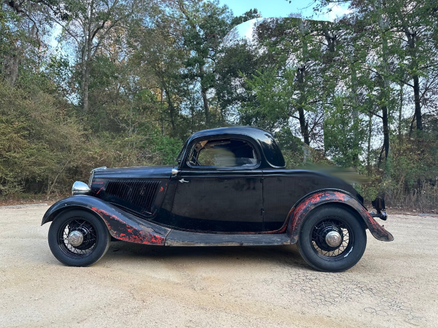

    Not that I'd do it, since this one is so clean to begin with, but you can make a 3W coupe out of one of these. Here's a quick and dirty rendering, just for fun.
    3blapcam, catdad49, brEad and 3 others like this.

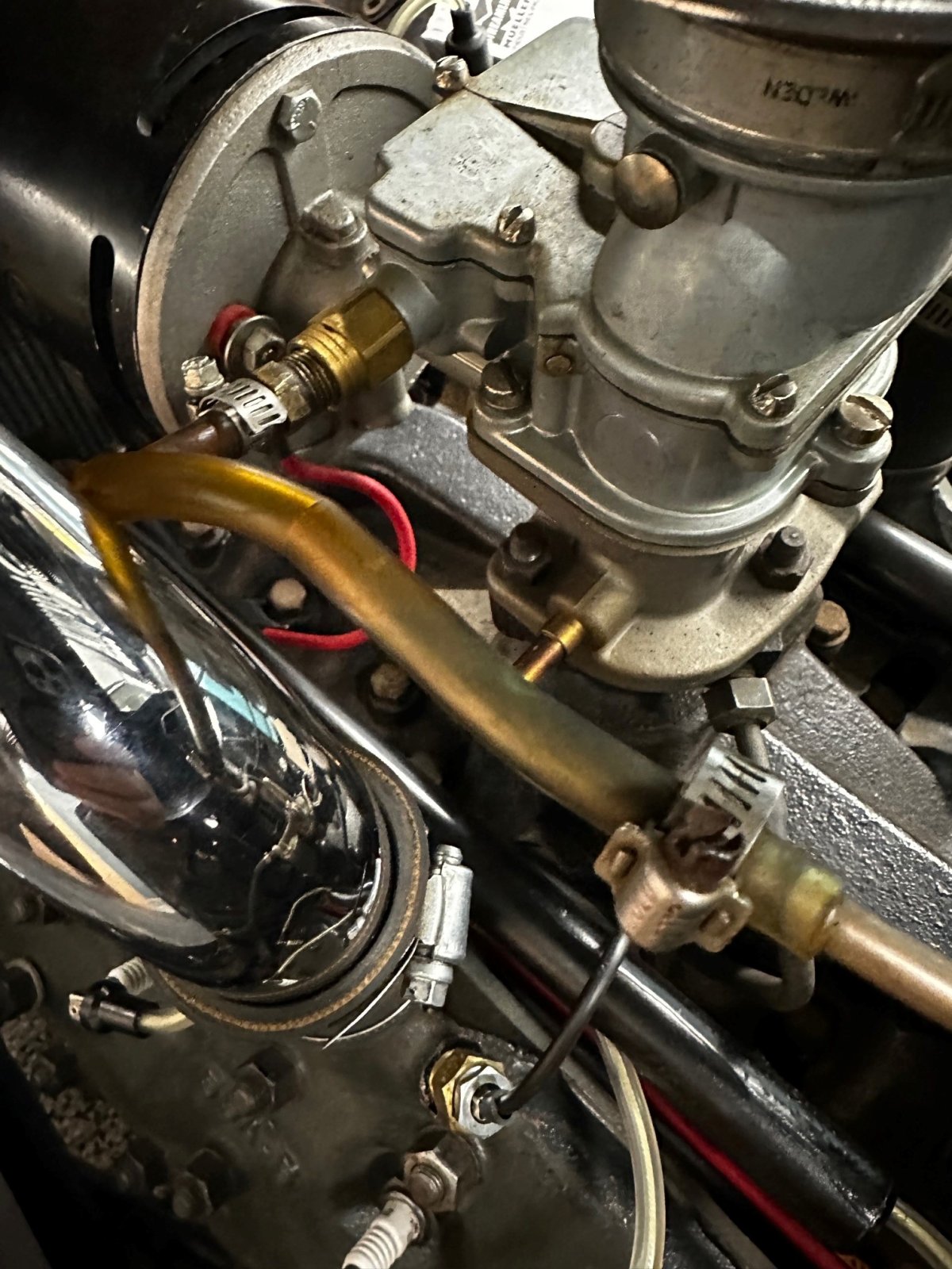

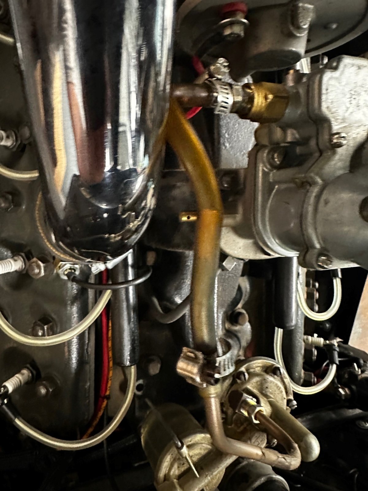

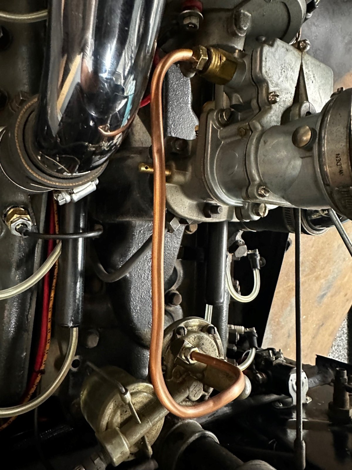

    So upon leaving after things had cooled off completely from the birthday party, she was hard to start. I was trying to figure out why when she fires off super easy on short trips, well I was like huh I wonder........ Yep fuel line on the radiator hose. Heating up and maybe caused some vapor lock etc? Who knows, but this will be better with my temp copper line till the 2x2 sharp goes on. I am not a big fan of rubber/plastic fuel lines anyways... Hope to try it out this weekend possibly.
    Before!!!!
    After!!!
    catdad49, JalopyJimbo, Stogy and 8 others like this.

    Ah forgot to update on the fuel line touching the upper radiator hose, getting them separated fixed the vapor lock issue. Started up last weekend like a champ after driving it for another long trip.
    catdad49, Stogy and guthriesmith like this.
