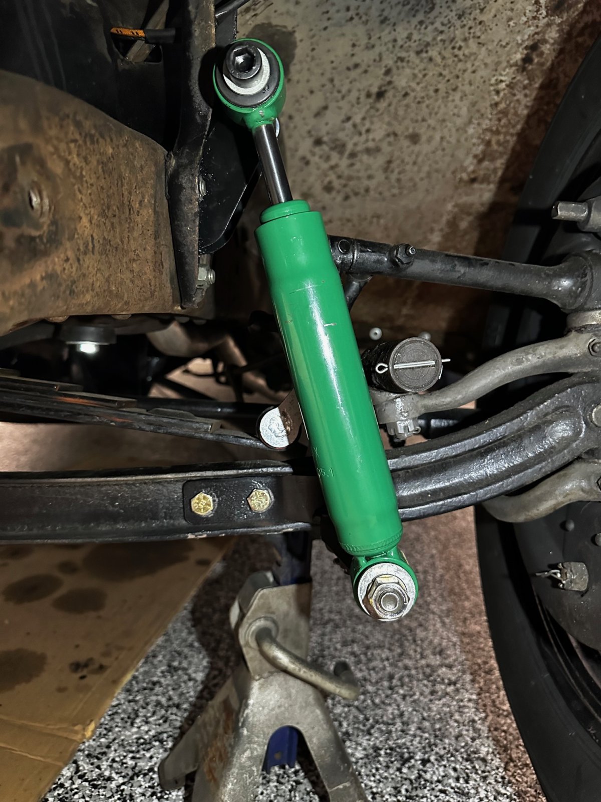

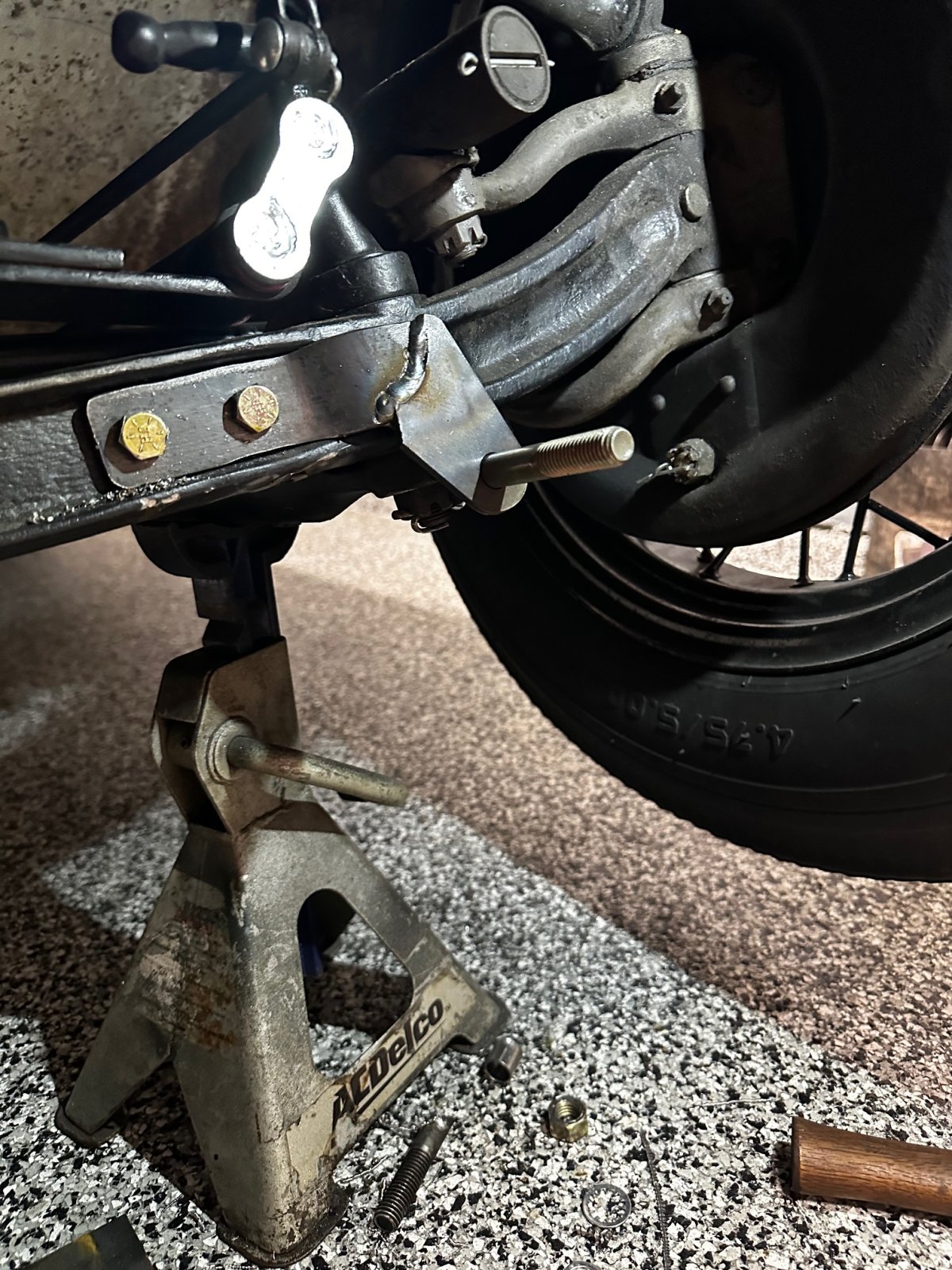

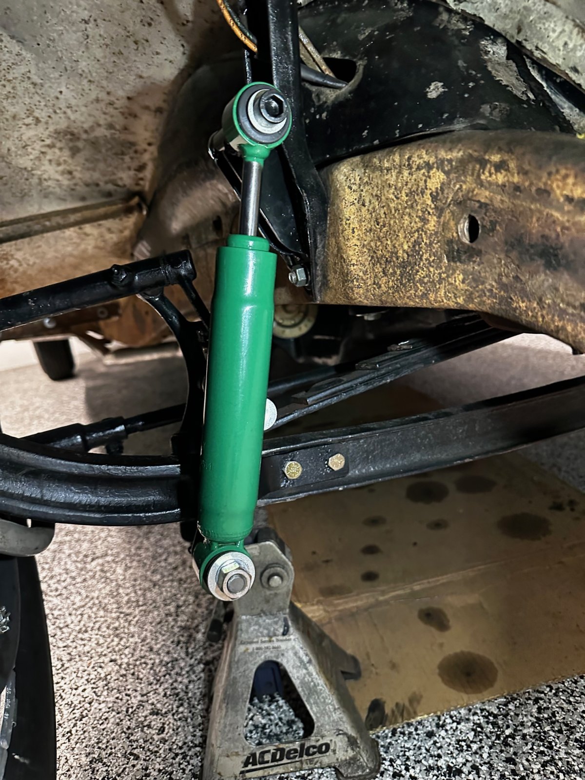

    So finally getting around to shocks up front... Bought a kit off the web, the top mount was decent, the bottom used one of those ****py ones that goes on the bottom perch nut... That won't work with retaining the mechanical brakes due to perch stud length being too short...
    Personally I hate those mounts almost as much as hairpins on a fenderless hotrod...
    So I came up with some brackets to bolt on to the axle and solve the issue.
    This is a prototype of sorts, no one makes these so hell maybe there is a market for mechanical brakes or just a better shock mount tab.
    What I came up with ... All grade 8 bolts and nuts...

    Ride is more settled. Bit more stiff but it's controlling the front end. Now I need to remove the knee action shocks out back and put tubes there and that should really help the little bit of freeway sway she gets in the 70 mph range.

    Well, onto other things I did the rear shocks before doing this. Either way, the shocks are pretty simple bolt on brackets for the drop shackles, stock they would be very short. Never mind the zip tie, its to hold the shock at ride height when building.
    Now lets talk ride after all the shocks installed.
    The rears are gas charged, I was thinking since the rear of the car is thick I would run gas charged back there. Well the ride is very firm, maybe they will break in but its firm like a race car... So we will see what the high speed manner is of the car with these installed, I may need to go to just fluid shocks and not gas charged but there is something nice about buying a shock off the shelf for use in these cars for finding replacement parts on trips.
