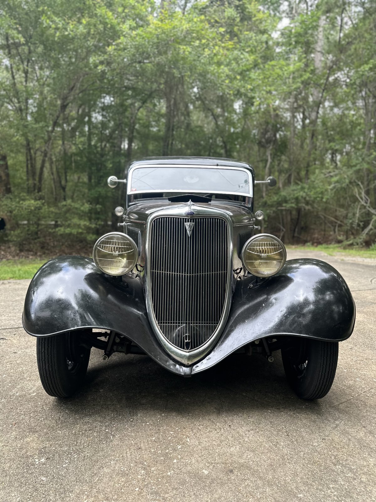

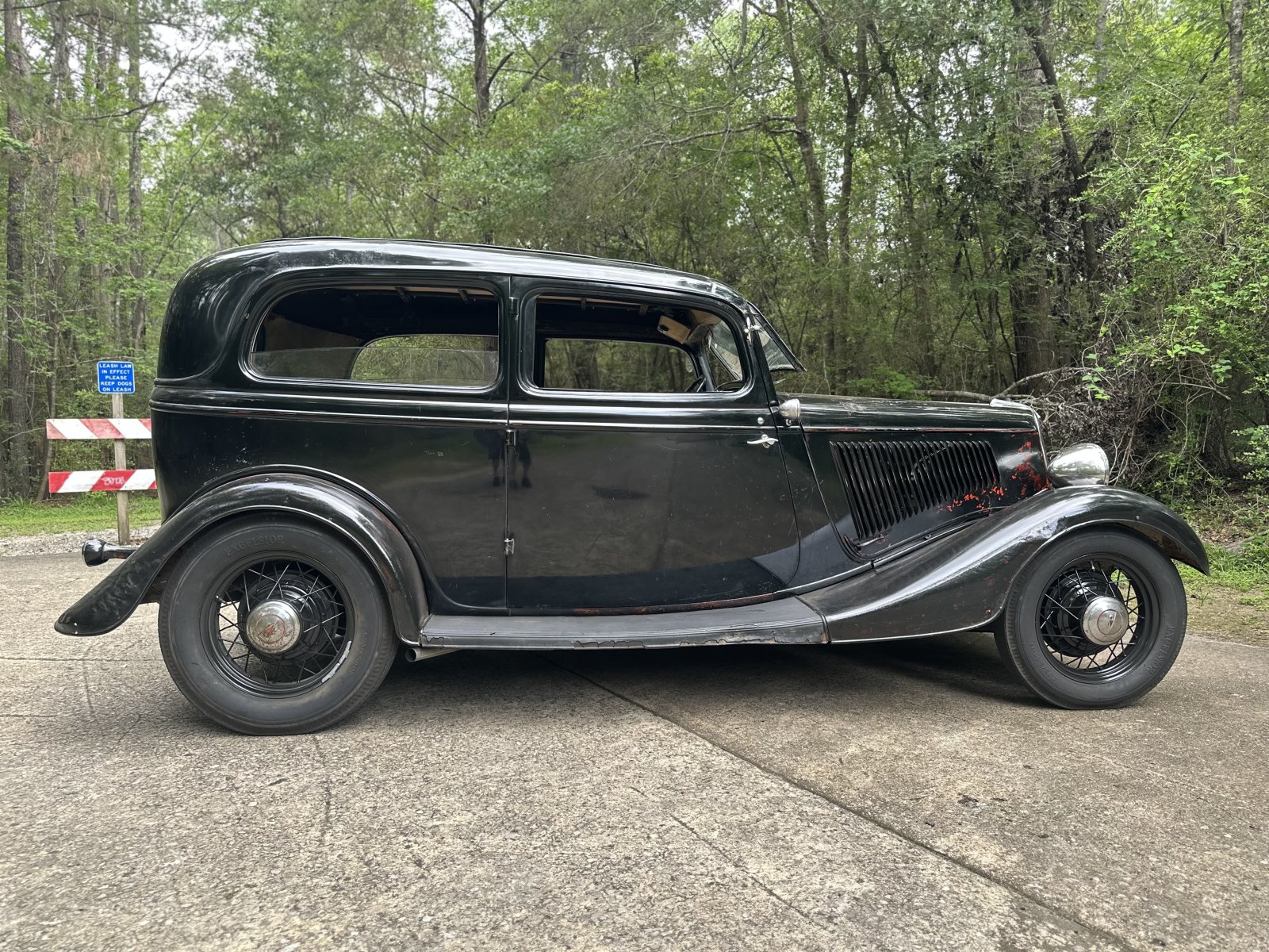

    Few updates.
    So the gas charged shocks out back were way too stiff.
    So I got some Pete and Jakes hydraulic shocks. Amazing transformation.
    We rolled 4 deep around Austin Thursday evening at the Roundup.
    Despite smoking like a steam locomotive on a grade under acceleration, cruise it barely smokes now. She did great driving around ATX this last weekend. Rolled 75 mph on the freeway leaving alot of my group behind at one time with 4 people in there. I can only imagine the extra HP from a good bumpstick will really make her even more fun.
    I didn't shoot but 2 photos of my stuff this weekend, I shot other folks more. But here are the pics that others and myself shot of her.
    Thanks for the love @Ryan
    The only 2 I shot that had my stuff in it...
    So my body smooth wore out after 2 days in ATX, as some know I have some lasting injuries in my quad, it really hampers walking around sometimes when it flares up. And I made it 3 miles before that happened, So Friday evening was brutal after the show, so Saturday morning it wasn't better, we decided to outrun the rain and head back down to Houston area. In total I had 2 cars I have built there at the show that I know of, and both of those are bringing their owners alot of joy still, and are picture heavy rides. Then there is my 34... Some folks get it and understand the vision I have had since buying this car. Some don't, and its not for everyone staying traditional. It seems everyone loves the flathead under the hood.
    There was a beautiful 32 tudor on the hill this year. Fenderless car, and was stunning all around. It had me thinking about pulling my fenders off. Or maybe Ill save that for its next rendition, Who knows.
    Next up will be starting to gather parts for motor refresh.

    I vote leave the body be and move on to mechanicals... that thing looks really good!
  3. simplestone
    Joined: Aug 18, 2010
    Posts: 1,006
    simplestone
    I really love the look with the fenders. I think you nailed it.
    Paul B, brEad and stubbsrodandcustom like this.
  4. continentaljohn
    Joined: Jul 24, 2002
    Posts: 5,982
    continentaljohn
    Great looking hotrod and perfect stance with the fenders

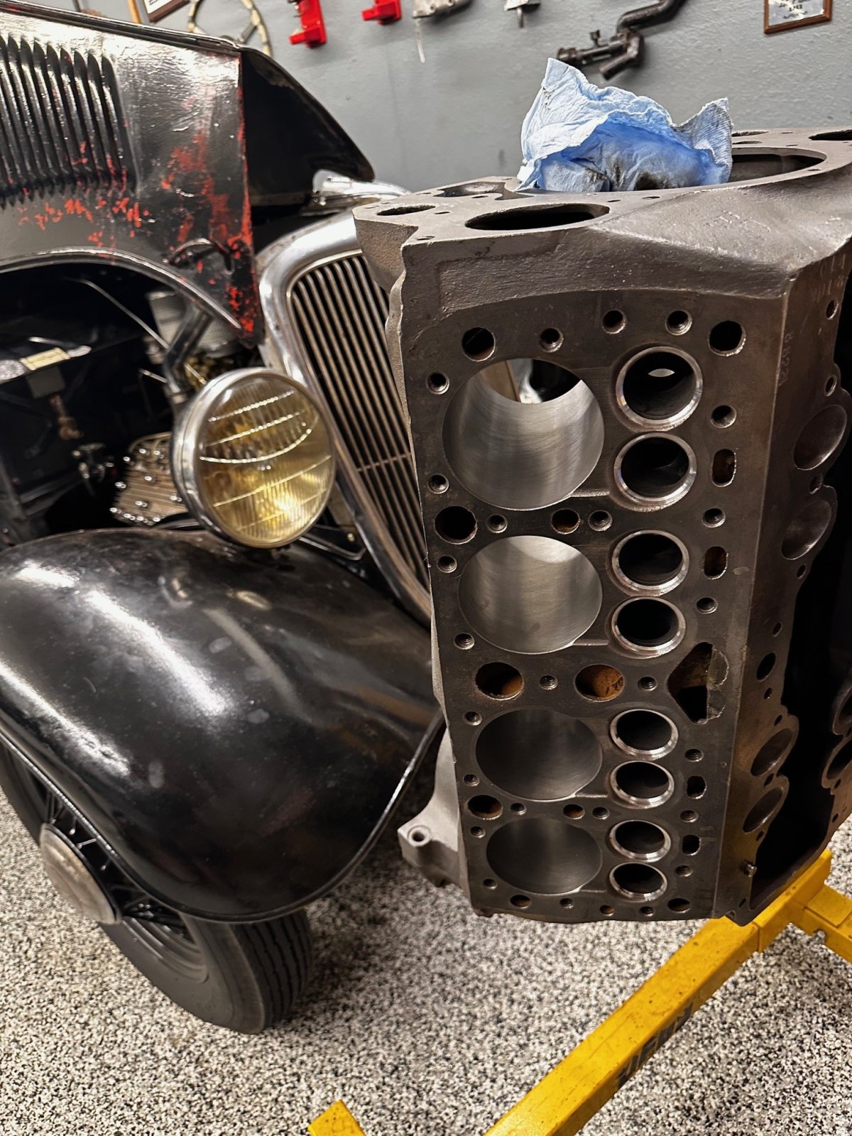

    So lets do some updates, Picked up a decent 59ab block, was supposed to be a runner, just had what they said was a bad rear main leak. I took a gamble, And went ahead and tore into it anyways. Here I was thinking it would be a simple hone and roll... I was wrong. Its got 2 cylinders that have some pitting in them so its .080 over already so Ill bring it to the machine shop and see how much cut it will take to clean those two up. I may sleeve and bore those .080 and re install what I have, the rings look perfect, minor scuffing on piston skirts etc, So we will see what the shop says.
    So with that said, it already had Johnson adjustable's in there. So I went ahead and drilled the bores in the lifter galley for adjusting them cause I have seen enough folks fight trying to hold them and turn the screw.
    So When I was stripping it down, I noticed every piston had this dusting of oil burn and carbon on top. I found that the intake valve guides didn't have seals, and you can see it was ****ing oil in from there. So it probably smoked a bit. The rear main leak was not a rear main leak, the oil pump plate was part of it, but the main culprit was the rope seal adapter that fits in the block was not sealed at all, no gasket maker etc at all on it, the whole groove around it was wet so I am pretty sure this is the main leak.
    Stay tuned. I have a regrind Isky 1007B going in there, and going to swap my Offy heads and sharp intake over once we pull the other motor next month.

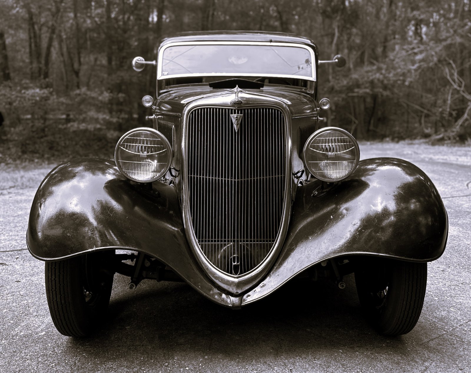

    How about a few highlights in Black and White... ?
    Just learned how to edit myself out of a photo... Feeling accomplished learning something new of technology.

    Damn... looks even better in B&W!

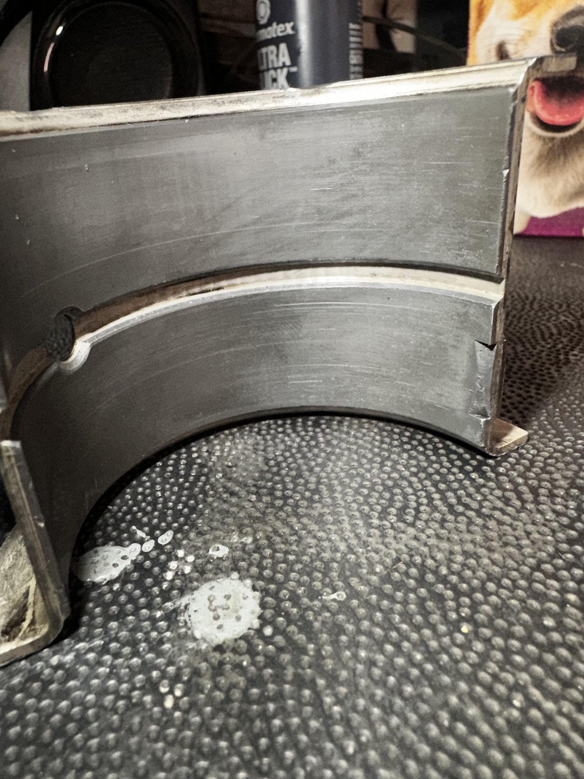

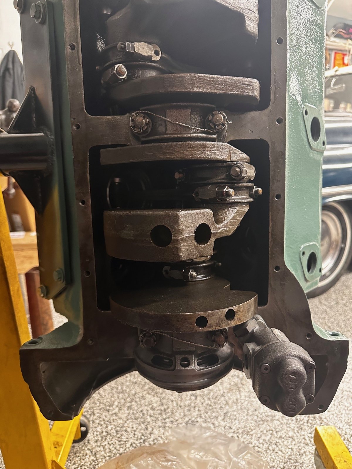

    So I’m going through cleaning. Mic all surfaces. Looked at all the mains. They are all this dark color. By the tang it’s the same color. You can just see by the tang it’s not worn at all. Is this what the protective coating does with ***embly lube or dirty motor oil? Honestly they look like someone spun the crank dry on them once with the micro scratches and it lubed up and clear and clean.
    All the mains look like this. Crank seems real nice also. Everything mics out.
    the photo is lit from the top to show the micro scratches.
    So my question is. Keep em or ditch em?
  14. Personally, at the point you are in dis***embly, I always replace them.
    Jacksmith and stubbsrodandcustom like this.

  16. Outback
    Joined: Mar 4, 2005
    Posts: 4,037
    Outback
    from NE Vic, Oz
    I don't think the micro scratches will affect the running of the engine, so long as there are no sharp edges to them. But if it's something that will bother you, new bearings might buy you peace of mind??
  17. RodStRace
    Joined: Dec 7, 2007
    Posts: 10,913
    RodStRace
    I would be happy to run those bearings. To amplify on this, how hard are you going to run it and how often? How soon are you going to have 50k miles on them?
    The other thing is, how good are new bearings? Lots of threads on QC and the lack of it on new parts, but I haven't heard about flatty mains and rods specifically. If you can spend the money and get quality parts, then it's your choice. Is spending here going to cut somewhere else? Good cooling, aftermarket oil filtration, and crankcase ventilation (even if it's a clean, clear road draft tube) getting the stink out are all going to improve longevity.
    Clark Coe, Algoma56, Thor1 and 4 others like this.

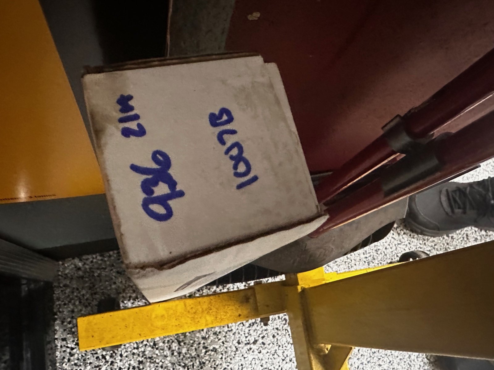

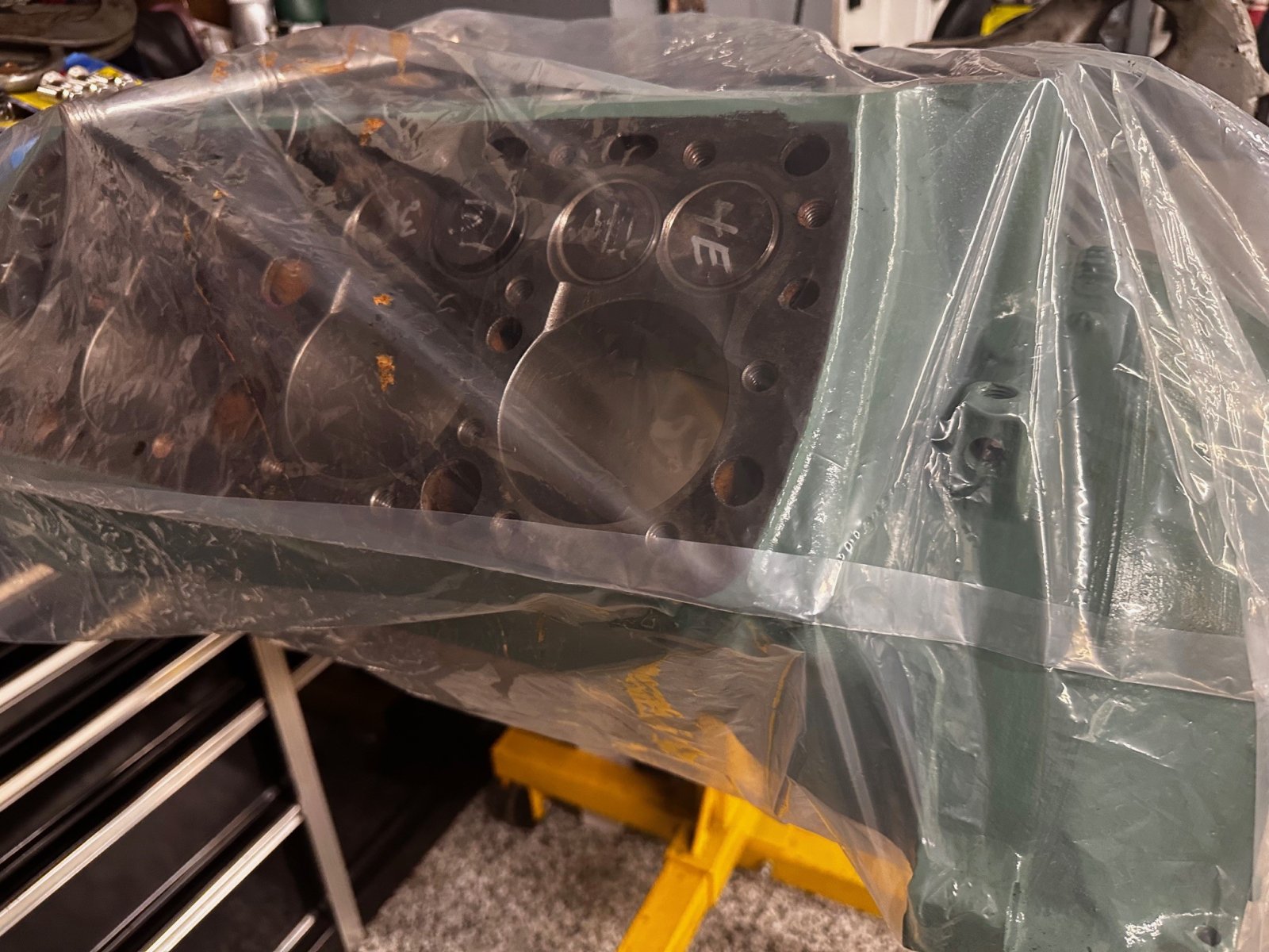

    Well, Its been a while, got the motor back from the shop... Been putting things together slowly but surely. I got new rod and main bearings, see how those work out, I figured yes the old ones were ok, but looks like micro scratches from dirty oil, I had cleaned so much on this that was previously overlooked so may as well go for the gusto.
    .125 over now to clean up. I figured what the hell everyone says they do fine at that much overbore. I noticed a diamond on the bottom of one of the water pumps, so I know on the Model A and B motors the diamond was by the timing cover and meant a factory warranty replacement motor. So did the V8 platform do the same?
    None the less, here is the cam grind I decided on for this one. My reasoning behind doing this one, everyone does the Max 1 **** and that doesn't sound fun. The 400jr is a bit suffering on the low end but has the SOUND of my people, and since this is not a T roadster I needed some extra torque down low. The 1007B grind has the same duration but a little less lift and from what others have said its a great all around cam so I figured why not!
    Isky 1007B Grind
    Lift .355”, adv duration 256*, duration @.050” 236*
    Decided on Detroit diesel green for the block. Just so tired of normal colors and wanted something that would look good with black and aluminum.
    Set up the valvetrain first and adjusted all the lifters before putting in the crank.
    Crank is IN...
    So I am debating on doing a smaller clutch but that would require a different flywheel. Its got an 11" that was in great shape upon removal, just don't want a left leg killer in traffic either but since this car is a larger car than a stripped down one, maybe some extra clutch wouldn't be bad? So this is the struggle I am at right now before putting the oil pan on etc....

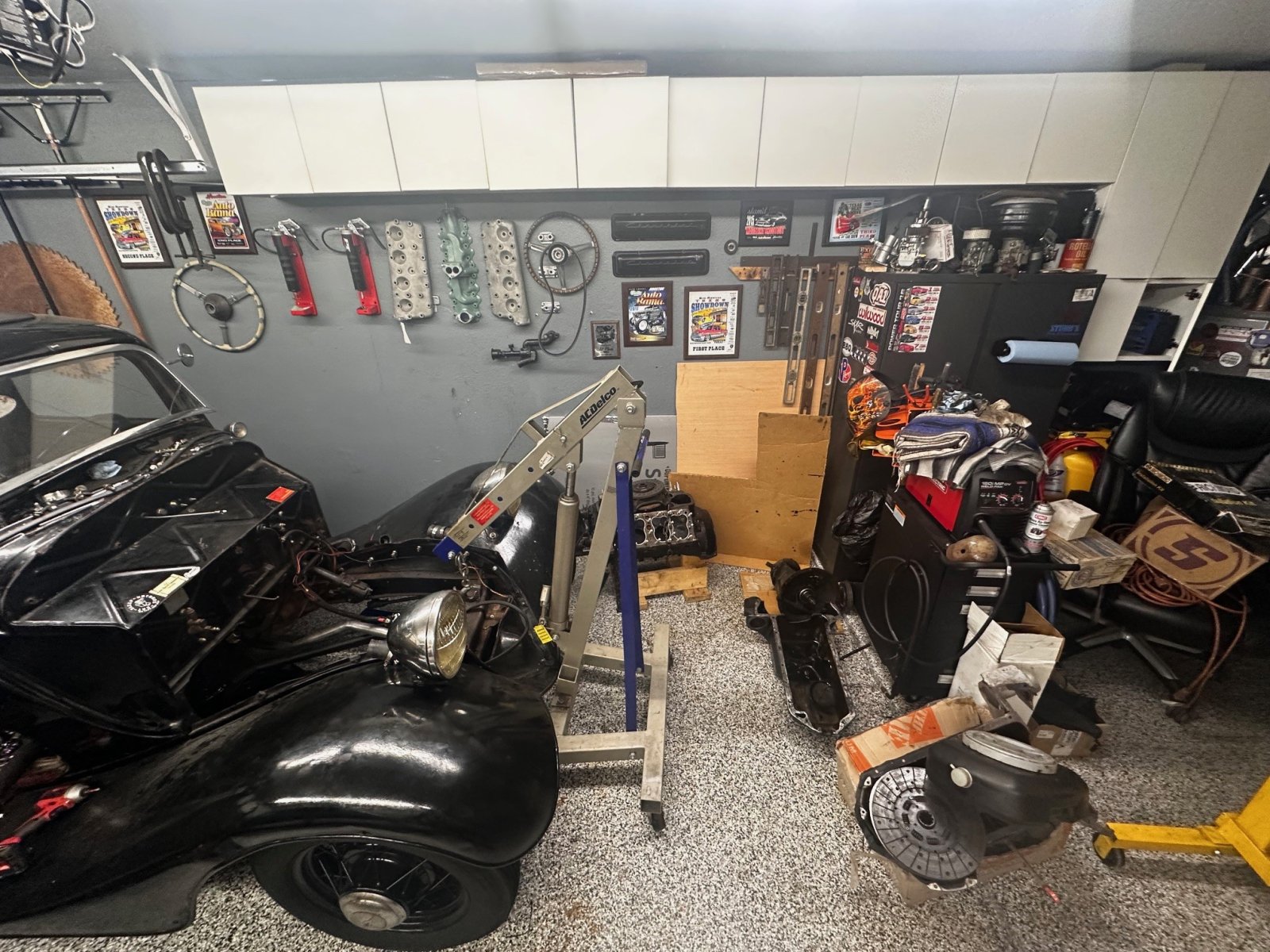

    Well, between Huricane and being without power for a week, Generator tending and refuling. I have been chipping away at the Flatty.
    Friday last week I decided to pull the motor and trans out. I know I have a synchro sticking so going to rebuild the synchro. Realized the torque tube seal is allowing fluid from the axle to go to the trans. So The work here has gotten more. Here it all sits sprawled out.... Pardon the mess, parts and motors taking up space for sure. Going to bolt up a set of old heads on the old smokey motor till I get her torn down.
    I needed the flywheel out of the old motor, I wanted the 9" for this build. I have pushed the 11" off to the side, I play to redrill it for 9" and use the 2 piece pan for the future project motor.
    So here are a few glamour shots from ***embly. Almost too pretty on Safety wire to cover up. I have to say I was skeptical on the ARP head studs, But the little extra of the allen wrench to drive them in was a nice touch. Well built kit honestly so much better than the speedway one. Discard the M15 pump, one of the suppliers sent it and it was in a M19 box, I just slid it in not looking till I was about to put the pickup tube on and was like huh, why is this so much longer. Eh... Stock 8BA goes back in....
