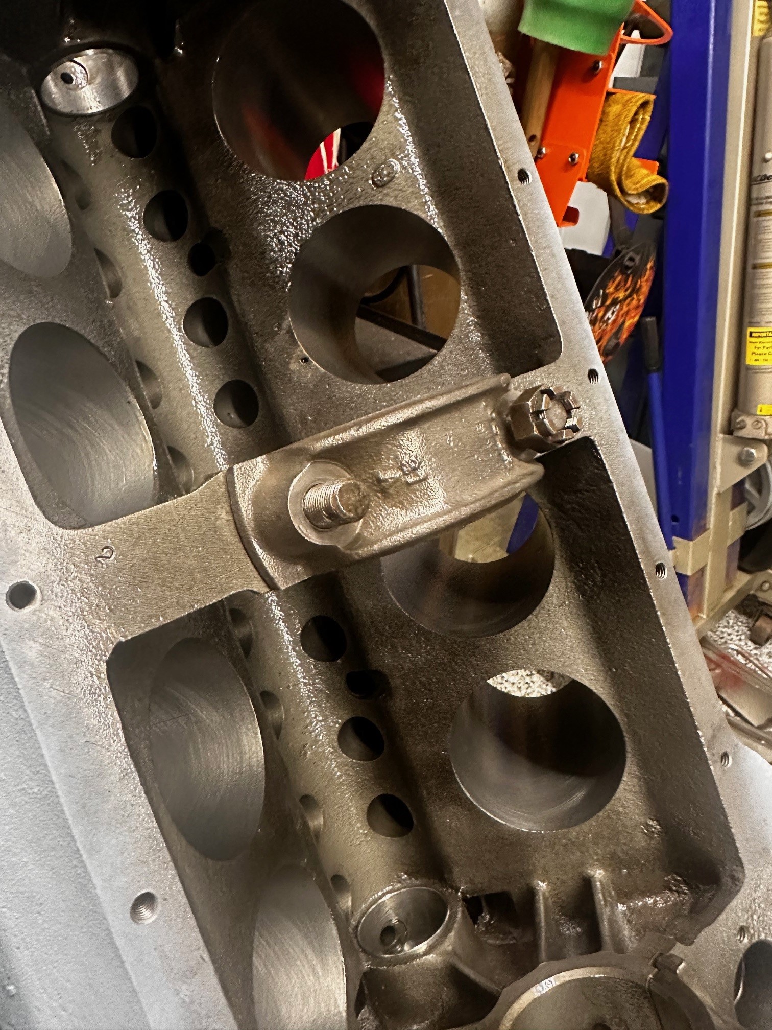

    Got the trans out and needed some extra stuff for it, so pulled the torque tube as the diff was leaking back into the trans so that needed fixing also.
    So after pulling the torque tube, I decided to s****e off the grease pile on the crossmember. It was 1" thick there as well.
    So decided to give the Trans case a good scrub and paint since I was delayed.
    I was going to shove the engine and trans in as one. But I didnt want to dangle it on the hoist all together and try to put it in that way, So trans first, then motor...
    Here she is in her new home!!!!

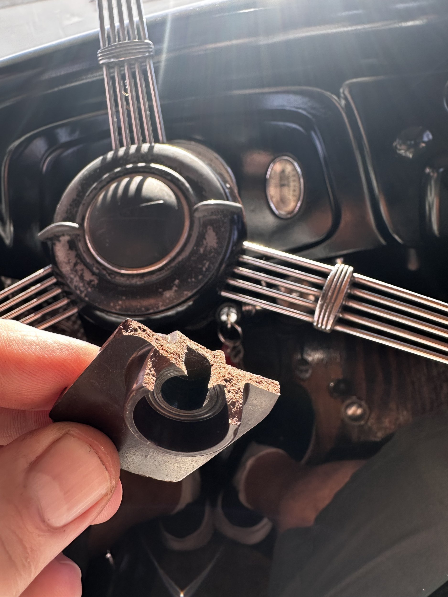

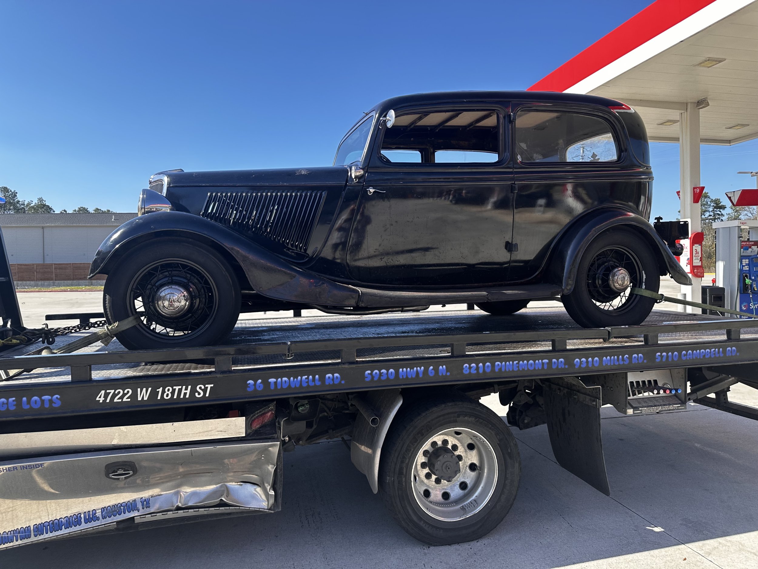

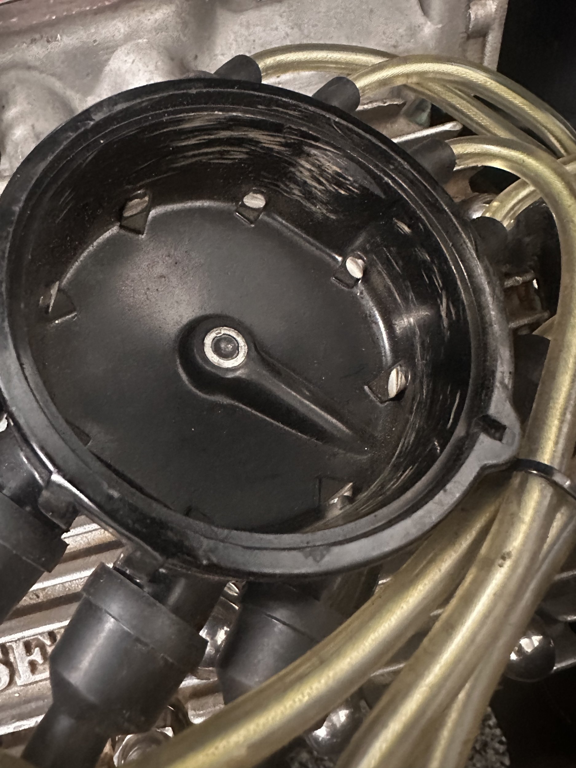

    So Decided to drive her to lunch with the wife sunday last weekend. Running great, then cough cough cough DIE.
    Fun discoveries in the gas station I drifted into.
    So Hagerty did me right, 20 minutes and tow truck was there.
    So got a new rotor, cap seems to still be ok and not cracked so I am running it. Found the clips and seal for the cap were not aligning right, so I think the seal failed and allowed the clip to pop off. So I tightened the clips up with a little re bend, and have a proper cap seal now, fits TIGHT. Ya live and you learn.
