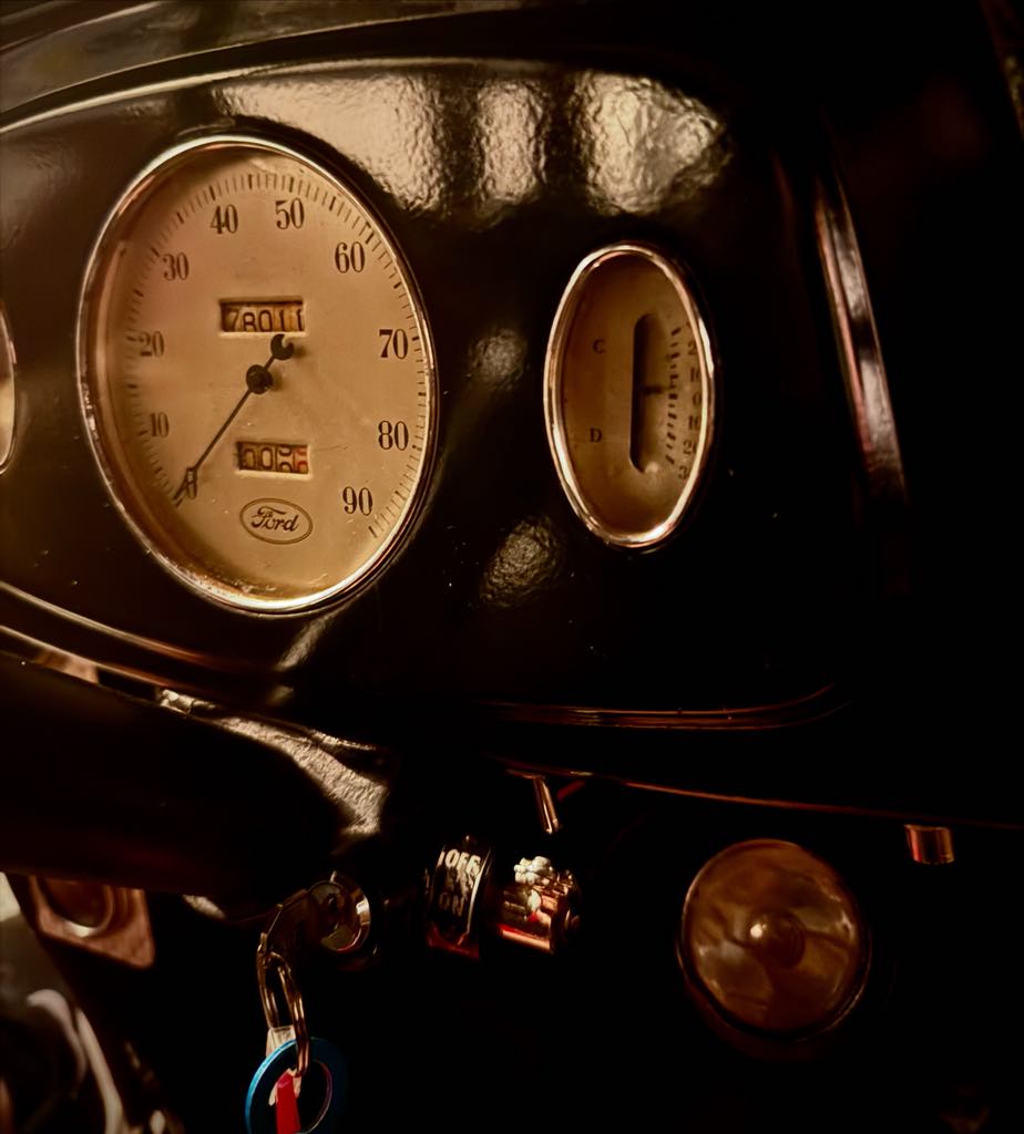

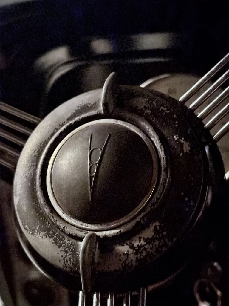

    Did a few shots a few nights ago, just the cool little things you notice owning these ole gals.
