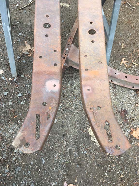

Got the outer frame off the inner frame. (A bit of polishing a turd). Next step is to set up the frame table, some sandblasting, more welding. moved it out of my tiny shop to get a picture. Its a 34 pickup frame with lots of issues including a former owner torched the front cross member rivets (guess they never heard of a drill) Hopefully I can relocate with the wescott print.

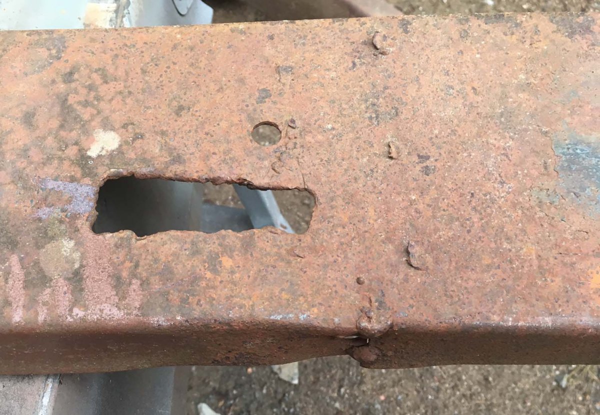

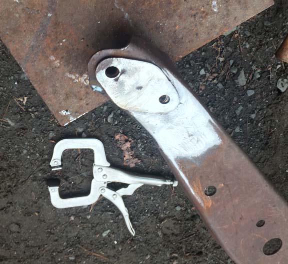

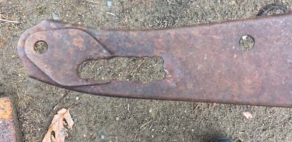

Got the inner frame back together. Started working on the outer rails. This was a pick up frame that came from Oregon. Someone cut holes in the frame and must have had used it for a hay wagon or something. Started welding the holes back in with some extra frame material and patience. Skip welding it back together. One hole down seven to go.
