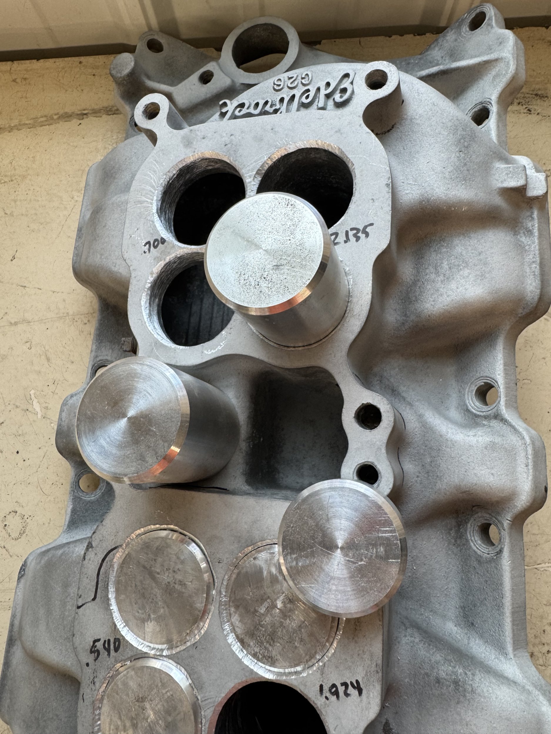

    IMG_1820.jpeg IMG_1989.jpeg I haven’t made as much progress this spring as I would like. I had a surgery that took me out of commission for about 5 weeks, graduation parties and mowing 5 acres every 3-4 days has slowed progress.
    I want to run a 2x2 intake on this. With the Nicson intake being super rare and for a 265 I decided to make my own. Anderson built one from a dual plane intake and a 471 carb adapter. I am going a little different route with mine. I took a Edelbrock C26 dual 4 intake and made some slugs to fill the holes. I am going to run Rochester 2cg’s on it. Next up is to hand it off to my machinist buddy and we will remove anything that doesn’t look like a 2cg base. I will then weld up where he machined into where the slugs are and then blend it all and use a needler on it.

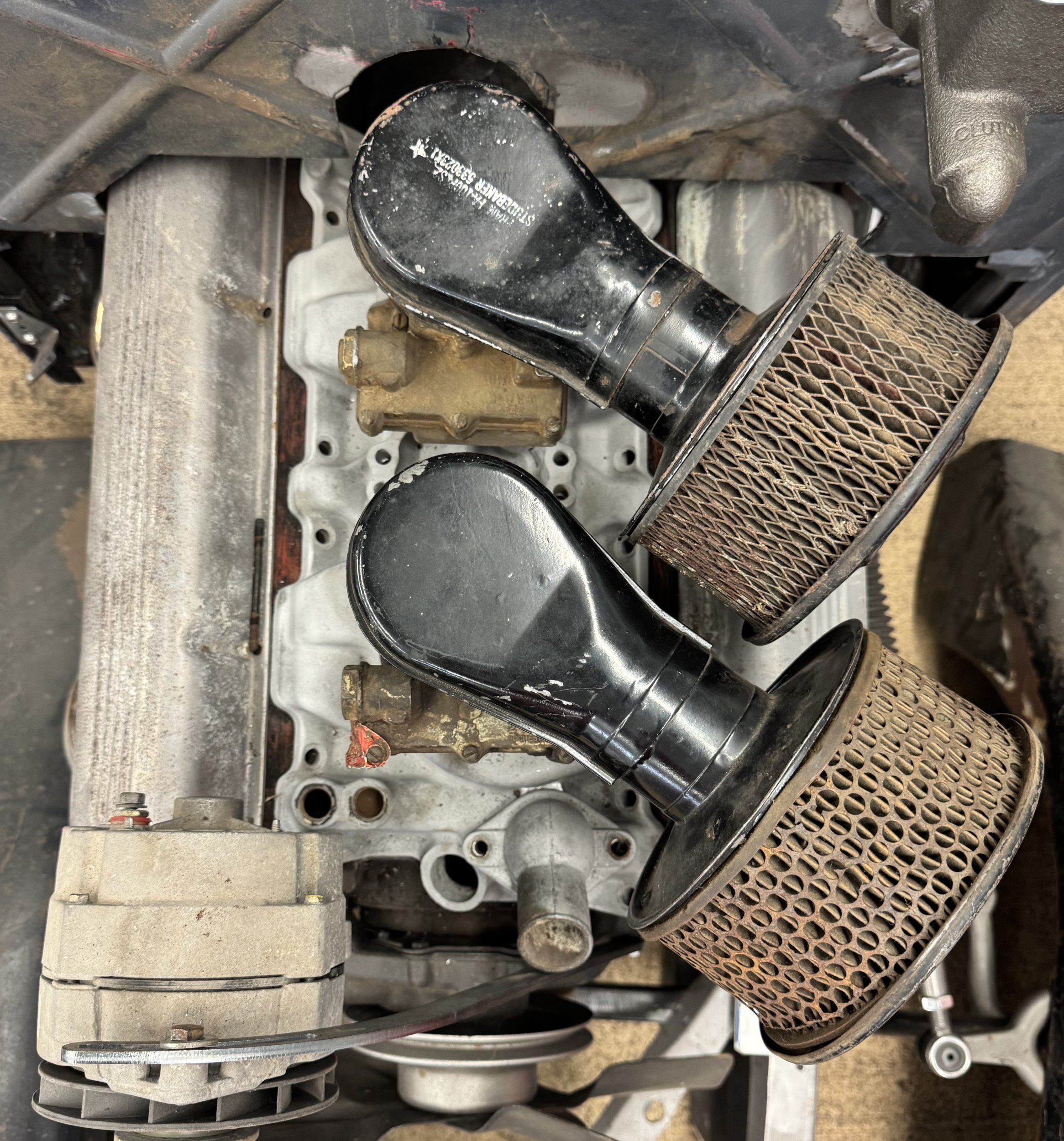

    32fenderless
    IMG_2034.jpeg IMG_1731.png I always liked the Hudson Hornet dual carb air filters. I found that the v8 Studebaker housings had the 2 5/16 openings. Got one bought and found it to be awfully big for the size of engine compartment so I cut out the extension piece. It took me a little bit to locate a second one but they are both modified now. I would like to get them chromed along with my stamped valve covers one I modify them for pvc.
    Next on the to due is get the firewall and trans tunnel made up so I can mount my steering column.

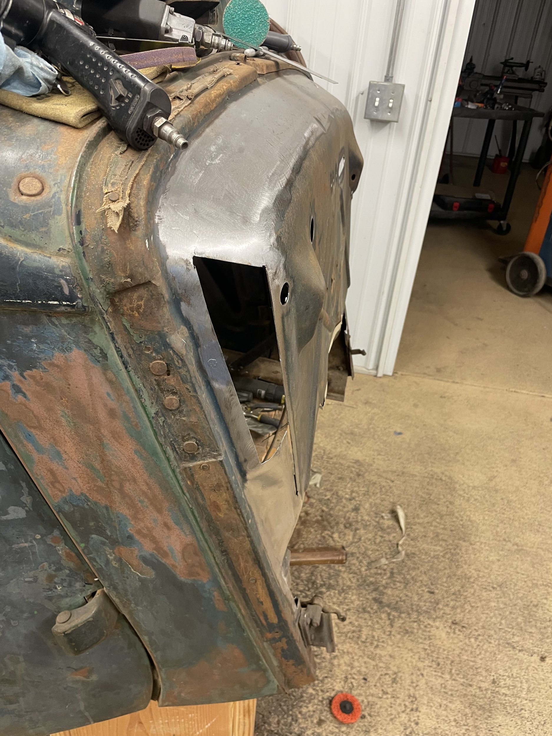

    This weekend I spent working on the firewall. I am going to correct the bead details in the firewall before I weld on the new lower. The cuts are a little weird as I was trying to save as much of the bead detail incase I would be able to use them to connect the left and right beads. I am just going to bring both sides to a point once I have that done I will make the final cuts and start to weld it up.
    I made an access hole so that I could pull my oil pump drive incase I ever need to pull the intake. I’ll make an oval cover to screw down to cap it off. The drive is halfway out in this photo.

    Undoubtedly this will flow less than it’s original design. this is my attempt of a 2x2 intake. SamIam and Anderson made theirs using a single carb intake and weld a blower adapter to it. Both of theirs turned out amazing
    So far we machined these slugs to each port diameter and height of each runner and welded them in. Next up is to machine the new openings and then remove everything else that doesn’t look like the 2cg base. I’m going to have a logo machined into the intake in the style of the Nicson one in the pic but with my last name(Crooks Engineering) or something similar where the Edelbrock logo is. Then finish it up with a bunch of time behind the needle scaler. Im hoping that my machinist buddy can make some progress this winter. He’s been busy building himself a new shop/home this past year.
