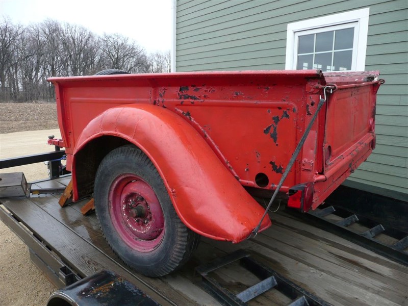

  8. You are not gonna find anyone repopiping fenders for this truck. Fronts sometime come up on eBay but you rarely see rears for sale.
  9. Felix 40
    Joined: Nov 20, 2011
    Posts: 102
    Felix 40
    from Wisconsin
    If you need fenders, Keep your eyes peeled for old Homemade Trailers.
  10. Felix 40
    Posts: 102
    Felix 40
    from Wisconsin
    forgot to upload pic

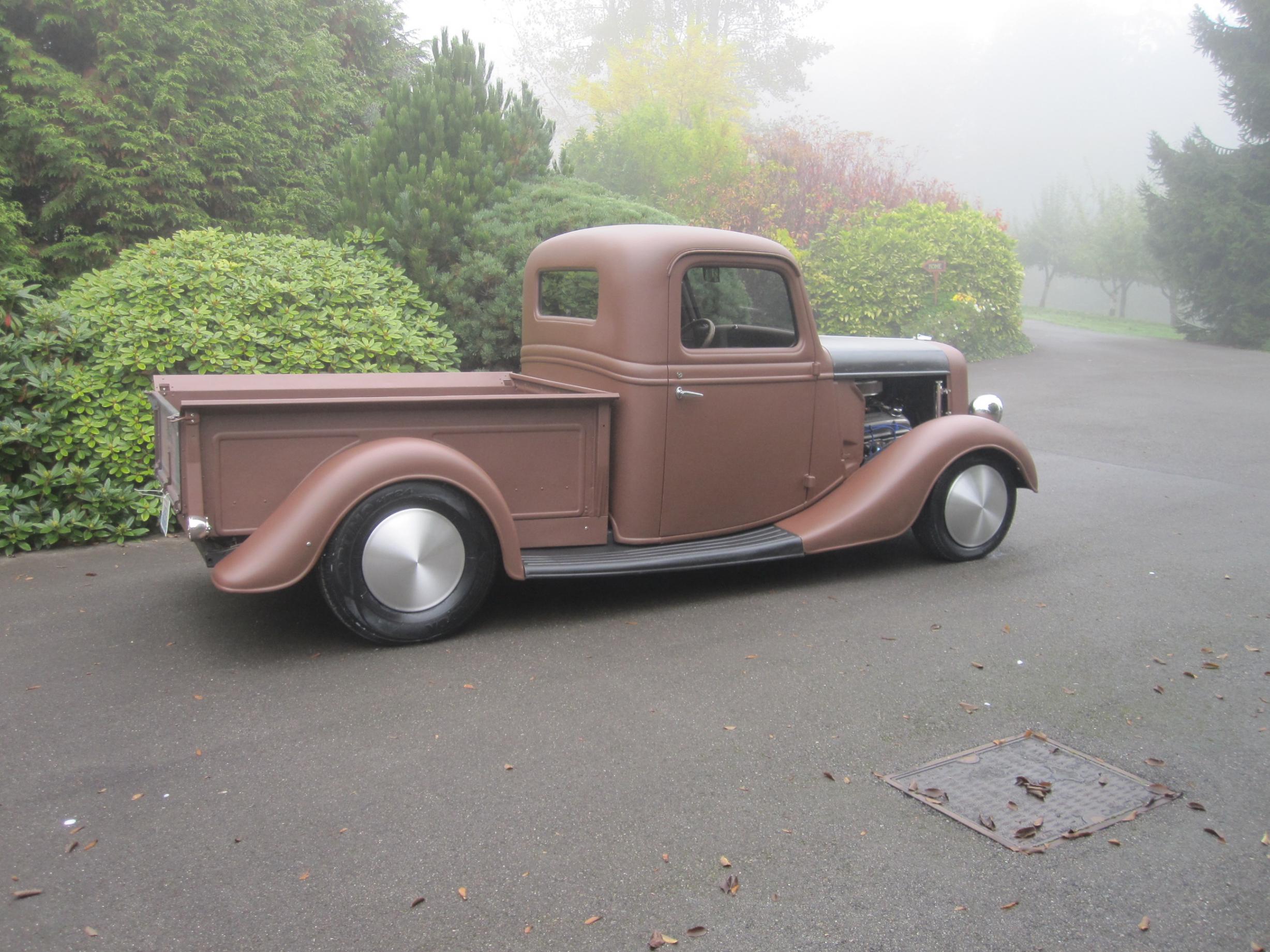

  17. rramjet
    Joined: Dec 30, 2009
    Posts: 643
    rramjet
    My first car was a 36 1/2 ton. Had a 48 Merc flathead, 39 ford gearbox and rearend and 40 Ford brakes. I found it beside a house buried up to it's axles in mud in San Diego around 1961. Told my Uncle about it and he bought it for $75 and went completely through it. Sold it to me when I turned 15 for $250. It was painted red oxide primer. Turns out it had been a push car in Balboa stadium when they ran jalopies. Sold it to a Deputy Sheriff in 1964 for $750. By then my Dad and Uncle had painted it metallic green.
    A few weeks ago I stumbled on a 36 1/2 ton in red oxide primer color with a 327, a Muncie close ratio and a 12 bolt posi. Didn't think I could even get in one any more but managed to and actually drove it. Fell in love and today at 1:30 PM PSDT I became it's owner.
    Reliving my wasted youth.

    Who makes a nice quality, nice fitting fibergl*** or metal single panel hood like the one shown on Ramjet's truck?
    I would like something temporary as I restore my original 4-piece hood, which I may or may not ever finish. I want something affordable that I can latch down solid for "freeway speeds" (ahem). For functionality, modification (my grill was chopped 2") and simplicity, a nice piece of fibergl*** with dzus clips might be a way to go.
