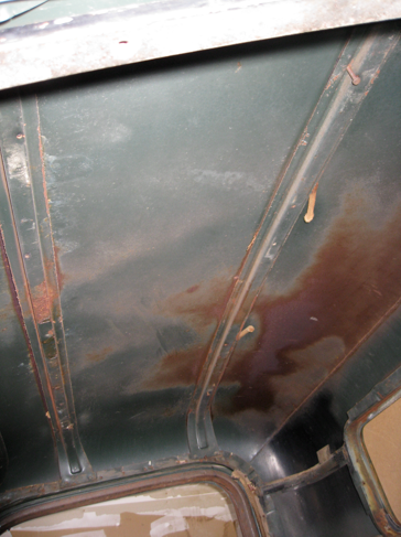

    Checked out my early 35 cab and it has 2 braces in the roof. It is a big truck cab and also has the removable window garnishes. If I remember I'll try to take a picture and post it.

    A pic of the roof in my early 35 cab.

    Wow, I have never seen that. That would make it easier to hang a headliner.
  5. Yep, that is exactly what the cab of my 36 looks like.

    So it's not a year specific thing. My 35 and 36 have a single bar in the center.

    Also, the corner brace on my cab is a touch lower and has a upper tab not found on the red roof cab.

    The corner brace on the red cab is one piece from door to door. The green cab has two separate tabs. One coming off the corner brace and one over the rear window.

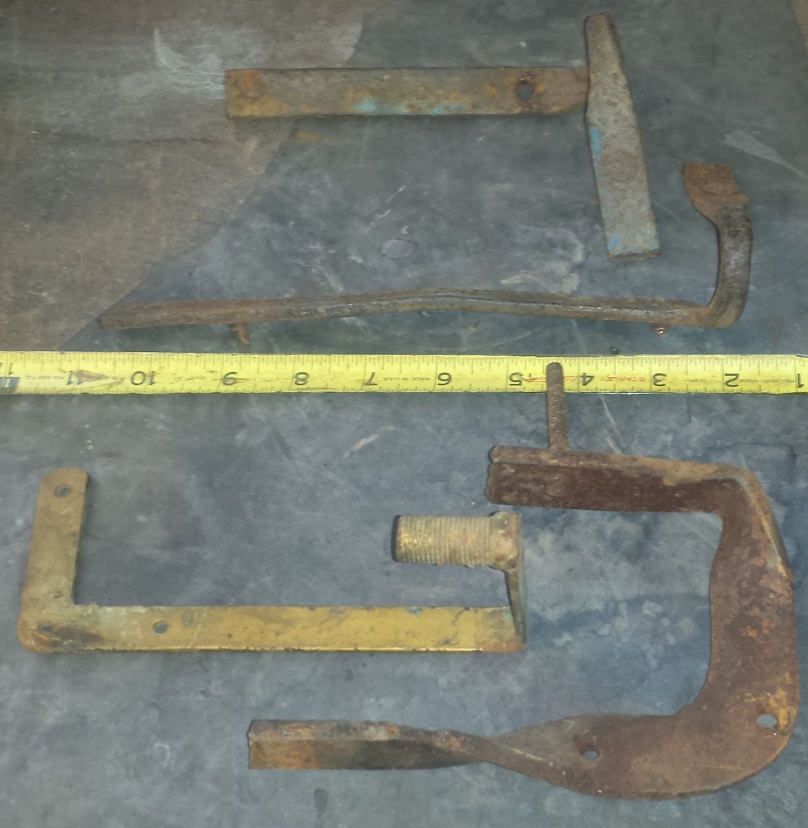

    So, I had some guys asking about the differences between big truck fenders and pickup fenders. I had a set of inner fender braces for each on the bench this weekend, so I snapped a few pics.
    I think you could make a set of big truck fender braces work in a pickup if you were creative.
