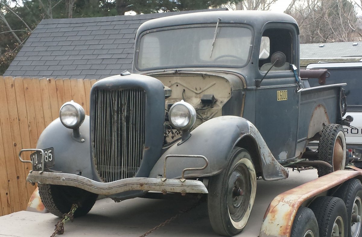

    A couple years ago after lots of begging, I got my great uncle's 1936 Ford Pickup. 100% original and minus the rust spots I wax over, I still polish the paint on the truck. I still run the original flathead (for as long as I can before it overheats) and just put a blanket over the original seat that has a small hole in it. In an attempt to find the right paint code for it, the matching color was Slate Green and was on 1935 not 1936 pickups. This is where the research started. After reading this post a lot of the information is dead on the money but some things simply don't fit. The grill shell is 6.5 deep, the bumper arms still p*** through the fender, and so far that I have only found those points to not be accurate. However the rest all fits. I have attached some pictures of some of the things pointed out on a 36. I guess by biggest question here is whether my truck is a late 35, or early 36, or ? Again I do know it is all original and remember playing on this truck when I was 9 in a garage in central Nevada.

    Henry was notorious for being a tightwad. My guess is this is a late 35/early 36. He probably had a run of left over 35 stuff that he wouldn't give up, so he used them on the early 36 until gone.
    The cab is definitely 36 along with the door pulls and the grille. The fenders are 35, but I am unsure if any ever made it to the 36 run. Also, it could have been wrecked in it's life and 35 fenders were all that was available.

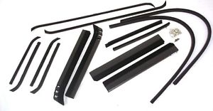

  17. Did anyone do a write up on the window fuzzies?
    I'm starting with previously molested doors so I could use a little idea on what's going where.

  19. Hey Vicky, I just finished a set of those doors. Let me know if you would like pictures. Generally, you don't have to remove any welds to replace the gl*** run channels. If your doors are early (i.e. '35 or early '36) they will have slots in the flanges that form the gl*** opening at the bottom of the door gl*** and use 4 rubber bumpers rather than the long metal backed fuzzies that Vintique includes in that kit. Joe at Joe's Antique Auto has the bumpers.
  20. That would be awesom!
    Thanks
    My doors are '36 with built in non removable garnish and previously molested.
