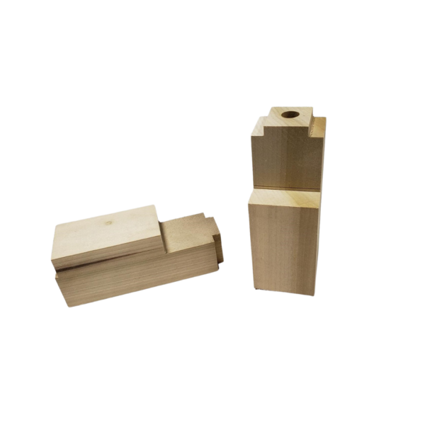

    Anyone have pictures of how these are located in the pickup?
  12. Roothawg
    Joined: Mar 14, 2001
    Posts: 25,982
    Roothawg
    They go between the rear frame crossmember and the bed. It has a step notch in it and the bolt goes down through the center.

    Thanks. I can’t seem to make sense of the location understanding that a bolt goes through to the frame. Being an old farm truck I am not sure what may have been modified. Would love to see a picture
  14. Roothawg
    Posts: 25,982
    Roothawg
    Mine is blown apart or I would send you a pic.
    Here are the blocks.
    They mount here.

    Here is the block sitting in the corner. Does it somehow line up with the hole you see? I think some of the tabs were cut off the back of the frame. I put in a spreader bar that you see below.
    The bed frame is lined up roughly with the tank filler so the bed location seems close.
    thoughts?
  16. Roothawg
    Posts: 25,982
    Roothawg
    The block actually sits on the crossmember of the frame where the hole is. The notch is cut out for the rear bed piece I showed you a pic of. The bolts come down through the bed floor. The flange of the rear bed piece sits on the notch , if that makes sense. You should be able to see the bed wood if you are kneeling down behind the truck.

    it would make sense that the bigger notch would line up under the rear cross member
    I am not sure the bed frame and tank have shims?
    F5C23744-1A4C-498B-B918-F5A77225DB7D.jpeg H 49277EB6-0D80-475C-AE3F-95175C49BA3F.jpeg
  18. Roothawg
    Posts: 25,982
    Roothawg
    Turn it 90*. The notch goes towards the back. There is also a wood substructure that the bed frame uses between the steel floor and the bed structure. It’s been 20 years since I have installed a set. My memory is foggy. I need to run by my dads and see if his is installed, where I can get some pics .
