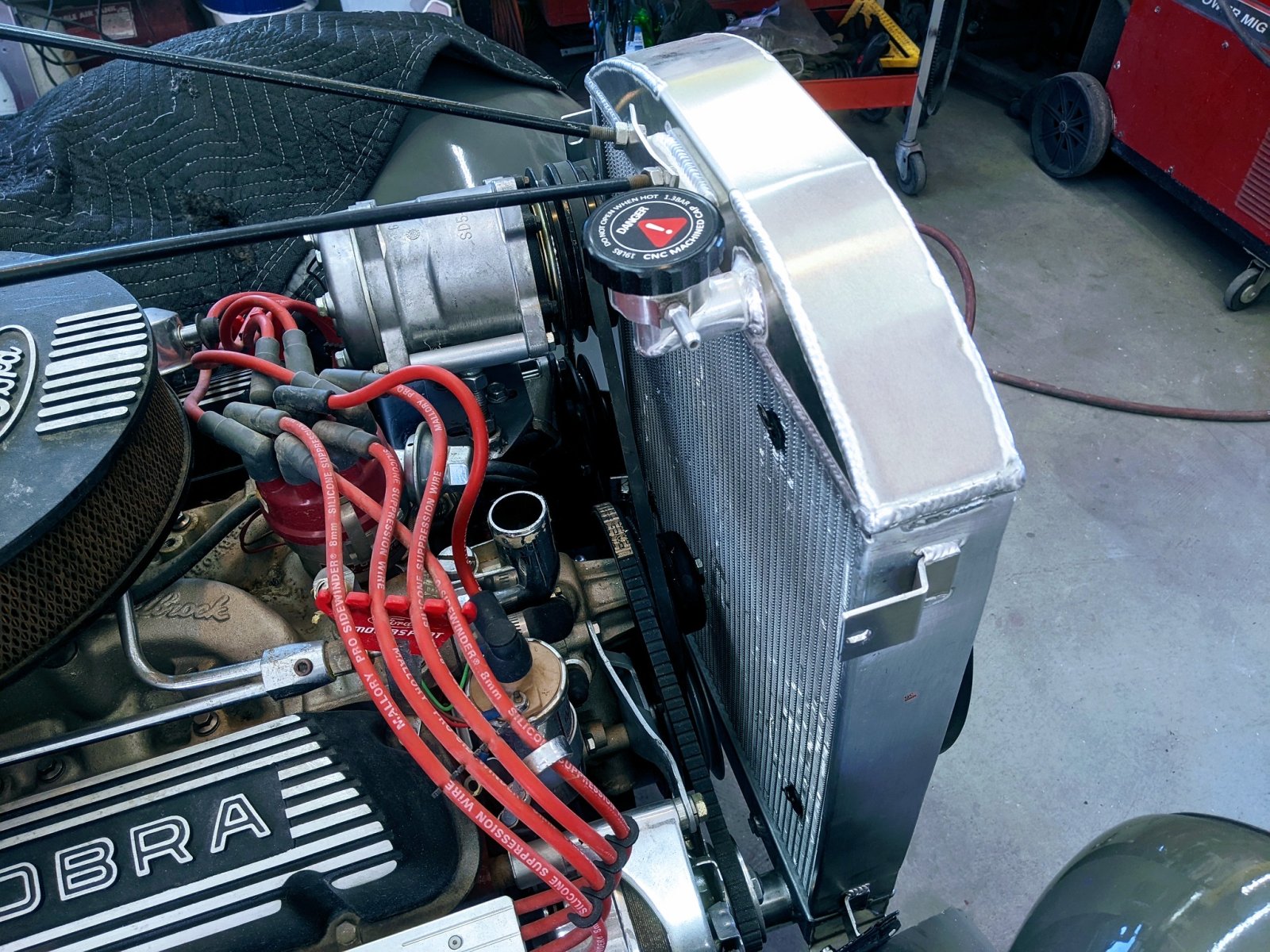

    I have another question. I installed the fenders, radiator, and now the grill. I'm having trouble mounting it. Should I have installed the grill first?

    No, some just fit better than others. I had a 35 grille I wrestled for days. My wife said "Why don't you just use the 36 grille hanging on the wall?" 10 minutes later, I was done.
    Start with the cab. Make sure you have the right wood in the right places. Mount the fenders.
    Mount the inner fenders next, then the grille. Leave everything loose so you can move it around.

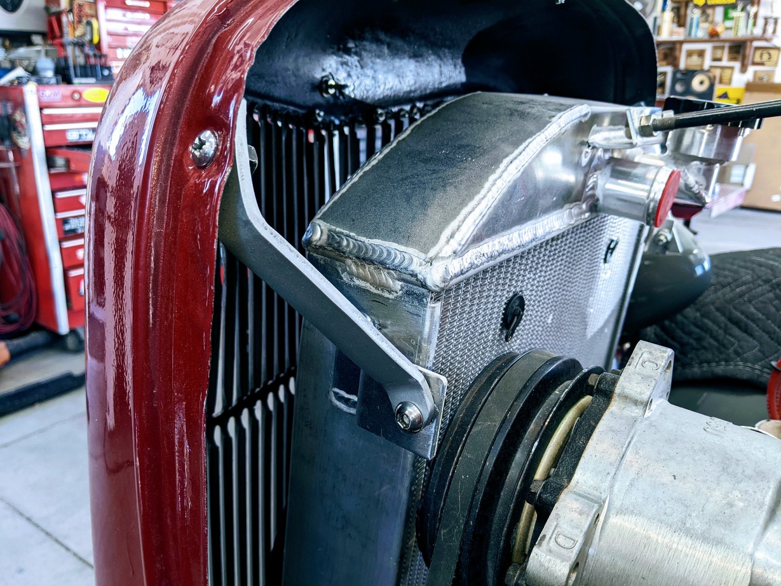

    Yup, I did all that. I finally got it to fit. I made some brackets to secure the upper part of the grill. It’s solid now.

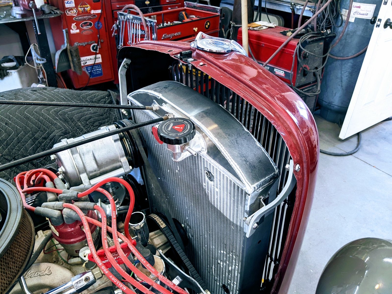

    Roothawg

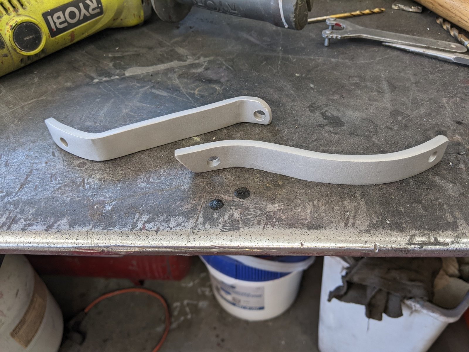

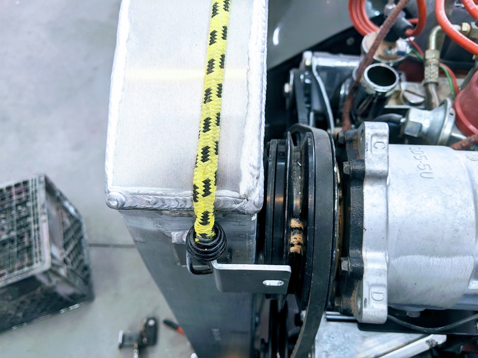

    Just remember the original hood sides latched on radiator side pieces that stuck out.
    These are by no means the best looking ones, but I fabbed these up, because my Walker radiator arms were too short.

    Those are some serious brackets.

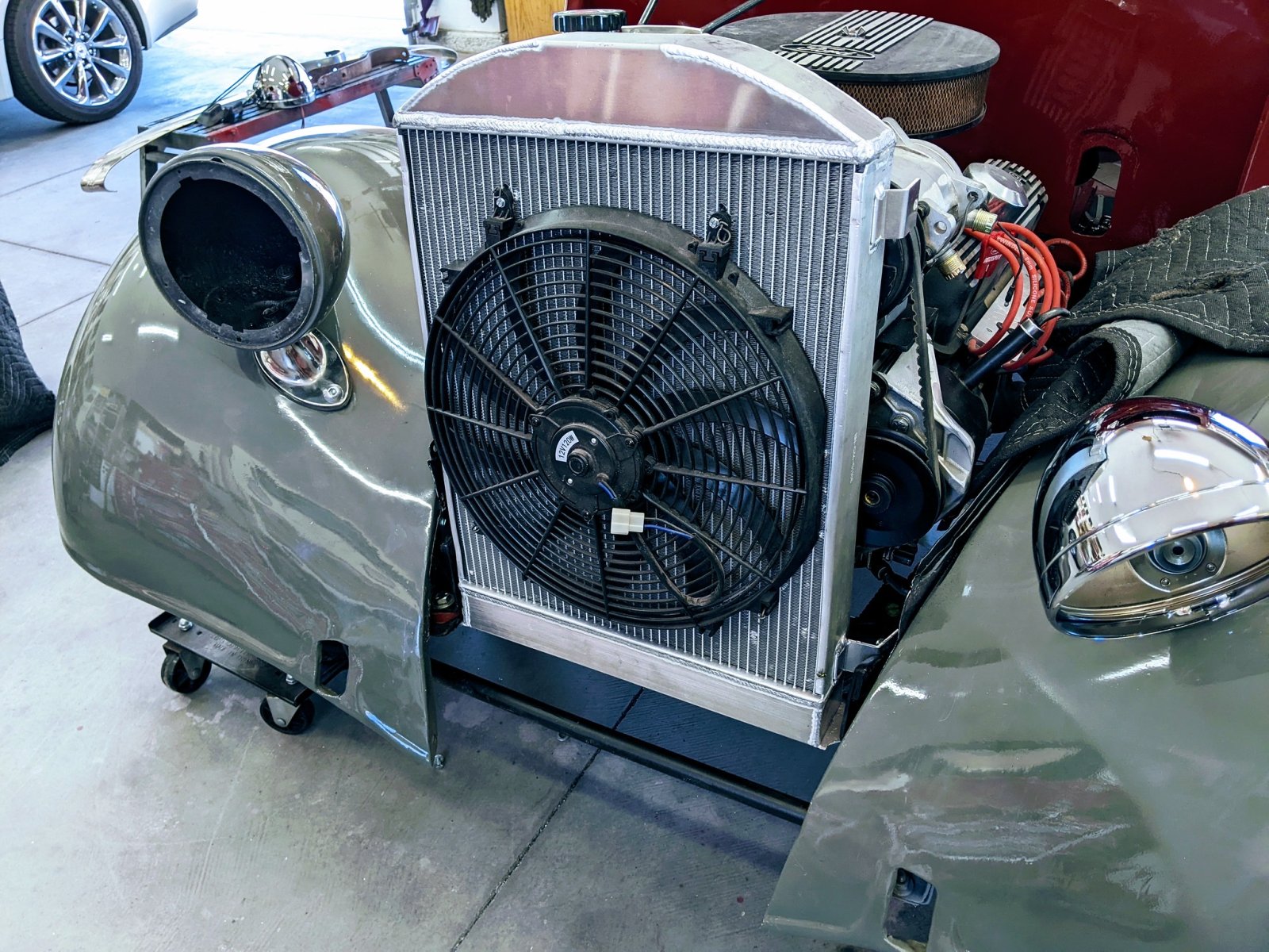

    The radiator is supposed to fit snug in the radiator shell and by doing so, it forces the incomeing air to go through the radiator. A schroud is often needed to pull the air through the radiator. Your radiator appears too small and will allow the air to go around the sides.
    Are you running a fan?
    I know it's a lot of money but the proper radiator would solve both mounting problem as well as the air flow.

    Strodder
    I do have a fan installed, but on the outside because of no room for it in front of the engine.

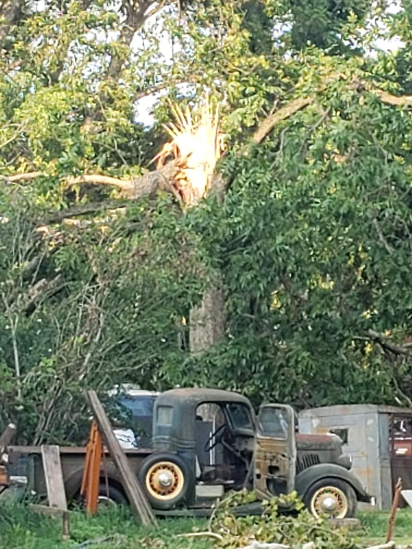

    tree.jpg Friday night was the worst storm I have been part of. My 35 got lucky when the wind blew the tree the other way.
