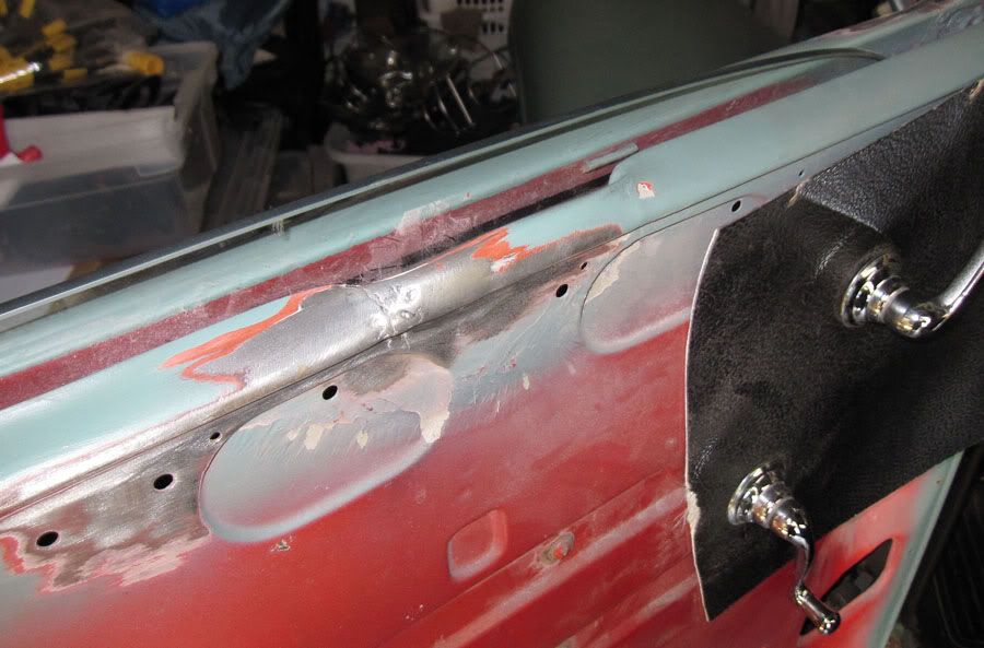

    Here are pics of the 2 different door interiors for 35 and 36. As Roothawg stated on this thread, the early 1935's had the screw on window garnish molding (last picture), the late 35's and most 36's had no window garnish (first and second pics); the interior door sheetmetal has the door handle stamped into it. Both 35 and 36 have a rear window garnish molding. 35 and 36 doors are interchangable on both cabs; you just have a choice as to garnish molding or no garnish molding. I have to say that the built-in door handle is a weak spot and is prone to cracking as seen in the pictures.
    I have yet to see a 36 with door garnish moldings. I think that if you see a 36 with garnish moldings, they have had the doors replaced with those off a 35.
    Lets all thank Roothawg for this great thread and info!!!
    My 2 cents

    My 35's driver side inner door was also cracked like the one pictured, but it was a easy fix... weld and grind with the little roundy grinding stone for the dremel.
