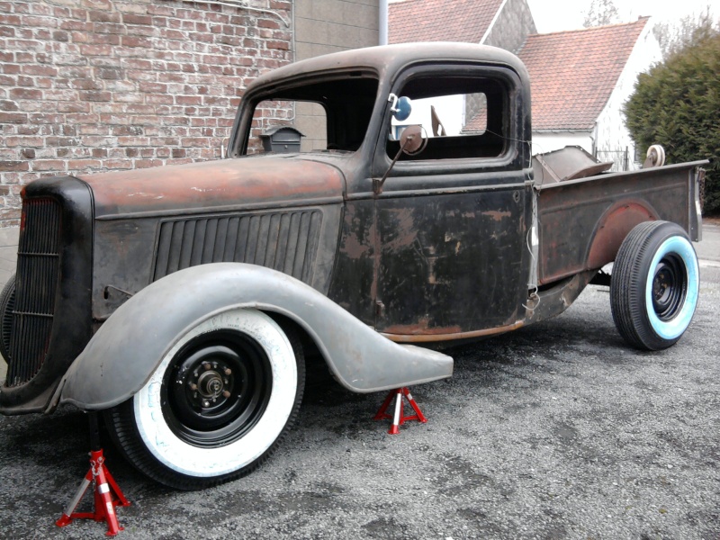

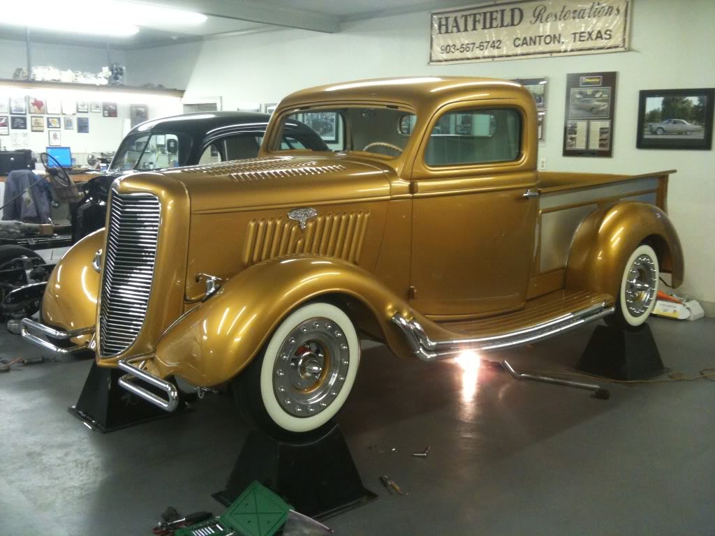

  4. 53choptop
    Joined: Mar 5, 2001
    Posts: 1,205
    53choptop
    I don't have pictures of them side by side, but the attached pics can give you an idea of the differences. I can tell you, there is a difference in the arches and minor differences in where the running boards meet up. Everything else lines up the same. I happen to have both 1 ton and 1/2 ton fenders.
    Here are a couple of examples, If I am not mistaken, Winfeild's truck uses 1 ton fenders (correct me if I am wrong guys), and the other truck are 1/2 ton.
    Toms Dogs likes this.

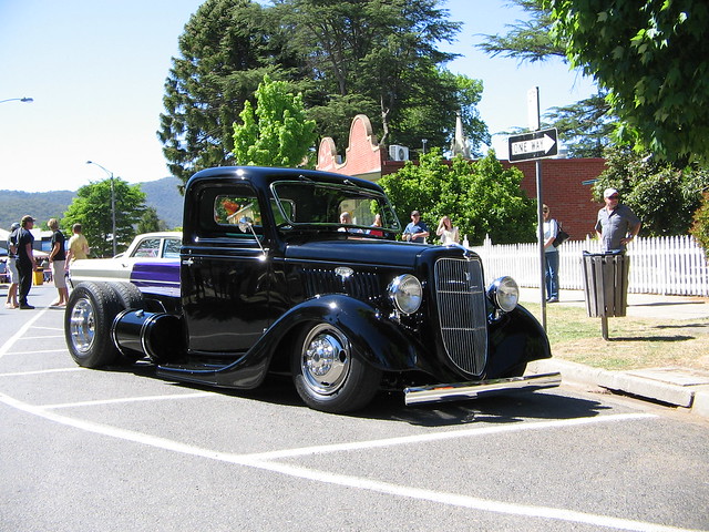

  20. pvcerod
    Joined: Dec 31, 2005
    Posts: 76
    pvcerod
    from Australia
    I don't know Root.....this one don't look to bad :cool::)
  21. yoyodyne
    Joined: Nov 26, 2008
    Posts: 855
    yoyodyne
    That looks like a 36 cab, and a 36 hood except the louvers are different w/a 35 rad shell. Is that right, or are OZ trucks different, or is it big truck metal which is different, or what's the story?

  22. rustymetal
    Joined: Feb 18, 2003
    Posts: 571
    rustymetal
    yes i would say you are right on the money.
    wonder what size tires he is runing with those air bags and big truck fenders ?
  23. cvstl
    Joined: Apr 15, 2009
    Posts: 1,504
    cvstl
    from StL MO
    That's a great looking truck, and it is actually the reason I have been thinking hard about building my big truck and not just using it for parts. I'm with Root, tho on the big truck fenders. Those fenders look good on that truck because they have big truck wheels under them.
  24. yoyodyne
    Posts: 855
    yoyodyne
    Tires look like 235-85X16s to me, not especially large. About 32" OD.

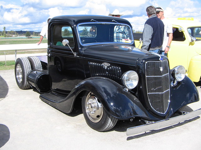

  25. pvcerod
    Posts: 76
    pvcerod
    from Australia
    Here's one of our stock 35 Trucks, our Cabs are a little different to yours, but the Grille & Bonnet sides are the same as your 35's
  26. Roothawg
    Joined: Mar 14, 2001
    Posts: 25,953
    Roothawg
    Thanks for posting that. I have never seen one of those cabs.
  27. southpaw-customs
    Joined: Jul 19, 2005
    Posts: 462
    southpaw-customs
    Looks like a panel truck roof cut off. Is that a piece of stainless that hides the weld seam on the back of the cab?
