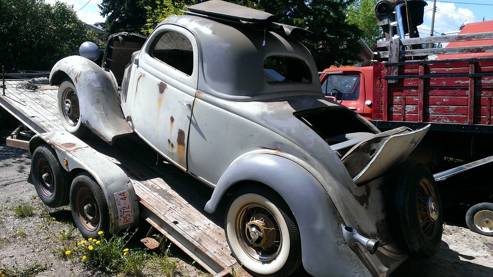

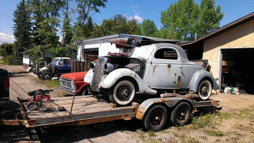

  2. IMAG0857b.jpg IMAG0862b.jpg IMAG0867b.jpg IMAG0868b.jpg IMAG0870b.jpg IMAG0876b.jpg IMAG0880b.jpg Finally! Got my garage interior finished and machinery moved over from my old garage next door, so the 35 gets its turn and for the first time since I built the new garage it sits on the pedestal as number one in the collection. Here are some pictures from moving day.

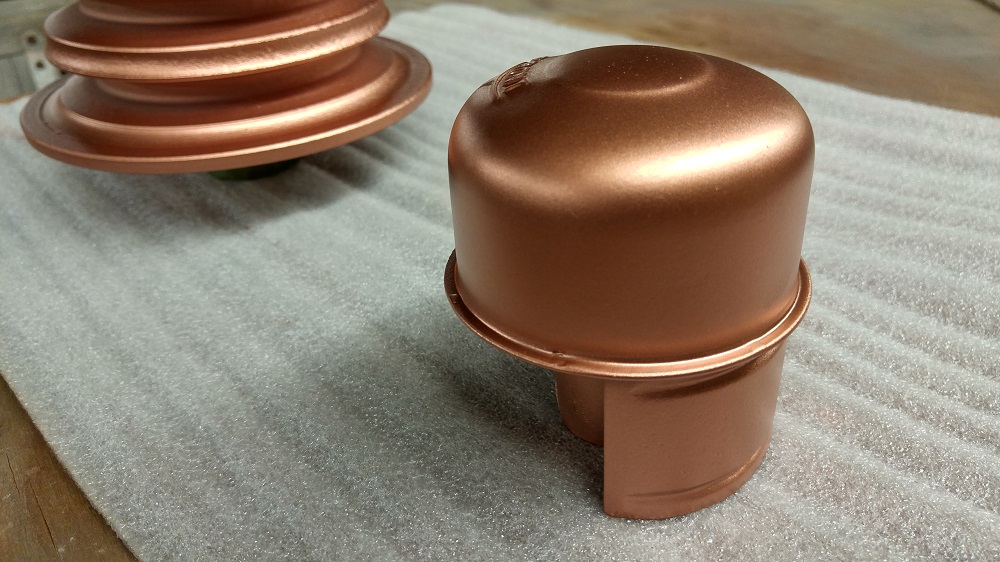

  9. Here is a teaser on the engine's new colour choice.

    I like it. What colour are you going to paint the car, Cream?
  11. It will be ages before a final decision on the car's finished colour. It was originally Washington Blue. I'm going with grey primer as work progresses.

    The engine colour is Chevy Sierra Gold?

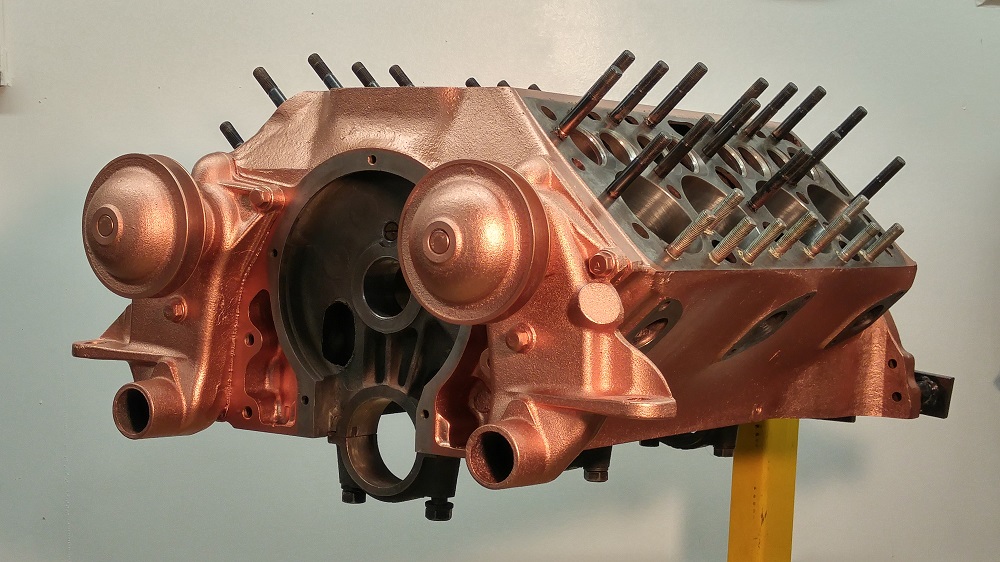

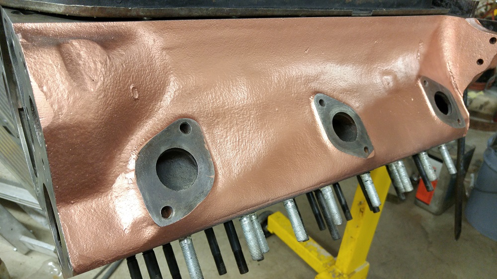

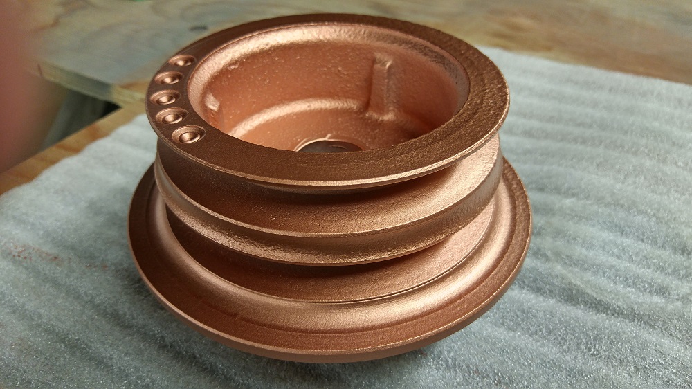

  13. Home Hardware Beauti-Tone Copper. Here's how it looks on the block just not as pink (fluorescent lights).

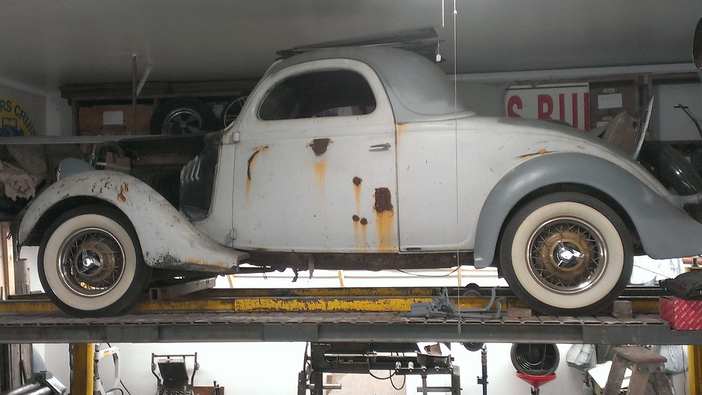

  14. Just puttered on the 35 a bit today. Let myself get side tracked on the hole that the mill will call home.
    Did a carnauba facelift on the left cowl and part of the firewall. Not too shabby for 81 year old paint. Guess a little wax goes a long way.

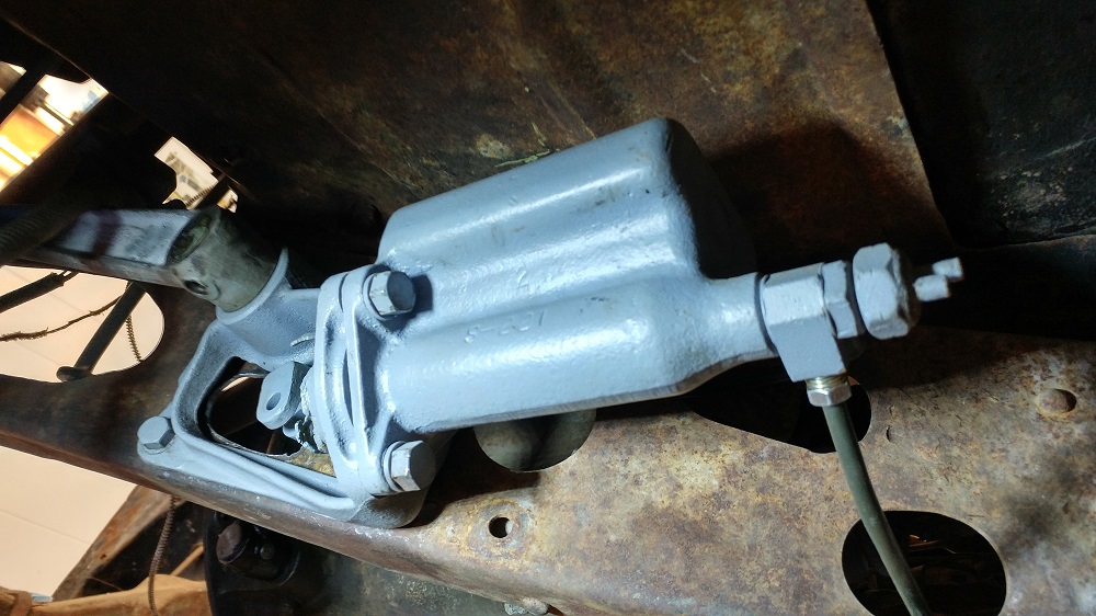

    I have managed to plumb brake lines, and get my $20 `39 master and brake pedals in, so I'll post how I did that for now, hoping that I'll have a lot more to report in the near future. I've also undertaken the huge task of removing the decades old gray primer, just because I wanted to see what is left of anything original under there. You could say that the polishing of the firewall inspired the shove in that direction. Just a preview of some posts to come.

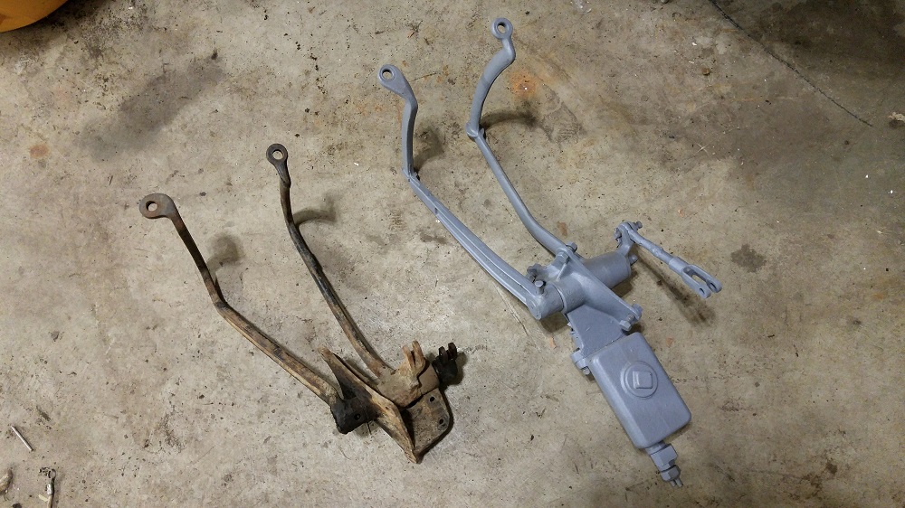

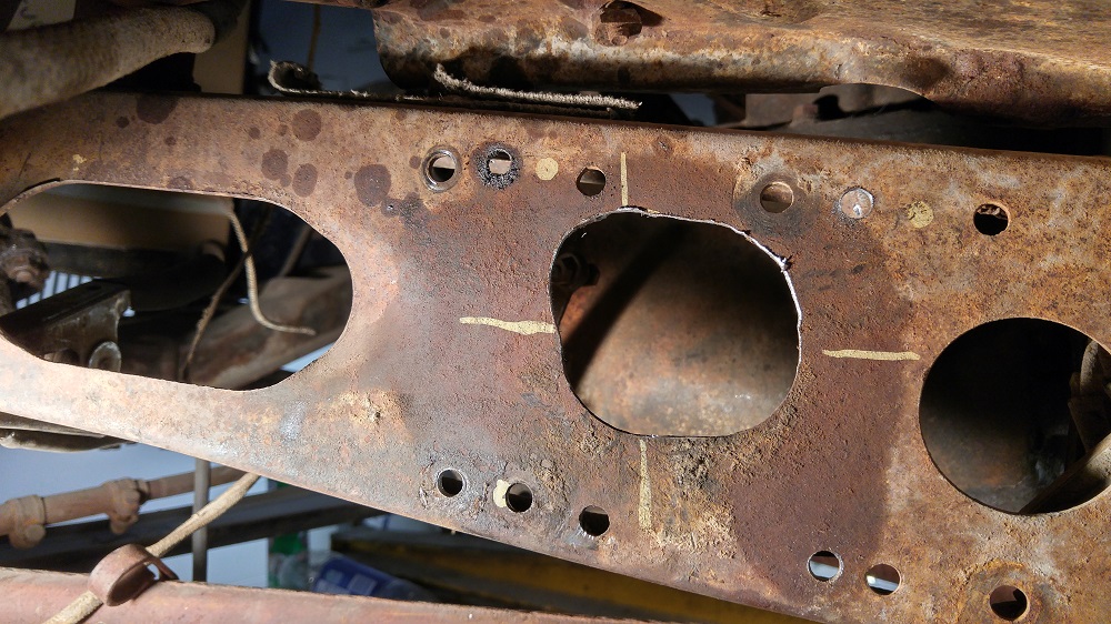

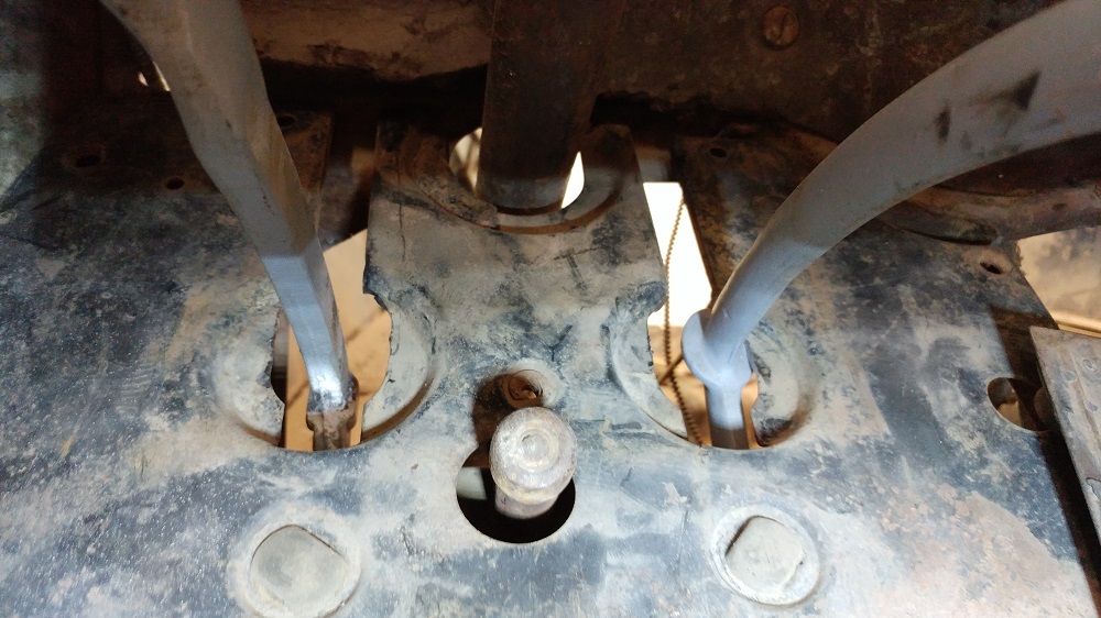

  23. So, here is a shot comparing the original pedal assembly with the `39 unit. It is not an assembly for assembly swap, but definitely makes the swap easier.
    The stock pedals(left) bolt in from the transmission side originally, and the `39 assembly has to go in from the outside of the left K member.
    I found my `39 cluster at a swap meet a while back. I was talking to a couple young sellers about their 35s and one asked if I was going juice brakes. He directed me to look down at the pedals under the table. I asked, "is that what I'm going to need?" He said, "yup big bucks and hard to find". He proceeded to point out the 91 prefix in the part code and the mechanical attributes that make them unique for 39. I told him I was sold, but din't think I had the cash. What, you don't have $20.00 on you? SOLD but why not get more for them on the auction site? We rather they go on your three window. So that is the way that went down, honest. All they're info checked out when I got home so I consider them well bought the Canadian way.
    Figuring out where to start when I did the swap turned out to be the challenge. I couldn't recall any threads I've seen on doing the deed, but there were some scattered bits of info that came up in a search. I knew before digging in, that the floor sheet metal plate around the pedals had to be clearanced. I also learned that the clutch arm at the transmission, had to be upgraded to a 39, which I didn't have.

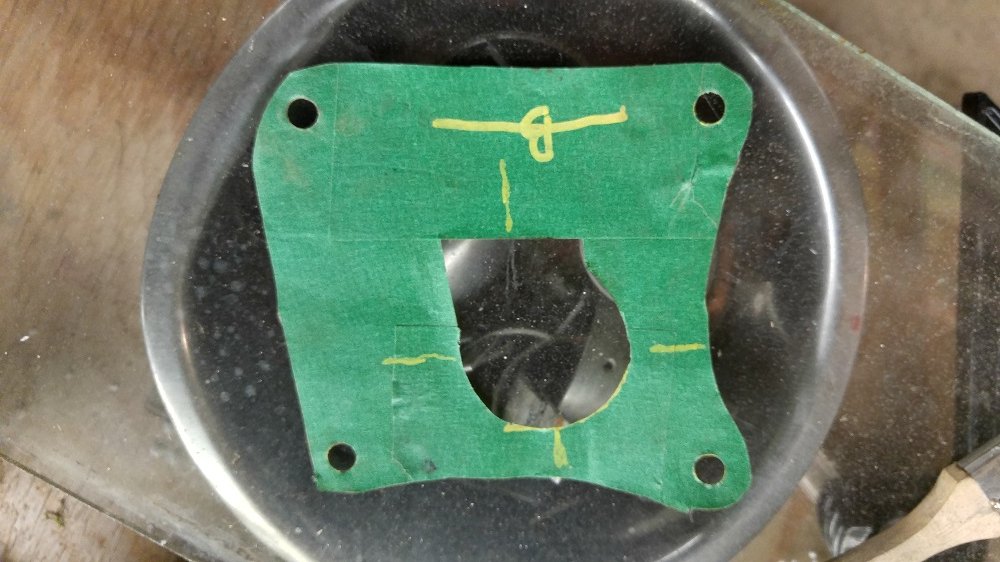

    I ended up figuring the most important thing was the pedal shaft location. All the holes had to be re-drilled anyway, so I made a masking tape template that marked the center of the shaft all the pedal arms ran through, in their relation ship to the original hole. After that, I transferred the info to the K member.
    I didn't know if I was on the right train of thought so I played with the position of the templates a bit, thinking I should try to pick up an existing hole or two, but in the end I think I did the right thing.

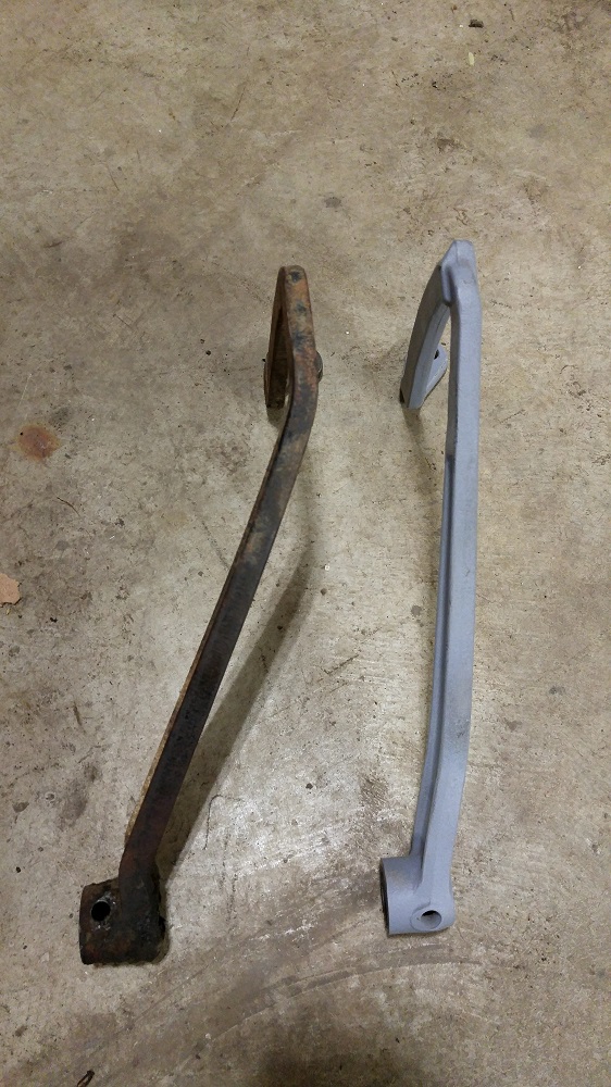

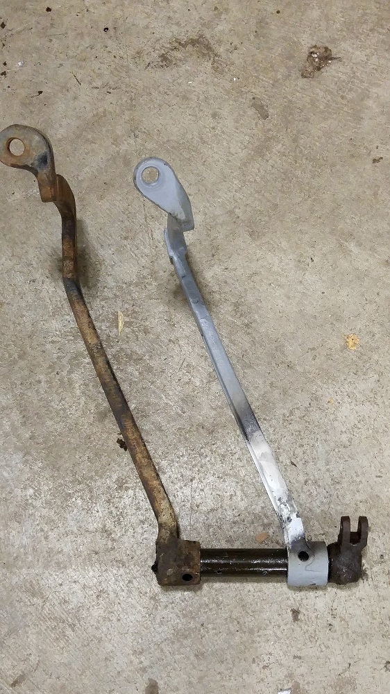

  24. I heated the clutch pedal arm and tweaked it to match the angle of the original. The brake actuation lever needed more room, so it went in and out a few times, to make sure there was enough clearance.

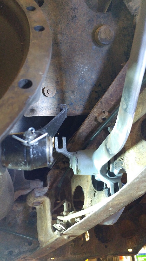

  25. I bought the reproduction 39 trans lever from Mr. Drake, replaced all the bushings and clearanced a little around the floor for pedal arms and I'm a little closer to the road.

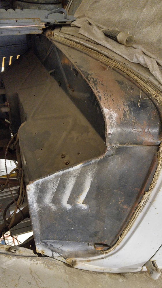

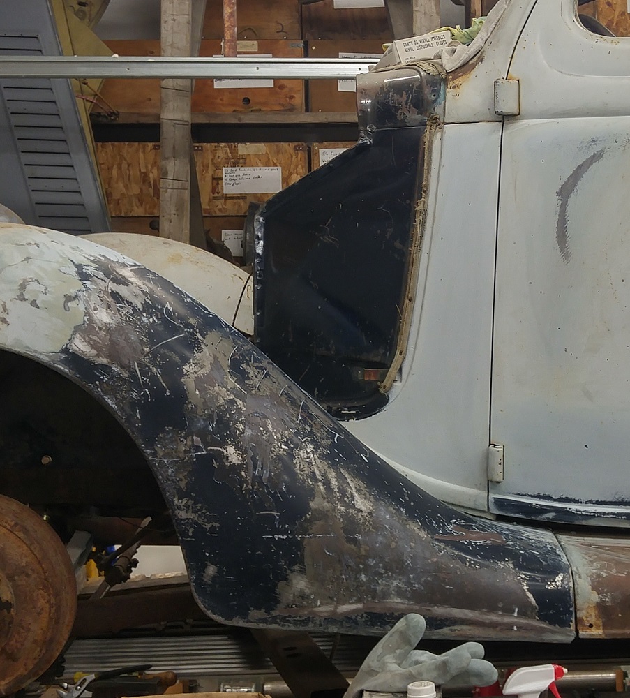

    Earlier in my thread here, I showed the 80 plus year old fire wall paint after I cleaned it up a bit. Since then I gave in to a little temptation to see what was under the grey primer applied years ago. I started with a little spot on the cowl next to the firewall and found original color underneath.
    I was hoping to reveal what I found after I had the car running and mobile, but other events have prevented that from happening, so far, so here it is anyway.
    One thing lead to another and after days and weeks of rubbing and scrubbing I have this.
