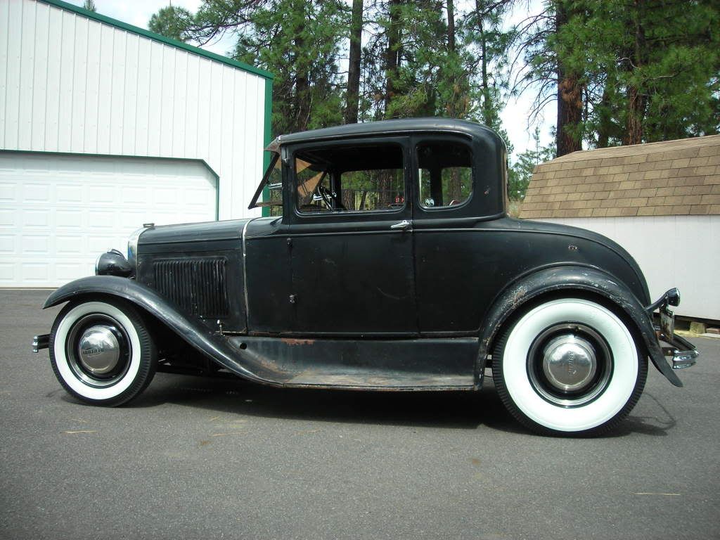

  4. That is the exact combo I'm running on my A. Don't worry, the rear ones will not look too small.
    Heres my old 41. Again, 7.50x16's in the back and 6.00x16's up front

  20. I vote 6.00's. The 5.50's are pretty small for such a big car. Here's my Dad's 36, has 6.00 Firestones all the way around. Photoshop this sucker down a bit
  21. More 6.00's
  22. Another vote for 6's on the front.... Personally I think the full fenders need the visual weight. My truck has 6x16 with a 3" WW on the front. 7.50x16 4.25" WW on the back.

    The 6.00's do look good. My only problem is that the Allstates that I have are like .5-1" bigger and since the car is coming down a bunch in front I don't want rubbing issues. The 6.00's do look good any examples of the 5.50-16's??

    That 5 window looks kick ass with a rake. I should paint my car so it's nice like that.
