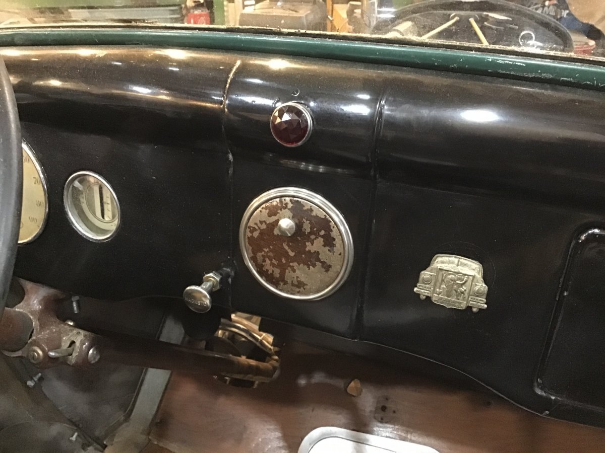

    So I have been do***enting this little project on Facebook but decided to do***ent it here so more of you guys could see it.

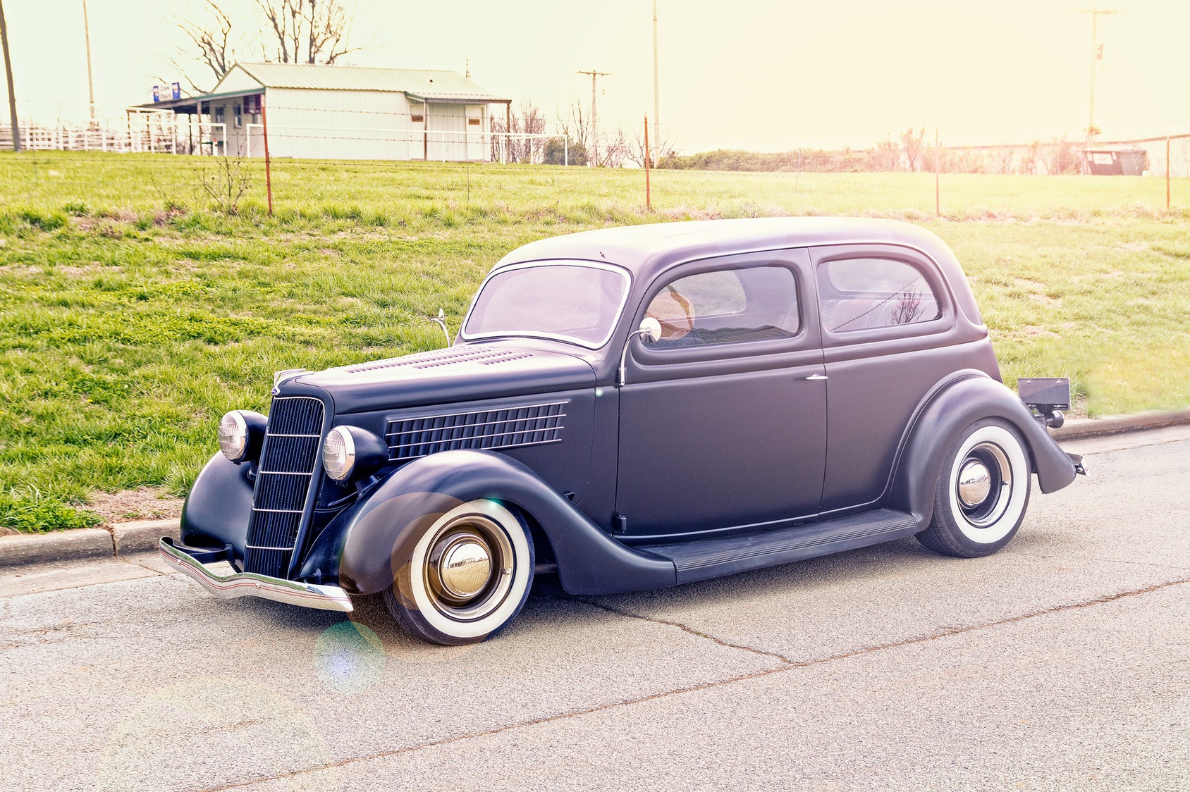

    I have been wanting to put a waterfall on the dash of my 1935 Ford Slantback Sedan (pictured below) but my dash has been filled dash can be seen in 2nd picture.
    I really didn't want to cut a hole in my dash and the cost of buying and restoring a real waterfall was more than I was really willing to spend so I kind of let the idea go to the wayside. Fast-forward a few months and I have been playing around with 3d modeling software (Fusion360). I decided to try and model a waterfall (first attempt pictured below). Needless to say it kind of worked just going off of a picture from the internet.
    After this a friend of mine on Facebook reached out to me and told me he had a 3d printer and we could try to print it. I sent him this model and he printed it at half size in low resolution. That print took 40 minutes to do. You can see that print below.
    I told him I would have to find a real waterfall to get accurate measurements off of. Another friend then told me he had a real '35 Ford waterfall I could borrow and take measurements off of. In the mean time I was trying to figure out what to do with the blank space on the waterfall since I didn't have an ashtray. Then it hit me since I was making a fake waterfall I could just make my waterfall look like it had an ashtray. Here is the final render of the model.
    I just sent my buddy the file to print today. After I get the print back I will test fit it to the car. If it fits on the first try (fingers crossed) I will start the finishing process. I am researching several options right now. From chroming plastic to that spray paint chrome. We will see what looks the best and is most cost effective.
    Now I have had a few guys ask if I would offer these up for sale after I'm done. The answer to that is 50/50. We will have to see how it turns out. I'm not about to turn out a subpar part. If I don't think its a quality piece then I won't sell them at all.
    Until then its just been a fun project. I will update more as I go.

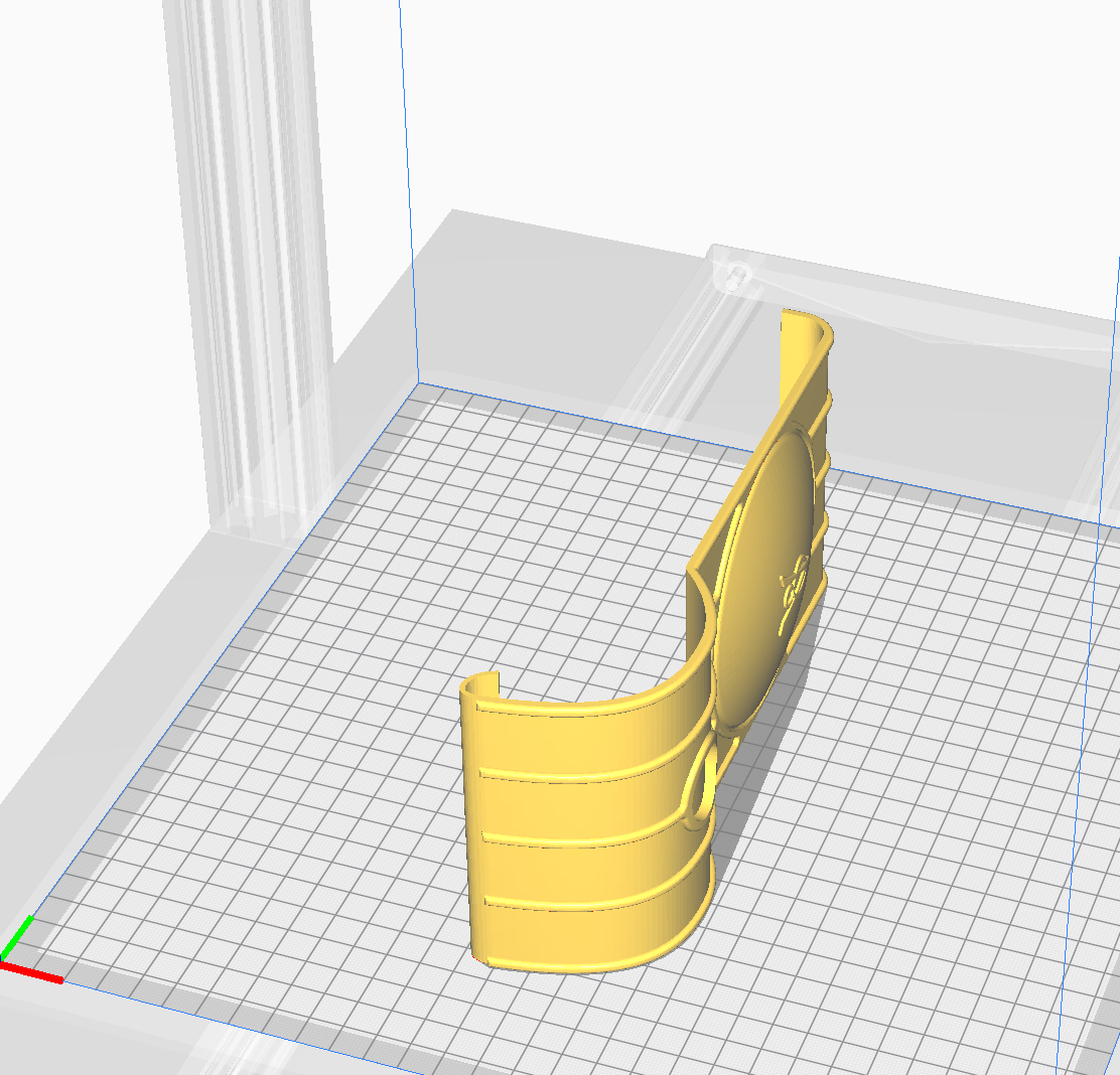

    UPDATE:
    Yesterday the gentleman that is letting me use his 3D printer started to print this. Below are some photos of the start of the process and the finished piece.
    This is my 3d model placed into his printing software so we could tell the 3d printer how we wanted it to print this piece.
    Image of the printer information screen showing the temps that everything is at and the process. In total this took 18 hours to print.

    Looks great from here. I was amazed when I read it took 18 hours to print!:eek:...Is that pretty typical?

    I think higher dollar printers would do it in less time. We had it laying a different way originally to be printed and laying that way would have taken 44 hours was the estimate given.
