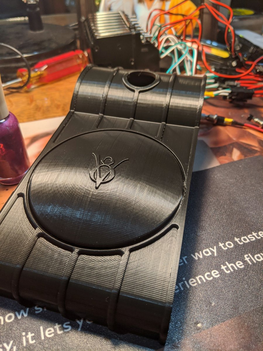

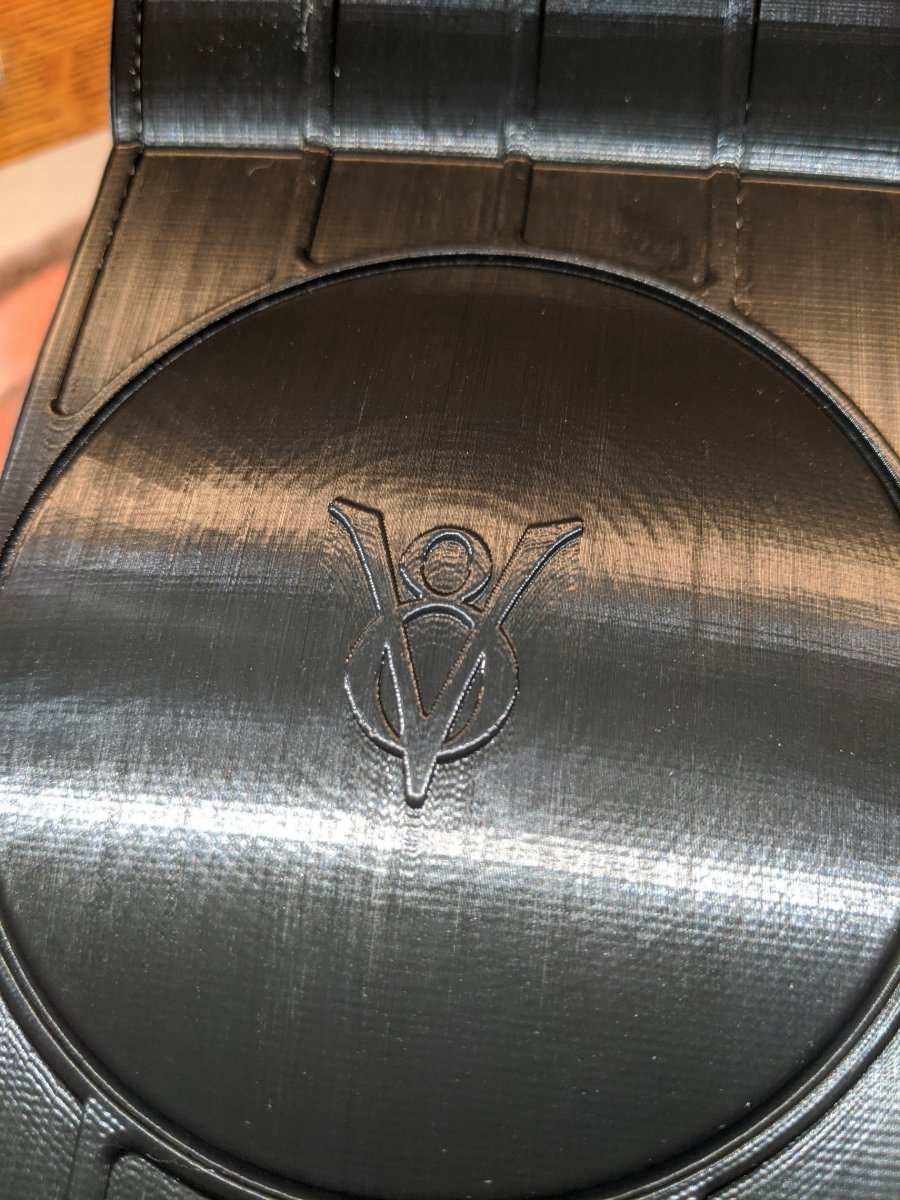

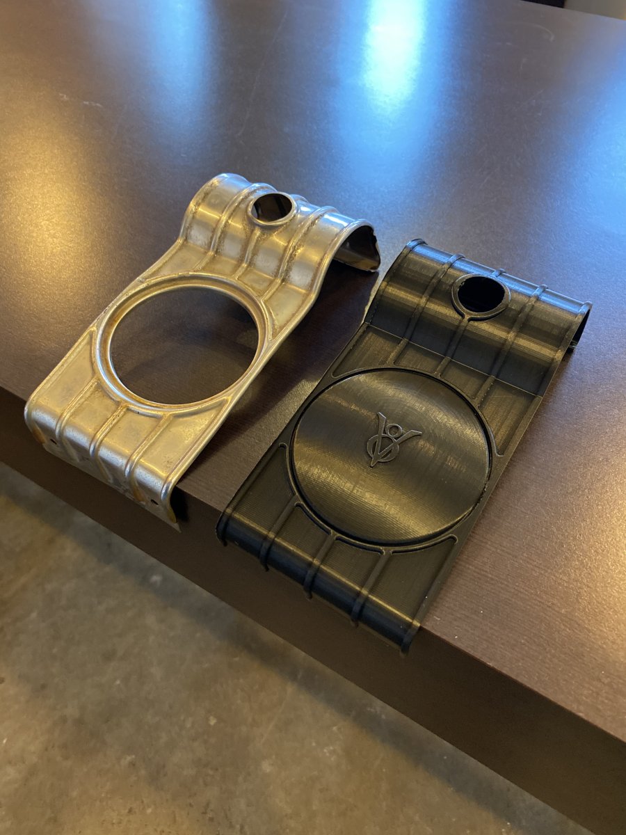

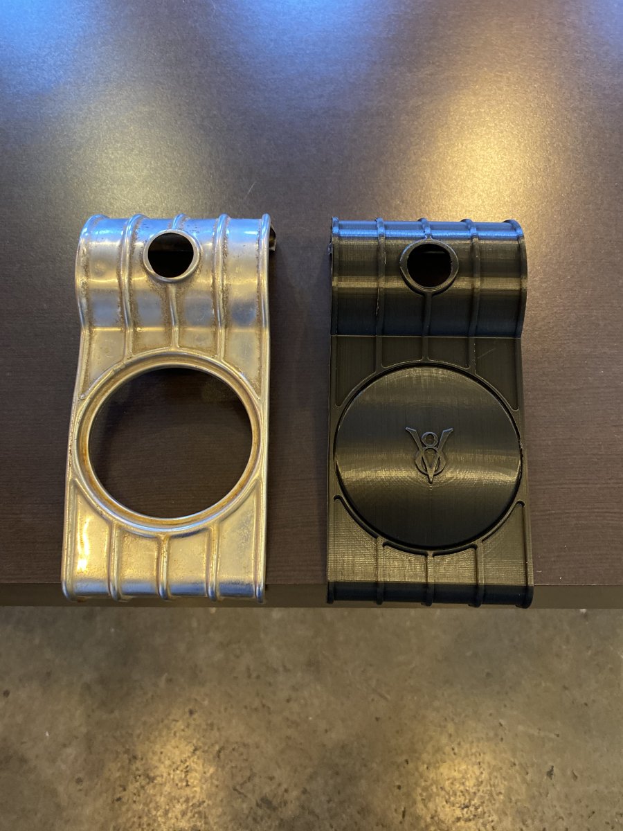

    Update to this project. I received the actual printed part today from my printer. Here it is compared to the waterfall that was loaned to me.
    Also some of you might notice that the bottom edge that rolls under the dash is a bit shorter on the 3d vs the stock waterfall. That is on purpose and not a mistake. My dash has an extension underneath it so the stock one wouldn't work on my car without some cutting.

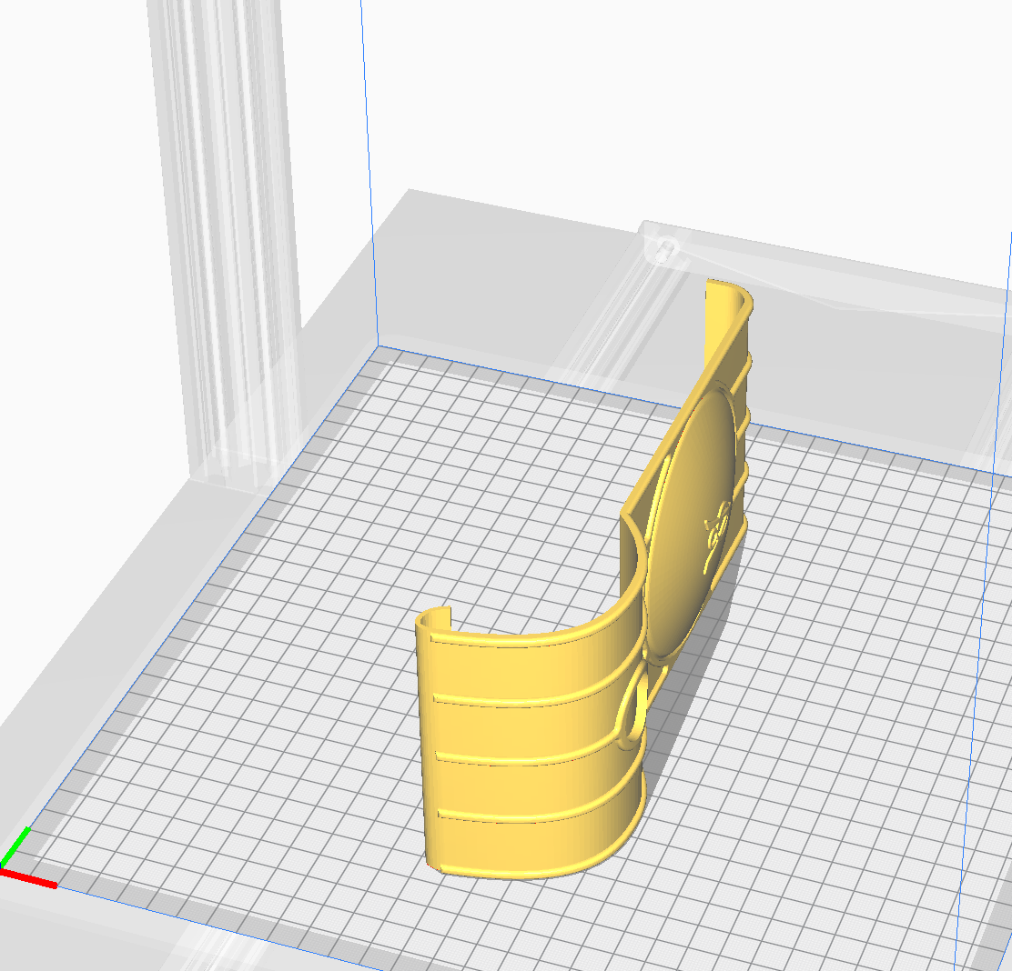

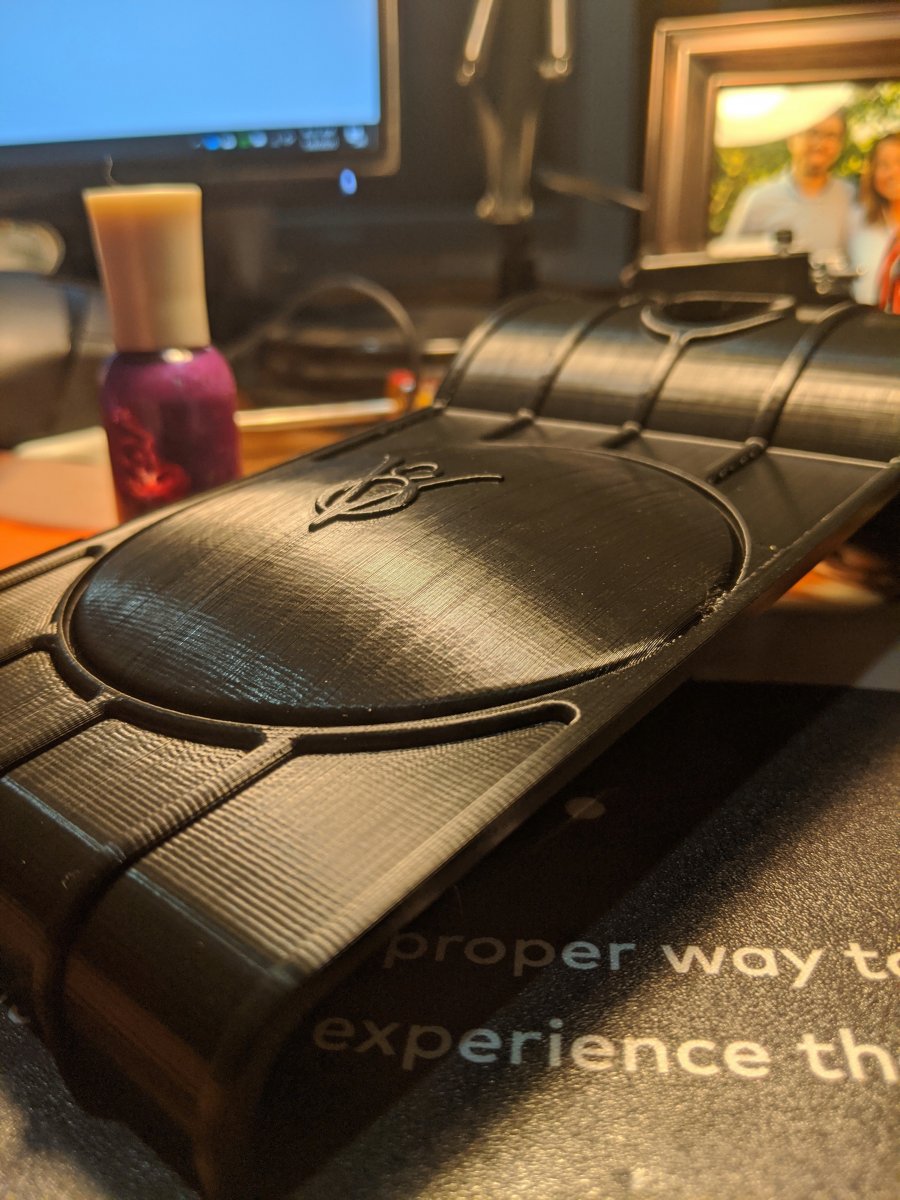

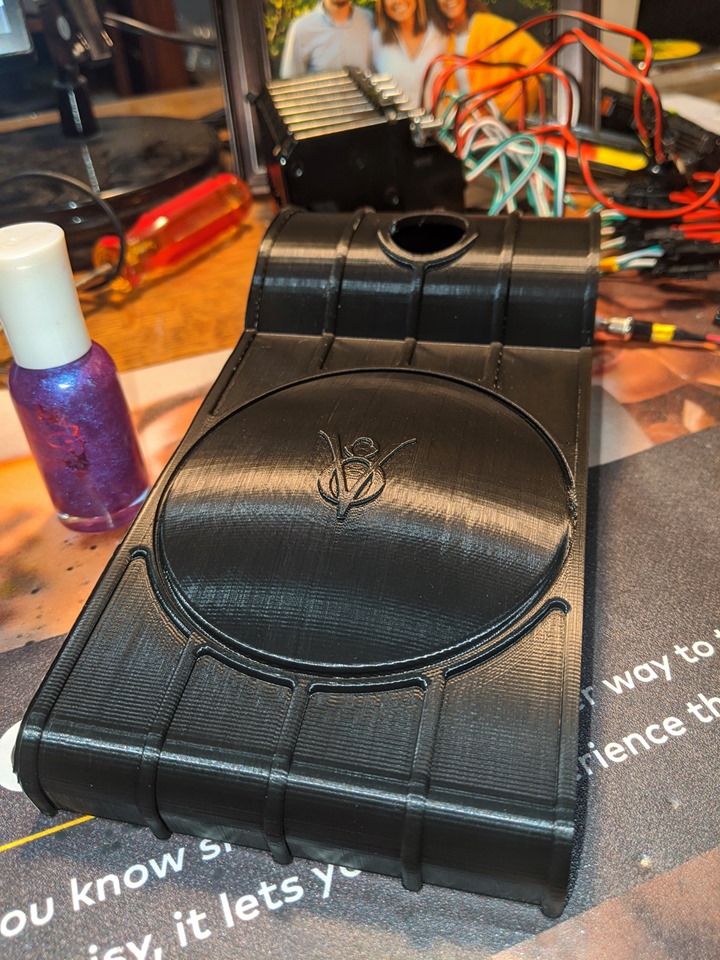

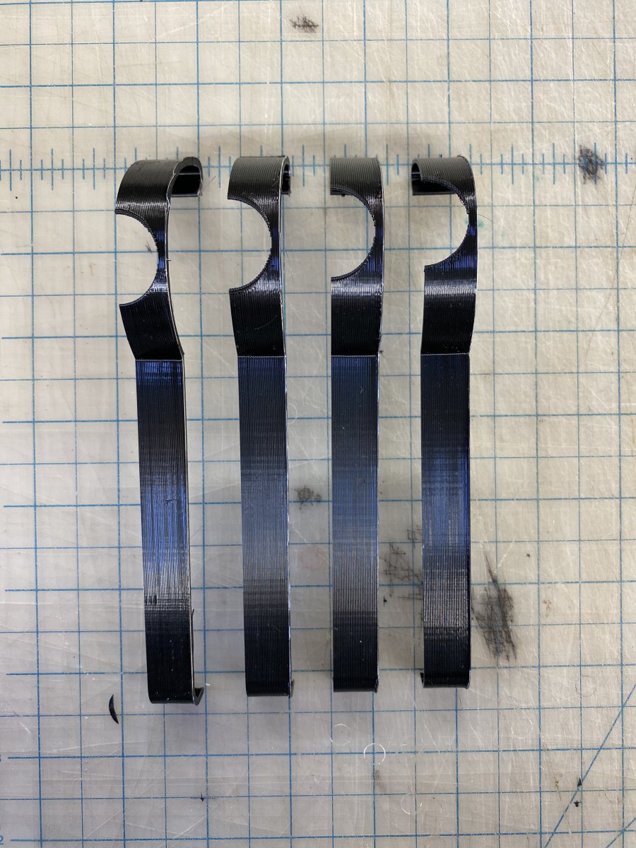

    This update to my 3d printed waterfall is a bit hard to write but I just keep telling myself if it was easy someone would have done this already.
    Friday after work I went home and test the 3d printed waterfall to my dash. From day 1 I have been concern about the accuracy of my measurements. The stock waterfall that I borrowed seemed to be a bit loose on my dash so I did alter my model a little bit. Well, I tweaked it too much. The top rolled part seemed to fit the dash quite nicely but the windshield crank hole was too low for my liking. And the bottom of the waterfall did not wrap underneath the dash like I thought it should. You could force the waterfall on but I wasn't happy with it. Who knows some guys might just call me a perfectionist or too picky. But I wasn't happy with it. I will say just the 3d printed waterfall looked super cool in there.
    So I went back to the drawing board and tweaked my design. This time I made little test strips to fit the dash. I have now made four in total. You should be able to see in the first image that I moved the crank hole between each version by about 1/8th of an inch each time. I lengthened the bottom piece by about 1/16th of an inch each time. Going to test fit tonight. From there I will rebuild the 3d model based upon which crank hole was centered the best and which bottom portion was lengthened the best. Then another 3d print and we will see how that one fits.

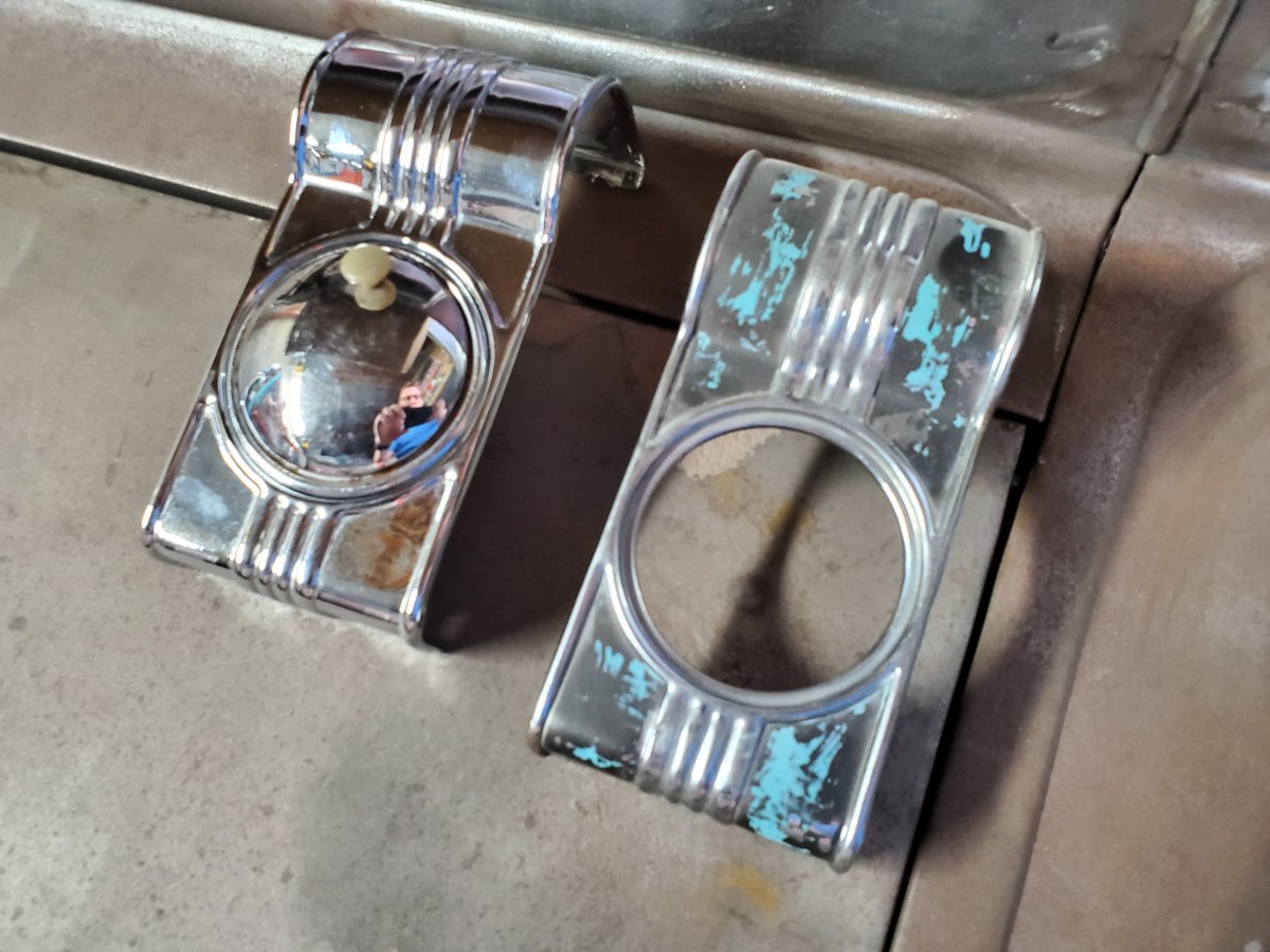

    Cool! Really neat work. You have to have your guy make a roadster/cabriolet version without the crank hole. I think hot rodders who swap in dashes would like that option. They get some crazy money for them so a small run might be worth the time.
    These are 36s but 35s, in your pattern also came without a crank hole.

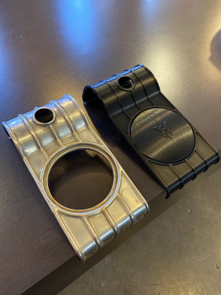

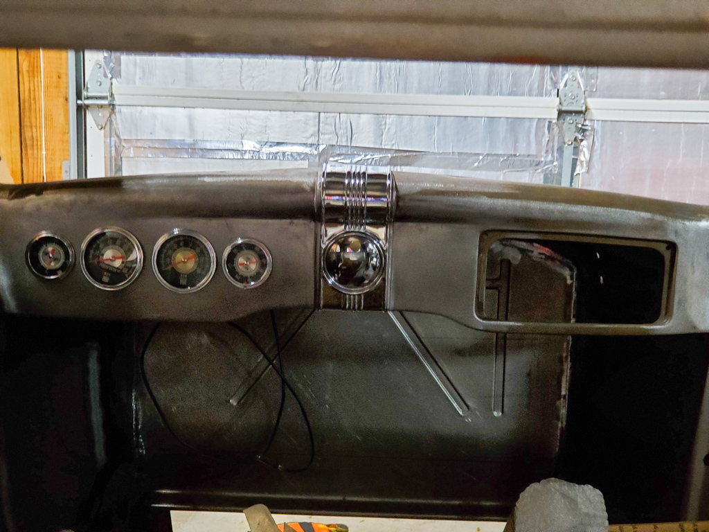

    gbrown
    Just a quick update. Tonight I went out to my buddies shop and took my test strips with me to try on one of his dashes. Seems like v1 is still the best fit to the dash and v3’s crank hole placement is best. Going to combine these and print a new waterfall. If that new waterfall fits like I hope it does I will move into the finishing phase of this project.

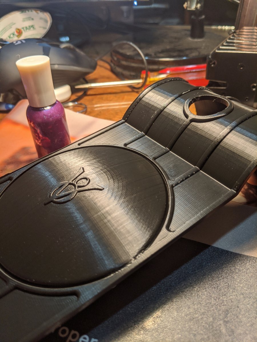

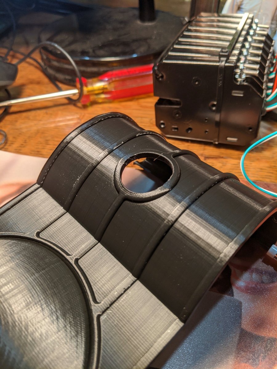

    New update to my 3D printed 1935 Ford Waterfall. This is a good one!

    So that version is closer to a 1936 waterfall with the ashtray hole filled. It was my original plan to go that direction but then I decided I wanted to see how closely I could replicate a waterfall with a fake ashtray.
