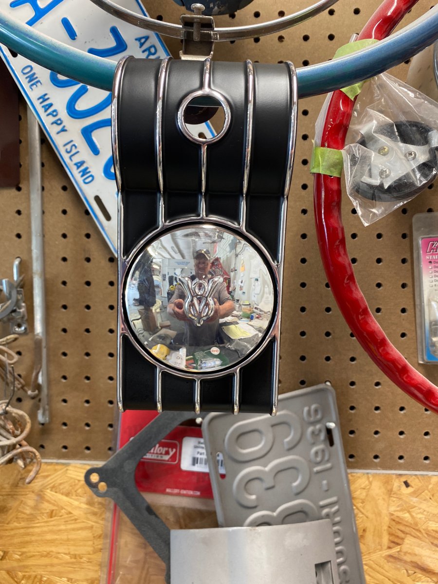

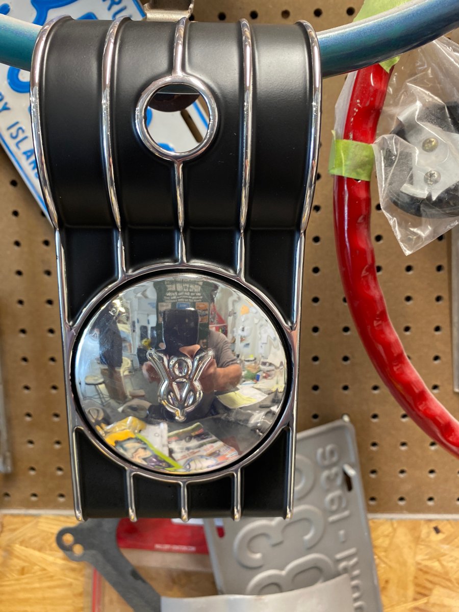

    I'm back! And my waterfall is FINISHED! Right as all of this CoVid stuff started happening I received my waterfall back from the chrome plater and then we got put on lockdown. Well last month when things finally started opening back up I was able to get this out to my buddy Mike Meeker and have him help me finish up the small details on this and get it final installed in the car.
    Attached to this post are some of the pictures that Mike sent me after he got the details painted and I finally have gotten around to making a final video talking about the finished project and my thoughts on selling these to the public. Thanks for watching!

  5. What process exactly was used to apply the 'chrome' finish? It's not actual chrome, I can tell from the 'color' that it's either paint or vacuum metalizing, neither of which is very durable in my experience. Both types give more of a polished aluminum look rather than the 'hard' color of real chrome. This is pretty obvious in the pic of it installed on your dash.
    It is possible to actually chrome plate plastic (the OEMs have been doing it since the mid '60s on selected parts, and it's become more common since) to get the durability of real plating but it can be prohibitively expensive in small lots.
    Not trying to take away from what you've done, but you should make possible buyers aware that it's not really chrome.

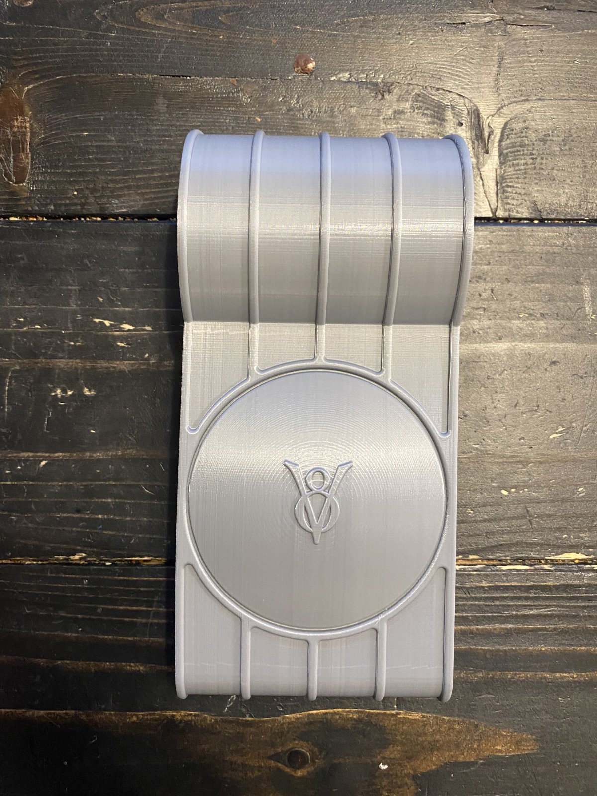

    Hey guys! It’s been awhile and I thought I’d give an update to this thread. I have started selling a few of these 3D printed waterfalls. The one I am sharing today is the first 1935 Ford Waterfall with my fake ashtray and NO crank out windshield hole for a closed car. This is going to a gentleman that was an early supporter of mine/ this project. The last several I have printed have been on Bret Chrismer’s printer and the quality is so much better than the one I originally did for myself. It’s going to be super easy finish these out. If you are interested is a 3D printed waterfall get with me and we can talk pricing. Also a local hot Rodder is going to start offering the same spray on chrome process that I used so I plan on offering a finished version just like mine before too long. Thanks

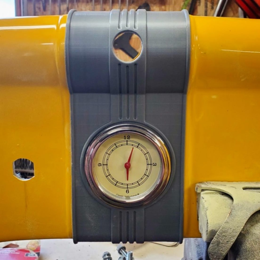

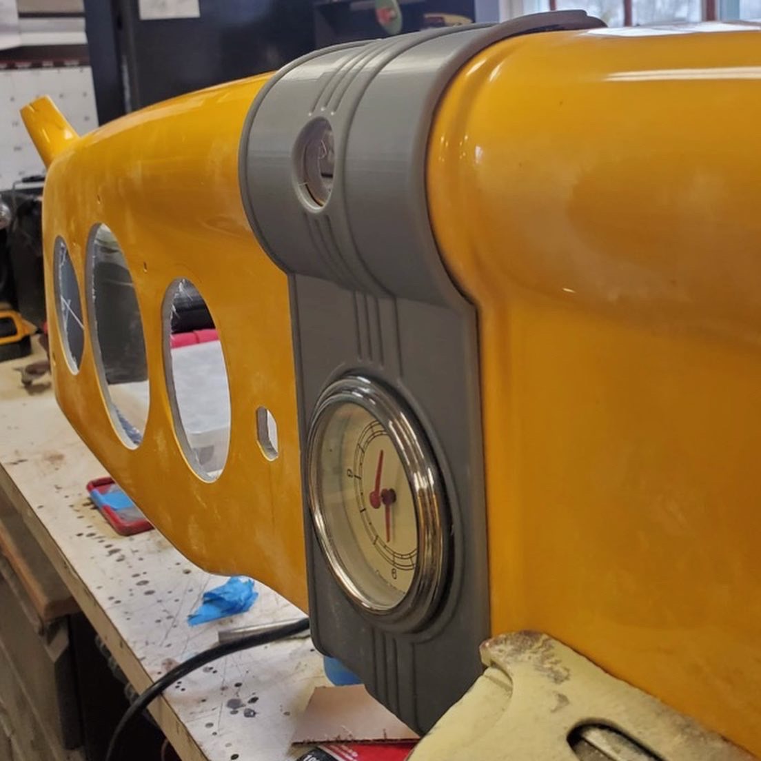

    Love getting photos from other Hot Rodder’s that are using my 3D printed waterfalls. This one is going in Joe Brognano’s 1936 Ford Three Window Coupe out of New York. We modified the original opening to be a bit smaller so the reveal would better fit around his clock. Small detail but I think it makes a world of difference. What do you guys think?

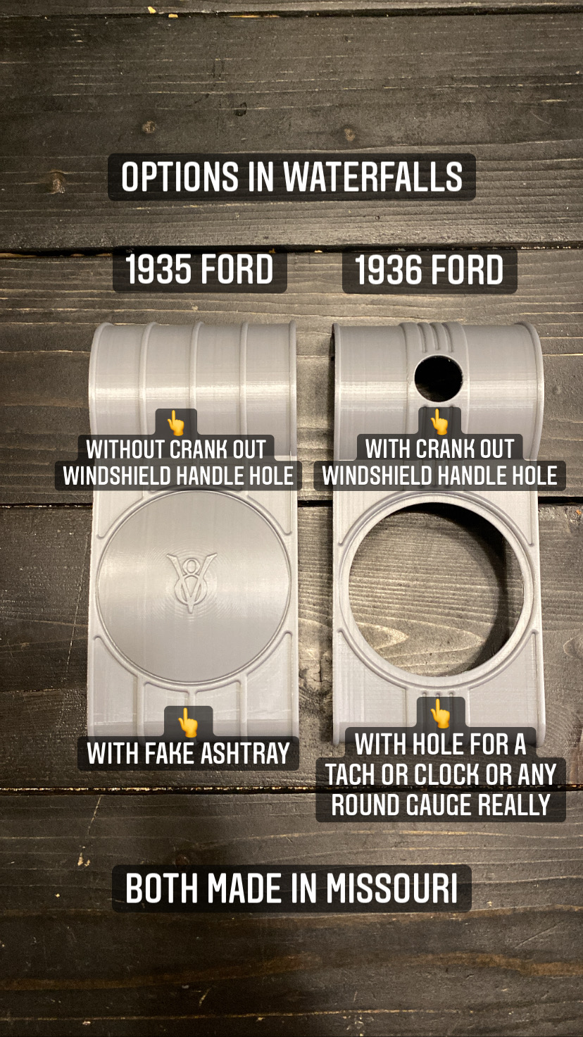

    $90 unfinished (like the one I just showed).
    Options are:
    ‘35 or ‘36
    With or without crank out windshield hole
    With fake ashtray or with a hole for a gauge
    Have an idea for something custom get with me and we can figure try to figure out how to make your idea a reality!

    For anyone interested in what options are available on these waterfalls.
    Also I’m always up for a design challenge on one.
