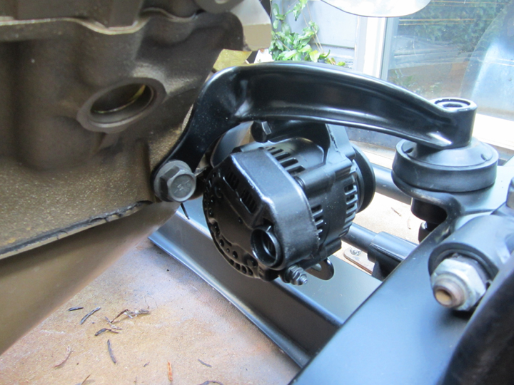

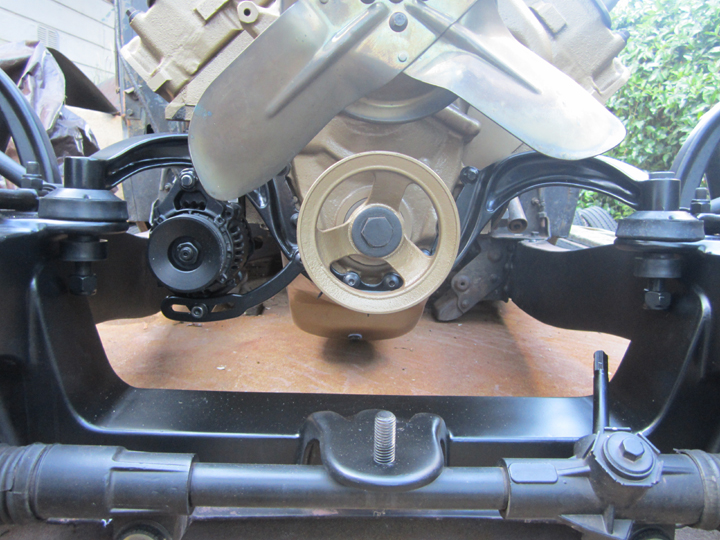

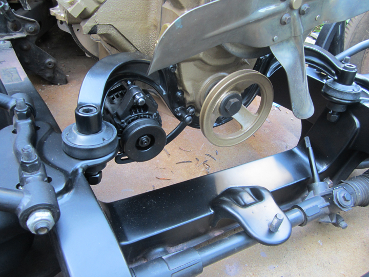

    motor mount time-
    Man these olds motors don't give you much to work with in the way of bolt holes in the block. I made a "hurst style" . . . but hurst never made them like this. . . mount for the front and I still need something near the bellhousing on each side and the trans tailshaft. The sidemounts on chevy's look really good to me now.
    Anyway- I made a flat plate and aligned it with 8 timing cover bolts, then followed an arc up and over to make a pocket for a black mini alternator. I also curved it forward to meet 1/2" plates for the biscuits that extend from my a-arm mounts. . . then I made curved flanges top and bottom to make it all like an I beam nice and strong- cut metal shaped, beat into a curve, weld, grind, weld, grind, paint and 2 weeks later here it is.

    You, my friend, are an artist.

    Your motor mounts are just exquisite. I am impressed that you incorporated function into your brackets to make room for the low mount alternator in your design. Also by shifting the mounts forward to the control arm makes for a nice concentration of details for the eye. As your frame develops I can see it becoming a virtual "setting" for the Jewel, that 324 Olds motor. Your rear upper control arms show your concern for form and function as well. I think you are as much a sculptor as an architect. Maybe the Antonio Gaudi of frame fabricators! Best Regards and good luck with all your endeavors. KB aka telekenfun.

    Of course I will run a hood so nobody will ever see the motor . . . but it sure looks good in there. Olds in an Olds.

    Putting the motor in there really makes me realize this is a whole new thing for me. I have built and driven a lot of 60's cars, a few 50's but never even ridden in a hot rod or 30's car with a V-8 in it. All of the sudden I am looking at this thing and realizing it isn't just a sculpture that sits in my driveway but that it will drive and will likely actually be fairly "fast" with that big motor!

    I just found this thread and I've got to say that the work you've done is as good as any work I've ever seen. Please share some details about those front motor mounts. Are they cnc carved billet? I know that's a delicate subject in some circles but you've designed and executed those mounts to the degree of fine art. Thank you for showing your work. Many years ago I walked away from a '36 Olds that I could have bought for $60. It was around 1965. I've regretted it ever since.
