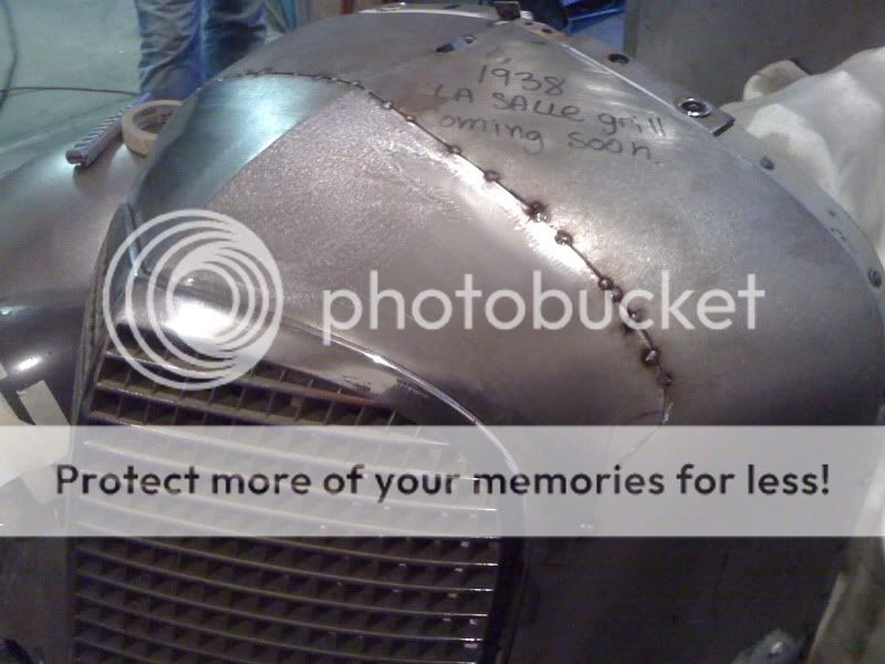

    Looking great man, but that is a Cadillac grill, not LaSalle.
    The LaSalle grill is similar but narrower than the Caddy grill.
  2. SKOTY CHOPS KUSTOMS
    Joined: Jan 9, 2007
    Posts: 797
    SKOTY CHOPS KUSTOMS
    from BAY AREA
    Yeah i was originaly gonna run a 38 la salle grill but i didnt like the way it was shaped. I purchased this 37 cad grill and it flows way better. The writing on my grill housing is really old, i just never took it off.
  3. cleatus
    Joined: Mar 1, 2002
    Posts: 2,277
    cleatus
    from Sacramento
    Gotcha.
    I have the same grill in mine and people are always referring to it as a LaSalle grill, so I guess I'm over-sensitized :)
