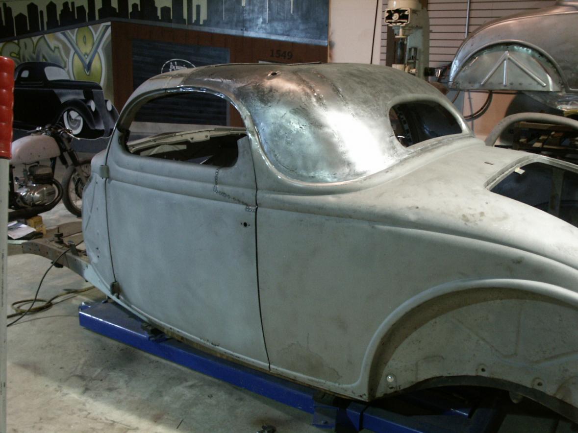

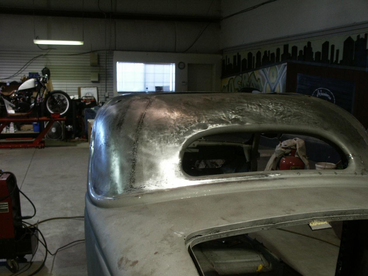

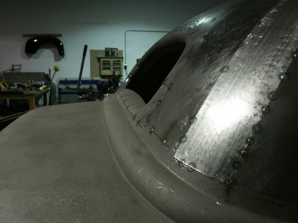

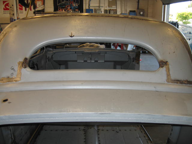

    I wanted to get this up so you guys could see the rear window tacked in place. Now you can see what I am saying when I said that I love how it looks when the rear of the window just flow's into that rear bead.
    Plus measuring it I only took 2 1/4" out of the rear window insted of the full 3"

  6. brigrat
    Joined: Nov 9, 2007
    Posts: 6,069
    brigrat
    from Wa.St.
    Doing your rear window like that does it effect the roll up mechanism , some, none, dunno? Thanks, Lon

    58Lincoln
    Your work is really good and you are FAST, very impressive!
    Brigrat, here is a shot of my rear window.
    My car was chopped 2 1/2" instead of 3".
    I did NOT change the bottom section of the rear window.
    I do not believe that changing the bottom section of the rear window will effect the performance of the roll down window mechanism.
    I did not notice any stress cracks near the top of the quarters in my car.
    Good Luck with ALL the projects!
  11. Salt Flats Speed Shop
    Joined: Sep 30, 2007
    Posts: 1,474
    from Utah
    The owner didn't want the rear window to roll down so I removed that section. Plus it was realy rotted out anyway. The one thing you would have to change would be relocating the brace that holds the trunk hinges. That piece is attatched to the part under the window as well as in front of the rain gutter.

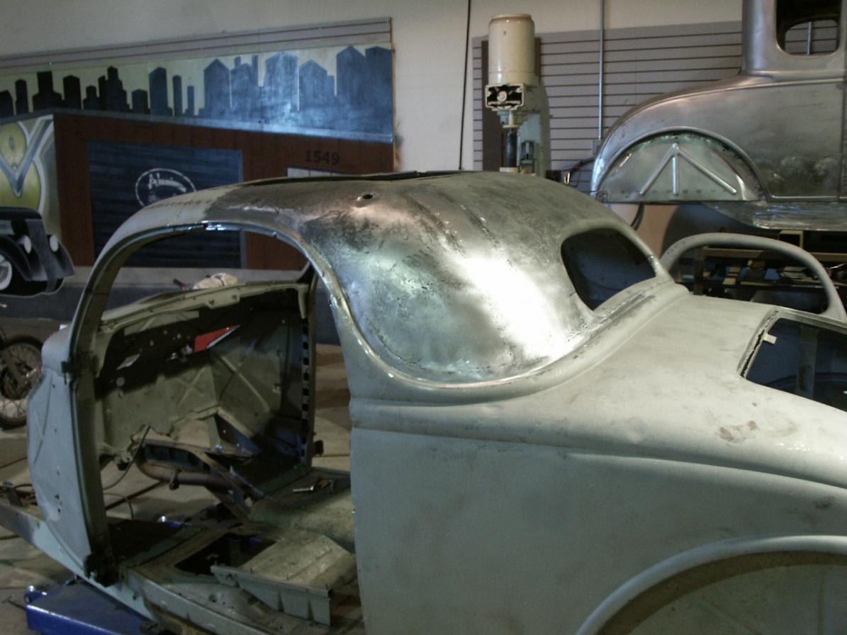

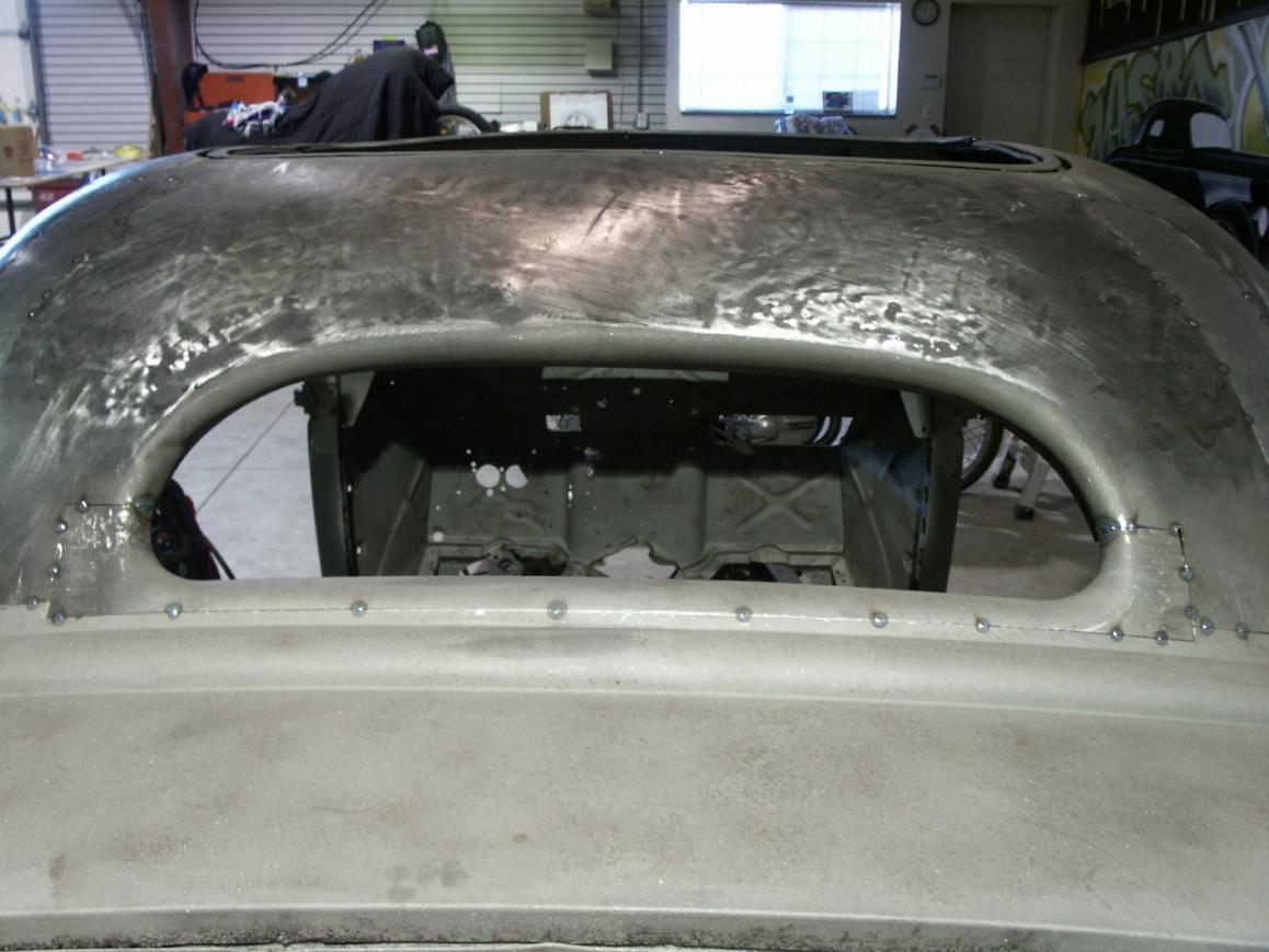

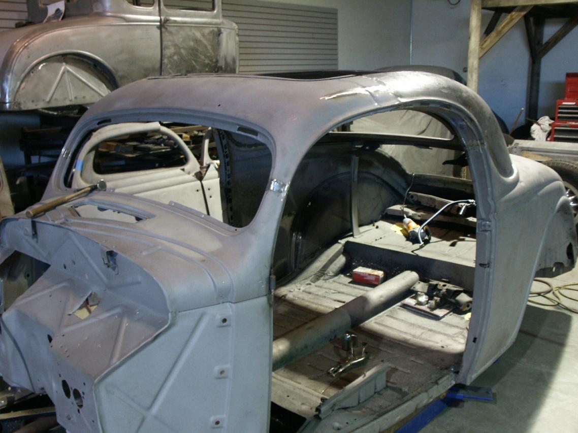

    I worked today on geting the rest of the welding done on the top.
    I also started chopping the doors, and geting the 3 window door tops spliced onto the sedan doors.

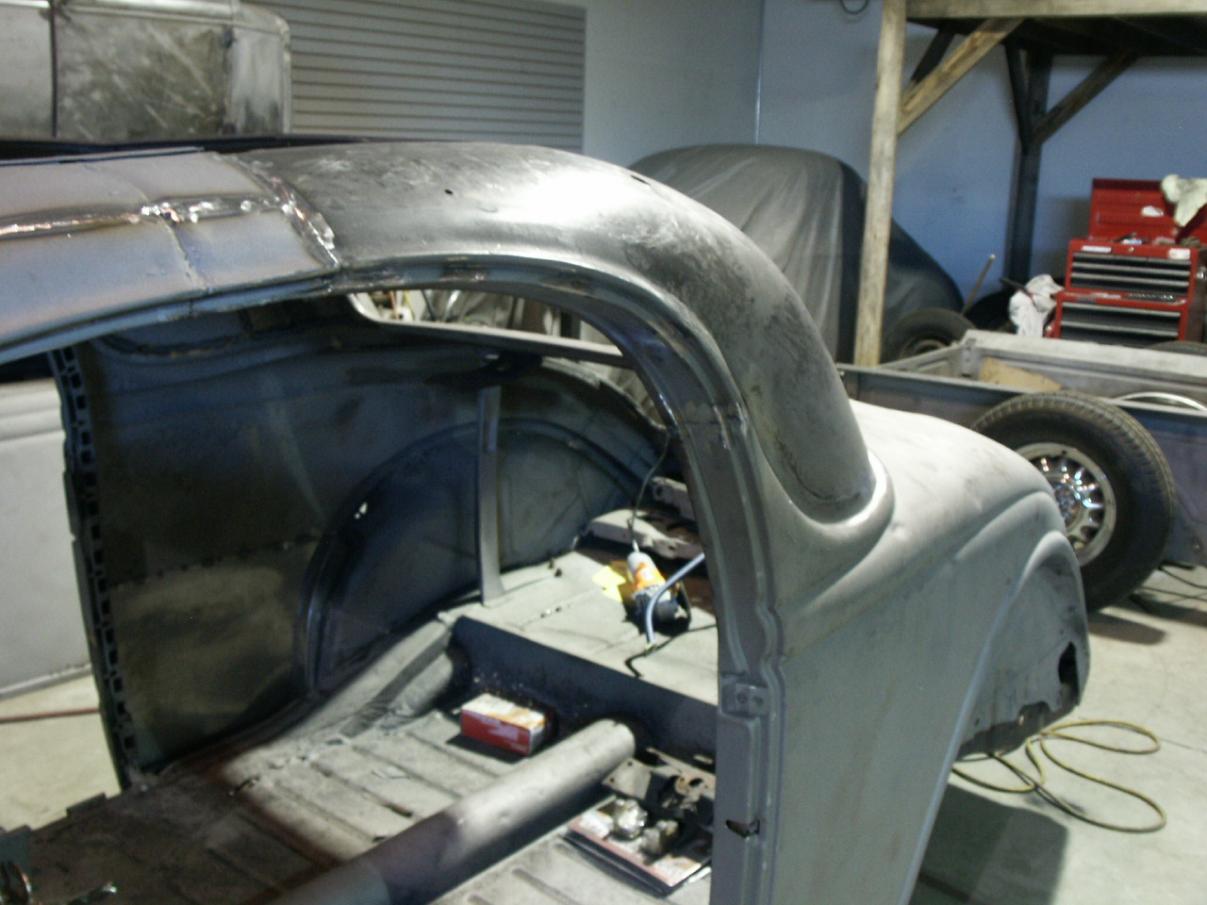

    Today I got the drivers door finished and the p*** door top tacked in place ready to finish weld.

    Really nice work, are the sedan doors the same length as 3Window doors?
  25. Salt Flats Speed Shop
    Posts: 1,474
    from Utah
    Ya tudor sedan doors are the same length as 3 window doors. Also 4 door's have the same length doors as a 5 window.
  26. Can you show more shots of the doors and how you chopped them.
  27. Salt Flats Speed Shop
    Posts: 1,474
    from Utah
    I should have taken more shots durring the process, but if you look close at this picture, you can see the different sections that I spliced together.
    First of what I did is I cut off the back of the 3 window door from below the second beadroll up to the top. (I did this because the 3 window door starts to curve right at the second bead roll).
    Then I got that fitting with the door shut the way I wanted it. I had to take a slice and close the gap on this piece because the door gap was too tight.
    Next I got the other section of the rear 3 window door top cut to fit and just tacket it in one spot with the door gap the way I wanted. (That way I could move it around to line up with the front door top).
    Then insted of using the rest of the door top from the 3 window door I used the front door top section off of the sedan door. I did that because I could get that fitting the rest of the way without having to add a piece like you usually do when you only have one door to chop.
    Then once all that fit it just takes some time making sure all the outside and the inside seams line up.
      105.3 KB
      480
