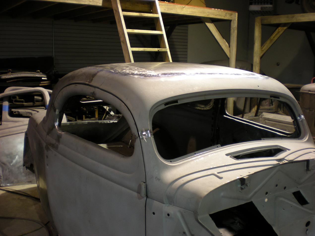

    I got the roof rough cut to start on the roof insert.
      71.9 KB

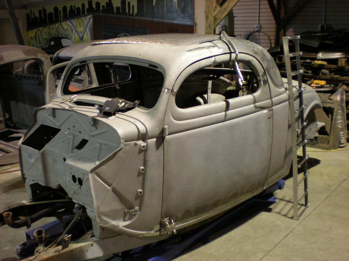

    I've finished up working on patching the bottom of the drivers door.
      108.3 KB

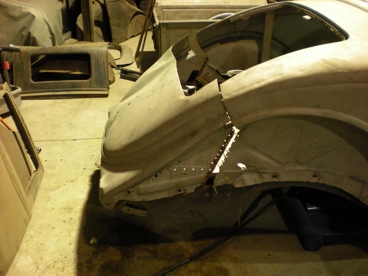

    I got the quarter panel patch finish welded in.
      106.5 KB
      383

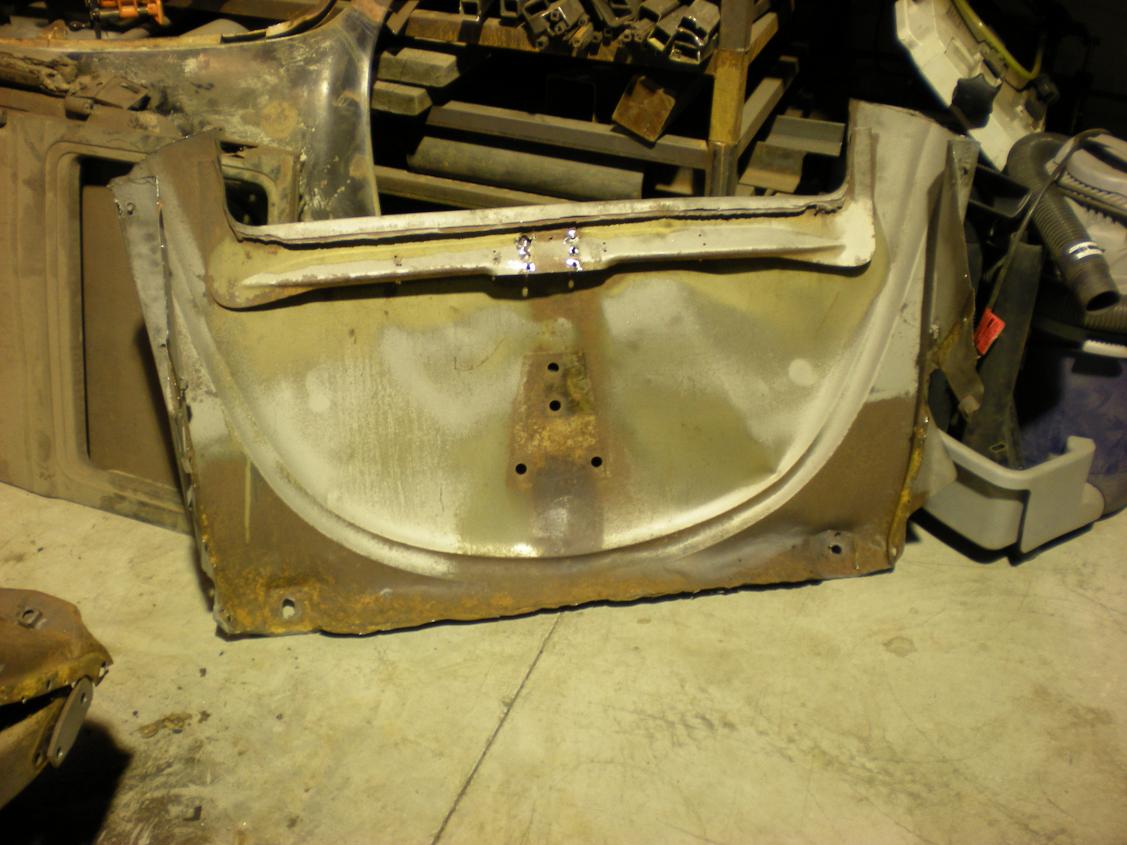

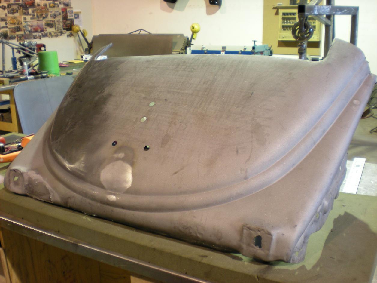

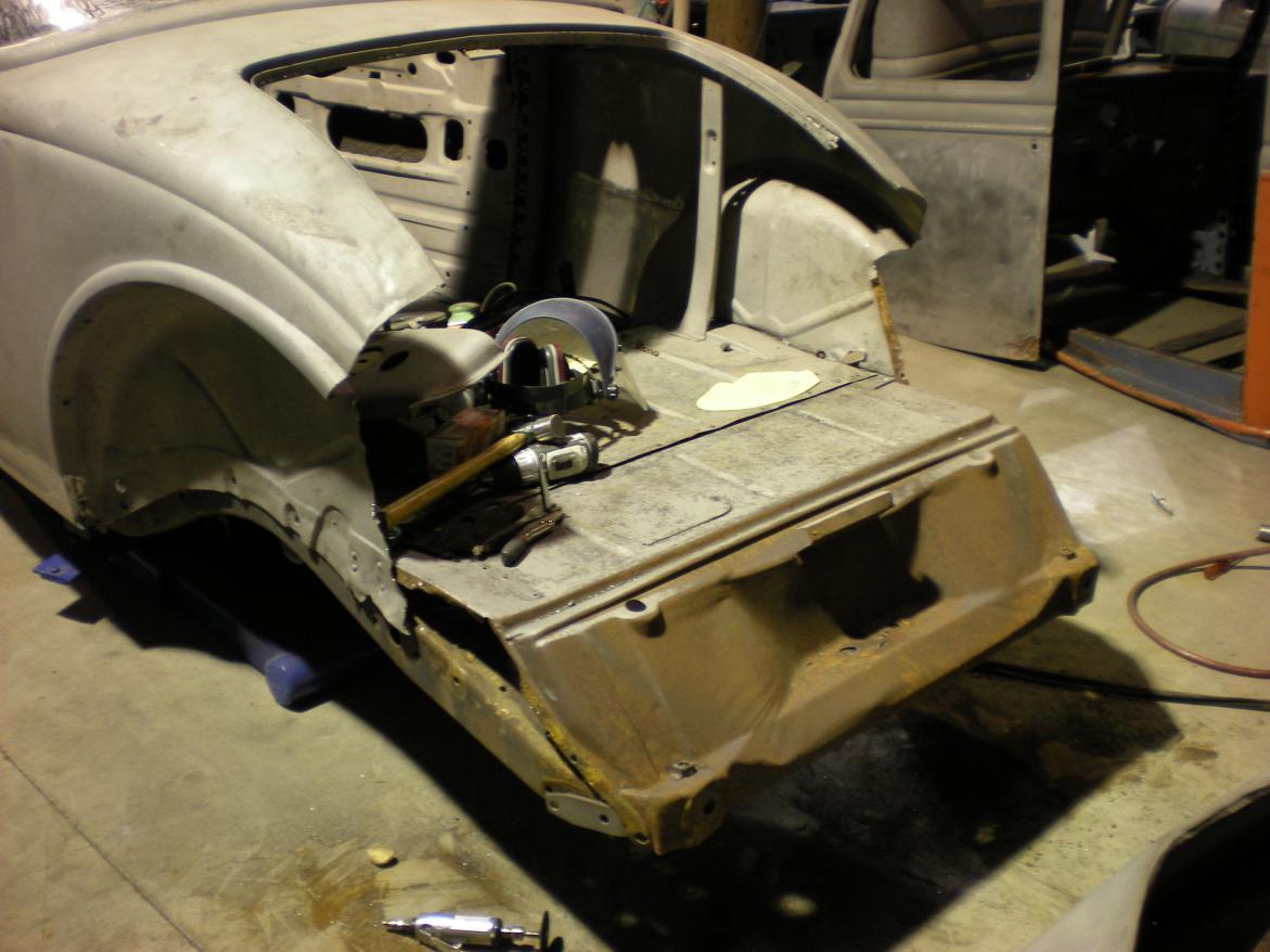

    This next part of the car should be interesting to do :) With all the dents and rust on the section under the trunk. I decided to drill the spotwelds and remove it completly from the car. With it removed I will get the inside and the floor sandblasted and fix all the rust and dents. Then re-attach it back to the car.
      105.4 KB
      510

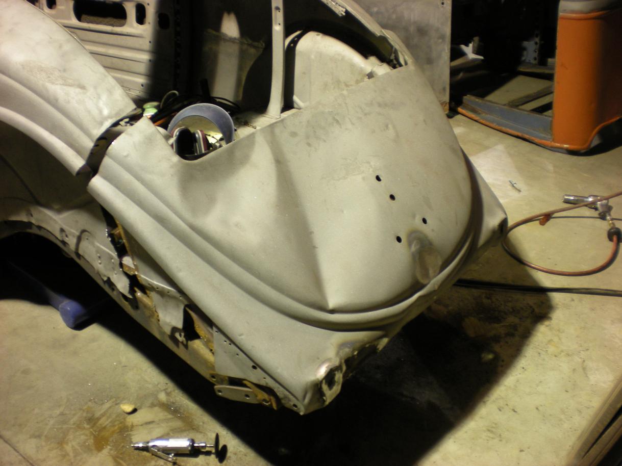

    I got the tail section re-sand blasted where they couldnt get before. I also got the major dents out, and i'm working the panel smooth.
      106.8 KB
      446

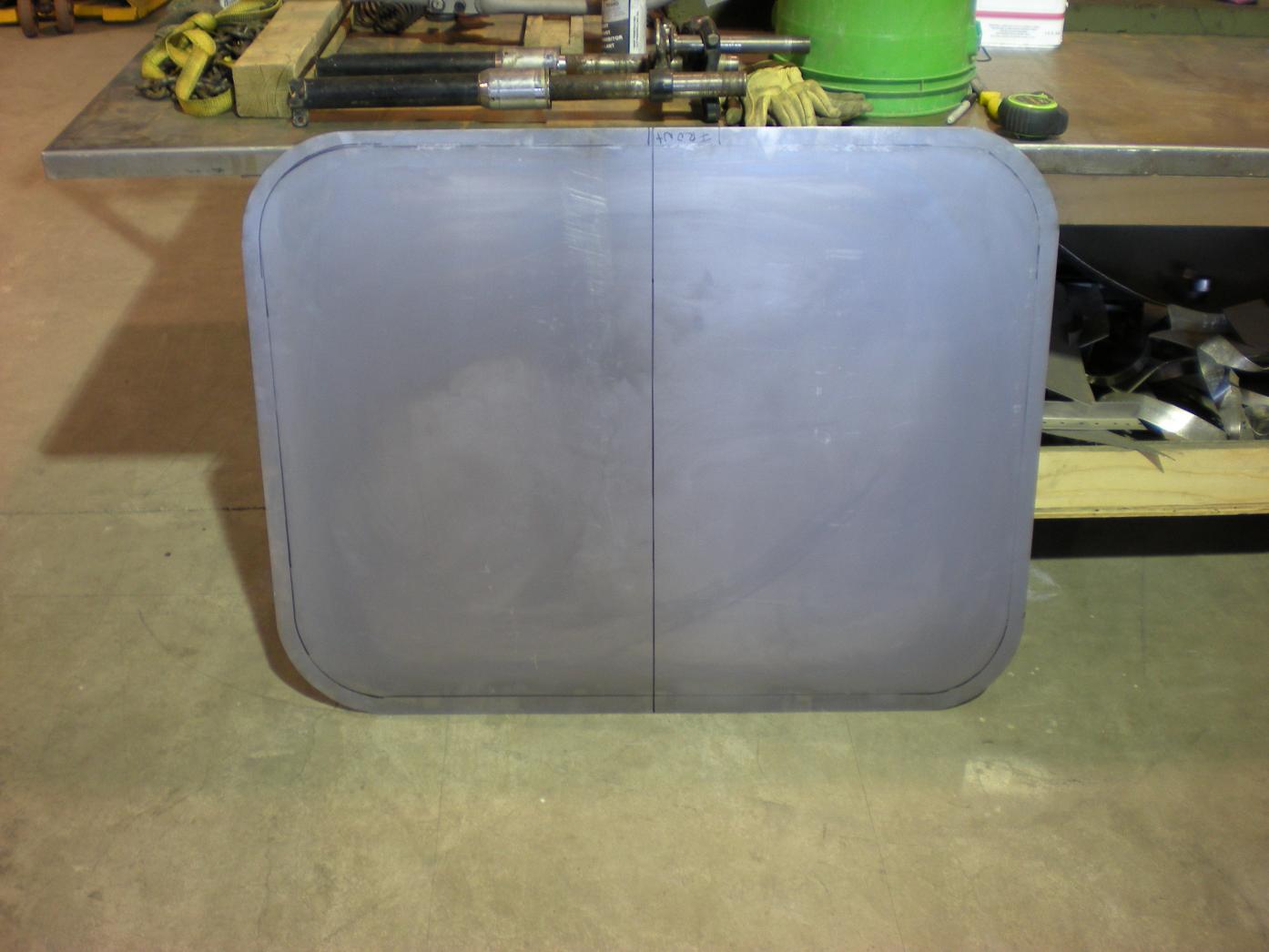

    I got the roof insert rolled out today. It flows realy nice and will definatly give the car a more smooth look.
      105.5 KB
      436

    Looks good! It also looks like that tail section will be a treat!

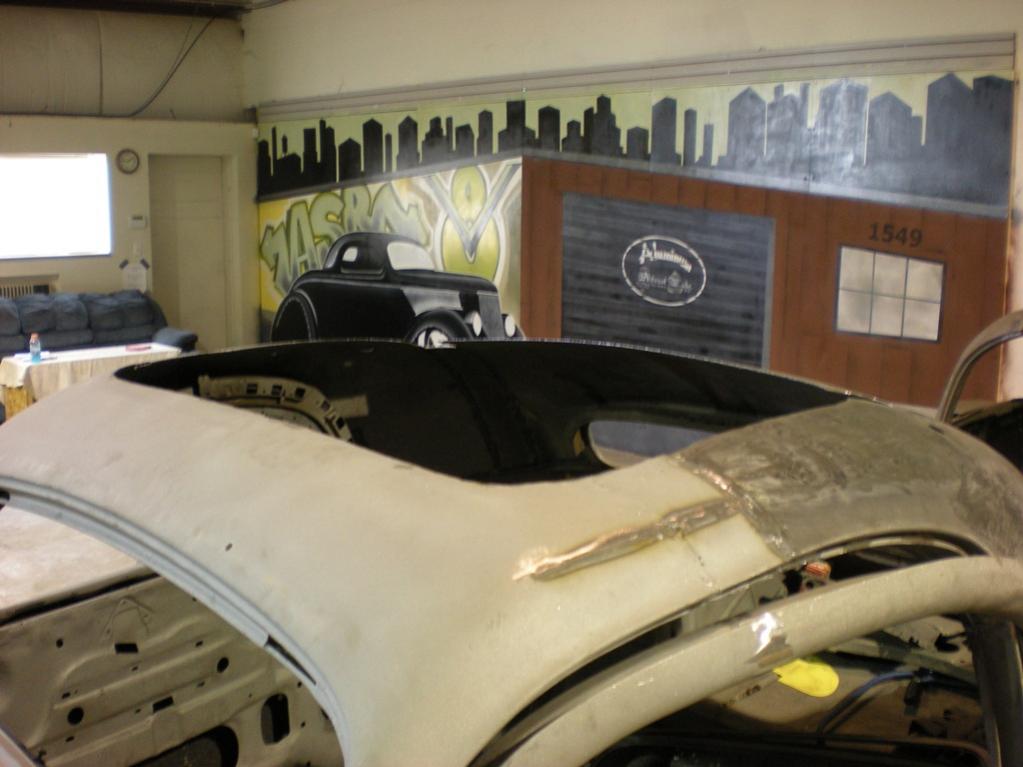

  26. Salt Flats Speed Shop
    Joined: Sep 30, 2007
    Posts: 1,474
    from Utah

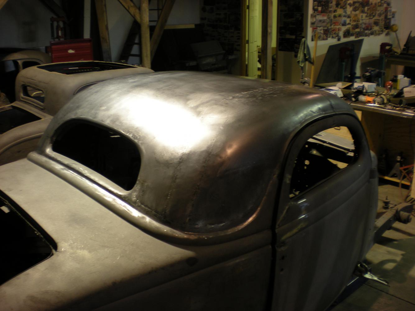

    I finished up the roof insert today. Overall I am pleased with how it flows with the rest of the roof. Ii still have some dents to work out on the lower parts of the roof, but thats for another day.
      118.2 KB
      390
