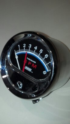

    Went over to my dads house tonight and found a old Dixco tach. Looks like early 60s and should look good on the column.

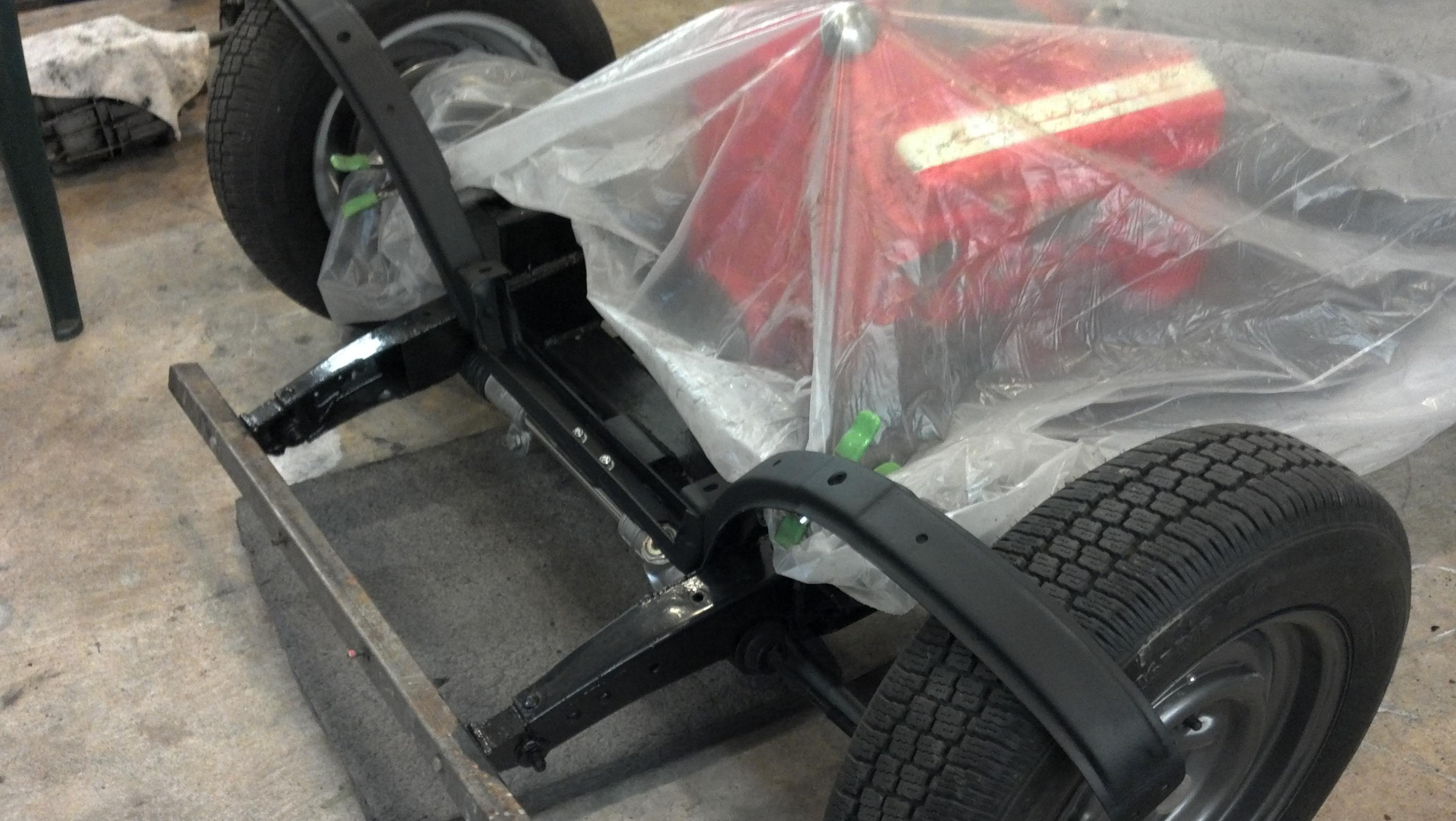

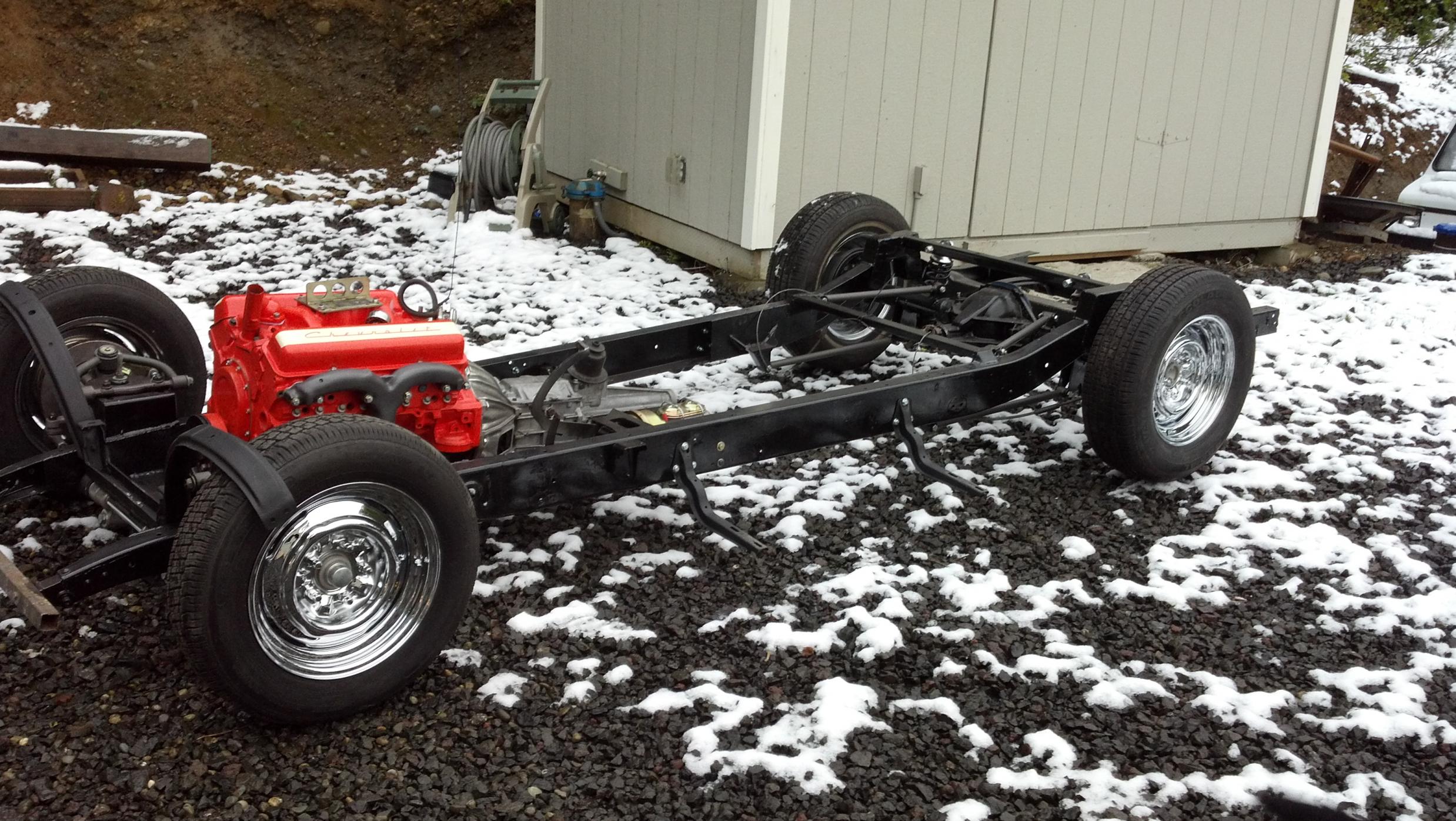

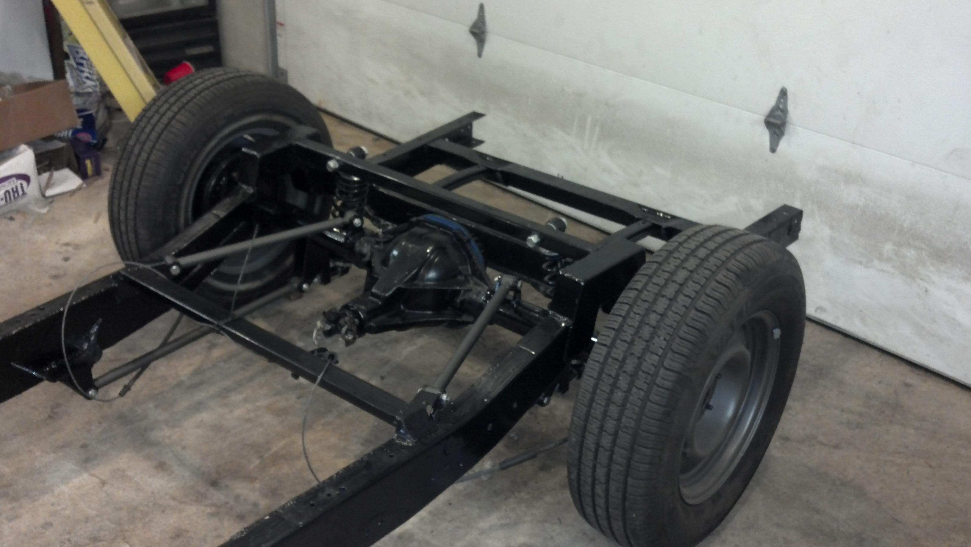

    Now the fun part, frame is coming together.
  3. Scotts Enterprises
    Joined: Jun 17, 2009
    Posts: 735
    Scotts Enterprises
    I thought you were going to install a pancake motor so you would have room for the generator under the hood?
    With that engine it will never fit without a BIG scoop...
    Nice progress dude...

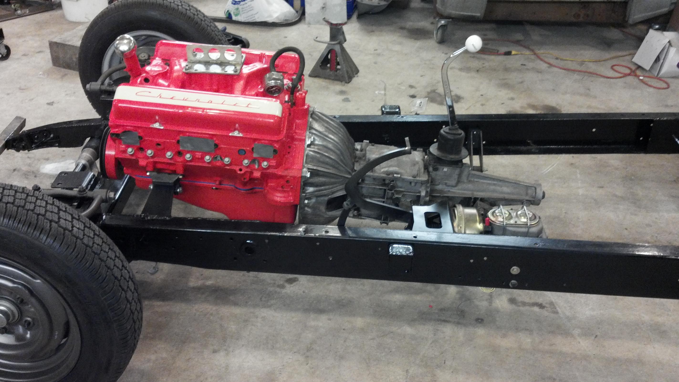

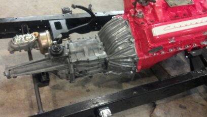

    Todays progress started by reading Flathead Ernies post on t5 transmissions, one of the best threads on the hamb. After reading as much about t5 as i can handle the plan is to take an Fbody T5 with correct gear ratio and other goodies and put a s10 t5 tailshaft on for perfect shifter location. I guess I'm about halfway.
  7. I had to extend the splines on my input shaft to allow the clutch disk to slide back far enough to disengage... just a heads up.

    Thanks Mike! well it's back together and I even made a new shifter to bolt my hurst stick to.

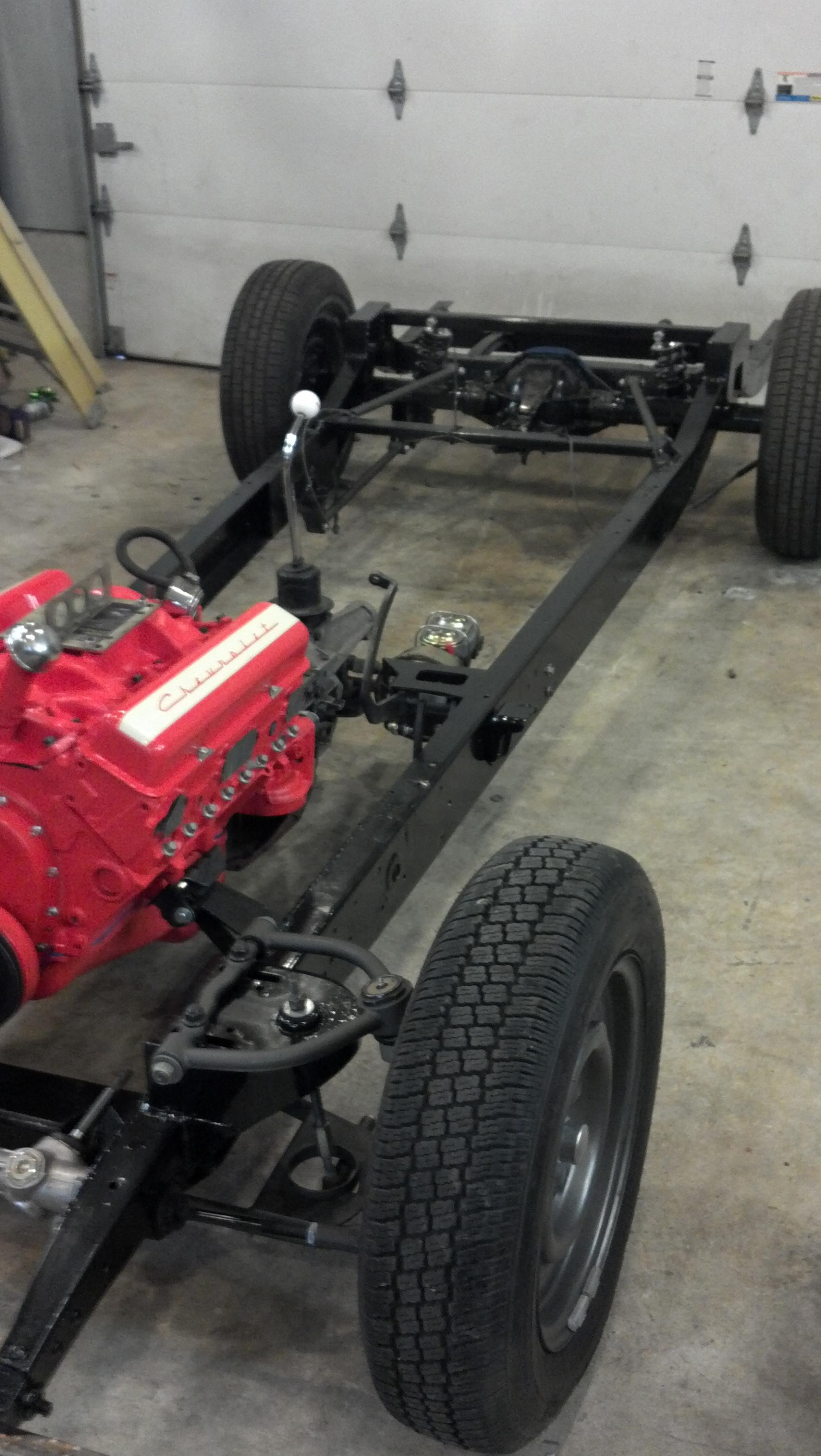

    Made progress today, modified the core support to clear the rack. I cut about 3 inches from the bottom and boxed from side to side. The ramhorns had a ton of casting marks, numbers, and bumps so I smoothed everything and painted them with some por15 manifold paint.

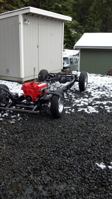

    Bolted the wheels on and rolled it outside to clean the floor before I take on brake and fuel lines. I'll have more pictures and updates soon.

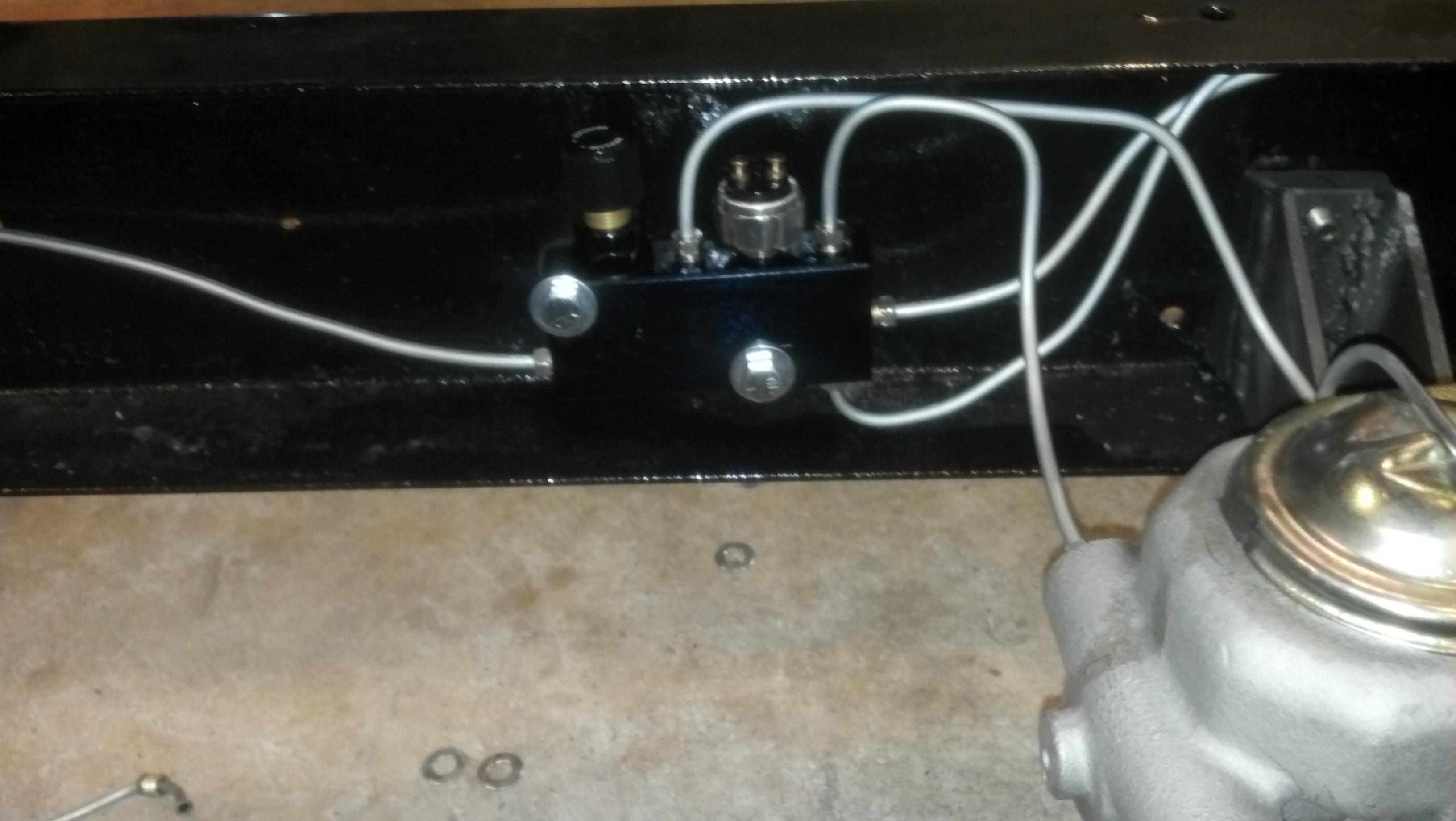

    Ok have brakes with good pedal feel and no leaks. I figured out the most important part while making the brakelines is not to bottom out flare on double flare and use a drop of oil on the die.

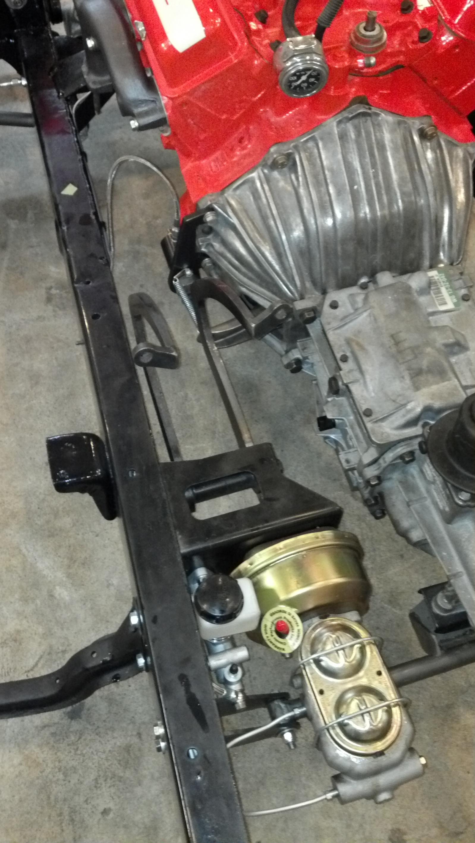

    Now I have the third pedal that make driving so much fun. Novak adaptors hydraulic clutch slave cylinder bracket for sbc bell and wilwood master cylinder. BW T-5, Sig Erson cam, and straight pipes.

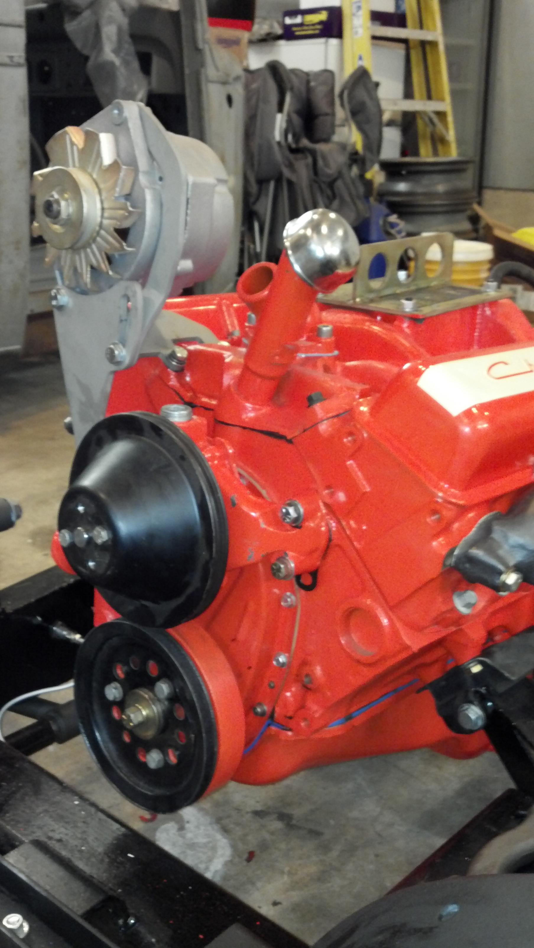

    Alan Grove components sells this trick little alt bracket for about $80, they work smooth if you wanna run a hood. Sorry generator police I bought this one wire GM alternator at a fleet supply house for $45.

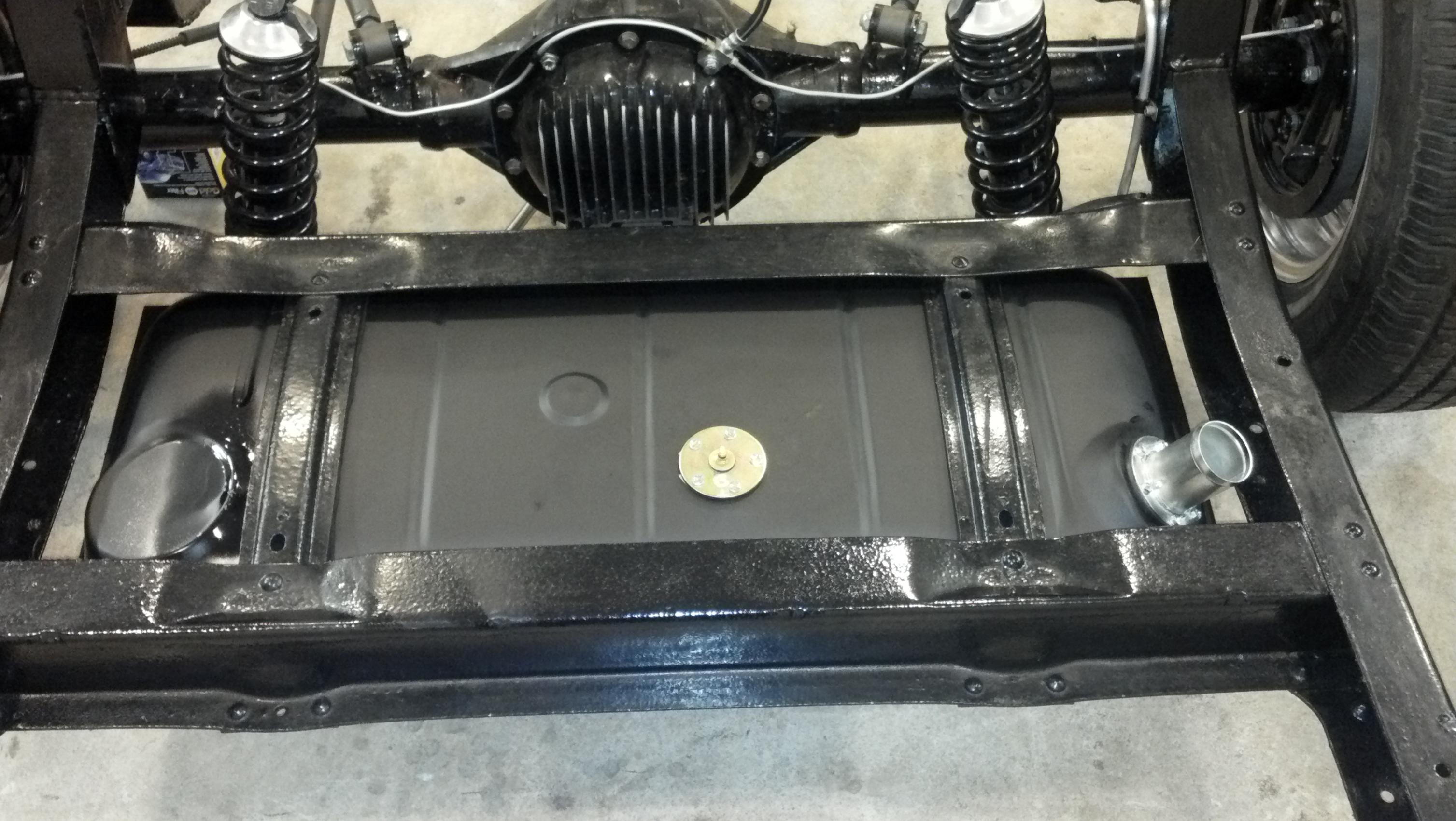

    Bought a gas tank from Yogis, fits nice and you can't see daylight inside like the old tank.

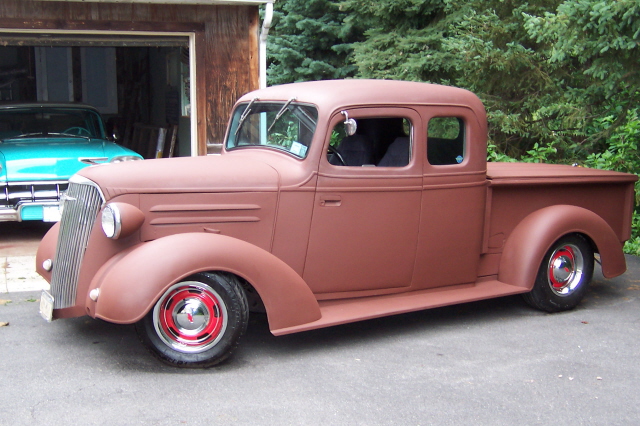

    ~adam
  29. raymay
    Joined: Mar 2, 2008
    Posts: 2,616
    raymay
    I agree. When I did my 37 pickup which has the same cab as a 36, I was able to move the front floor pan about 3" and gained some nice leg room. I am about 5'7". I also made mine a kingcab which allowed me some nice travel with my seats. Another trick was to angle my dash and then I added to the bottom to accommidate the heat/AC.
    Your truck is looking cool. Good luck and have fun.
