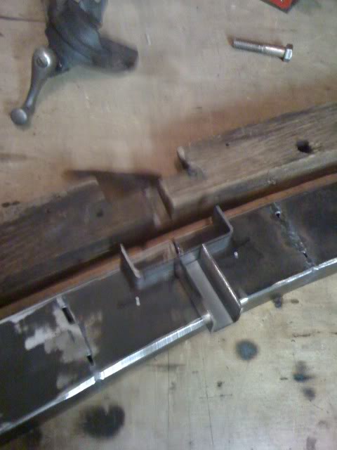

    Make sure you post some good pics. I want to get the wood out of mine whenever its paint time.

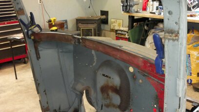

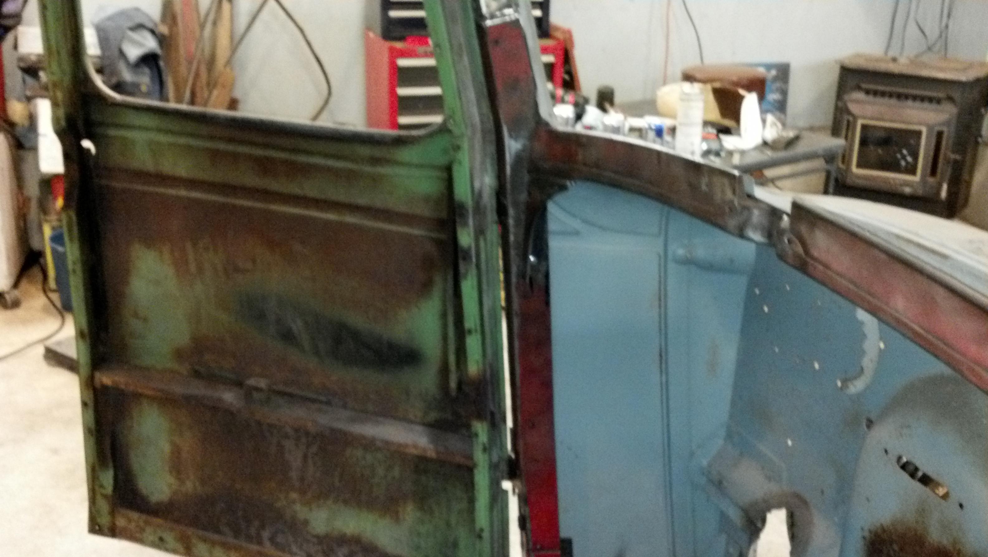

    Thanks everybody for the kind words, I'm having a blast with this truck. On vacation this week so I'm planning to put all the 37 metal in the cab, hinge pilars and dash support. The old owner of the cab started to replace the wood with steel and was on the right path but the original a pilars from a 37 truck cab just look correct. Media blast cab and doors then neighbor and I start with color.

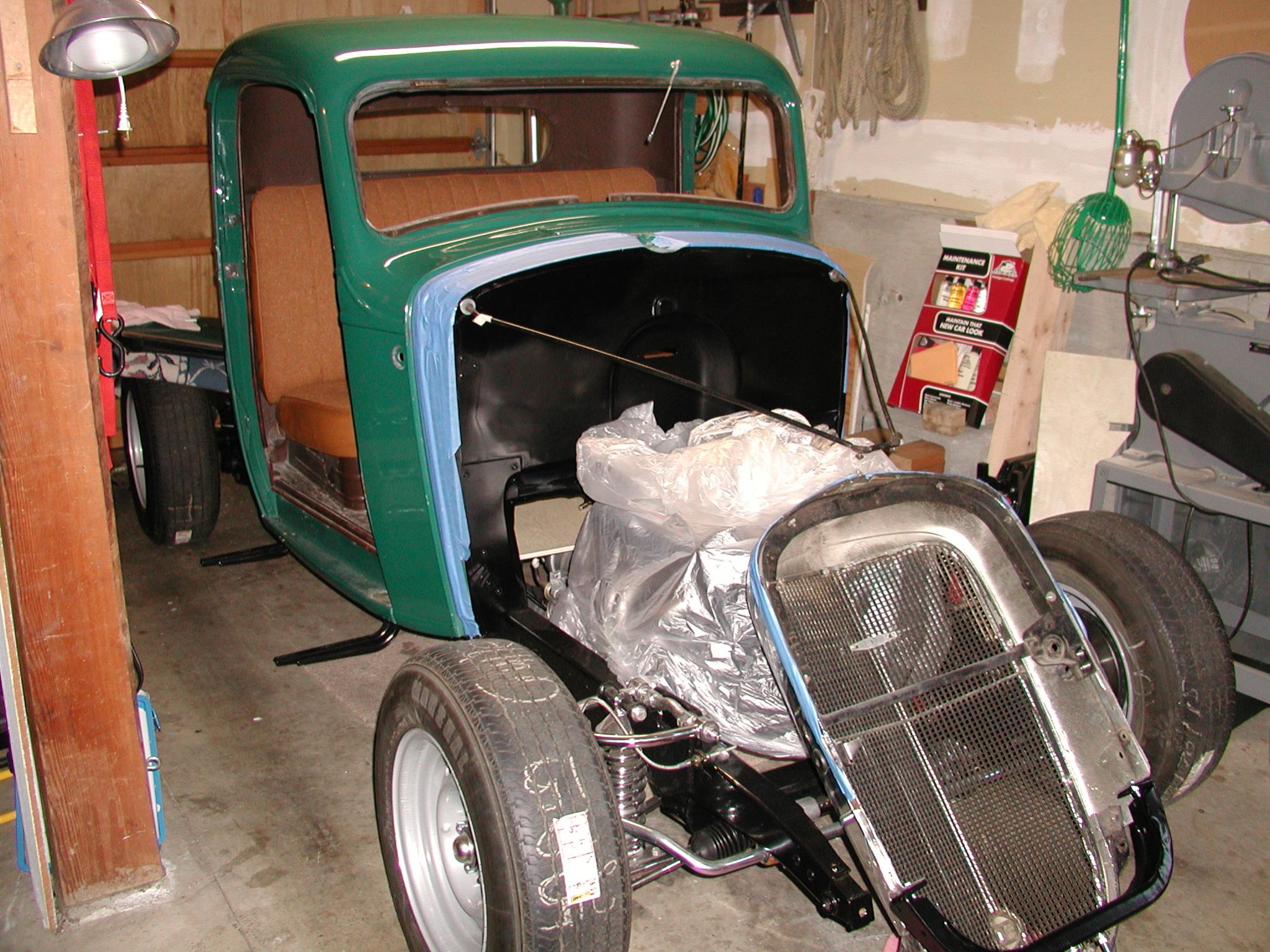

    Craig, here's a similar view of Grandpa's '36 before and after motor and front-end mods. Seeing your photos is motorvatin' !!

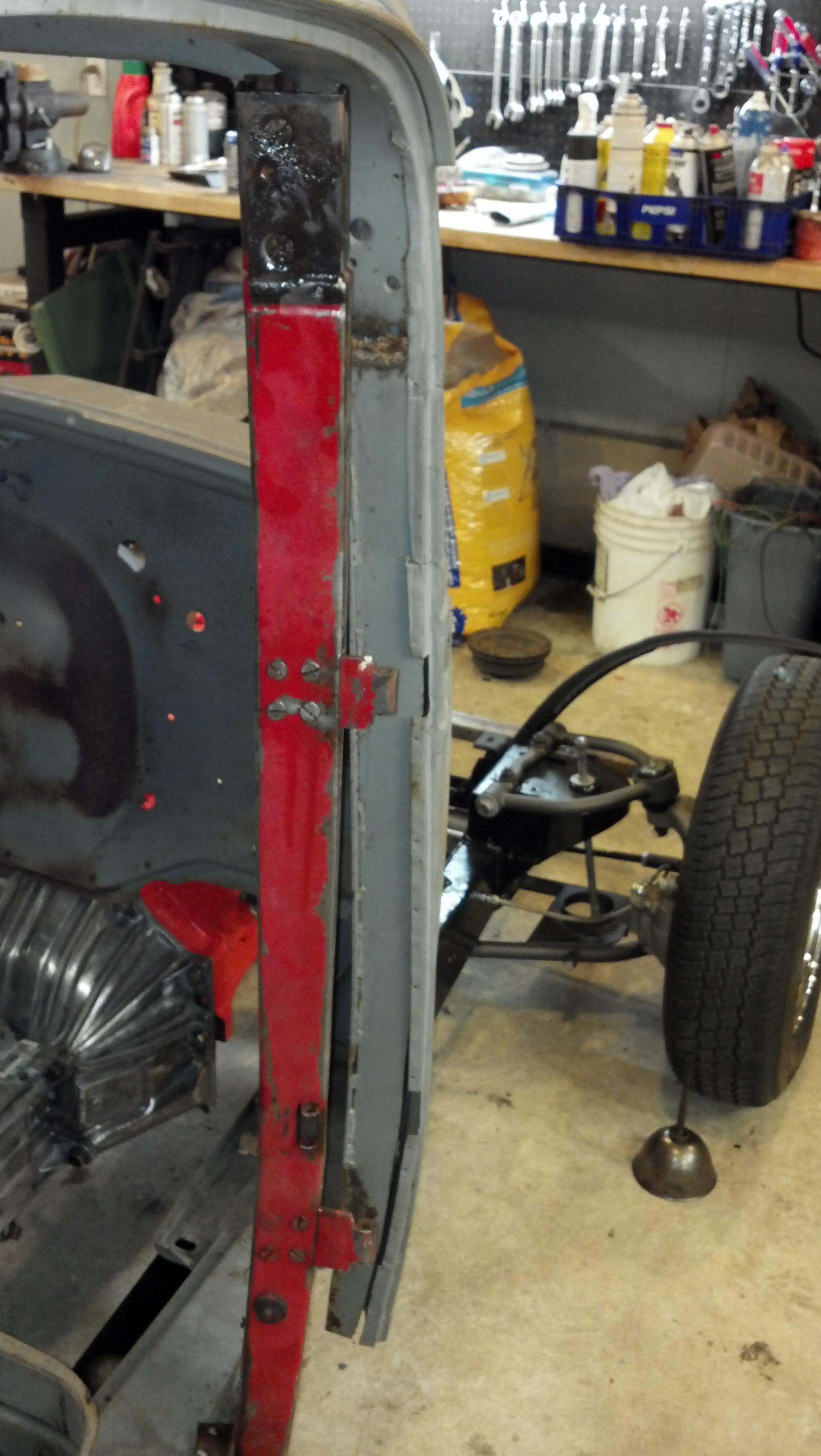

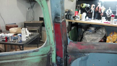

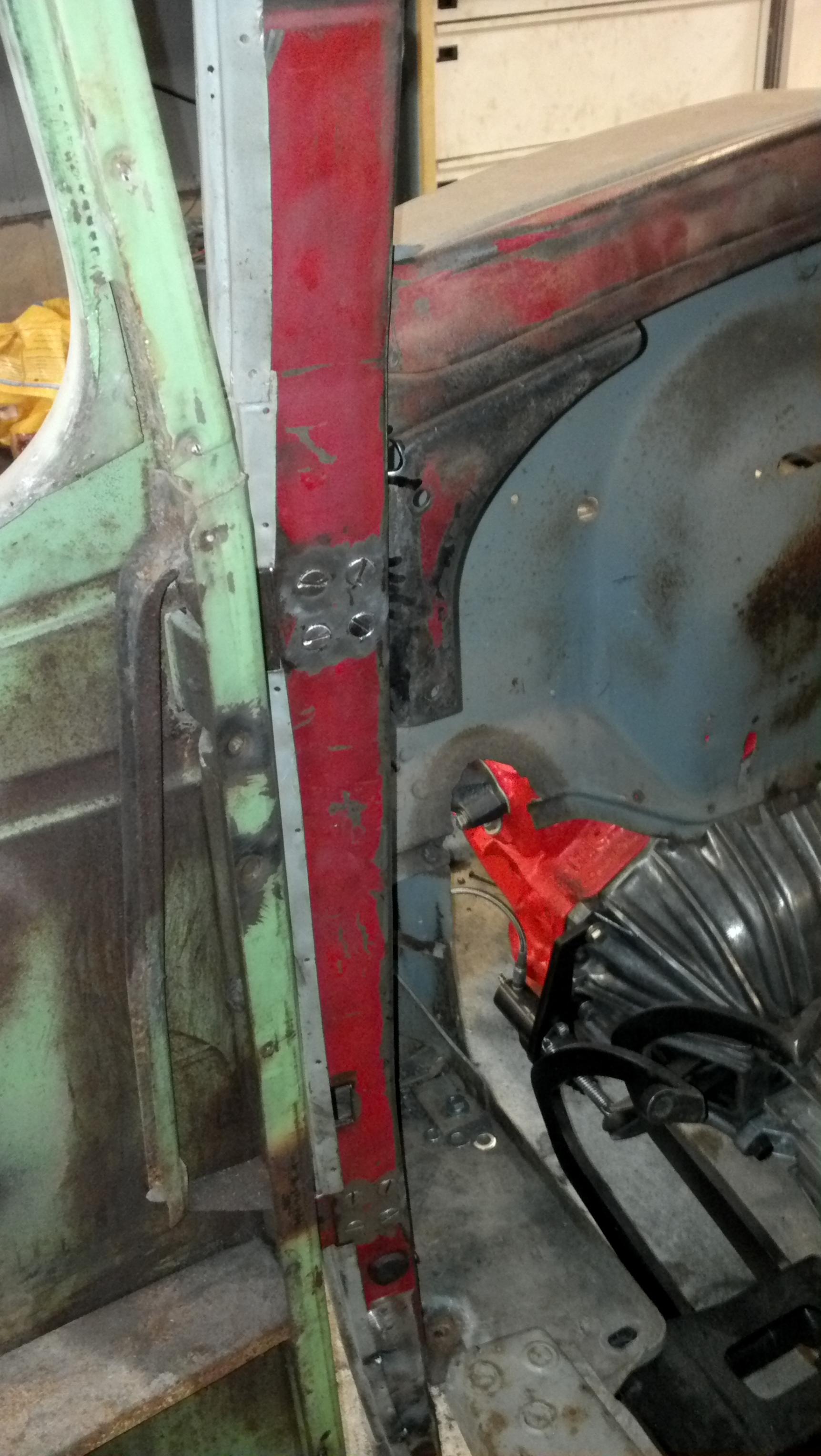

    Install metal hinge pilars and dash support today. Still need to do some adjusting to get the jam gaps correct but it feels pretty good to have working doors for the first time. The 1937 steel pilars are the way to go!

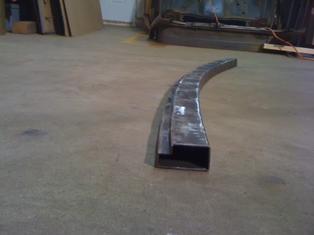

    Looking real nice, I was going to send you a PM cause I came across a set of 37 door columns and the dash piece on ebay, but I see you already got yourself a set. Looks like the fit is real nice. I wish I had known about that before I went through all the trouble building mine from scratch making the dash piece was a nightmare... having to arc the piece then take the corner back out then I couldn't mount the windshield regulator.. and had to recess that spot in there...not that the door columns was much easier.. almost makes me want to cut mine back out..Live and learn, now I know for the next one

    Bought the pilars off ebay, cost a pretty penny but needed a good foundation to setup the cab

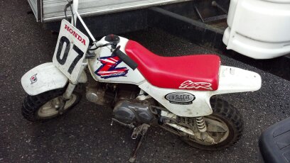

    Nice, this is mine [​IMG],
    I'm probably going to kick myself but I put it up for sale last weekend. I just have too many cars I need to get done and not enough $$$. I do wish I would have put fenders on mine though but I like them both ways.

    Those pilars look great!! I'm going to keep an eye out for some. Thanks for posting the pics....

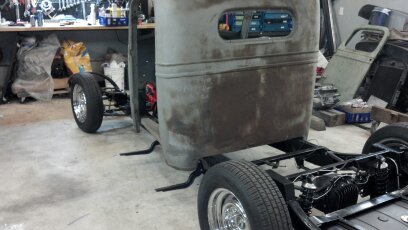

    Still blasting and stripping, I'm really taking my time so the metal doesn't warp.
