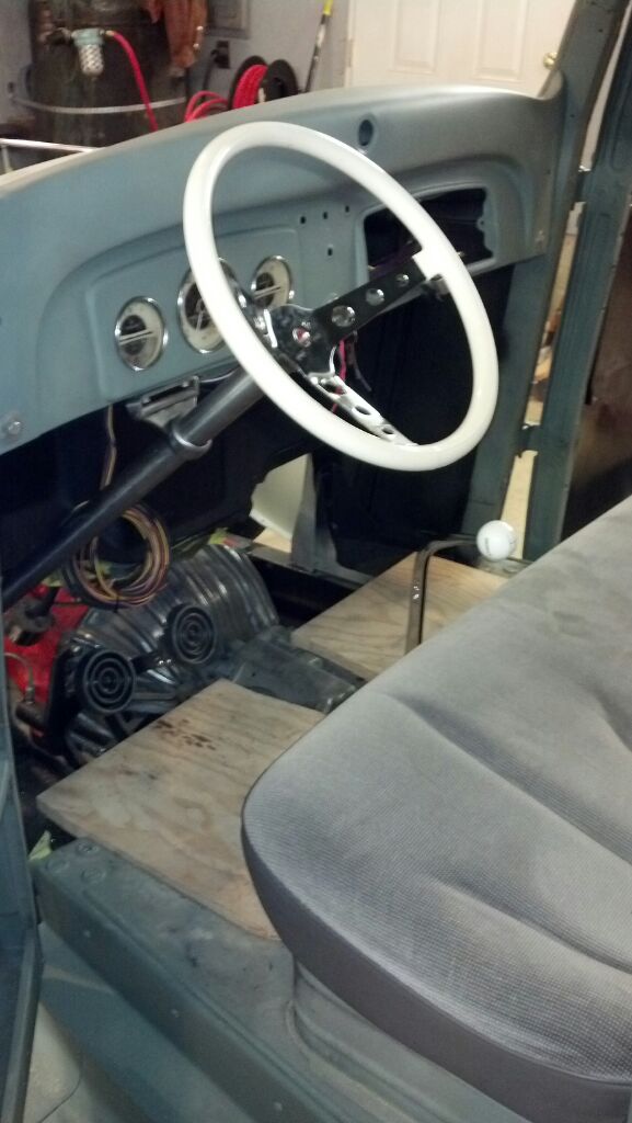

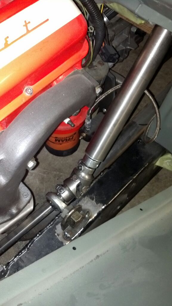

    Made a steering shaft carrier bracket and tacked it to the frame rail to see if everything clears. Carrier came from my buddy Nacho at work, was on his rockcrawler.
    Pedals, steering, and shifter are done and the good news is I fit

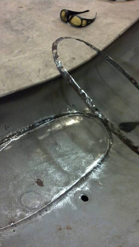

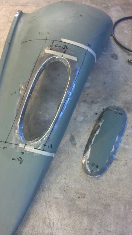

    Well everybody I'm back worked all winter building a 1955 big window truck, sold it last night and now I'm back to my favorite little 36. Tonight I'm going to start to fill spare tire well on the front fender. I'm going to use the same portion of an extra drivers fender that's pretty beat up. I'll post pics.

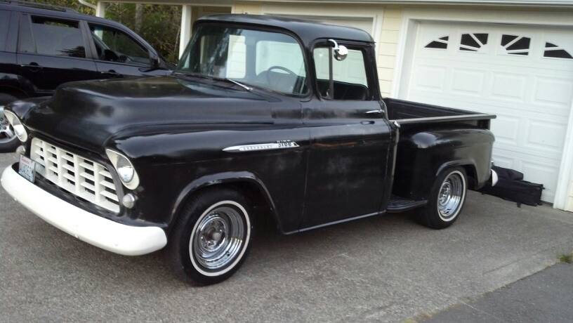

    This was the 55 sold in 24 hours

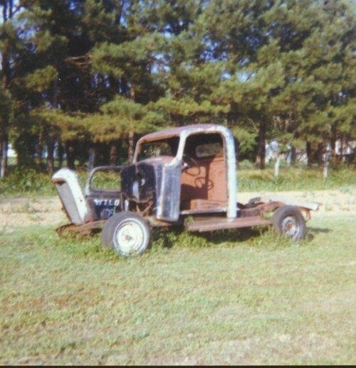

    I've attached pics of my truck when it was still a phone company truck, one from when I found it, and one two years after I bought it when my dad and I had just finished building it. I drove it like that for MANY years before tearing it back down. Too many obligations have delayed me over the years but I've got 5.3/4L60E combo sitting in the frame now, and the bodywork is about 50% so hopefully it will be back on the road before long!
    Clark
    p.s. I apologize for the poor pictures, the two after I bought the truck are scans of old polaroid pictures...I'm showing my age now lol!

    That's a cool truck! Just ended up making a template for the patch my plan is to take one on p*** side the flip it over and take that piece from my extra drivers front fender. Should have a very similar contour. Just backwards, hope it work I'll be sure to post.

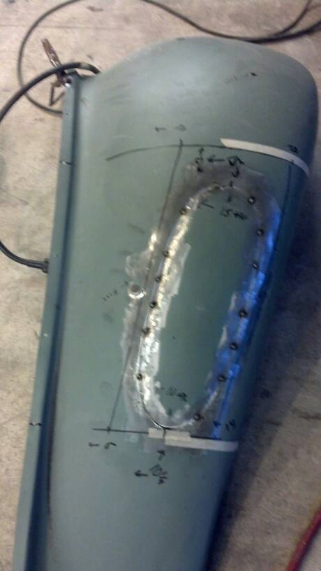

    Took some pics of filling spare tire carrier.
