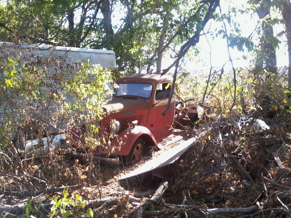

    Found this truck behind a barn not far from home. Grabbed it and brought it home. The flathead six in it is shot, been left sitting without a head, pan, and pistons and rods for 20+ years.
    Want an opinion on the power train. I lean toward putting an original flathead in it, if not that a red ram hemi has been kicking around in my head. Seems to me these two are about the only thing that would do it justice.
    But, always one of these, friend has a warmed over 318 with a 727 for what it would cost me for a salvage yard 218 flathead.
    Question you will ask is what are my plans for the truck, mostly just running around town and the countryside here. But would like to be able to road it at turnpike speeds and don't think the six would be up to much of that. But if I swap out for higher speed travel would the 318 be a let down in this truck when telling folks what it has in it? Again I'm building a driver not show.
    So let me know your opinions...thanks.
