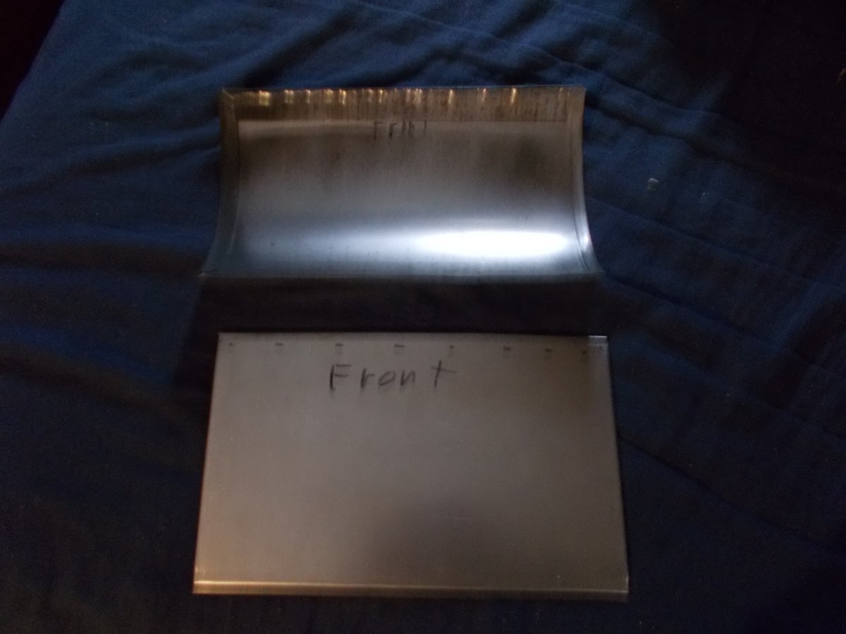

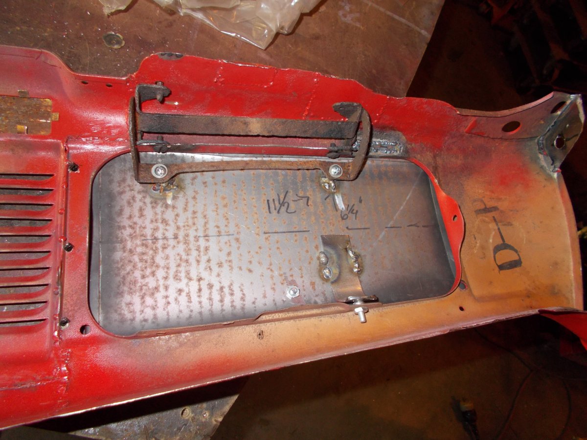

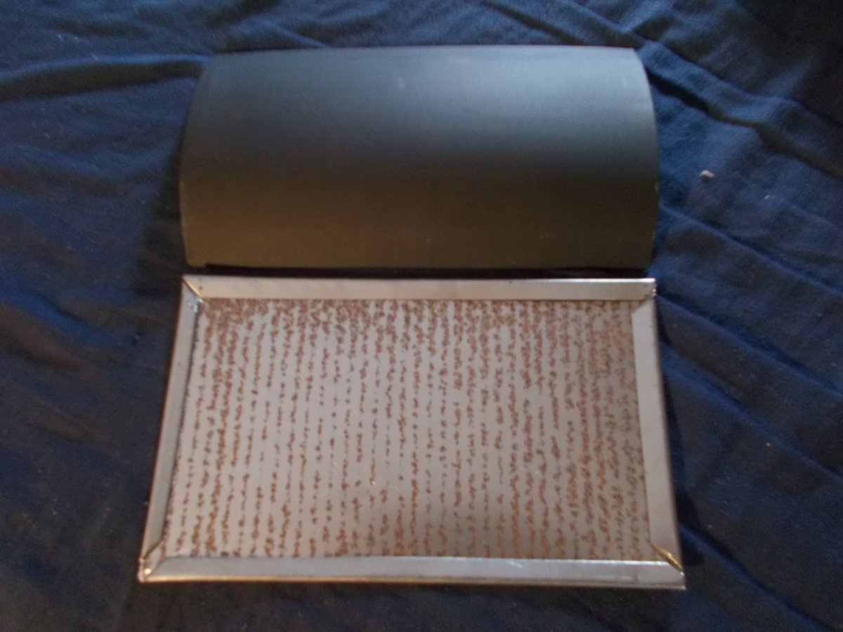

    i made a couple '38-'39s and a '40 [black primer] with a pan break and a slip roller...
    no inner panel so i had to weld a latch tab, some nuts together to offset the hinge mounts...
    closed car 1st pic...
    DSCN2306.JPG DSCN2303.JPG DSCN2304.JPG DSCN2638.JPG DSCN2577.JPG DSCN2581.JPG DSCN2586.JPG

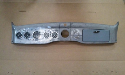

    I modified the stock '36 dash for my 3w......still a work in progress
    [​IMG]Un***led by TagMan, on Flickr

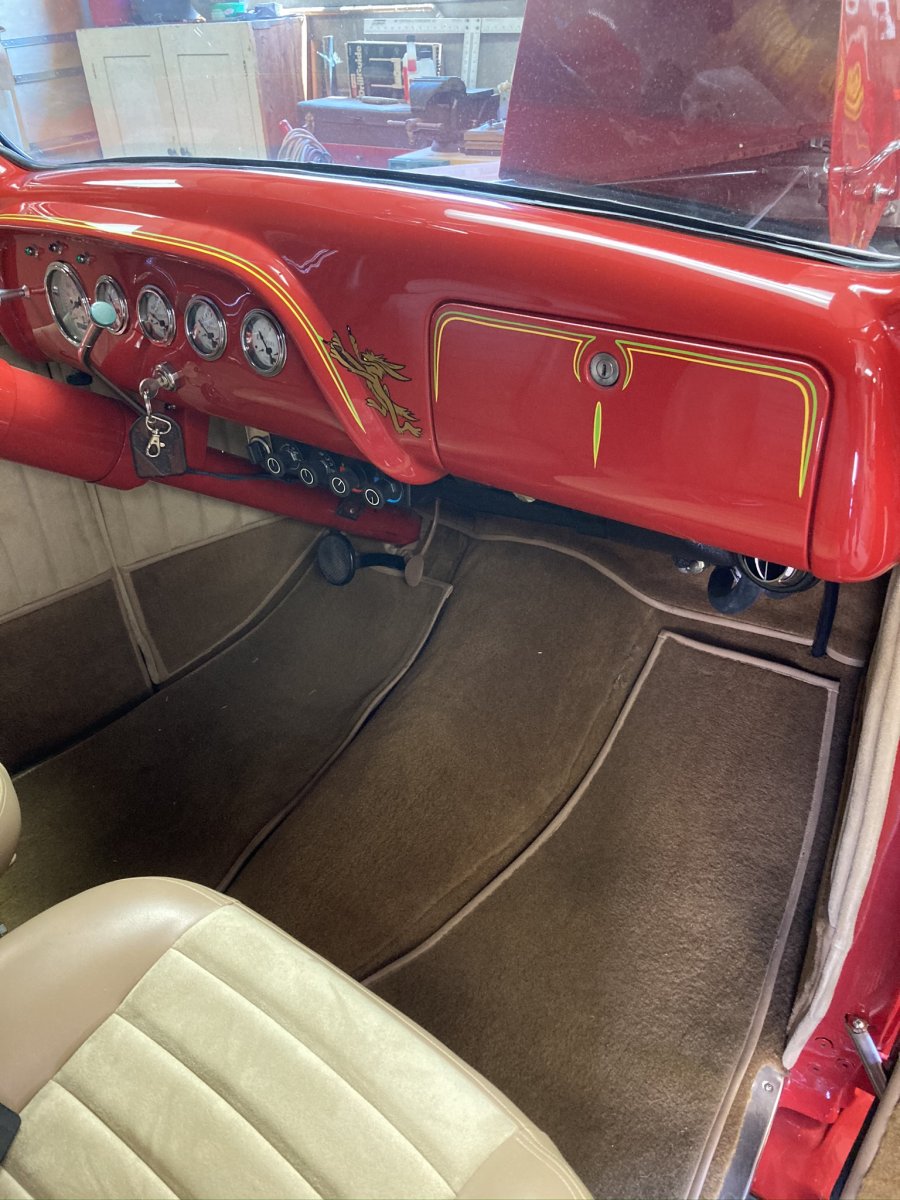

    Not the best picture but I slightly enlarged the speedometer opening to accept a slightly larger diameter aftermarket speedometer and then mounted SW oil and temp gaugers ON TOP;) of the stock 36 Ford gauge bezels in the stock 36 Ford gauge openings. I mounted fuel and volt gauges below the dash. Note that my pickup has a stock waterfall that does NOT have an opening for cranking out the windshield.;):)

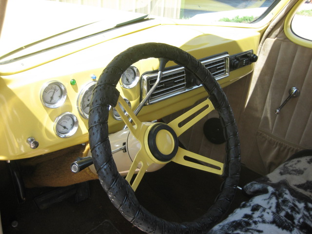

    swapped '35-'36 gauge set up into my '38 closed car dash that will go in a '30 coupe...
    filled the bent finned speaker grill...
    the red '39 was modified with '35 style cluster and to fit a '30 model A... patmanta. 38 dash 2.JPG DSCN2621.JPG
