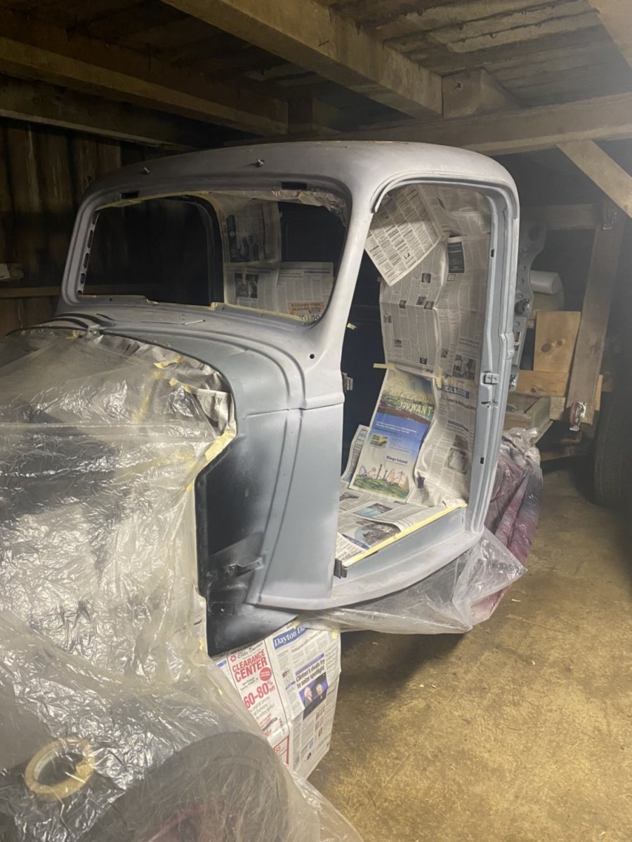

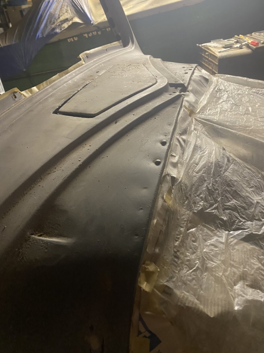

  4. Getting the cab taped off so I can put some primer on and then use a da sander with probably 220 to sand. This should get rid of sand groove marks and any small imperfections I may have missed.

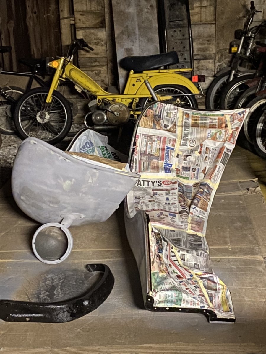

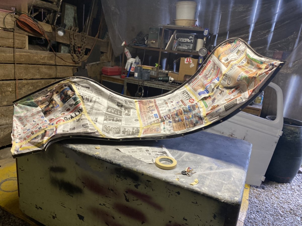

  6. Fenders are taped off and working on a bulb I forgot to clean up and fix but other than that I’m pretty set to paint. I’ll need to clean all my surfaces and all but other than that I’m liking it. I plan to spray primer tomorrow and hopefully I don’t see too many areas that I missed. It’ll never be perfect but i’m also trying to make it a 4/5 on appearance. It’s a little too wet and keeps sprinkling on and off today to paint now.

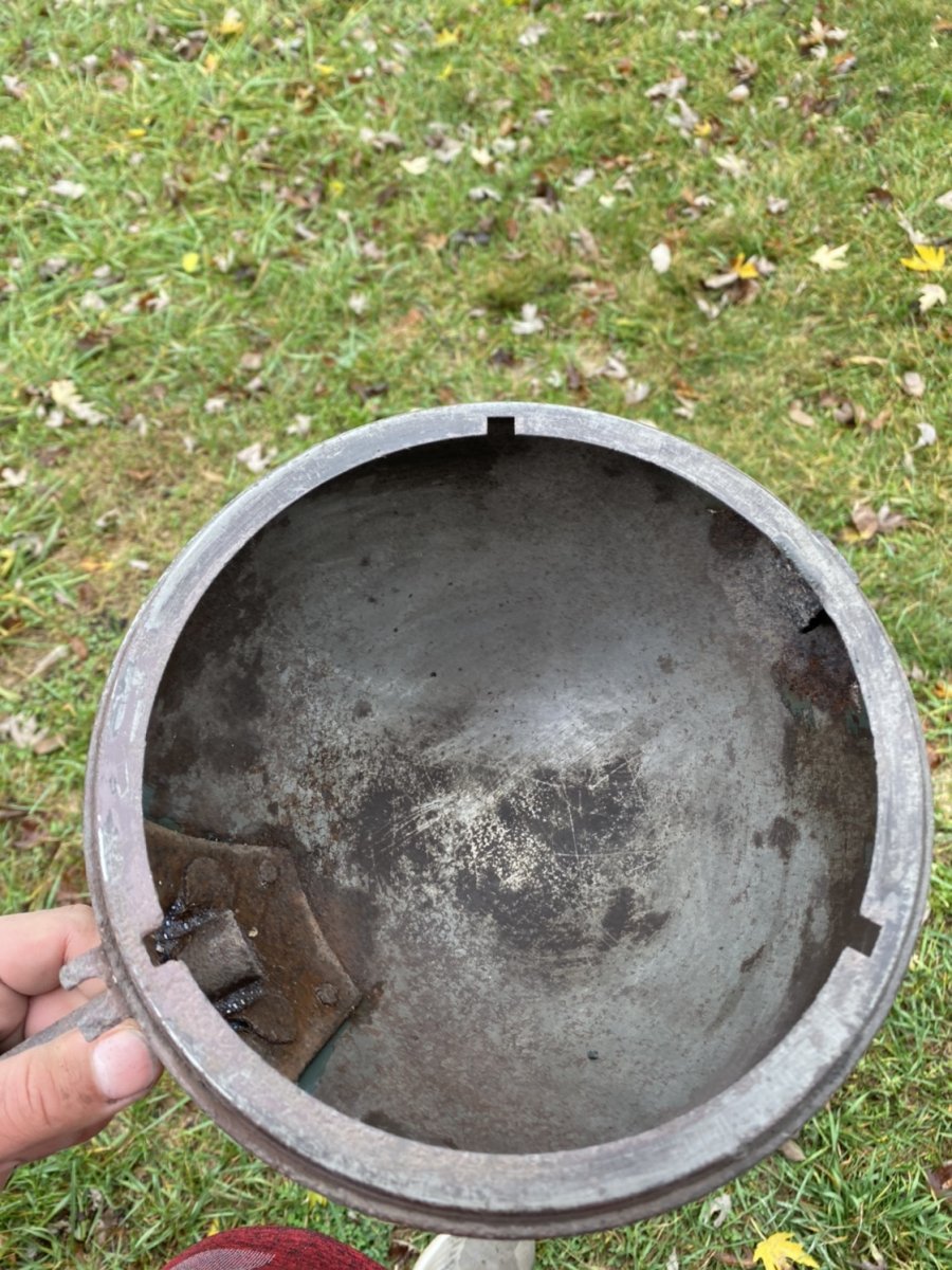

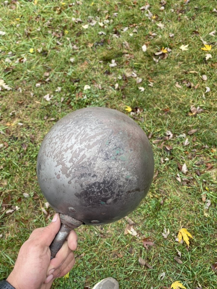

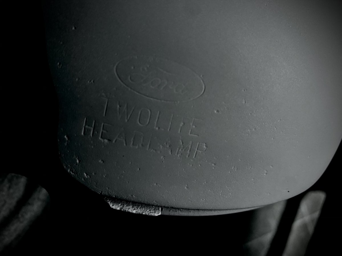

  7. Kind of hard to see so I used some editing to bring out the lettering on the headlight after I cleaned it up
    Cleaning of the headlight in order
    Paint stripper
    Wire brushed
    Ultrasounic cleaner
    Sand blasted
    Orbital sander
    Filler primer
    IMG_5287.JPG IMG_5288.JPG IMG_5289.JPG IMG_5290.JPG IMG_5295.JPG IMG_5296.JPG IMG_5286.JPG

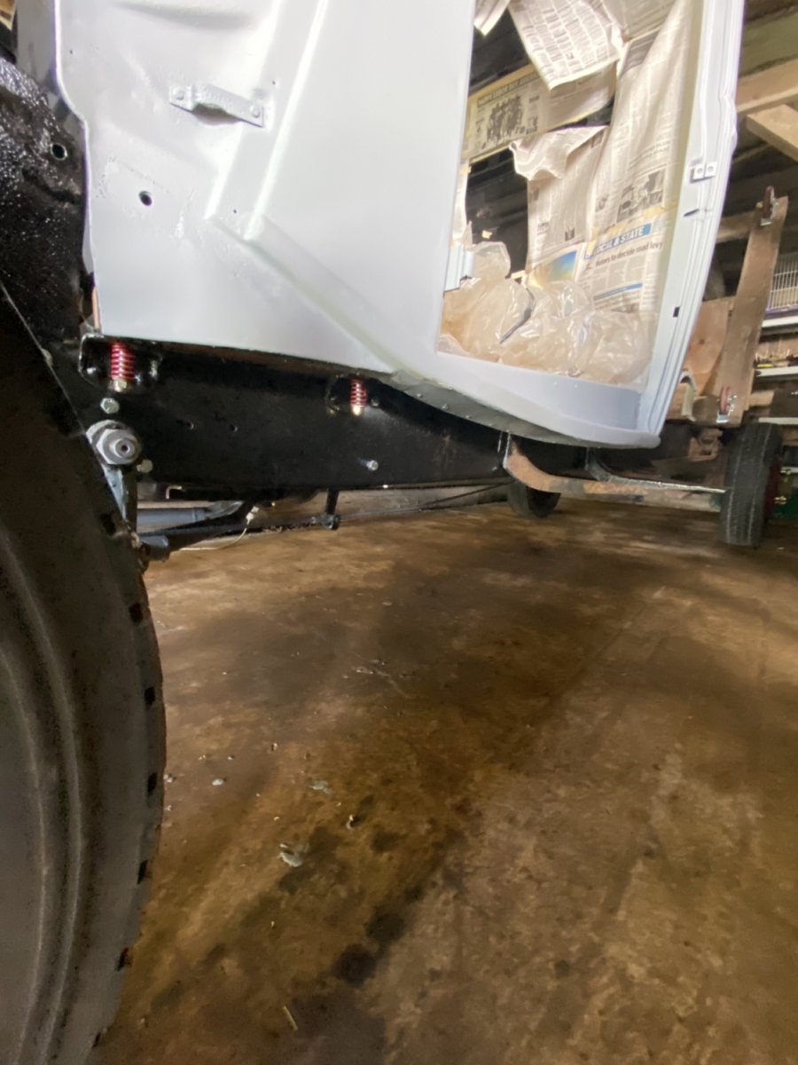

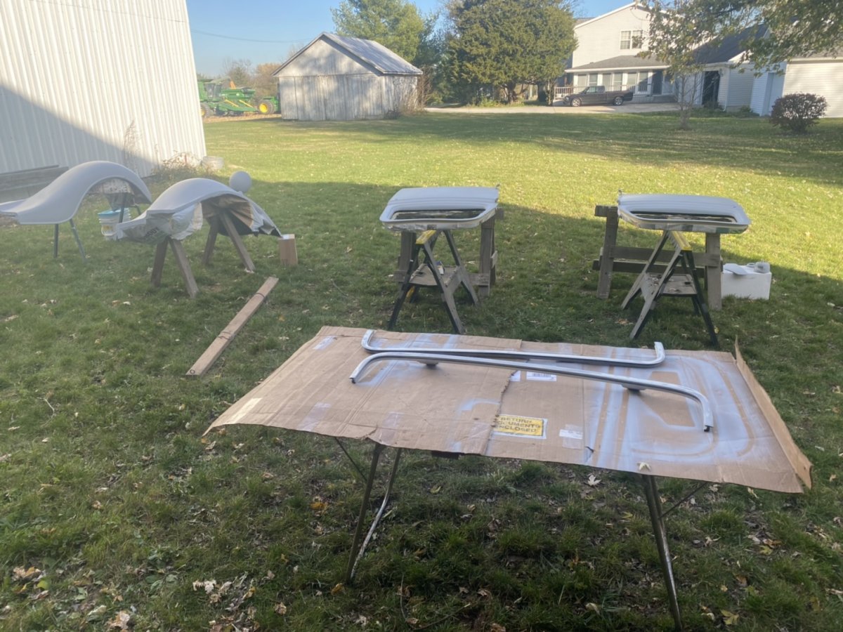

    And I think with a days work in I’m ready for paint tomorrow in exception to cleaning some surfaces

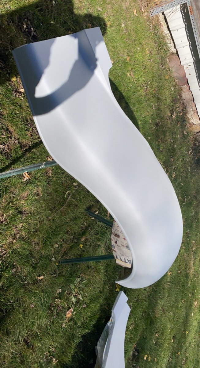

  10. Painted and done. Had one mess up in which the tape came off and I accidentally hit the firewall with paint but I think I can fix it Sanding will be next when this is all set.

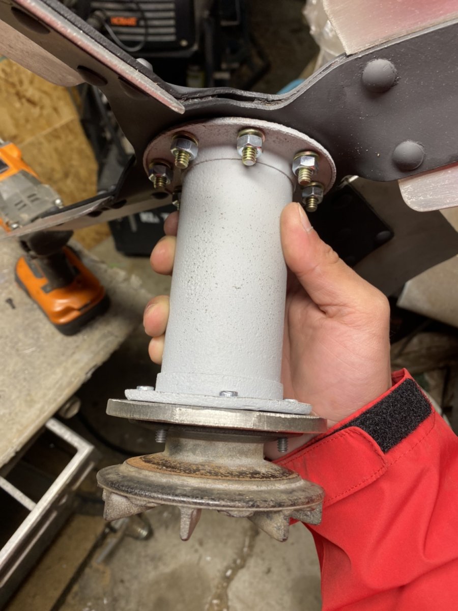

  15. Concerned my radiator fan may be too heavy. Anything I can do to make sure it’s not??
  16. Here’s my set up. I have not weighed it but I know it’s heavy
  17. 1930artdeco
    Joined: Oct 25, 2011
    Posts: 786
    1930artdeco
    from Lynden, Wa
    Probably the normal weight. If you want something lighter then you will have to go modern flex, electric or maybe find one with a clutch.
    Mike
    Christopher Miller likes this.
  18. Been really looking into this and I can’t find any research or things to compare my setup to. My set up uses a plate to connect the fan to the pulley. Originally I wanted to weld the fan to the pulley but I think the pulley is hardened steel so I can’t. We made a plate which connects to the pulley by 4 holes and cap screws. The pulley then connects to that plate in 4 areas.
    I broke out the scale and my whole setup is 7.33 pounds. Quite a lot to be spinning so fast I think but maybe that’s just me. Last thing I want is the fan to fly off and hit the radiator after we got it re-cored. Too expensive to mess up at this point.
  19. Lock tight will be added to ever bolt in this ***embly, the cap screw will be grinded down so the belt can go through smoothly, and lock washers will be added to the base of the fan. I’m purely just mocking this up for weight right now.
    Let me know what you think or if you have a weight of a Flathead fan or what you’re using would be even better!

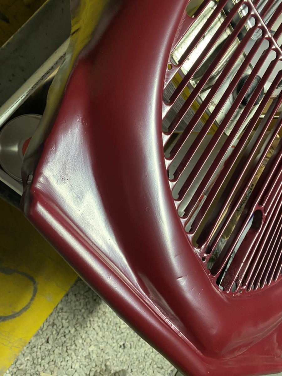

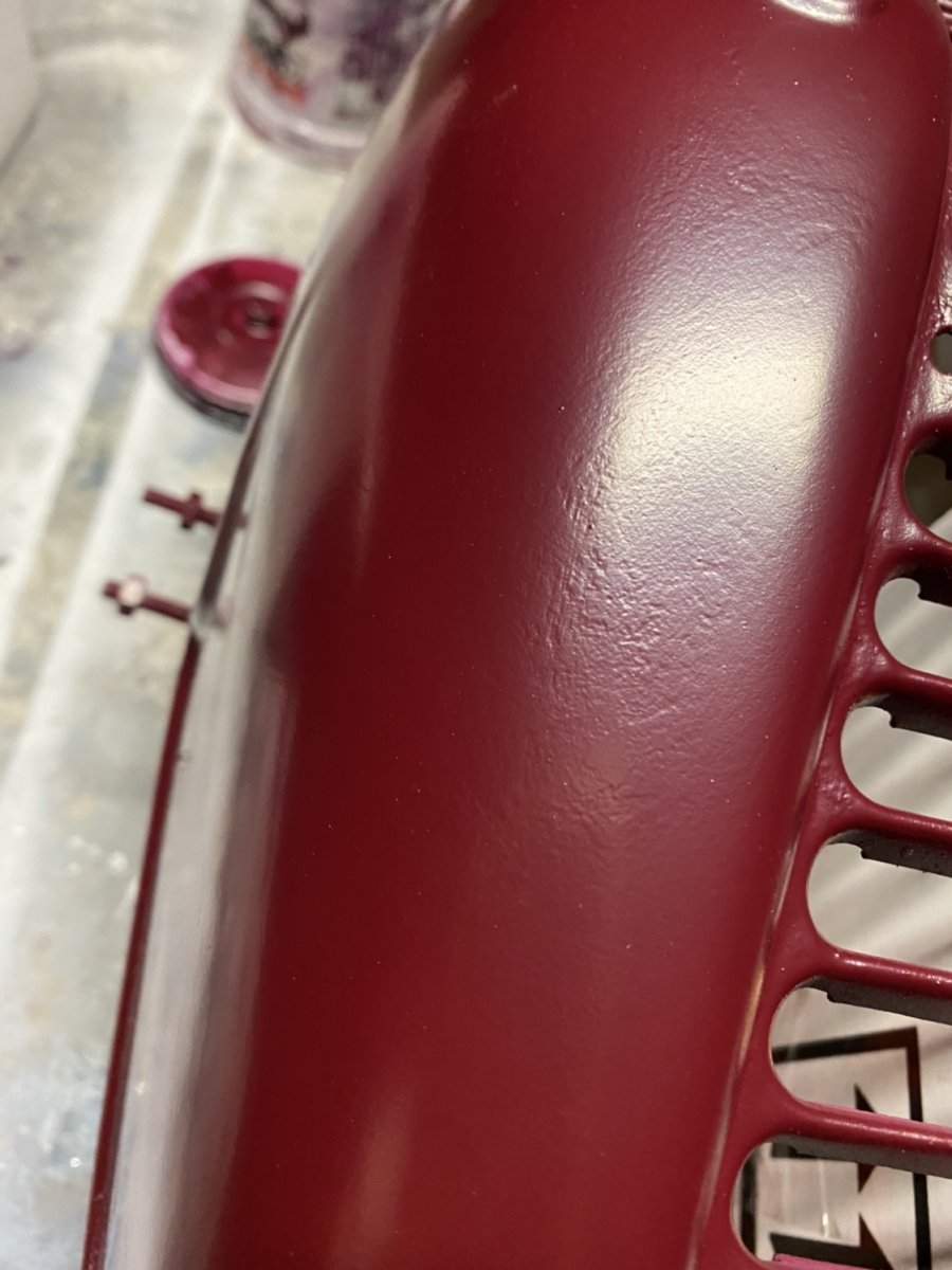

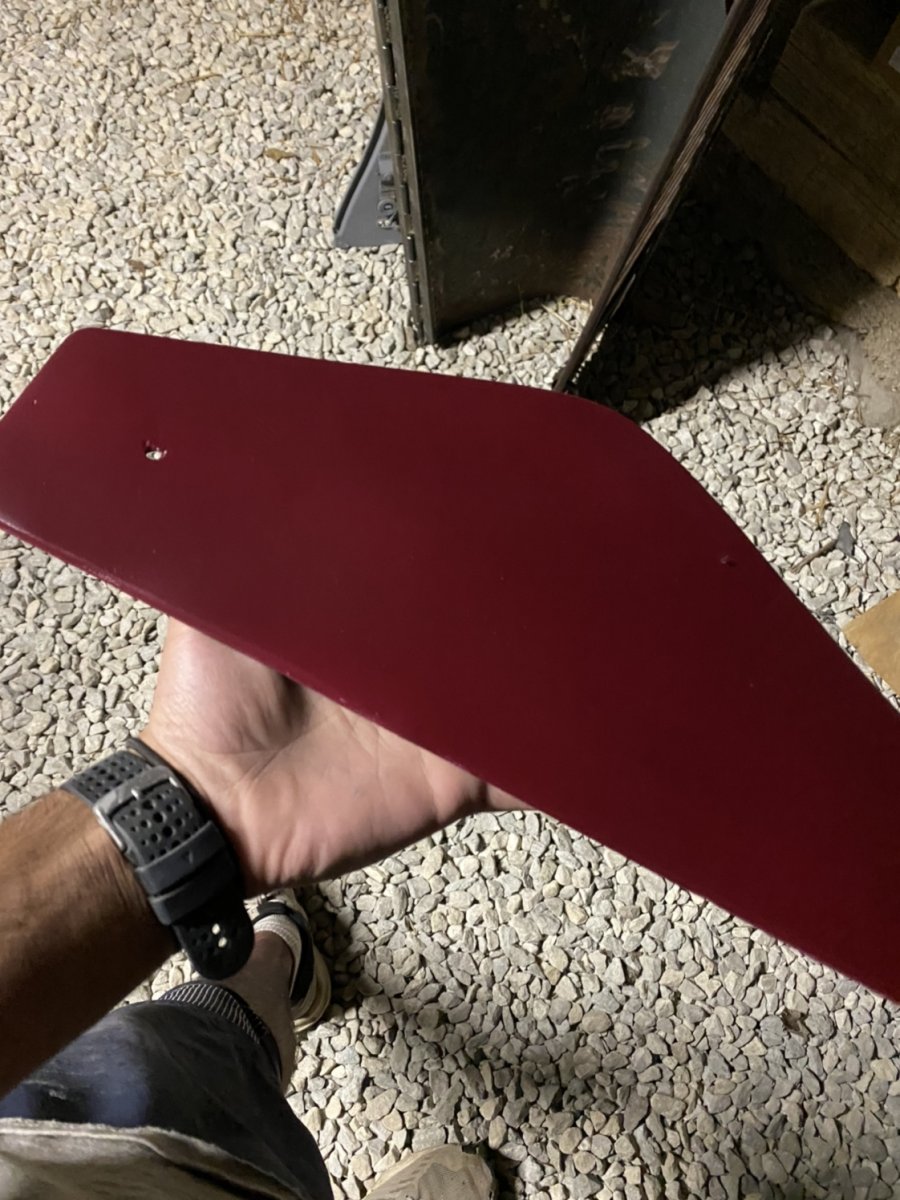

  24. While I planned to paint the whole truck truck today with red I only got to two doors, the grill, and a few small pieces. Here’s how they turned out
    IMG_5503.JPG IMG_5504.JPG IMG_5507.JPG IMG_5508.JPG IMG_5509.JPG IMG_5510.JPG IMG_5512.JPG IMG_5514.JPG IMG_5521.JPG IMG_5522.JPG IMG_5526.JPG IMG_5527.JPG IMG_5528.JPG
    While I want things to be perfect I realize I just can’t get it all. I was hesitant to show these but I think it just goes to show I’ve done my best and it’s part of the story of my personal project. Overall it’s really not that bad, just not perfect

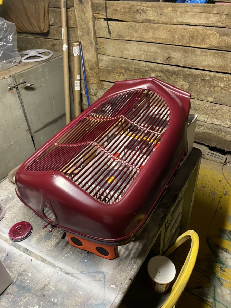

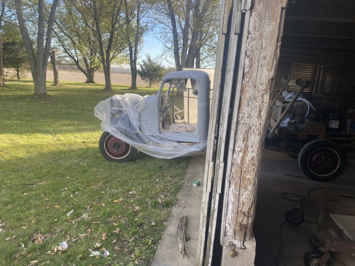

  25. More progress today
    IMG_5554.JPG IMG_5556.JPG IMG_5557.JPG IMG_5558.JPG IMG_5559.JPG IMG_5560.JPG
    Painted more-
    Final coats of window frame
    Other fender
    Headlight
    One coat on grill, I missed a spot
    Cab only has one coat, it’s all I could get to with the sun setting so soon.
    After getting off work and before the sun sets is a small window of time to try and get it all done. Tomorrow I aim to get the last of the truck painted and the Rims, the rims will take a while

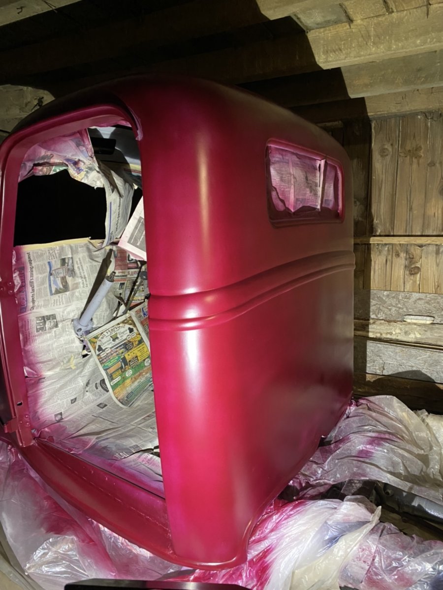

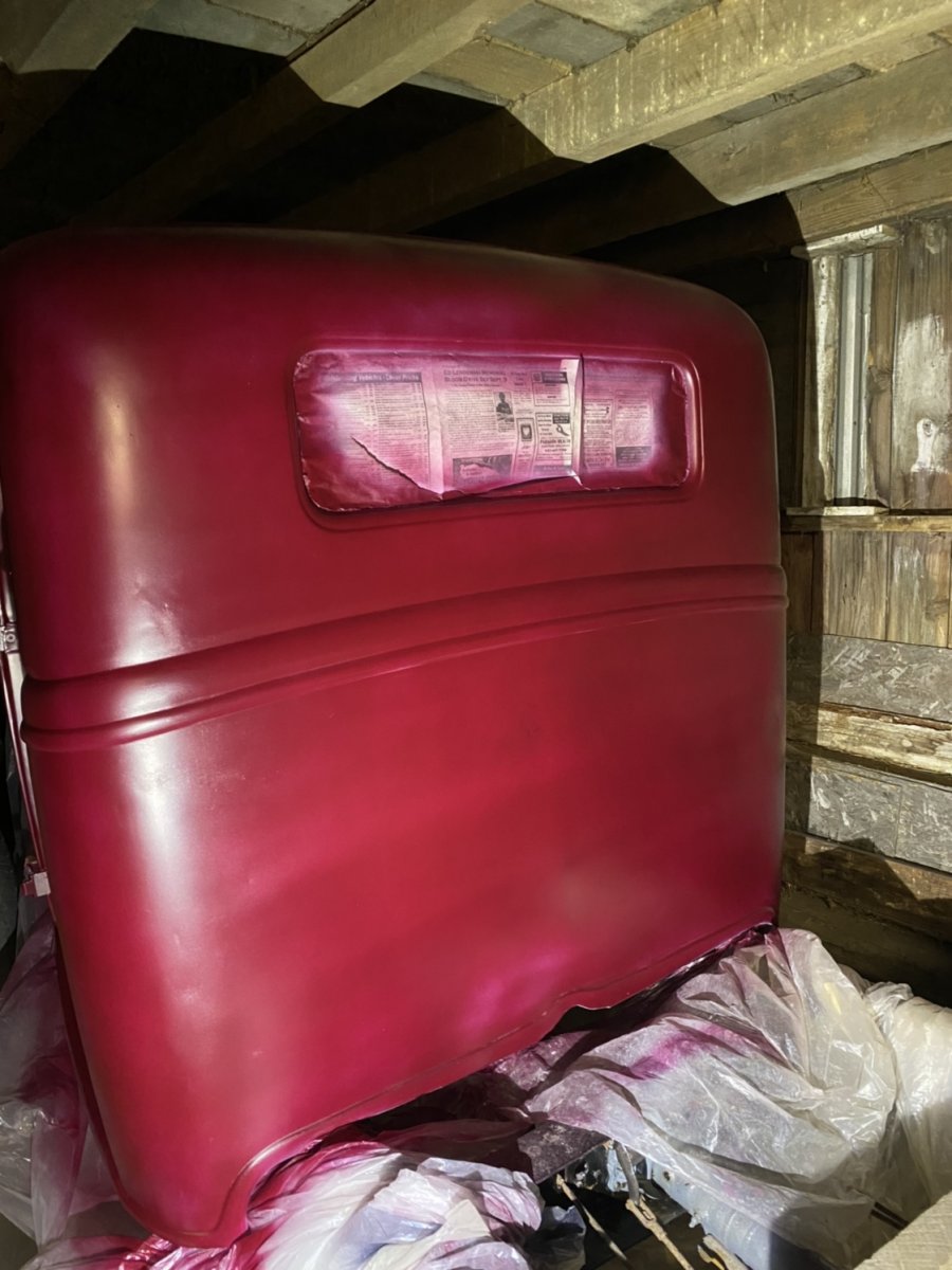

    Not many pictures but I can update you guys

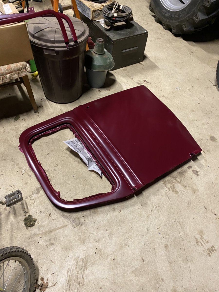

    Final color was put on and I have a toooooon of extra paint. Granted I still need to do the hood, still working on that.
    Today I painted more coats on one side of all the rims, a few small pieces, and finished the cab. I should be able to do a bunch of clear coats tomorrow

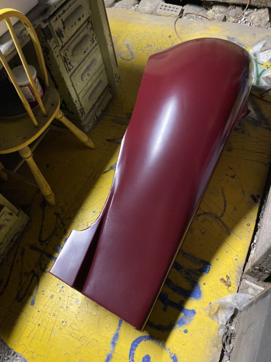

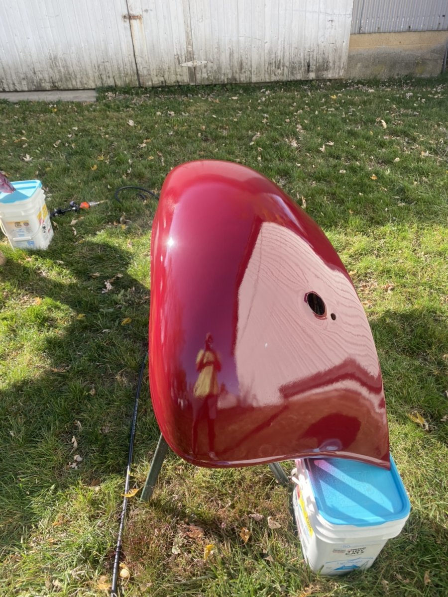

  29. Got the clear on a few items today in exception to the doors,the Cab, and the rims. I have 2 more warm days before it gets cold again. I took a video that captured the reflections in the panels but I’ll drop a few pictures as well. Click the link to see the Grill and both fenders in the sun.
