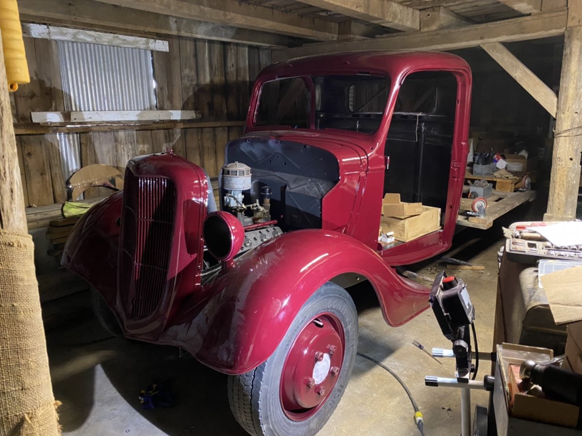

  3. I’m not a big fan of working with wood but I gave it a shot today and it’s decent I’d say. Welded in new hinges as one was missing and the other was hanging on barely and very rotted away. The seat still needs sanded, stained, and painted with some urethane. A good start to the interior which is next
    Really trying to distance myself from anything that could mess up the paint job I just did to the truck. About a month until I can really be in there working on ***embly of all the pieces I just did. I want to focus on the interior next and the more mechanical pieces will be last. Get all the time consuming pieces done with so I can focus on all the functionalities of this vehicle like brakes, window actuators, gas, electrical, radiator, alternator, all those kinds of things

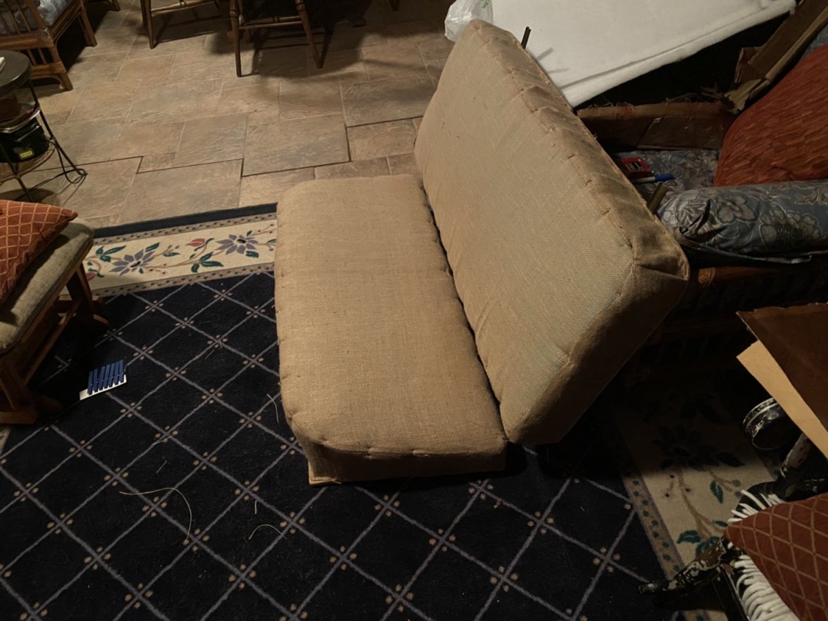

    Top of seat wrapped in burlap with foam underneath

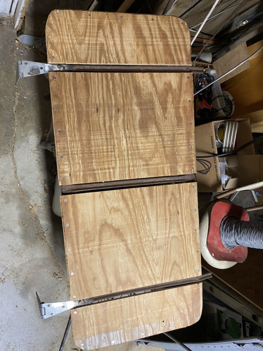

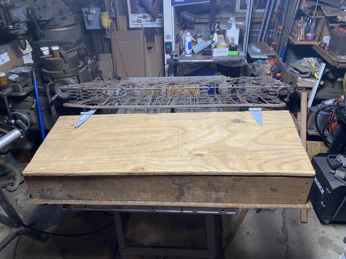

  6. And while the top pieces of wood were able to be screwed on, the bottom had to be approached differently. Here I used these little clips, about 50 of them attatched by self tapping screws to hold the wood to the springs and it’s metal frame
    Burlap stapled down and really gives it it’s shape. Next is to make the actual seat cover of the brown interior fabric

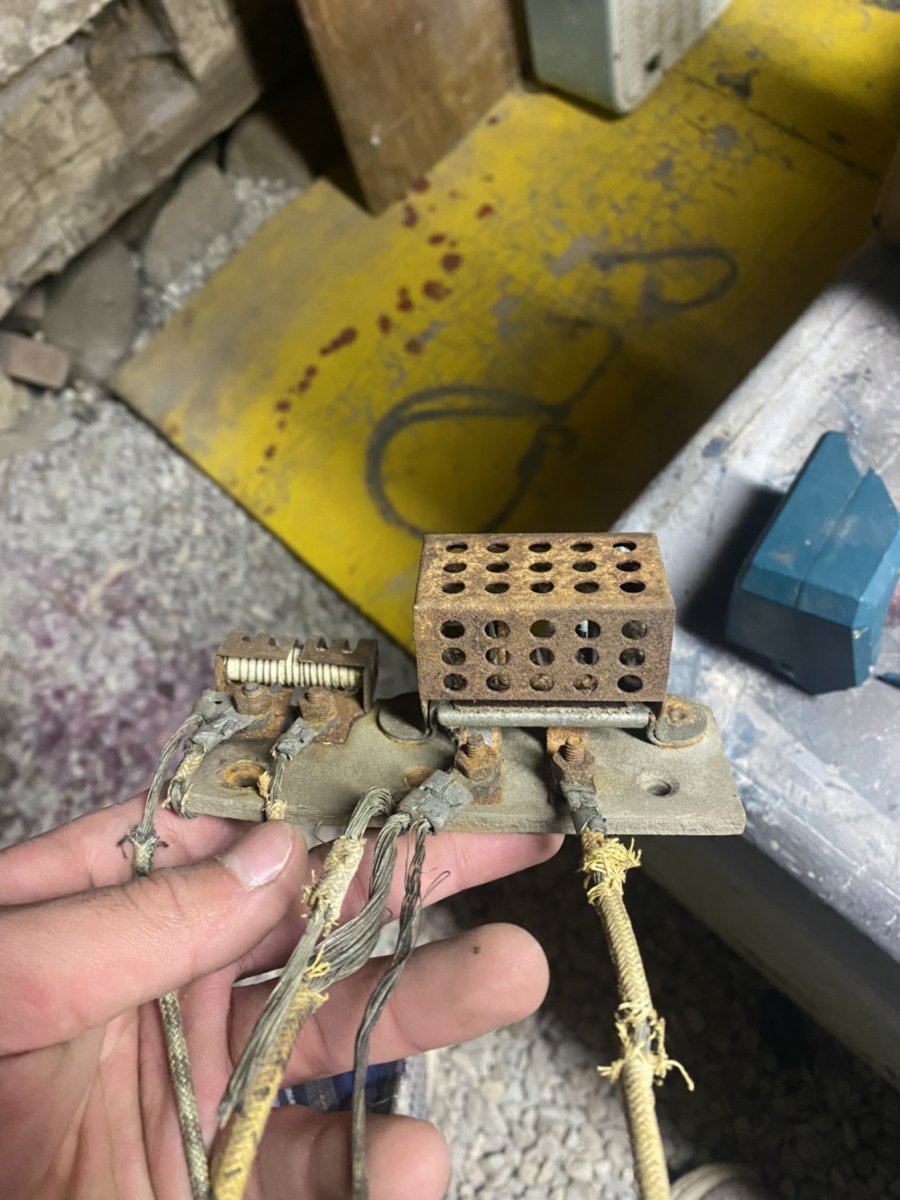

  10. As I investigate the electronics in the truck to gear up to do the work I was wondering what these electrical components are?
    View attachment 4889187 IMG_5801.JPG View attachment 4889187
    Let me know what you think. Trying to find wiring diagrams for a Flathead as well that maps out all the wiring so if you can link a wiring diagram or even point me in the right direction I would be very thankful
  11. vtwhead
    Joined: Oct 20, 2008
    Posts: 5,362
    vtwhead
    Are you doing 6 or 12 volt?
    Christopher Miller likes this.

  13. rusty valley
    Joined: Oct 25, 2014
    Posts: 4,514
    rusty valley
    your part in question, on the left, the small one is the resistor for the ignition wire to coil, the bigger thing is a circuit breaker
  14. I will be converting This to a 12 volt

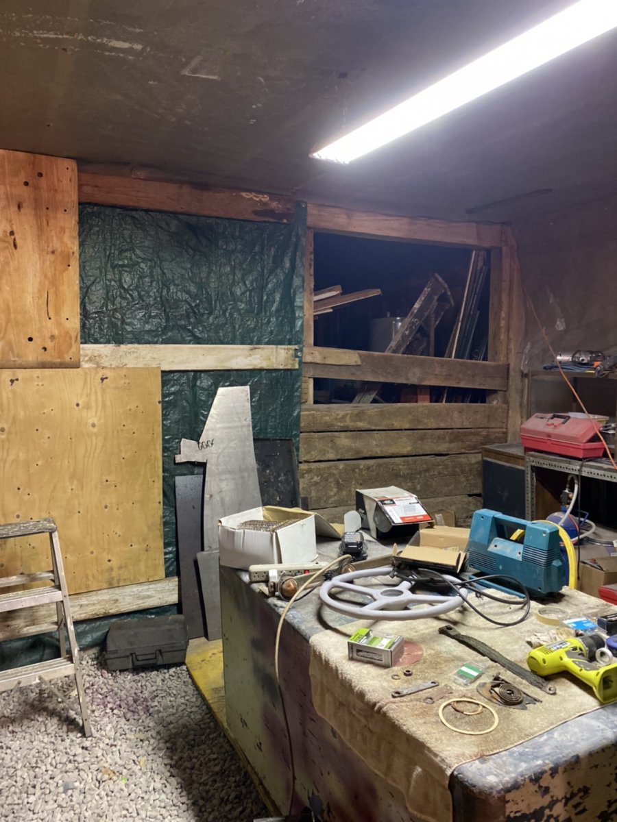

  20. Another thing that has been slowing me down that I knew but didn’t really connect is preparing my workshop as I get closer to winter. It’s right around the corner and I needed a space to work that wasn’t 5° like outside. Sooo... using tarp, s**** wood boards, and plywood to create some sort of wall around my workshop. Tarps to stop some wind. Plywood to back it up. Trying to keep wind and cold out so when I use heaters the heat doesn’t just go right out the walls. This is not huge but will make a huge difference to the progress of this build and how fast I can get it done. I’m a ****er to cold so I wouldn’t get much done this winter otherwise. Workshop is a mess but here’s what I’ve done. I’m about 2/3rds of the way done with the walls and i don’t know about the ceiling but there’s tarp on a lot of it and a good base as it’s flooring for the upstairs. Praying this keeps some heat in this winter
    I’ll have to post a picture when I’m done to show I reorganized the mess I’ve created in this process lol

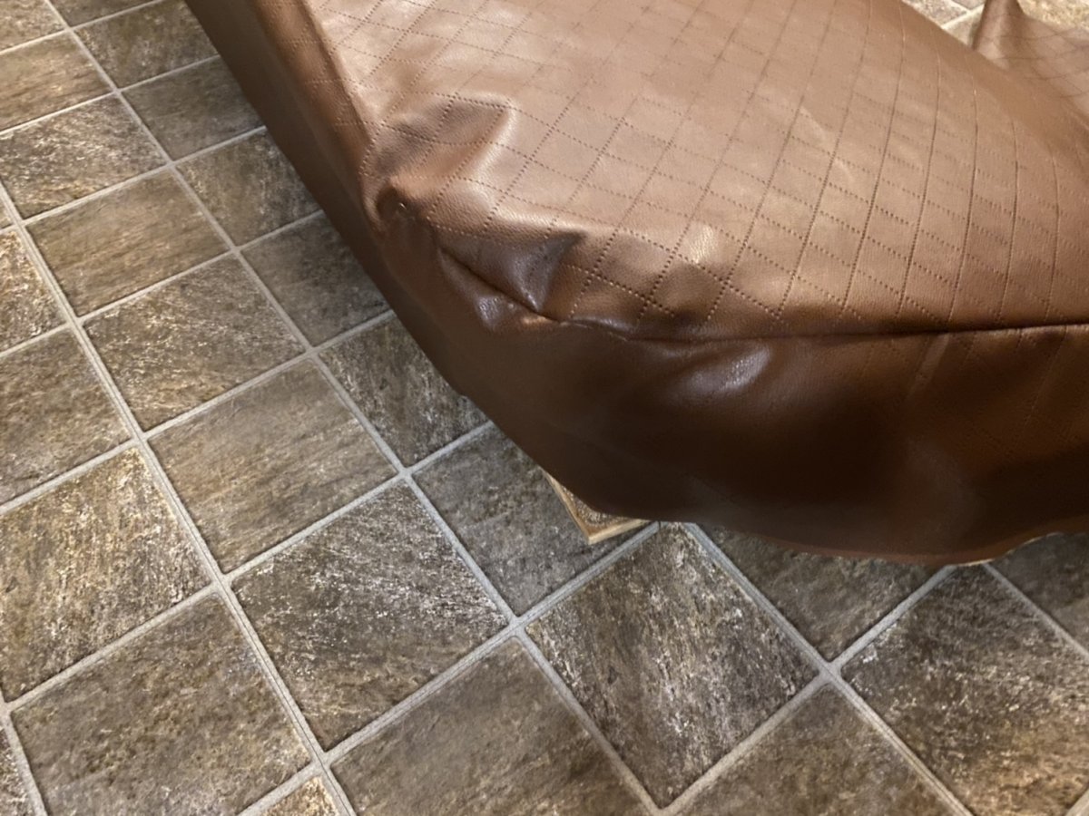

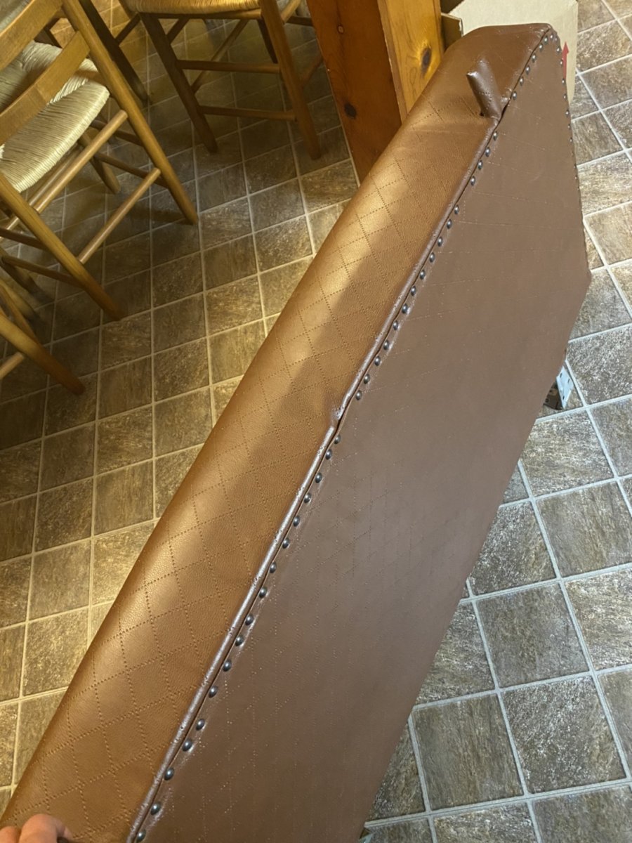

  22. Finished the top by putting in some upholstery nails to hold the back on. This is a wrap for the top of the seat. Here’s how it turned out
    Now onto the bottom of the seat...

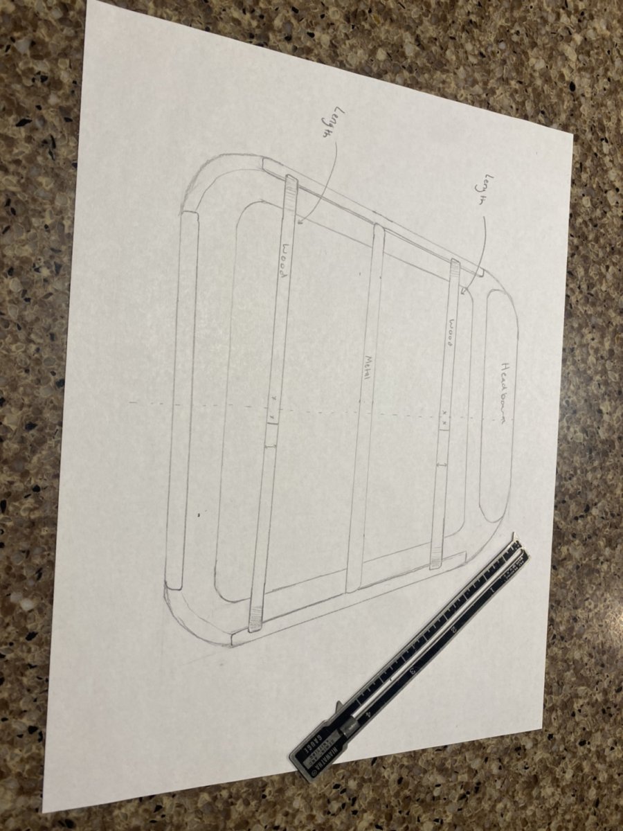

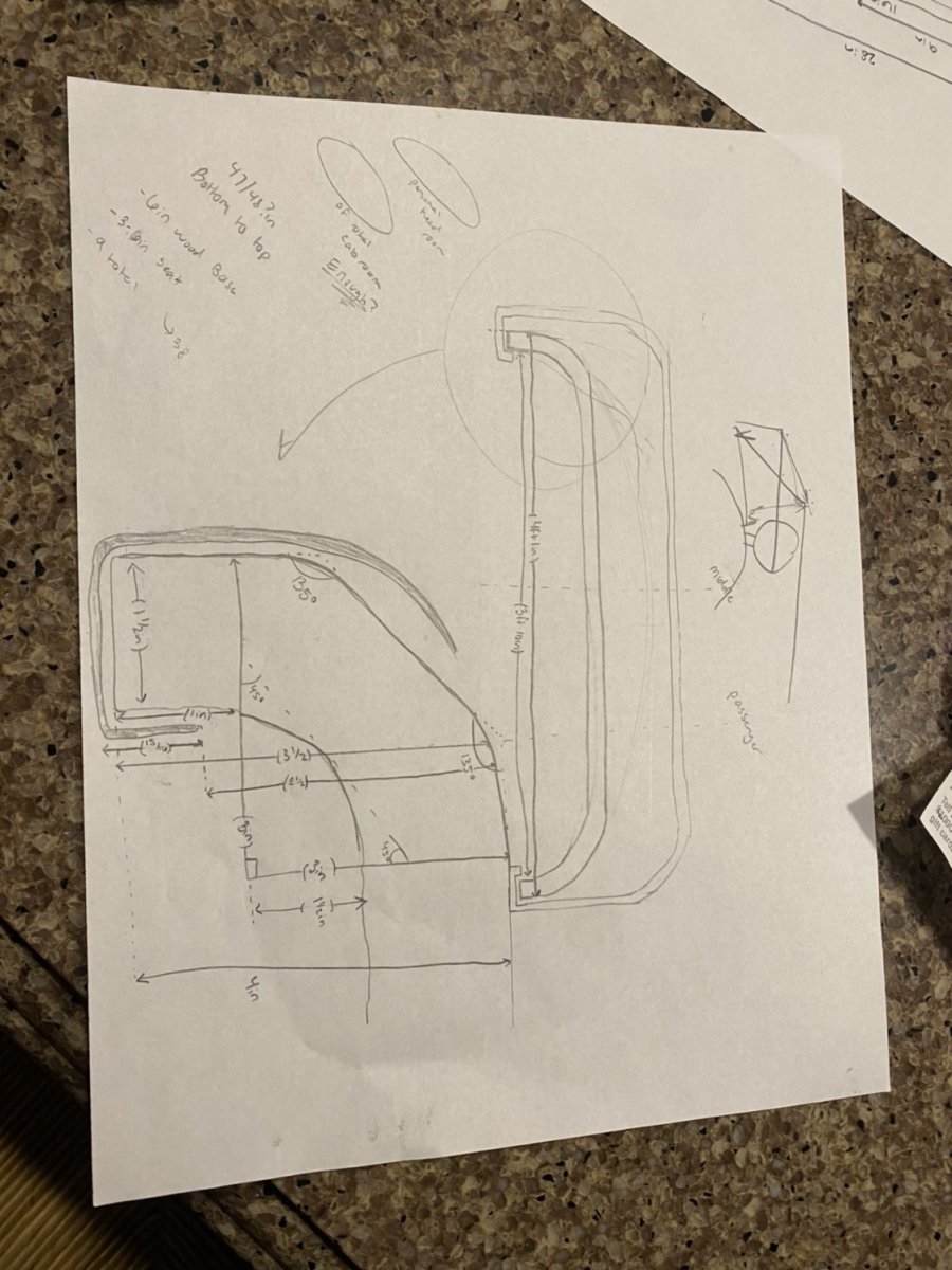

  23. Did a lot of planning of the headboard today
    Finding out I’m running out of headroom quickly so have to modify it a lot but I think I can make it work

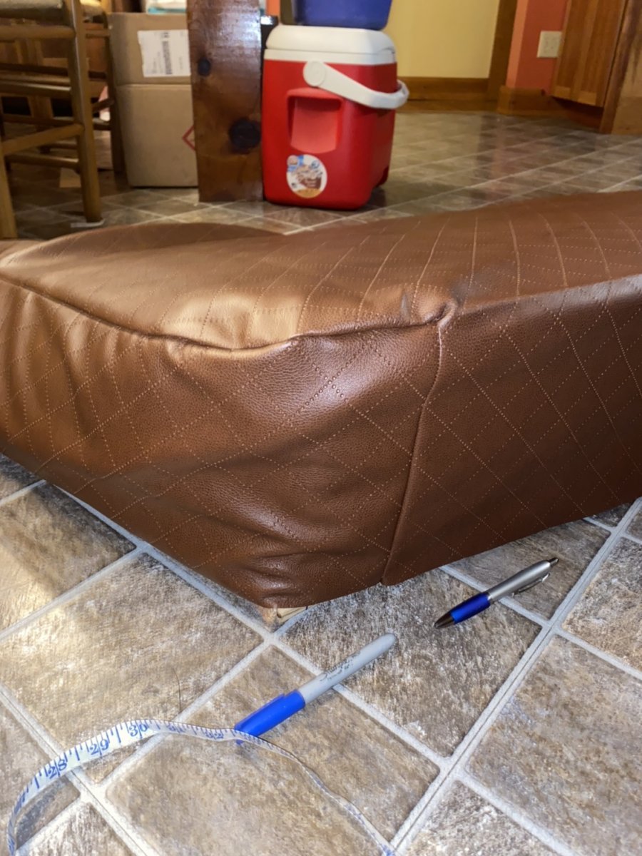

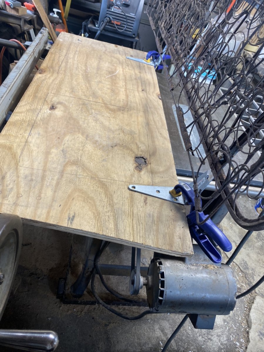

    Getting the bottom planned out. Dad helped with the last one but taking the forefront on this one, praying for the best. Went back to the seat because I’d really like a good measurement of headroom when making the headliner. Concerned for lack of headroom and things like that.

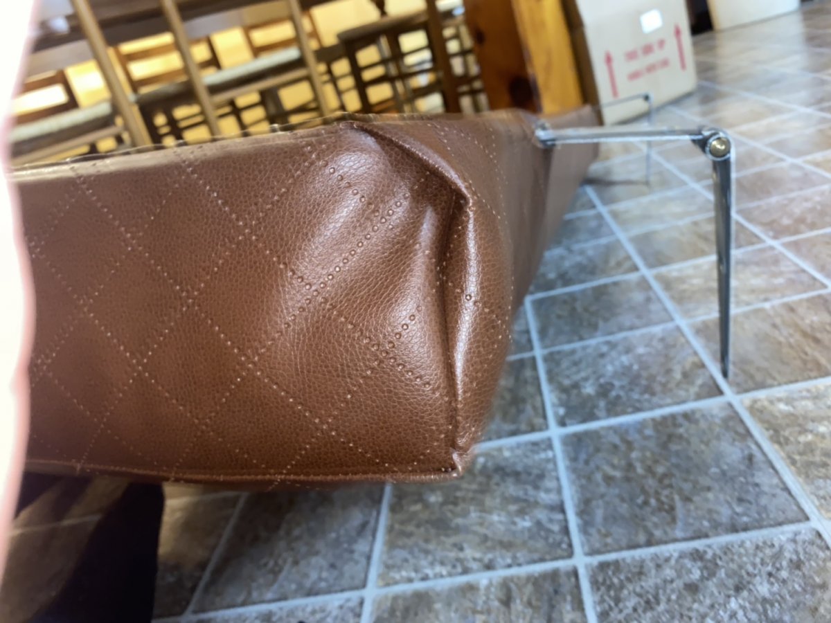

    One corner done, had a lot of complications leading up to this point. Going to go do the other side next

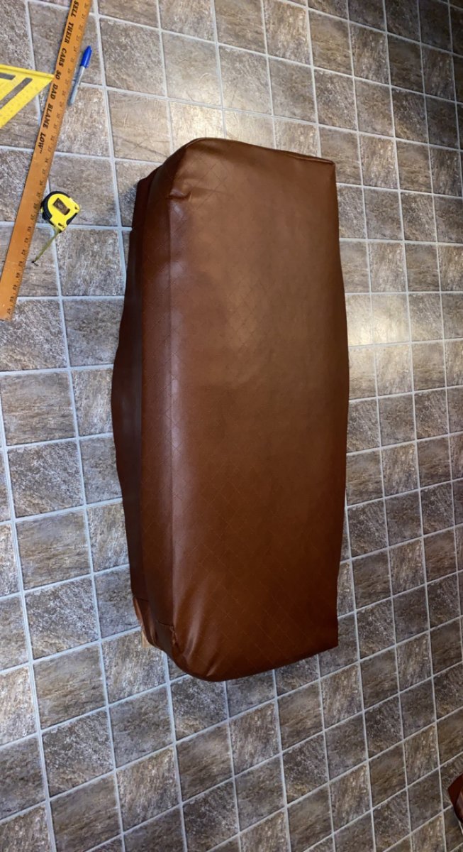

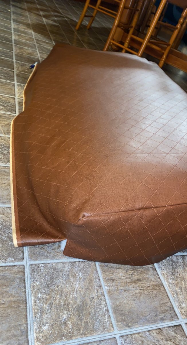

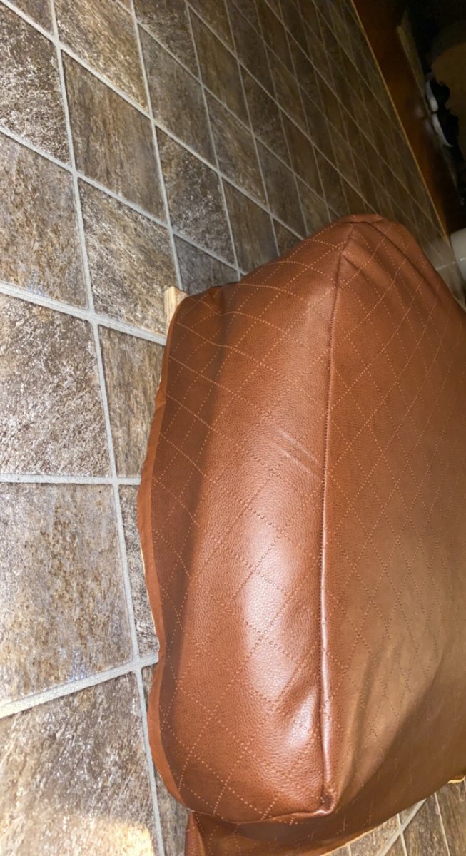

  27. Wrapped up all the corners and ready to staple it down. Simpler design than the top and easier to do as I didn’t have all sides to cover. I’ll try to get to stapling tomorrow to show you guys. I think it’ll shape out pretty well, really hoping for no creases.
    rusty valley likes this.

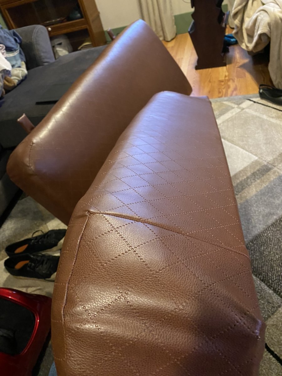

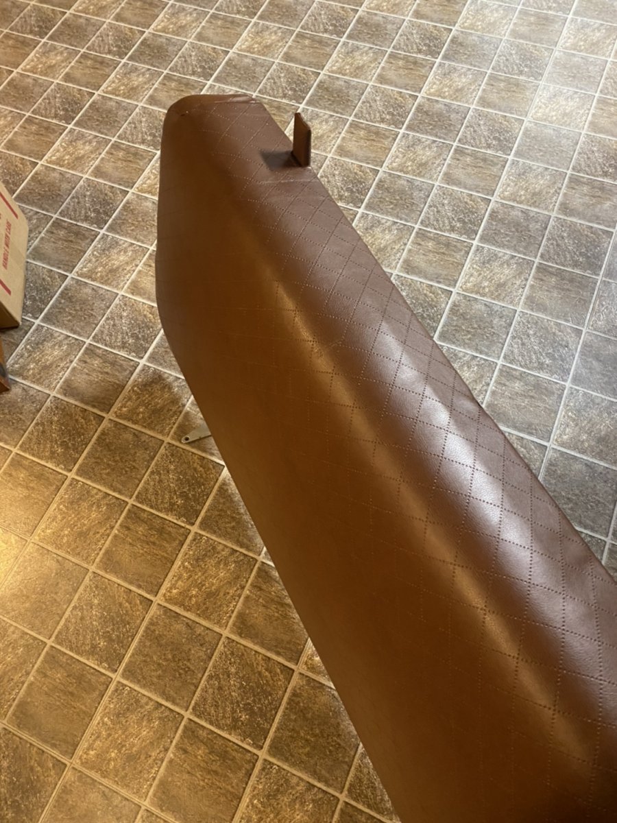

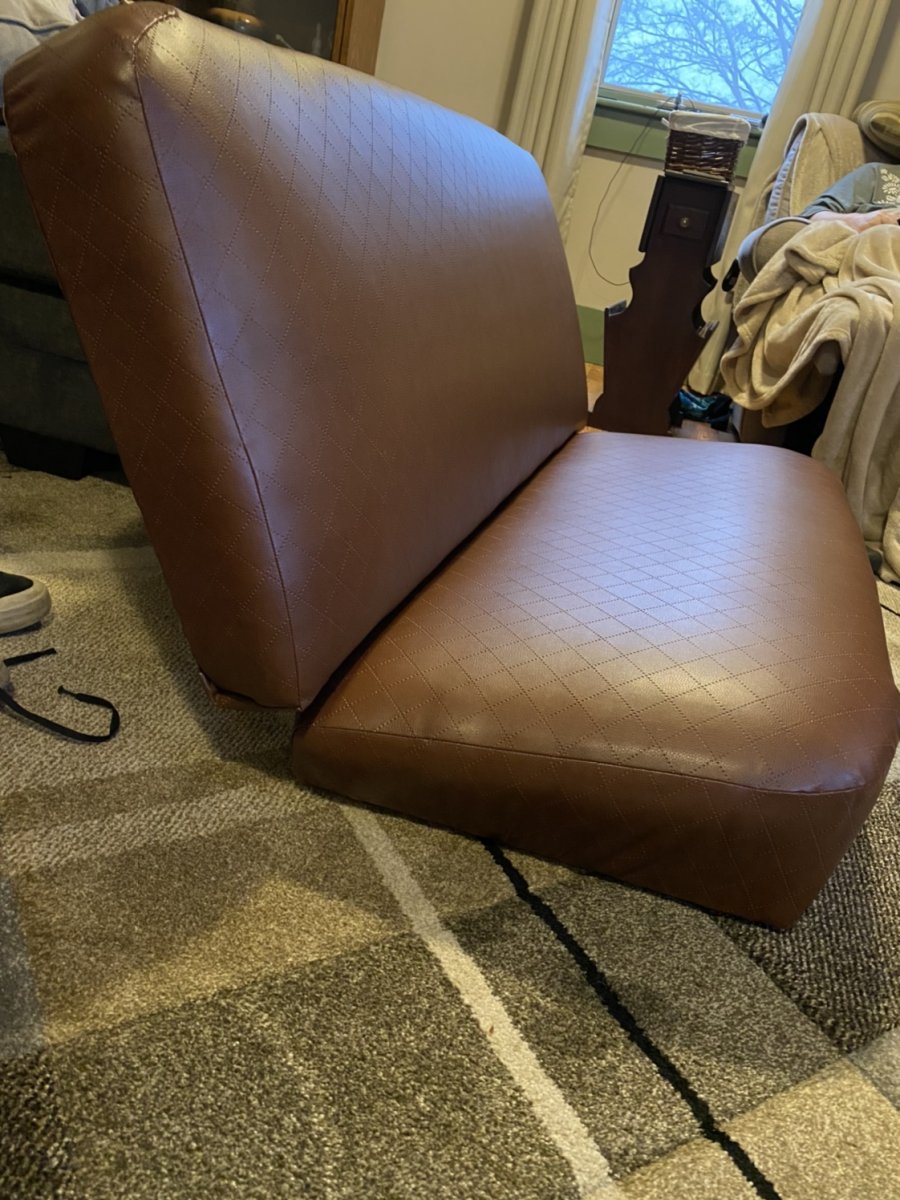

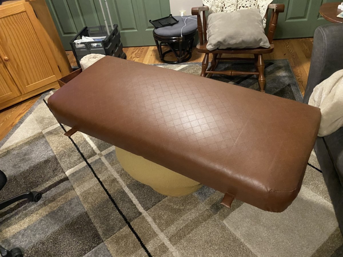

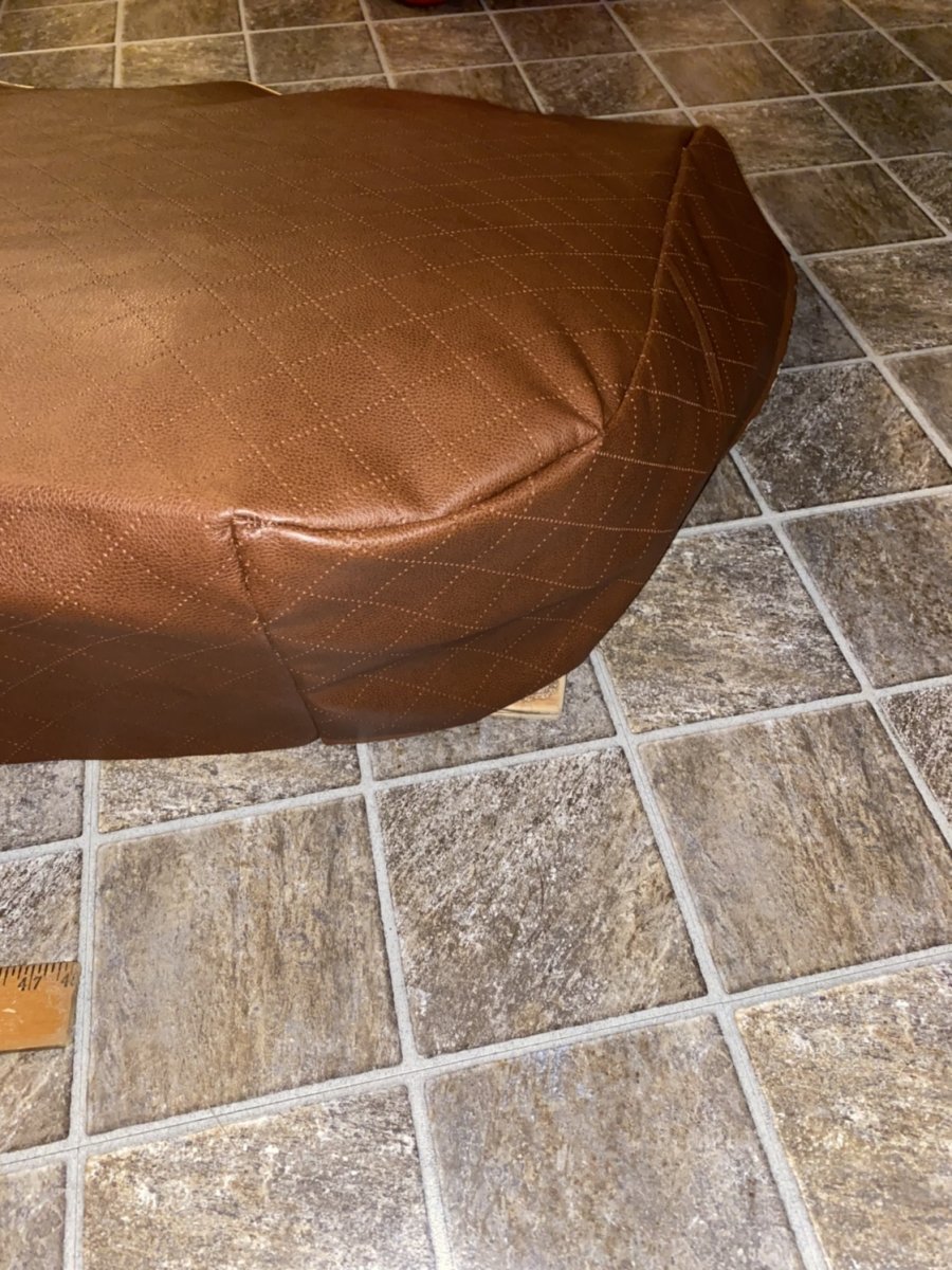

  29. Seat is wrapped up and ready to be bolted together and I have to say it’s both comfortable and appealing. Diamonds go all the same direction from top to bottom and are not conflicting anywhere. Little to no bunches and overall very pleased with the turnout
