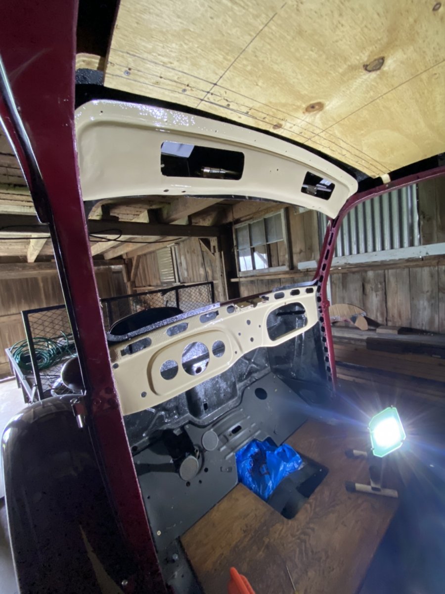

  3. More headliner stuff going down today
    All the bracing is done and ready for headliner to be either fastened to or stapled to! Exciting stuff.

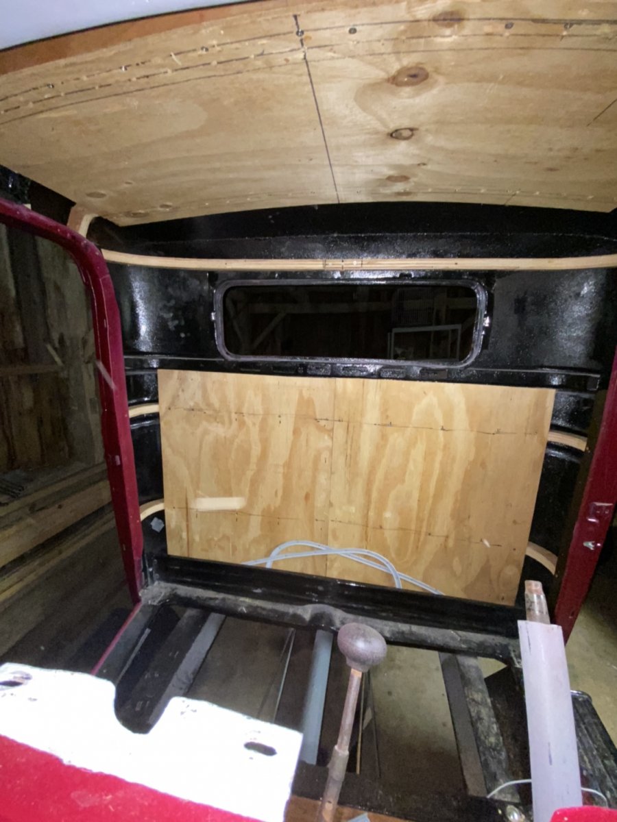

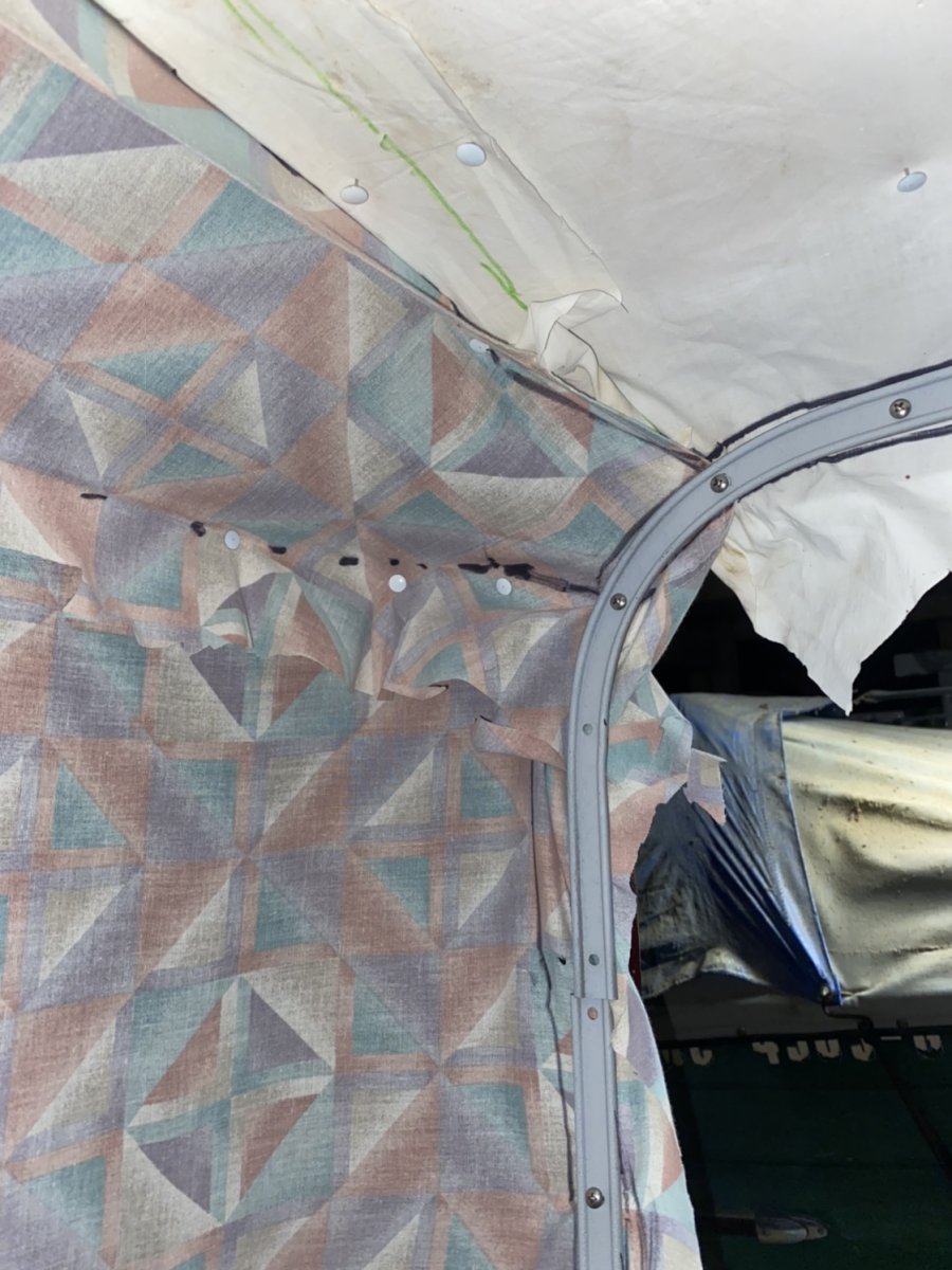

  4. IMG_7520.JPG IMG_7523.JPG IMG_7527.JPG IMG_7528.JPG IMG_7531.JPG IMG_7529.JPG
    Just a mock up from old sheets and I’ll use these as templates. Everything came out really well and good I only have to make 3 s***ches. This should be a fun process. Stressful if it doesn’t go in right but I should be okay

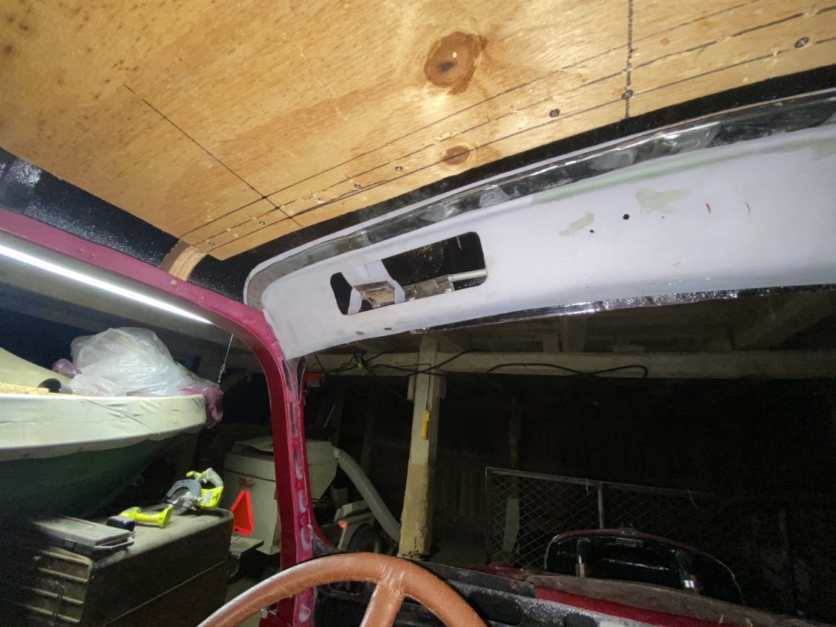

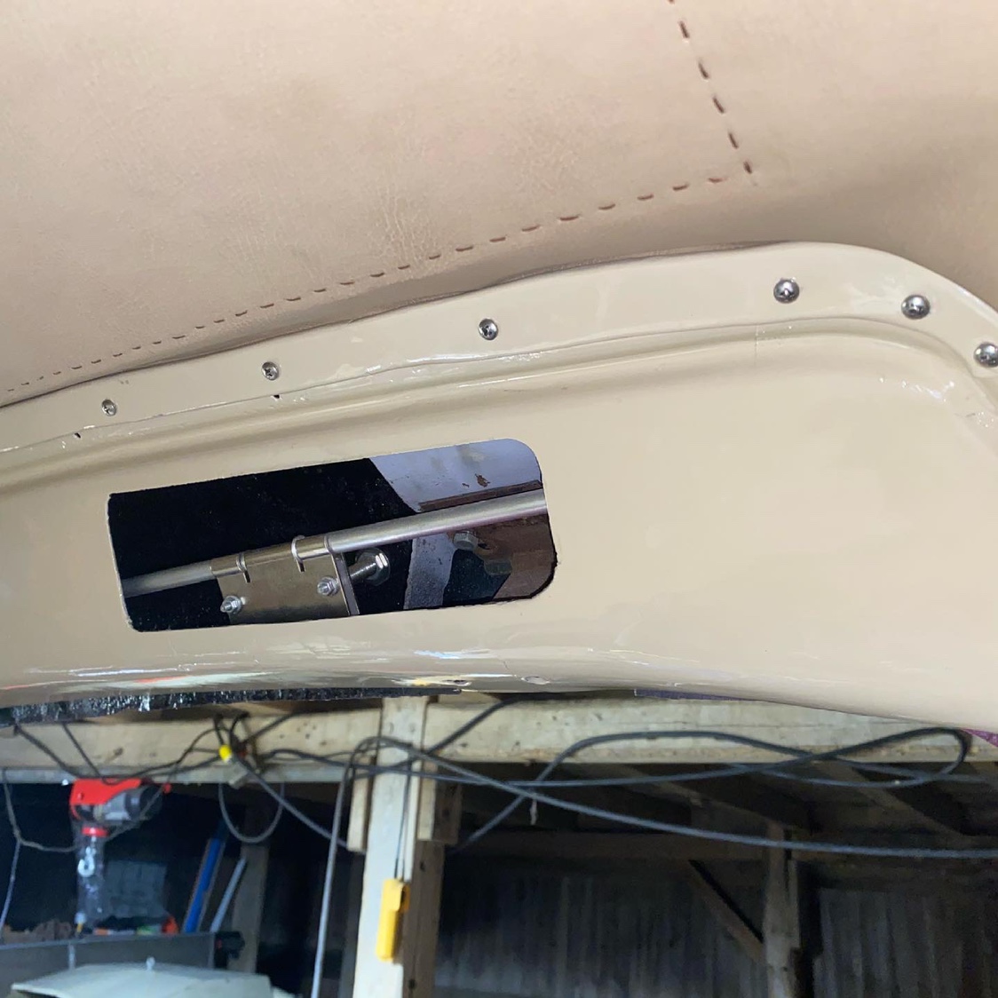

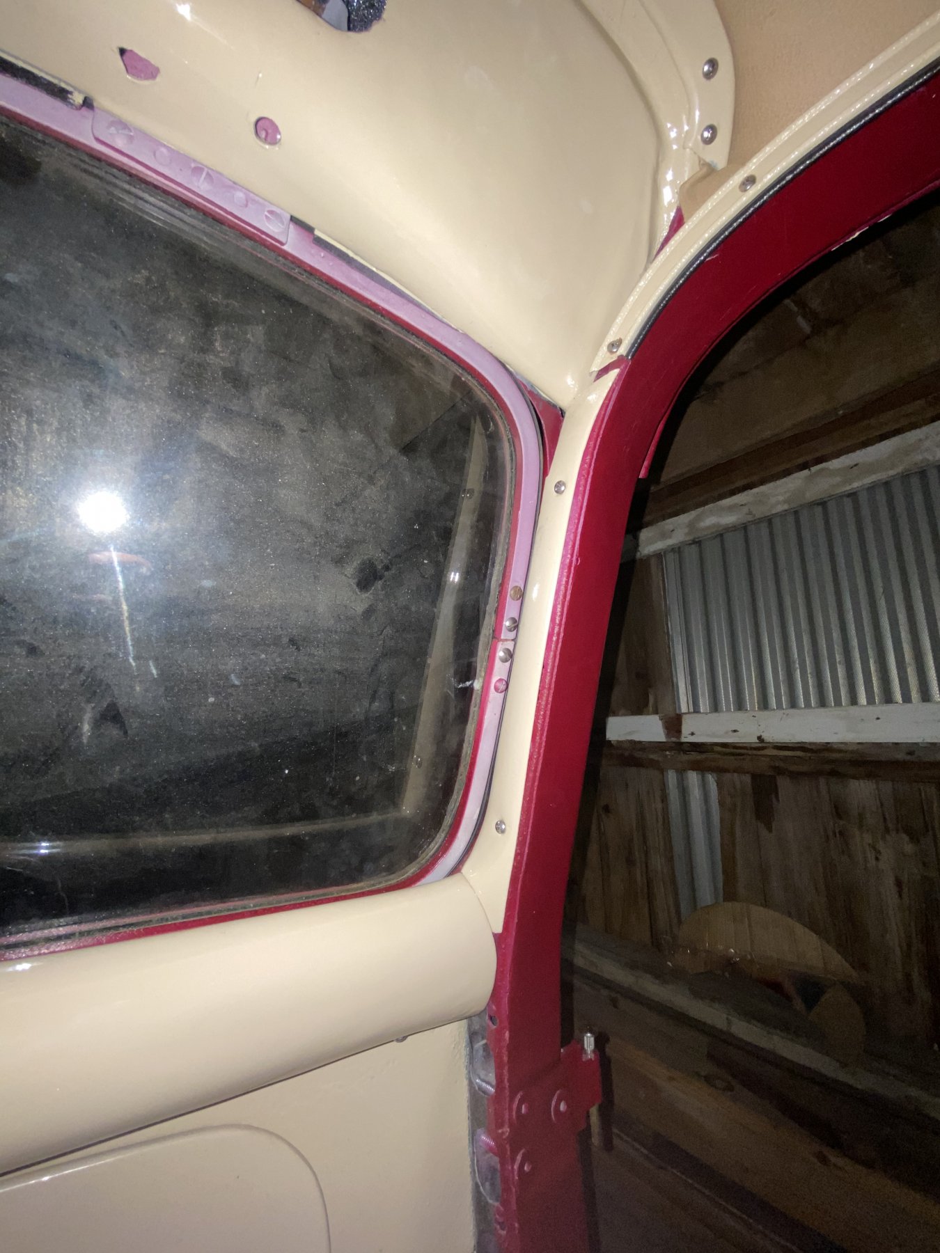

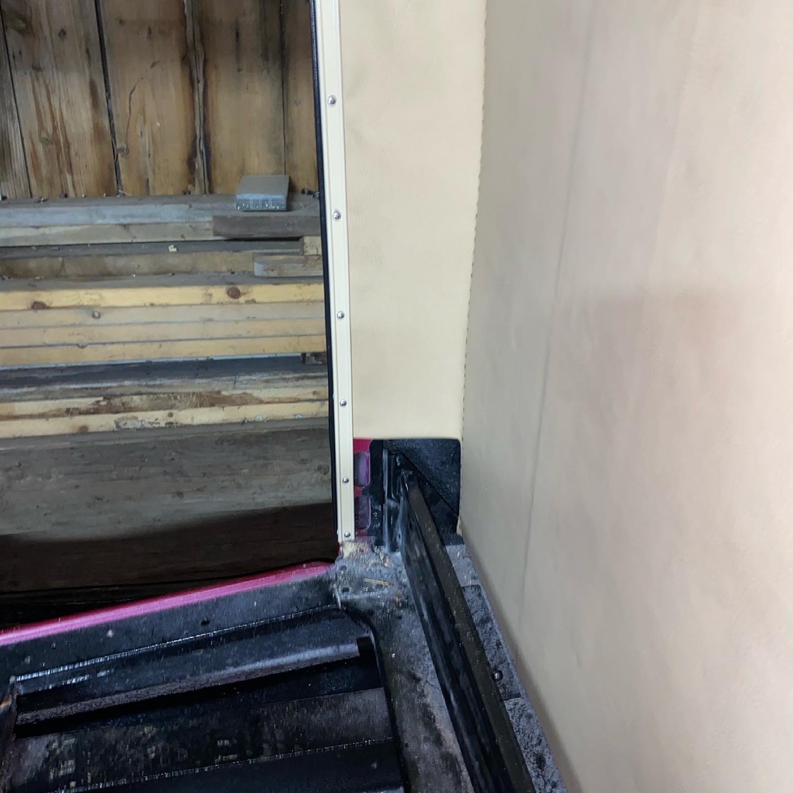

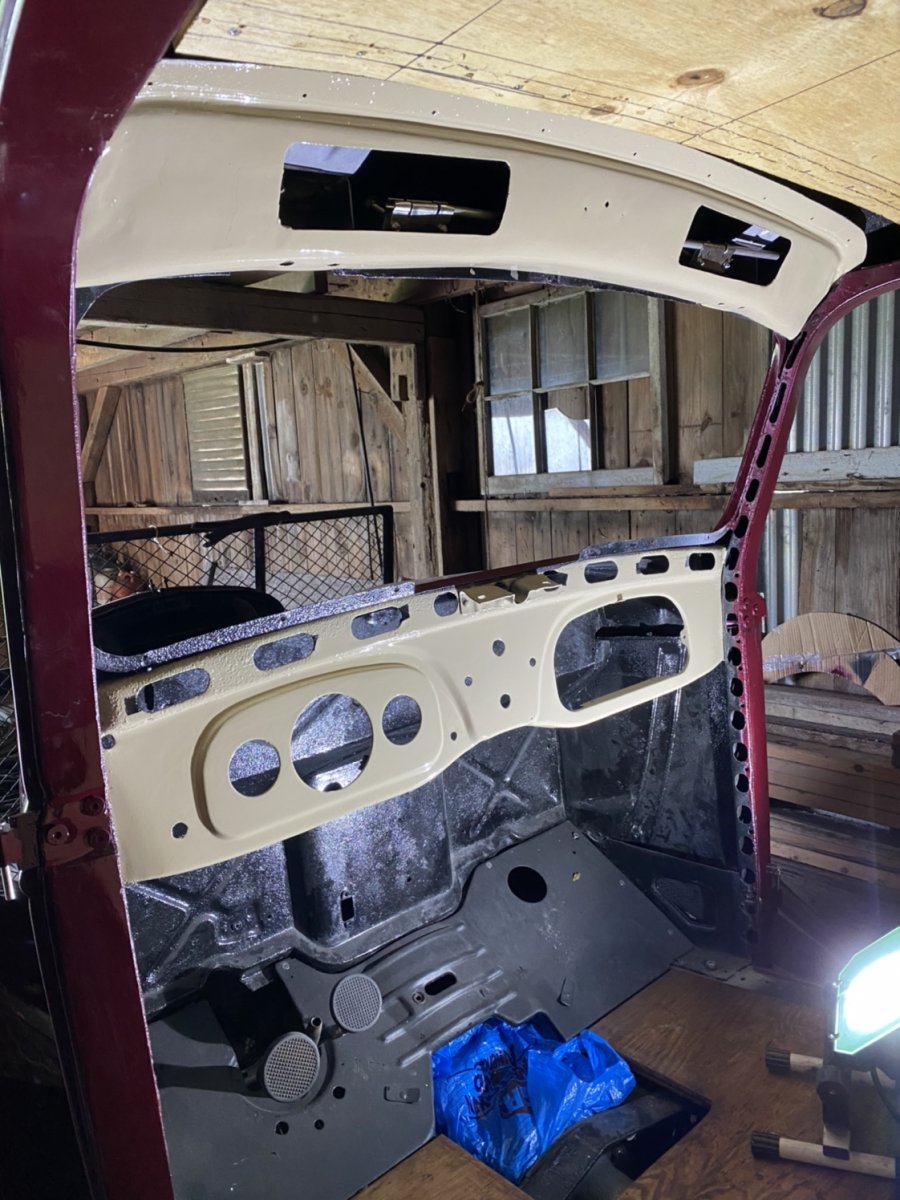

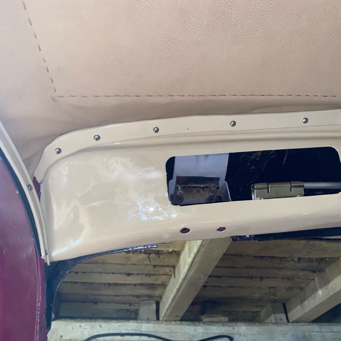

    Needed to make this trim piece just like those around the doors. Not the prettiest piece yet but I have it made up and I’ll weld it next and shape it more to make it more appealing hopefully. This ensures the headliner has a place to fasten to in the front by the headboard, previously I had nothing there at all.
    Some final things left is to finish this piece, do some body work to the headboard and the dash, then get the paint. I have Thursday off so potentially I can get the interior and trim paint then.

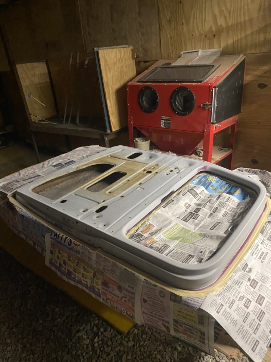

  7. Didn’t want to bore you all with the step-by-step on preparing for paint but long story short I painted all the interior pieces today and I’ll clear another day since it’s gotten late and I work in the morning.
    IMG_7747.JPG IMG_7751.JPG IMG_7757.JPG IMG_7758.JPG IMG_7759.JPG IMG_7760.JPG IMG_7763.JPG IMG_7765.JPG IMG_7768.JPG IMG_7769.JPG IMG_7770.JPG IMG_7771.JPG IMG_7772.JPG

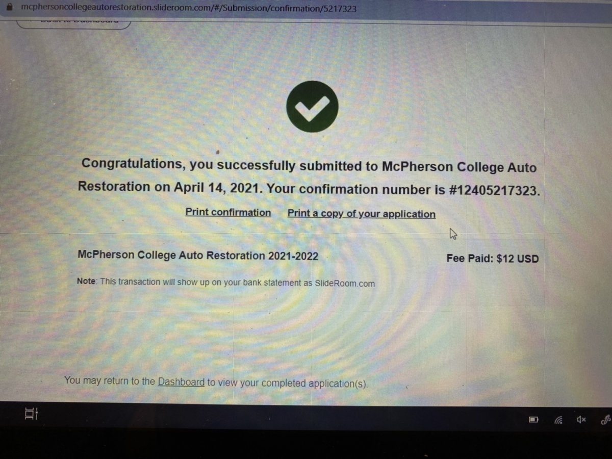

    It’s safe to say I’ll be headed to Kansas in the fall to study all there is to know about restoration!

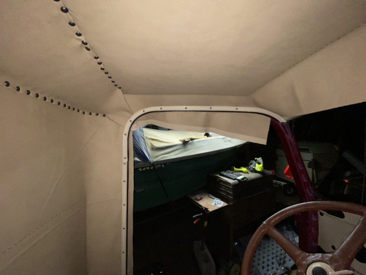

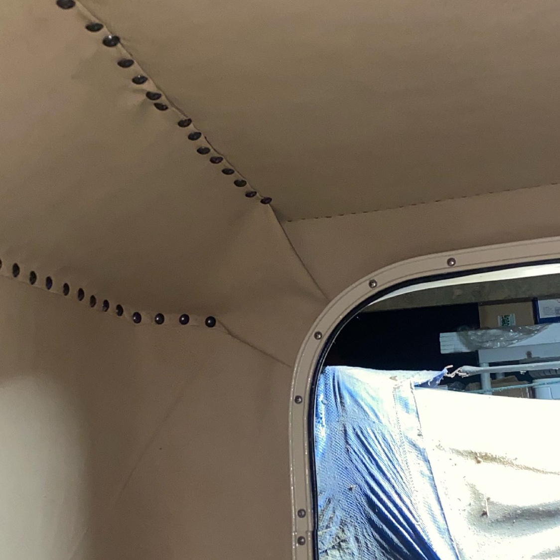

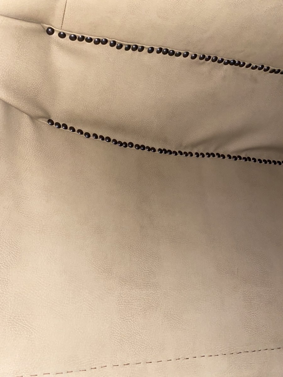

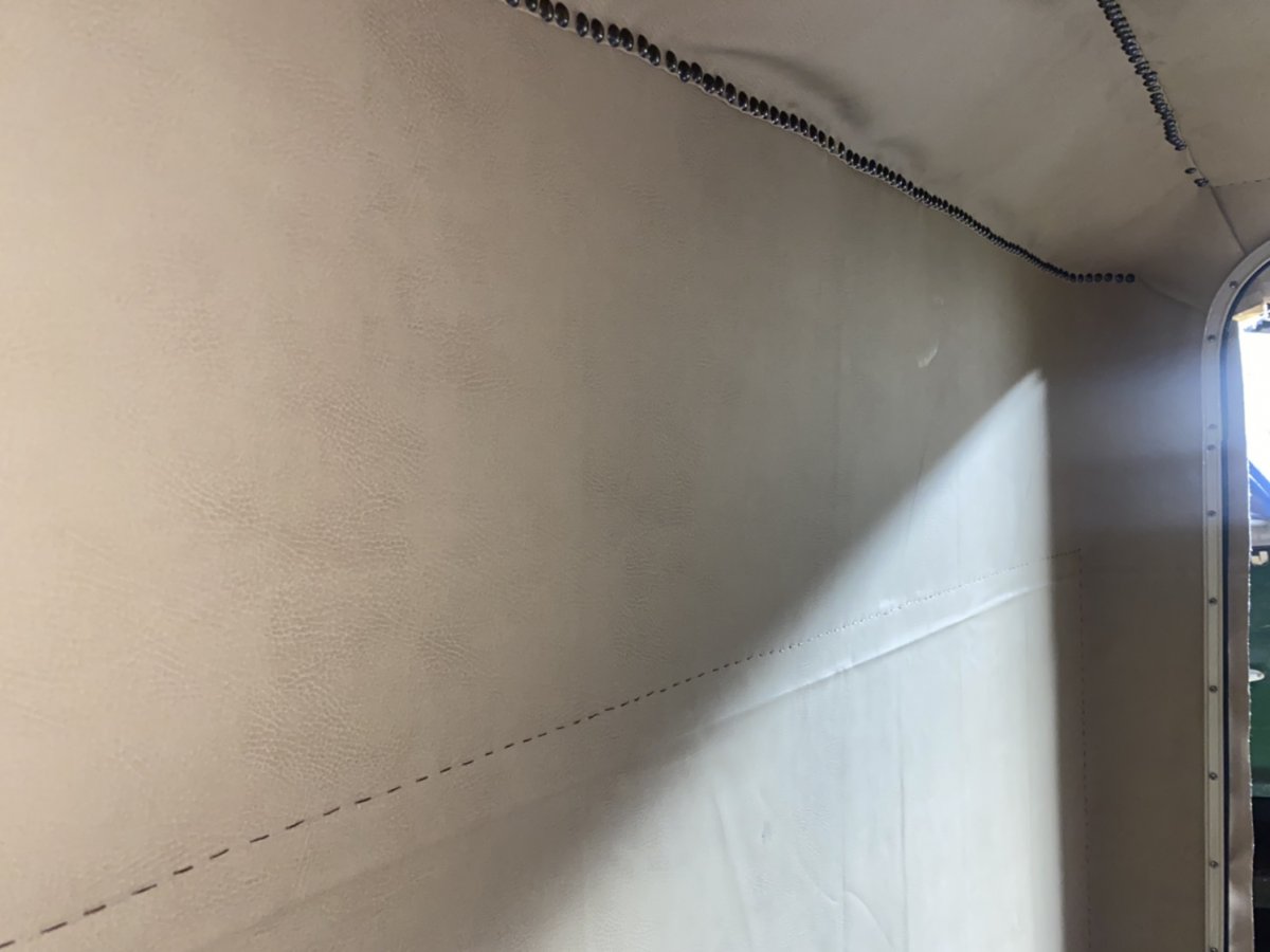

  18. I started and almost finished the headliner this evening. I didn’t get to putting the back window in yet, the trim above the headboard, and I ran out of upholstery nails for the back.
    I do have to say I am quite unpleased with how the nails went in as it’s not straight and they aren’t spaced well. Any tips or tricks to putting these in and having them look very clean? I can most definitely re-do this section and most likely will when the project is closer to an end and I can go back. Any advice will be appreciated since I don’t like as it stands and would like a better look.
    The last photo really shows how uneven the upholstery nails are and somehow I lost tension and it even just has some creases. Quite sloppy in my opinion and I know it can be done better but need some tips as to how to get the nails going in evenly spaced and well lined up.
    Thanks, Chris. IMG_8503.JPG IMG_8505.JPG IMG_8512.JPG IMG_8513.JPG IMG_8506.JPG IMG_8507.JPG IMG_8499.JPG IMG_8500.JPG

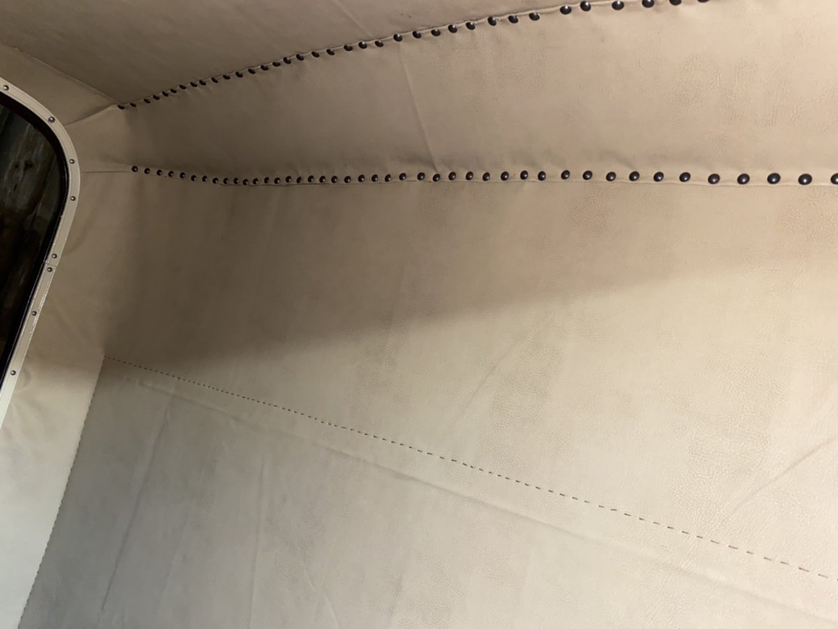

  20. Corrections were made and it looks much better. I spread out the pins more with an inch gap and marked a line to try and follow, it’s the best I can do at least for now. I’ll work on getting the front fastened next as well as the back window and trim
    rusty valley and '28phonebooth like this.
  21. Headliner is done and installed with exception to rear window trim and window. For a first time not too shabby. Things I don’t like which are understandable for my skill levels is my ability to ge the nails lined up perfect, and the front corners and getting the fabric to cover everything without wanting to crease. If you paid attention you’ll see I moved the nails further apart and I think it did a lot for how it looks.
    CA7C9941-1546-4713-B0C9-98867AAD437F.jpg 491BC9BA-2607-4721-94A1-C1DEB6B3AE5E.jpg 459D62CE-30D9-4308-A56E-A18A2B6B6C62.jpg 63DD3881-8486-406E-B74C-3084AEB88FCE.jpg 820DD110-C5DE-4050-9ACA-902C7E2E2E8C.jpg F8C95D78-B7BA-46CF-8101-876DCEF48AB0.jpg IMG_8556.JPG

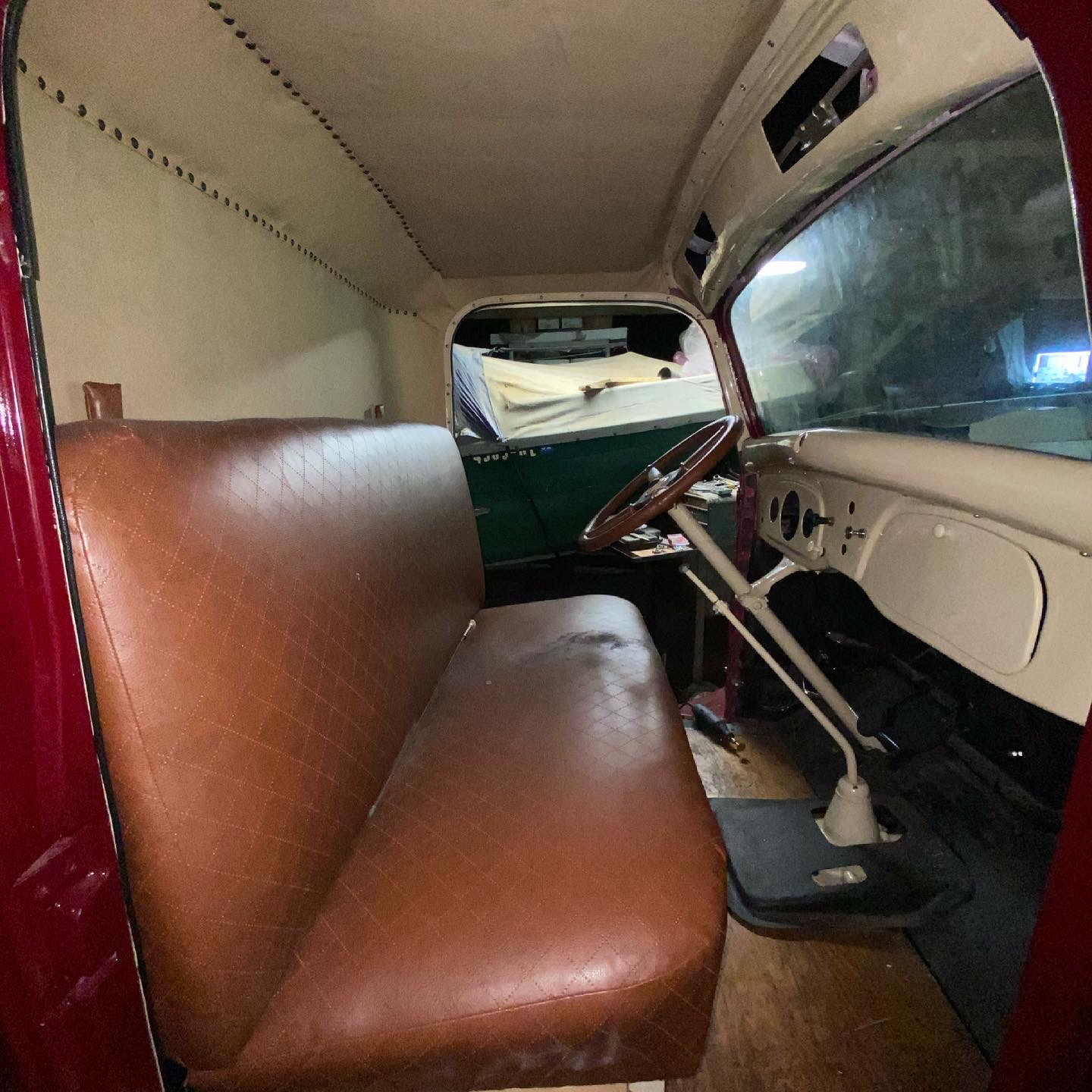

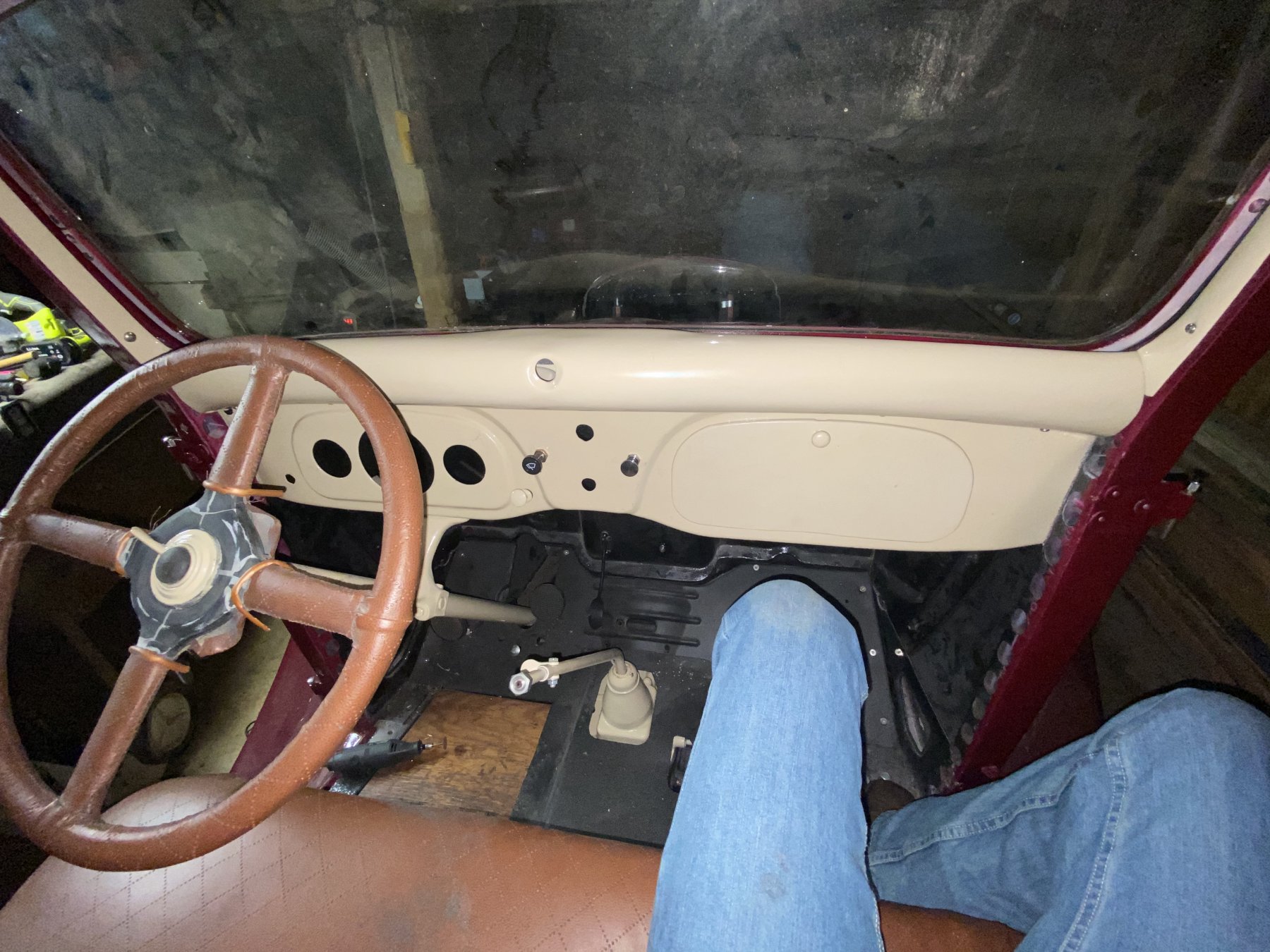

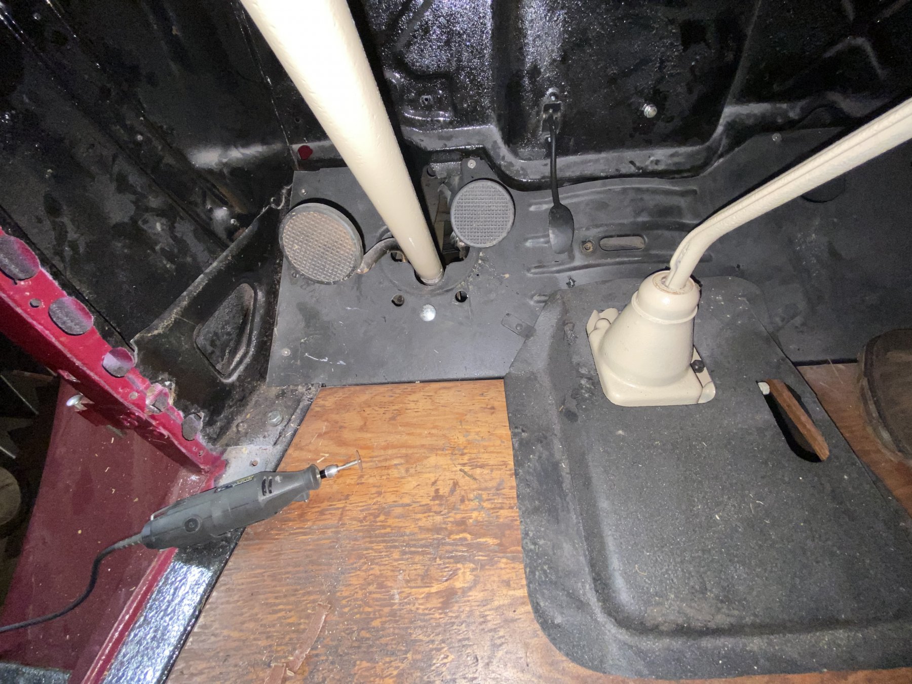

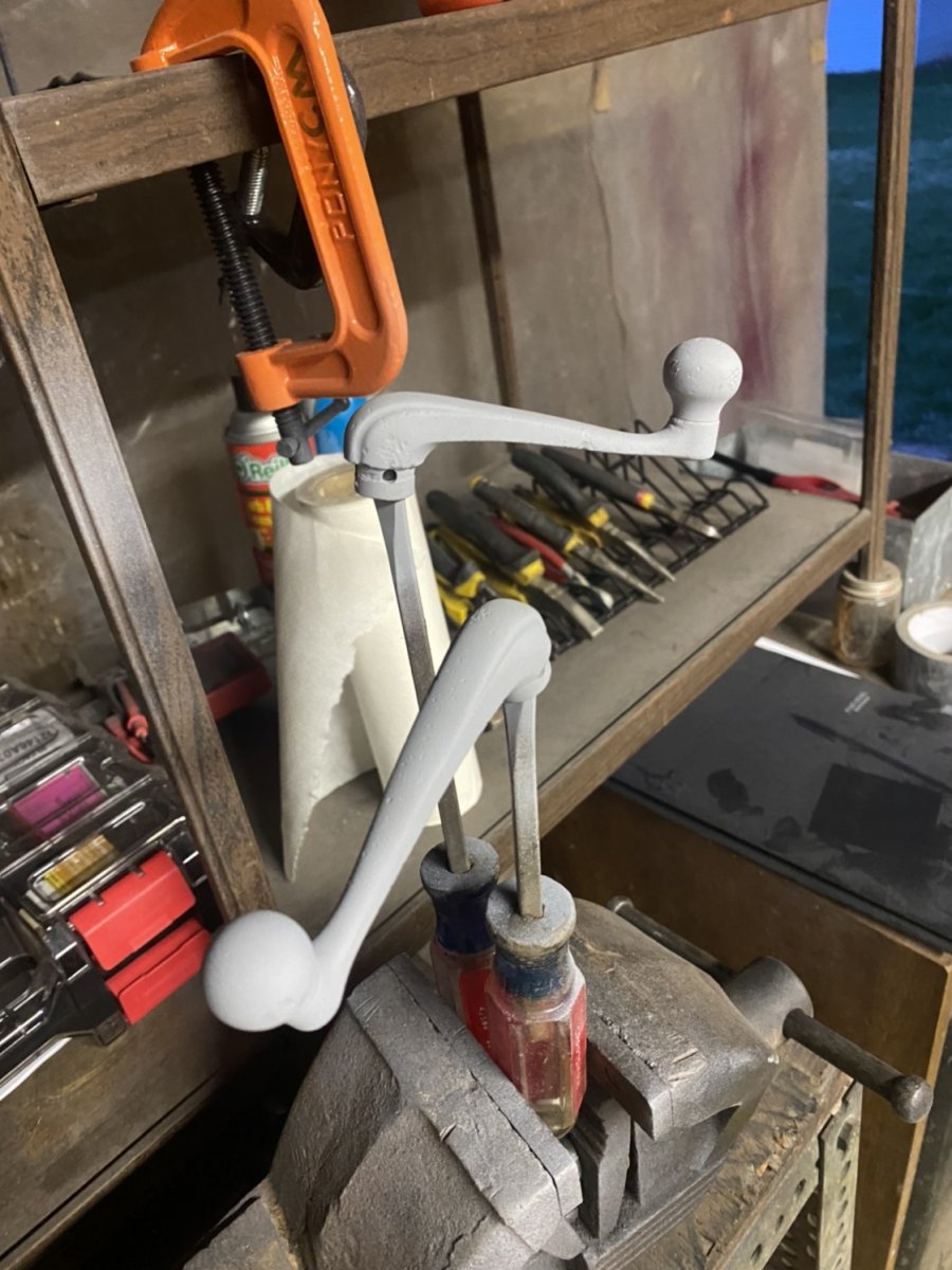

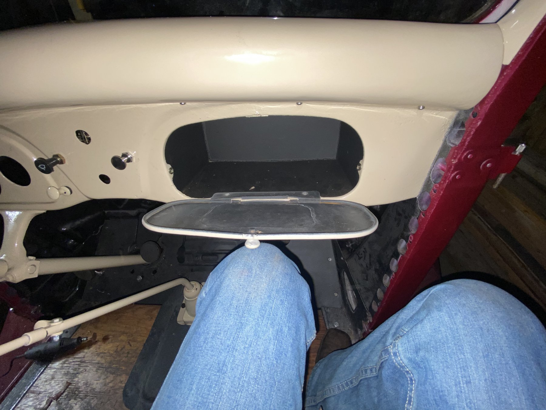

  23. 1FCA8ABF-6AE7-4A4F-B71F-C19153EE1F13.jpeg 49611D90-A35A-4E9E-ACB9-ADE03A955FF7.jpeg F7693A69-C70E-4B9D-B4FB-034554043C37.jpeg Can anyone confirm or deny if the H.A.M.B. app got shut down?? I haven’t been able to get on in days and it’s off the App Store. Anyways here’s an update to the truck. Trying to wrap up some interior stuff. Got the window put in and I’ll just have to wait for a mechanism to push it in and out because it hasn’t been anywhere. I just decided to ***emble it without and I can always just take it back apart. Dash is in, front window, glove box, throttle pedal, choke rod, shifter, and p***enger headlight.

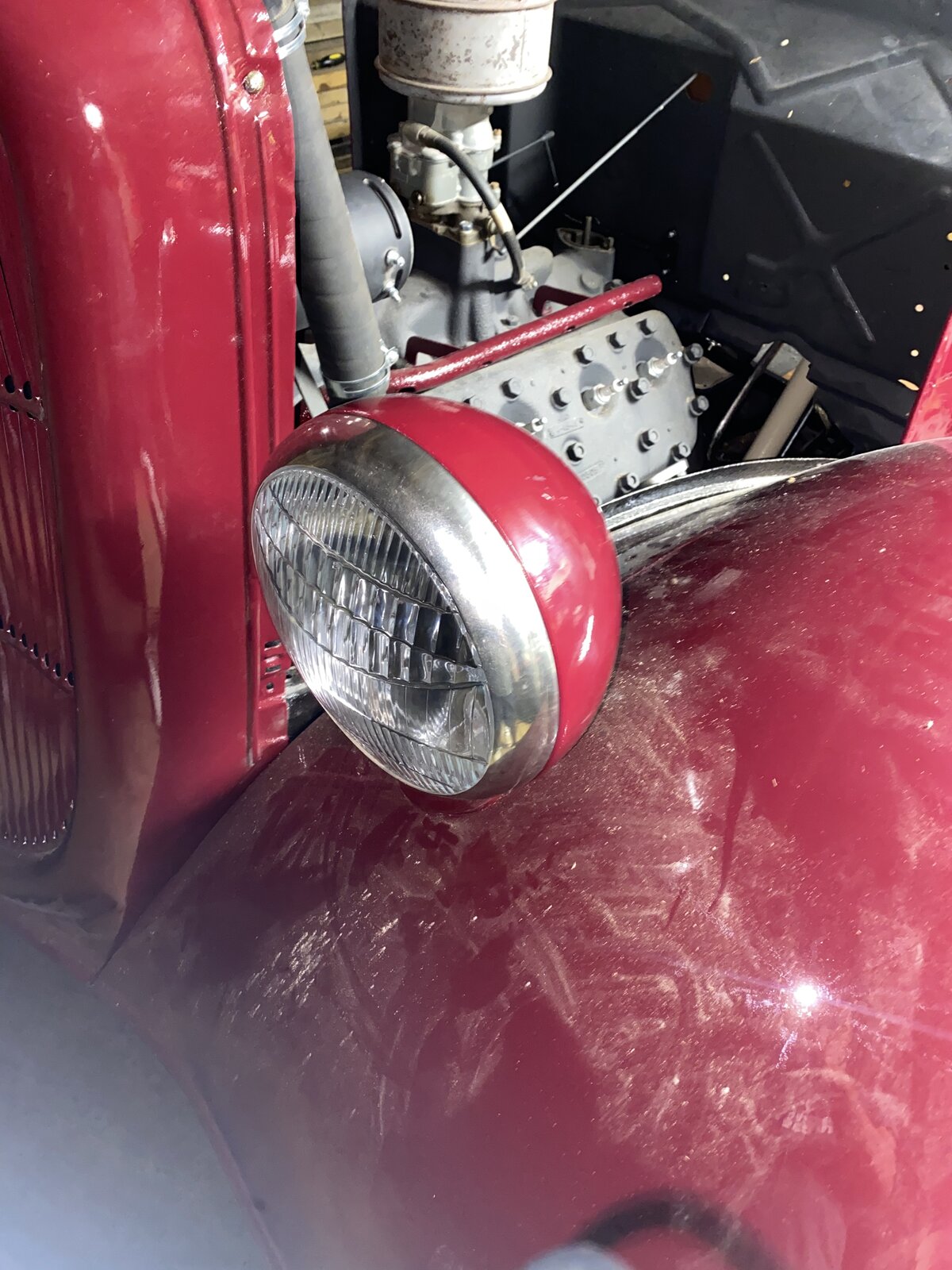

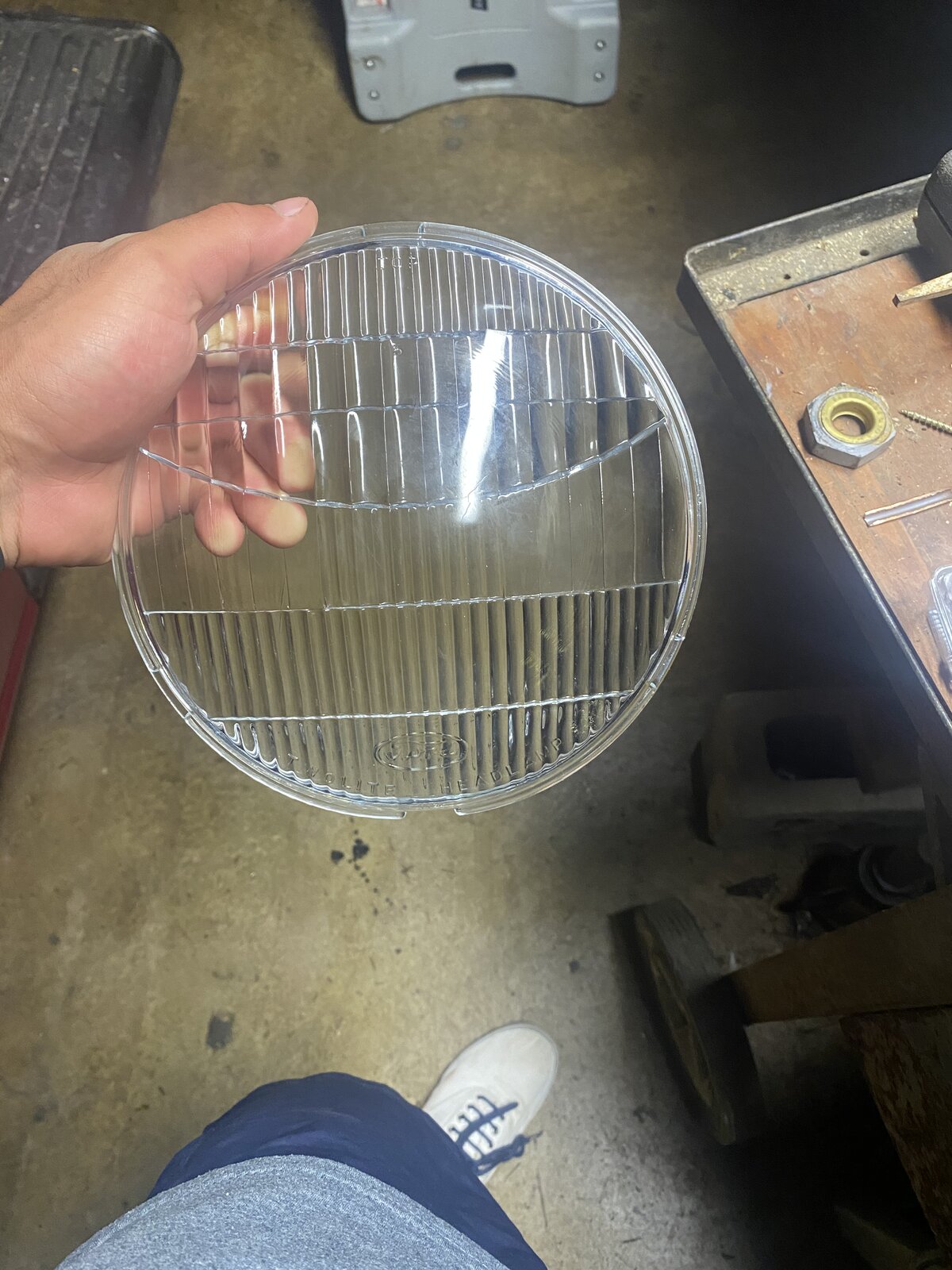

  27. 2BEA89D7-C645-49AD-AD27-DBF1C23870F9.jpeg 6556CBA2-5E4C-4D31-B03F-D5403949FDC9.jpeg Got a lot of parts today and hope to really start ****oning some things up. Here the headlights are installed with new Halogen light conversation.
