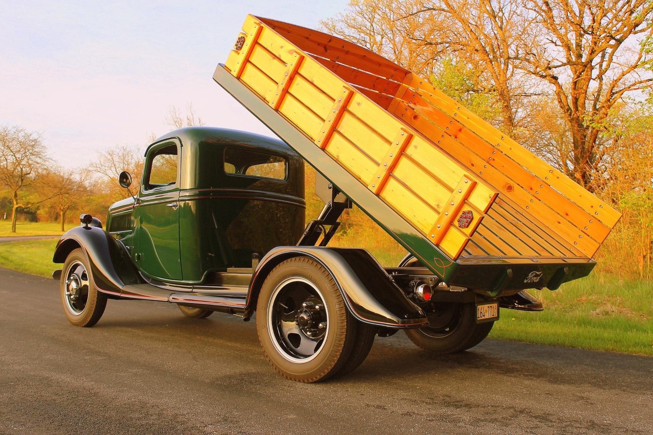

    I also was curious to find what kind of bed was typical to these trucks and i was able to find two different kinds. One being from a model 51 hydraulic dump bed (this truck was $795) and one with a wood and metal (this popular Stake style was less at $670)

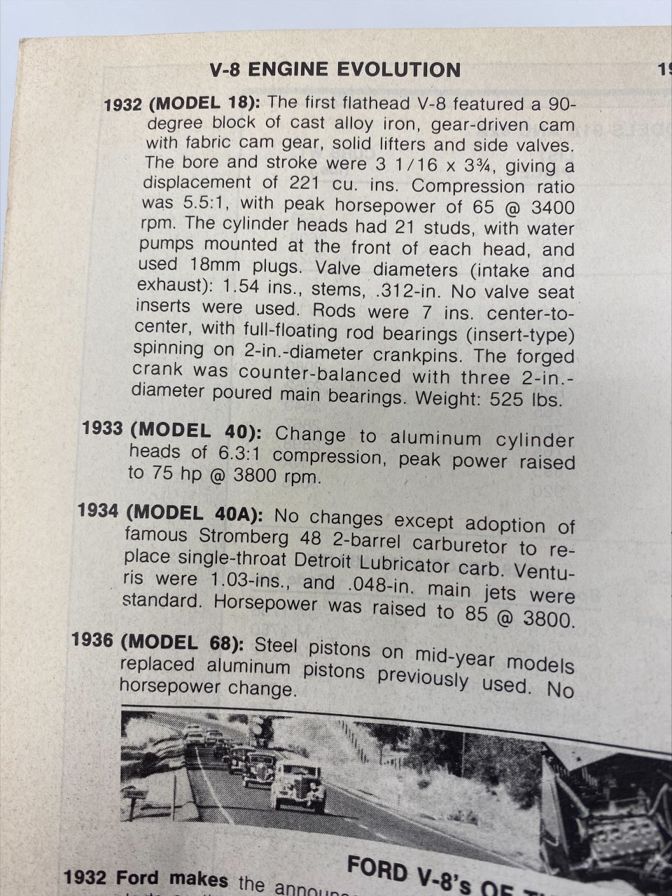

    (Engine info on the 1936 V8)

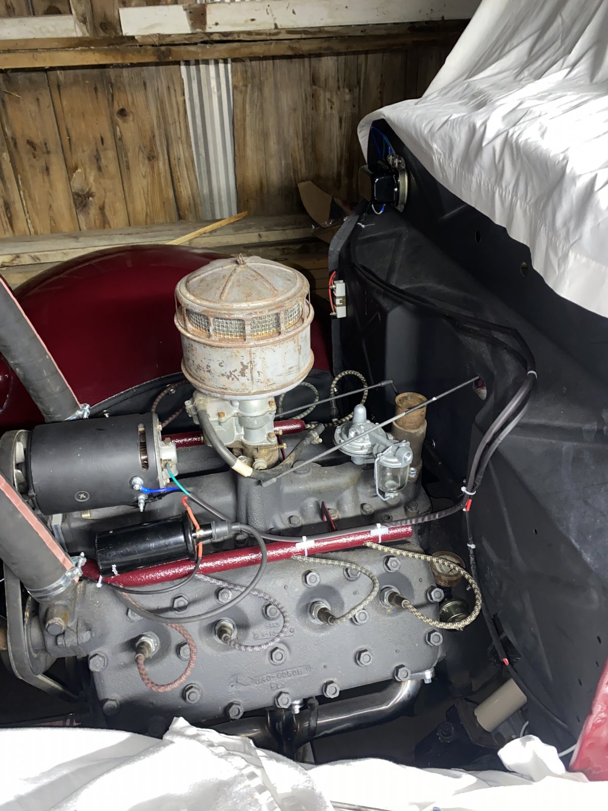

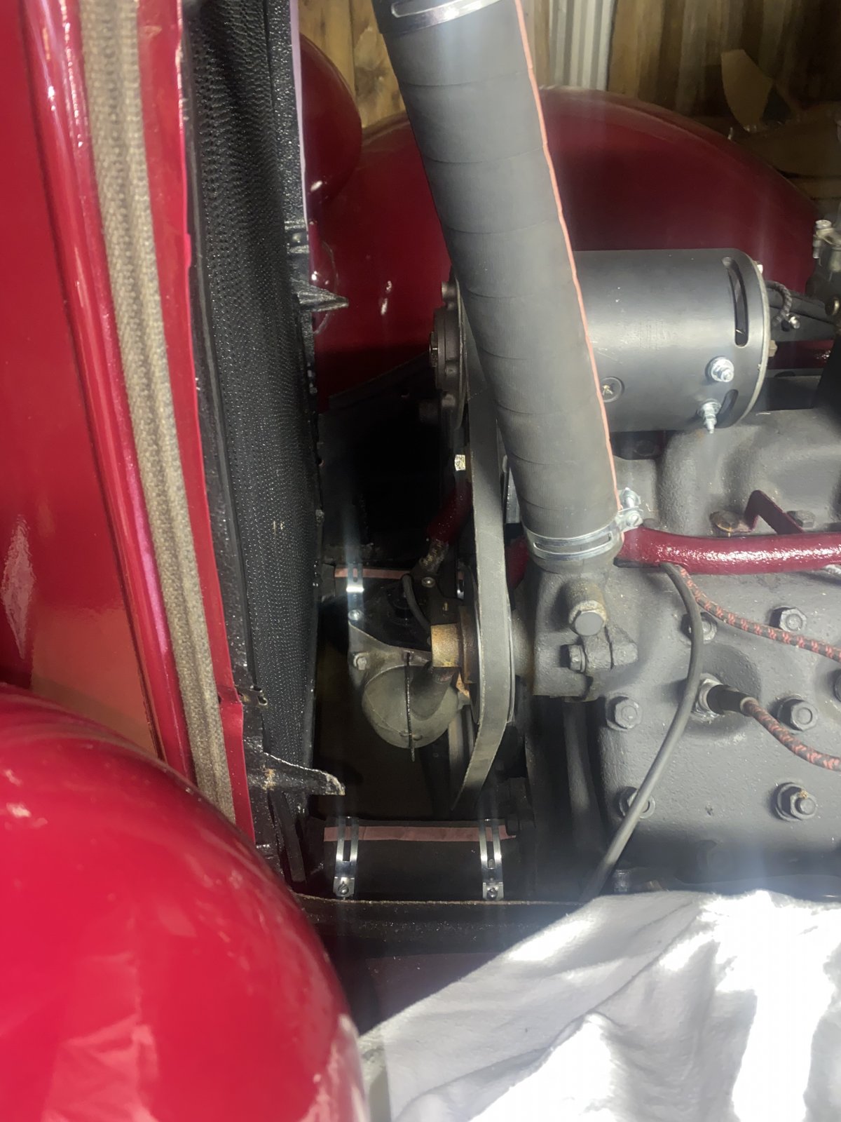

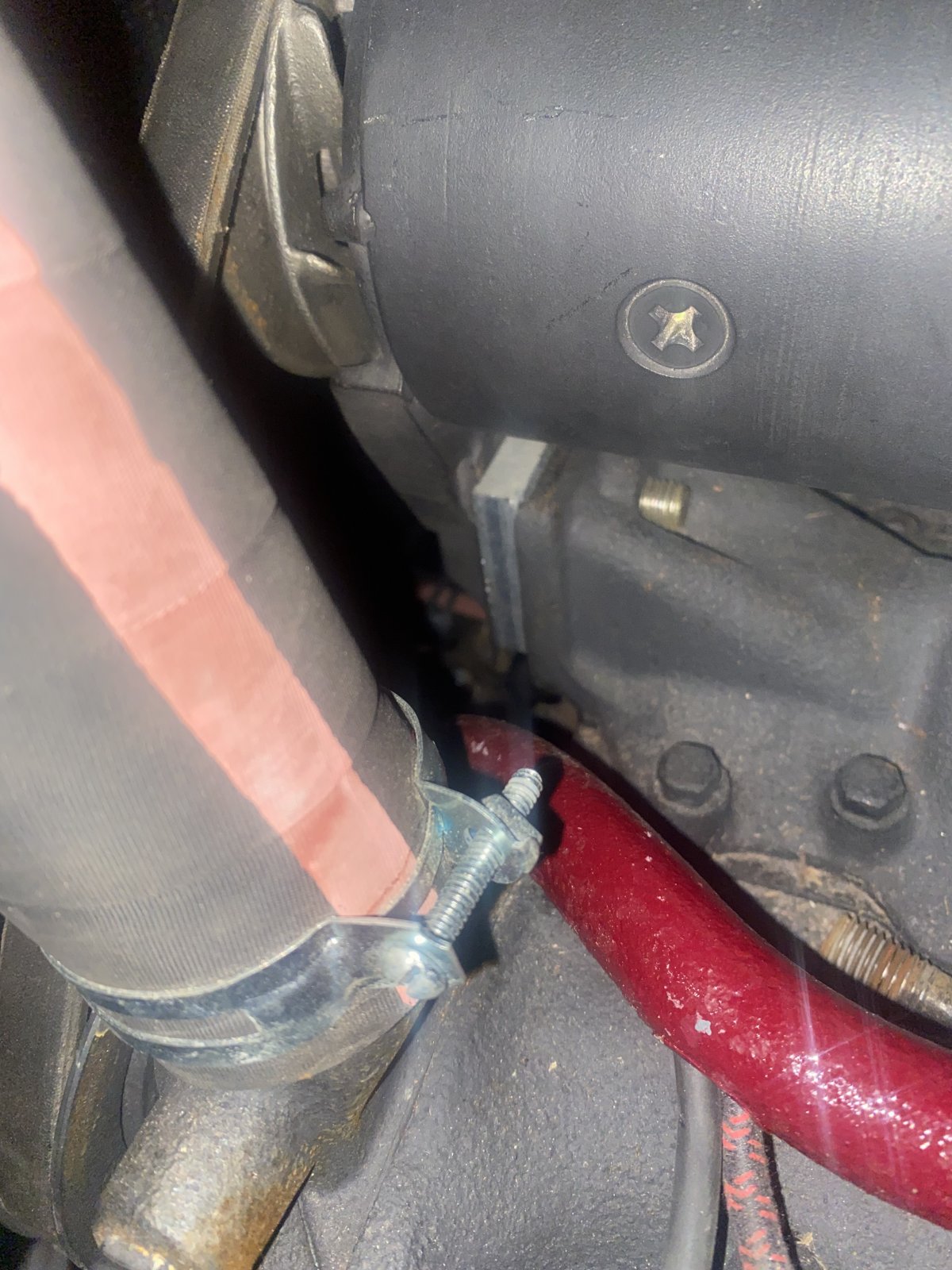

  2. So I’m home for the holidays, first semester of College down and learned a lot! It was a great learning experience and definitely worth it. That being said, I’m still glad to be back in Ohio to work on my project.

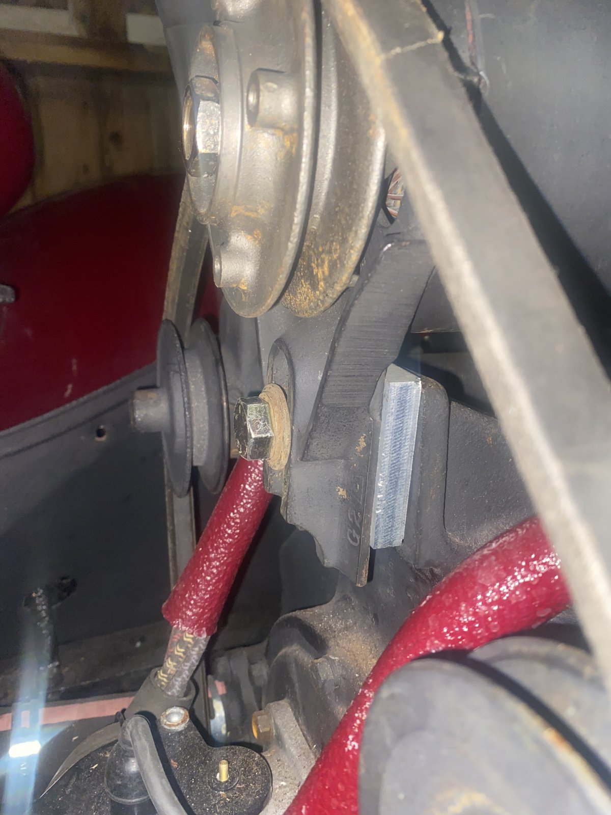

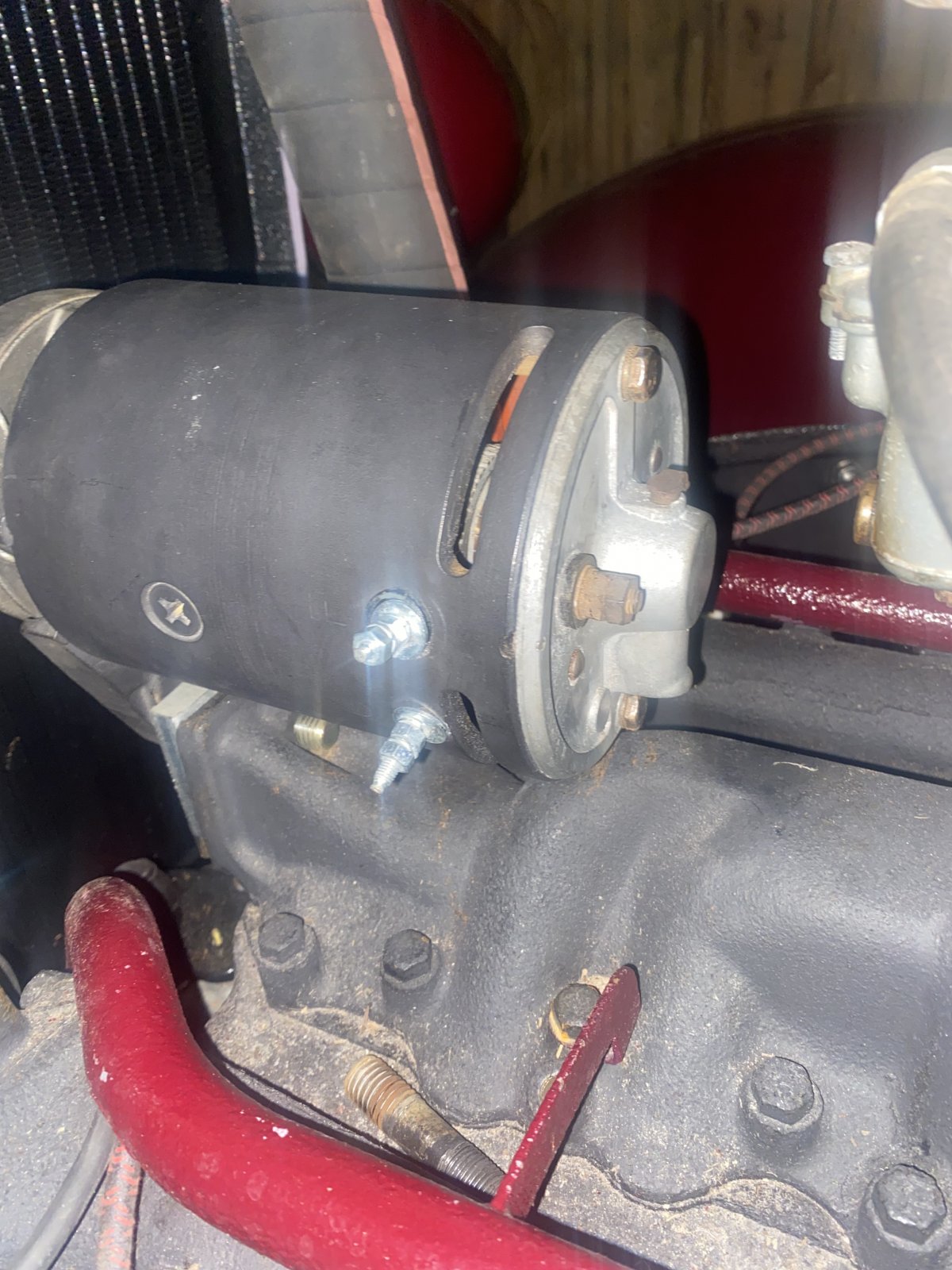

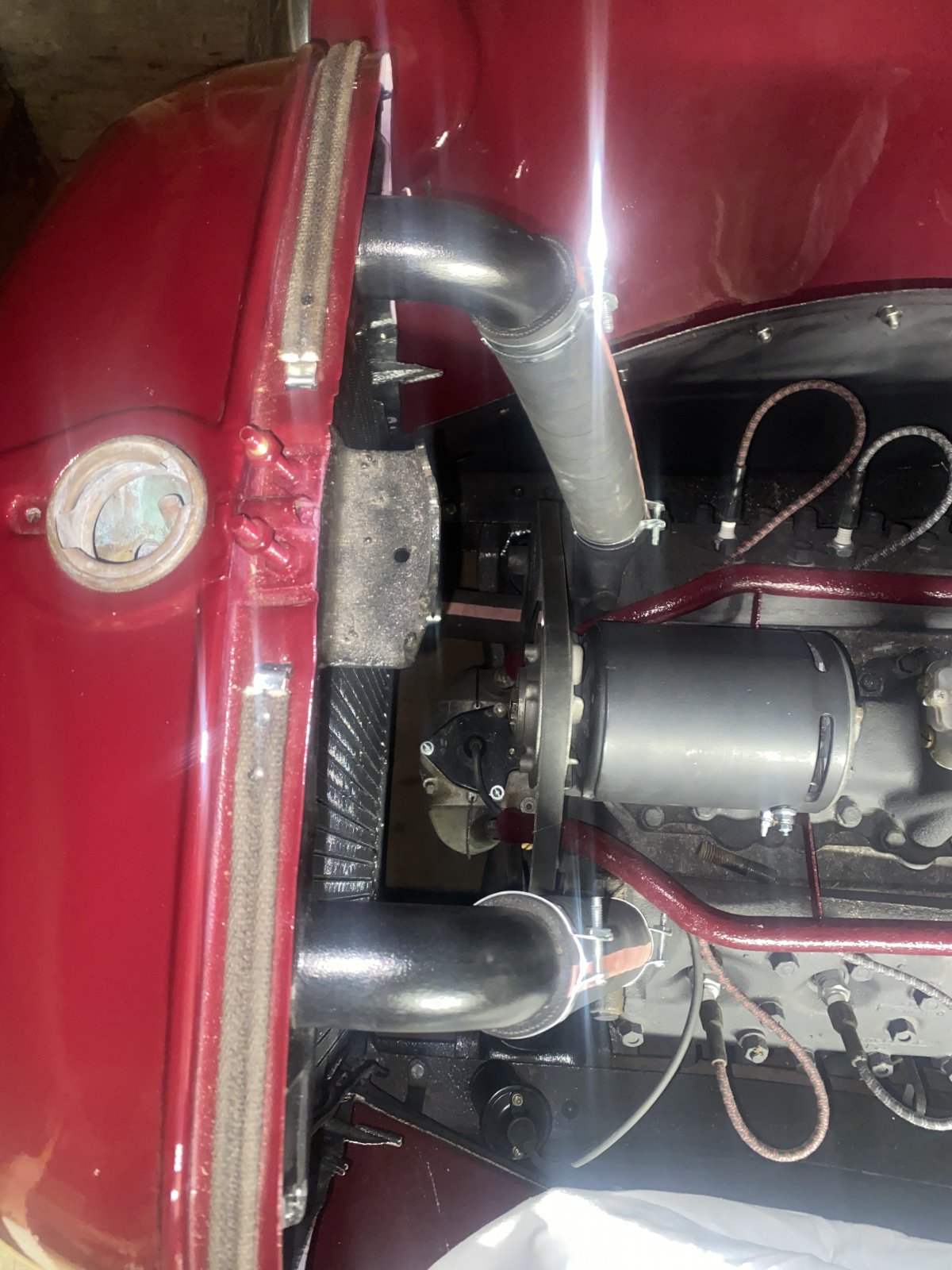

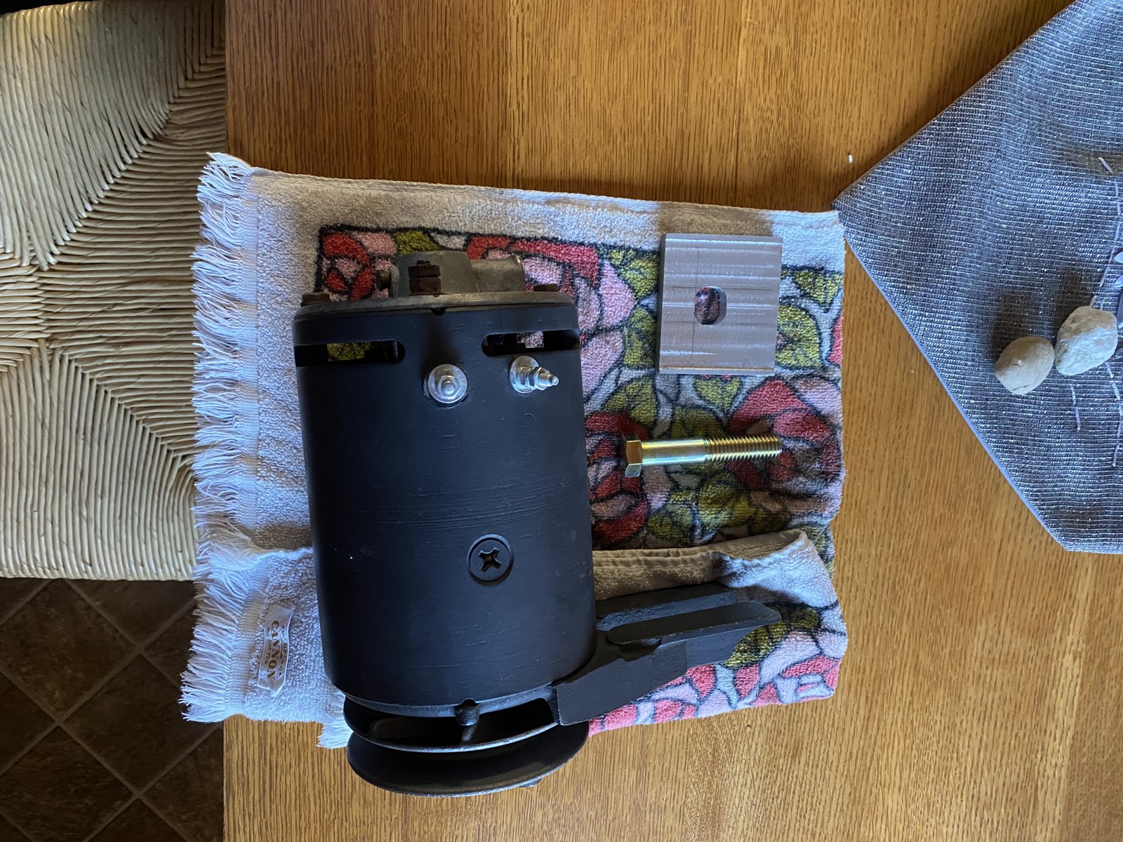

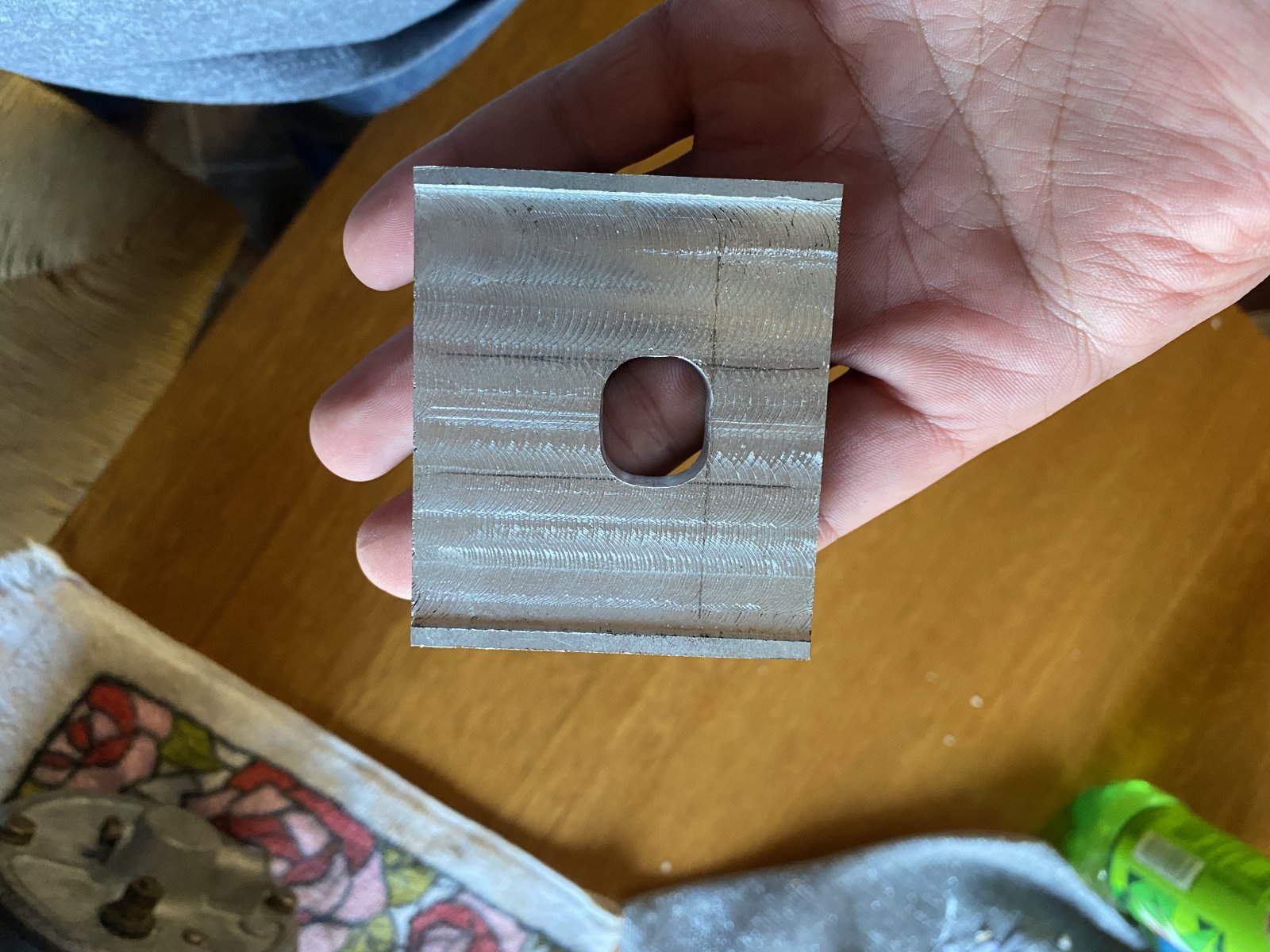

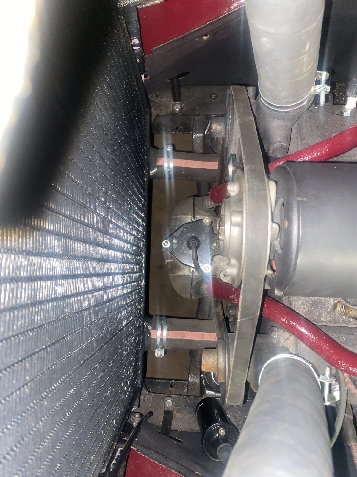

    Today I milled a spacer for the generator to align the belt. Have a smaller fan on order as well. Originally I was going to use a 18 inch fan but there were many clearance issues so I’m thinking a 15 inch will fix that.
    Here are some photos of the generator work today. Everything looks to be lined up well. I’m happy with it. Moving on to the next step..

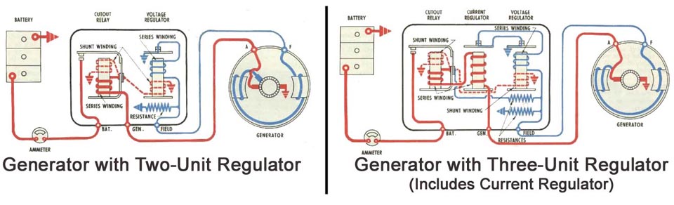

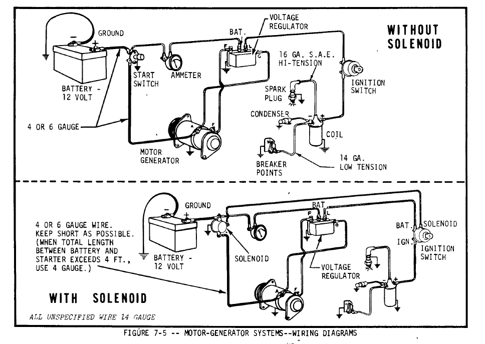

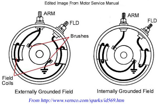

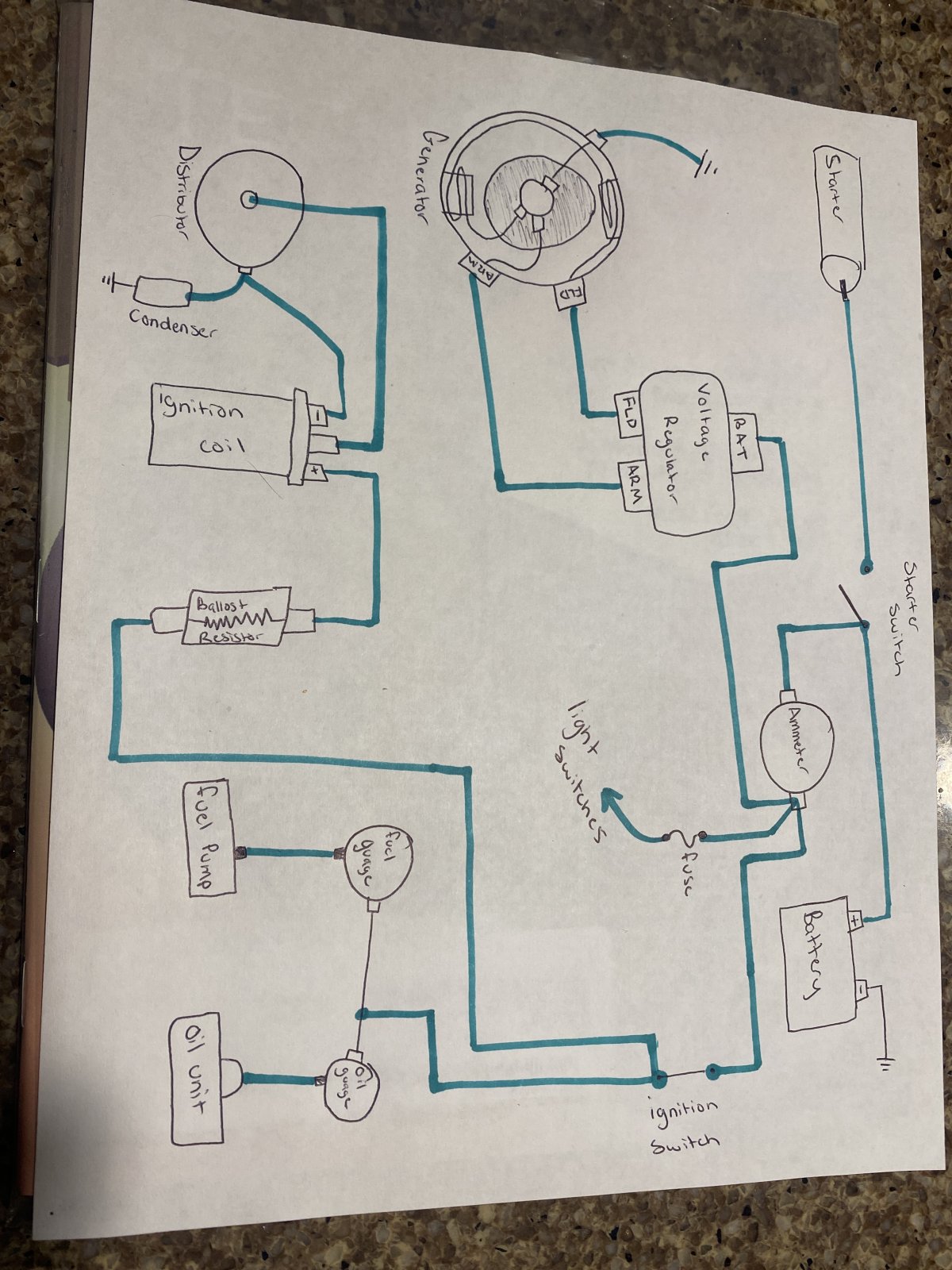

  3. Bought a lot of Electrical equipment the other day to prepare for a full wiring job on this vehicle. I made a wiring diagram I’ll attach below in case anyone is curious. It’s very basic but should have it running. Also, my generator has 3 wire placements and I’m a little unsure but I’m thinking it’s an externally grounded unit. Take a look at the diagram and let me know what you think.

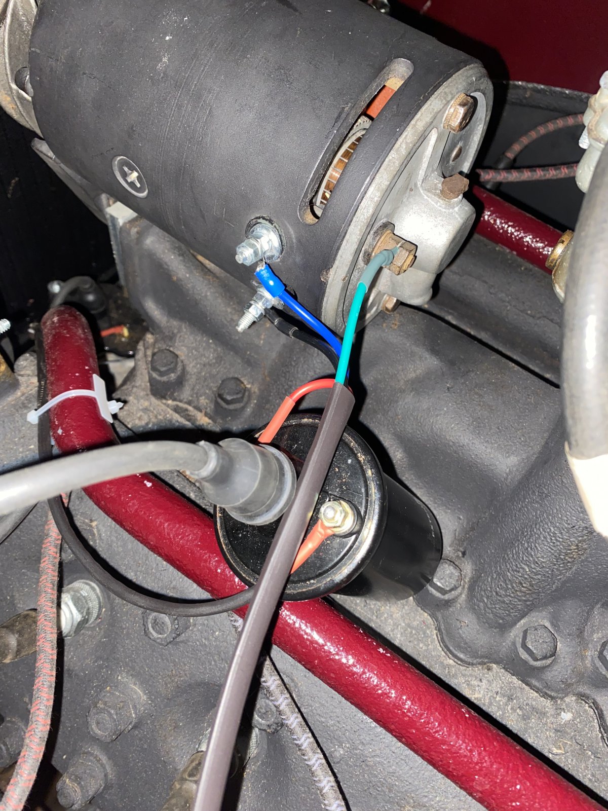

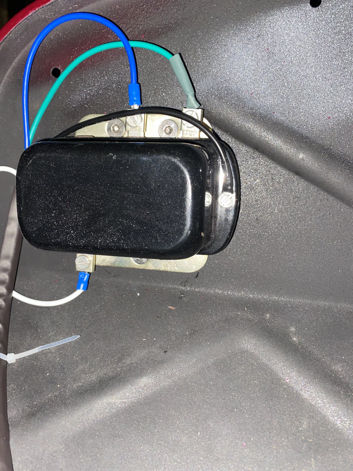

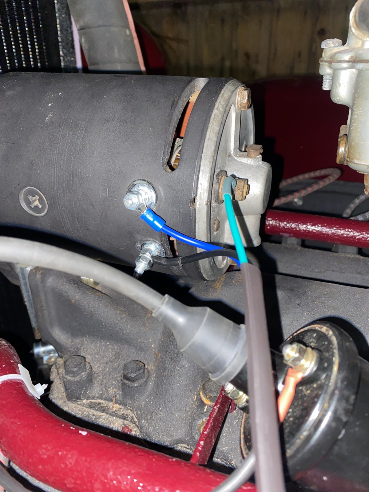

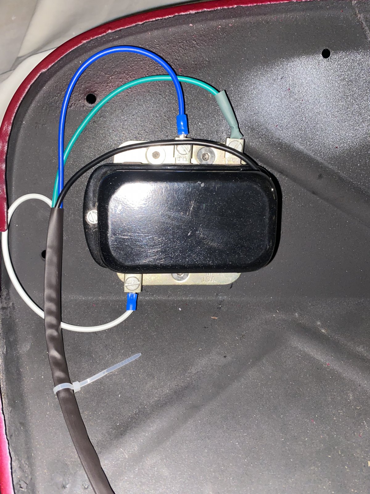

    Hello Christopher.
    The rusty terminal on the end is the Arm terminal.
    The upper one on the side is the field terminal.
    The lower one on the side is a ground terminal and should have a wire from there to the voltage regulator box.
    The generator is internally grounded.
    You need a voltage regulator for a ford that is 12V. Typical 57-62 year range will get you the right item. Standard Motor Products VR21 is the one normally offered.
    Mart.
  5. Thank you! This helped a lot when I was wiring

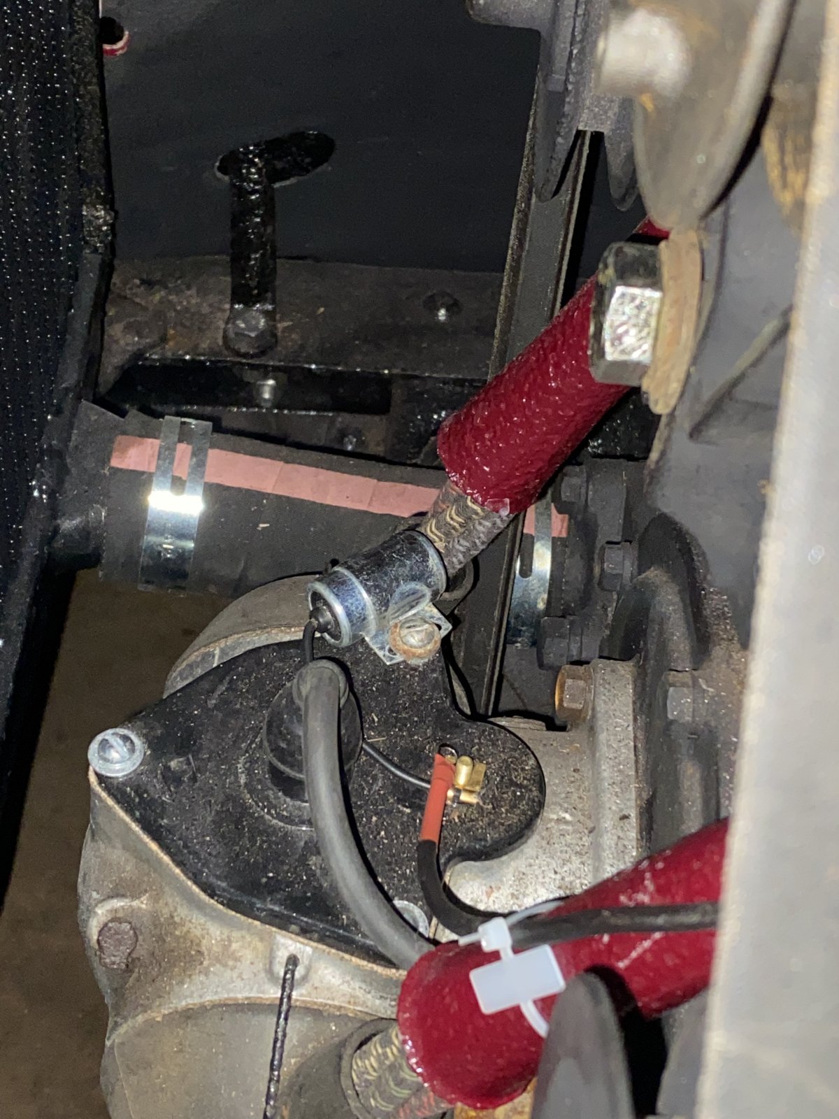

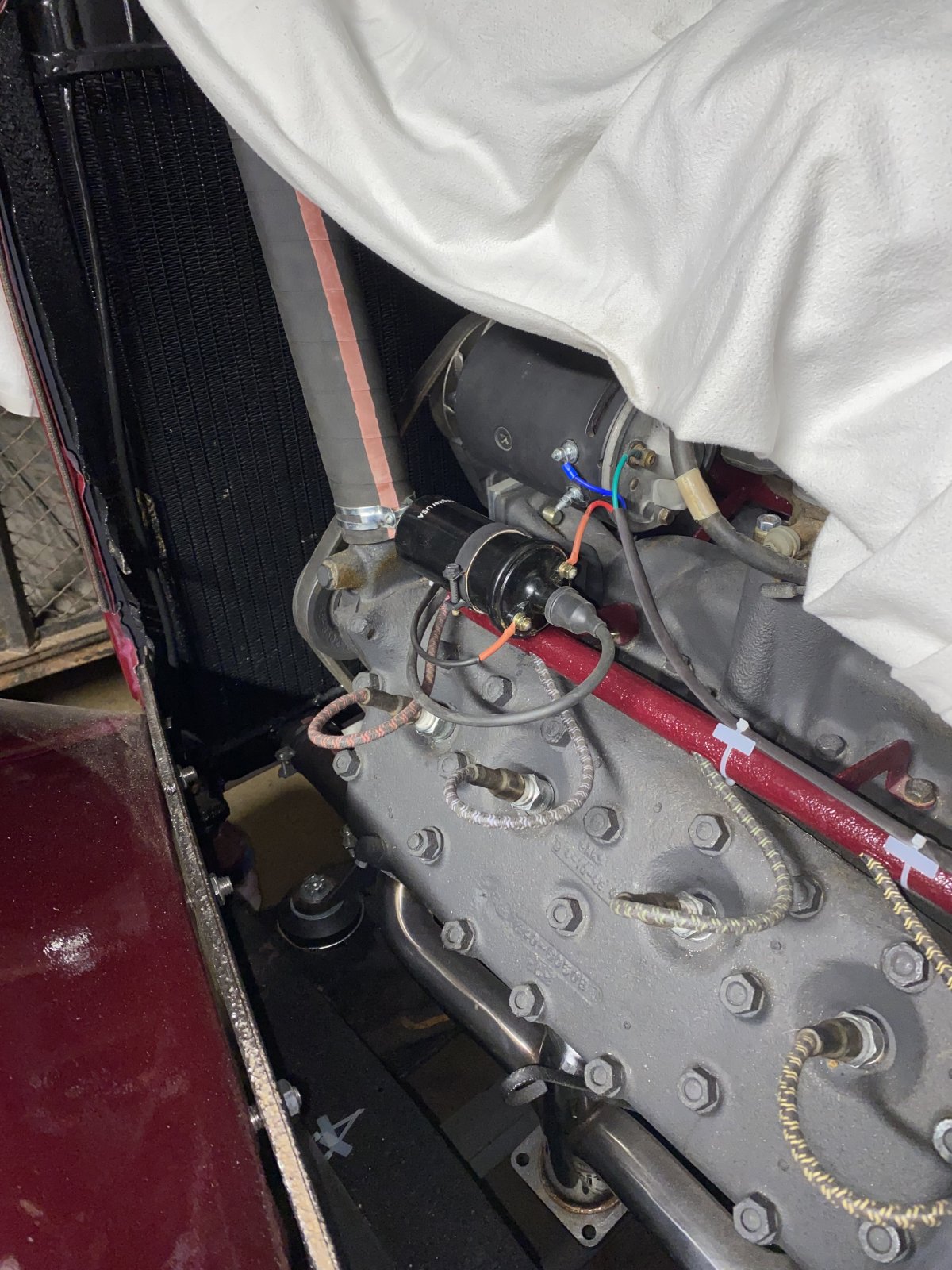

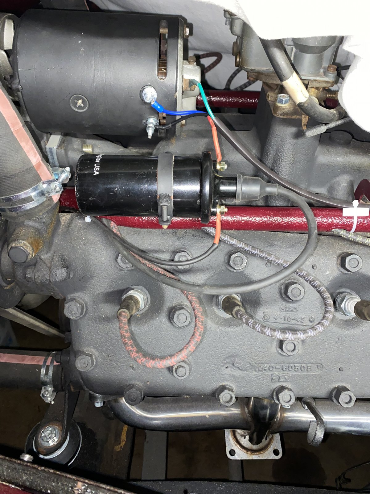

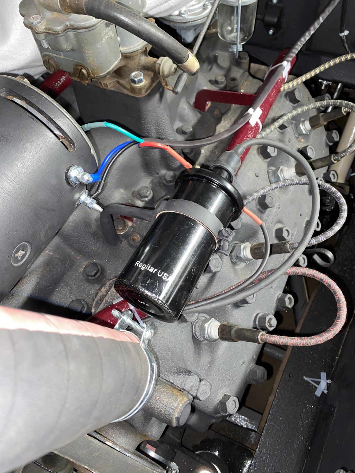

  6. As a follow up to my last post here’s how the wiring is going for the generator and the regulator. I need to make a bracket for the ignition coils still but it’s also wired
  7. Just a few more photos. I’ll try to finish up the ammeter gauge and get it actually fixed into the dash. At this point all I need is some thick wire for the starter and battery. I also need to wire the oil gauge and fuel pump gauge. If only I knew where those were…. Yikes. I should have them still, where is the question for now haha..

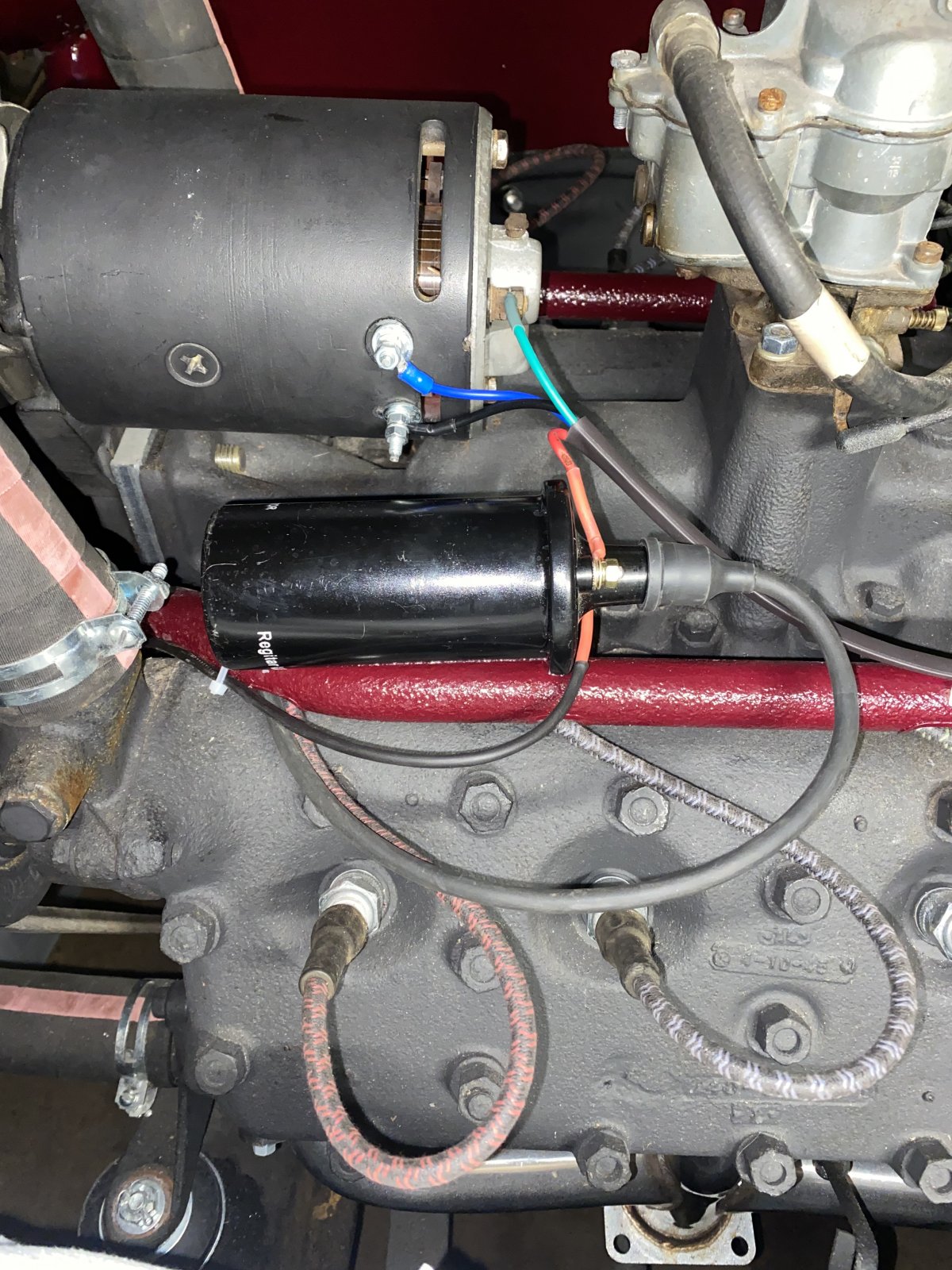

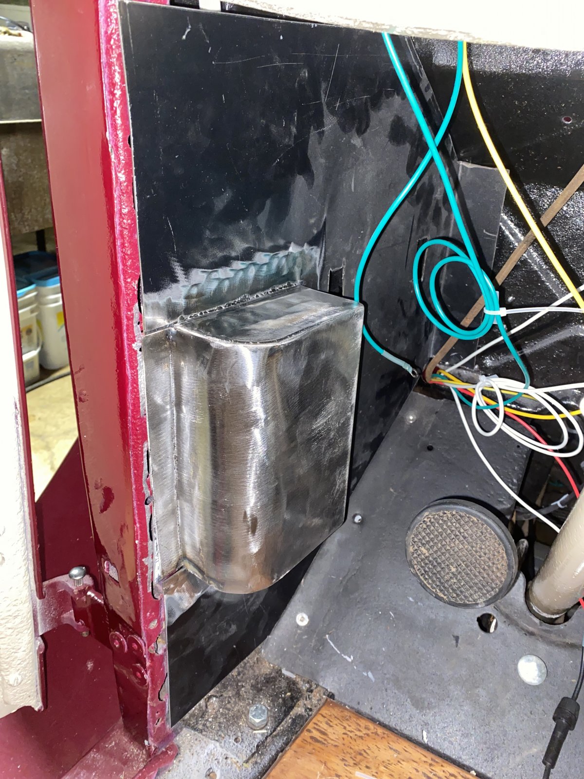

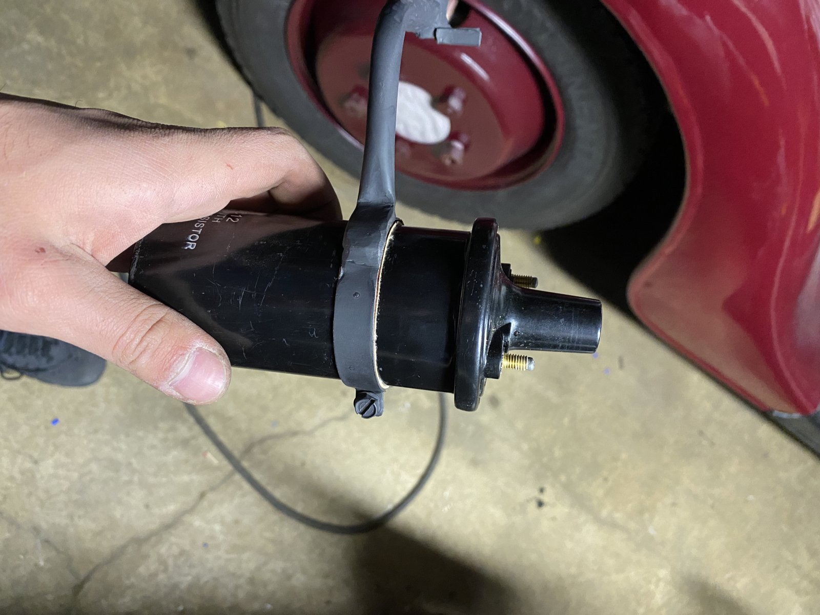

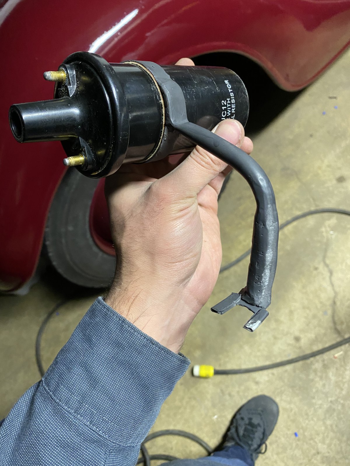

  8. Made the bracket for my ignition coil today and got that all wrapped up. I think it turned out pretty good.

    Christopher. That looks tidy but I have some bad news. an oil filled coil should be positioned so it's standing up so the internals are not exposed... they need to stay covered in oil.
    Henry even made a stand-off Brkt for these on the 49-53 engines that kept them upright and away from any excessive block heat.
    here’s a homemade one.
    https://www.jalopyjournal.com/forum/threads/8ba-coil-bracket.974560/
    Henry’s

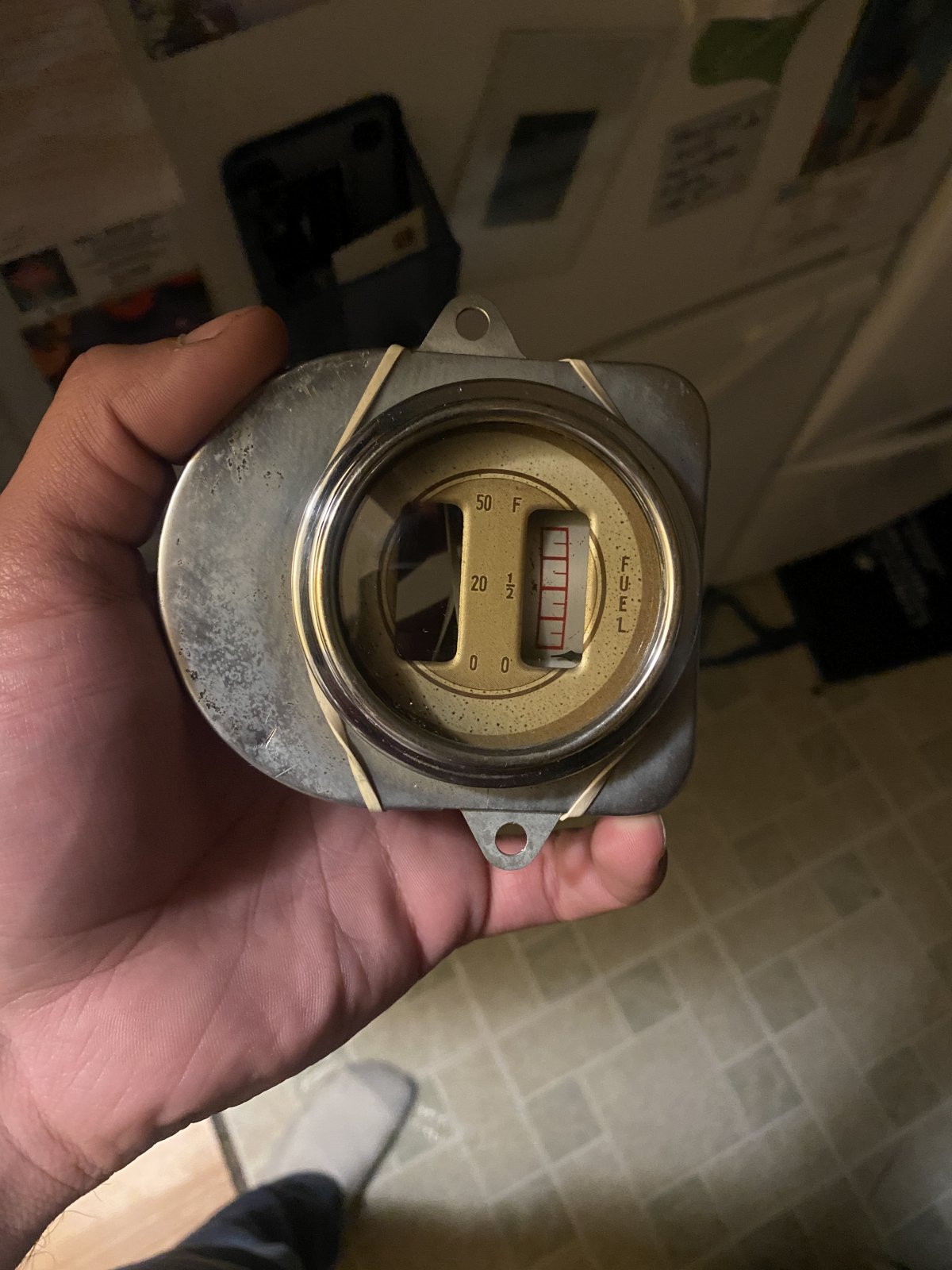

  10. Got my new gauges in the mail today. My old ones were BUTCHERED. I’m guessing with the old set something went out and they modified it for just the one. Here are some photos. I’d like to wire these up before I leave for spring semester

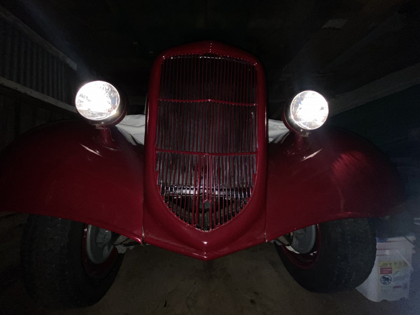

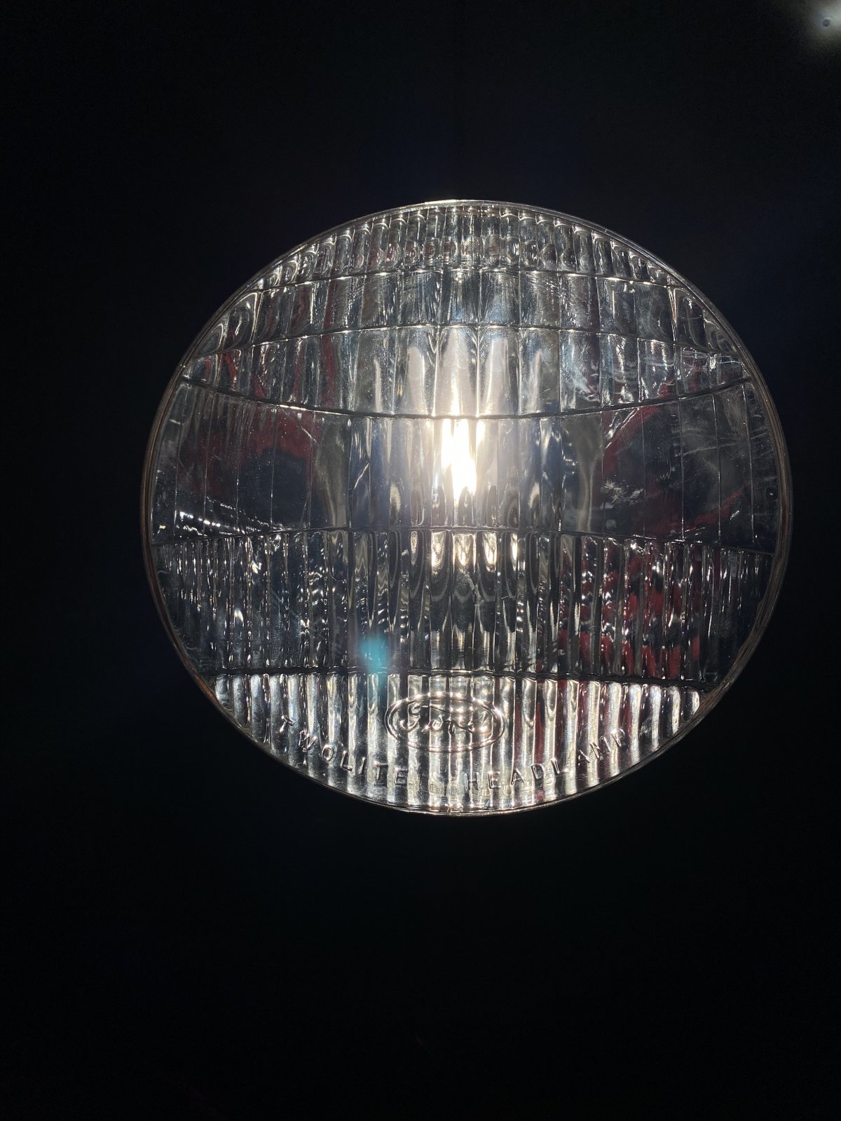

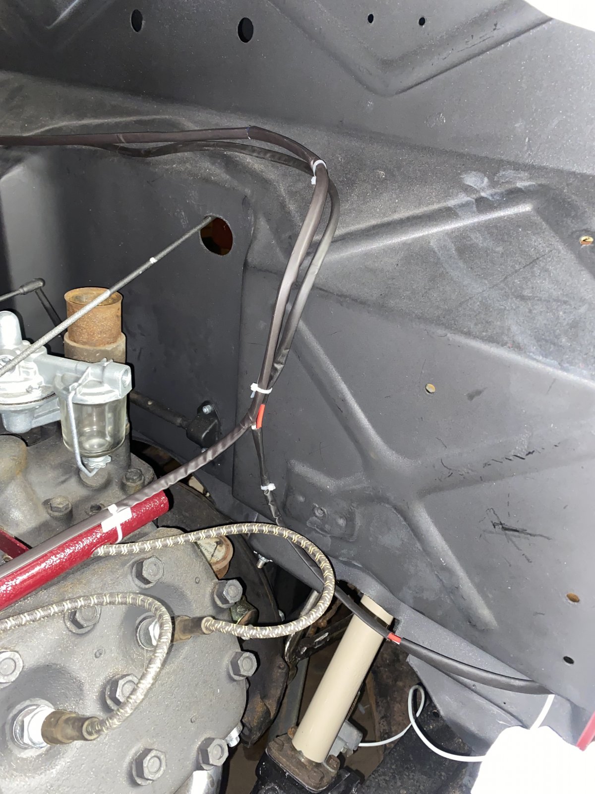

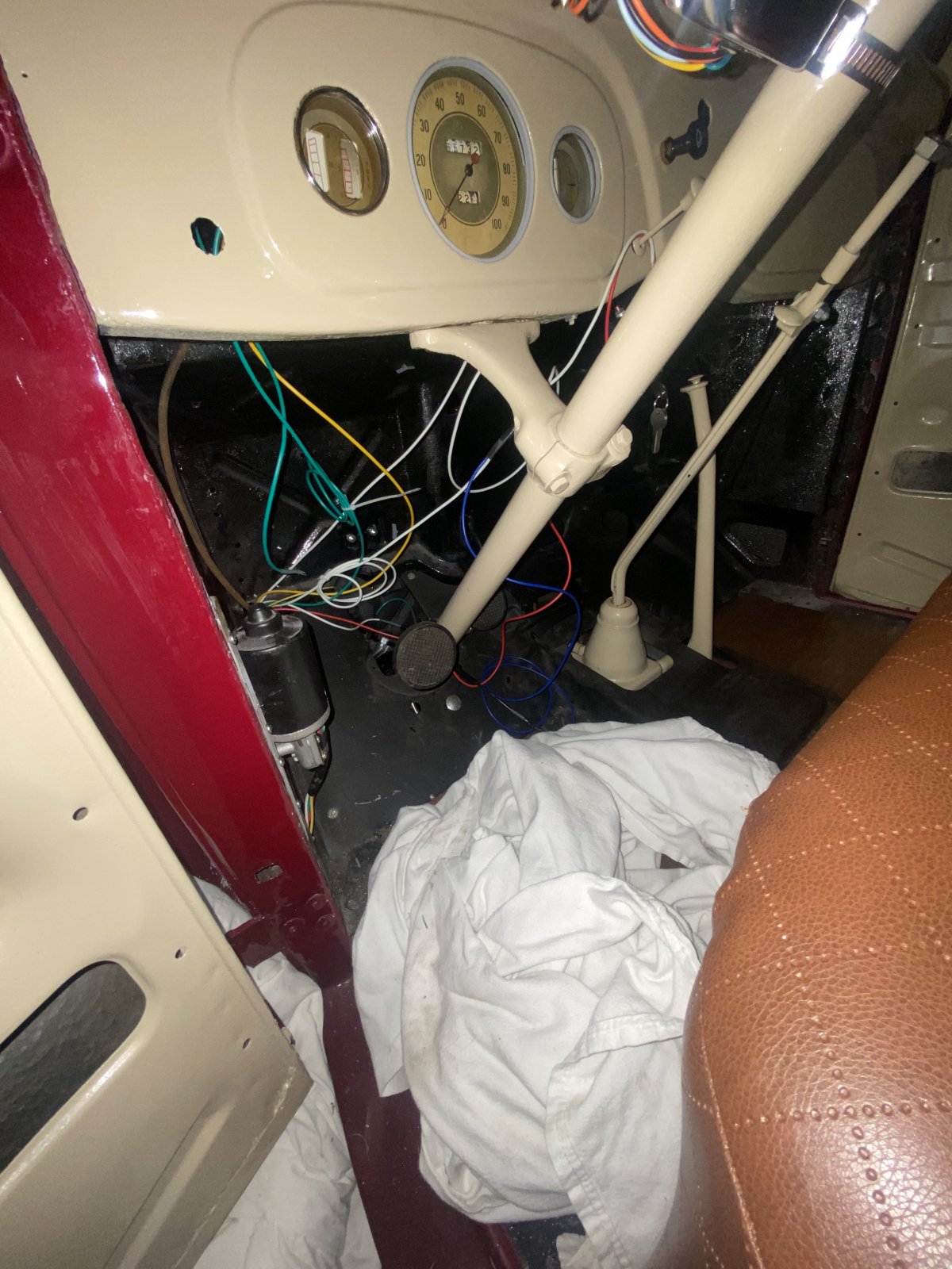

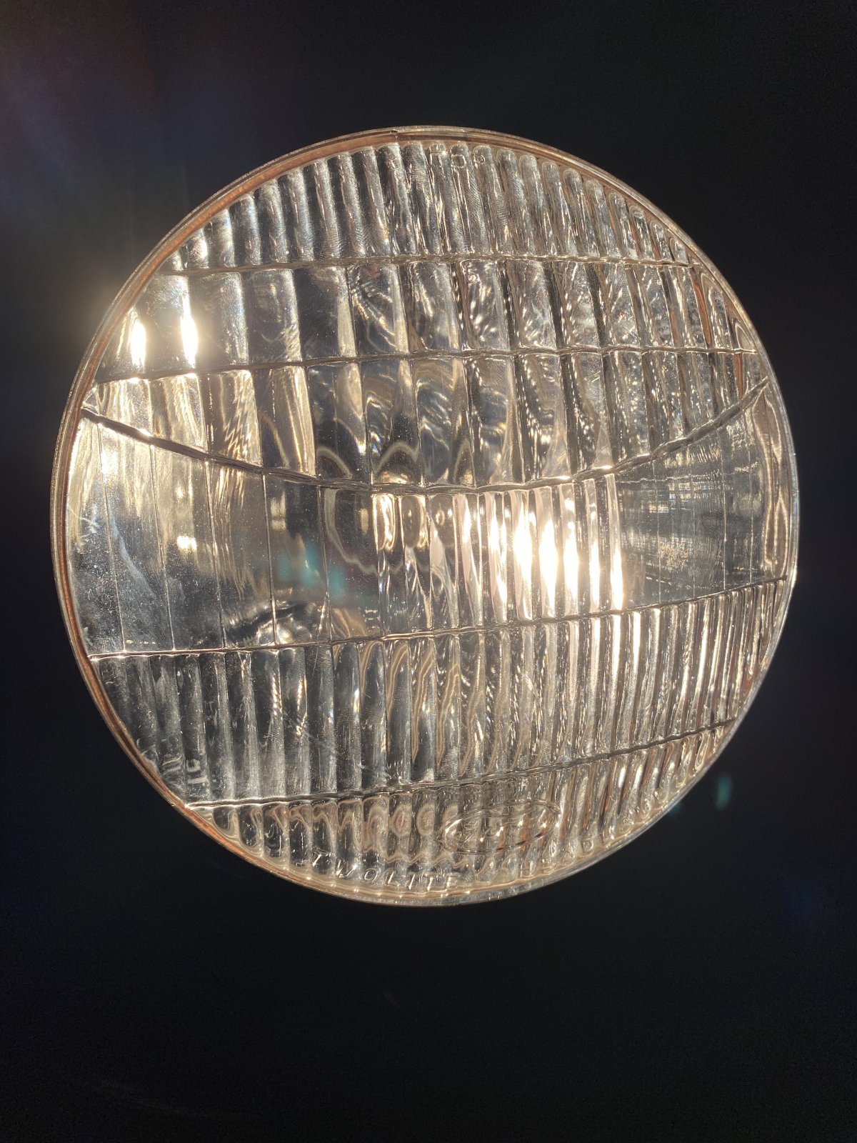

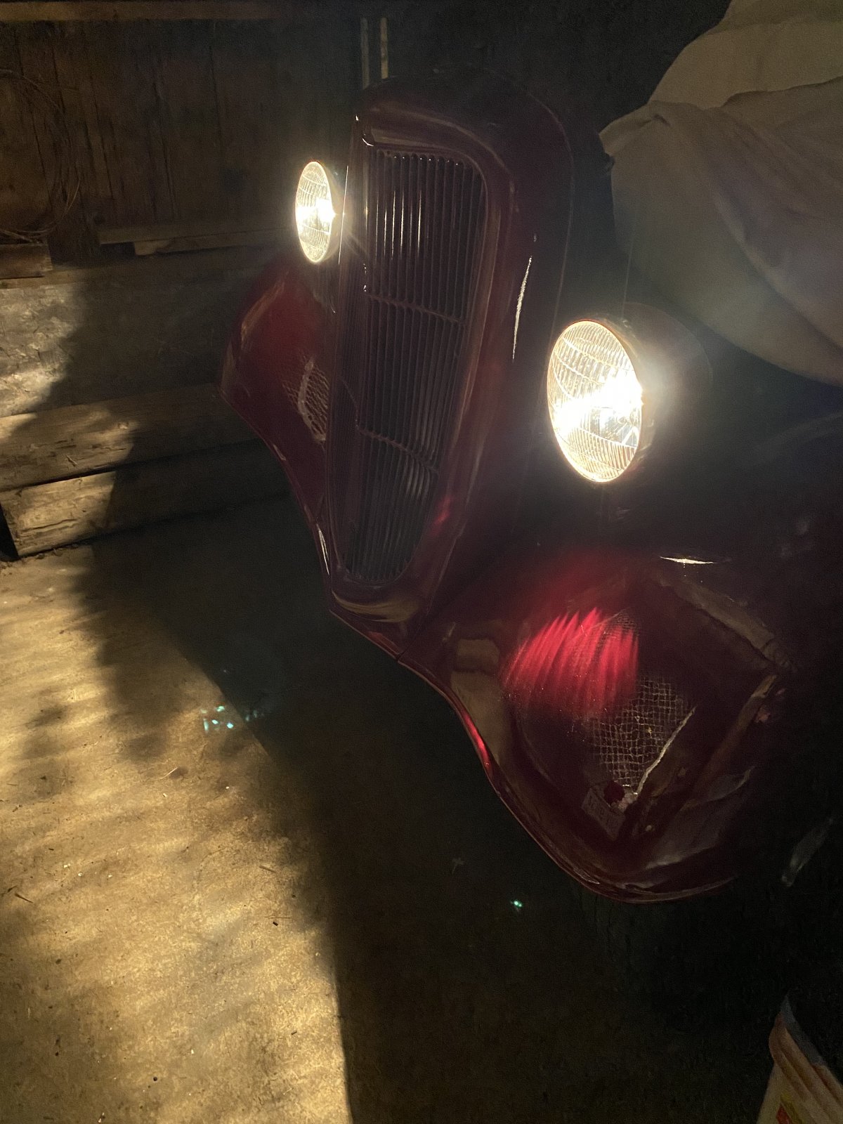

  13. As an update I got most things wired in with exception to accessories and some things that have not been set up yet.
    Things not set up yet are
    -brake light switch
    -tail lights
    -dash lights
    -horn

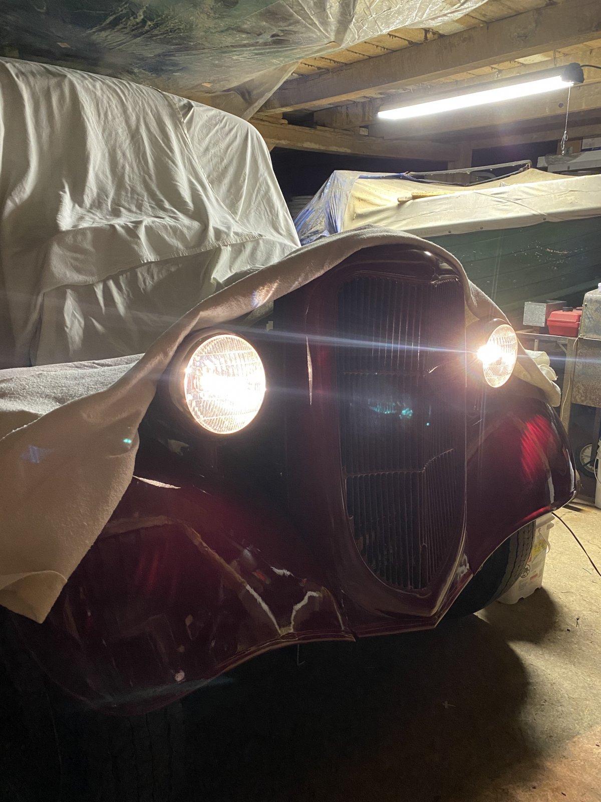

    BUT, the headlights are working and I love them. The halogen kit is bright and wonderful. Enjoy the pictures.

    As a rule, halogens draw a lot of amps and often may be more than the light switch can accommodate requiring a relay to protect the switch and the wiring. Might consider that just to be safe.
    If my memory serves me right (often does not) most aftermarket light switches I have seen come with a 30 amp circuit breaker attached.
    Others will chime in here Chris I am sure.
    Christopher Miller likes this.

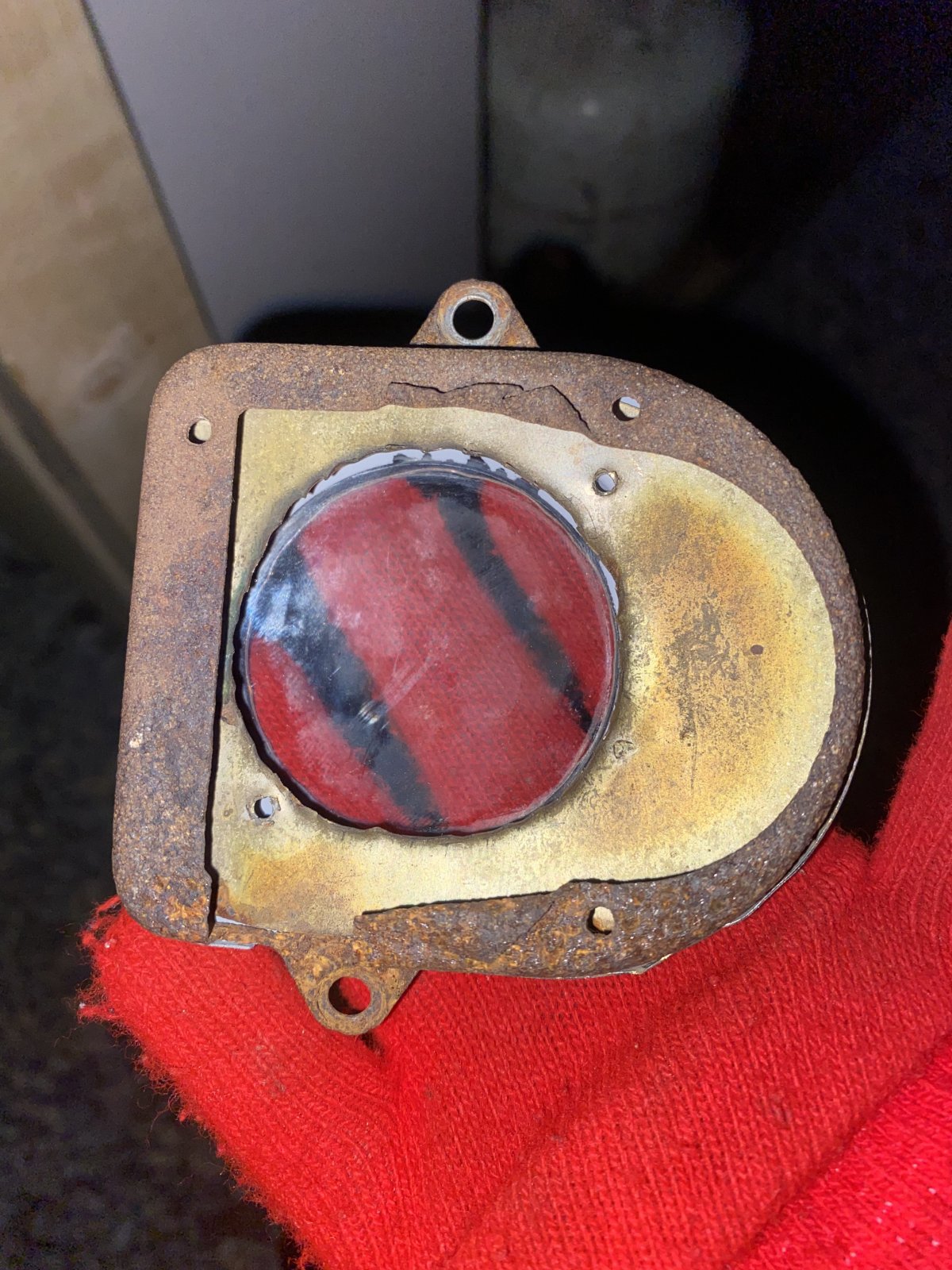

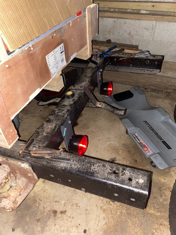

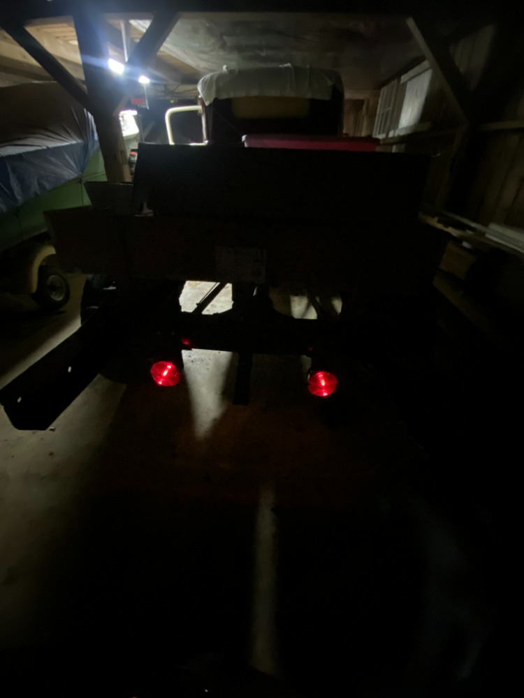

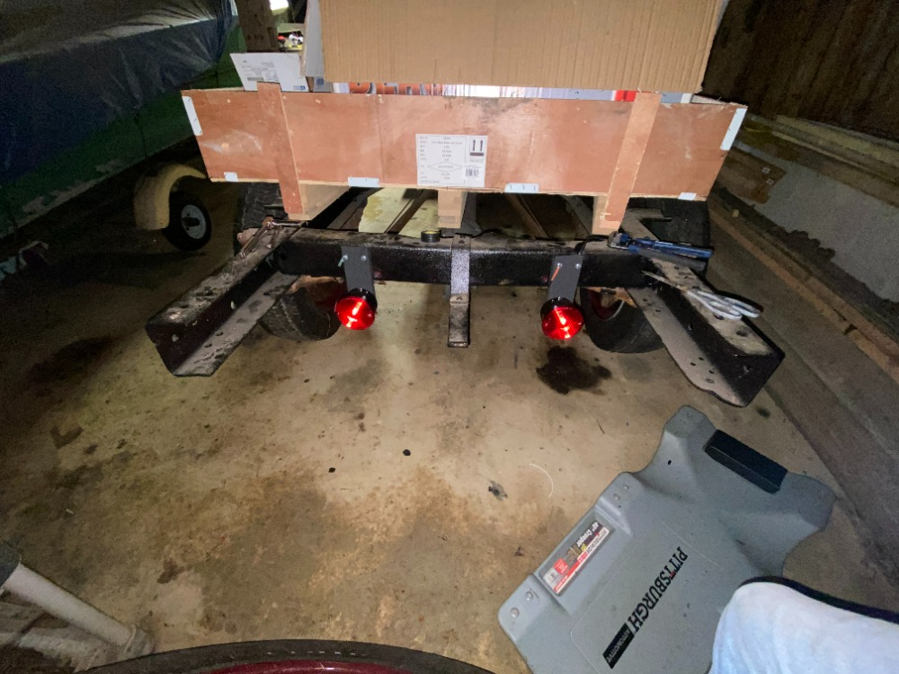

  19. I went home this past week for spring break to see the family and did some work on the truck i thought i'd add. It wasn't much as i didn't have that much free time but i have added a gas tank and taillights. In addition to the work i did on the truck i spent 2 days with my father visiting museums. We visited the Cord and Duesenberg Museum in Auburn Indiana, the early ford V8 museum in the same area, and the Packard Museum in Dayton Ohio. I recommend each museum if you get the chance to.
    First on this i made some simple brackets to mount the tail lights and then wired it up. This was an easy process but it was good to see one more thing done. I think these will be temporary as i will add a bed probably move these lights or get new ones altogether.
    upload_2022-3-29_12-32-38.jpeg upload_2022-3-29_12-32-53.jpeg upload_2022-3-29_12-33-15.jpeg

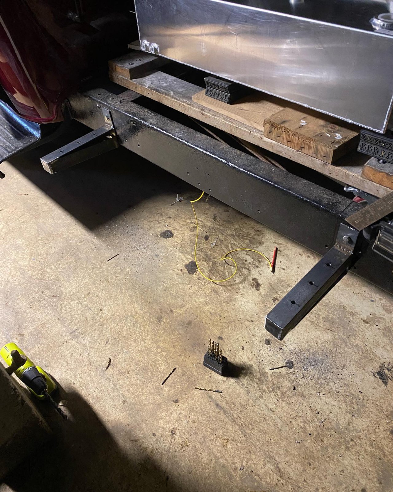

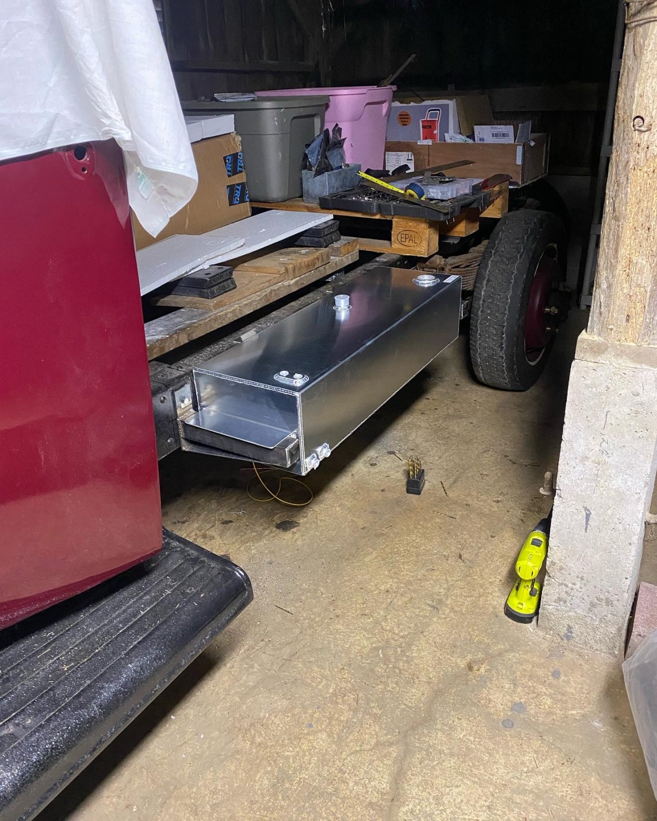

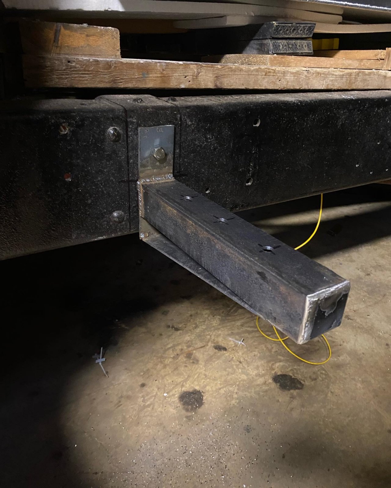

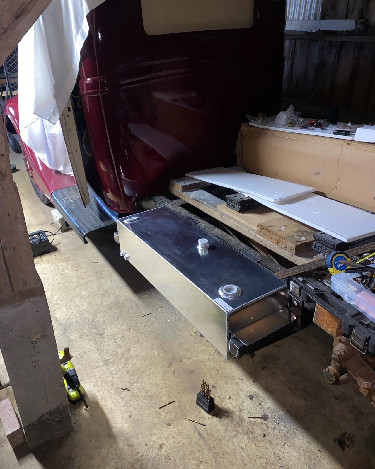

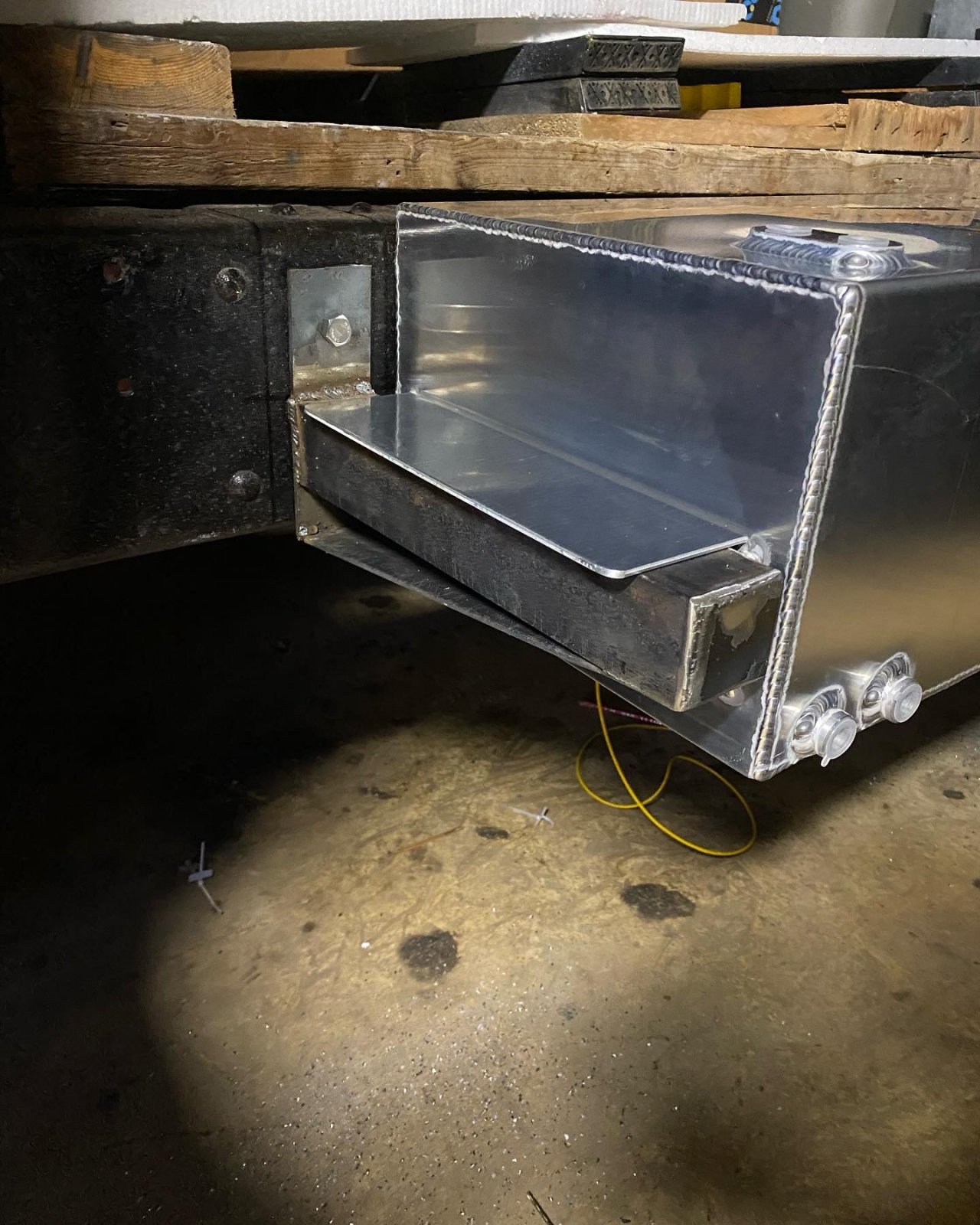

    The last thing i did was to make up some brackets to hold the gas tank out of angle iron and some flat iron. The gas tank is just a standard tank of aluminum. The old tank was slightly smaller and while this one isn't a exact replacement i think it will serve as a great tank to use for years to come.
    06005EBD-96D9-4AA1-88F0-20F462A14504.jpg 0DADE909-2667-4DE8-8064-9274DAB5DC0C.jpg
    12D88AF2-5E30-4CE9-8DB2-E530457D5F2C.jpg 8455B968-8EF8-4ABE-BF64-E97DC7B32FFB.jpg 670FEC47-D764-4661-8B22-F2E6A787DF93.jpg

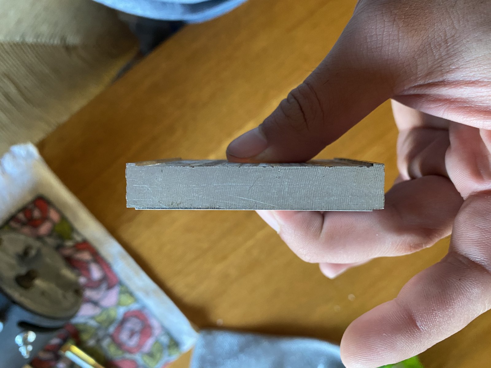

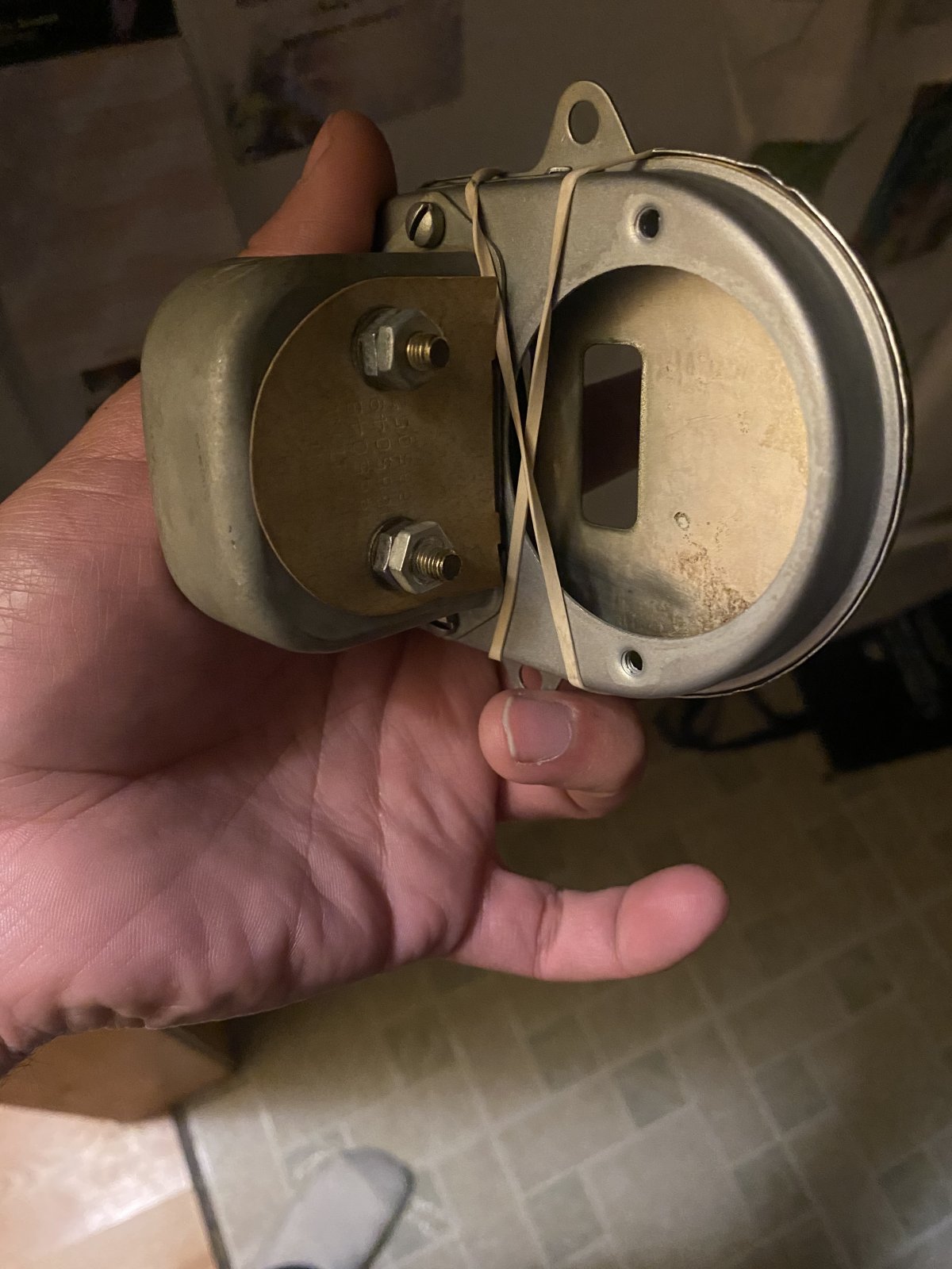

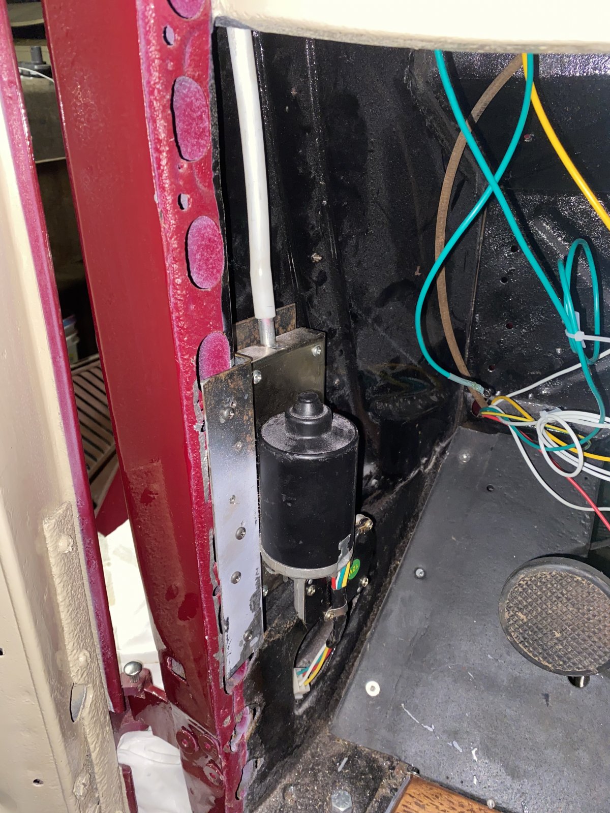

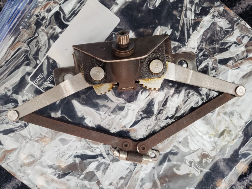

  20. Got something else in the works. Thanks to my father for organizing the shipment of the front window actuator we were able to get the piece rebuilt with new wing gears and special pins. It cost a little more than i wanted but these are hard to find anymore. No one that i know of sells them new and if you can find an old original you still run the risk of damage and future dependability. This is the last piece needed to complete the front window construction.
    rusty valley and 210superair like this.
  21. Link to this actuator after it was rebuilt
    Boryca, 210superair and 1-SHOT like this.

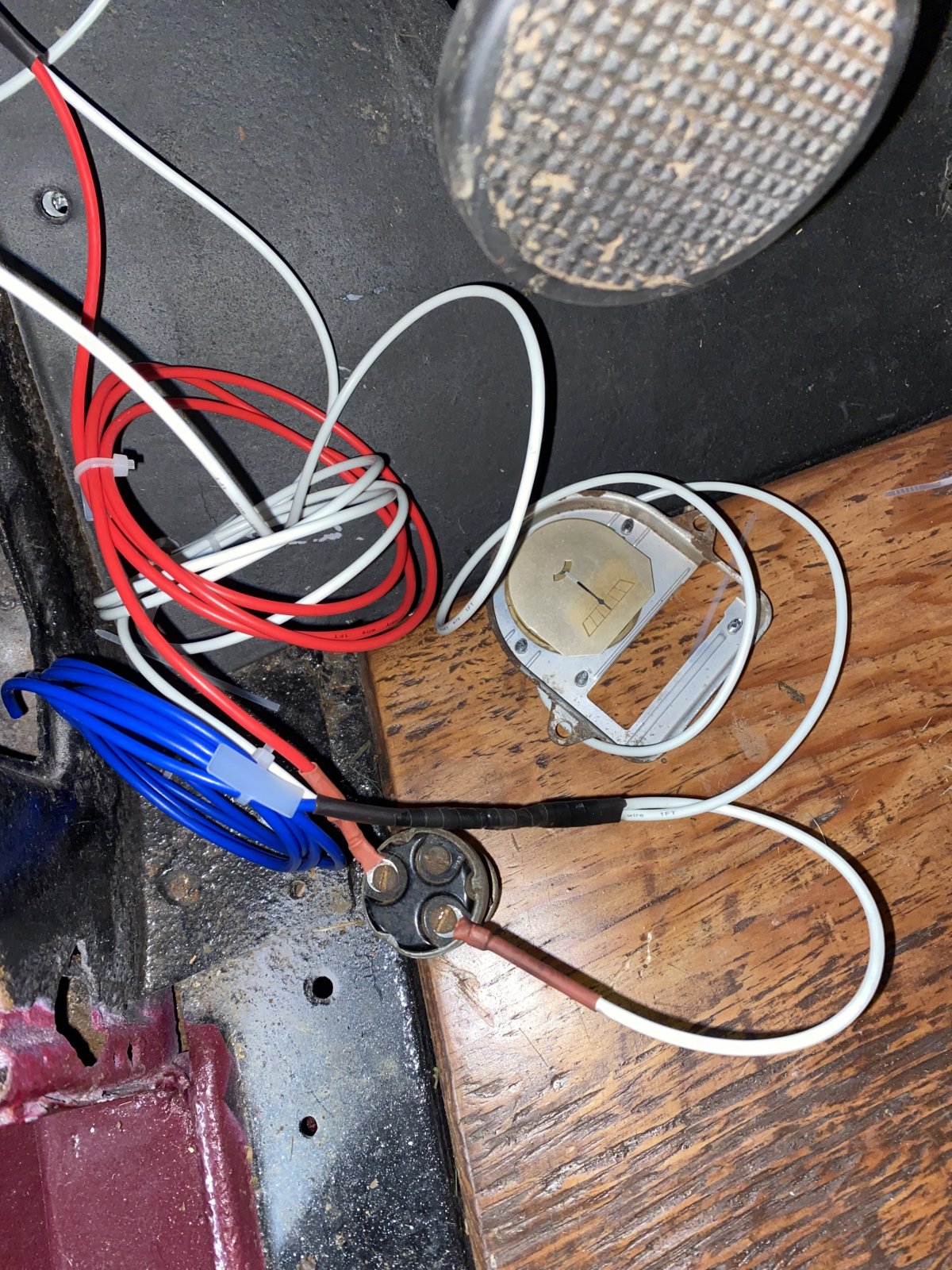

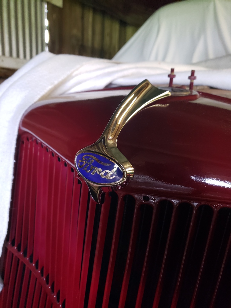

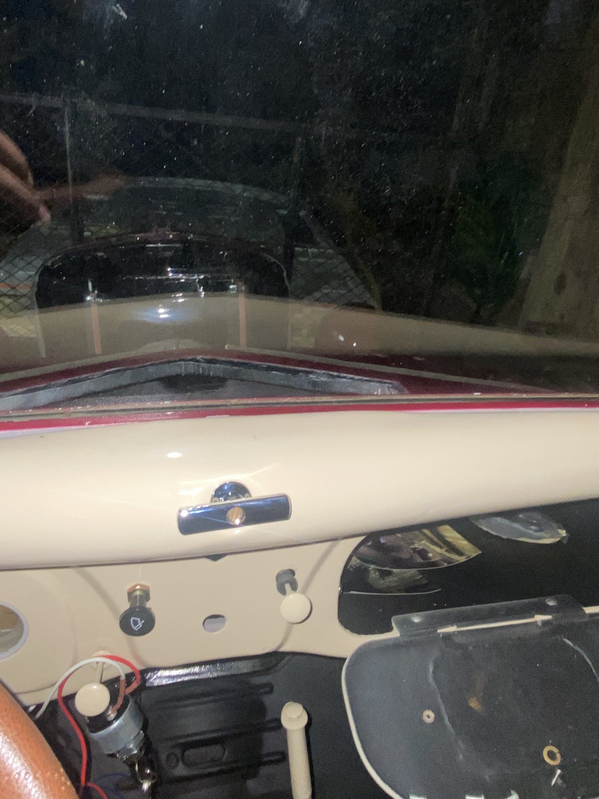

  24. Got the new hood Ornament the other day

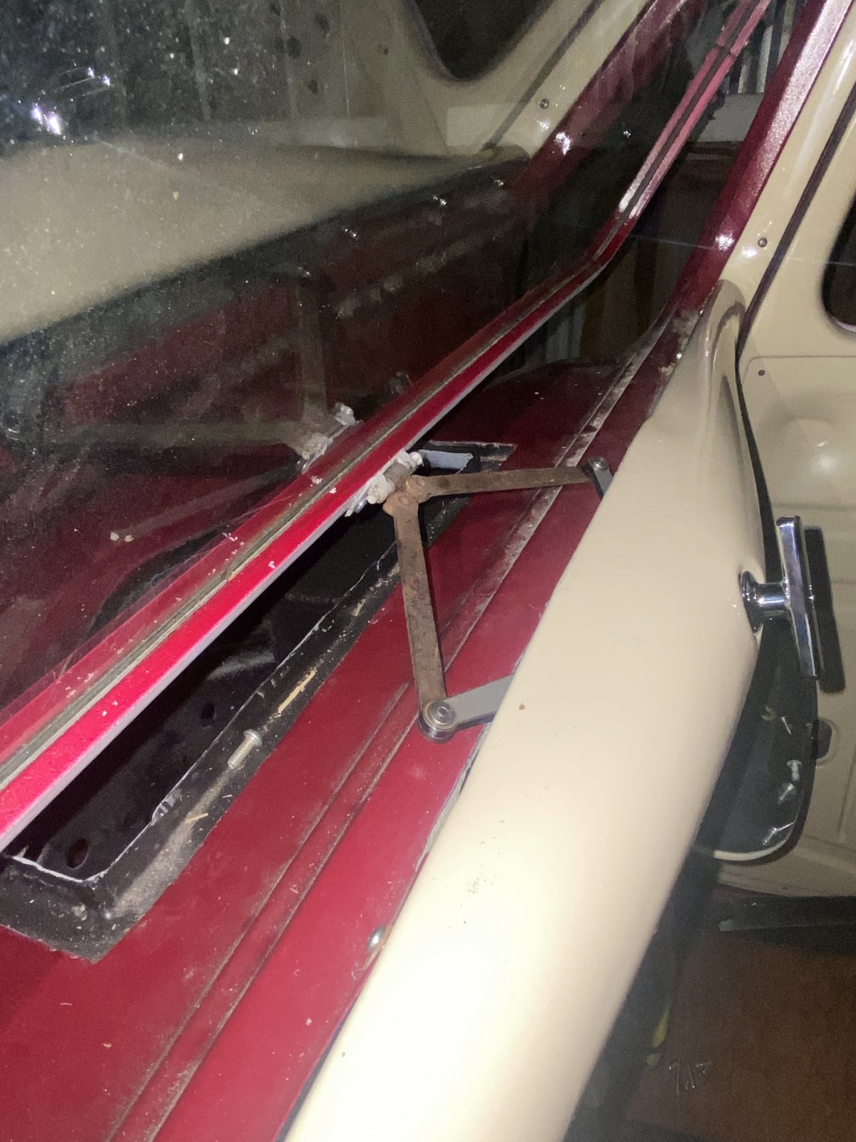

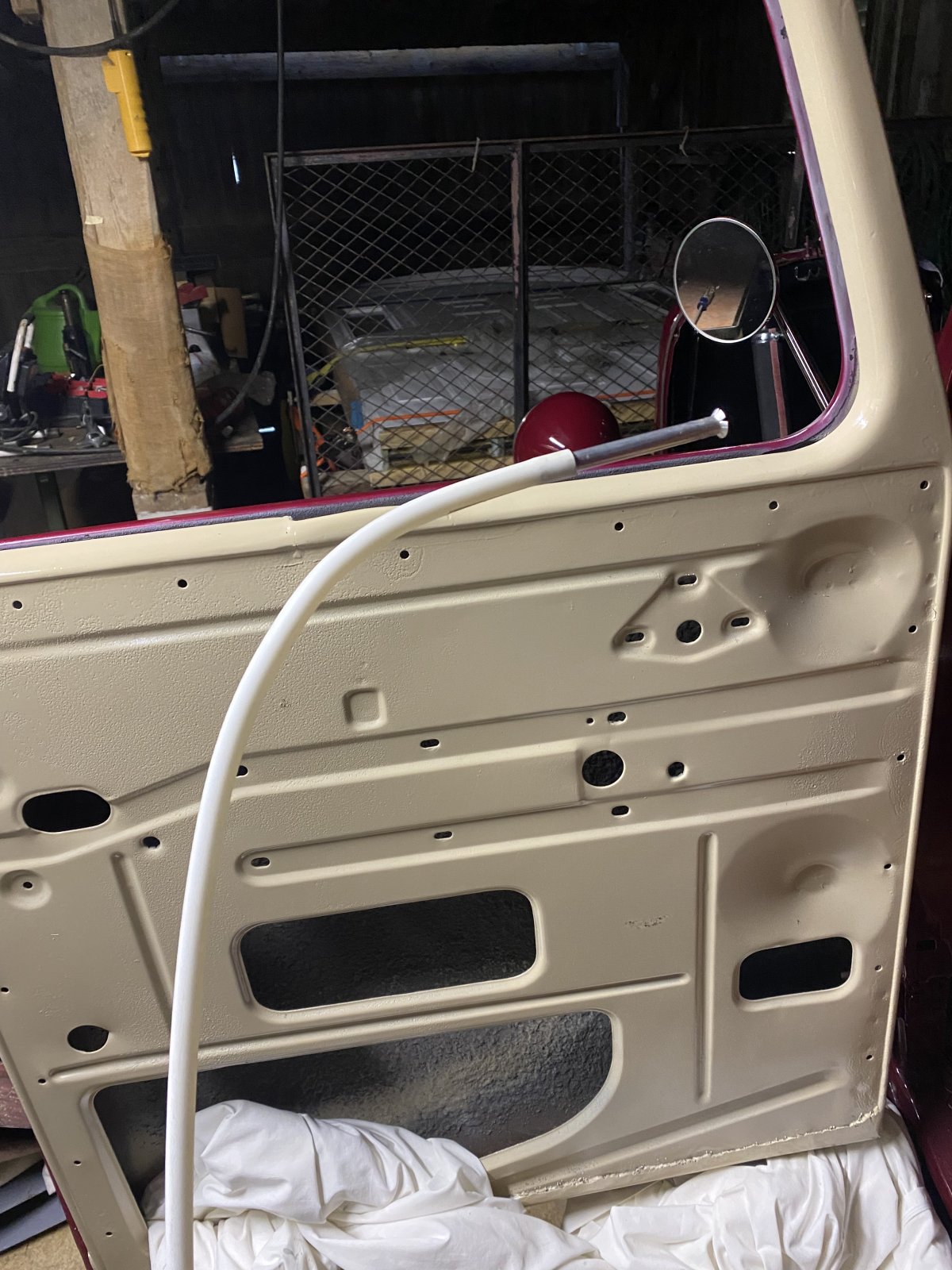

  26. The first thing i did was install the new front window regulator. She works incredibly smooth and was a simple installation. Here’s some pictures of it installed, pretty simple concept C7252A58-0919-43DF-83A2-6A3ACBA03B4A.jpeg C7252A58-0919-43DF-83A2-6A3ACBA03B4A.jpeg 8562E88E-5B40-4C46-9E4B-0C1451766C10.jpeg 8F1005E0-1BE8-4CB2-A7C2-234192B0EF37.jpeg 5DAFBB52-3159-439D-92CD-BDAB472D0471.jpeg

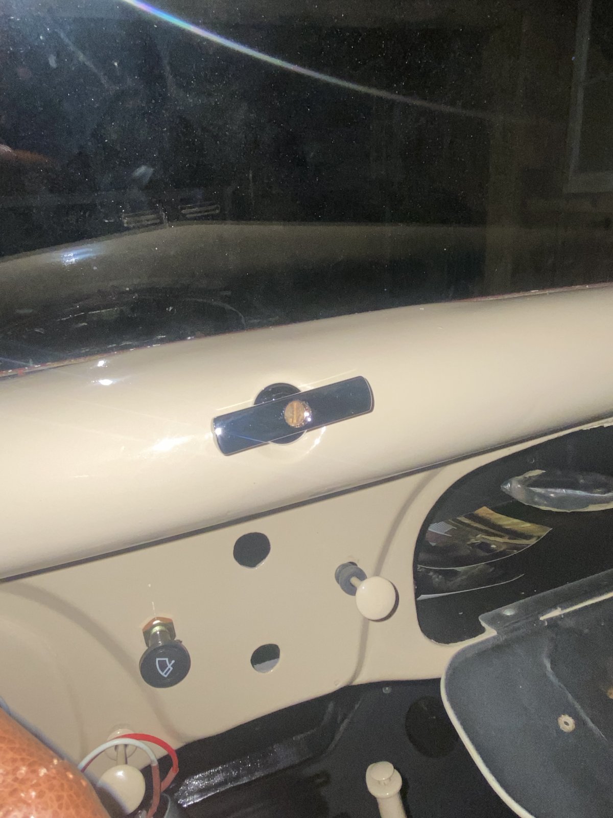

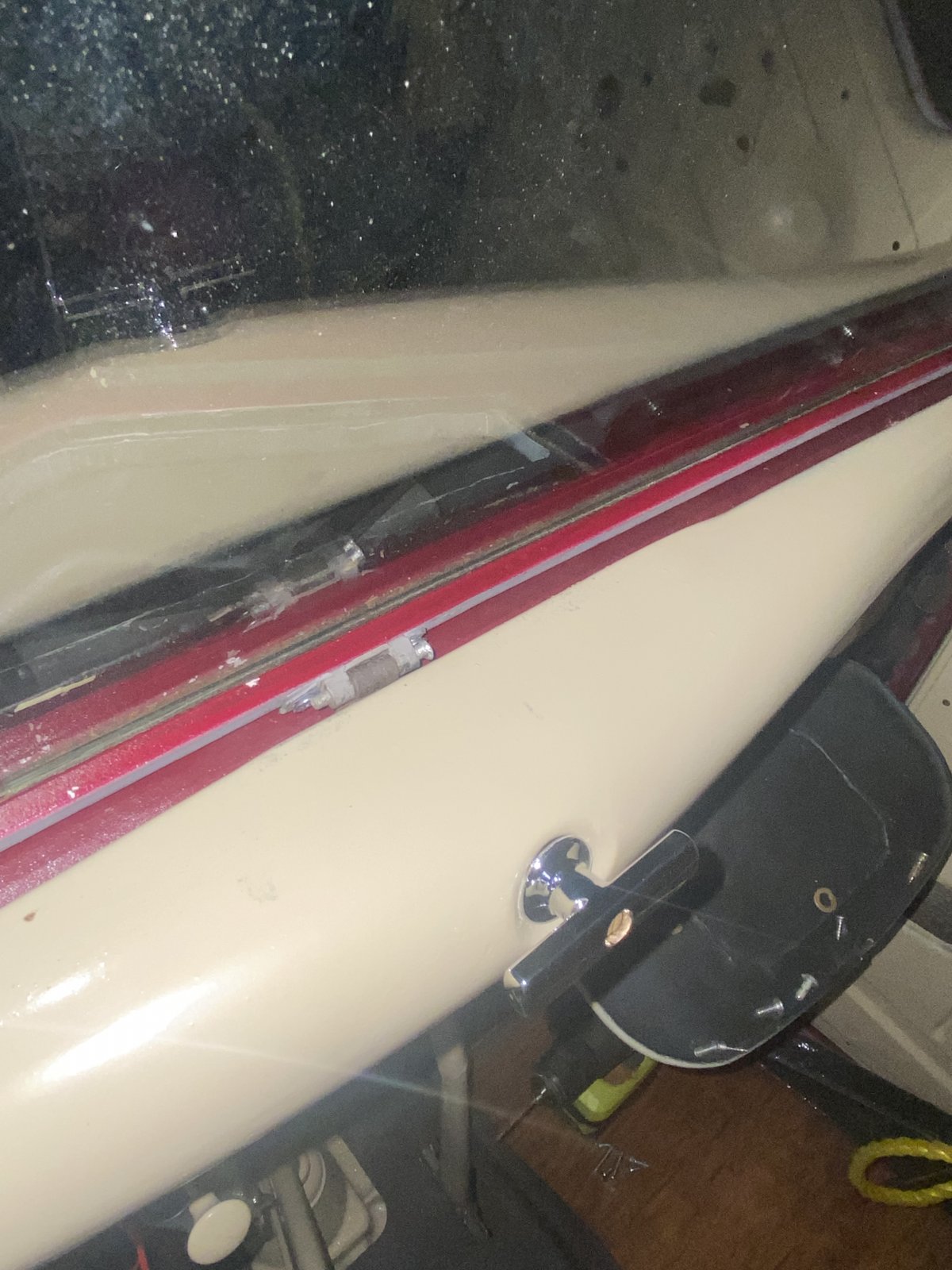

  27. Next thing accomplished was installing the windshield wiper motor and linkage. I’ve explored this before but if you can remember I had to change the location of the motor because it was in the way of the seat. Now it’s in a place not as hidden. I haven’t wired it up yet but all is fastened and ready to go. I had to get creative and use some plastic tubing for a section because it would have been 10 times harder if I used the aluminum pipe that’s the kit came with. Tomorrow I’ll try to install the windshield wipers and maybe wire it up. 23F87630-4619-44AF-B545-31064708D9ED.jpeg 42790756-84F4-49BE-9A86-0DE1205B5C7F.jpeg 97A085FE-B2F2-4A97-B7FC-DB55C6BBB274.jpeg
    210superair likes this.

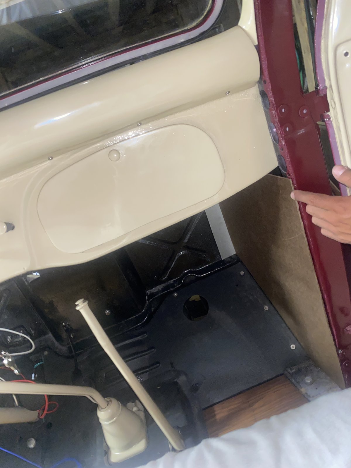

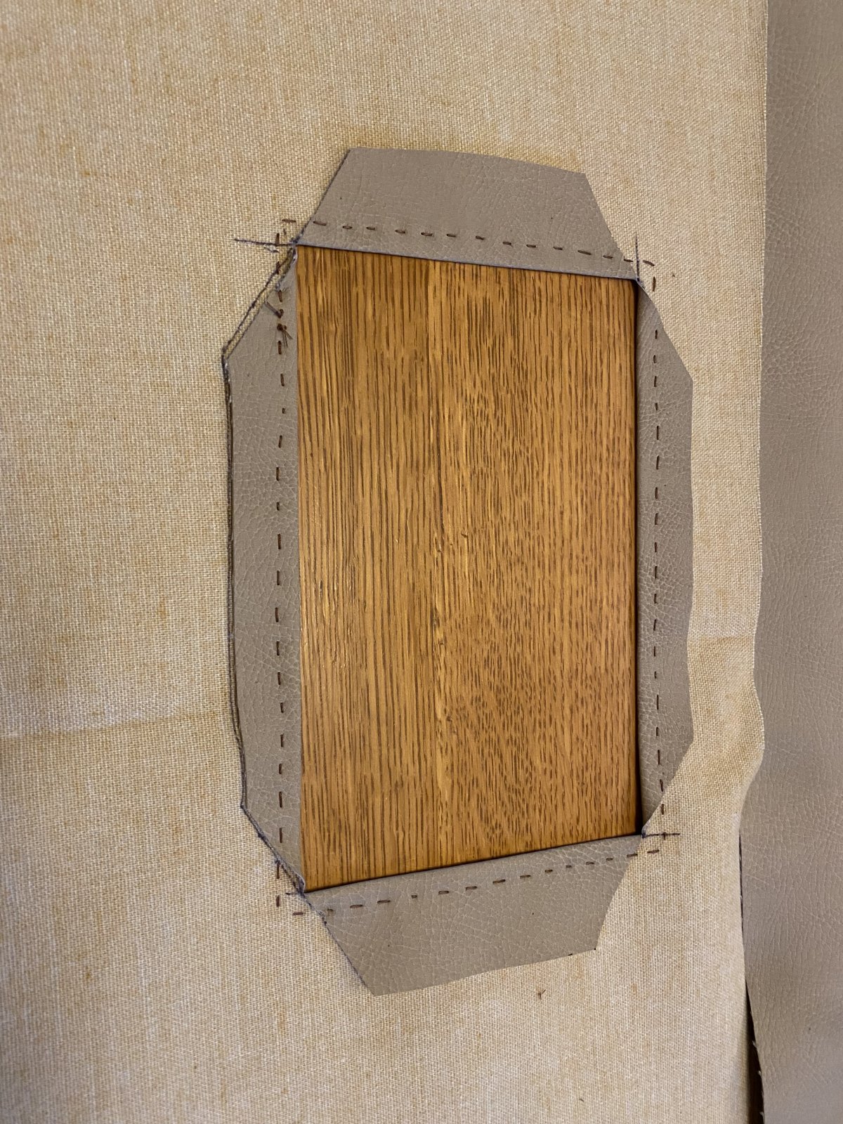

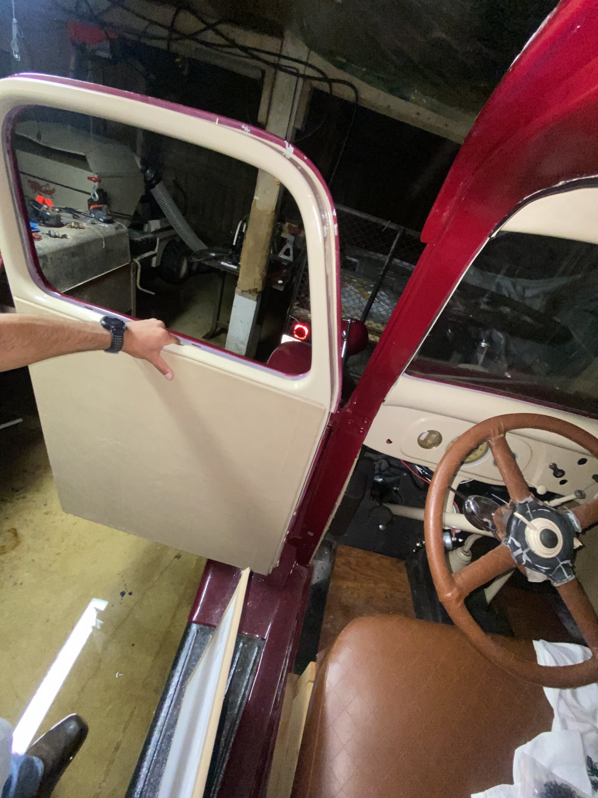

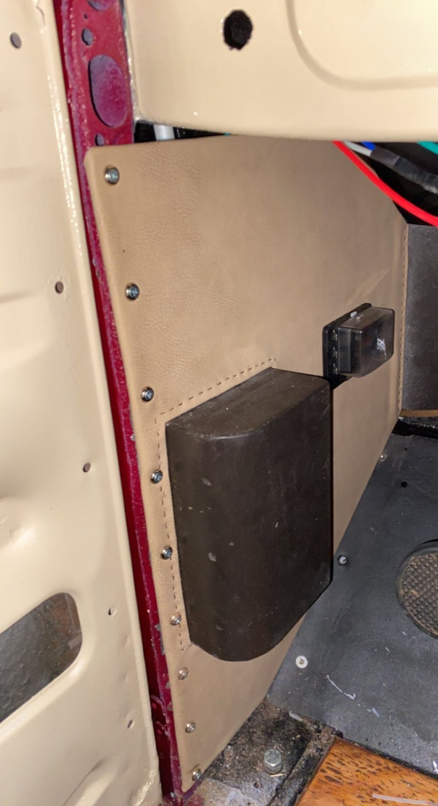

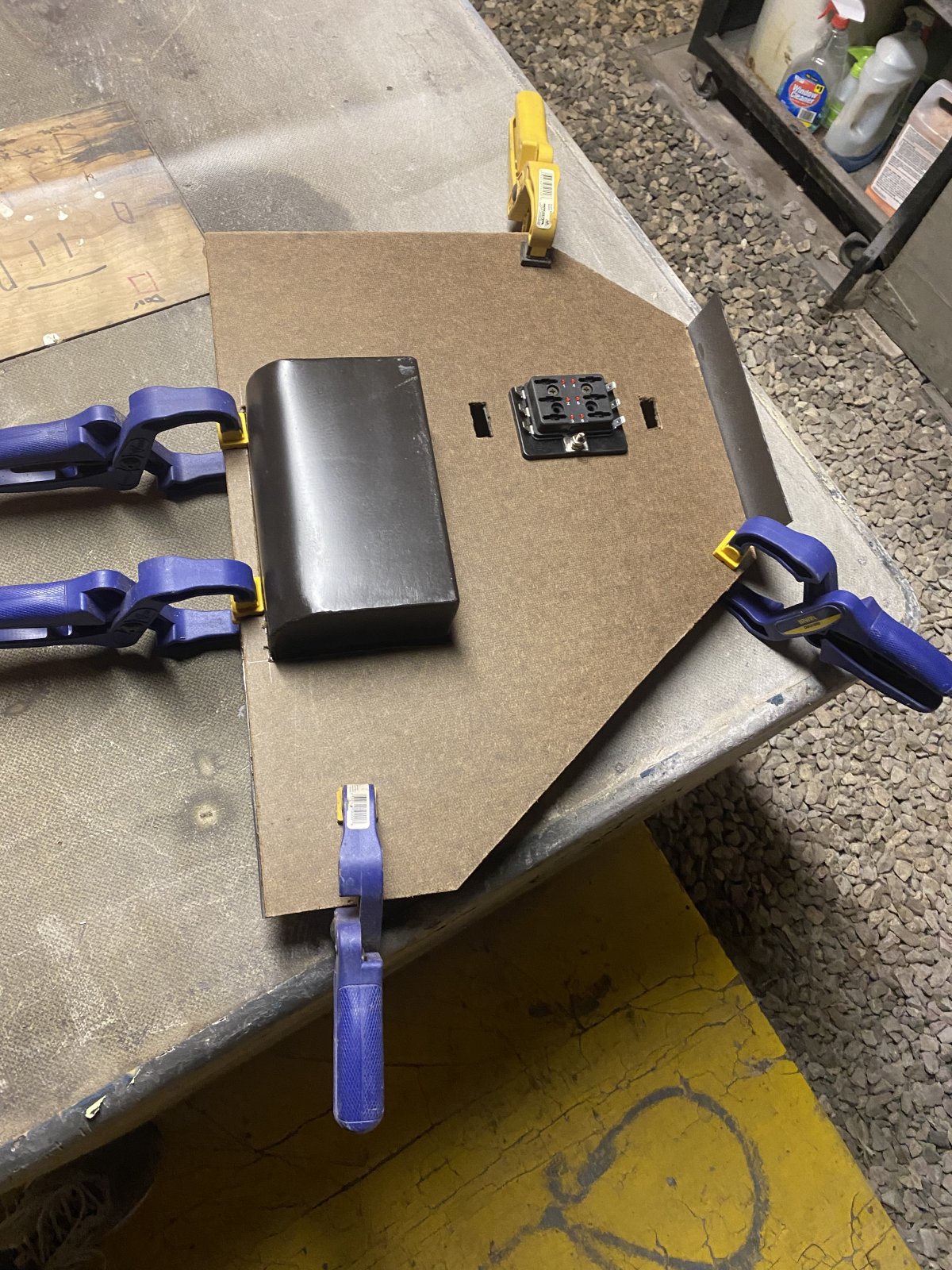

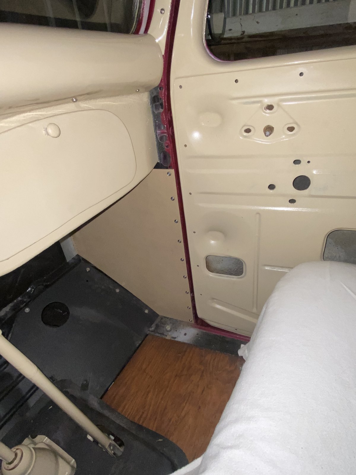

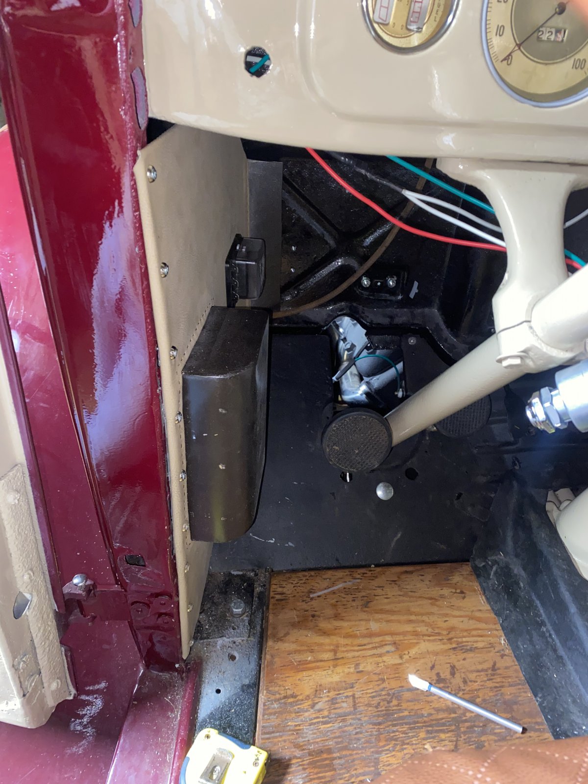

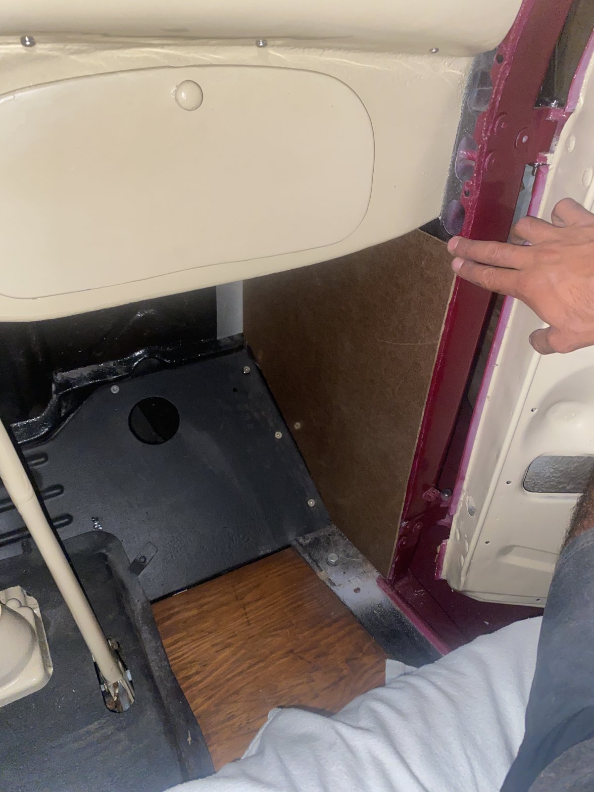

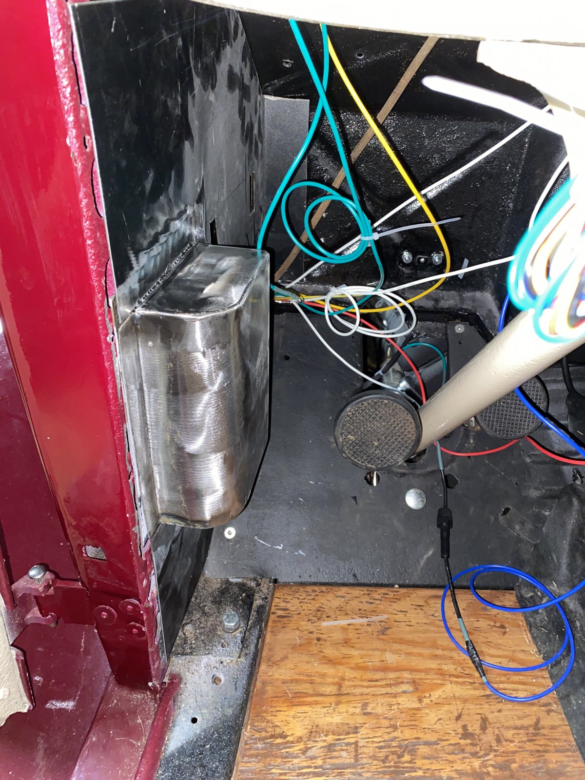

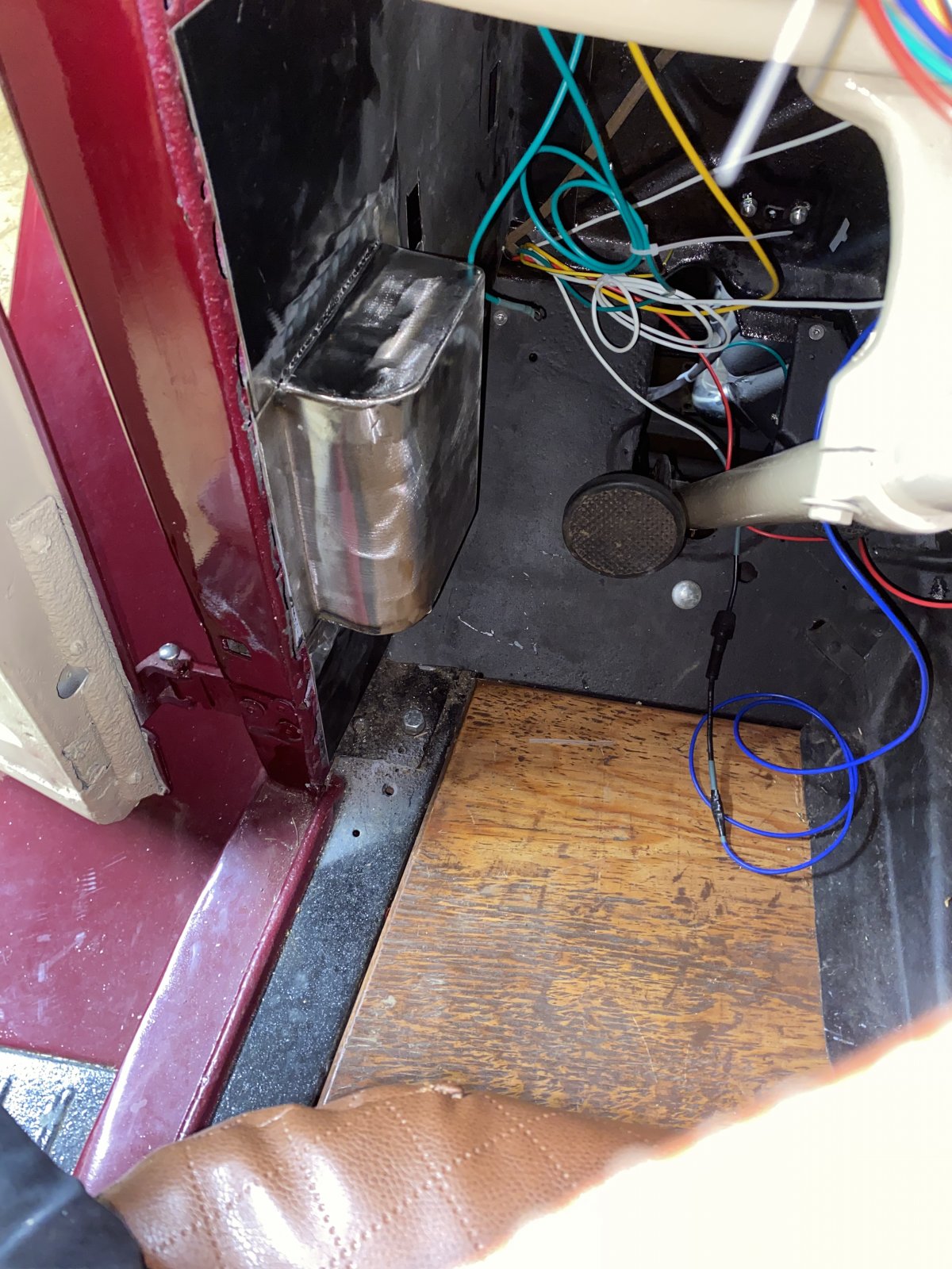

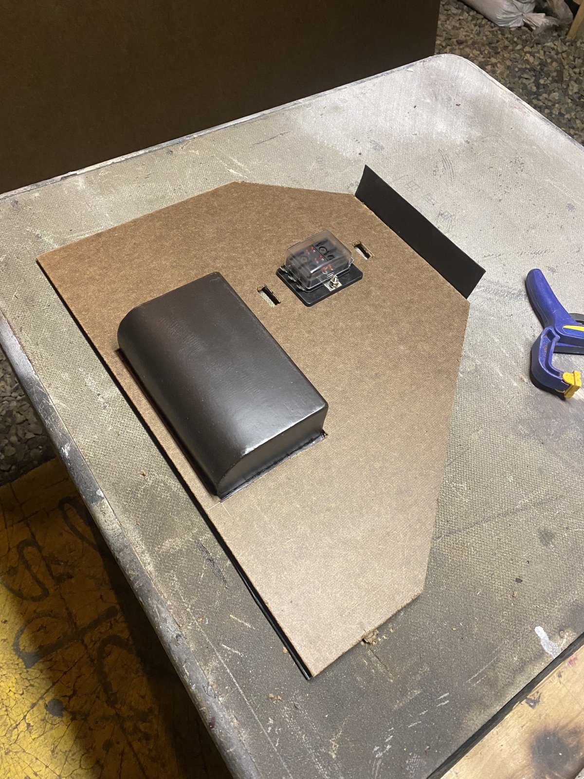

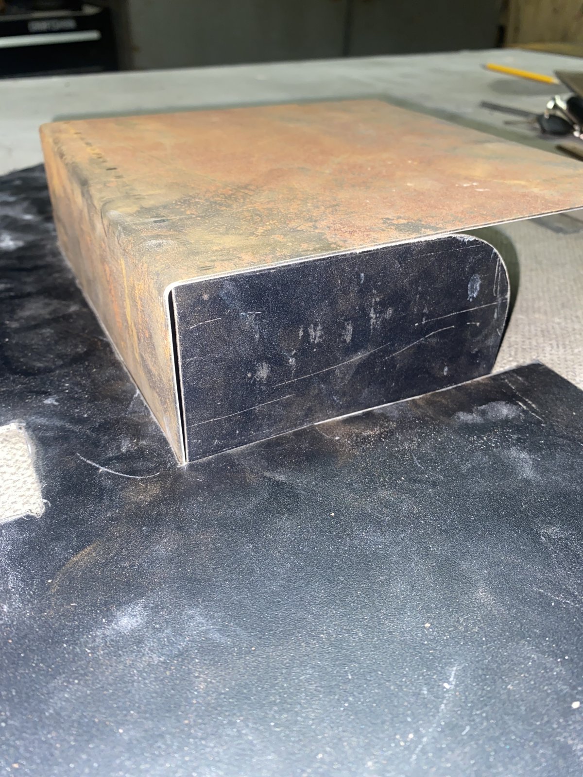

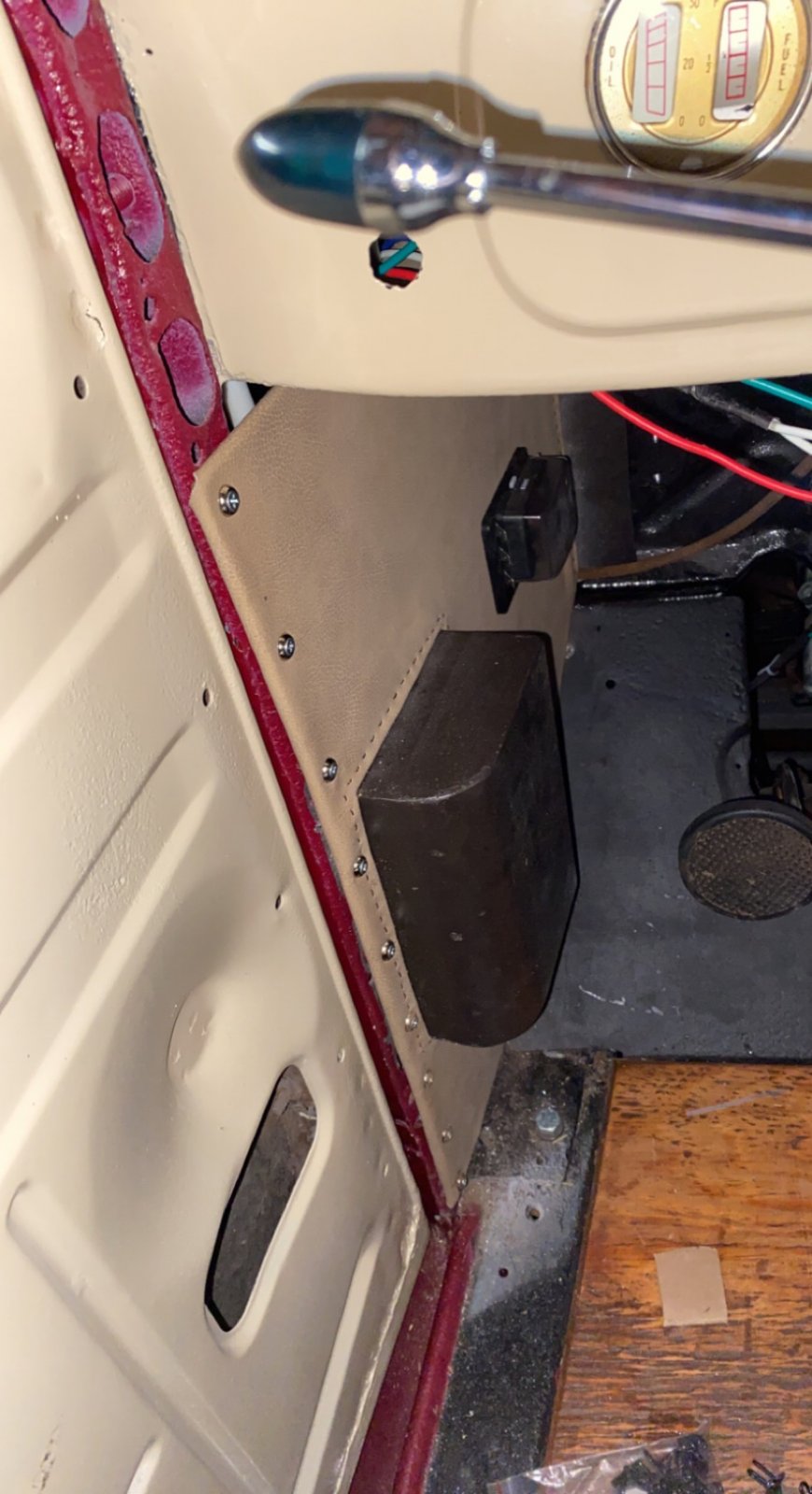

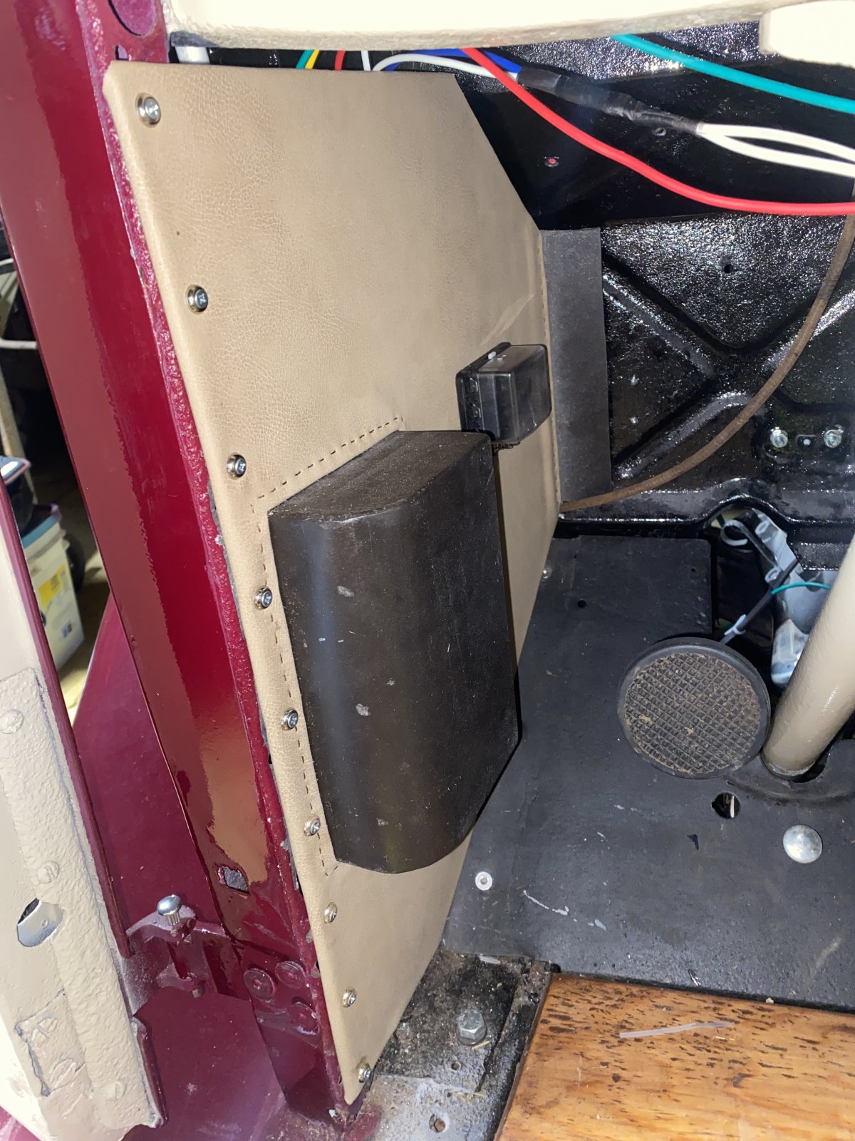

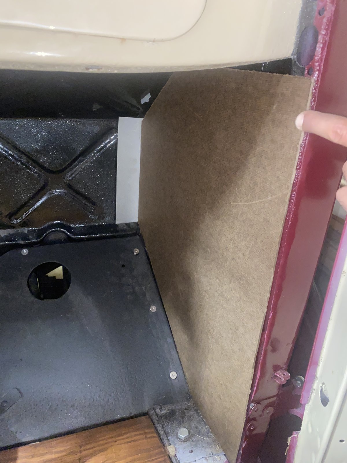

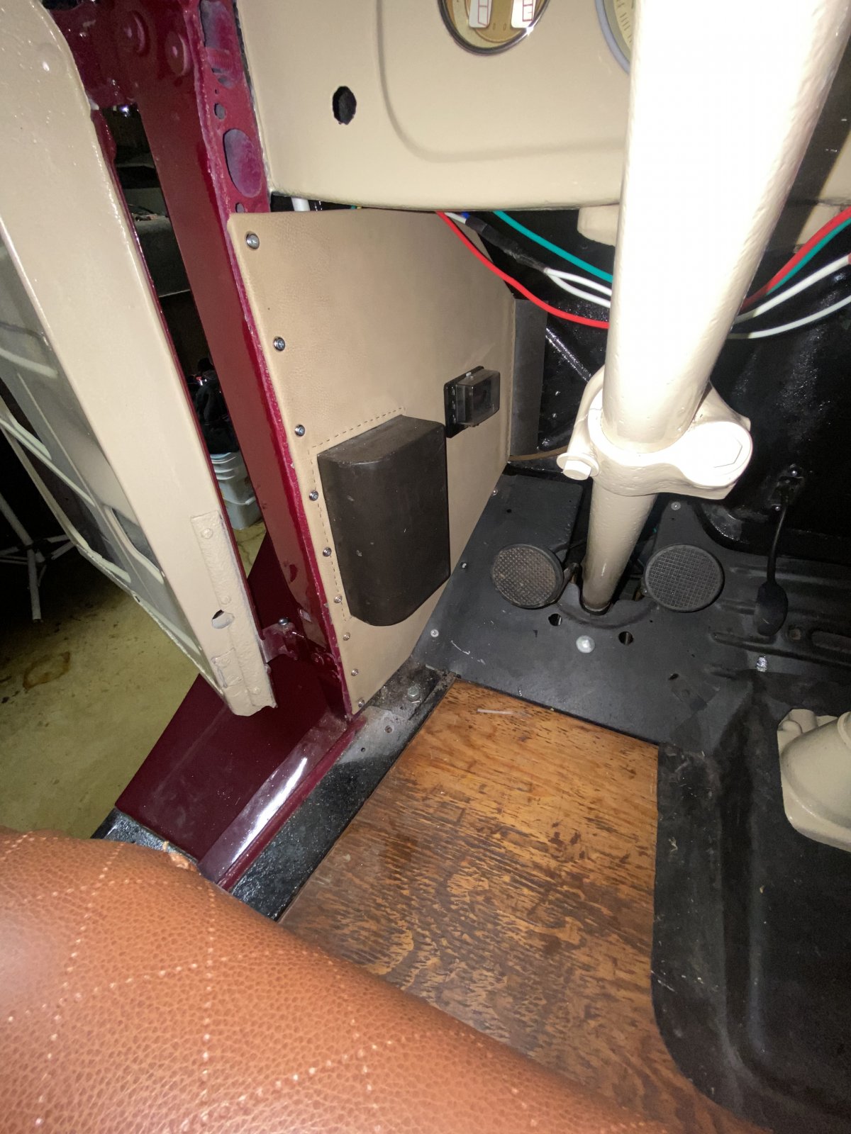

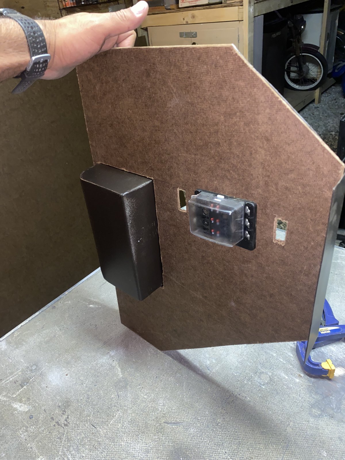

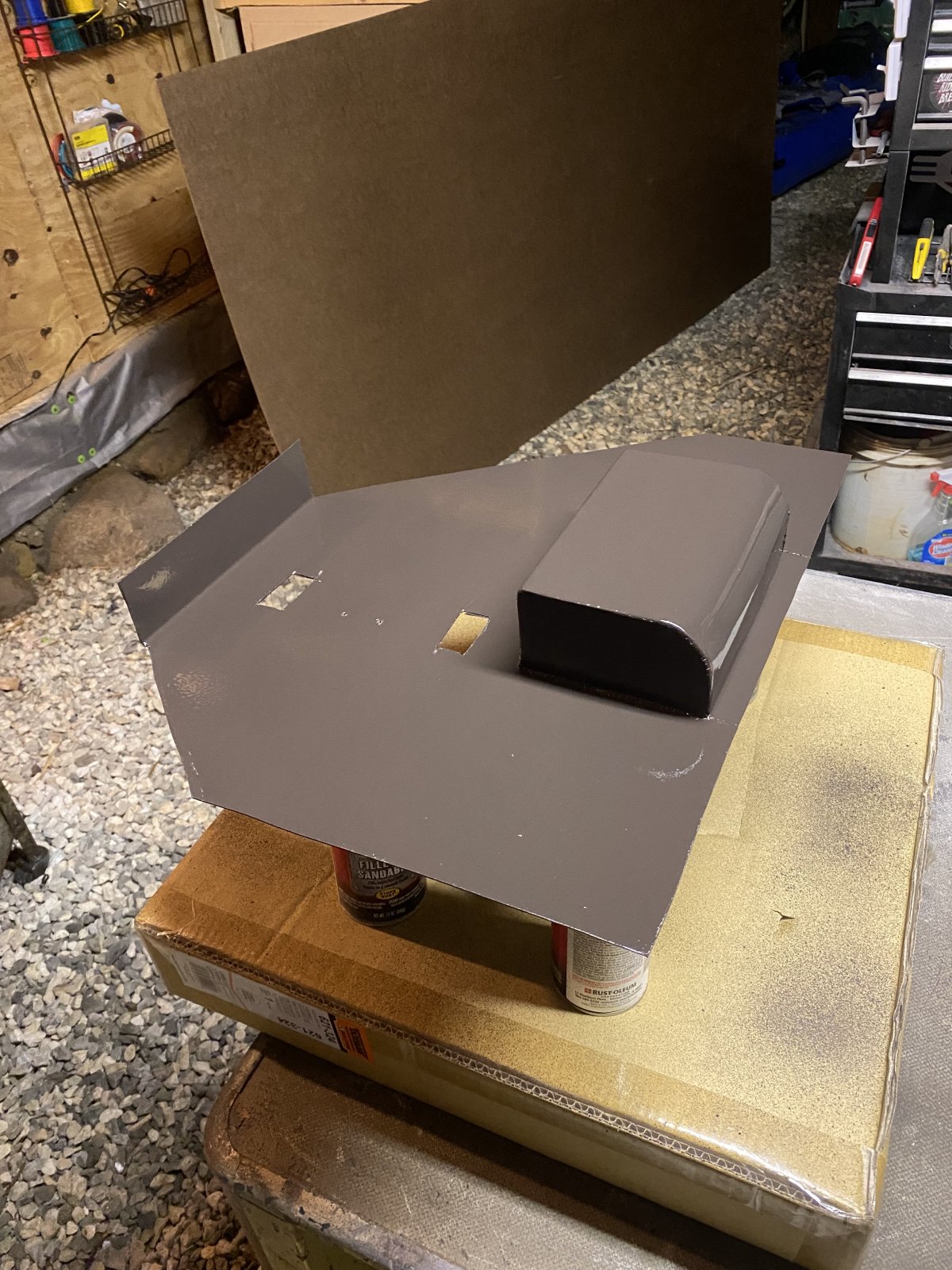

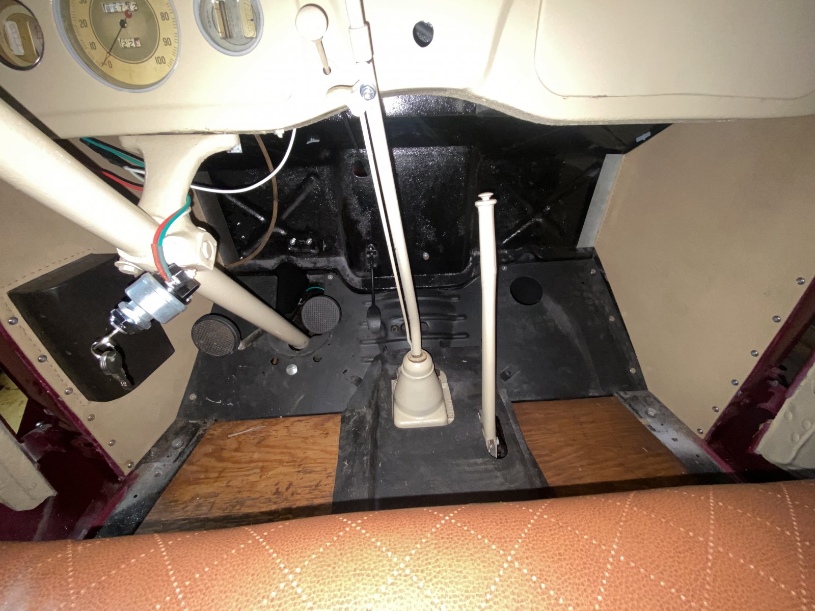

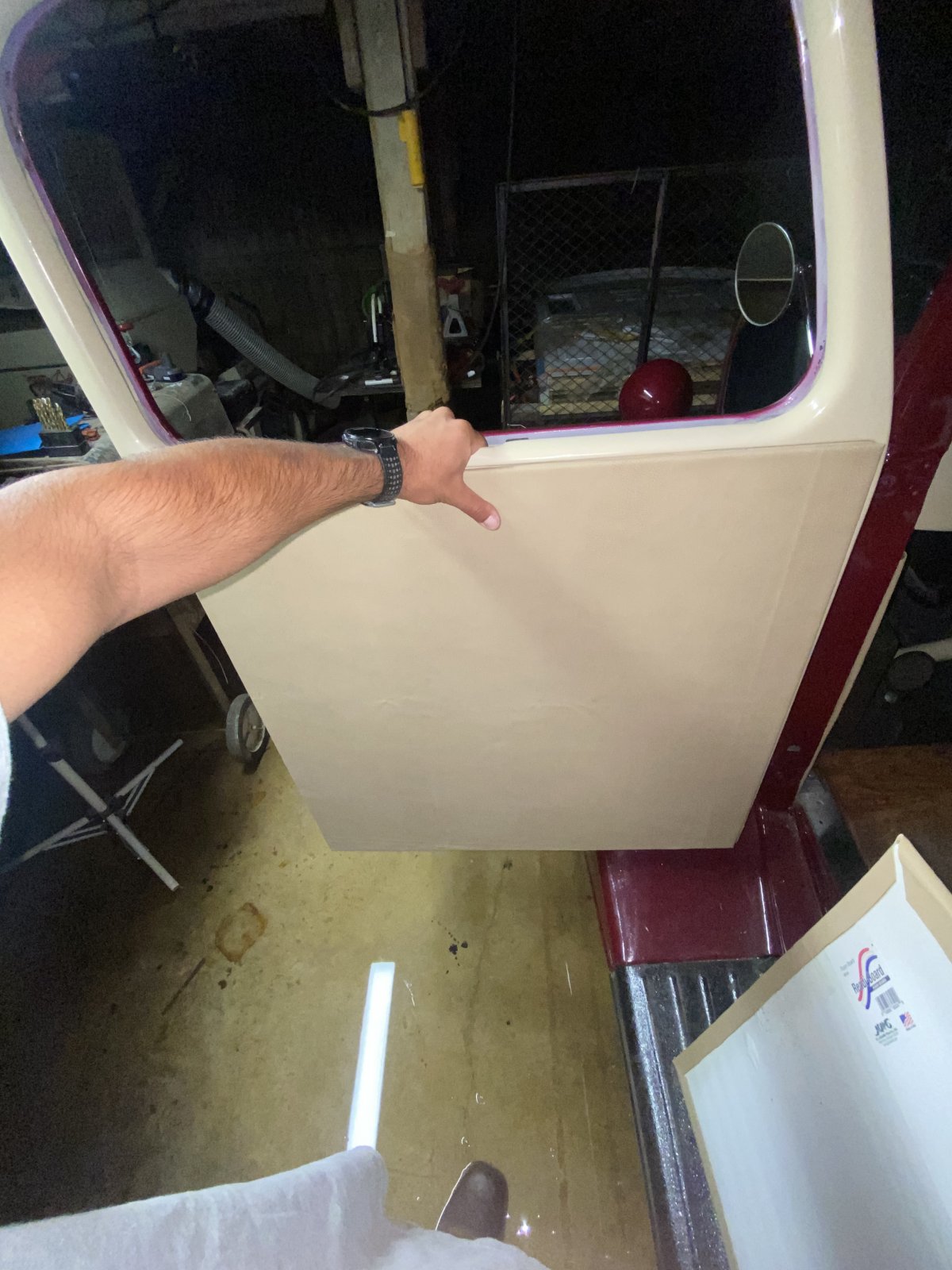

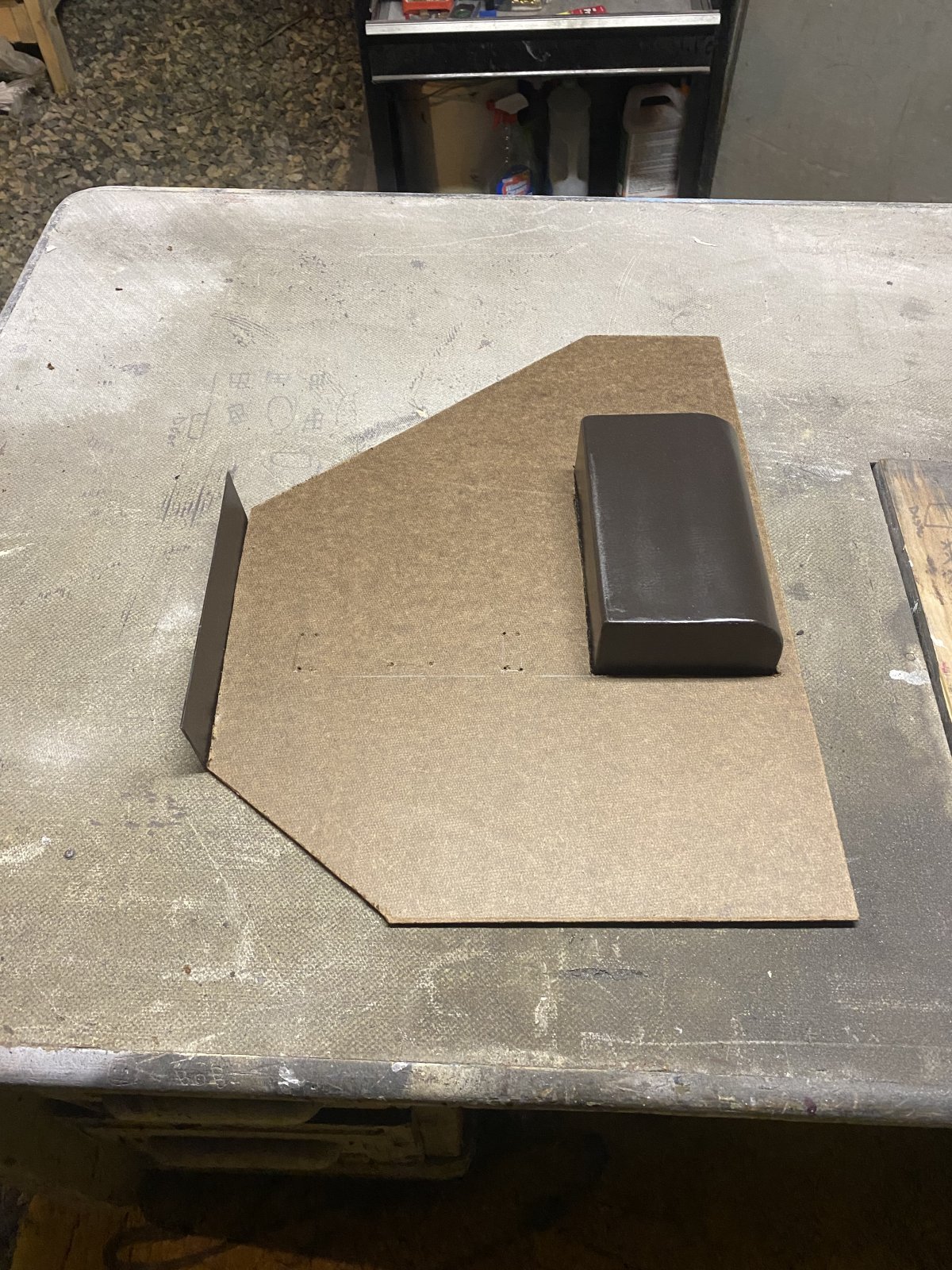

  28. Today i started to make the inner door panels as well as the panels by the floorboard. I had to made the drivers side panel special to cover the motor. Not the prettiest thing to have but I think I covered it the best way possible. I’ll just have to glue the fabric to the panels tomorrow to finish these. There will be a little sewing required but overall pretty simple. Personally I’m just ready to have all that wiring tucked away neatlybehind these panels.
    You can see all I did was make metal panels for the floorboard pieces since those panels might get kicked. On the doors I used a mixture of the hardboard and some foam board. I needed a little more thickness with the kind of clips I have, other than that there’s no great reason for the foam bars. Maybe it’ll help with lessening vibration noise but other than that, not much.
    639F429D-5F9F-4A4D-B146-A88D787271C7.jpeg CCDC3618-733D-4694-945E-4F1C877339F6.jpeg 15A68218-5EEC-45EB-B1D8-E1260B54DAC6.jpeg B1401C17-BA58-4739-A7F2-F2236A05843E.jpeg 0F5F4306-4FF0-42B9-BFBC-8E384F87EDBB.jpeg F11510A7-03B9-4FF9-849E-D031DDC9411A.jpeg 0DA69776-96F1-4D8B-AC21-A29037ADD1ED.jpeg 58ED492E-EC12-454B-B0C6-D41E8E272268.jpeg A42A6885-CE5A-4230-89B8-3FBFD0CE5591.jpeg 0249511B-2030-42C8-988E-BA2377D13DA8.jpeg 05021A67-3A1D-40C1-96F5-FA72D0F264DF.jpeg 404483CC-C00A-436E-984B-8FD7A6FFA7AA.jpeg 98BDF2E7-47A4-4BCA-85F7-C64F31337D88.jpeg CF58129B-CF80-4DE2-9C4F-E0E019FE1BA0.jpeg 7F5E7771-C5D0-454D-9D44-4158DB626AB4.jpeg FFBE0F9A-BA53-4CF6-A590-8061E0CCAAA2.jpeg

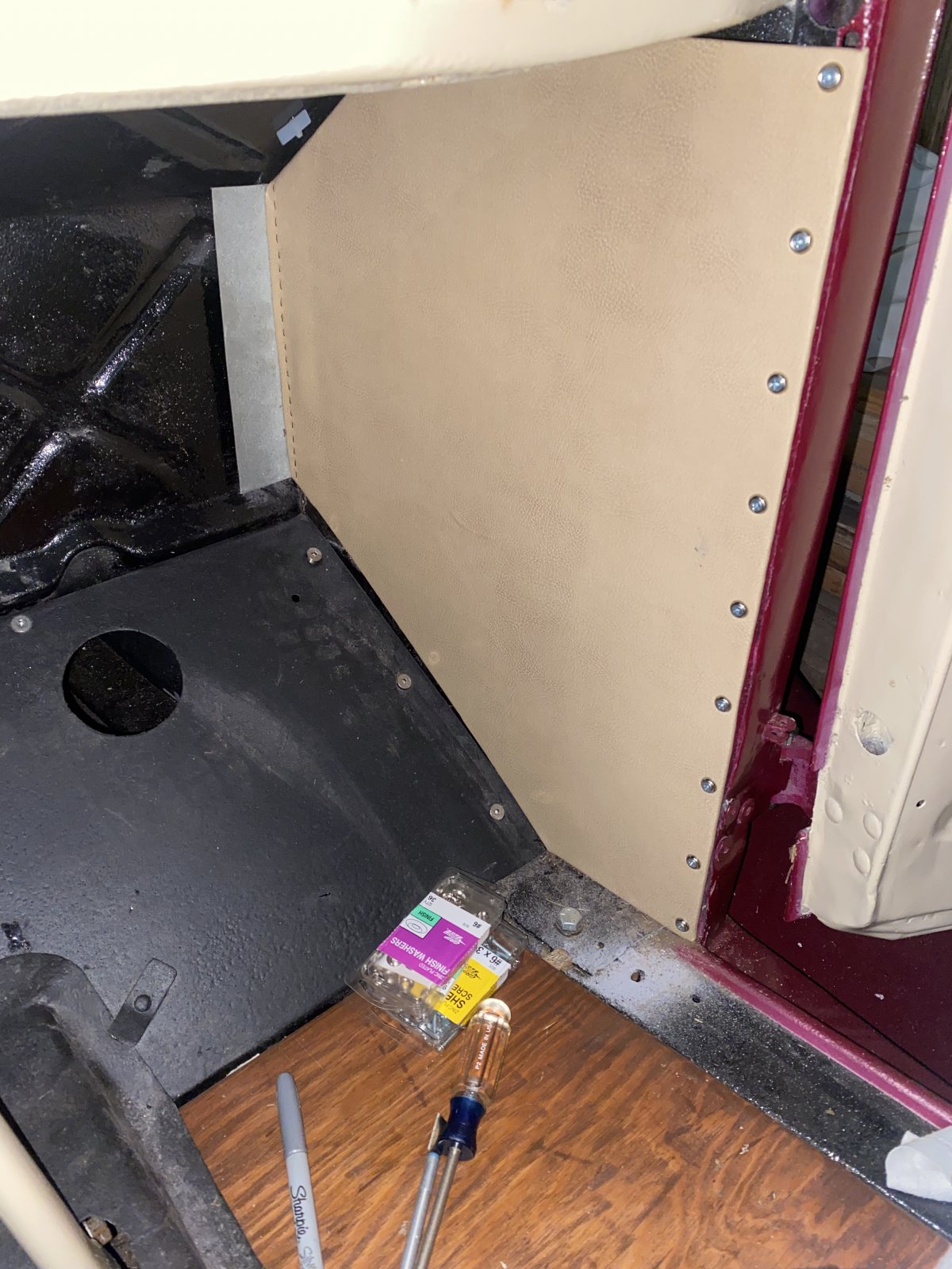

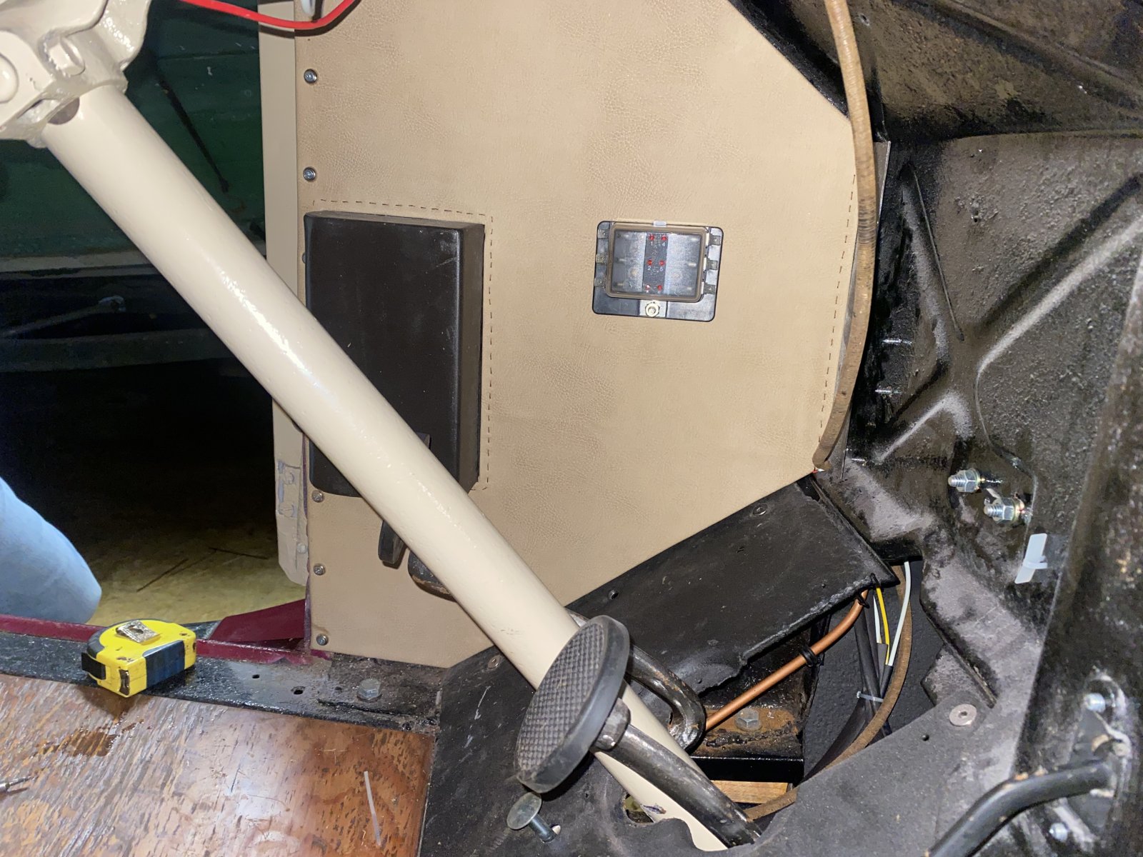

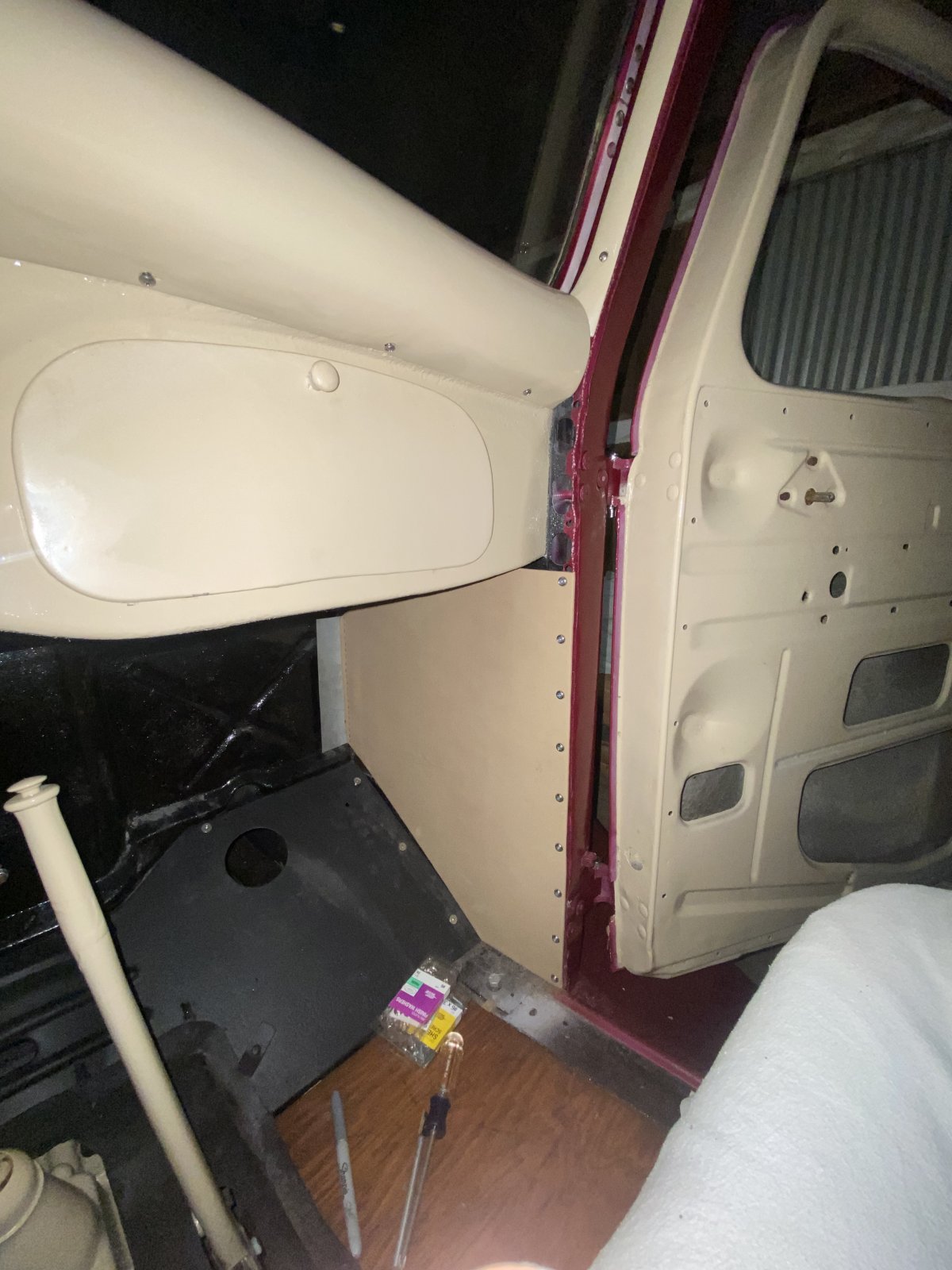

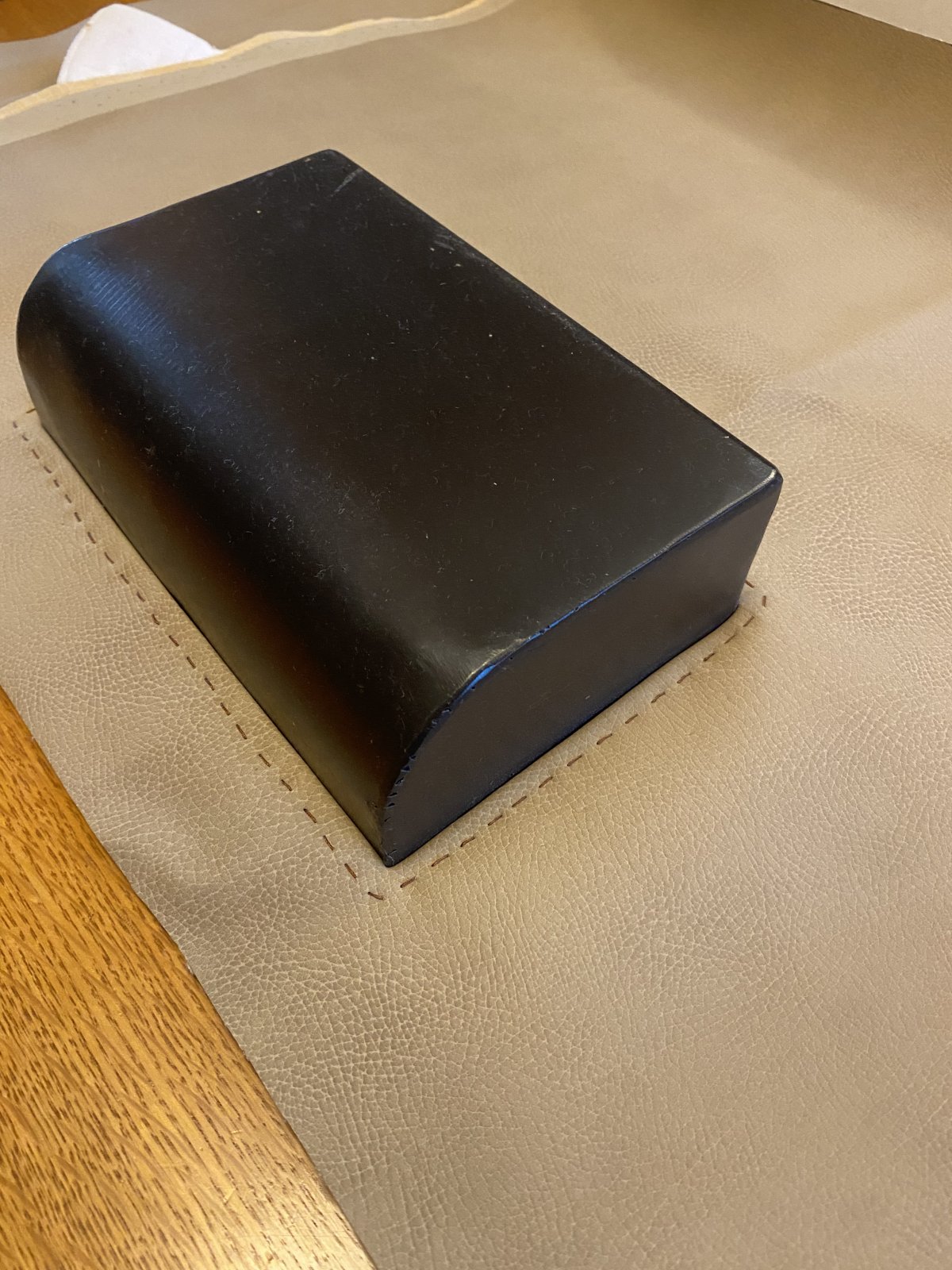

  29. Got all the panels made today. It was a little of every thing to get it done: cutting, gluing, sewing, and bolting. I’ll let the photos speak for my work but I think I came out pretty good.
    Only mistake I made was that I accidentally made two p***enger side door panels. It was extra work to peal the foam panel off the hardboard, cut a new piece and redo it. But overall I’d say everything went smooth.

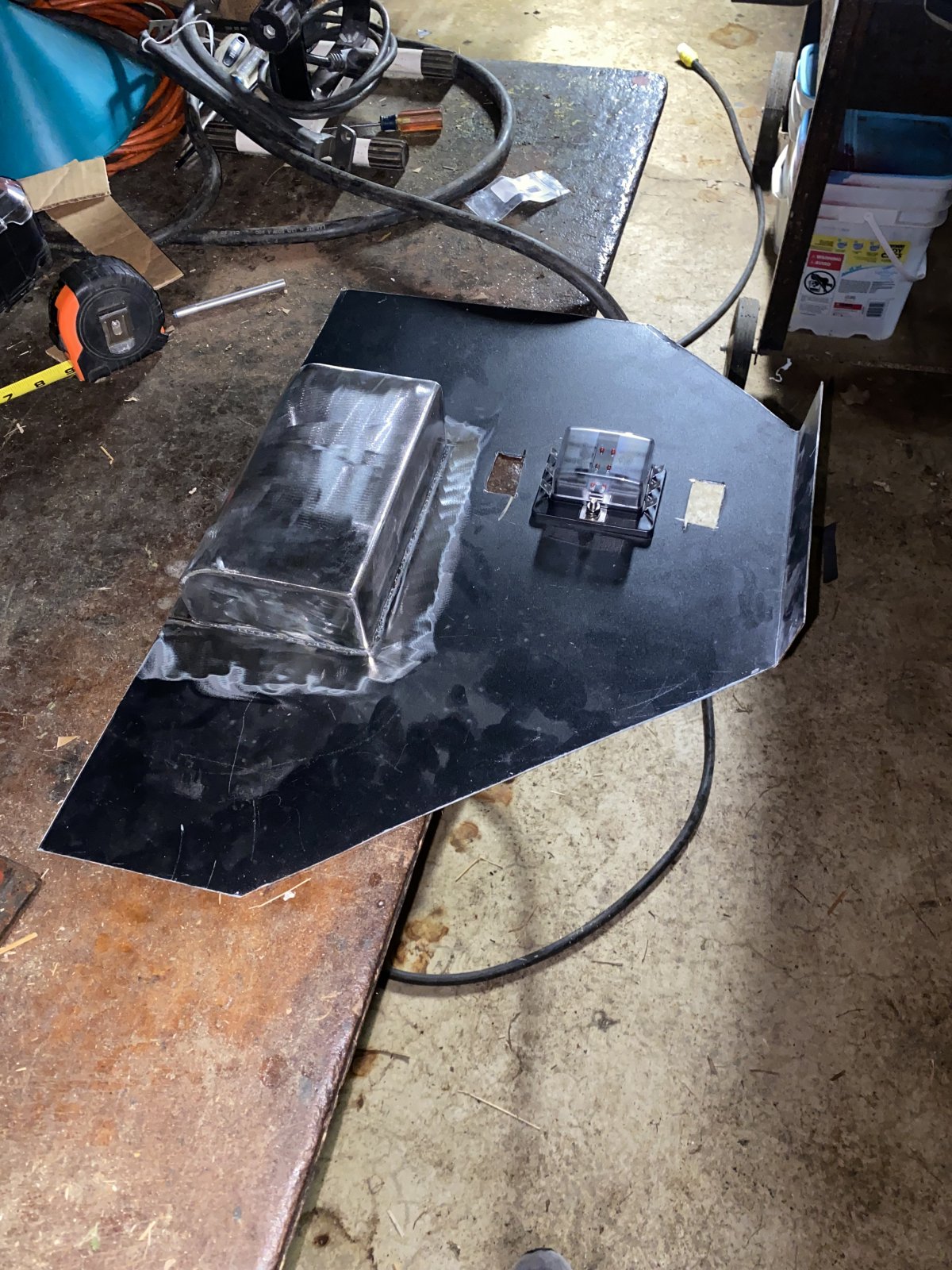

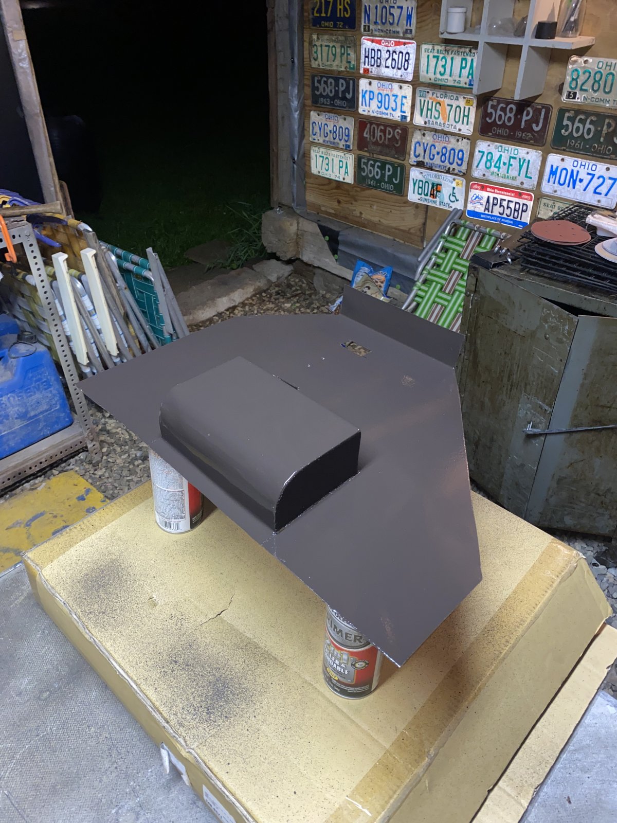

    Haven’t hooked anything up to the fuse box yet, I’ll have to think about how I incorporate it and what wires will be off of it but it’s there and ready. Most importantly, all the wires are now hidden behind it.
