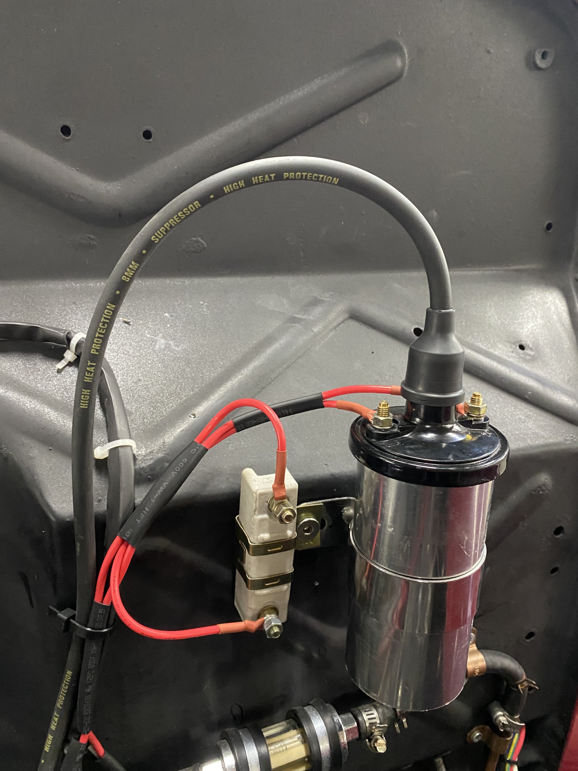

  4. Got a little done today.
    -checked the horn I bought and it works fine
    -wired up the horn (it just needs soldered in)
    -put the front light wiring in heat shrink
    -hooked up the fuse board, it works great
    -wired up original ignition switch
    -hid all wiring behind the left lower interior panel

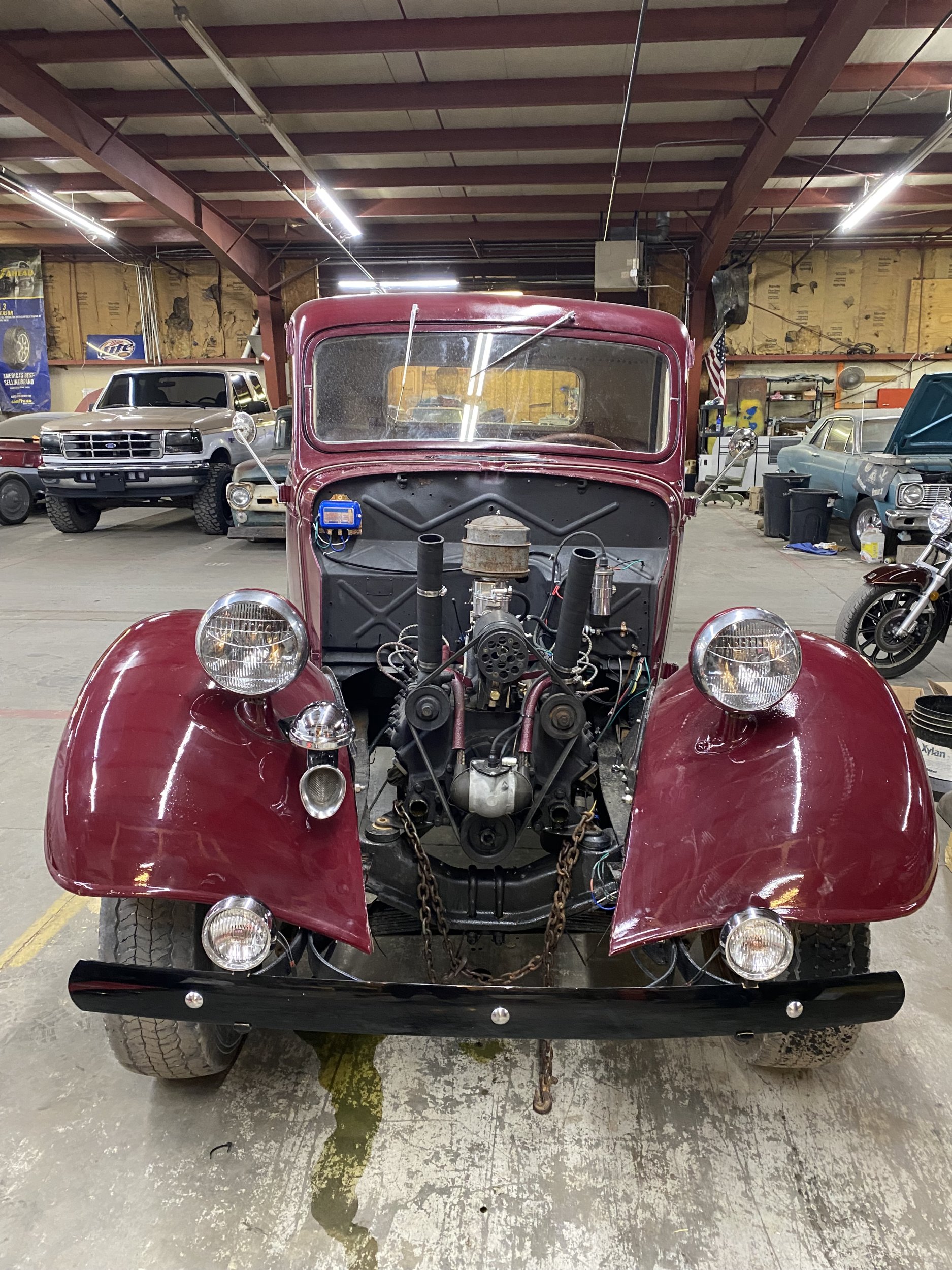

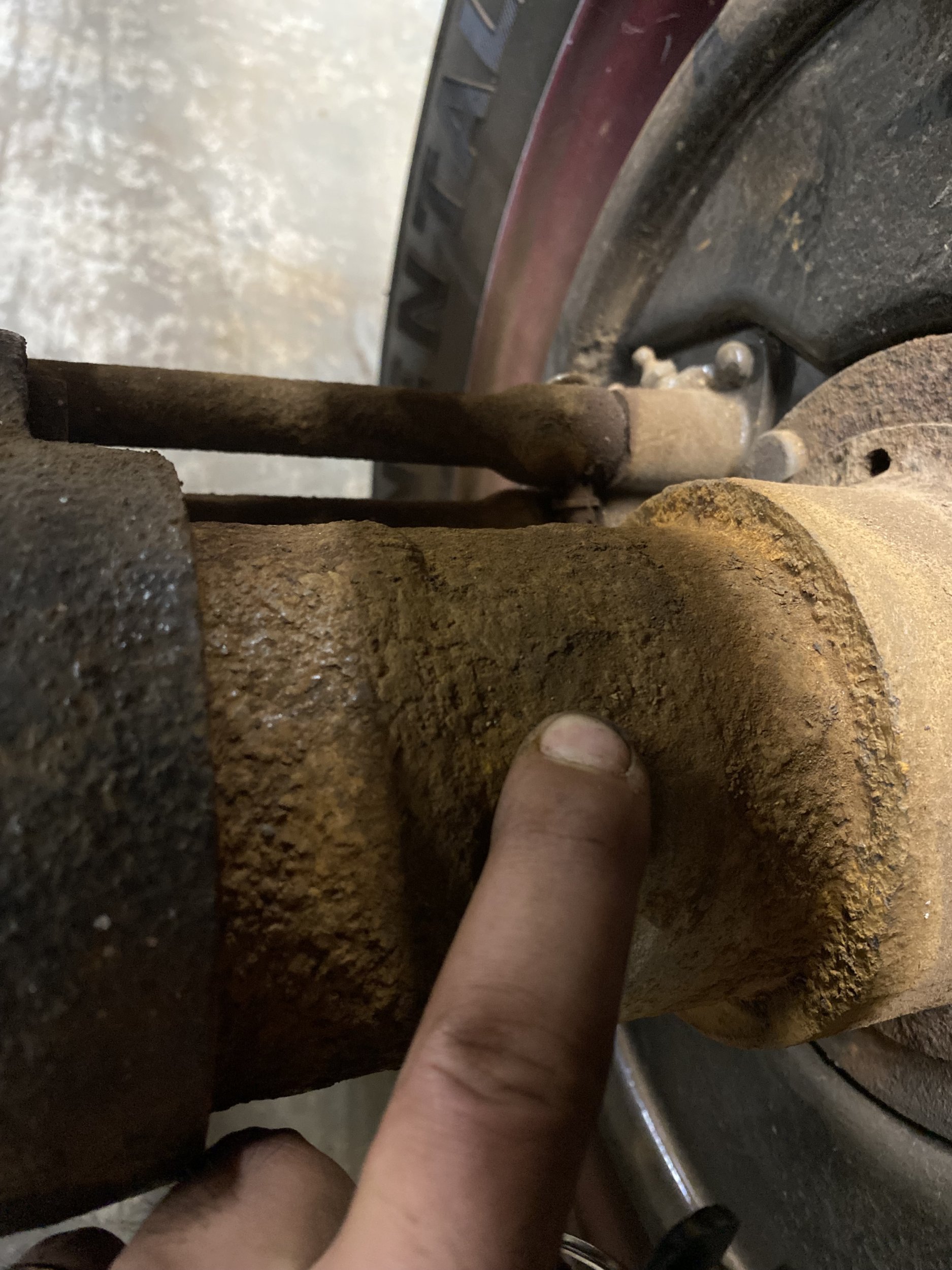

  7. After graduating this fall I realized I never kept y’all updated on this build. If anyone still follows and is interested I’d be willing to post more of what I’ve done.

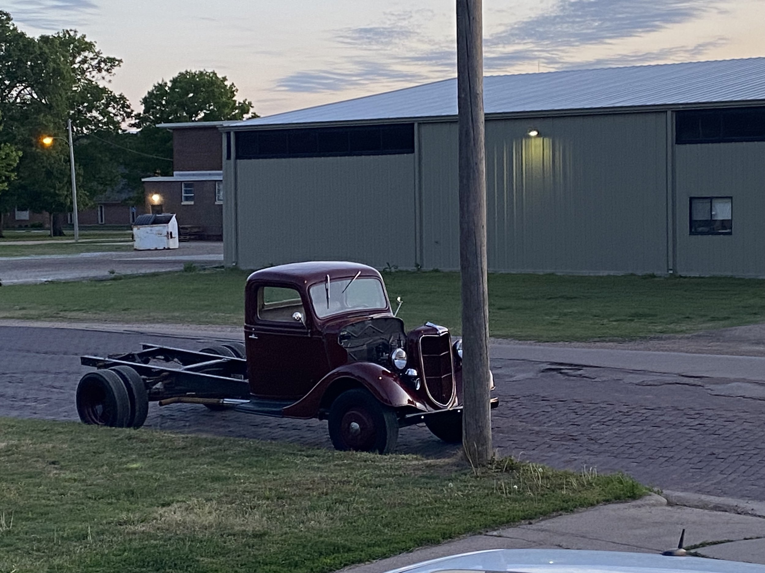

    I took this Truck to Kansas and mechanically was able to dial in much of my diagnostic issues and took it on a few rallies and drives.

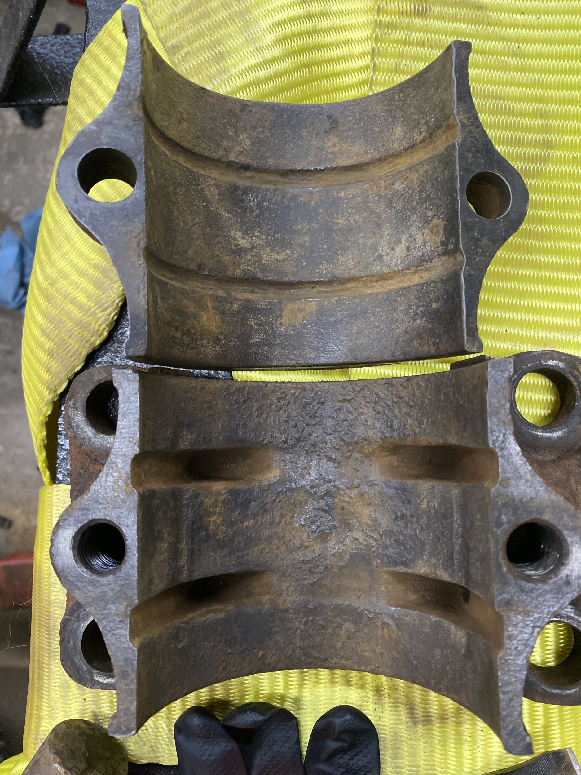

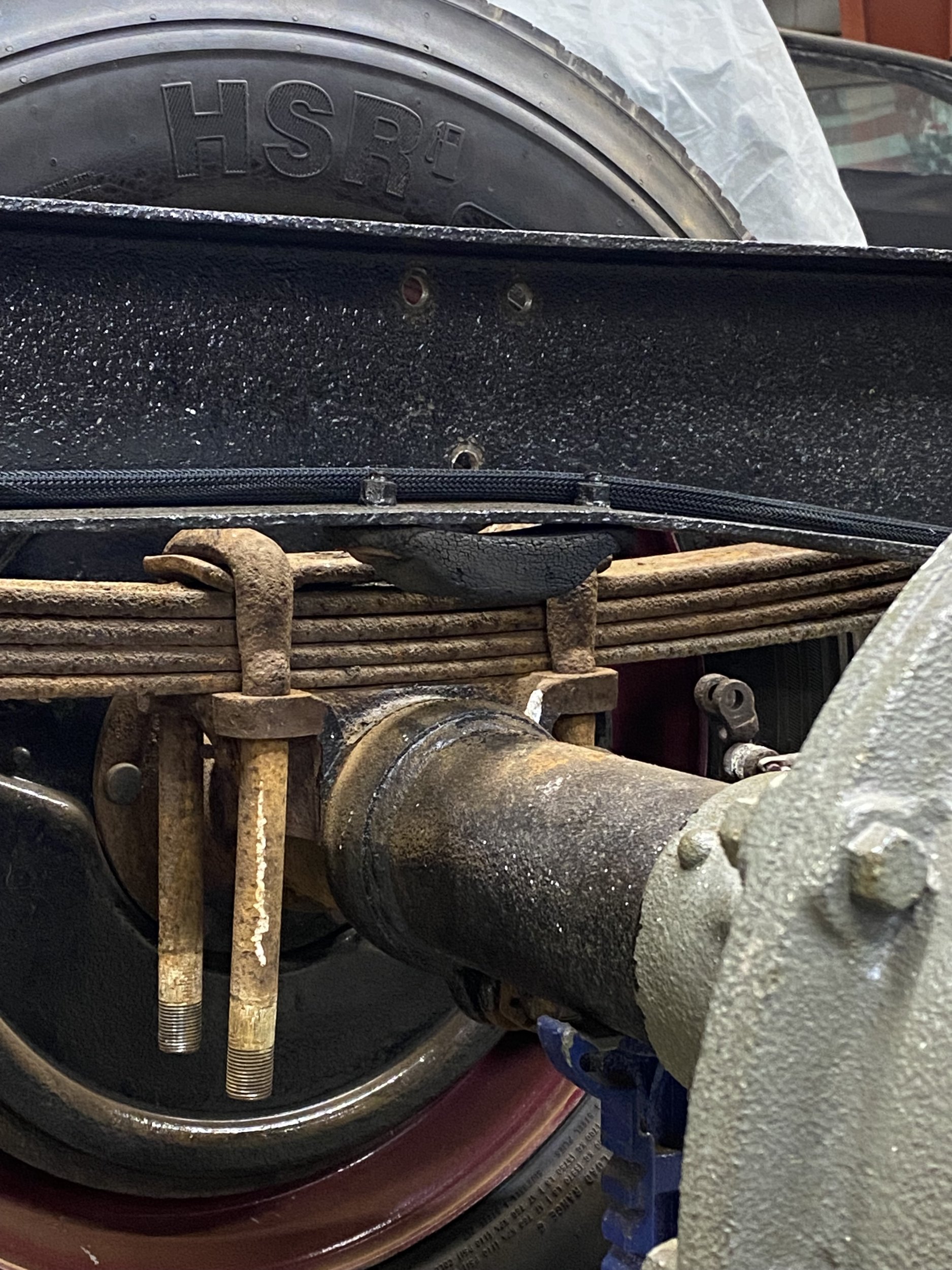

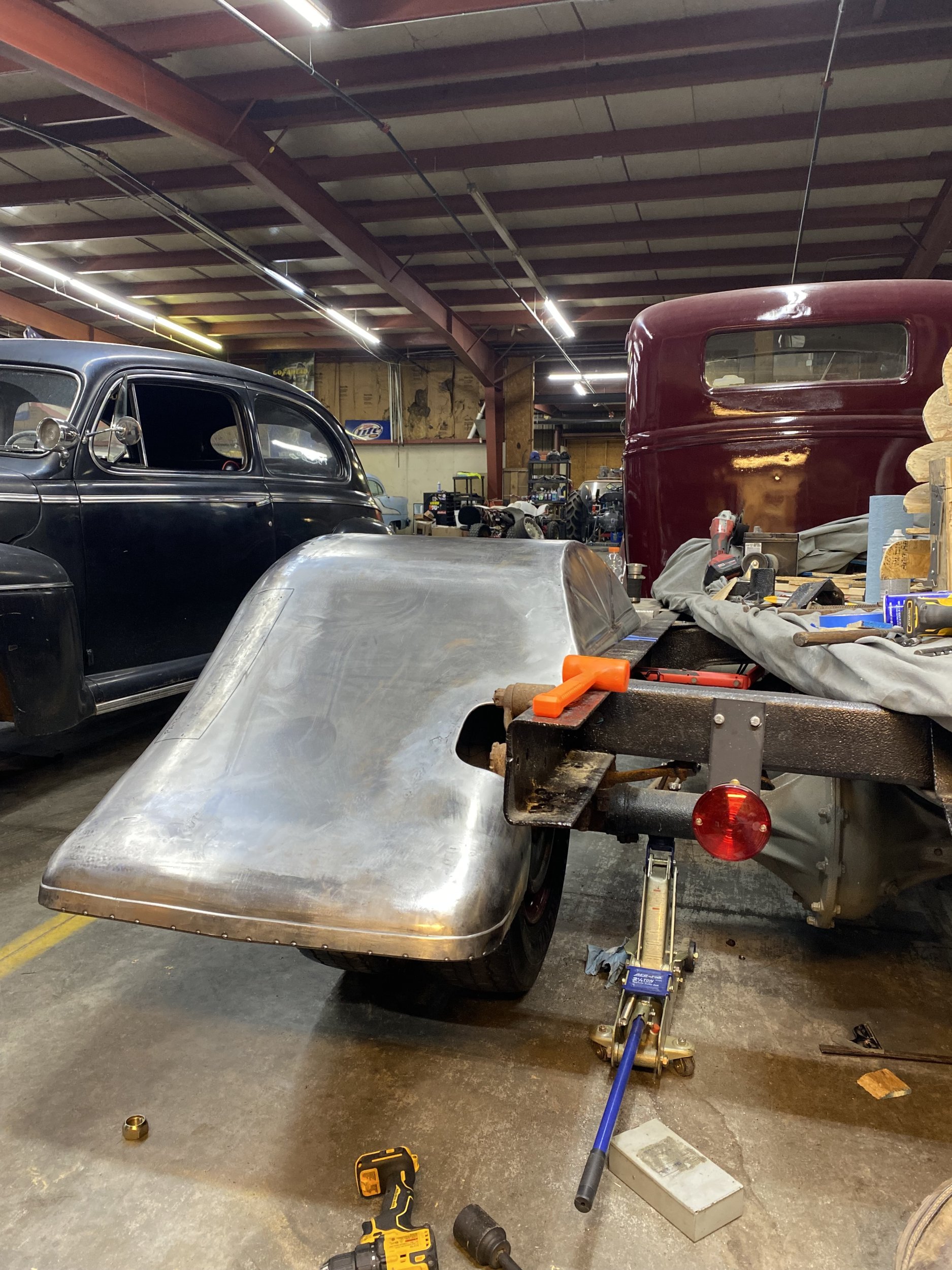

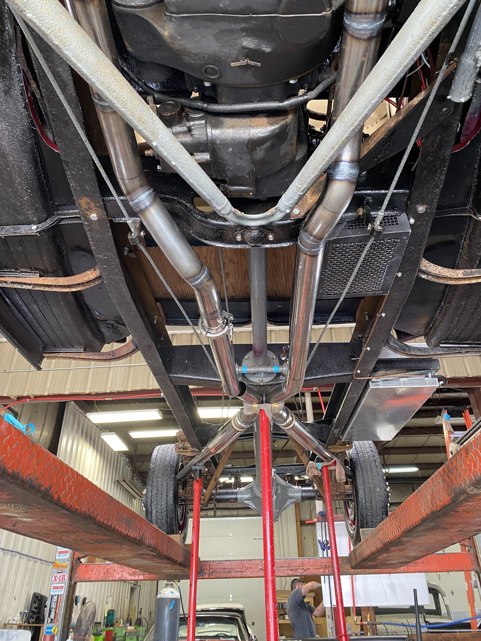

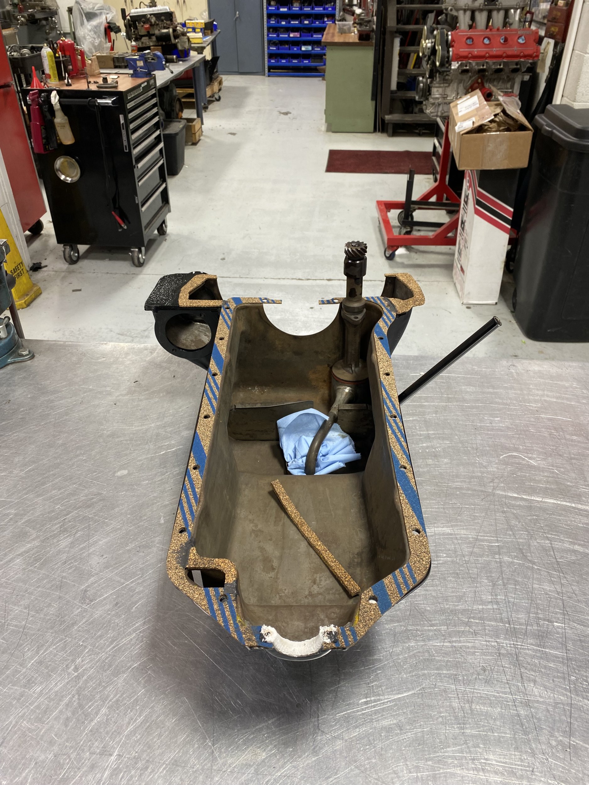

    I’ve done a lot of other things such as final ***embly, fabricated custom removable blinkers, made a custom rear fender, removed springs, custom exhaust system, pulled the oil pan to reveal a surprise, and much more.
    My metal skills are my strong suit these days despite the atrocities I let slide at the beginning of this project. This upcoming week I’ll work full time as a metal shaper in the Indianapolis area doing metal work on coach built type cars in aluminum.
