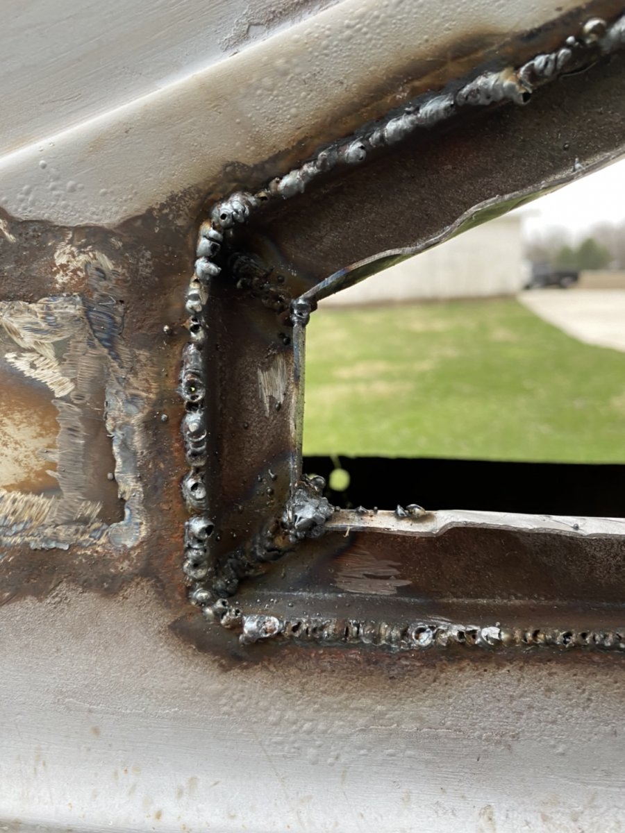

    You could try just setting up some pieces of metal and practising. The welds look like there is no shielding gas. I ***ume you have MIG with separate gas? If flux core I have no experience of that. Make sure you have a good earth. You are doing what are quite difficult welds. Thin sheet metal, vertical. A good tip I learnt years ago is make sure you have a good mask, and can really stare straight at the pool of the weld. Put tacks at intervals, dotting all around and then slowly fill in the gaps between with more tacks/short beads until there are no gaps left.
    If you're **** welding you can get inexpensive clamps that look like a piece of 1" square tube with a bolt and a strap through. They can help.
    Best of luck, practise makes perfect.

    I've had my fair share of welding on rusty thin sheet metal, especially on exhaust systems. If the metal is rusty, and thin, it is very easy to blow right through it. Where practical, as suggested already, cut further back, if not, try to build up on areas that you already managed to get a bead laid. It is time consuming, but you do what you have to do.
    If using a flux core machine, I'm guessing there is even less shielding gas available than with gas, and again if welding outside, even the slightest breeze will leave you with no shielding gas. If that is the case, try to set up some sort of wind break close to the area you are welding with some s**** steel.
    As far as sand blasting, that is really the only solution in your case with so much heavy rust. You can start with just a gun (suction type), and a bucket of media as opposed to a pressurized pot blaster. The only issue, and it is a big one, is that you need a big compressor. Mine puts out about 14 CFM at 90 psi, and I would say this is about the minimum for such a job as yours. Of course, you can get away with a smaller commpressor, but then it kind of becomes impractical due to the "wait" time for the pressure to build up. When you are sand blasting, you are releasing an incredible amount of air under a lot of pressure. If you do decide to try sand blasting, get the proper personal protective gear, and DON'T actually use sand due to health risks. I really like gl*** media.
    Also, look into a weldable zinc "primer" paint for those inaccessible areas. In even the best of cir***stances, rust will return, it is just a matter of how long it will take. Clean the metal as best you can after welding. Use wire wheels if you have to, and then get a quality self-sketching primer, and then cover with regular primer.

    The sand blasting leaves a silica like residue on the panel and if you run a flap wheel or wire wheel across it it welds better.
    I am glad to see you are using proper protection. On thin sheet metal i use E70S6 wire 023 in diameter and 75/25 gas and i do use a copper backup. Horrible Freight has these. I have a copper buss bar for backup that I got out of a old electrical panel I s****ped out. Don’t give up it just takes patience and practice.

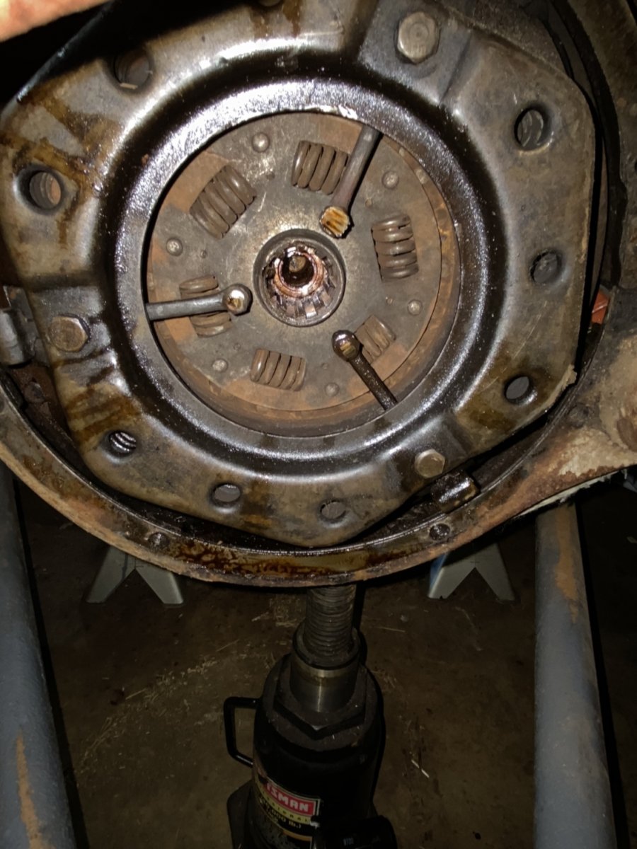

  13. Old transmission came out today. I have plans to go get a replacement next Saturday. In the mean time I’ll clean up everything in this vicinity while I have it all apart

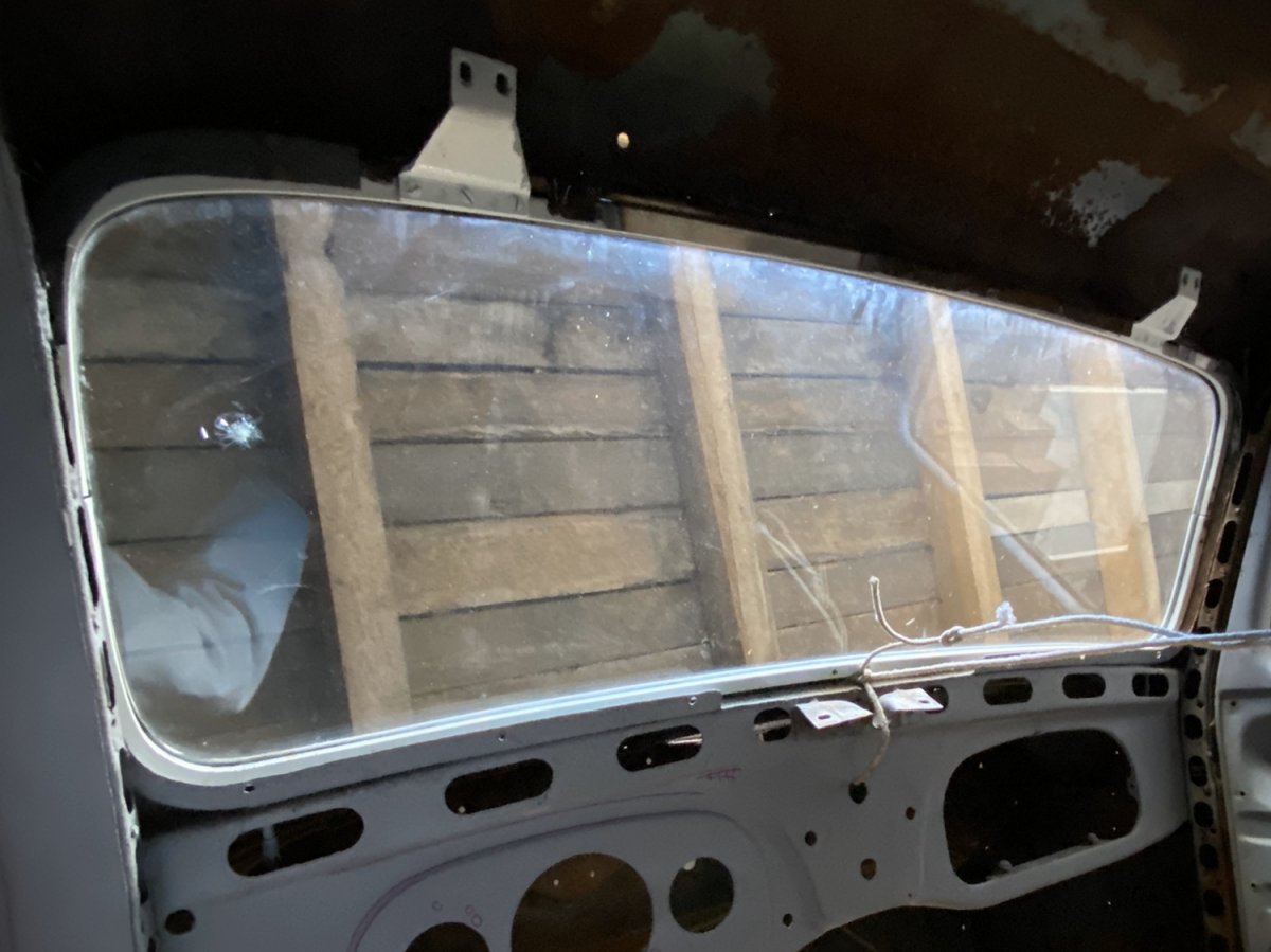

  14. Made the drive up to Michigan today to purchase a new transmission. This window frame found its way home as well IMG_1310.JPG Adjustments.JPG

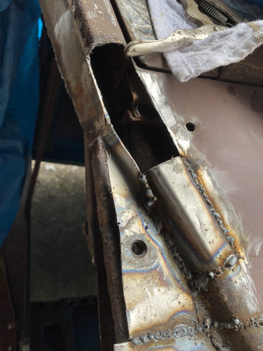

  15. Here’s an update on the overhead piece that goes in the cab, after realizing there was way more to be replaced on this piece I went back and replaced much more metal. Almost done with sanding just wanted to post an update. I’ll be purchasing a sand blaster soon that I’ll take to the back before painting it all. I probably will end up using a more rust protective paint on the back and primer+ color paint on the front
    All of the ****py metal to come out

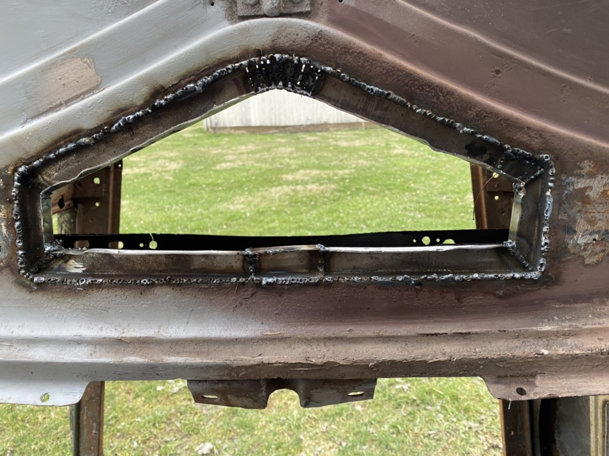

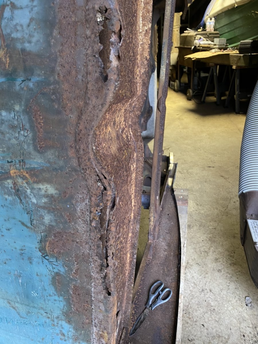

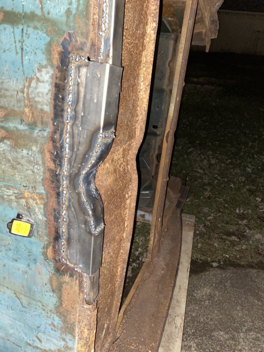

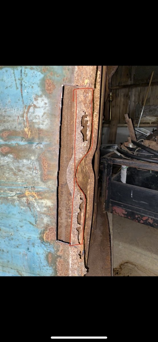

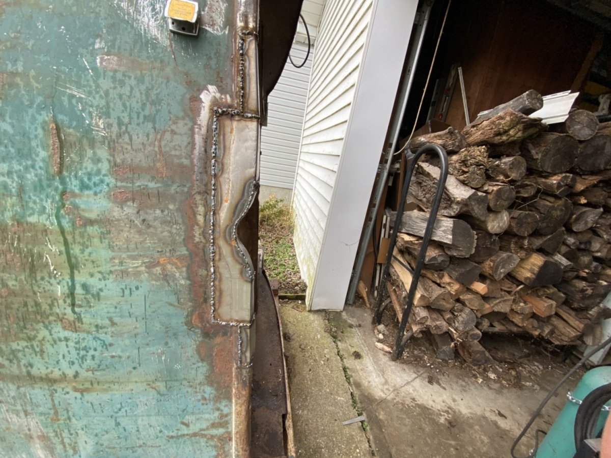

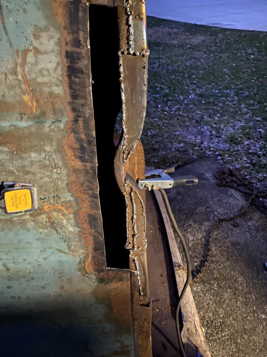

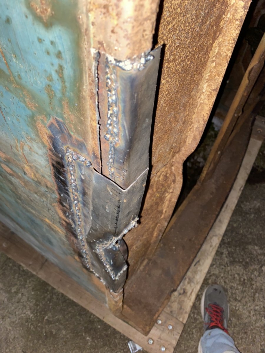

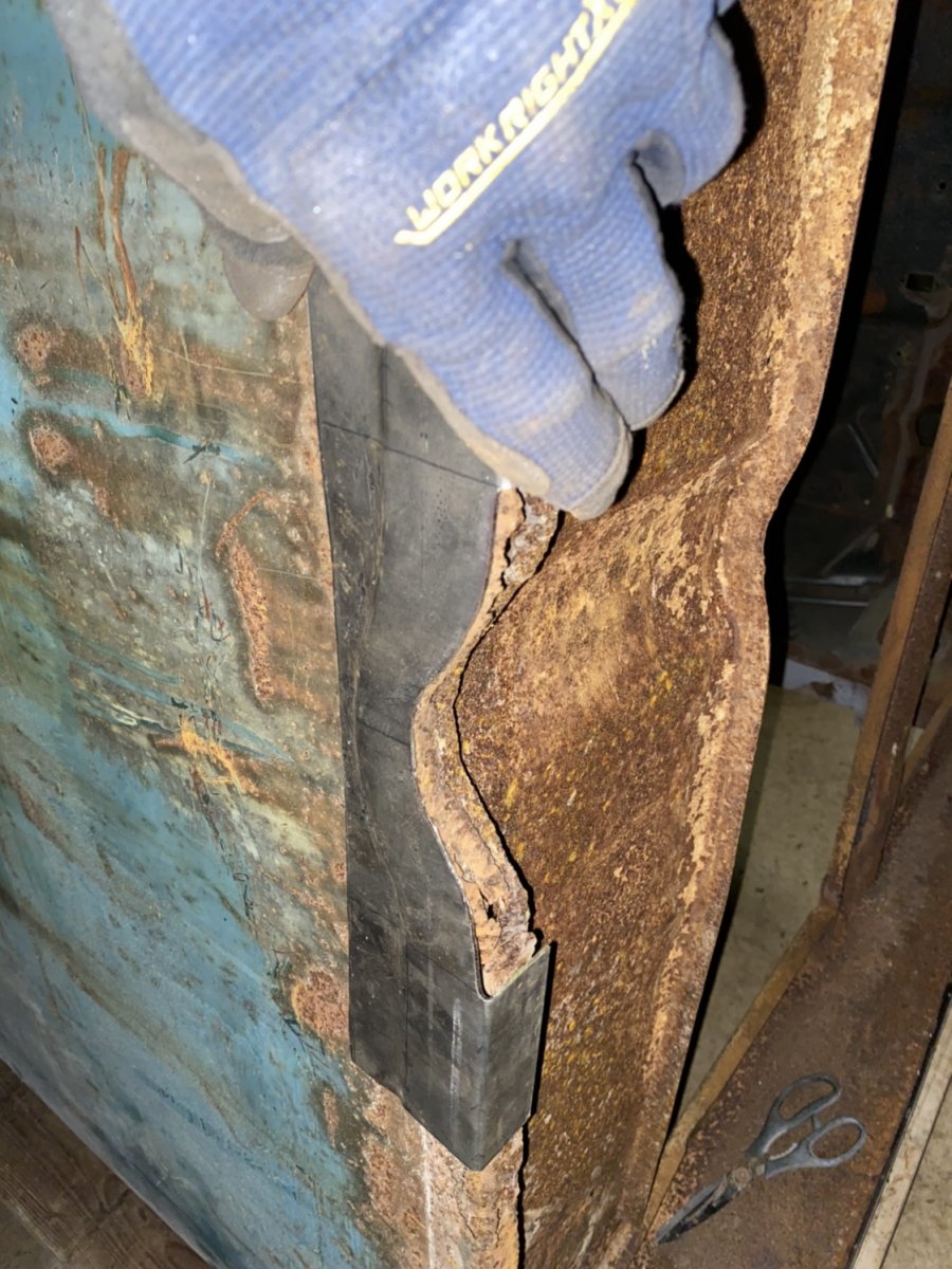

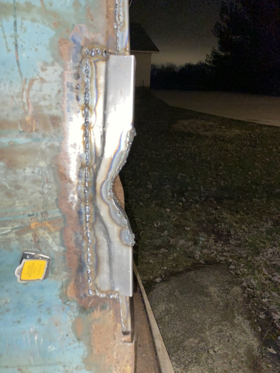

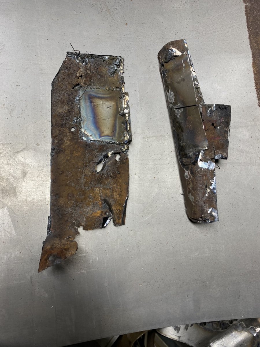

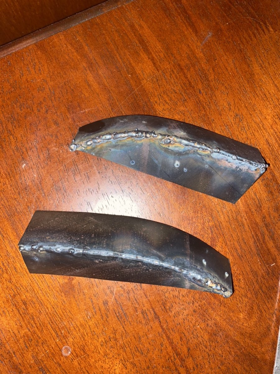

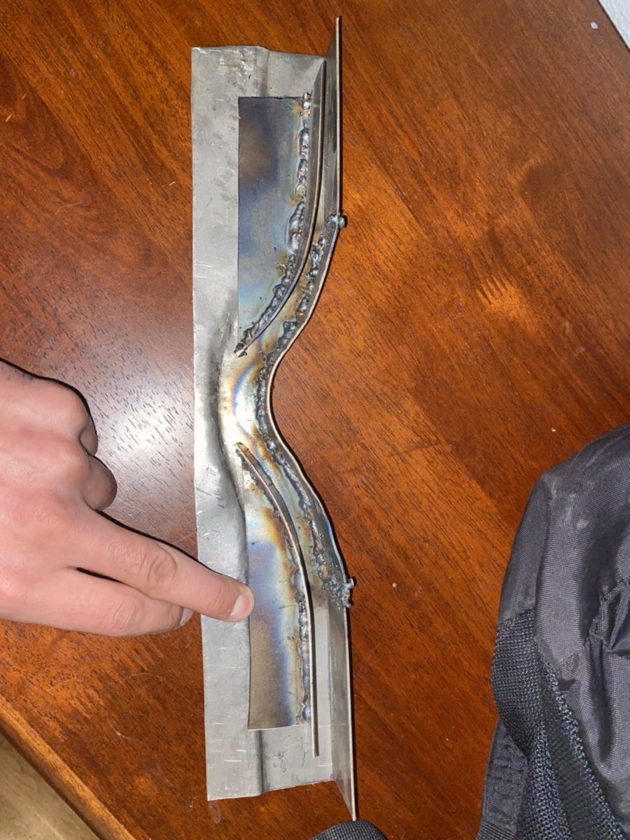

  17. This is my last big issue regarding the rust on this cab and I saved it for last just because of how intimidating it seemed. I thought and thought about it and i probably didn’t do it the way you would have but here’s how it went.
    The rust I was dealing with
    What I drew up
    Here’s some of what I ended up with
    Showing what it looks like compared to original
    I then cut the outer piece out
    A side by side with the old, crazy difference
    This what I ended up with at the end of welding it up. I’m no welder, I’m just glad to get this done
    IMG_1364.JPG IMG_1365.JPG IMG_1366.JPG IMG_1367.JPG IMG_1368.JPG IMG_1369.JPG
    If you were wondering what those other small two pieces were, they’re to go behind as I have in this picture
    simplestone likes this.

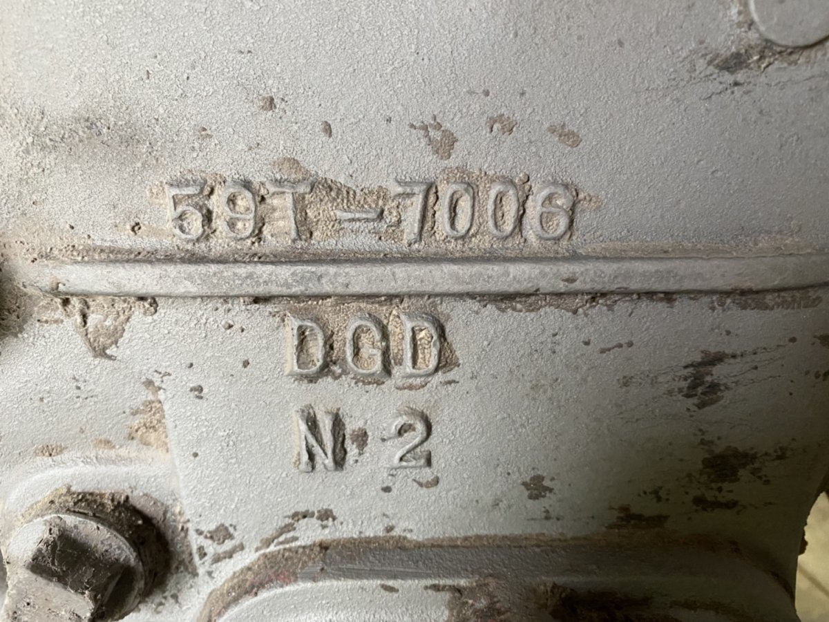

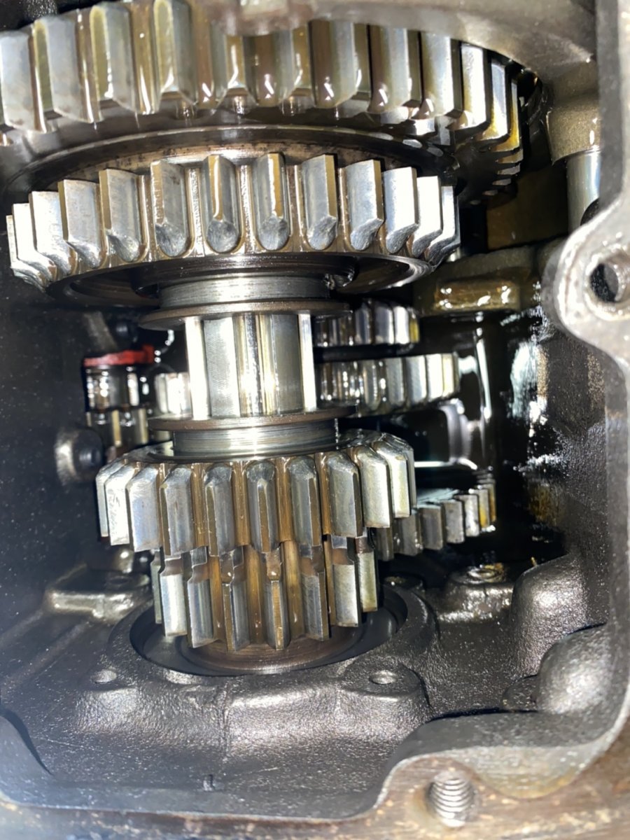

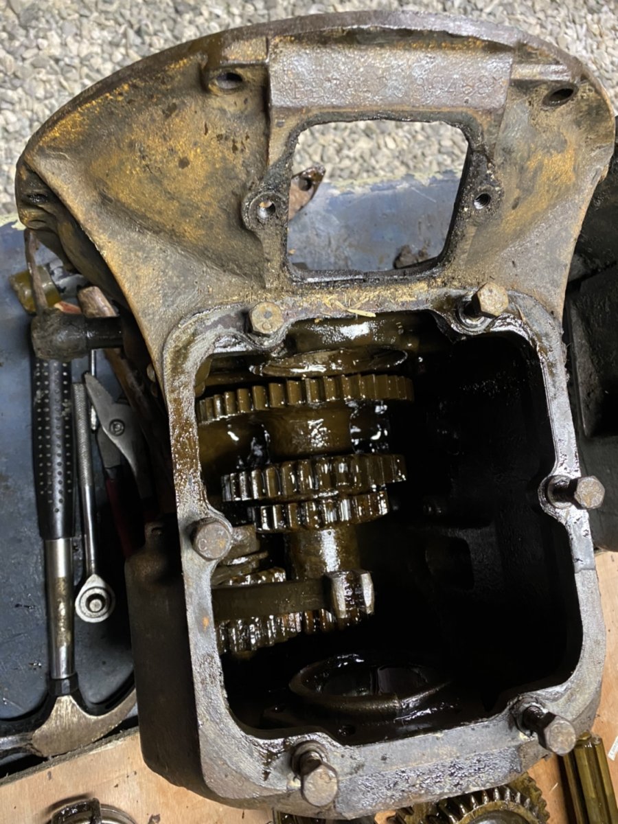

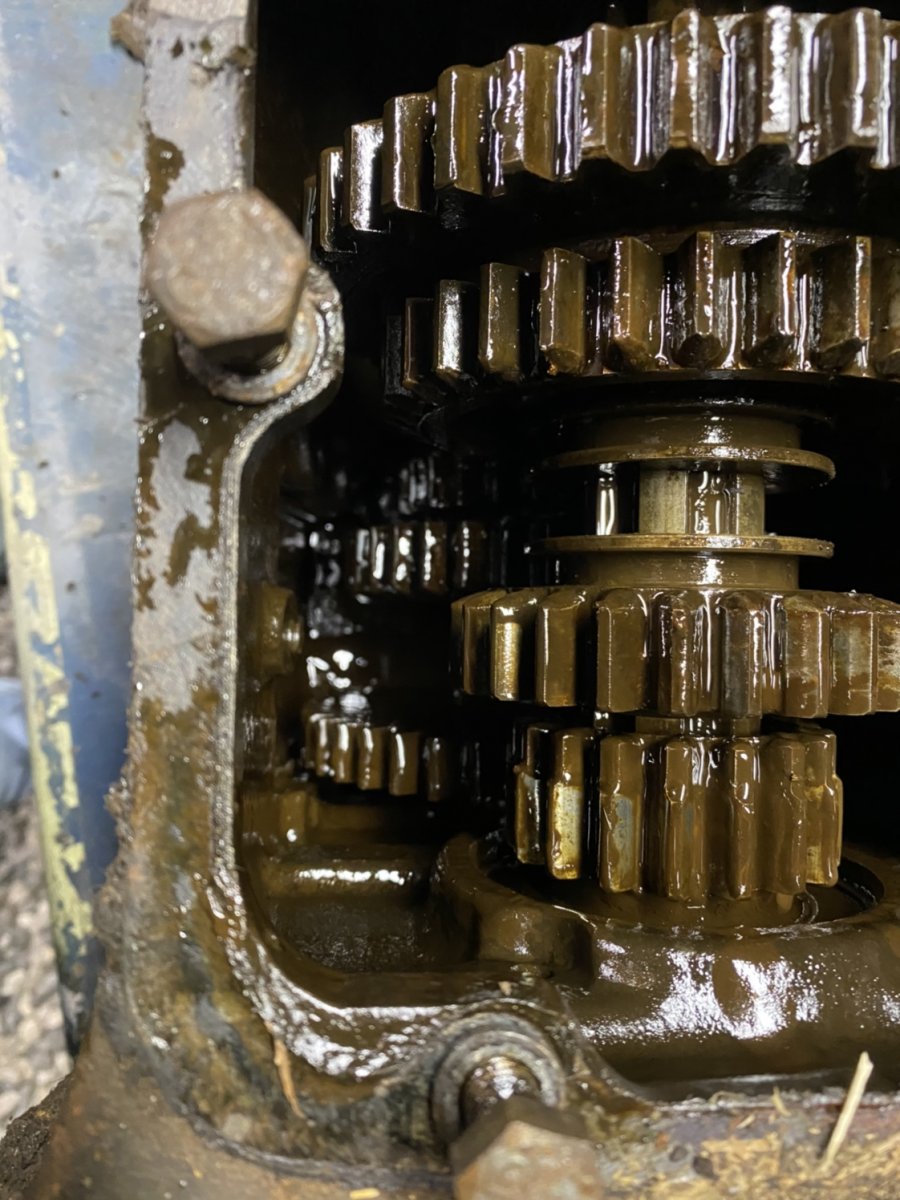

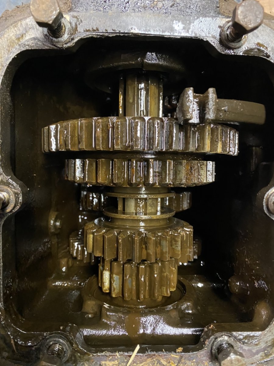

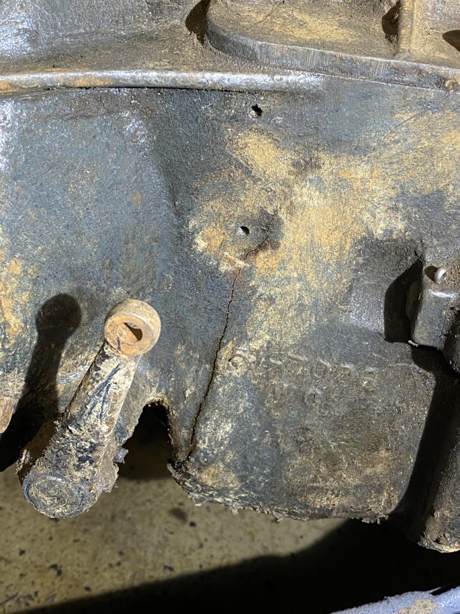

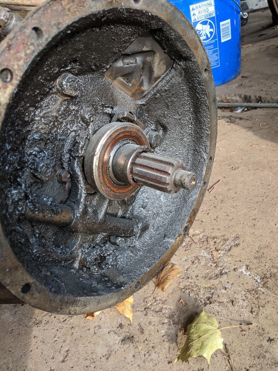

  24. Getting away from my normal body work updates as it’s probably quite boring and there’s a lot of it. As you probably remember from the beginning of this thread there was a major crack running down the side of my transmission as pictured below
    I knew I would need a new transmission even though it would be a task quite crazy to me. I searched and came across this one....
    ... at a fair price from a great guy I met in Michigan. After sitting for the past couple weeks I got the time to finally get into the “new” transmission. I knew while they were close to the same that they were also different enough to need some ***istance as a instant swap would not be able to happen. The new transmission had a whole braking ***embly on the back different clutch levers, one had a PTO and the other didn’t, and lastly one was one solid big case and the other was a 6X6 box with a bell housing attached to the front by 6 bolts.
    After removing the whole braking system off the back i hoisted the new transmission up and lowered it down into position. I then lined it up and put a few bolts in just to confirm they were the same.
    After evaluating I noticed a new issue. The new transmission’s output shaft was much longer than the one I had originally.
    The new^
    The short length I needed^ (original)
    This is quite an issue as I need clearance for a ball joint I think they are called
    This^
    This is very critical as the engine does not sit level with the drive train.
    After doing some research I concluded that I would need to swap the shafts from the two to get the desired length in the new transmission. I hoisted it back out and carted both transmissions to my workshop to start dis***embling each for part swaps.
    Things that I would need in my final transmission
    1. The case that’s not cracked (obviously)
    2. The shorter output shaft
    3. I decided I will keep the PTO because why not
    4. The desired clutch lever
    5. And a fully functional shifter lever as the “new” one could rotate 360° and should only shift forwards and backwards

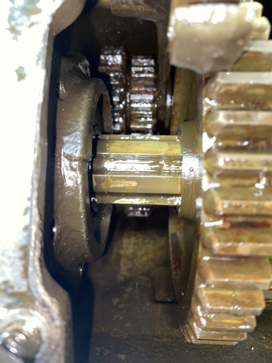

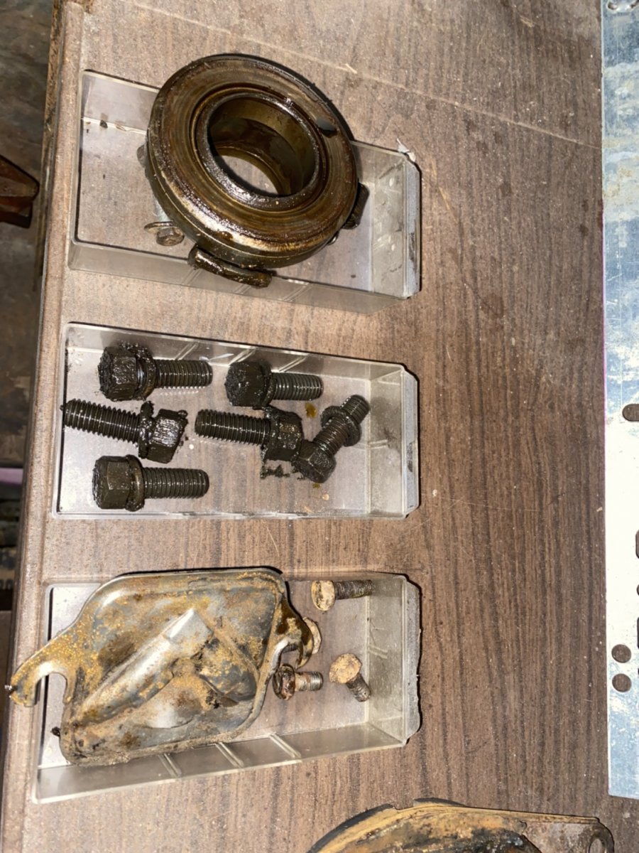

    I started dis***embling and making sure to make note as I need to know how they came apart as to how to put it back together
    One quite interesting thing to note is the color of the oil in each. The crack allowed for dirt and grime to get into the gearbox and crud up the inside compared to a sealed gearbox
    The old and cracked transmission ^
    The “new” and sealed transmission case
    Updates to come after I clean the parts
  25. Got it all back together for now. I’ll order a new gasket kit for it and have to do it again
    Got it ready for more fine cleaning after I chiseled all the clumps of dirt off it
    Surfcityrocker likes this.

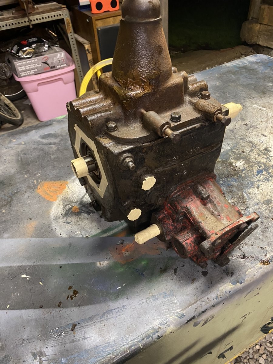

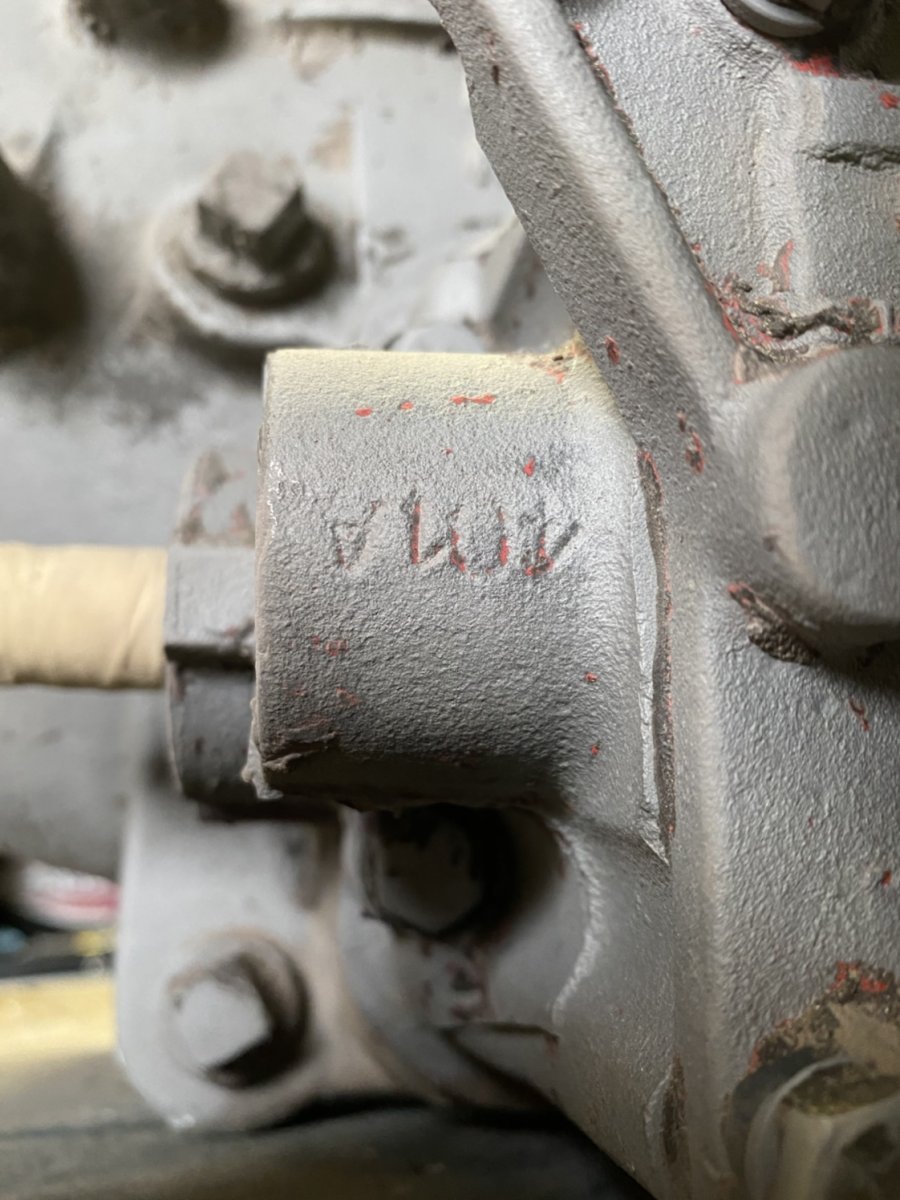

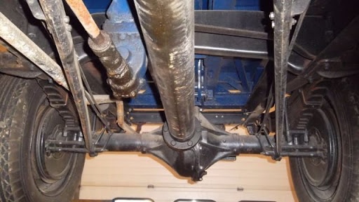

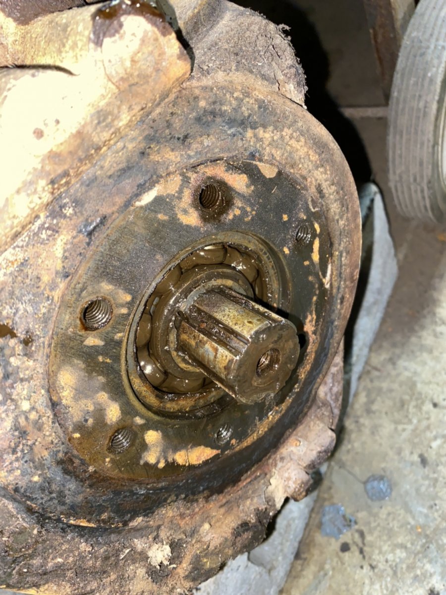

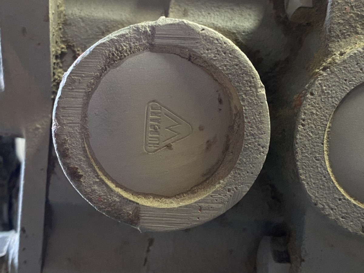

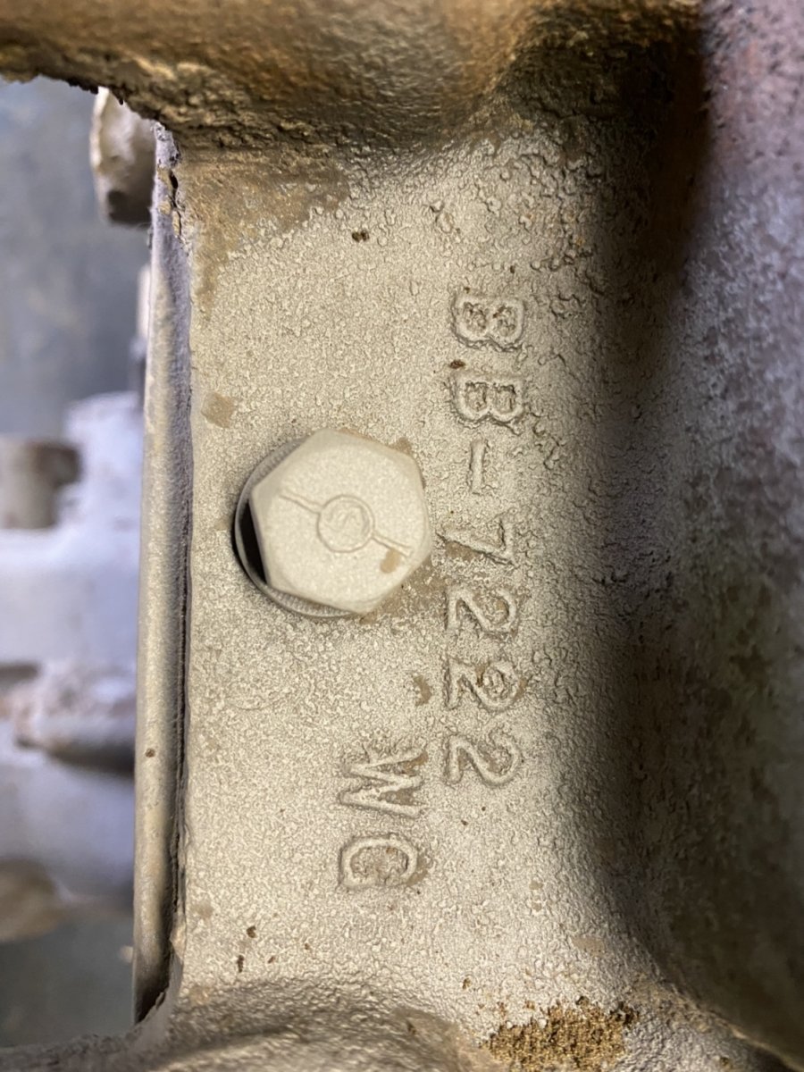

  28. This PTO confuses me. I’m pretty sure it powered a hydraulic pump that lifted a dump bed but there’s no parts out there indicating so and very little information on it
    IMG_1688.JPG IMG_1689.JPG IMG_1690.JPG IMG_1691.JPG IMG_1693.JPG IMG_1695.JPG
  29. These are all pictures indicating a shaft leaving the PTO to a hydraulic pump
    I can’t seem to find a shaft or hydraulic pump for this truck though for sale
    Lmk what you know please. I really like the idea of having a dump bed on this truck

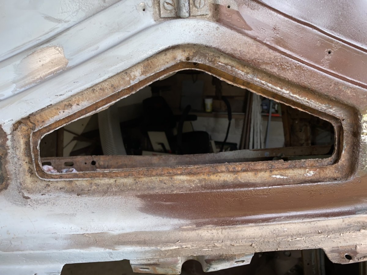

  30. Cowl vent replacement
    Here are before photos. Many pin holes and just overall weak metal
