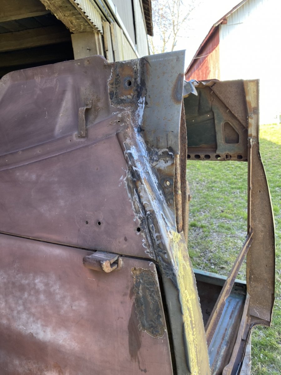

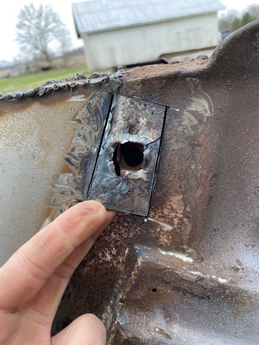

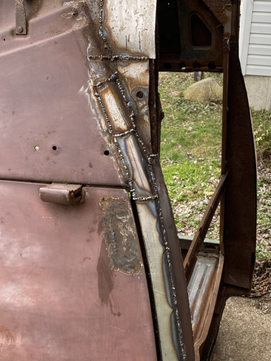

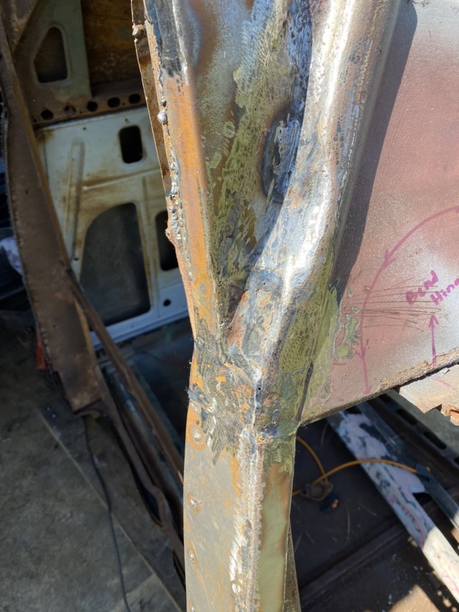

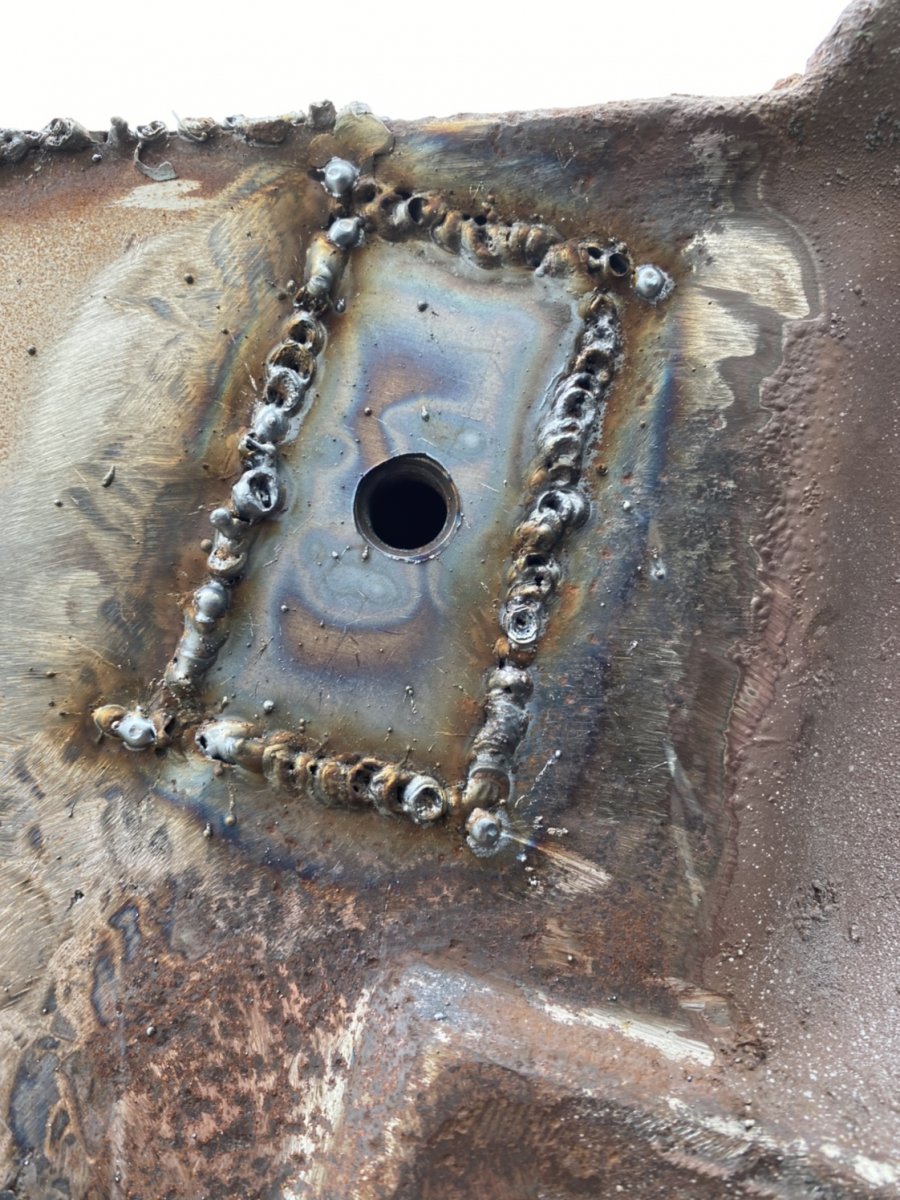

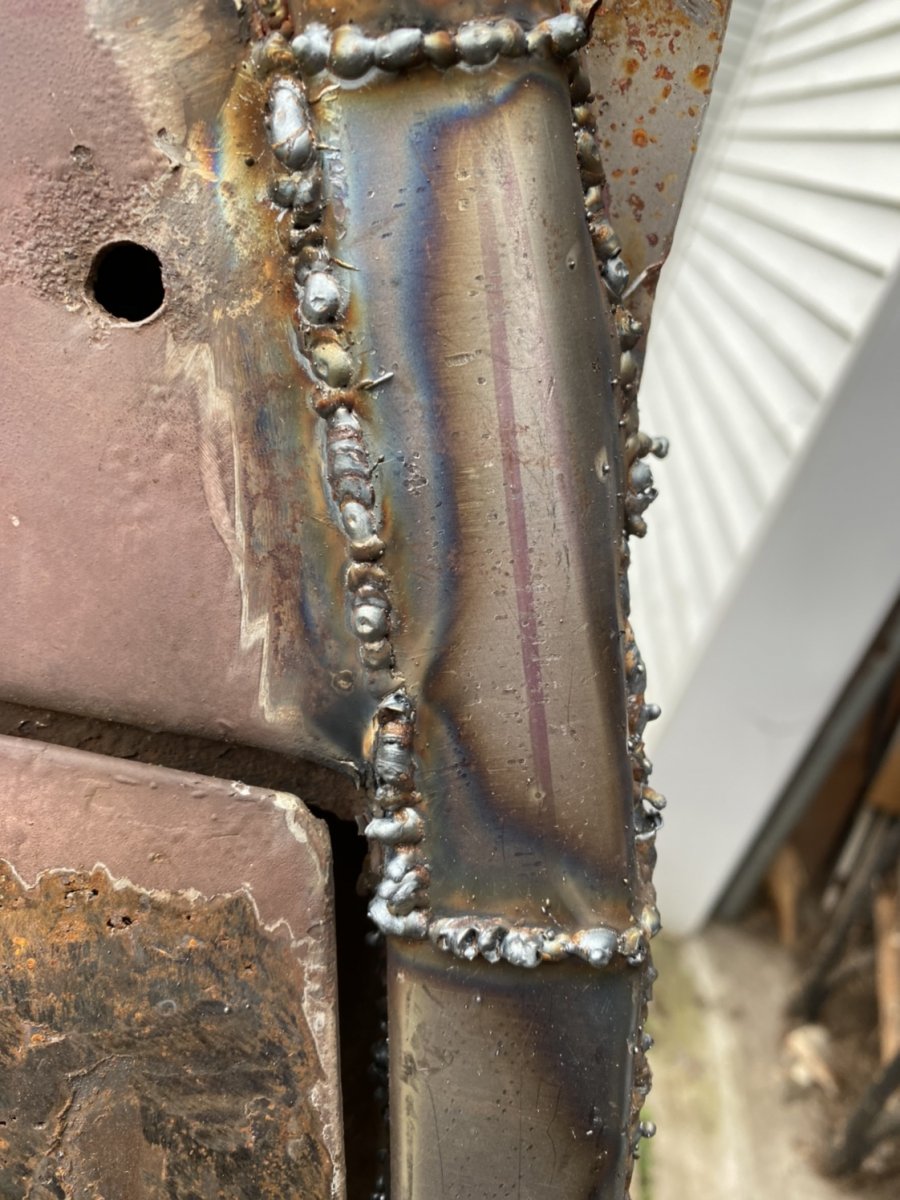

  6. I think this is the last metal replacement I made for the cab. It’s been a long time coming to be able to say this

  7. rusty valley
    Joined: Oct 25, 2014
    Posts: 4,510
    rusty valley
    you have some grinding to do now !
  8. For sure. This is my plan for tomorrow. Depending if it all gets grinder down I plan Thursday to be able to lay down a simple primer layer down just to be able to see all the imperfections I’ll need to further address
  9. Mart
    Posts: 5,046
    Mart
    Your welds are improving. Still room for improvement, but definitely better than when you started.

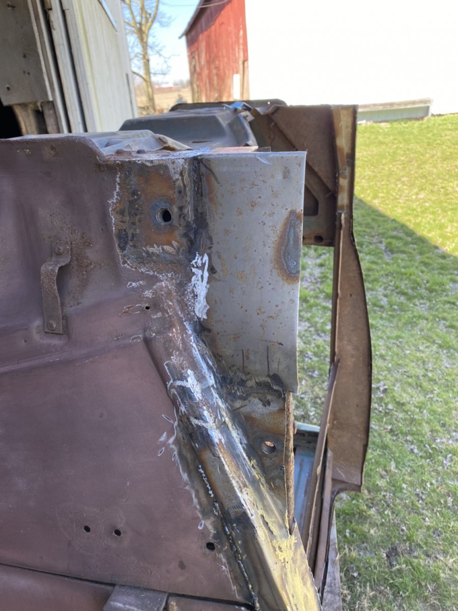

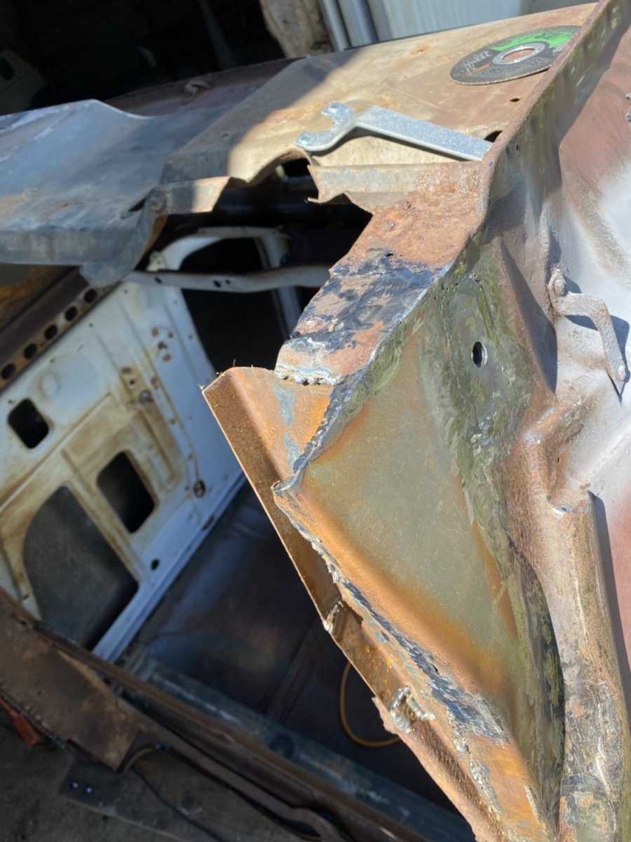

  11. Getting a ton done. It’s so nice I can just be in a tee shirt, its a good feeling. It’s all starting to clean up IMG_1798.JPG IMG_1799.JPG IMG_1800.JPG IMG_1801.JPG IMG_1802.JPG IMG_1804.JPG IMG_1805.JPG IMG_1807.JPG IMG_1808.JPG IMG_1810.JPG IMG_1813.JPG IMG_1812.JPG

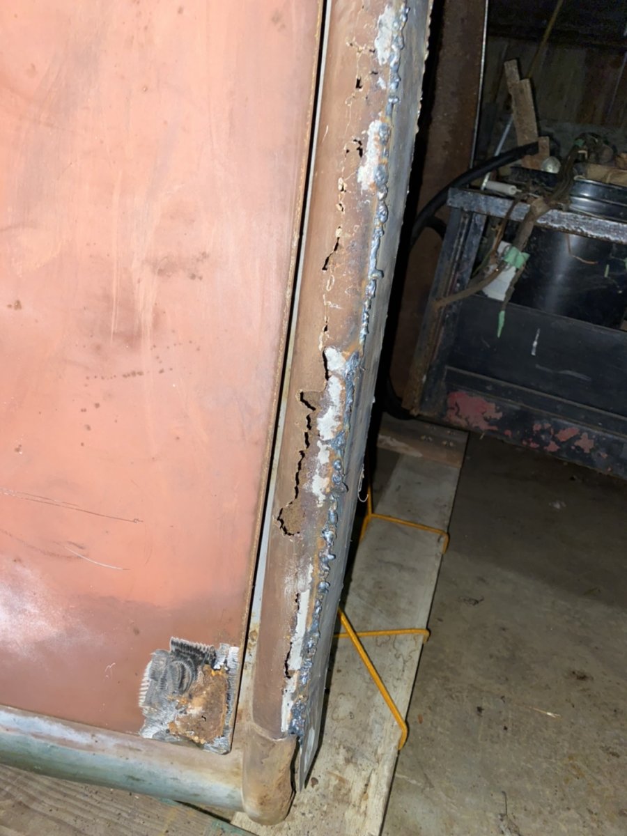

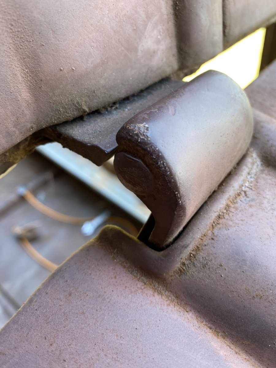

  12. Also anyone know if these pins are threaded? Or the best way to get them out? IMG_1814.JPG IMG_1815.JPG IMG_1816.JPG

    There's a press made for pressing out the hinge pins - this is what they look like. You can do it yourself with a C-clamp and some ingenuity though. Deep well sockets make pretty good supports for something like that.

    I made a pusher for one of those pins. It was very very difficult to get out. (I only did one).
    As your cab is not fixed down, would it be possible to have it upside down with a piece of strong tubing supporting the hinge, solidly grounding it to a concrete floor. Then you might stand a chance of drifting the pins out by hitting them downwards backed up by the floor.
    Purely theoretical, never tried it.

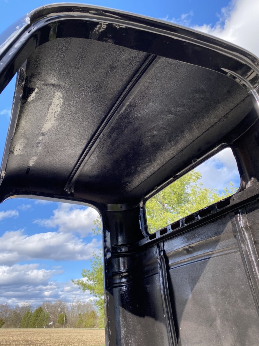

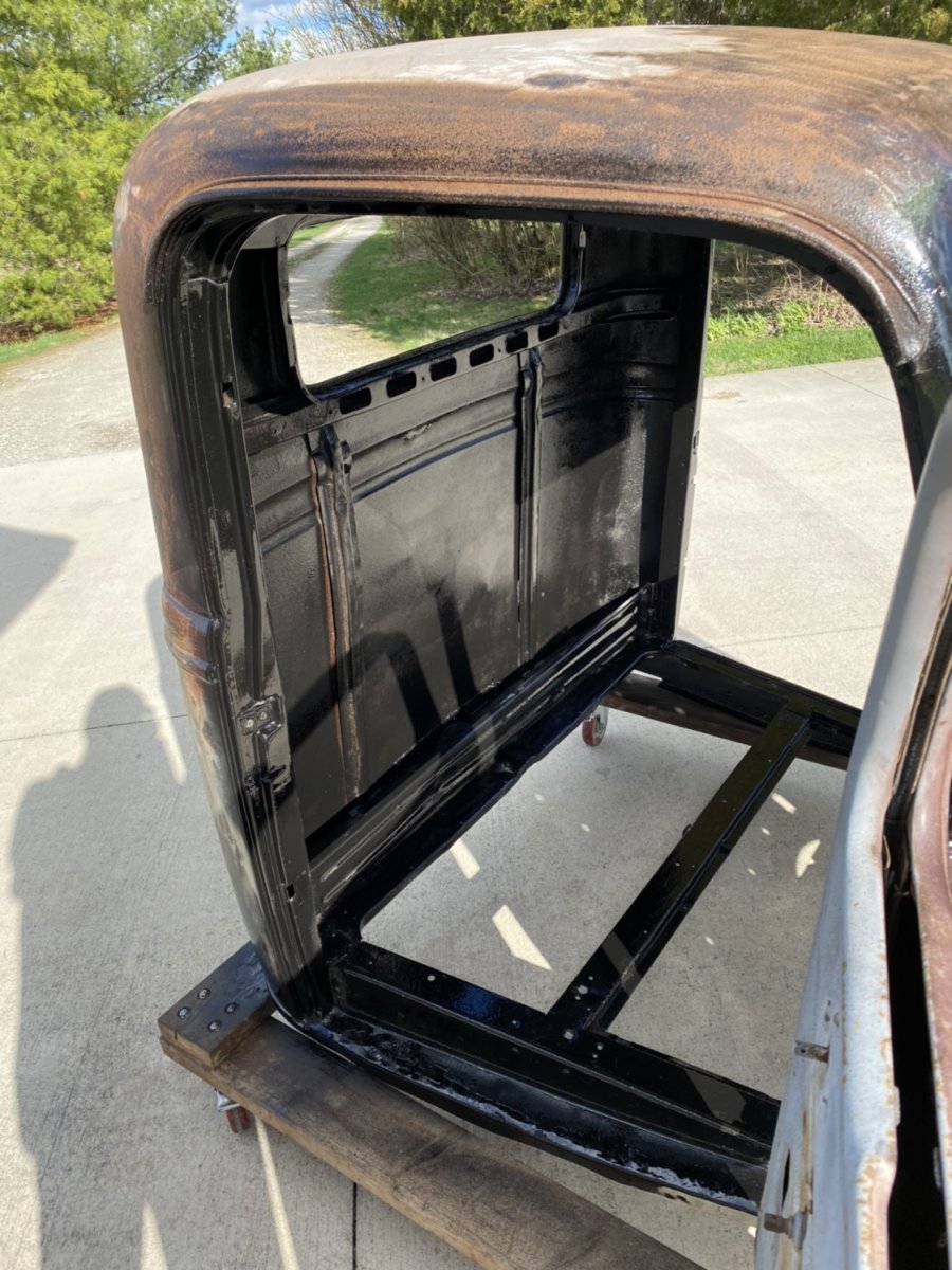

  16. Just now noticing I didn’t share this info yet. Here it is!
    I intend to do the same but with this product below. I plan on spraying all the inside with it as well as under and probably the step up as well. I may go a few inches up from the bottom but still debating. I know where the rust damage was before and would like to paint all parts that were previously hit bad with this.

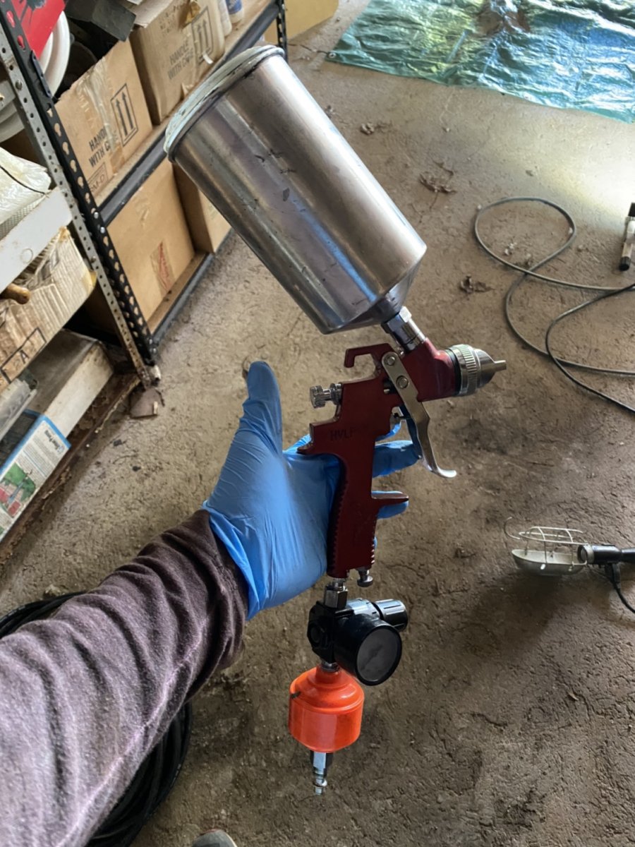

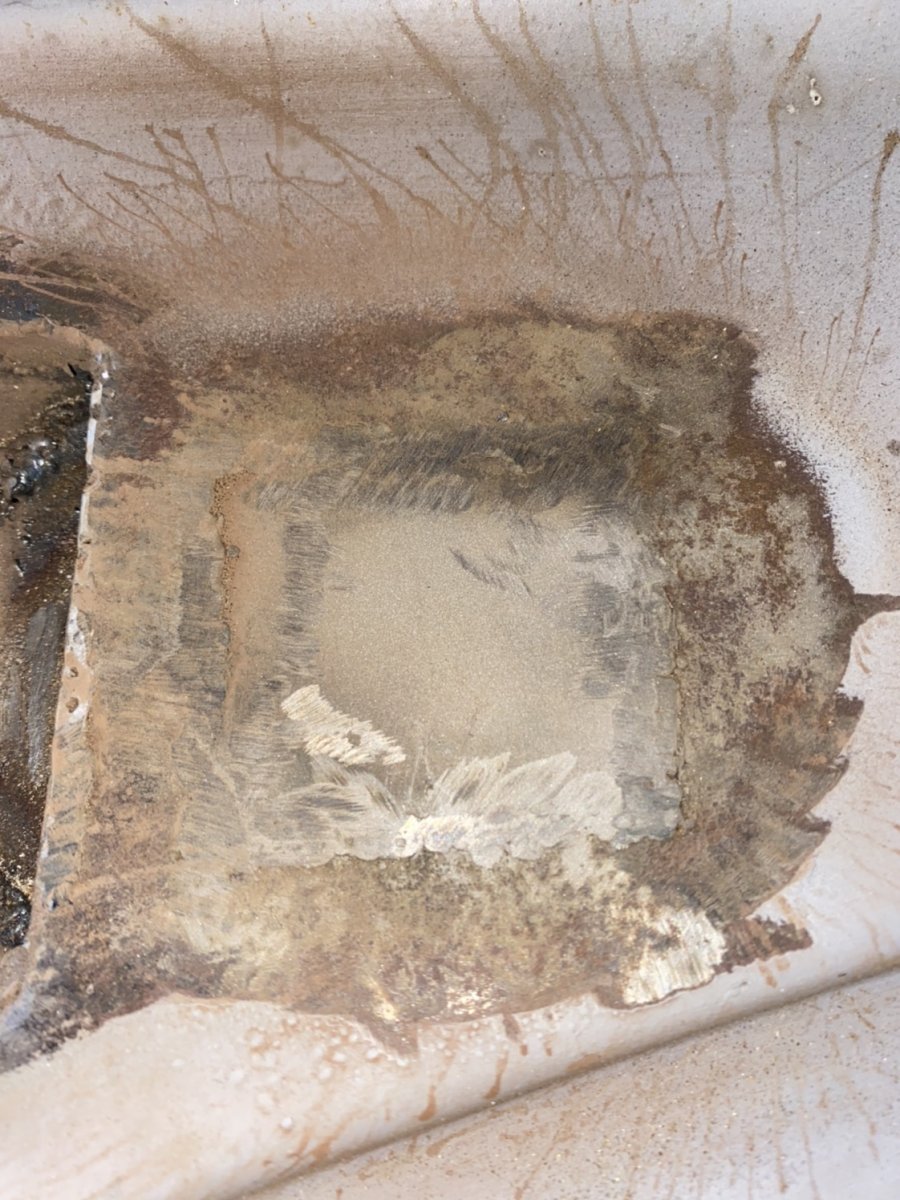

  17. Busted out the sand blaster today and while it’s not very efficient I used it on the areas needed it best. Granted I’m not doing this as a final primer, just a first layer so I can get an idea for where I need to address more carefully. Still wanted to get as much cleaned up now so I’m not just painting over potential problems later.

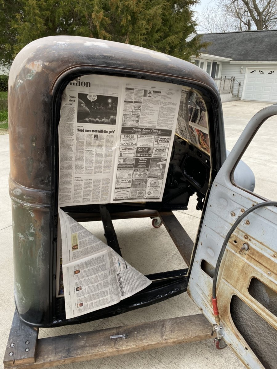

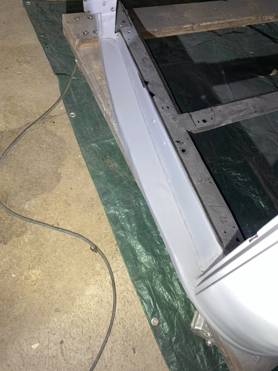

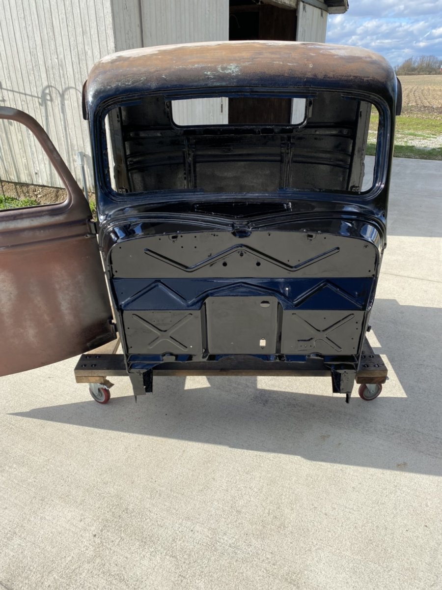

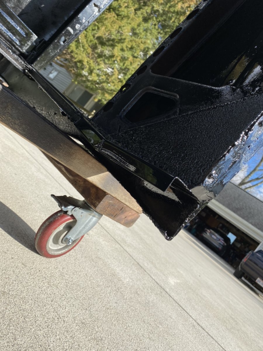

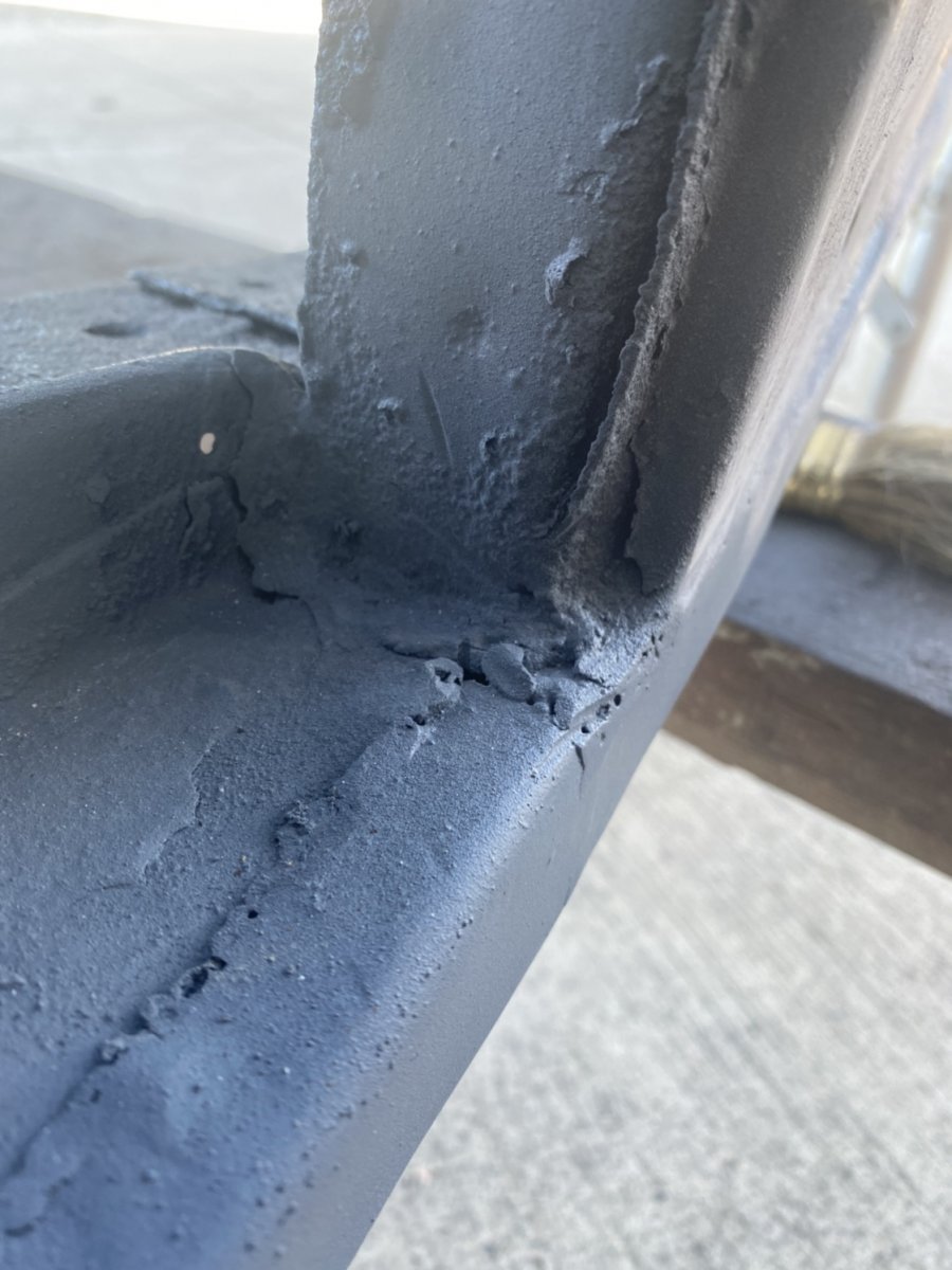

  18. So I painted today. Not perfect but pretty descent and good coverage. This is the rust protector and I’ll put the primer on next when this drys well. A few runs but this is only the first layer so I can get a feel for what body work needs done still. My dad smiled to see his old truck coming around which was a good feeling
    IMG_1924.JPG IMG_1925.JPG IMG_1922.JPG IMG_1926.JPG IMG_1929.JPG IMG_1930.JPG IMG_1932.JPG IMG_1933.JPG IMG_1936.JPG IMG_1939.JPG IMG_1940.JPG IMG_1916.JPG

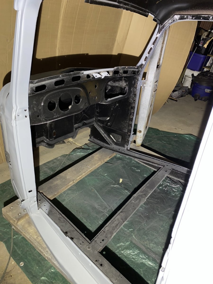

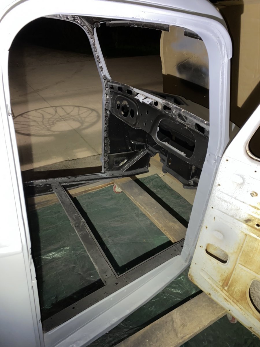

  19. Just fit up the dash and headboard to see how it would look. It’s come a long way [​IMG][​IMG]

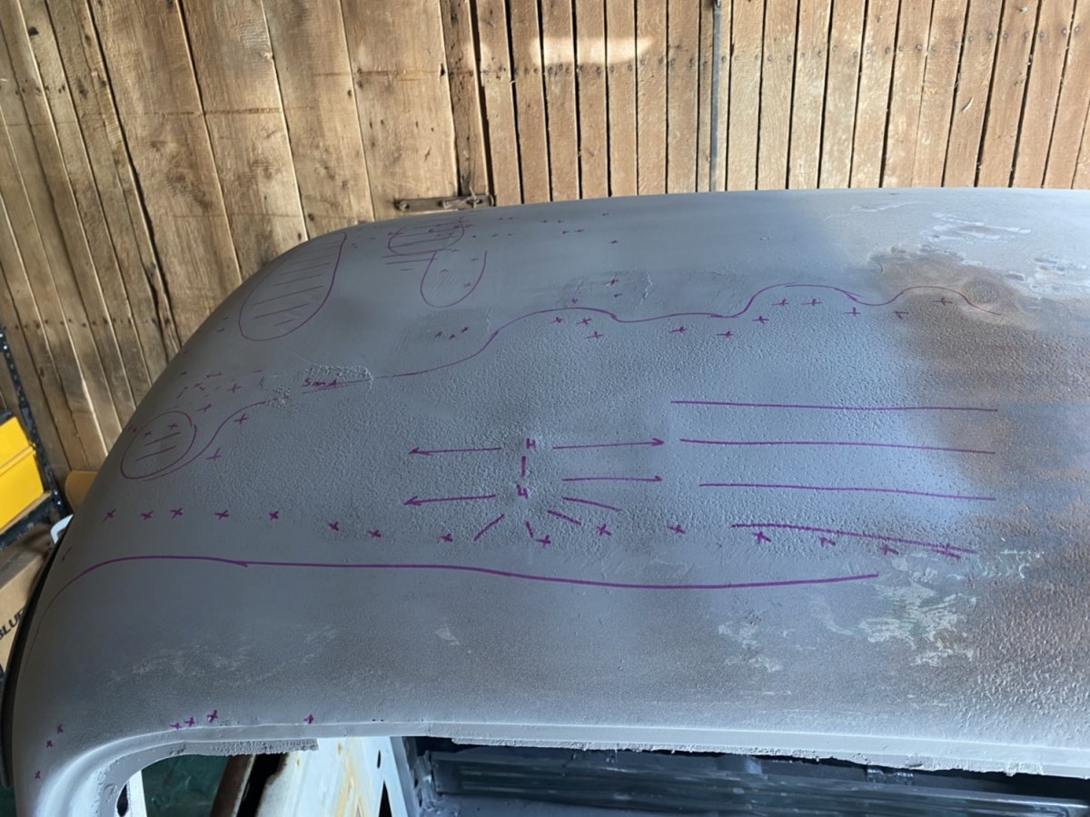

  20. Getting a lot of Bondo work done. It’s not done yet just roughing in. I’ll do the fine bits another day and really get into the nitty-gritty imperfections

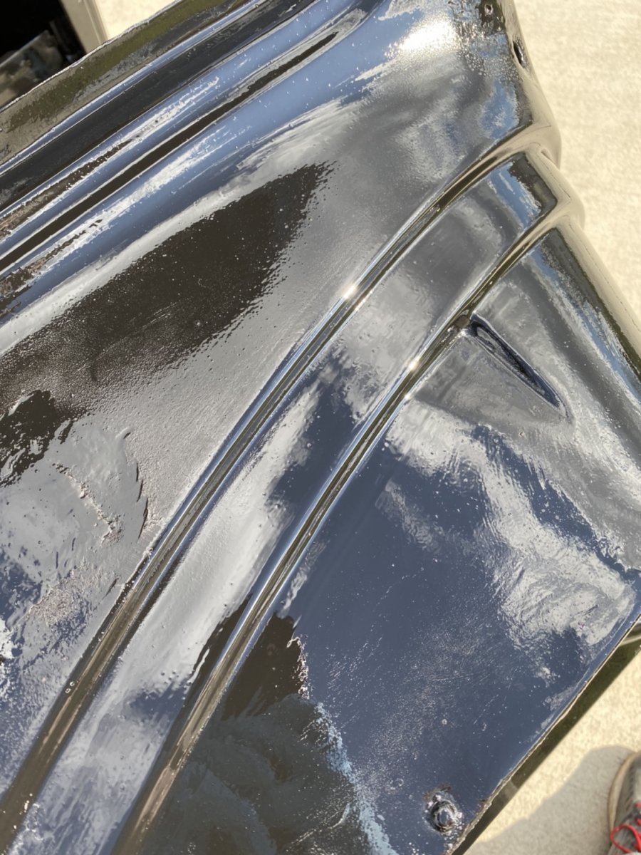

  22. Painted some primer just to see all the imperfections I was dealing with and what a difference. It’s obvious the difference between step ups that I had started to work on. I ran out of primer for the top left and that’s the only one I couldn’t get to. The last picture really shows all the imperfections on the back

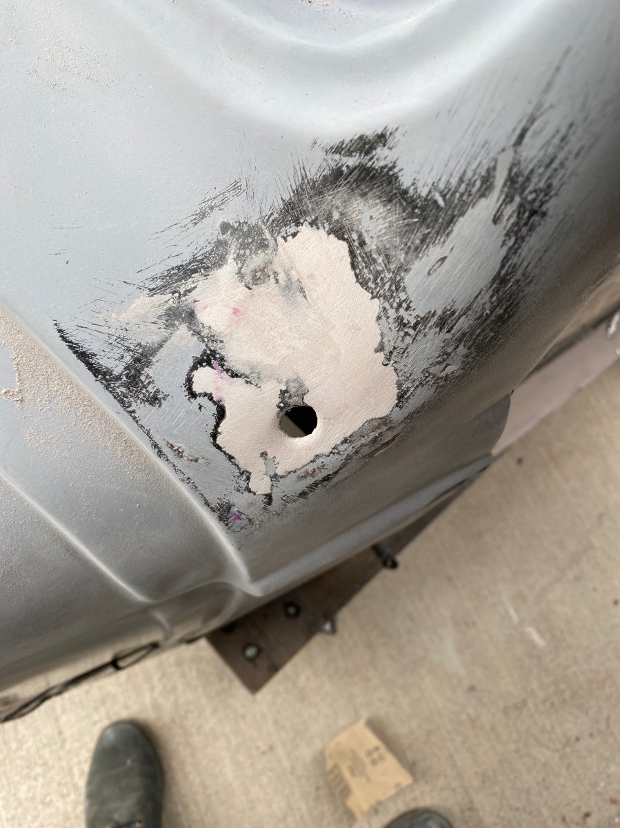

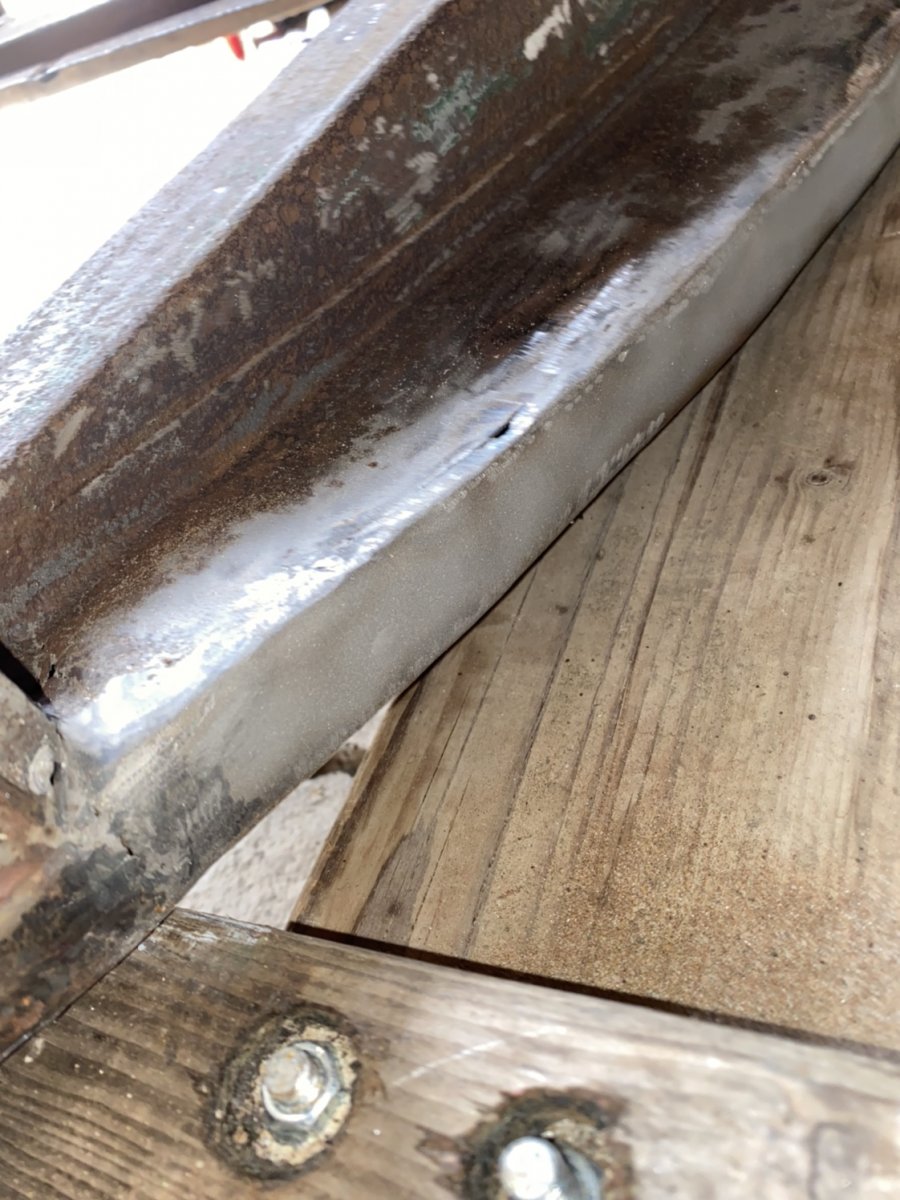

  26. These tiny holes have to be the most annoying

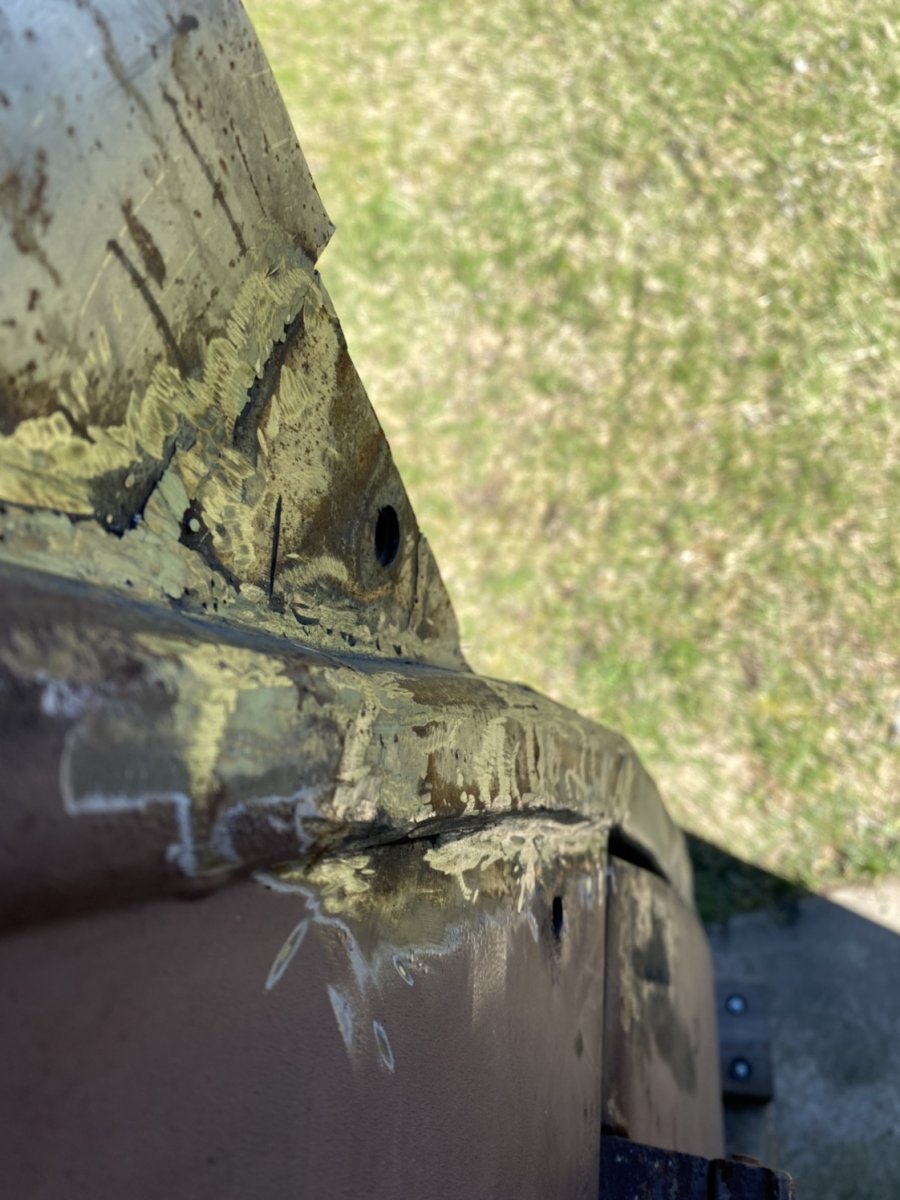

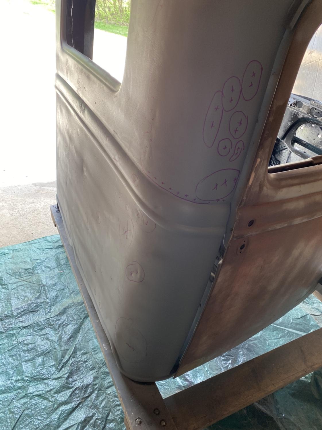

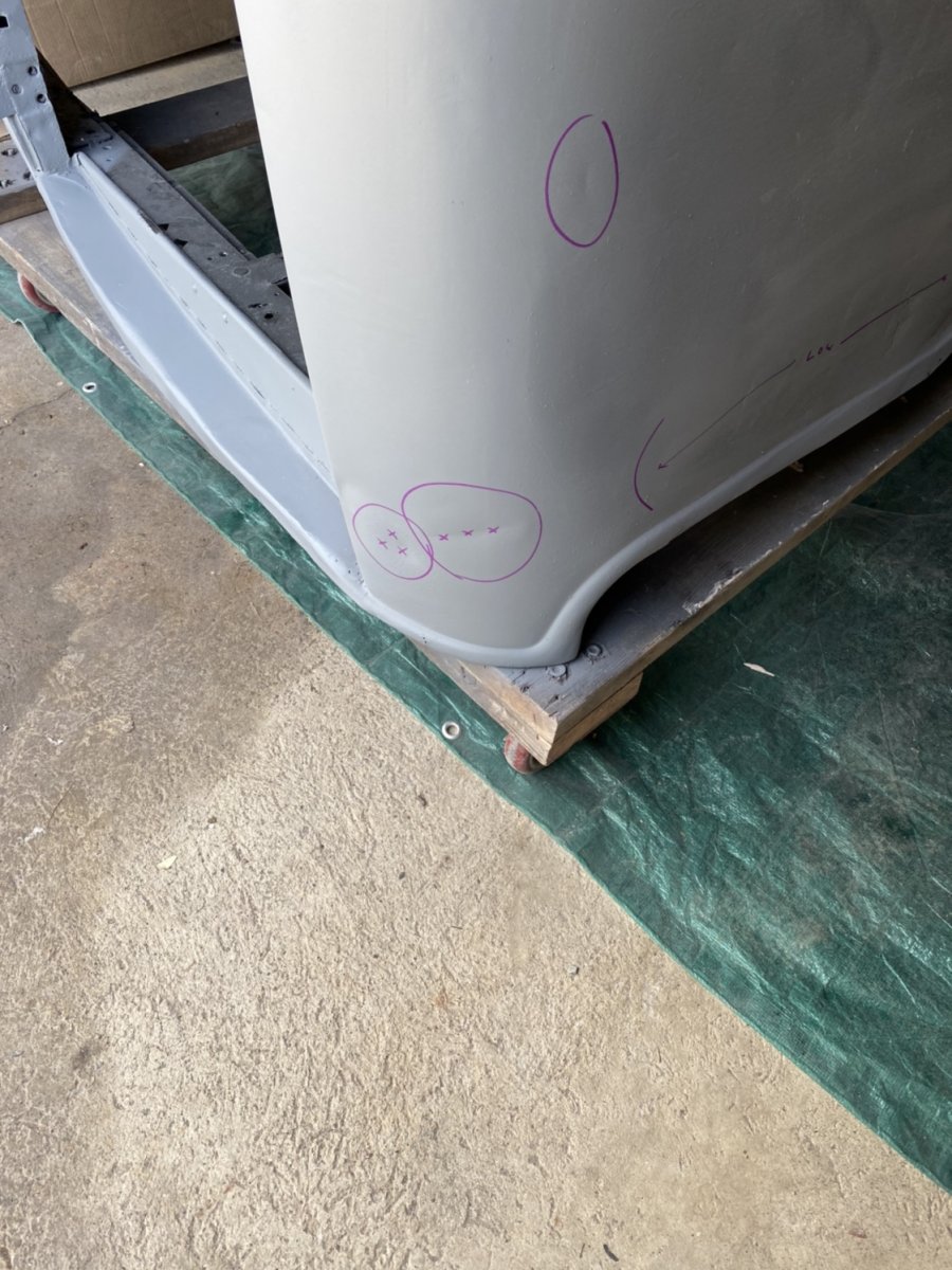

  27. Before I had applied some Bondo i really made sure to mark up everything I could see. After all this is done I’ll do another coat of primer and hopefully have gotten it all, if not I’ll do one last run of Bondo work and prime a 3rd and final time

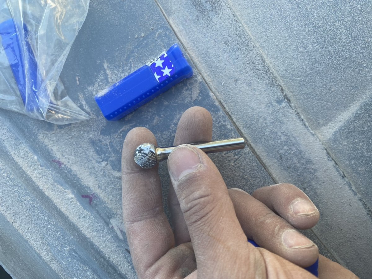

  28. Got a ball grinder today to really get into the tight spots on these door step-up areas
    My current project up against a past project

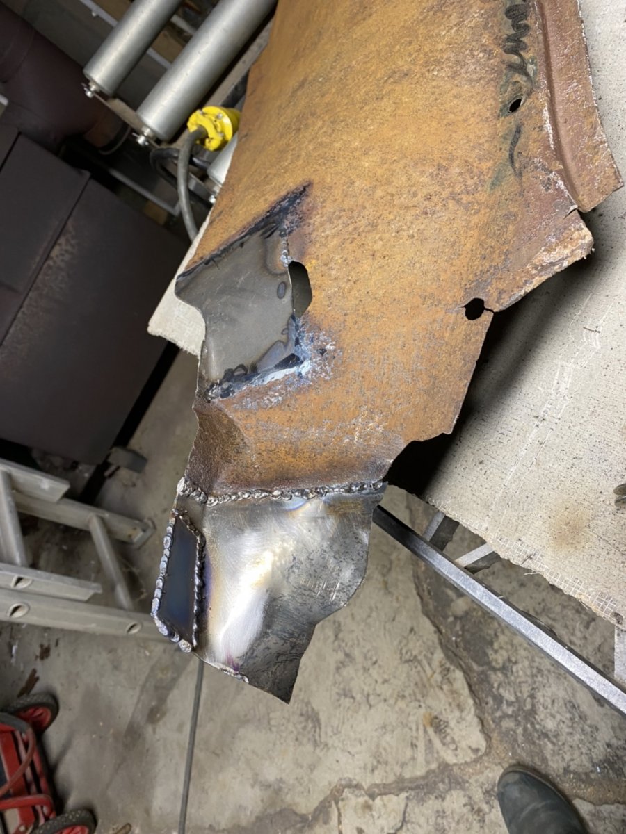

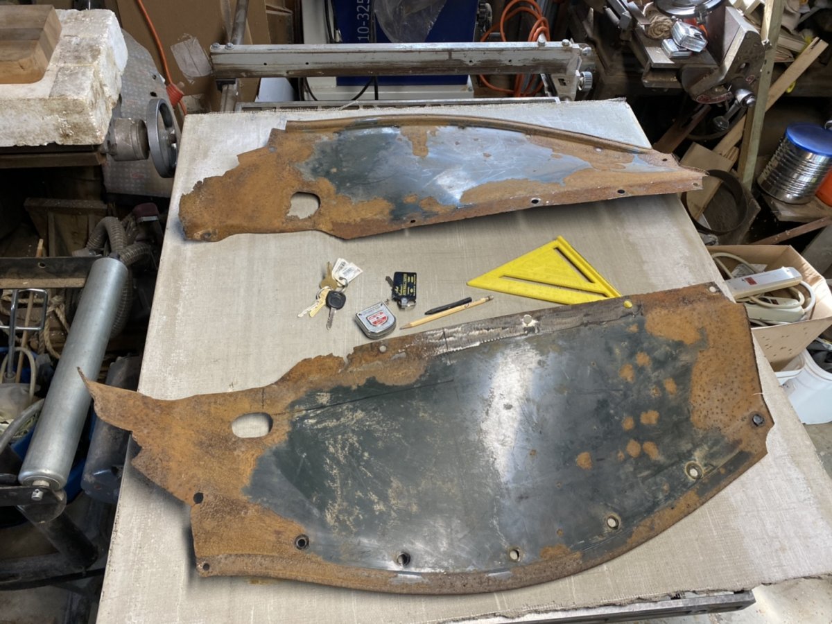

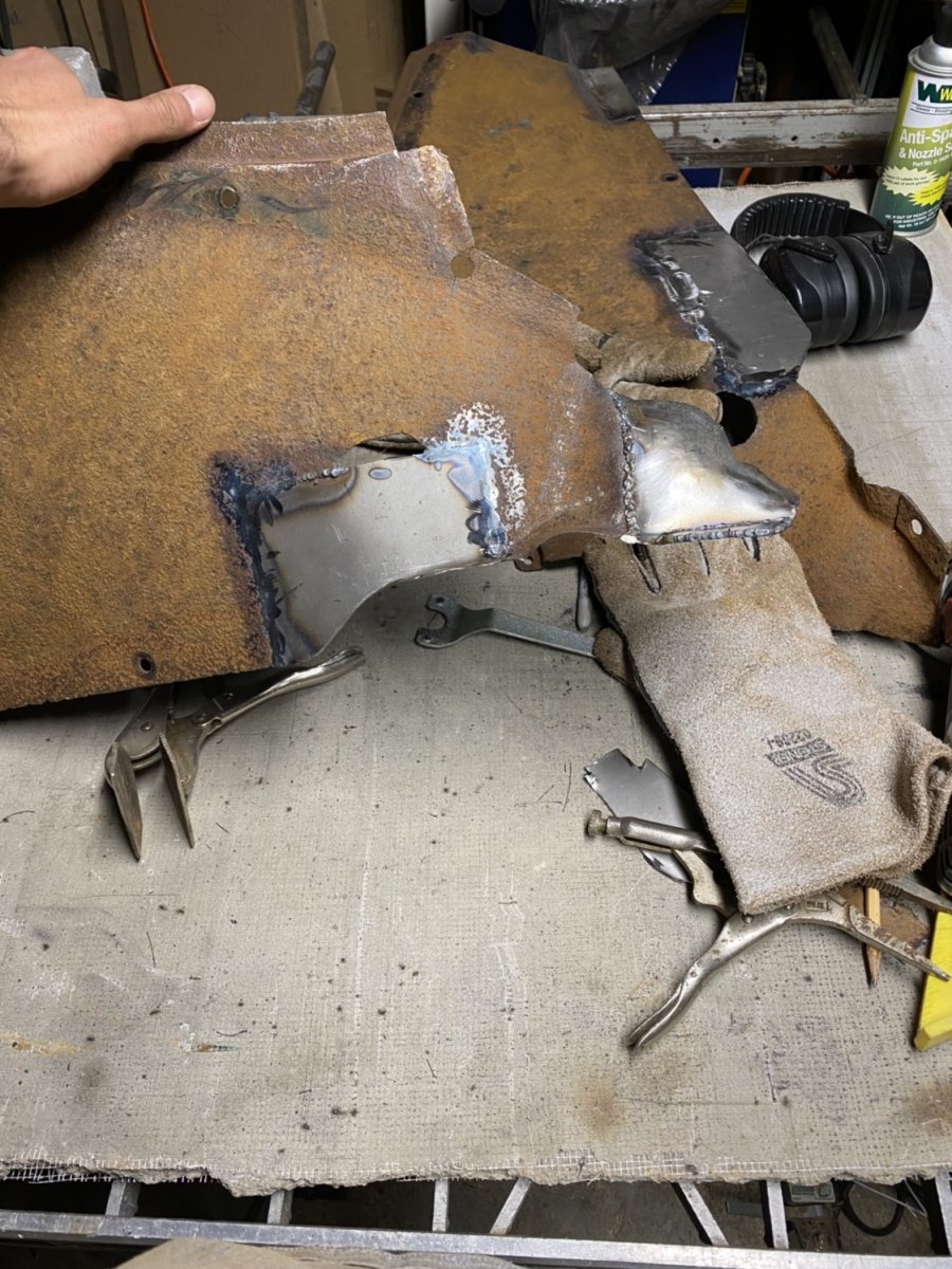

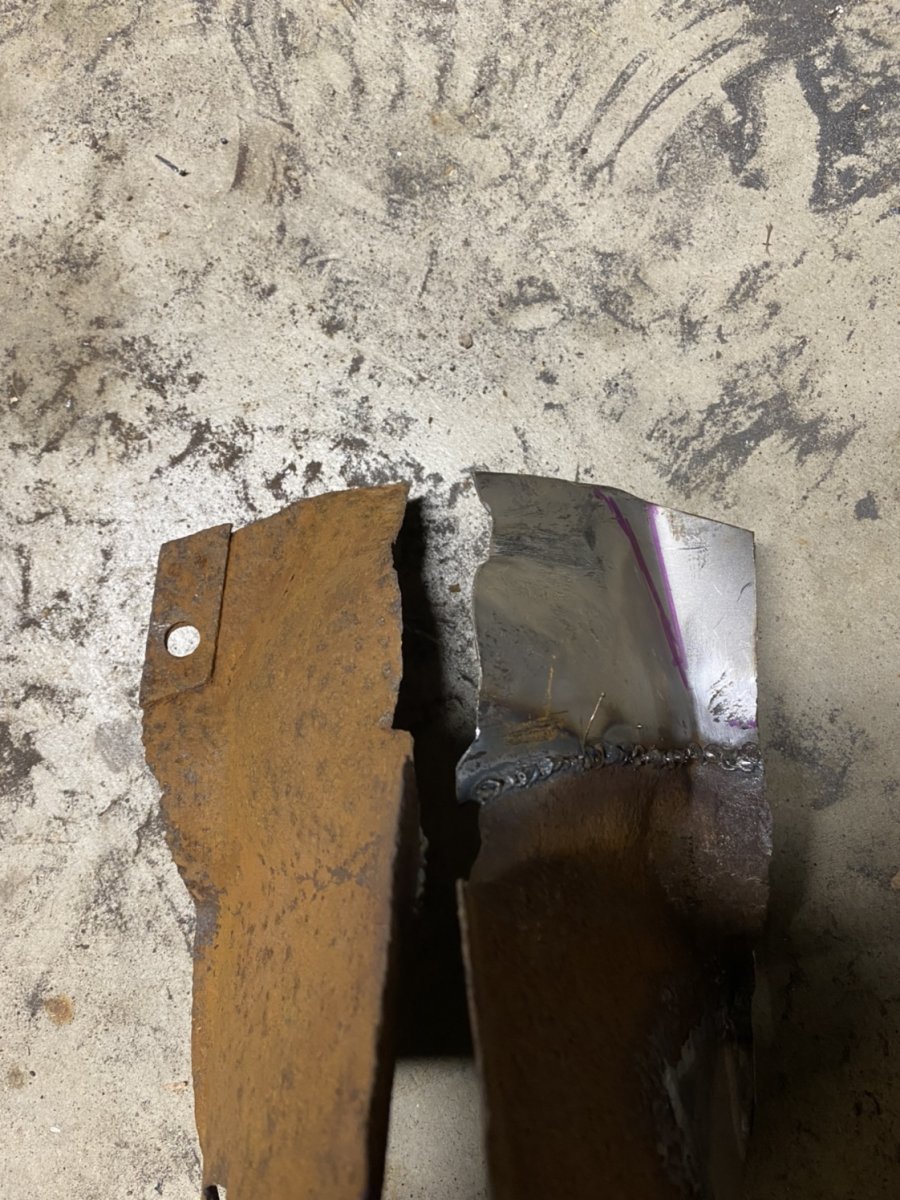

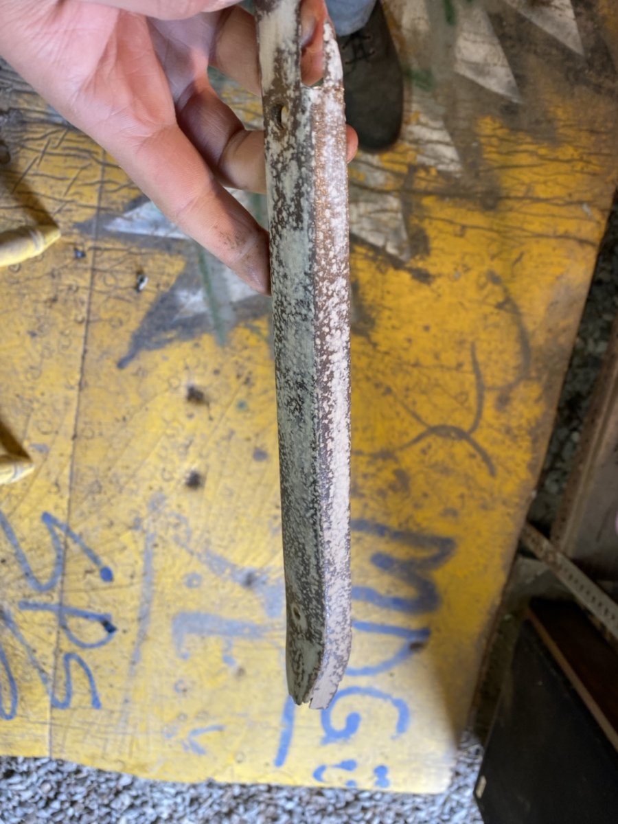

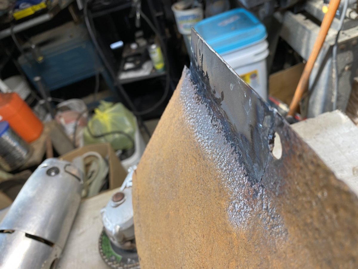

  29. Started to get rid of rust damage on the splash guards
    This is the other one, pretty proud of this piece, while it’s not perfect i think I did a decent job of getting a good amount of the curvature into the piece.
    I’ll still need to grind down some welds and clean up some edges but for the most part I think these are done. They aren’t very visible so not crazy concerned about how amazing they look but still good enough to not look like a pile of rust
    Surfcityrocker and simplestone like this.
