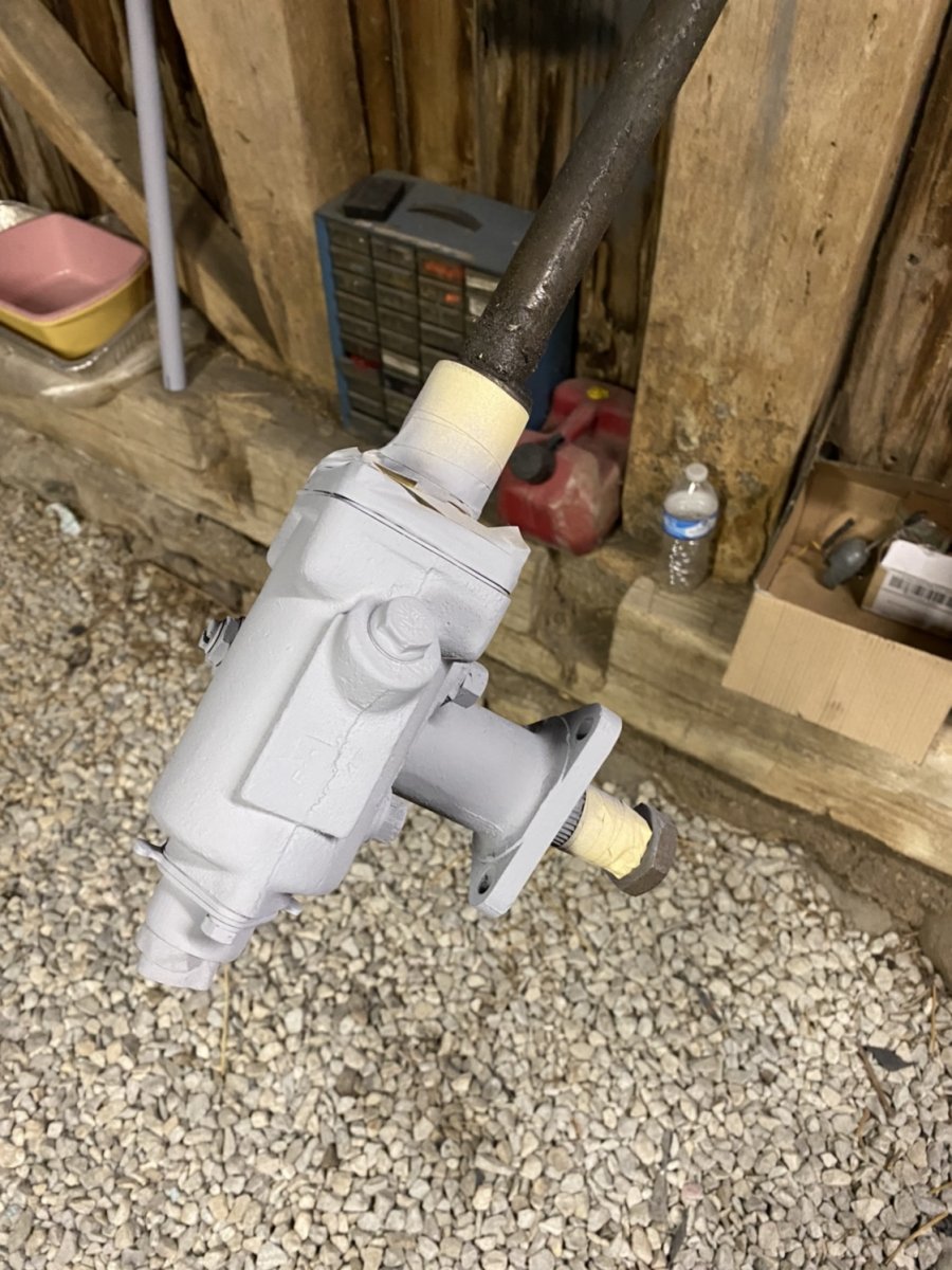

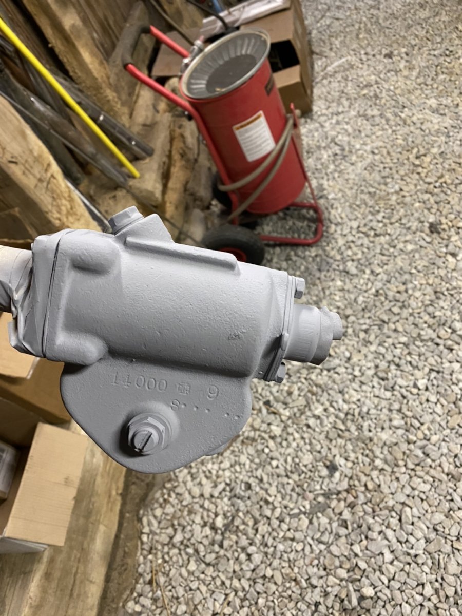

  6. Lastly got some primer on this piece as I’m tired of seeing the steering box rebuilt and pieces ready but not ***emble ready. So I’m getting to it and hoping I can clean this out of my shop and into the truck.
    Okie Pete likes this.
