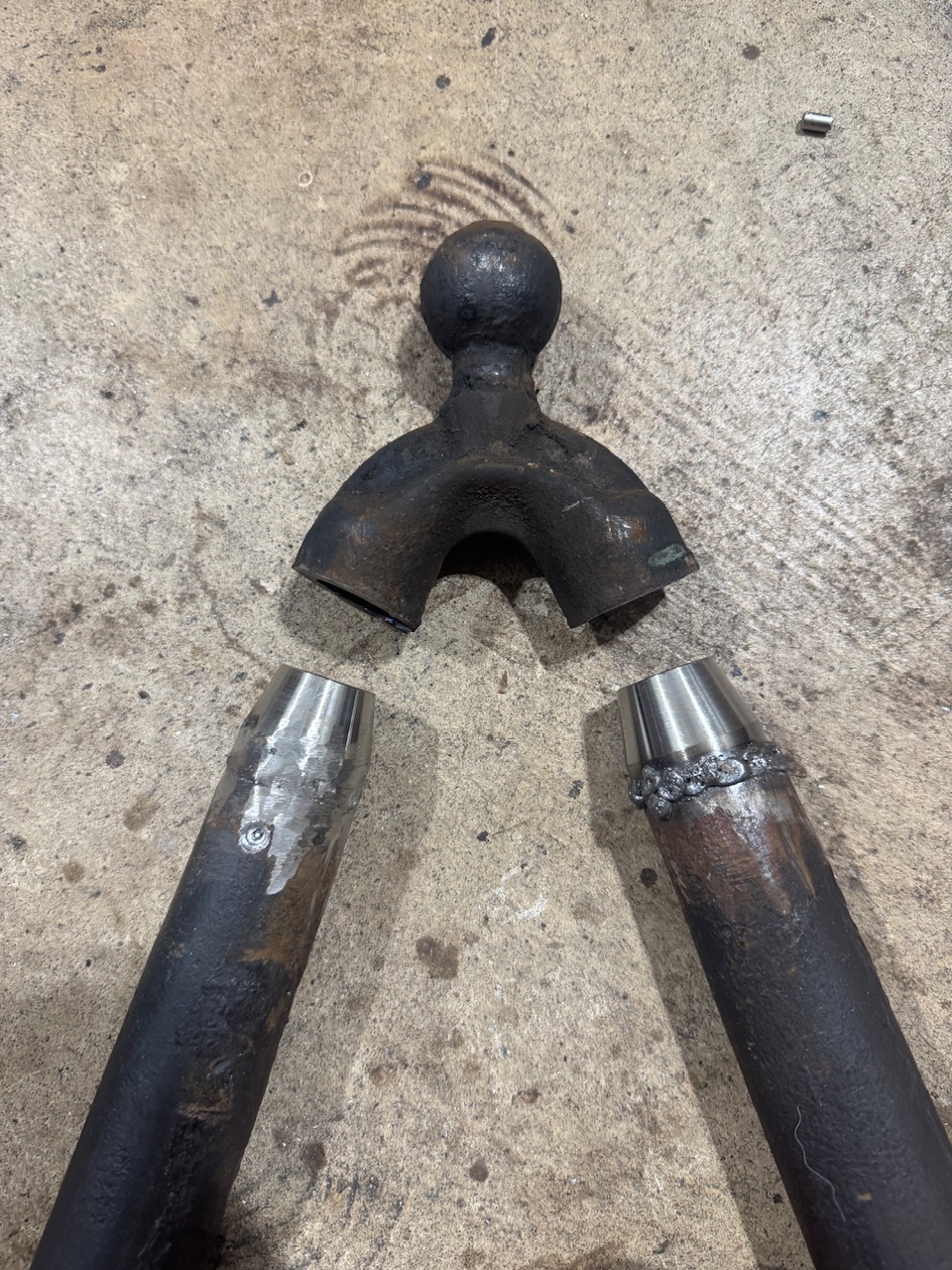

    I appreciate the concern haha. I did bevel the ends and also left a gap. Im pretty new to welding but i read up on it and watched a lot of videos before attempting. How can u tell machine is too cold?

  3. alchemy
    Joined: Sep 27, 2002
    Posts: 22,704
    alchemy
    The weld shouldn’t be blobby on top of the joint. It should have melted in more. Turning the heat up will help cure that.
    And, it shouldn’t be full of little bubbles. Those show contamination that was trying to cook out, but didn’t. Cleaning the metal before welding will cure that.

    When your weld is all boogered up like in your picture. If your heat, speed and motion are right, you should be able to weld halfway around that joint without all the starts and stops, and you'll have a uniform weld that you don't need to grind. Unless you plan on chroming, that is. Welding takes practice, practice, practice.

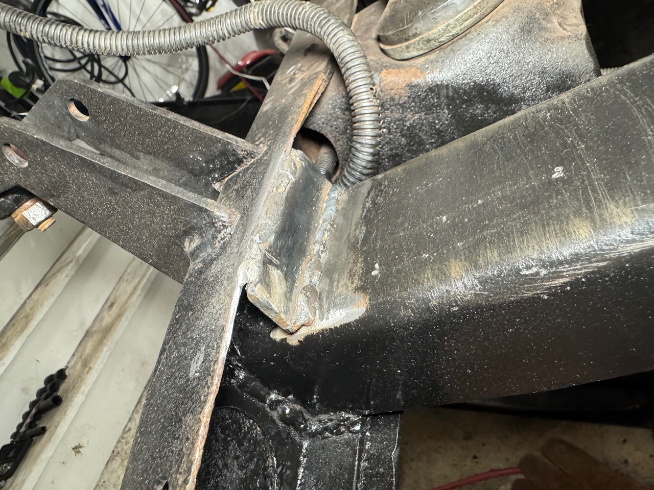

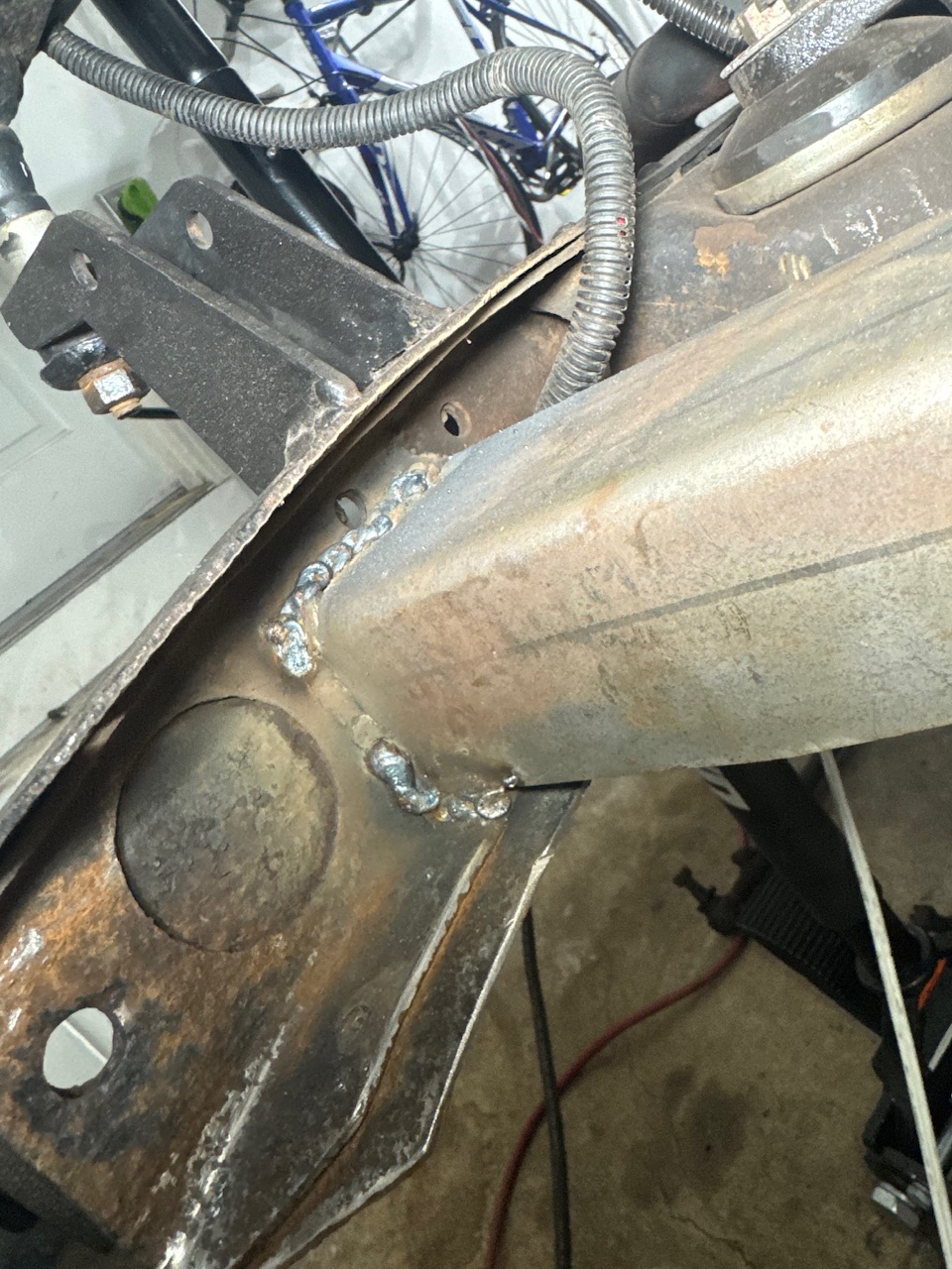

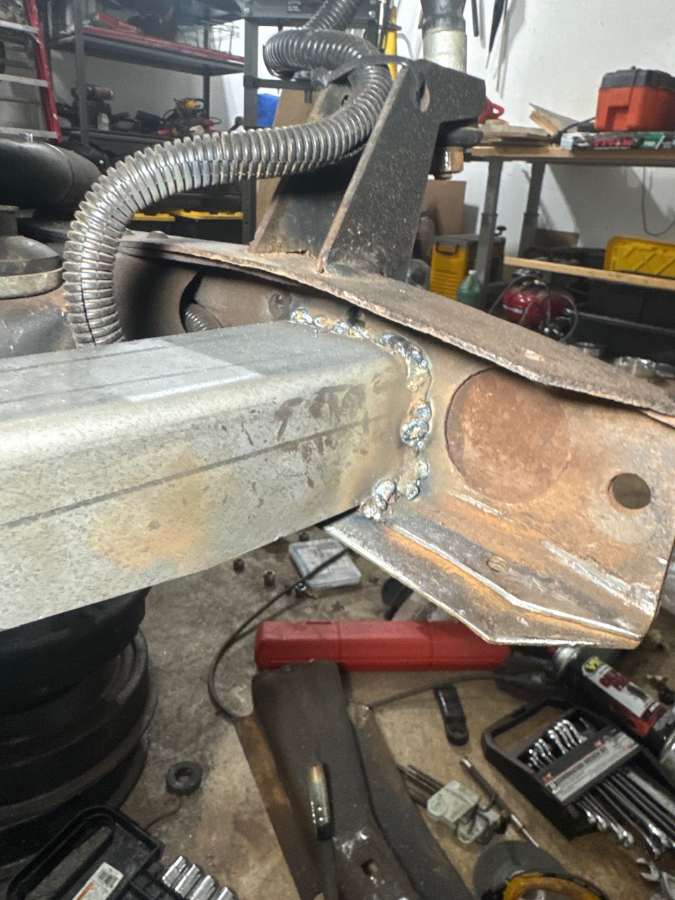

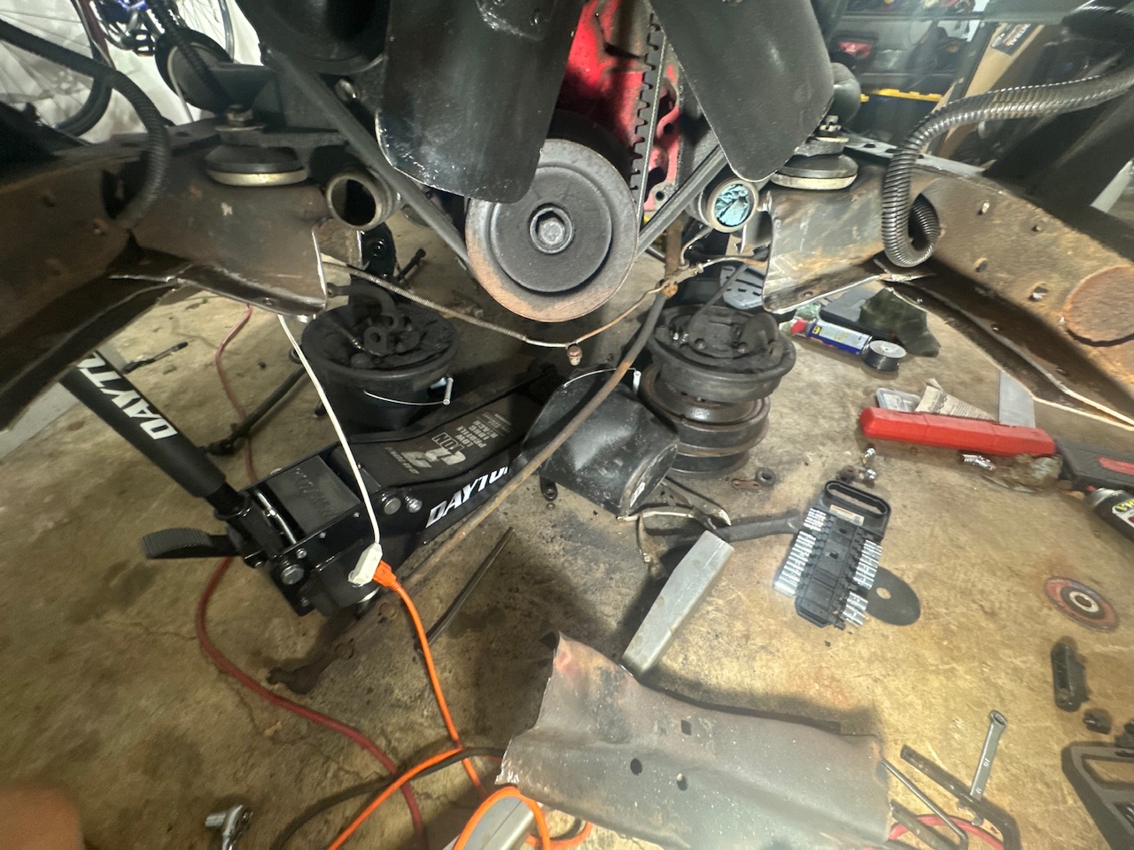

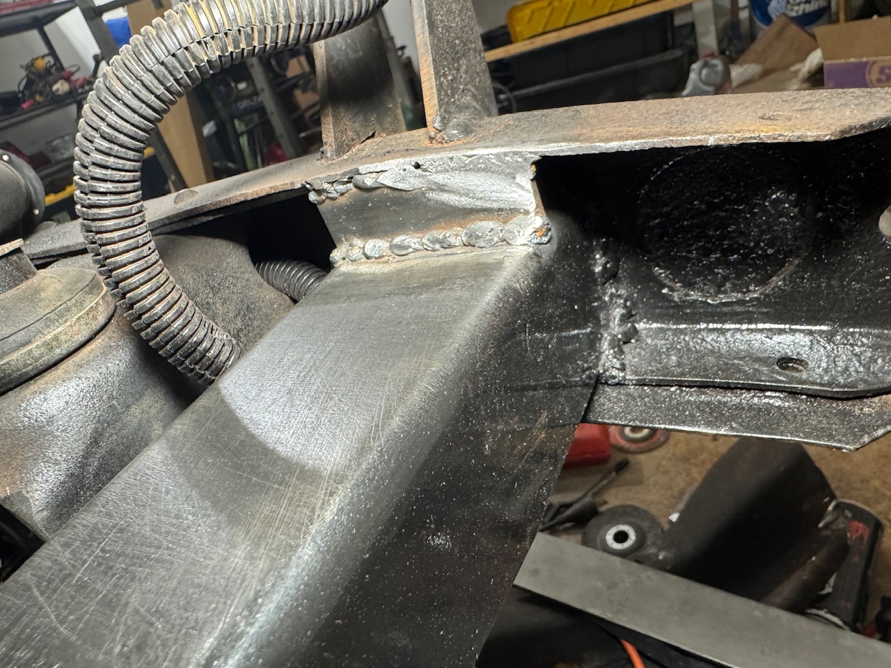

    Cut the old crossmember off and installed the new crossmember. I don’t know about the penetration here. I hit it a bunch to see if is stable and lifted the whole truck from crossmember to check and seems good but maybe i will need to redo it IMG_2861.jpeg IMG_2862.jpeg IMG_2863.jpeg IMG_2865.jpeg IMG_2866.jpeg IMG_2867.jpeg

  12. Budget36
    Joined: Nov 29, 2014
    Posts: 15,318
    Budget36
    I’d go back to @alanp561 ’s suggestion of practicing.
    I won’t critique your welds, but you really need to start on some s**** pieces and get good at them.
    You can start with just a flat piece, run a bead, look at the backside (google it) and you’ll know what you should be seeing.
    Good luck!

  14. alchemy
    Posts: 22,704
    alchemy
    That won’t hold together in use. Looks like a flux core weld. Or a gas shielded with the gas turned off. You really need to practice more. Parts like crossmembers are something your life will depend on.

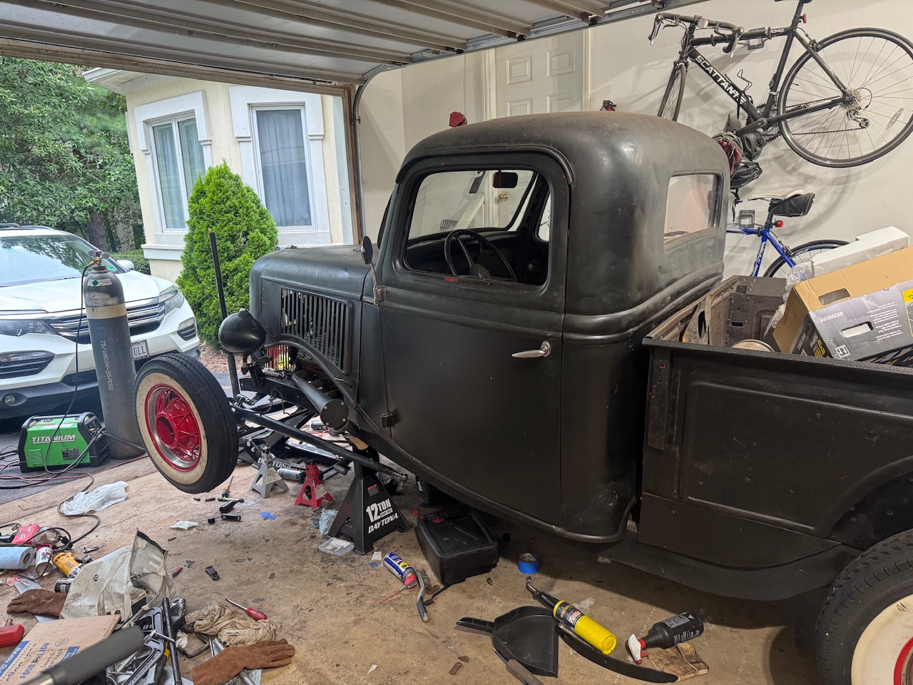

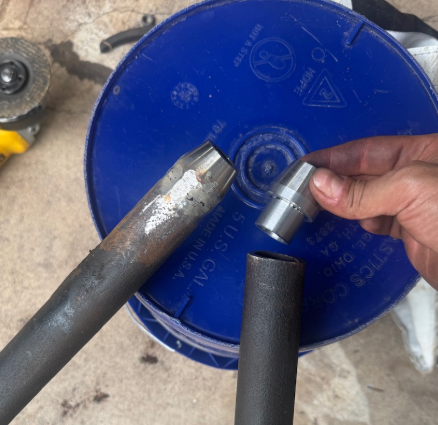

  20. Ed95
    Joined: Jul 8, 2025
    Posts: 93
    Ed95

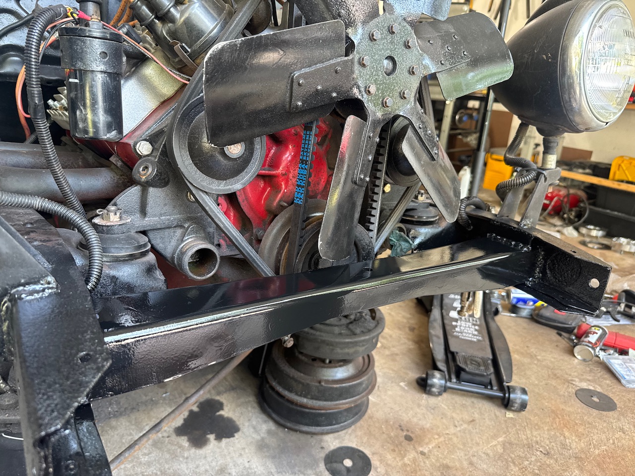

    Attached spring and wheels. Starting to get the right look IMG_2999.jpeg IMG_3002.jpeg

  21. Your weld looks like a bunch of separate little Turds, not any flow together between them. What looks like bubbles is what's called porosity and is caused by a couple things. As mentioned poor or little Gas flow and or rust and paint. I doubt you understand the impact the road actually has on such a joint and lack of quality in the weld joint. I'll just tell you as a concerned Friend here on the H.A.M.B. and a pretty qualified welder that your joint stands a more than 80% chance of total failure happening while being driven. That's based on just this photograph.
    Grind it all you want and make it look a little better but it's still a very week weld! If you care about what you're building as well as drivers around you get some help be it some welding instructions or have a better welder lend a hand. You can beat on things with a Hammer all you want but that is Nothing like road impact and vibration. There's more to hand building a good Ch***is than just getting pieces to stick in place. Do all of us a favor and get yourself some help.
    P.S. These welds just reinforce my comments in that you need some help.

    ^^^We call him the Wizzard and not just cause he looks like Merlin! The man can weld. You on the other hand are not yet a wizzard, more of a first year (if you watch Harry Potter). But we all started somewhere. Point is, do not trust those welds. Cut them open (I think you may be surprised how easy that will be), clean everything up and have someone ***ist. I had a HS coach always say "practice make perfect as long as it is perfect practice", don't practice on suspension/steering/frame etc.
    I only MIG weld, I use a 220v Millermatic, I weld with a lot of heat and less wire. Like the Wizz said, clean everything, hospital clean. Cut the ball off the wire with side cutters before every weld, wire brush between trigger pulls. If I was welding those ends on your bones I would do them in 2 p***es, 3 at the most. Those little holes are signs that your gas is running low, not enough heat, not clean enough, to much space between the torch head and metal, not enough power (like running a 110 welder on an extension cord...no bueno).
    I was welding on a frame a few years back and @Pist-n-Broke came over to supervise. He watched for a second and asked me "do you where readers?". I said yes, and he told me to go put them on. :cool: Best advice I have ever had. Eyesight deteriorates slowly over time and I didn't realize I was welding like I needed a white cane! I now have magnifiers in my helmet and extra lighting so I can see the "puddle" . Those welds pictured above never had a puddle. Please don't trust them.
    You will figure this out, you will become a good welder if you work at the trade and develop the skill. No one was born a welder. The Wizzard? Maybe. The rest of us "muggles" have to learn.

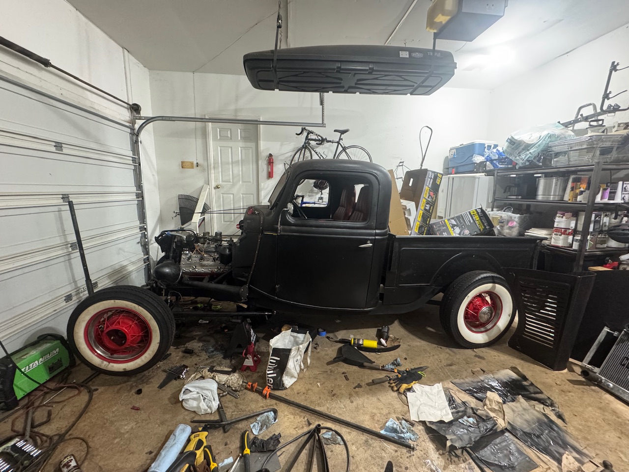

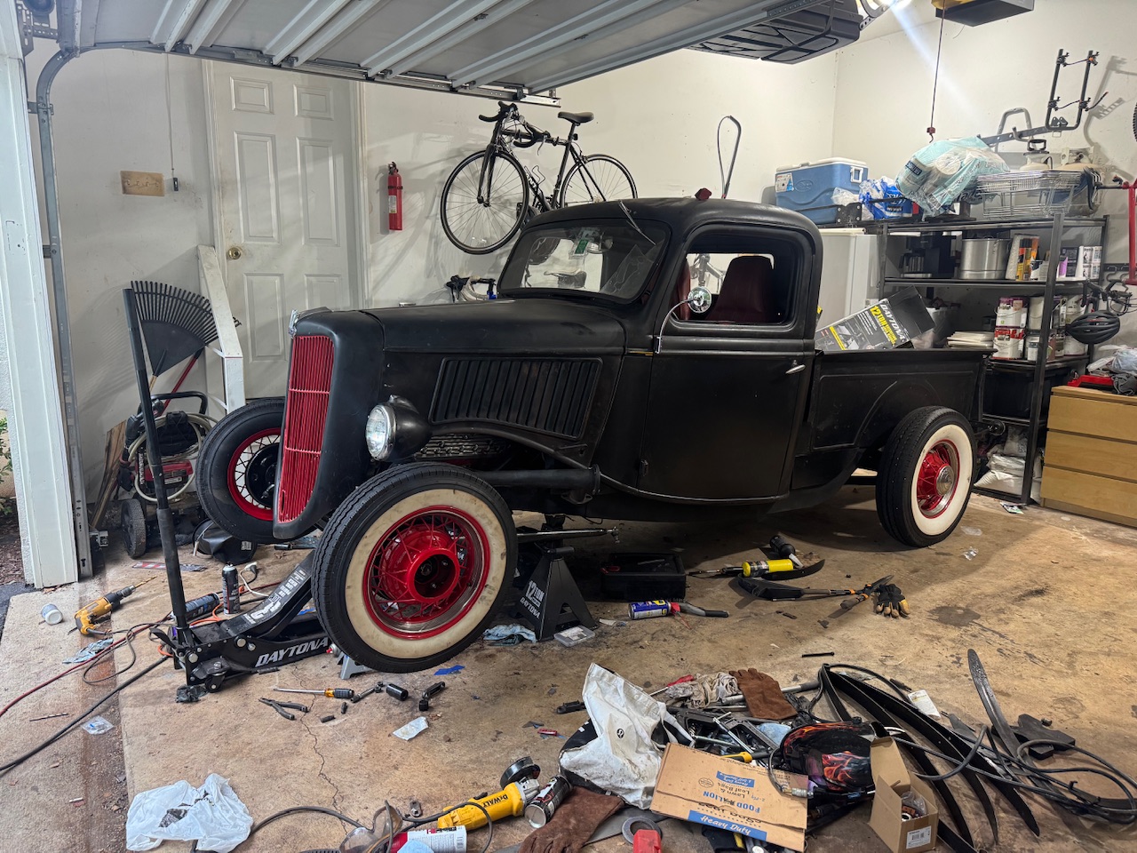

  26. Ed95
    Joined: Jul 8, 2025
    Posts: 93
    Ed95
    Mounted everything just to get a look at how the new setup will work. I will be taking the truck to a professional to redo the crossmember and wishbone welds… IMG_3013.jpeg IMG_3020.jpeg IMG_3019.jpeg IMG_3021.jpeg

  27. alchemy
    Posts: 22,704
    alchemy
    Don’t paint them until the welds are ground out and rewelded. The steel needs to be absolutely clean. And don’t be hurt if the pro cuts your parts all the way off to grind off the porous welds.
