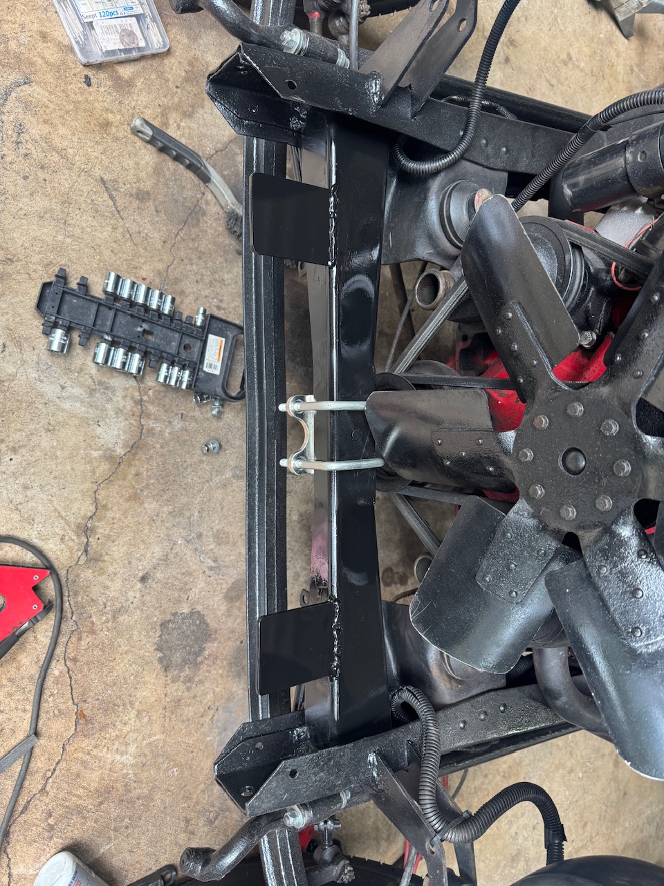

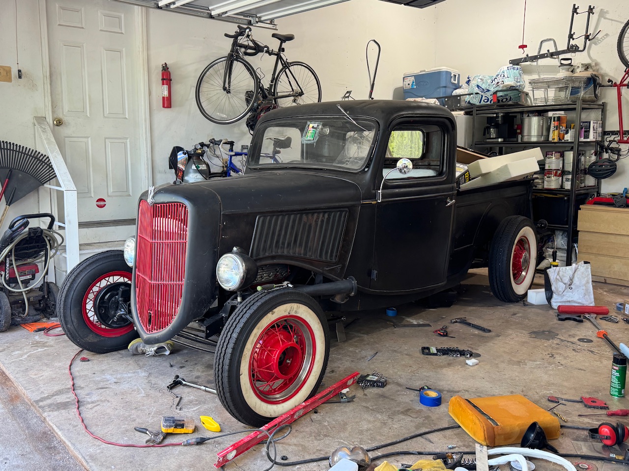

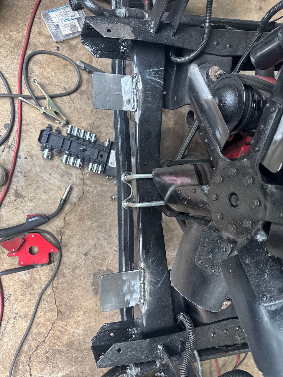

    IMG_3103.jpeg IMG_3104.jpeg IMG_3128.jpeg IMG_3129.jpeg IMG_3131.jpeg IMG_3119.jpeg While i wait for the seat stuff i started tackling other things. Welded some radiator mounts got some rubber pads on them. Installed back the radiator. And pie-cut the bones to get the proper caster. I’ll wait until the end to attach them but l now they’ll fit under the frame. Also a little design i did on the seat. Took some inspiration in a 60s corvette i saw.

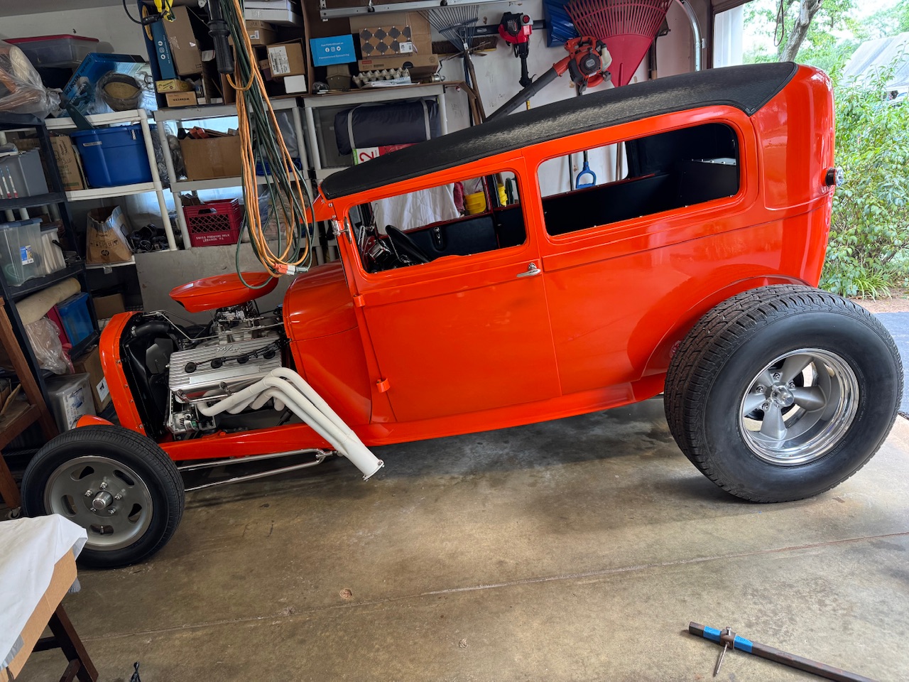

    IMG_3137.jpeg Spent some time at @Just Gary s garage — he hand-built a ’28 Ford Tudor sedan that looks like a real-life Hot Wheels! Incredible rake, flawless paint, and craftsmanship that’s next-level. Really appreciate his advice, tips, and help. It meant a lot! It’s great to meet some local hotrodders.

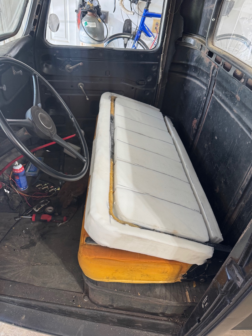

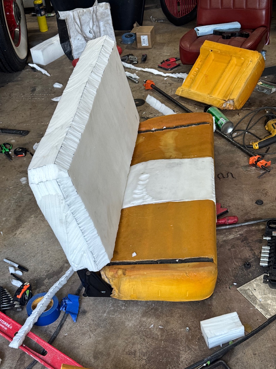

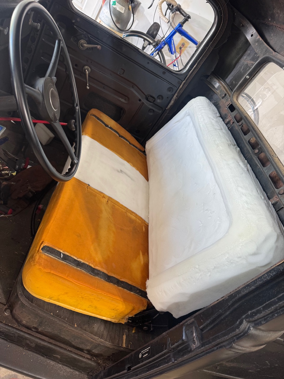

    IMG_3153.jpeg IMG_3154.jpeg IMG_3155.jpeg IMG_3156.jpeg IMG_3158.jpeg IMG_3159.jpeg Been working on the seat. Starting to look real. Trying to give it the overall shape and keep it comfortable. Been shaping with grinder. Works somewhat decent. I glued the missing piece in the middle with some foam glue. Also put the front together

    I might take the top edge off. Want to keep it early 50s style and also comfy

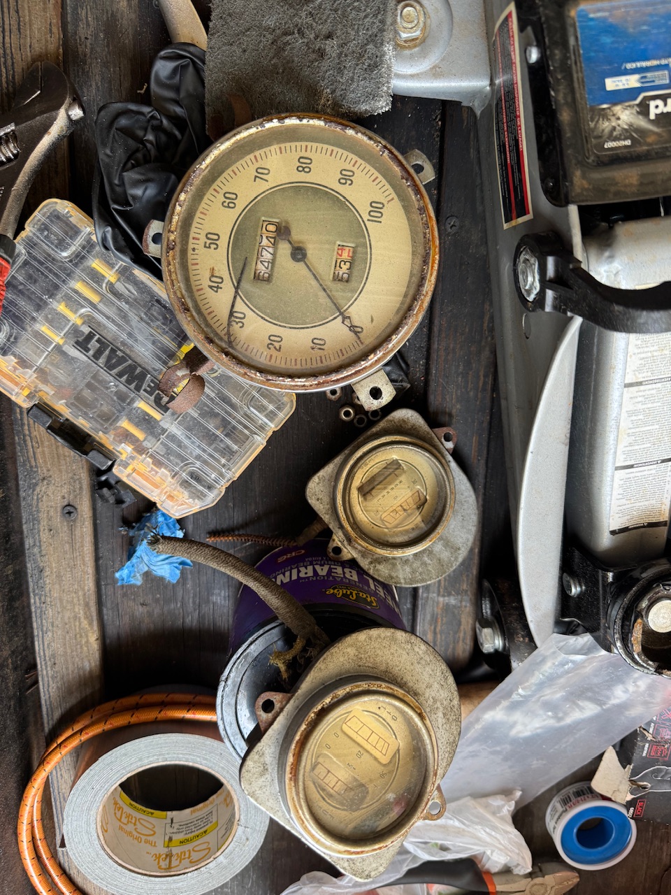

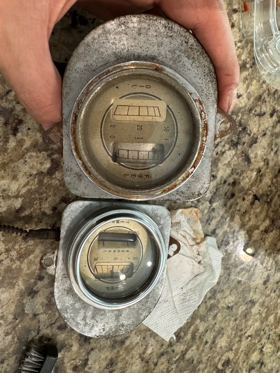

    I have the original gauges. Anyone can recommend someone to restore them? Especially need the engine temperature one restored. Need the liquid to be filled and a new tube. I don’t care much about the paint but want them mechanically sound. Maybe new chrome for speedometer. IMG_2641.jpeg IMG_2640.jpeg

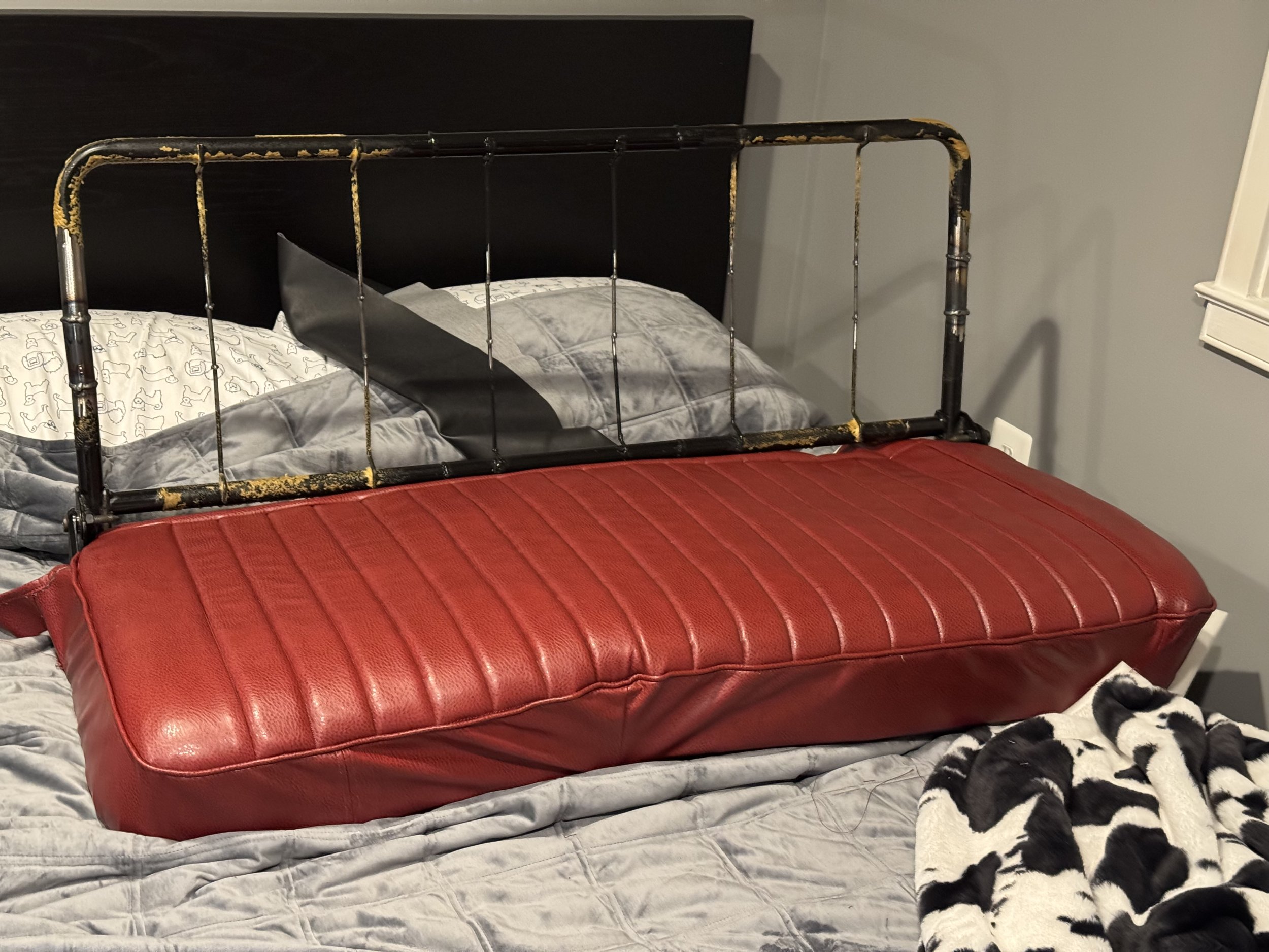

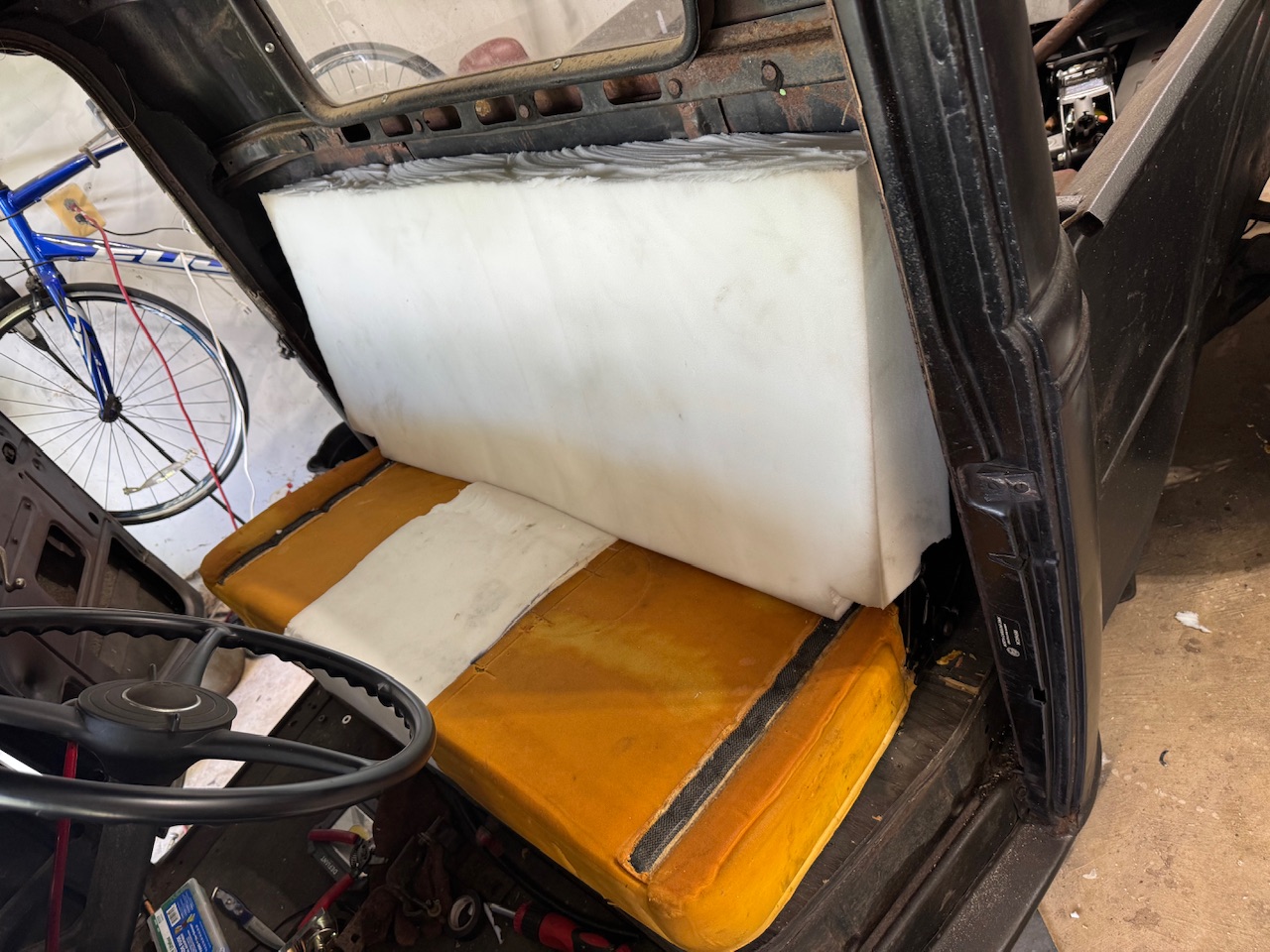

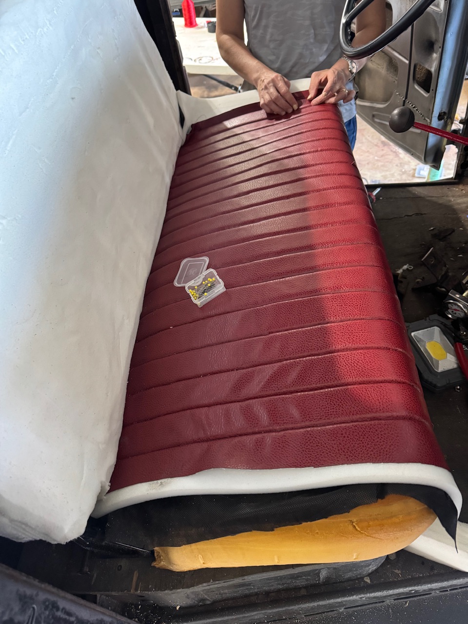

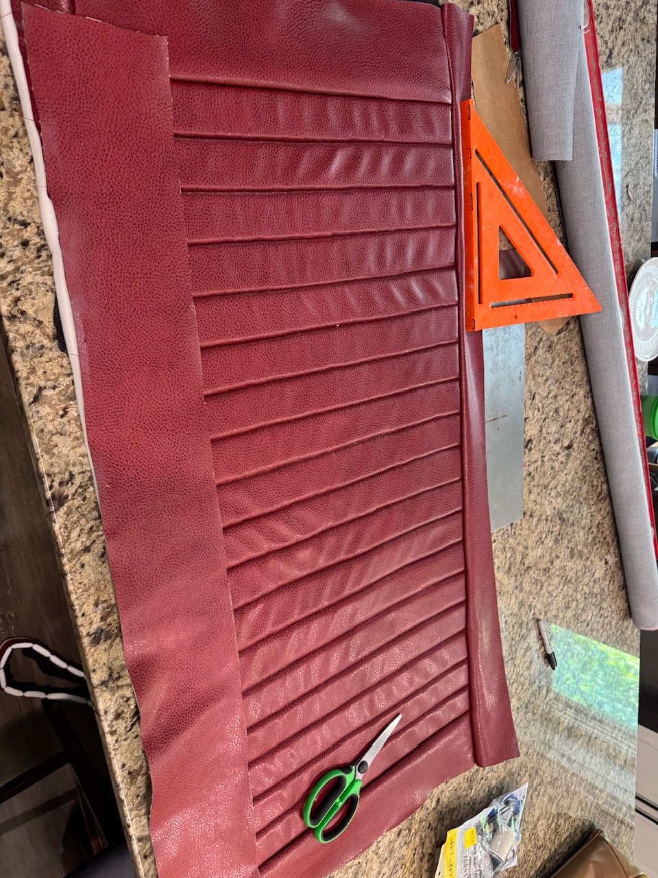

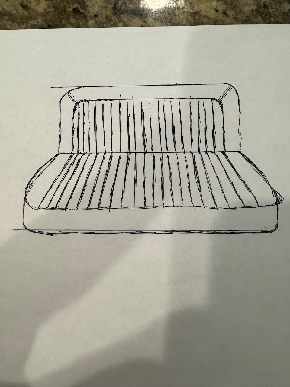

    I took some 1/2 in foam and vinyl from ebay and sewed 2inch pleats. Looks kinda ok haha IMG_3181.jpeg IMG_3189.jpeg
    This is the chatgpt version of what i’m trying to make. We’ll see how close i get IMG_3183.png

    Williamson used to have a good reputation for gauges, I don’t know about now. Worth a Google look, or maybe someone on FordBarn has a source for gauge repair.
    Might want to ask with another thread topic for more leads.
    Ed95 and Just Gary like this.

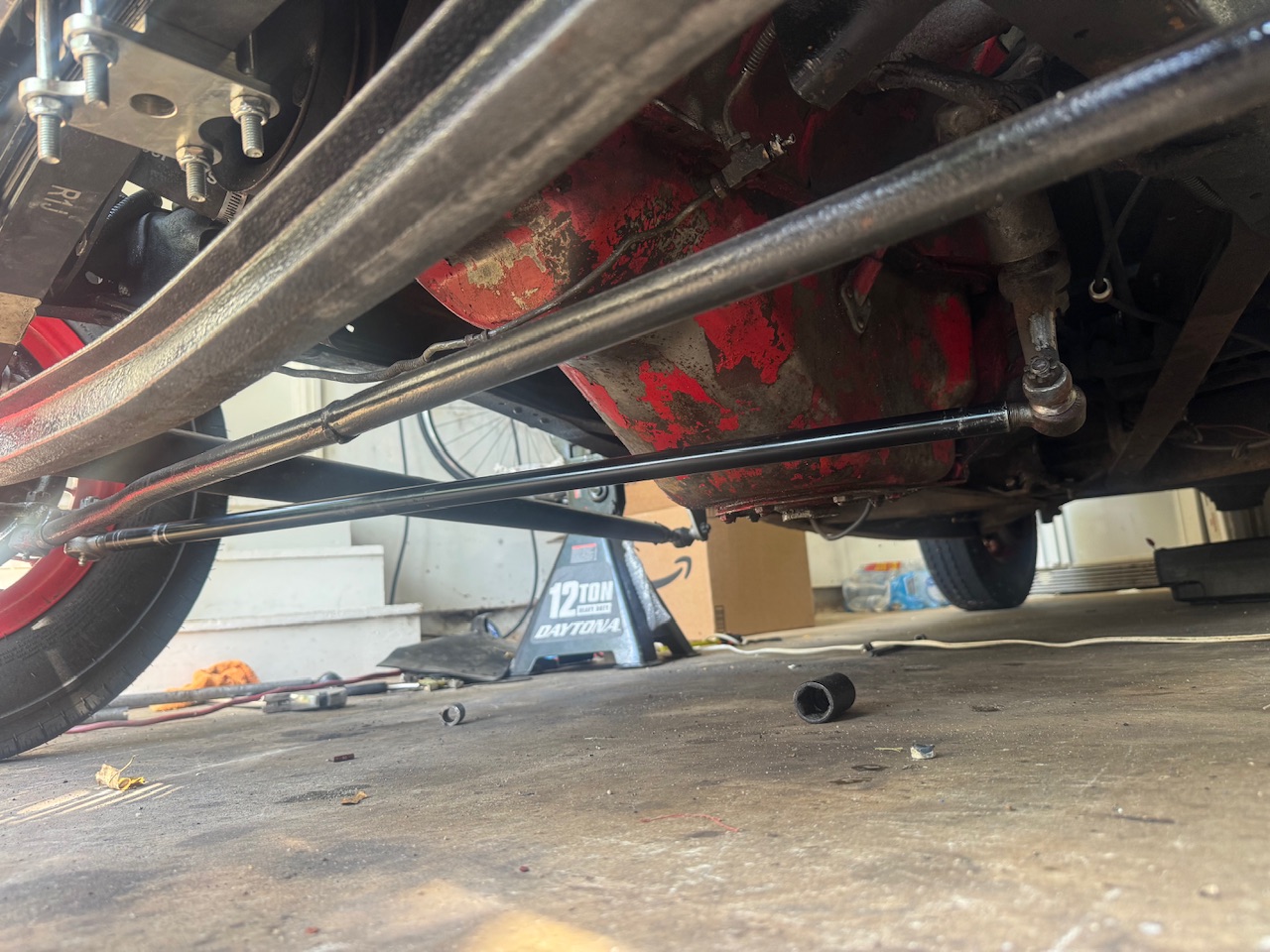

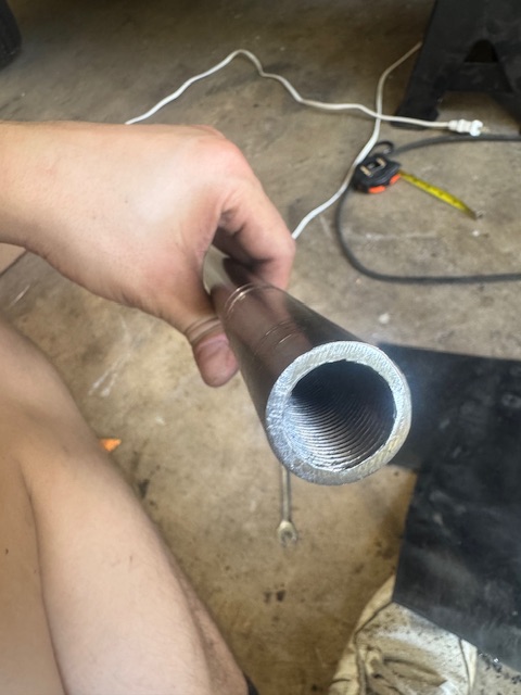

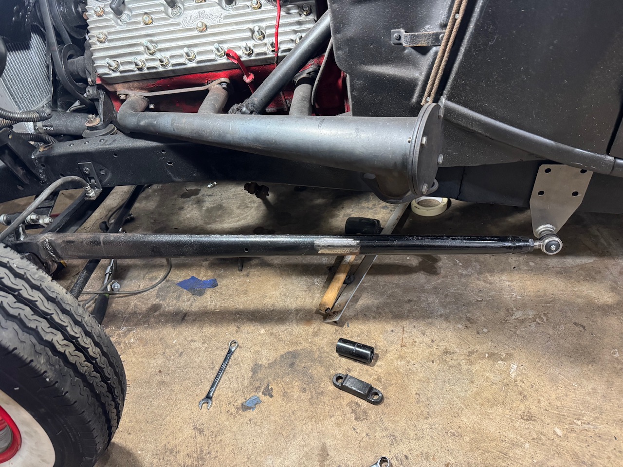

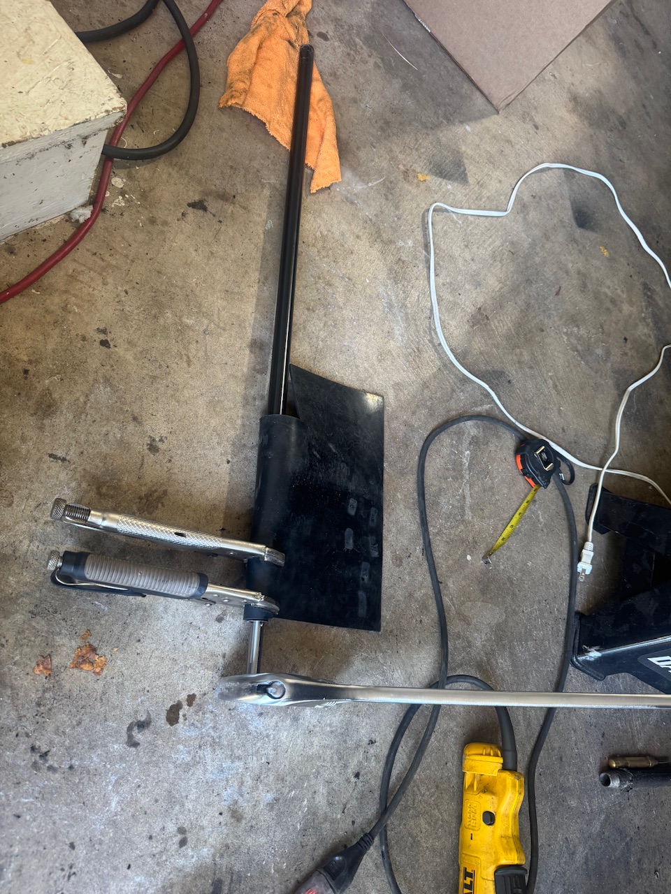

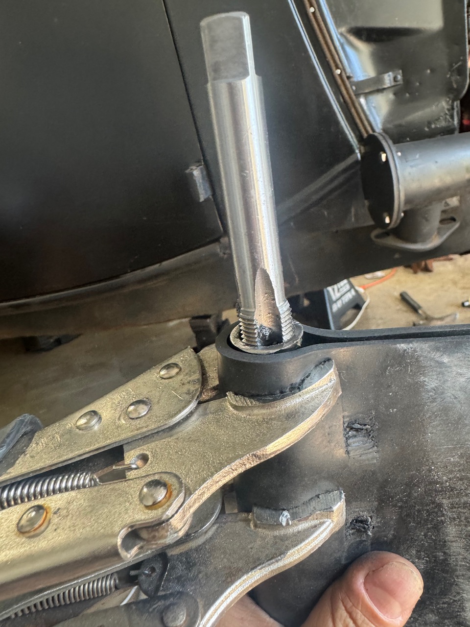

    Got my drag link from speedway. It was longer but only $21. So i decided I was gonna cut it and tap it. I grabbed it with some vice wrenches and some rubber pad i had and it worked well.
    Here is where I ran into my next problem. The drag link the truck had installed before was bent. Whoever installed it before bent it so it could clear the oil pan. Smart, but i hate the way that looks. I saw they sell dropped pitman arms so I guess that’s next cause it does hit the oil pan when steering all the way right

    Are you kidding? That looks great!

    Haha thanks! I guess i see some spots where i didnt sew super straight but i only kinda know how to sew. Been watching a lot of YouTube

  13. Buy a single Dropped tie rod end from speedway and put it on the sight side of steering link. End of problem.
  14. Ed95
    Joined: Jul 8, 2025
    Posts: 101
    Ed95
    This is why i post here! Thanks for the tip! I’ll try that.

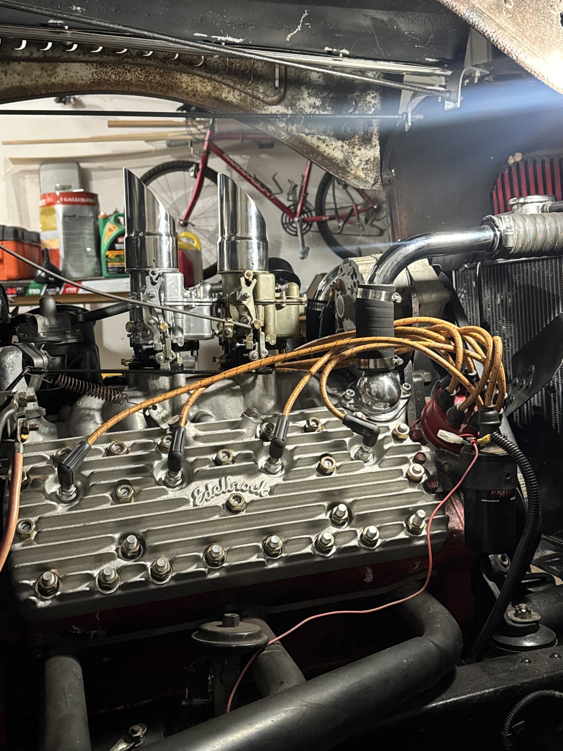

    IMG_3227.jpeg Getting to one of the more fun parts… i finally installed my mechanical advance mallory distributor. I got a 1.82 ohm ballast resistor and my coil primary resistance measured 1.2 ohms.
    • Coil primary: 1.2 Ω
    • Ballast resistor: 1.82 Ω
    Rtotal=1.2+1.82=3.02 Ω
    Then we use Ohm’s law
    I=V/Rtotal= 12V/3.02 Ω≈ 3.97A
    So, I’ve got about 4 amps to my distributor. That sounds pretty safe to me, but if anyone has more advice on that let me know.
    Just need to finish wiring it but I’ll be starting her soon.
    Mallory has great instructions on how to install but essentially i found TDC and kept note of my rotor position to align the new one close to that. New distributor goes in and i marked the rotor location on new distributor housing and thats my cylinder #1. At least that’s what i got from their instructions.
    Also pictured my new rear holley 94 carburetor and velocity stacks from speedway. I’m using a solid H&H dual carb linkage in my offenhouser dual manifold. Pretty sick!

    Thanks for the kind words! I love this stuff. Finally I’m able to mess with it and I spend all my time at the garage haha. I do plan on taking that head out and redoing those bolts i marked them cause theyre a little lower than I want them to. The threads in the block are not so good tho. Maybe ill try to repair those with some helicoils.
    Also I must have not done my homework so good. Engine did not fire up :(
    It ran before the distributor. I had the original distributor in and it was able to run but it overheated. Which led me to change the distributor as a possible fix to overheating… think the timing was a little retarded

  18. Basic rule of thumb on hardware. Bolt dia, (lets say 7/16 like the head studs) require same amount of thread purchase to be able to set proper Torque values. Most standard nuts like the ones your using on the heads are also the same height nut so they have proper amount of purchase when the stud comes clean through the nut. I believe Torque spec on your motor is 70 ft lbs each to properly seal the gasket. You have a very good chance you have already pulled some threads on either or both nuts and studs on those shallow ones. Hard to get 70 lb's on 3 threads, for long.

    IMG_3237.jpeg IMG_3238.jpeg IMG_3239.jpeg Omg! Upholstery is so hard
    Eh. Cost me a bunch of time and like $100. I guess you get what you pay for

    As a new flathead owner you will soon learn about the importance of tight thread fit on the head studs. If you retap those holes you will have coolant seep through. If you don’t seal up the threads you will have sealant seep through. That’s why I prefer studs.
    When using studs you can basically glue the studs in the holes with good sealant and never need to mess with them again. When using bolts you will need to use a less strong sealant because you will need to retorque a few times, and probably check them once a year after that. Turning and chewing up the sealant every time.

    Did you take it out and let it lay flat preferably out in the sun for a while to let it "relax" before you started? That and stretching tight where appropriate before you affix the hog rings will help. Give it some time with your **** on it driving around and it might look a whole lot better when installed. Overall, it does not look that bad for your first attempt. You are learning why a full-time upholstery shop charges what they do. Doing a lot of these things yourself is the way it was done as the guys before you were not rich. Plus, you get the satisfaction of telling everyone that asks, you built it with your own two hands. If they point out flaws and mistakes. Ask them how they would have done it. If they offer sound advice take it. If they have nothing but, "You should have paid someone to do it". Tell them to pay for it and you will have it redone and walk away.

    I did use sealant when installing the studs. I like the studs too. I did a bunch of research at the time and the studs appeared to be better in the long term and they ensure i didn’t strip the threads

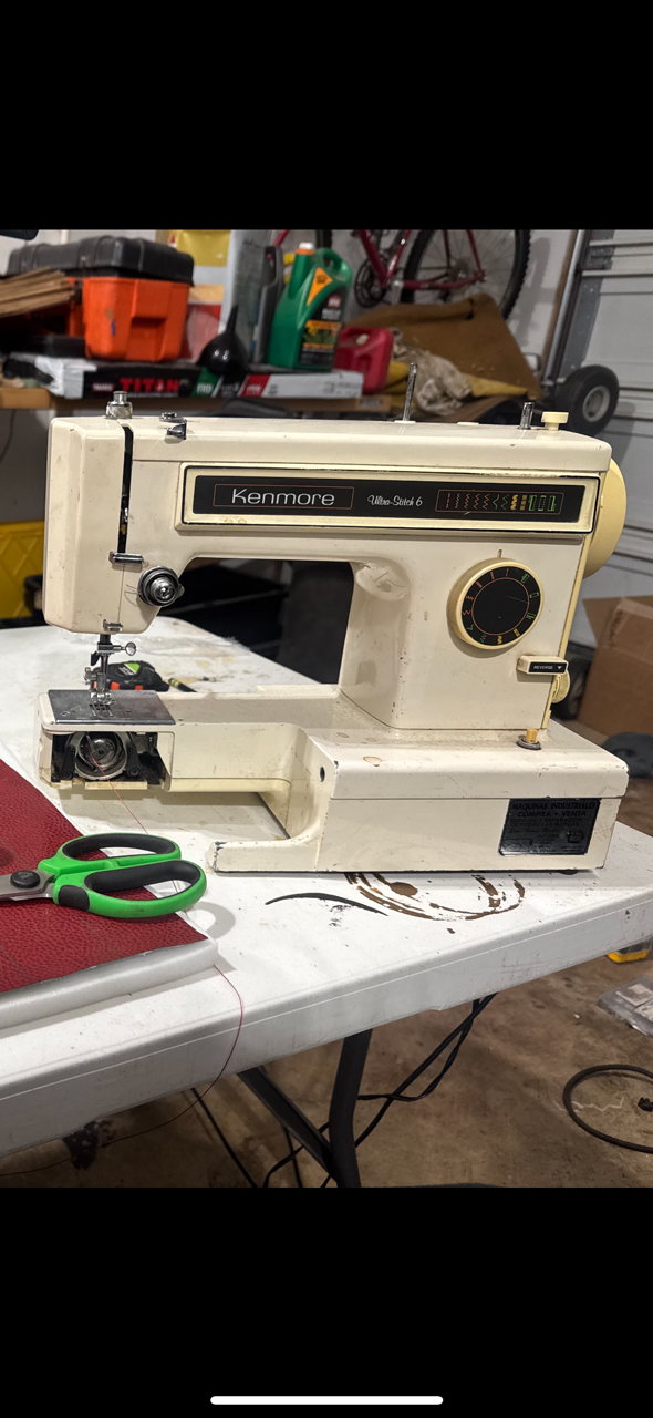

    Yeah haha I got the vinyl like a week ago. It was well rested lol. I’m just not the best at making seats I guess. I learned a bunch doing it tho. A good sewing machine goes a long way. I was using a more new/budget one at first, but then it started sewing ****py. So I busted out my old grandmas kenmore haha. I looked up the model and its from the 70s. Its quite nice and powerful. All metal inside and out.

    doing upholstery w/ that is like putting a 55 chevy at watkins glen-you did great considering!

  27. So how I read this is that there is Zero chance of the Stud turning in the block and the Nut will always turn first. Good luck there.
    Something I learned a very long time ago. Give 5 skilled Craftsman the same mission to do and you'll get a good job done by all 5 and all 5 done just a little different. I also learned to never give advice if I haven't done it myself and had success. alchemy and I simply do things differently. I bet we both agree you need better thread purchase on the shallow studs.
    On a different note, I wouldn't have just changed my Dist simply due to a little too much heat on startup. I do however like Electronic Ignition. On a basic startup I preferer to use a Vacc gauge than a timing light. Helps me find the sweet spot for what's going on at the time. Final set with a light comes after everything is working as a system. It's a balancing act at first. Who's happy and where.

    It takes time to learn "the feel". That means, when to stretch more and when to stretch less and where. Knowing what the fabric will do when you sit on it and then get up and it still looks good. Upholstery is not a "black science" but an art. to be an artist you have to have the feel for whatever endeavor you attempt. No one is an expert at everything. For your first attempt it looks good. Try again and you may find a niche that you are good at. You will never learn unless you try. You may find something you are an "expert" at. Never give up.

    I got her to fire! Someone marked the crankcase wrong. I used the old thumb in the spark plug hole while someone cranks the engine by hand. When I felt the pressure build up and it pushed my thumb we stopped spinning and pointed the rotor to cylinder one right there. She sounds dreamy, but i notice a lot of white smoke… probably not great huh? Is that coolant getting burnt?
