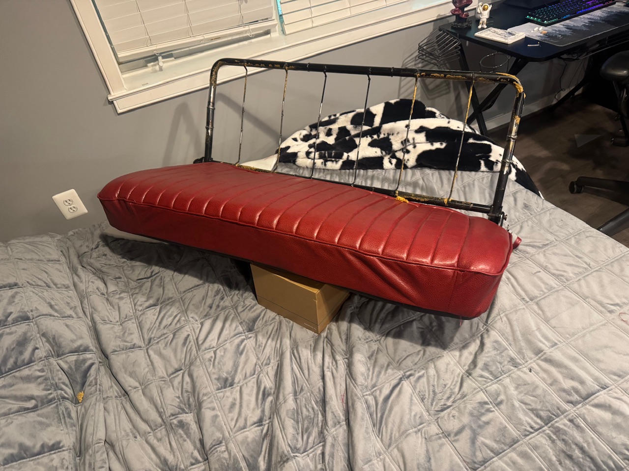

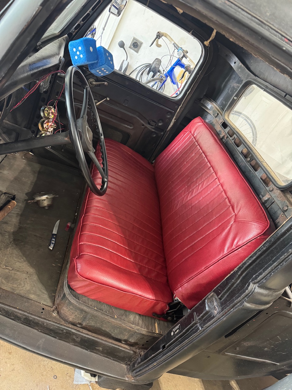

    Redid the seat. Its still not perfect but better.
  2. Budget36
    Joined: Nov 29, 2014
    Posts: 15,280
    Budget36
    If you want perfection, pay for it. But I gotta tell ya, look good to me.
    Can’t see wrinkles with your **** in the seat!
    Ed95, BigRRR, Deutscher and 2 others like this.

    Like I said, it is a learning process. The more you do the more you learn what to do and what not to do. It still looks great for an old car and when you sit on it, it may get even better.

    The seat looks great, good job. They’re a pain to do for sure. Perfection is overrated

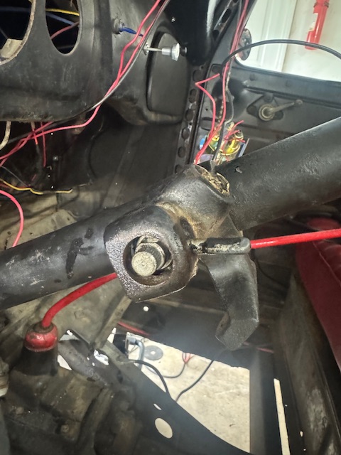

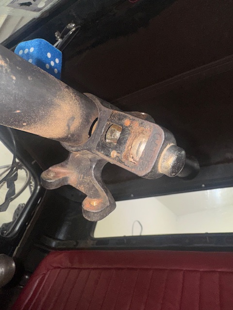

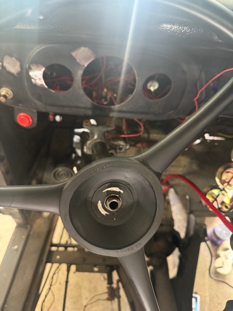

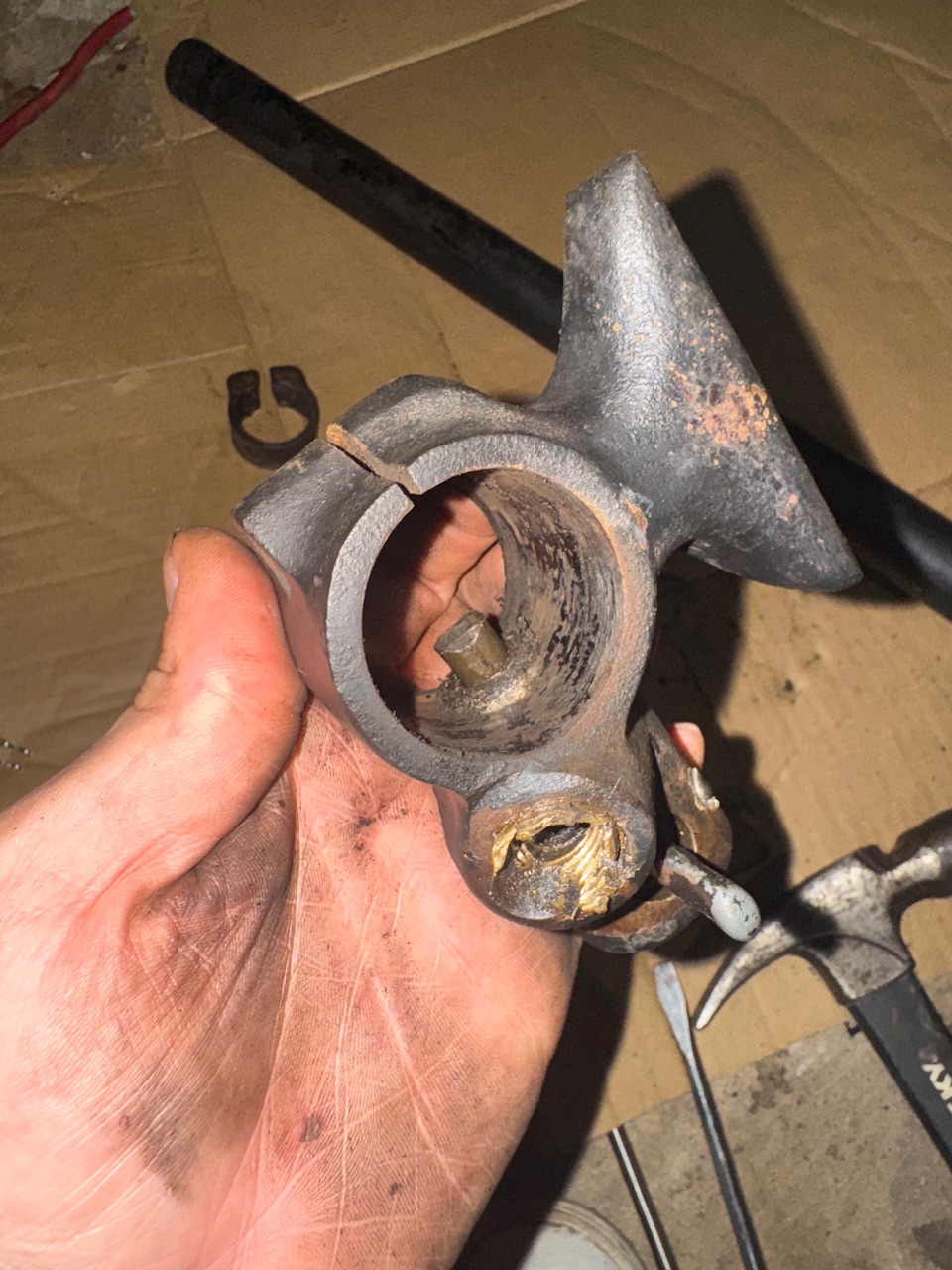

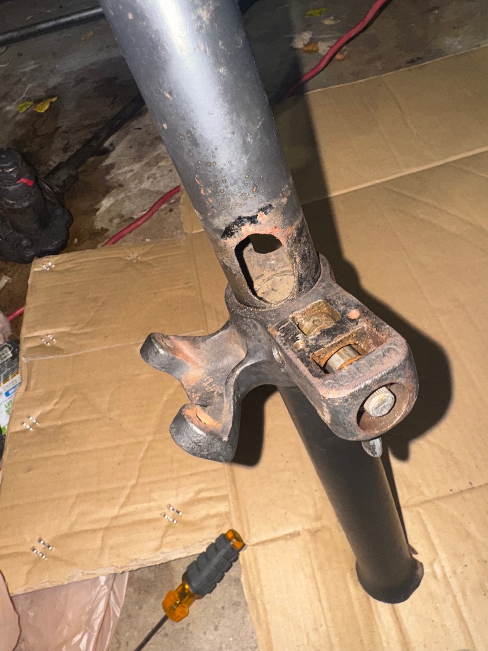

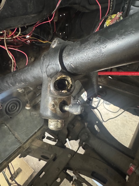

    Next I’m trying to restore the original key functionality. Someone destroyed the lock cylinder in place. So this will be fun IMG_3268.jpeg
    i took the steering wheel off and loosen the outer jacket or whatever the tube is called from the steering box. I was able to slide it a little bit up. I was trying to remove it but seems like i need to remove the steering box so i dont wanna do all that.
    So this is where i’m stuck now…
    I am trying to dis***emble the entire inner awitch system. I figure this way ill be able to push the remnants of that cylinder piece. There’s a little pin thing remaining in there that doesn’t let me slip it out. I read youre able to claw it out somehow but don’t wanna damage it
    Deutscher and Just Gary like this.
  9. Budget36
    Posts: 15,280
    Budget36
    I read the pin needs to be drilled out. Maybe @alchemy can confirm the process?

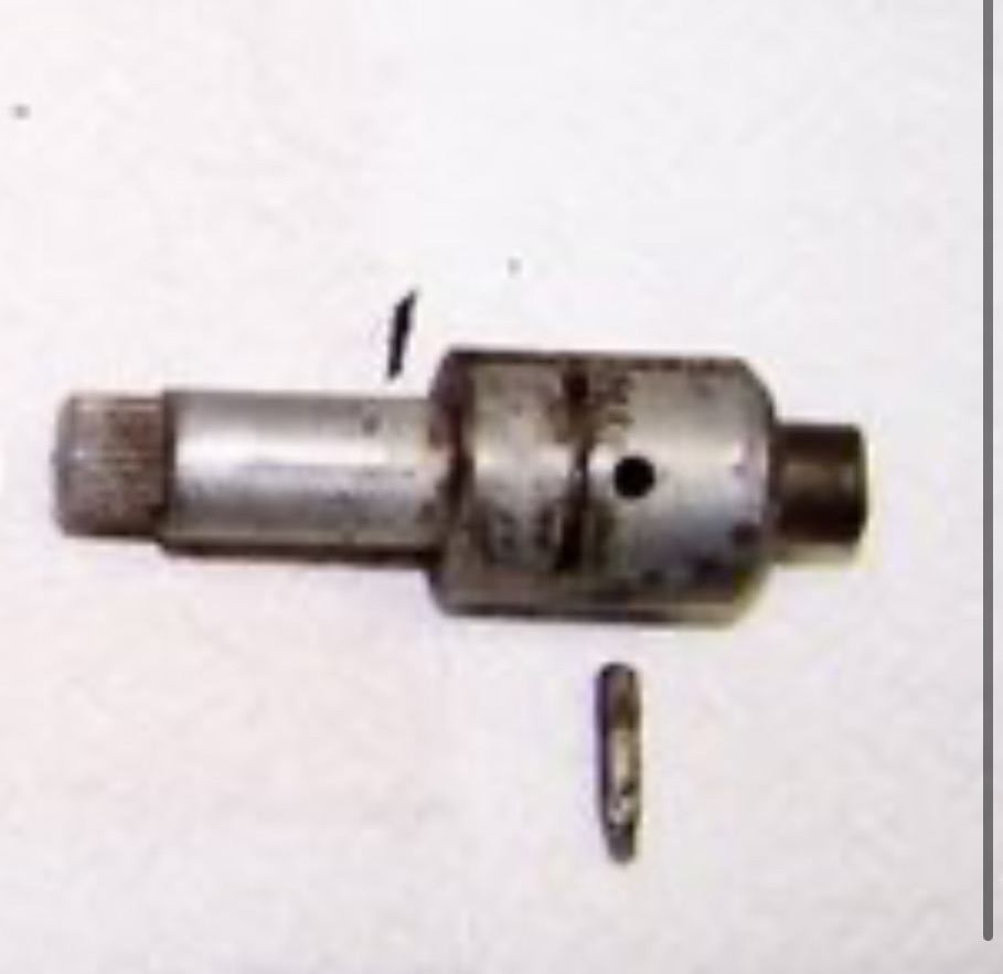

  10. Ed95
    Joined: Jul 8, 2025
    Posts: 91
    Ed95

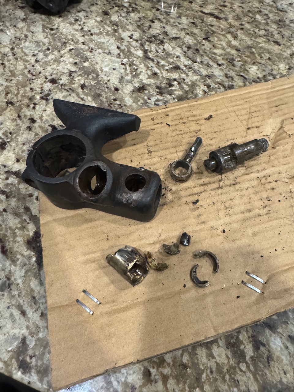

    I pulled it out! but still cant slide the switch off. It should be pushed into the steering shaft. This is the piece
    here is how it looks now. Im able to push it a bit but it hits the inner steering shaft
    Might need to remove the steering box

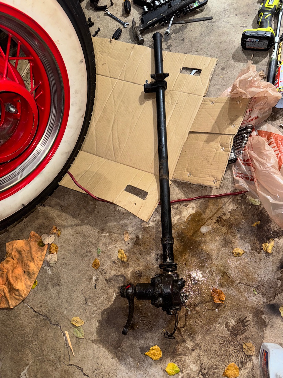

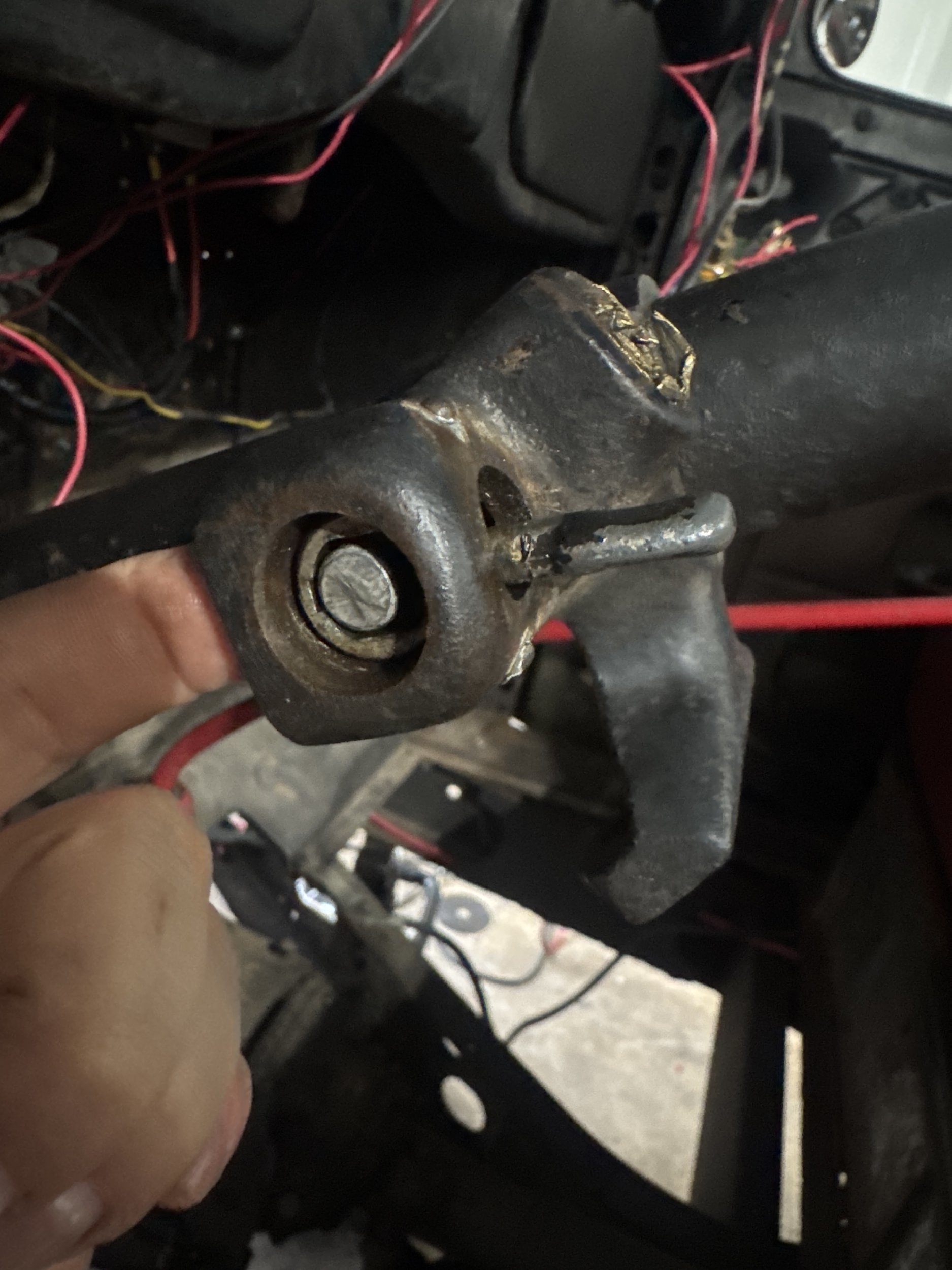

    Oh well… i guess i’ll clean the steering box and repaint it too had to cut the bolts to remove it they just kept spinning. All this for the stupid key cylinder and i dont even know how to take the outer tube off and the steering drop slides side to side but cannot slide it up the tube for some reason. Like stuck inside

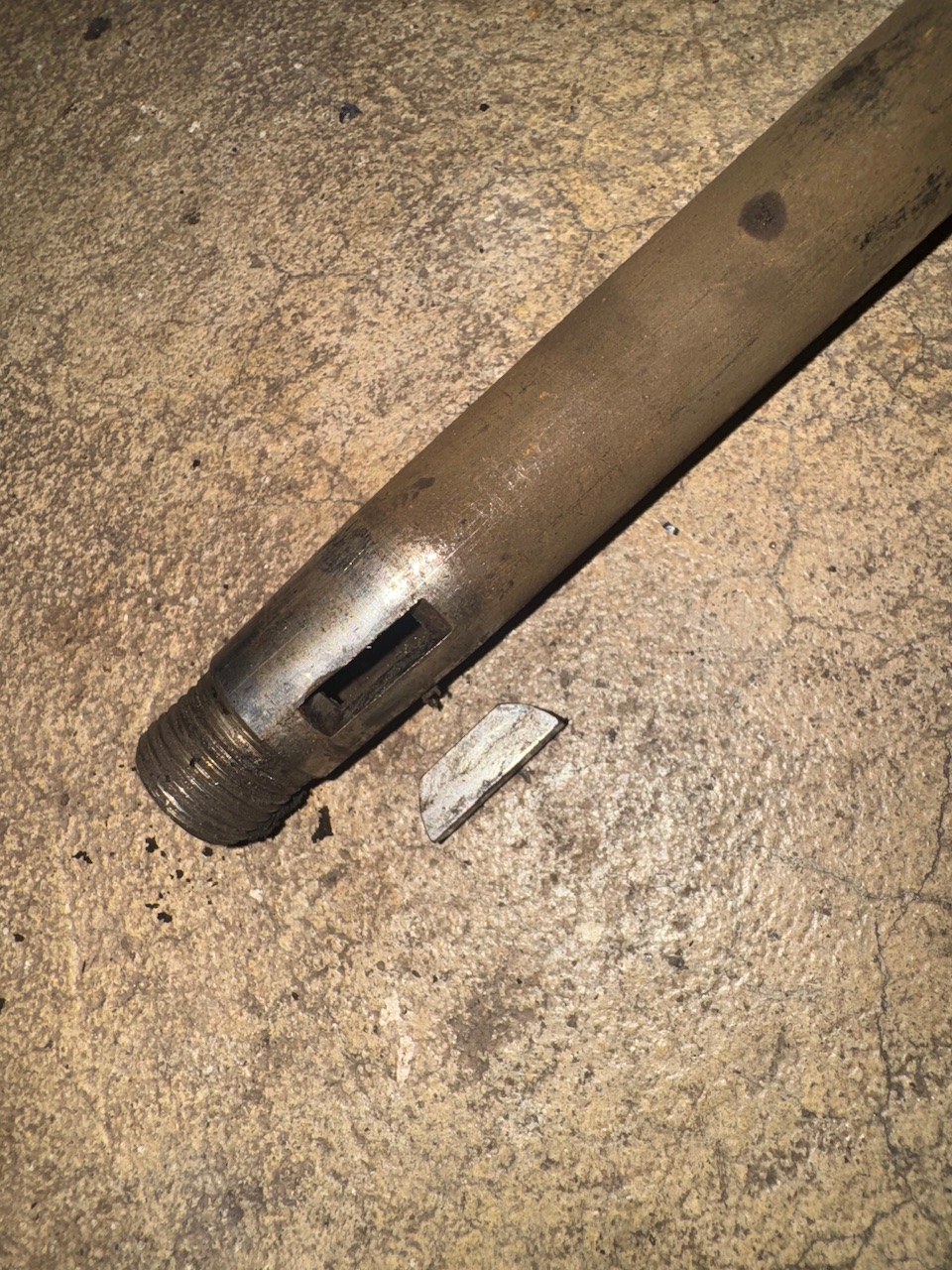

    So for other people u dont really need to do all that.
    Theres a key thing that punches out on the inner shaft
    then the drop thing can slip out the outer tube

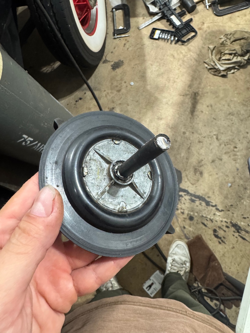

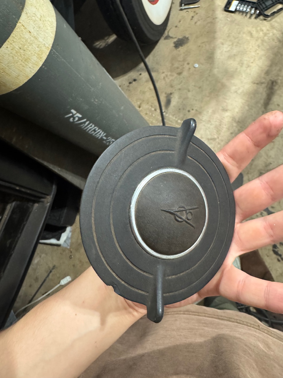

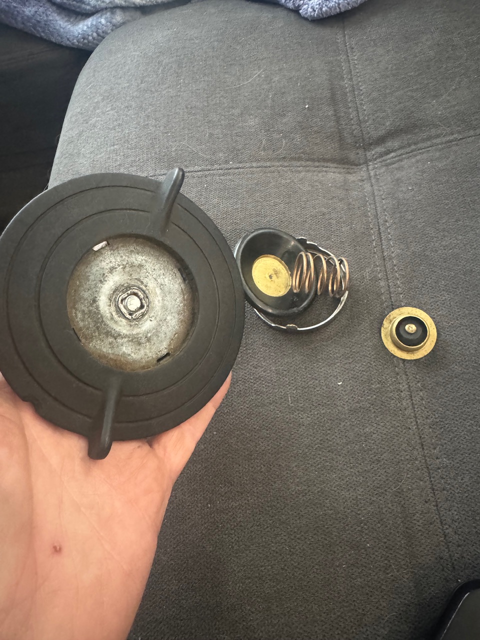

    For the switch parts I’d search at Third Gen Auto. But I think your horn rod is fubar.

    Haha yeah thats what i see too. Is there any other more modern way to restore functionality even if its not the original design?

    Unfold the tangs on the back of the horn switch, solder a long wire to the contact of the ****on, and run that wire all the way out the bottom of the steering shaft and column. Hook it to your horn relay just like a modern car. You will need to make sure the little bit of tube you have left on the back of the horn ****on ***embly will ground to the steering shaft. Looks like there’s tape on it? Clean that off. And put a very slight bend on the middle of that tube so it kinda wedges in the shaft and doesn’t slide out easily.
    warhorseracing likes this.

    Can you explain that with a little more detail? There’s a contact ****on? What does the wire soldered to the ****on contact do? Grounds it? Do i need a spring or something? And that bent little rod will be enough to keep it in place?
    Is the little ball with v8 in the middle of the chrome ring a separate piece from the whole thing?

    Should be a spring under the V8 ****on. If it doesn’t spring now, somebody has messed it up. Most horns work when you ground the ****on, which completes the circuit.
    My sedan is done exactly like I described for you. Except my horn rod wasn’t messed with before I got it, and my rod is a couple feet longer than yours. It stays in place during normal use, but if you yank on it, it will pull loose.

    Ahhh got it. Looks like someone did mess with it. Took it apart… i see what youre saying now. Thought it was all a solid piece. Someone screwed a threaded rod in it. I’m gonna see if i can attach a small tube back in it and do what you said

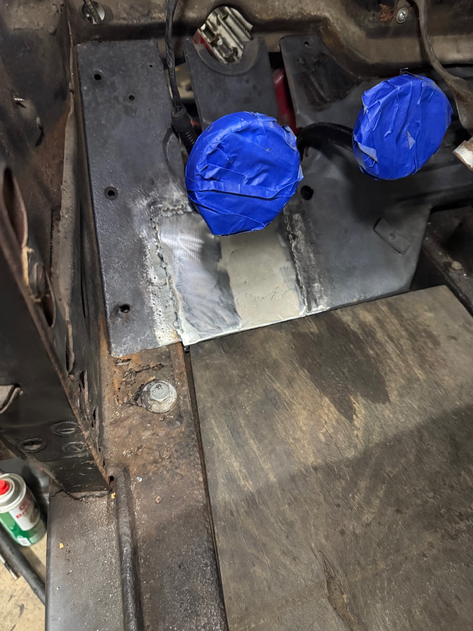

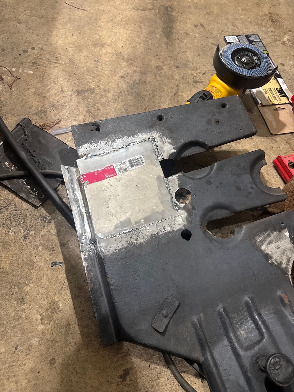

    Whoever had the truck before had done some pretty ****py patch around pedal area IMG_3334.jpeg
    Just made it a little better . It was annoying me
    i think they did some work on the clutch and it looks like the clutch pedal sits a little lower than the brake pedal.

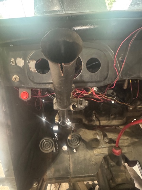

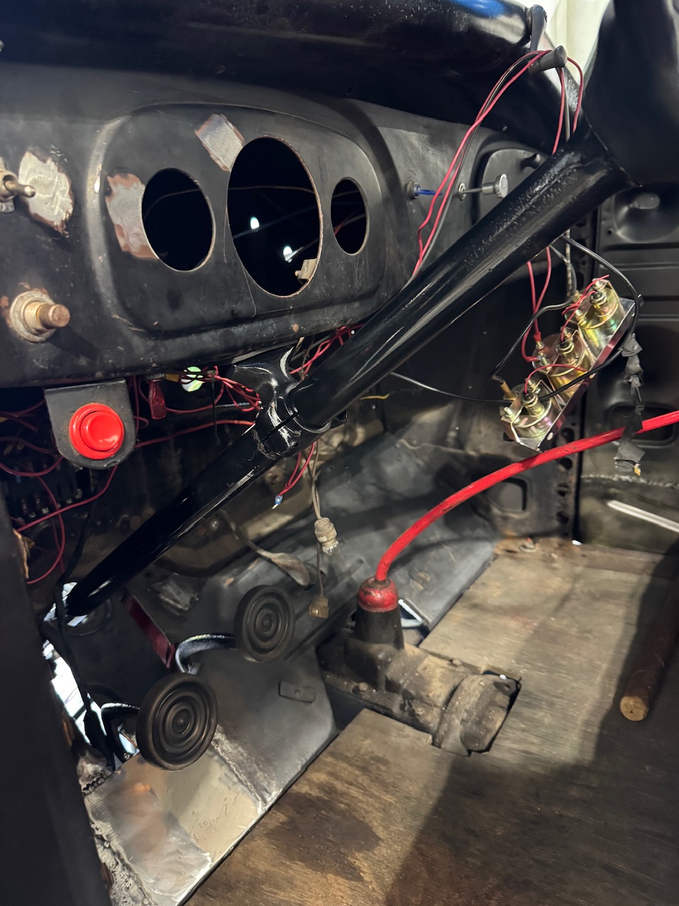

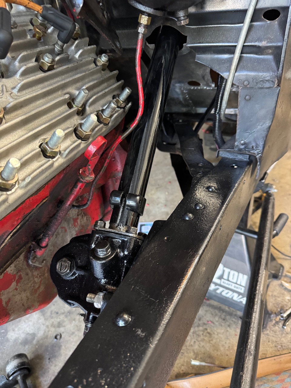

    Cleannnnn steering column! Also repainted the steering box while I had it out and the frame rails. Ignore the ****py wiring. I promise I’ll get to it eventually lol

    ****py wiring?:confused: Man, this is a work in progress. One thing at a time. It isn't like you have a team of six guys working on it 10 hours a day.;) You are doing it all by yourself. Learning as you go.;) It is looking pretty good, and the "****py wiring" will one day tucked away out of sight while you drive it down the road.:cool: No need to apologize for work in progress.:D
