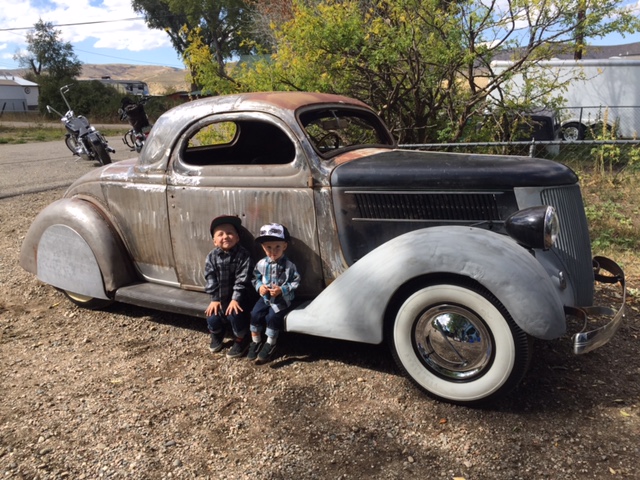

  15. One last photo with the kiddos before she gets locked up into storage for the winter. Now that most of the cutting/grinding/welding is done I look forward to working on the next portion of the car with them. The family and I have decided to dodge the heavy snow this year and head west, so this winter I'll be without my little shop or tools which means she's on hold for the time. Hopefully this will allow me to return to the project like a bullet out of a gun, hungry to continue the process.
    Thank you so much to everyone for the kind words and encouragement!
