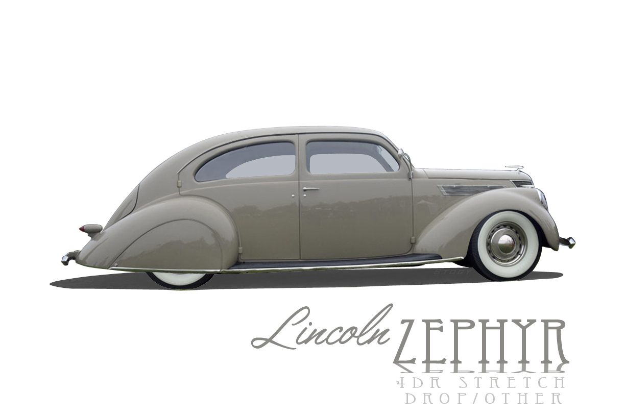

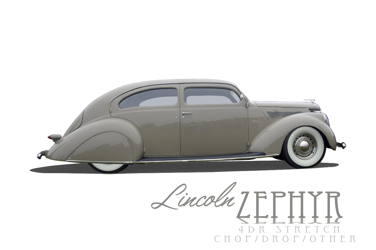

  8. Stogy
    Joined: Feb 10, 2007
    Posts: 27,218
    Stogy
    Photoshop is really incredible for Inspirations...It's even in many ways like the real thing however it ends there as the real steel will pose a much bigger challenge...
    Suicide rear doors no problem...I have no doubt it can be achieved...I think the bottom hinge would be quite unusual. You could also run hidden hinges on the center post and open the rear same as front as that would be easier, but what fun is that. Anyways I had fun with these...Other things I did were make the side hood panel one piece to the grille and stretch the side hood venting, shave the bumpers. drop the mirror, fiddled some with the rear door window openings albeit I kinda like them long. Hotrod/Custom is such a personal thing...and I like it that way...And @fruitygreen, I get why you want to lengthen the doors...Please share the journey with it...No pressure either...
    By the way Stretch is only in the Doors not the wheelbase...(Note this was a 2dr image modified and it looks as if they all had same wheelbase)...The other thing I did was ditch the rear door handle and left an optional key/****on for the what will be a sophisticated entry to the rear for the Ladies as Hotrods win the race and Customs get the girls...;)

  9. Squablow
    Joined: Apr 26, 2005
    Posts: 18,543
    Squablow
    Unfortunately the hinges need to have an imaginary line running straight through the pin holes or they won't work. The lower hinge in this picture would need to be in the middle of the tire.

  10. Stogy
    Posts: 27,218
    Stogy
    I did say Photoshop was great for inspiration...will it work....hmmmm...:confused:...I was also thinking something that would allow the door to come out then pivot back...or the bottom hinge could be a hidden track that rotates out with the upper hinge doing something lesser. Or he can angle the hinges and cut the fender and skirt and fix it to the door...but that wouldn't look to great would it...
    Or maybe a gull wing style...if it was me I'd hinge forward. Hidden at that. I don't believe rear opening doors would make entry any easier.

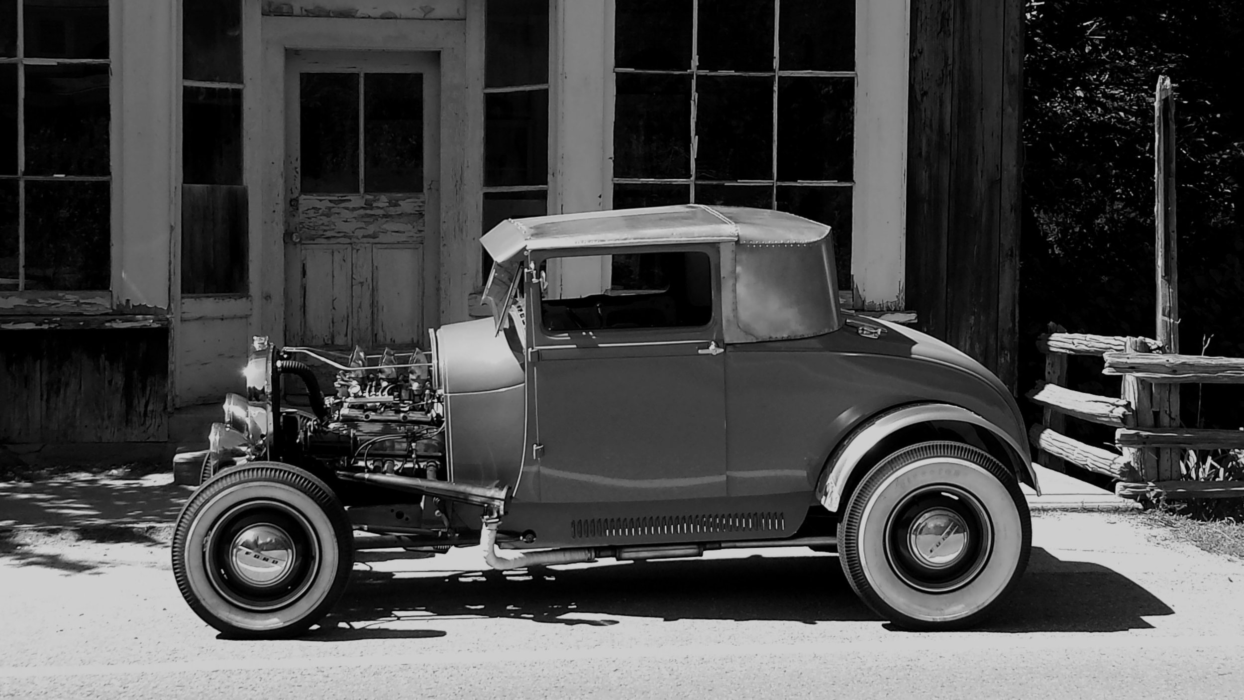

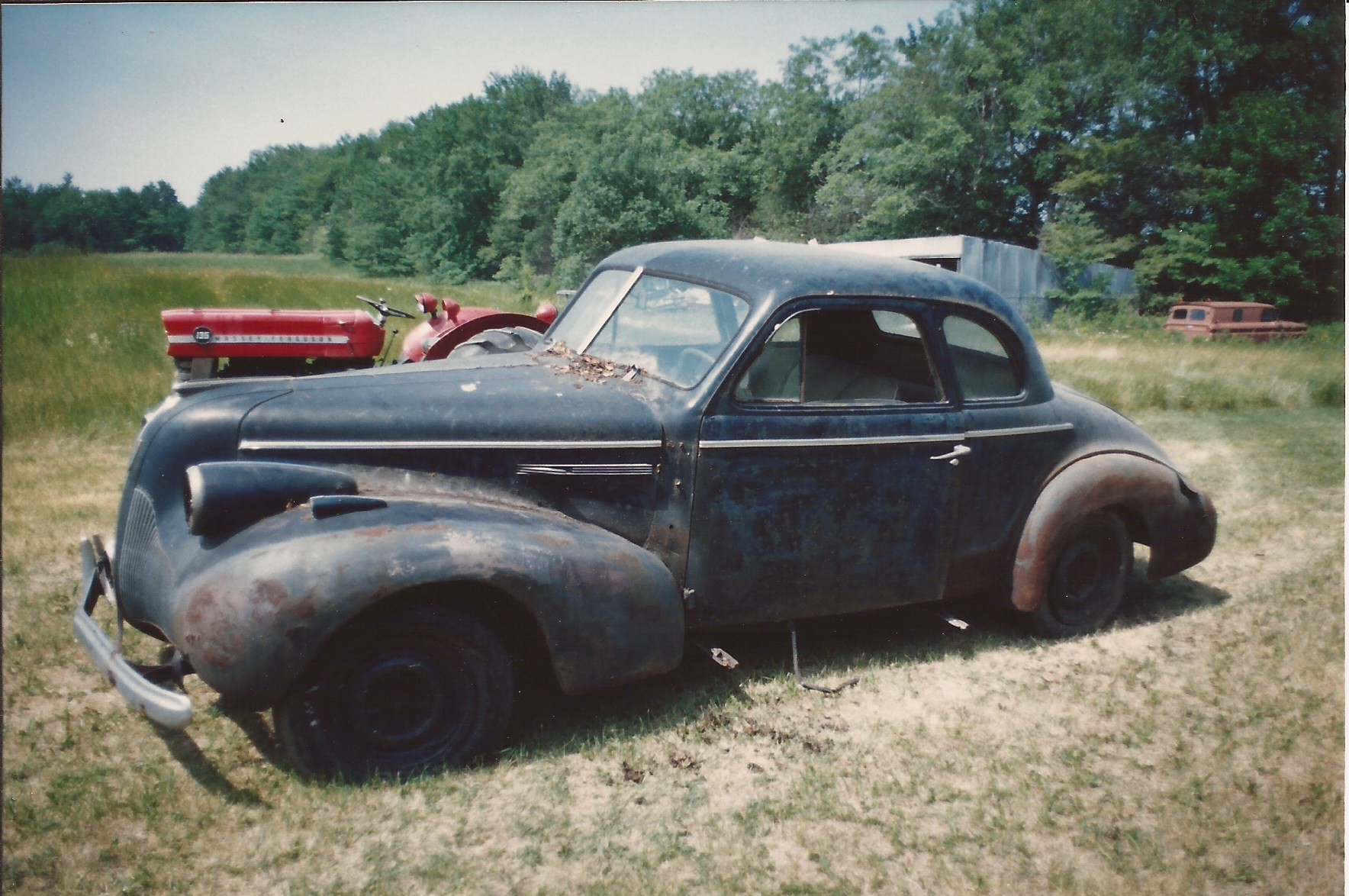

  19. Stogy
    Posts: 27,218
    Stogy
    Like any pics of the car not buried in the garage...for example my Sport Coupe and a Buick I owned. I mean, most here don't mind sharing a full pic of their rides...It's entirely up to you...I enjoyed doing the inspirations, I think we had the year and Model correct...and I found through websearch that the wheelbase was the same for 2 & 4 drs...

  22. Stogy
    Posts: 27,218
    Stogy
    We'd all enjoy them...I can't wait to see what you do to it. Are you considering other details such as, lowering, hopping up the v12...I think they had them didn't they? Possible chop...What do you think of the hood mod I did, eliminating the curve and extending the trim/vents also on the hoodside?

  24. skooch
    Joined: Feb 7, 2007
    Posts: 760
    skooch
    For what it’s worth, I REALLY like the photoshops that have been shared especially the unchopped versions. Sleek and smooth while still retaining the charm of the original. Of course chopped would be very gangster.

  25. nrgwizard
    Joined: Aug 18, 2006
    Posts: 3,045
    nrgwizard
    from Minn. uSA
    I like the details/proportions on the 4dr Linc Zeph Stretch. The rear door hinge line being straight is worlds better than a curved line following the rear window corner. That appears as if it's trying 'way too hard. The straight also mimics the other door opening lines.
    From the drawing, it appears that there's ~ enough vertical room for ~3 std hinges stacked. I'd seriously look at making them one long ~7 1/2"(?) long hinge, at least the same thickness as oem(Somewhat like the one Anthony posted.). Like a super-duty version of the hinge-style Es*** used in '28/'29.IDK iffen it matters, similar to an early hood hinge. I'd also incorporate a number of hinge "fingers", instead of the usual 2 short & 1 long finger-wraps, if for no other reason to spread load/wear over a larger(more wear points) area. Maybe not actually needed(? Does anyone actually *know*?). & I'd also look to put bushings in(AMC did this on a lot of their 80's cars, & but the pin was really a pin - 'way too thin, but easily replaced, as were the bushings), to make either them or the pins easily replaceable, since I also don't know about the wear factor. Guessing it's not really needed, but... Attaching the hinge to the body may not be too bad, since you could connect to both the wheelwell, body C pillar & roof area.
    Only other thing, for better proportions, like say mimicking a "Life" magazine ad drawing, the top needs to be chopped ~1" - *maybe* up to 1 1/2". Not so's it's noticeable, actually so's it's *not* noticeable, to get the "experts" & the waah-fo's to wonder that somethings been done, but just what... ?
